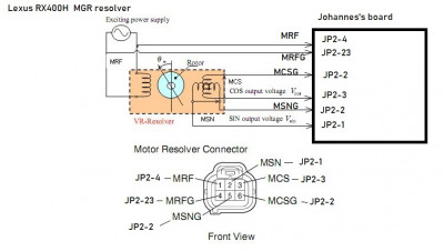

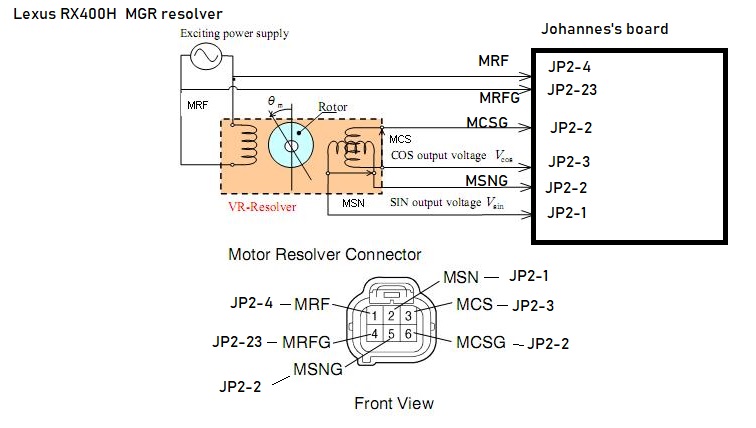

Is there anyone who could confirm the resolver pinout on this?
I have Johannes Gen2 Inverter board connecting to an MGR. Zookeeper, as you have the same setup, could you confirm which pin on the 6 pin resolver connector connects to which pin on the 20 pin inverter connector?

tom3141 wrote: Thu Aug 27, 2020 3:57 pm Is there anyone who could confirm the resolver pinout on this?
The ONLY change from the diagram is JP2-23 is pin 5 "R2" on the VCU.

Re: Toyota MGR Rear Traction Transaxle
Post by tom3141 »
Brilliant. Thank you!

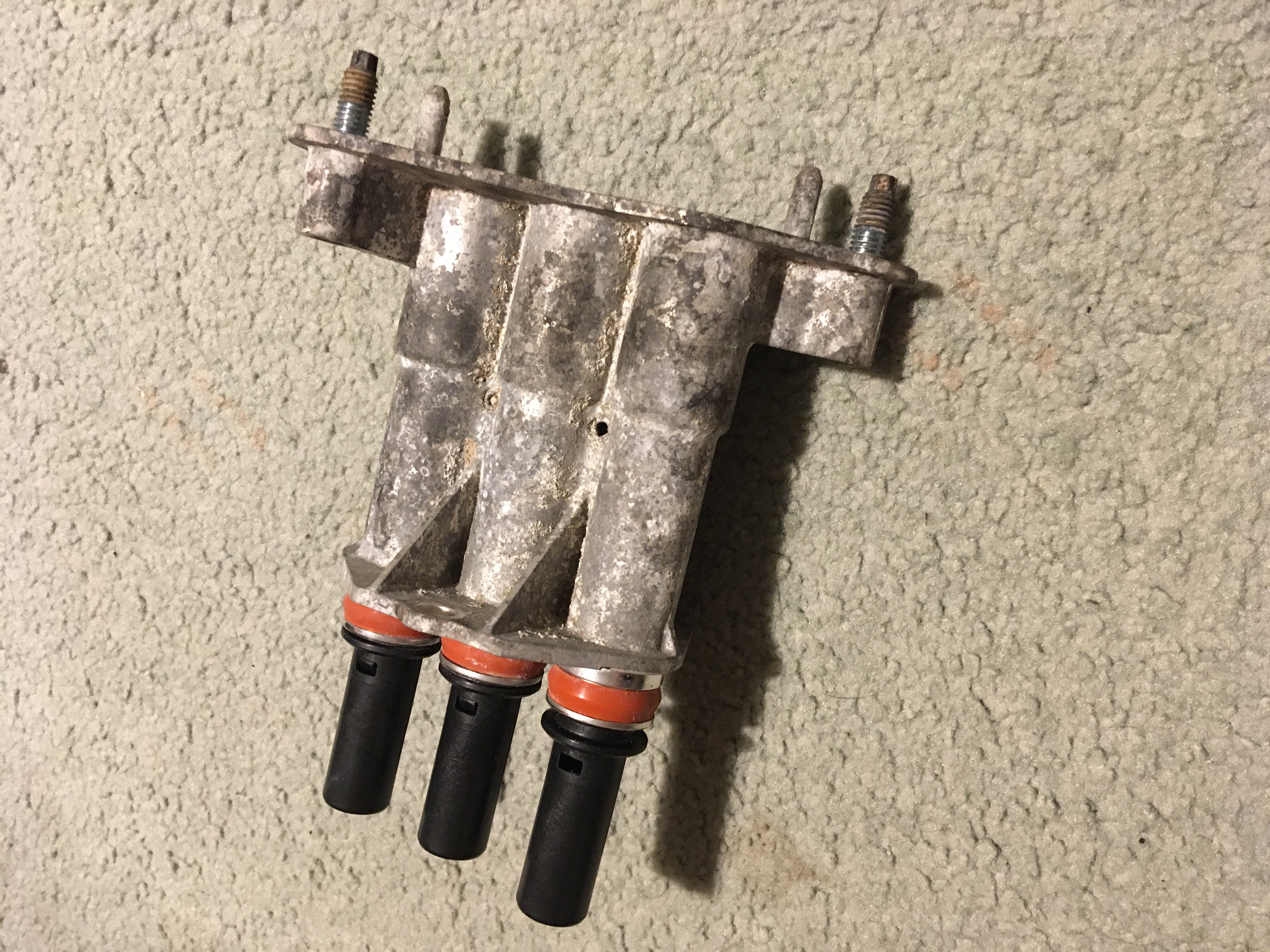

I only have the extension piece, not the connector itself. If it’s any use the extension part number is 82090-48010, photo below

Post by ZooKeeper »
When I looked, the 3ph connection (wiring) was only available as part of some "engine harness" and really costly. I was lucky to get blunt-cut wires on mine :)

Post by tom3141 »
I was thinking that I might cut away some of the aluminium on the extension piece so that I can drill a hole in the contact blades and connect that way.

Post by ZooKeeper »
tom3141 wrote: Thu Aug 27, 2020 9:03 pm I was thinking that I might cut away some of the aluminium on the extension piece so that I can drill a hole in the contact blades and connect that way.
I seem to remember seeing some TE female terminal in about their size, combined with insulation and a method to hold them all in place, might be an option worth looking into.

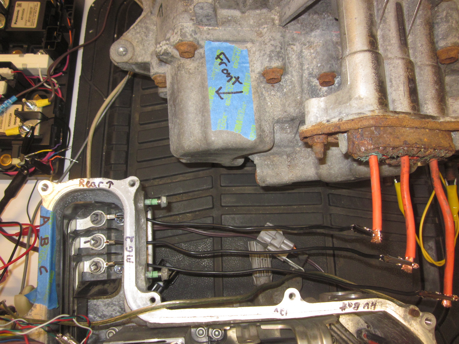

Managed to get my MGR spinning nicely on 30V tonight :)
Thanks to everyone who has contributed to these discussions and the wiki. It’s meant that I can get up and running with it very quickly. I’m happy to start trying to put together a wiki on the MGR if people think that it would be worthwhile?
I’m using a Prius Gen2 inverter with Johannes smd PCB wired as per the wiki schematic. The resolver is connected as per Zookeepers post above and phases as per Zookeepers photo below:
I tried using the exact same parameters as Zookeeper but ended up having to change syncofs. With syncofs at 43500 it spun ok in both directions but would slow down and get jerky as I increased throttle input. It also span the opposite way to the way it should (forward when reverse selected and vice versa).
I then went through the wiki procedure for tuning syncofs and a setting in the region of 7000-9000 seems best. Interestingly about 32000 less than Zookeepers which would explain the direction reversal. It now spins the correct way and will spin up to around 1000rpm in both directions until I hit the current limit of my power supply.
The plan now is to get it into my car as soon as possible to try it a full voltage (300v) and see what it can do.
