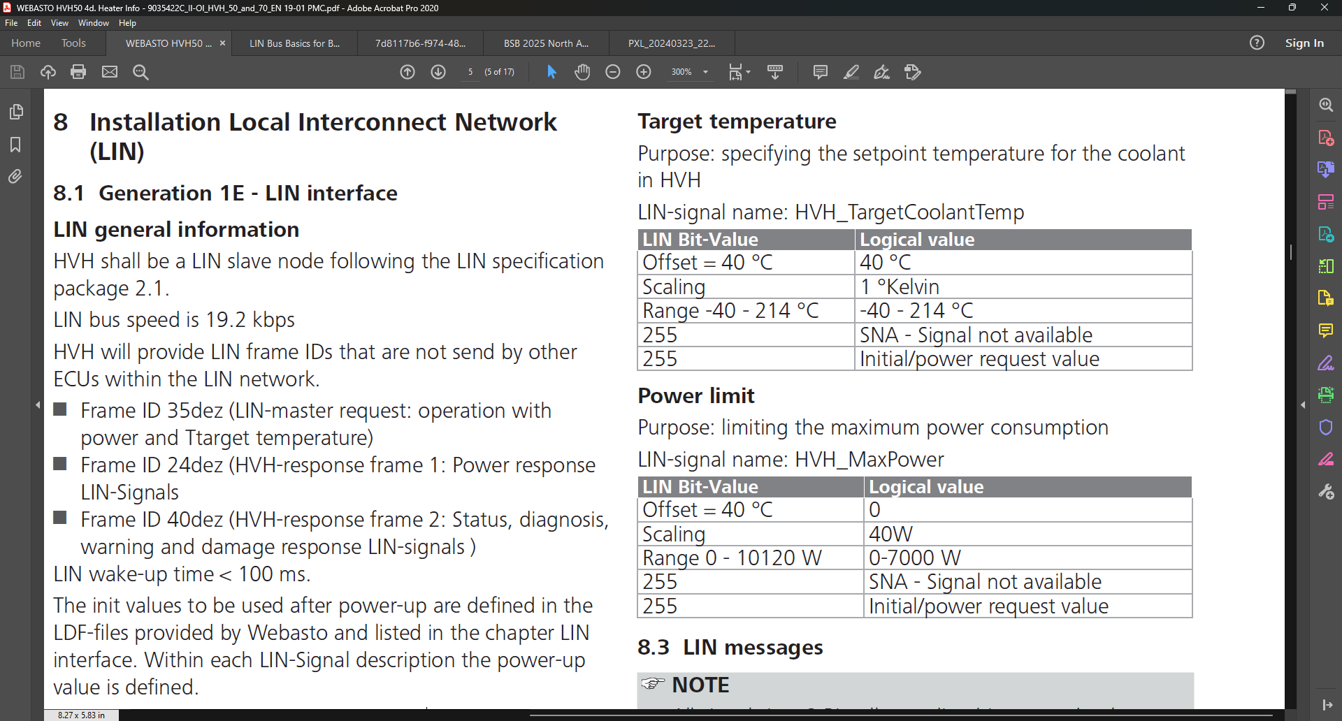

I am curious why the final data byte 8 goes back and forth between 0 and 1. The wiki page lists the 8 bytes out. I wonder if the 0,1 back and forth is trying to turn the heater on, but it is not appearing in the correct location.
 	Status
          	4=running
          	Outlet temp
		Scaling as above
		Inlet temp	-
		Voltage LSB
		Voltage MSB - 2 bits
		Power LSB - 6 bits / Power MSB 1 digit=20W
		Unknown
For some reason, the formula in the STM32 version used to decode the data is not giving me accurate info:
Interesting to me that the data readouts by each number are different that the printout of the linRXdata repones of:
59, 0, 114, 58, 64,0, 239, 0

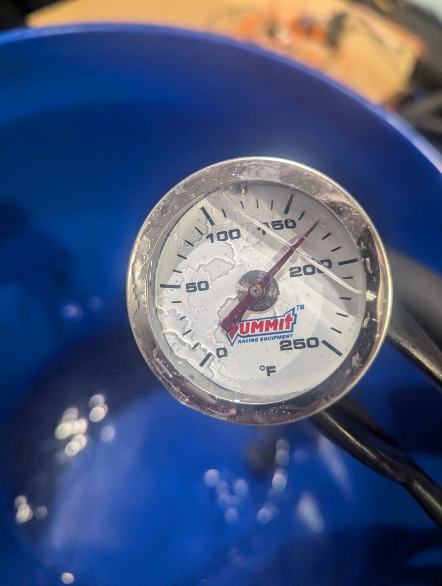

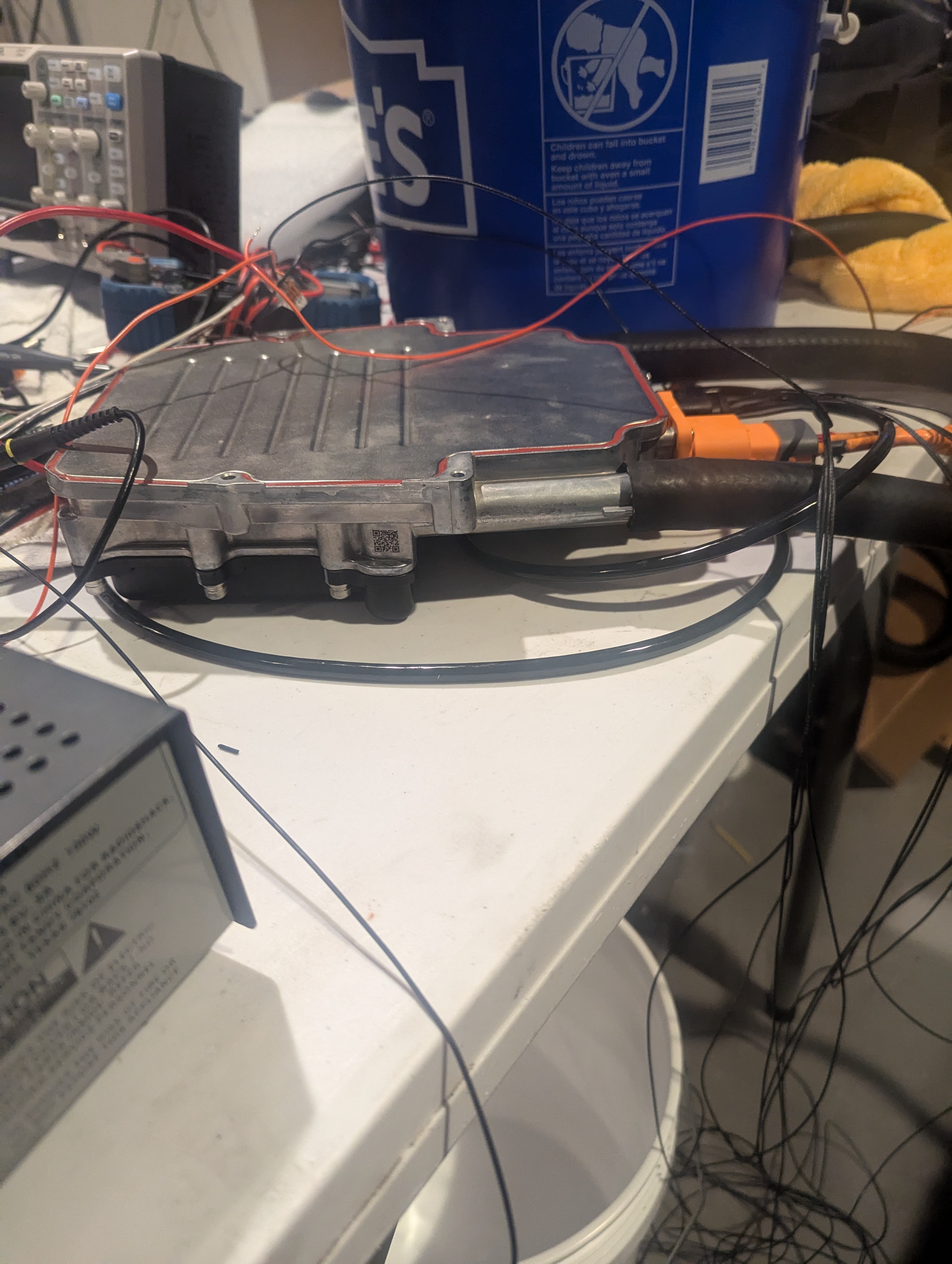

I HAVE HOT WATER!!!!!!
So I went to bed last night thinking about what I was missing and woke up with the thought that there might be info hidden in DATA[0] since DATA[1] was used to calculate temp and I recall Johan mentioning that the on status would be in byte 0, so I modified the code to print out DATA[0] through DATA [8] using lin.response ID 39 and running through all of the lin.order IDs.
I ran this code:

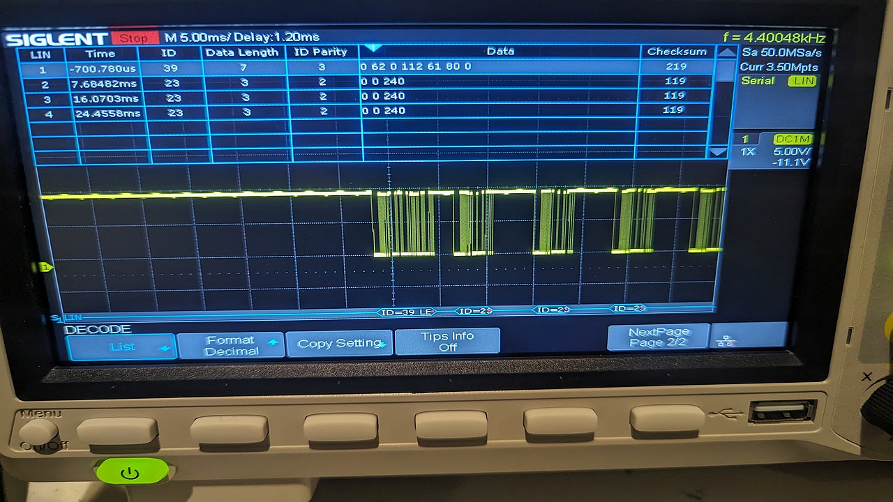

with this response:
orderID:30,Temp:19,Udc:58,Power:320
CRC:0
0,59,0,0,58,64,0,238,27
orderID:31,Temp:19,Udc:58,Power:320
CRC:0
orderID:32,Temp:19,Udc:58,Power:320
CRC:0
0,59,0,0,58,64,0,237,27
orderID:33,Temp:19,Udc:58,Power:320
CRC:0
orderID:34,Temp:19,Udc:58,Power:320
CRC:0
0,59,0,0,58,64,0,239,27

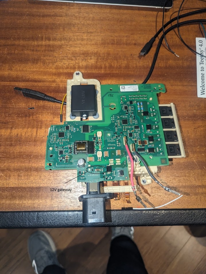

espriev wrote: Mon Jul 08, 2024 4:55 pm I am going to open this thing up and trace out the circuit.
Just so you know, I did this as well a while back. Here is a photo of the board. I purchased an extra heater at a good price that was sold without warranty it was functioning. I opened in up and started checking for continuity and I was able to identify some of the pathways, such as the HVIL loop and the 12V line pathway to a dead end after the resistor at a small black chip (circled below), which might be the gateway that opens when the proper LIN command is received. I assume this could be bypassed, but I abandoned this in favor of learning how to program the LIN with a sealed unit. I also discovered that there is a GND wire in the 8 wire setup (#8) that I started using with the board outside of the metal case, just to make sure the board was getting a good GND signal. I actually got some sparks with the 12v only attached when the multimeter prong touched across a couple of lines accidentally. I agree that there should be a way to bypass the lockout of 12V on and off that is closed in programming.

Thanks for showing that, it looks plenty complicated!
If only they would sell the 12VDC controlled model, or if there were information on what application it was used in...
With the help you have provided I will pursue getting the local college's programming school to take it on as a project.

Hello everyone. I have finally SOLVED the HV heater issue and can set out a path for anyone still trying to incorporate an HV coolant heater into their EV build.
After not having much luck with the various HV50 or HV70 heaters from various companies like Volvo and Chrysler, I looked into other options and found this company and their HV Heater.
https://www.auto-parkingheater.com/elec ... -cars.html Ask for Luda.
The form factor for this HV Heater is almost identical to the Webasto HV50/70, probably a little smaller actually. The cost, including international FedEx shipping to my home in the USA was under $350.00 AND it came with all of the mating connectors, already wired up. The LV connector is identical to the Webasto LV connector. The HV connector is similar to the Webasto one, but has a slightly different key at the top. Also, it is brand new and not harvested from a junked EV.
Best part about this is that it came with the manual and all of the LIN commands and IDs and baud rate and the proper LDF (Lin Description File) and tech support to get things working. I was able to salvage the code we started on this post and completed with the help of folks on the teensy forum site. I ran the final code tonight and it was heating the water on my test bench to 80C.
Here is the code for anyone that wants to go this route [UPDATED ON 8-19-24]:

So for tests bought a broken HVH unit(9033263D) from JLR and a cheap USB LINTEST-MI adapter from Aliexpress which comes with a software to talk to LIN and also has internal DC-DC 500mA converter to 12V to drive LIN slave.
As the heater didn't come with wiring then removed the low-voltage (LV) connector and tapped directly to pins. The connector (9033777A) is replaceable so that can help if used unit comes with broken one just replace it from failed.

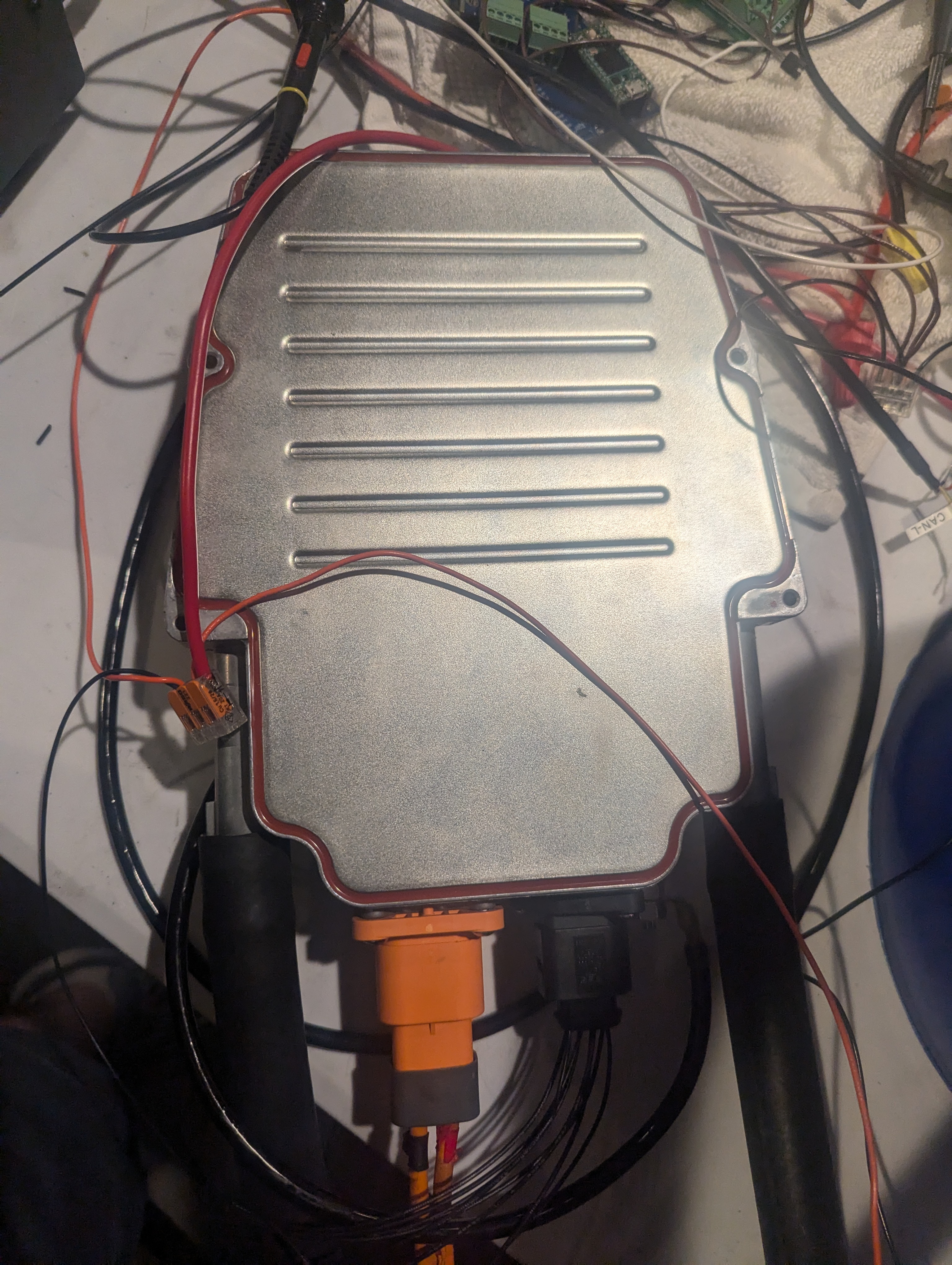

My lab setup for bench testing:
Took an hour fiddling with it until finally got some response. Seems Webasto settings from workshop manual do not correspond to OEM units.
LIN adapter has no auto-baud detection so baud has to be set to 9600 for this unit.
The LIN frame IDs are same as wiki first column, 21 (0x15h) for heating request frame, 22 (0x16h) for operating status and 23 (0x17h) for diagnostic values.
Communication:
So from response it is clear that this heater is shot. It has permanent lock flag so even replacing PTC core it won't be reset. In case it would be overheatlock then there is also reset command to unlock if temporary locked in case of overheat event: UDS Service Write Data by ID (0x22) FD1A - unlocks the control unit and reactivates for heating mode.
