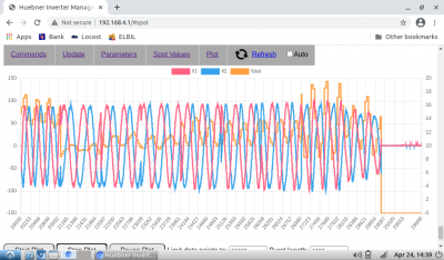

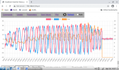

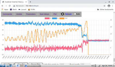

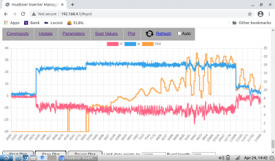

Results from current plots during stuttering. I'm focusing on the stuttering between 2-3km/h as it is here it really oscillates. When I increase current by applying brakes simultaniously as a drive forward, the oscillation seem to increases in magnitude.
When looking at fstat in the first plot below, one can clearly see the area where it starts to oscillate. The oscillation also shows in the Iq and Id currents. In the second plot, very obvious effect on Iq during oscillation.
Id & Iq left, fstat right
When looking at il1 and il2 it is much harders to so what is going on. Currents seem to chage shape and/or phase during the oscillation.
il1 & il2 left, fstat right
The question is, what causes what? If you send strange output to the motor it will behave strange and give strange input feedback...
Not sure this tells anything more than an oscillation occurs at certain speed. Could it be a issue in SW similar to what happend with the tested TIobserver speed calculation, that induced oscillation, but at standstill.
This behavior seem to always occur at the same speed.

Ah, you're correct of course, that's sine and not foc. Although some of the techniques may transfer over, not sure. I'll get to that at some point I'm sure haha
Yes, almost impossible to work out if current oscillations are causing or caused by motor movement. Same with the encoder I guess. As it's always the same speed, my gut feeling is that a software oscillation is being magnified by mechanical resonance though.
Oscillation increases with higher currents... that's quite interesting, as noise will have less effect at higher currents (unless you've got a load of unshielded HV cable wrapped around something sensitive :) ) Your il1 and il2 plots seem pretty good too, I'm tempted to discount noise as a cause.
Thoughts: From your first two plots, it looks like the oscillation in fstat is 'always' there, but I can't make out if the frequency is fairly constant or changes with speed. What do you think, do you see oscillations in fstat on the plot at higher speeds (difficult to test, appreciated) or lower speeds? Do they seem to be constant frequency or related to speed? Increasing with speed could suggest a mechanical cause? (I had a similar fstat plot when my encoder was off centre, unlikely with your hardware. But bent driveshaft? Stiff bearing? Doesn't seem particularly likely, but worth asking, can you feel any 'stiff points' if you jack up the front wheels and turn by hand?) Have you checked resistance between each pair of phases?
It also looks like during the large oscillations, iq rises at the same time as fstat, and falls at the same time too? Which is the opposite to what I'd expect for a constant torque request. But fstat leads iq slightly? Certainly feels like a poorly adjusted control loop...
Your second two plots... I don't like the instantaneous changes in phase at all! And these are readings from the current sensors, so aren't just artefacts of calculations...
Have you played with curkp and curki? I remember reading a post fairly recently where someone had adjusted these and improved iq and id control. I'm not sure what the technique was... I'd suggest trying locking the wheels, apply a little throttle, and adjusting the gains, probably reduce at first?
fstat is calculated from turns per time period, so should always lag a little. But should change slowly relative to all the important variables (except at very low speeds.....) id and iq are the outputs of the Clarke Park transforms - I think these rely on angle and not speed so should be 'correct'. and then the pwm is set based on the transforms, and il1 and il2 are just measurements of actual phase currents. If there is oscillation causing id and iq to lag fstat (which already lags angle), that would point to excess integral gain in the loop I think...
I also note that fstat is around 10Hz as the oscillation gets really bad. Could be a coincidence, but this is when syncadv starts to kick in... I can compile a binary with no syncadv at all if you like? (as a test - it will ruin higher speed performance :) )
I don't suppose you'd be able to stick a camera pointing at your motor during one of these tests? It'd be interesting to see how much physical vibration there is.

One comment on these out of phase currents: they are plot artefacts, it pulls 1000 samples at a time.

Yes, the plots are not trustworthy when it comes to time due to the not constant sampling. Is it possible to somehow get constant sampling out via the WiFi-interface? It is hard to use a serial cable while driving the car.
In a theoretical ideal world I expect fstat to be a line without any oscillation, correct?

A bit higher speed fstat plot.
A fstat plot at oscillation speed.
Does not seem to vary with speed... but not obvious.
Stock I got curkp 32 and curki 20000.
A lower curki reduces the oscillation significantly. at curki 1000 I can still hear something but I can't feel it. Increasing to 50000 makes the oscillation larger.
Compare with the above at same fstat, curki 1000.
A higher curkp seem to slightly reduce oscillation, but not at all as much as decreased ki. Tested up to 128.

Still some oscillation in fstat then even away from 'vibration speed'... But it's only ~1Hz of variation, maybe not worth worrying about.
Good results with curki! Any negative drivability effects? Edit: Even if so, I wonder about setting curki over CAN based on speed... could be a nice workaround. Or in fact, I'd be happy to add some sort on curki ramp into the firmware for you if that's neater. (Still a dirty hack though hahah)

Back to 5.06 with same settings, ok but some stuttering very close to standstill during regen stops.
Tested 5.00 with same settings. This really have bad/nasty regen stops when comparing to 5.06.
My conclusion is 5.00 is not usable with settings above for regen stops. 5.06 is useable but still room for improvment. TIobserver is perfect but needs improvment in other areas.
