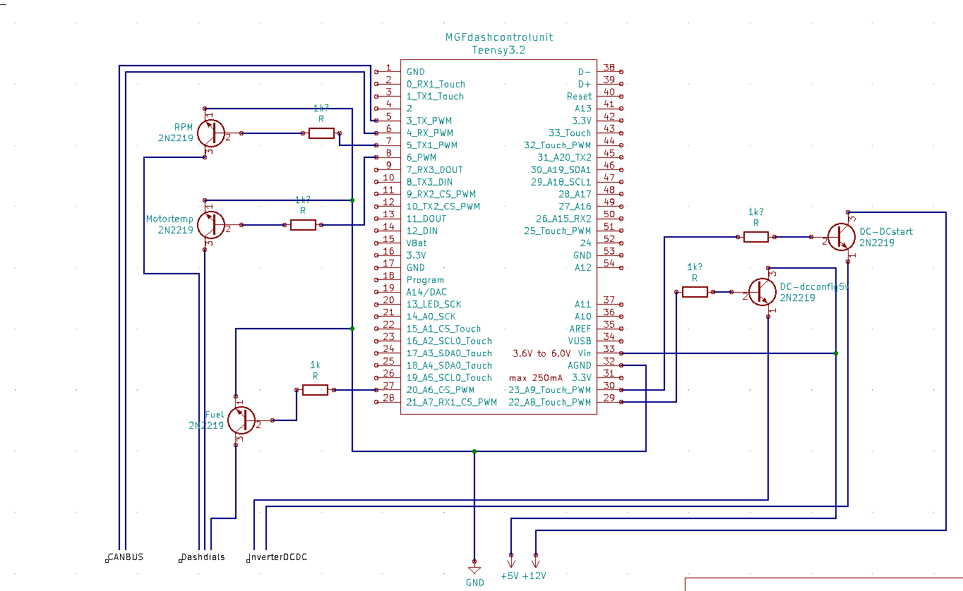

I'm currently working on the dash dials on my project. It is looking pretty simple in theory.
My RPM is controlled by square waves, the motor temp and fuel temp gauges can be controlled via PWM. Thanks to Clangers wiring diagrams I was able to confirm that I can control some gauges with pwm and a transistor on my arduino.
My plan is to use a teensy 3.2 to read the canbus signals from OpenBMS and Openinverter, and then send out the relevant signals.
From the looks of the wiring diagram for my car the dash gauges connect to the ECU which then grounds the signal wires in order to control the gauges. This makes the practical part easier as I am just going to tap into ECU connector and then all I need to do is to PWM that signal to ground. No need to get the dashboard out.
I made a start today on the plan for the control unit. I'm a complete novice when it comes to this sort of stuff, but I think transistors are just about making sense in my head now. I was unsure about the 1k resistor values for a teensy, since the voltage is 3.3v rather than the 5v for the regular arduino, but from my limited understanding that resistor is just there to make sure the voltage doesn't get near the Emitter-Base Breakdown Voltage?
Regarding canbus connections, from what I can gather I only need a transceiver if I want to send canbus messages, the teensy should be able to receive them without any additional hardware.
It's pretty simple on the inputs and outputs side, just the two canbus wires and then three signal wires from the dash. I also added in some controls for the dc-dc on my gen 2 prius inverter. Figured it might be handy to have some control over when that dc-dc starts and the output can be controlled with a 0-5v signal. Not sure if the transistors are really the correct tool for the job there, but for now they are just place holders.
I have some transistors on order now, once they arrive I will breadboard all this out and throw some test code on the teensy and see what happens in the car.

You can’t just connect the CAN straight to the Teensy. Even if you just use the receiver, you have a single input on the Teensy and CAN is a differential pair. Also you can easily destroy the Teensy by connecting directly to vehicle wiring. You might be able to bodge it with some transistors etc but it’s easier just to use the device designed for the job.

Fair enough, I'll use a CAN transceiver.DaveH wrote: ↑Tue Mar 23, 2021 9:36 pm You can’t just connect the CAN straight to the Teensy. Even if you just use the receiver, you have a single input on the Teensy and CAN is a differential pair. Also you can easily destroy the Teensy by connecting directly to vehicle wiring. You might be able to bodge it with some transistors etc but it’s easier just to use the device designed for the job.
Just realised that I was being a bit stupid over that tach. In all the notes before I made that wiring diagram I had the tach controlled by a 12v square wave, two waves per rpm. Then I forgot all about that little detail for a few days.
I did some testing today in the car just to confirm the correct wires for fuel and temp gauges. I'll put in the teensy tomorrow and mess around with the pwm. Digipots haven't arrived yet so I'll have to make do for now.

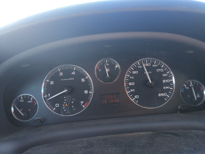

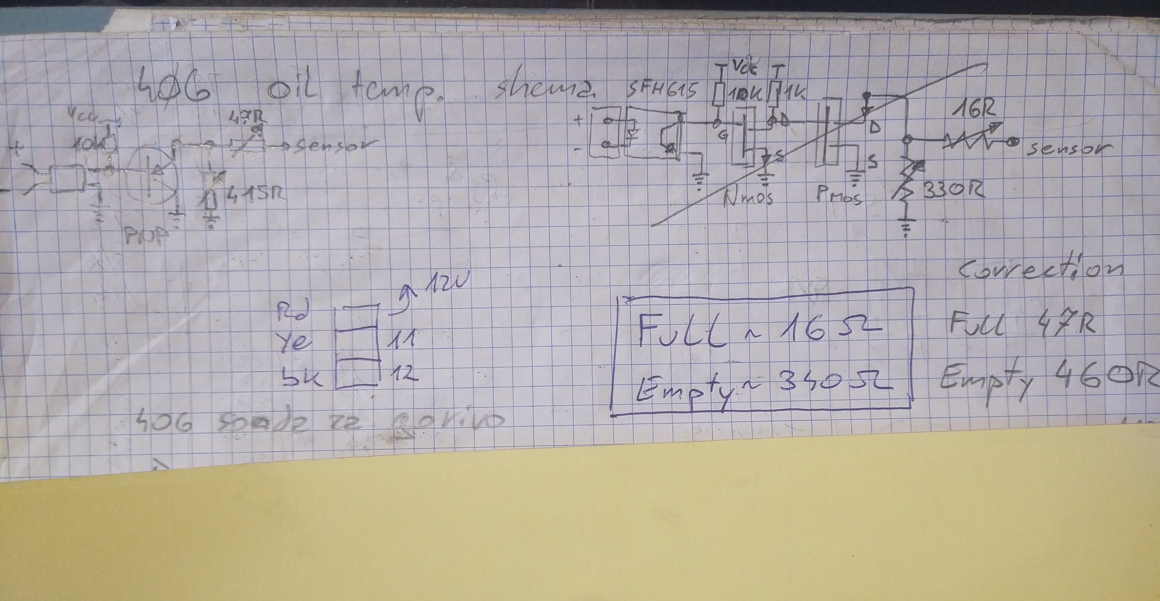

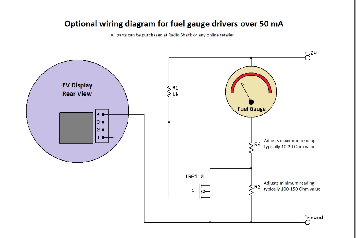

My EVdisplay has one output via which i can drive regular fuel gage. While original setup uses Nmos to pull gage needle from higher resistance (150R for american cars) down to GND via PWM i figured Peugeot fuel gage is wired in reverse.

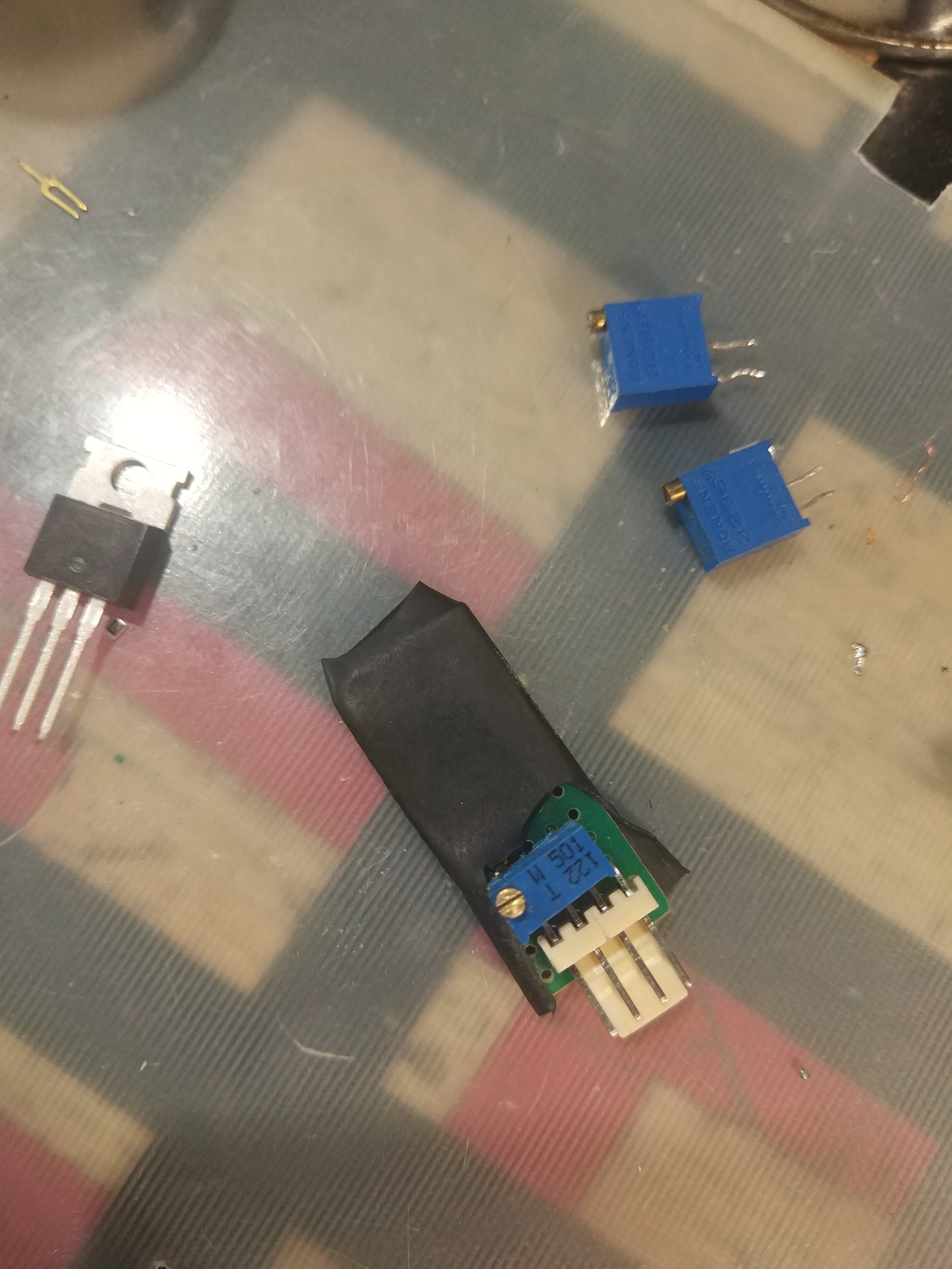

So how to find out what the values are for my car? Simple, i made a small variable pot and wired it into my dash. I used 500R variable pot and tried limit values. I got 16R for "tank full" and 340R for "tank empty". Linearily before needle reaches empty it shows yellow light when still near 310R which is good because i can anticipate empty condition before my battery is actually empty.
Now i needed to make transistor setup that will pull PWM inversly from the original EVdisplay setup. I chose to use original setup first with IRF510 transistor and both resistors. Of course i still needed to use SFH615 optocoupler because EVdisplay is NOT isolated from main battery! So i got inverse function empty when full and full when empty.
Next i added another Pmos to my design. IRF4905 is capable Pmos about proportional to IRF510. Together they make negative PWM signal which pulls less duty when battery gets drained. This means the more PWM EVdisplay is showing the less duty pulls the gage to GND. That way i get inverse effect.

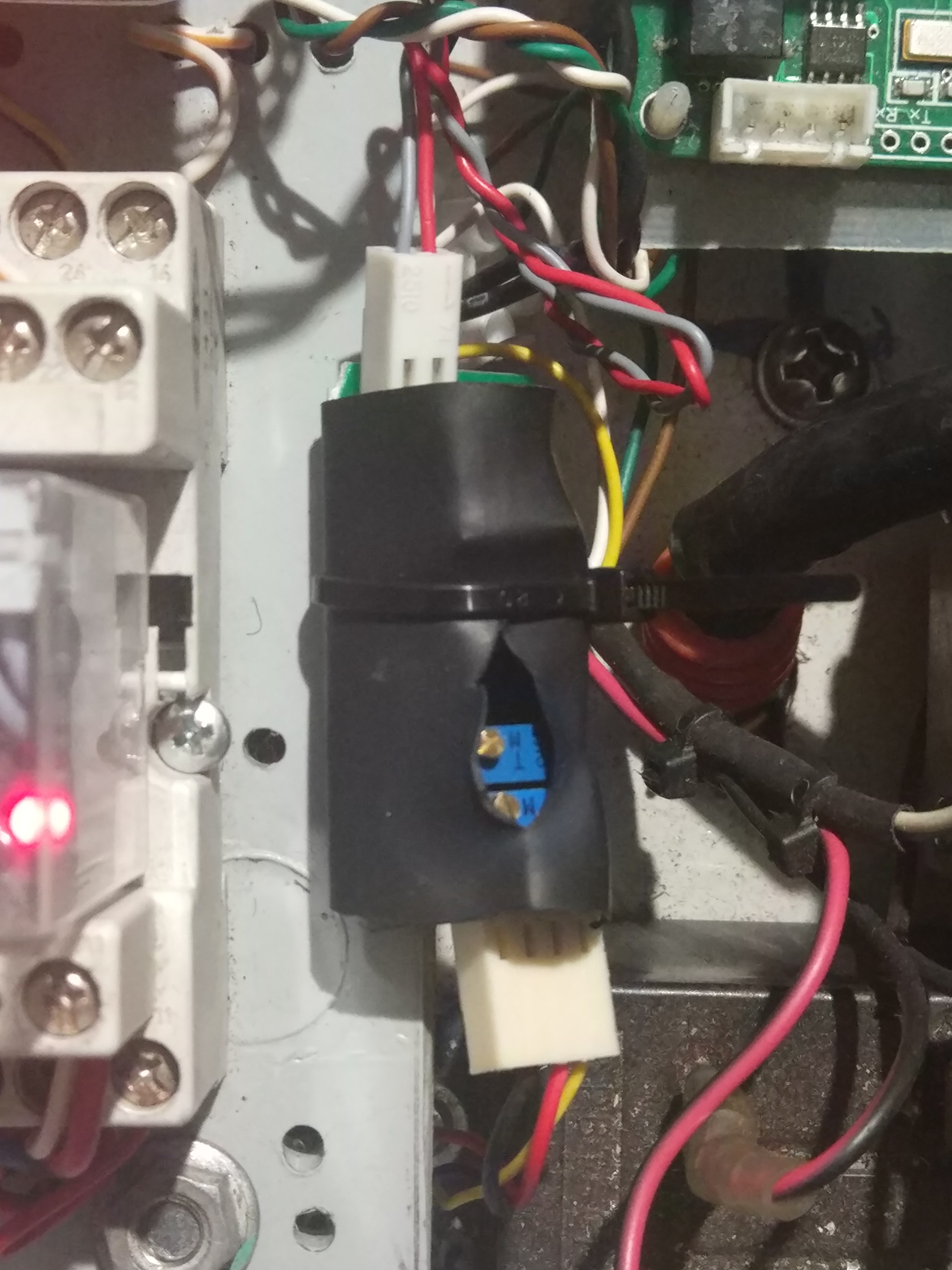

My wiring in the contact box. Output of EVdisplay i use to connect to opto and then convert PWM signal to 12V.
EDIT: My Pmos wiring didnt quite work out. I wonder why... I had since replaced Pmos with a simpler PNP BD244C transistor and some arranged resistors. What i needed to take into account was different PWM behaviour of cars gage circuit at 8Khz that PWM was operating on.
Results were a bit different with 47R value for FULL and 460R for EMPTY thus R2 vas set at 415R. I add circuit below...

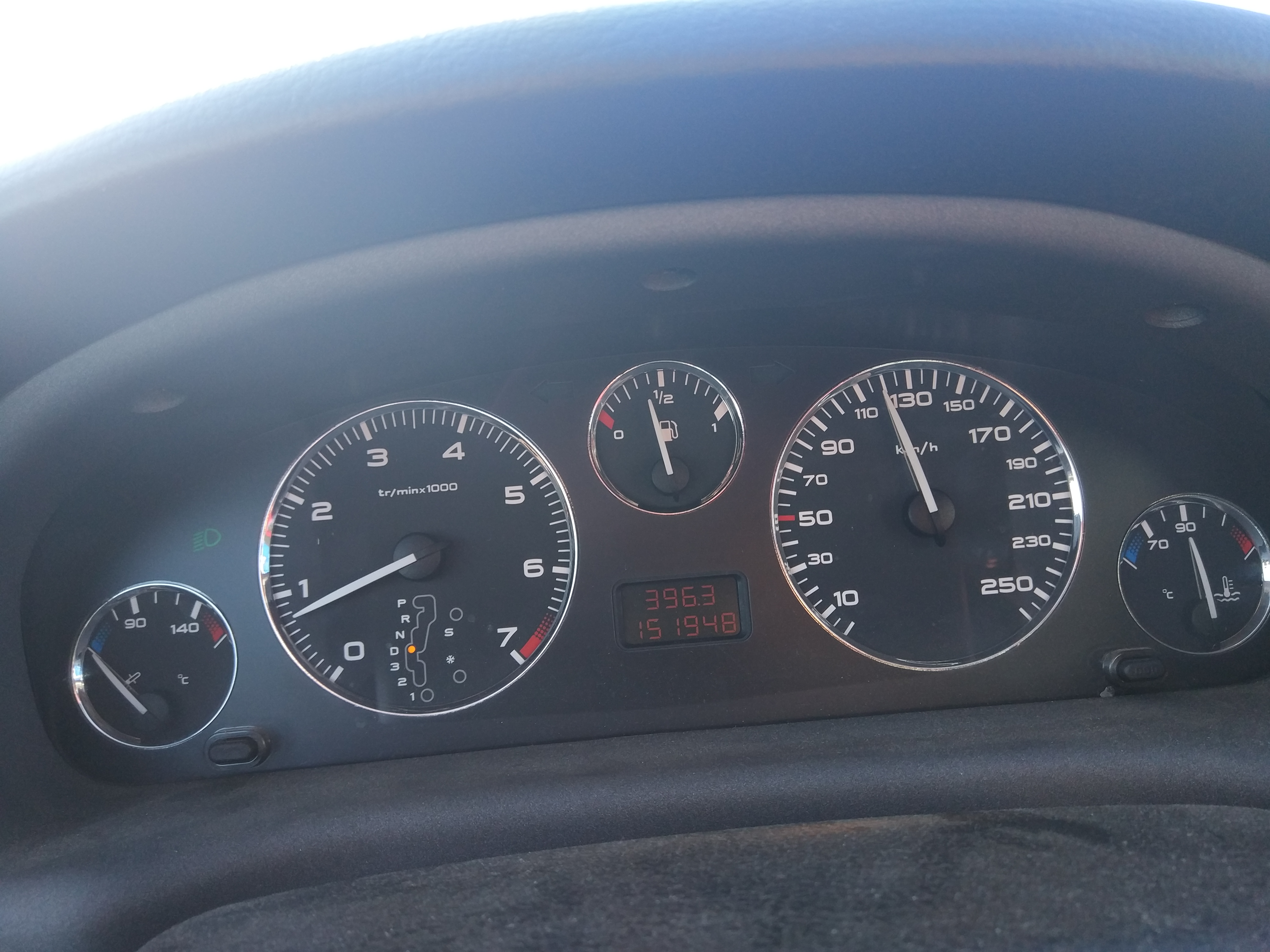

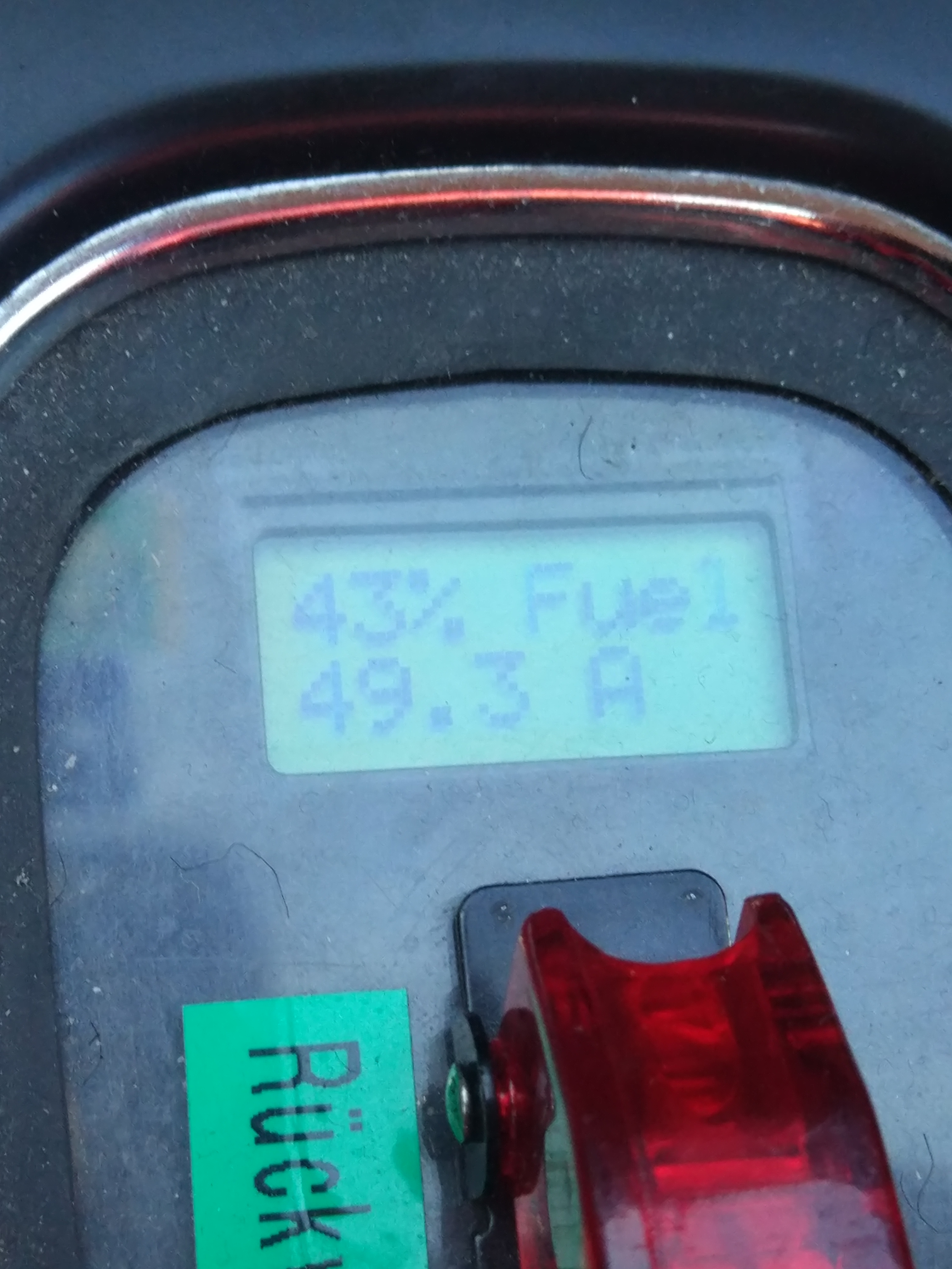

I am adding some additional pics. I have setup my system in such a way there is logic behind the needle position. It now goes through positions of Full, 3/4, 1/2, 1/4 and Empty/reserve with reasonable accuracy. Pics show 43% SOF with a little over 50% of needle travel.
However the function is a little slow and if you would drive all the way i expect the function would show with a little time delay unless you stop.

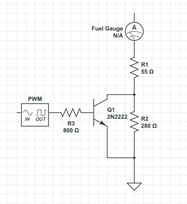

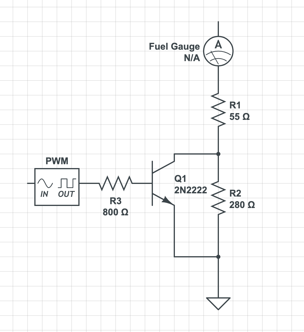

I'm trying to control my fuel gauge but it's not stable. I'm currently just using an UNO to generate a PWM signal, but will be moving over to the STM32 that's already in the car once I've got it sorted.
Any suggestions?
Any suggestions?

2N2222 is not strong enough. You need to use Nmos to quickly show GND to the dial. Now you are probably getting shark teeth...

It was a fixed PWM but the needle was sweeping.
Would an IRF520 be up to the job? I have a couple of those laying around?
- Posts: 3795
- Has thanked: 166 times
- Been thanked: 411 times
Re: Controlling an analog dash
Your resistor could be too small or too large. What make is the car? Is it US or EU made?
Or you might have to use one PNP transistor before Nmos to reverse PWM duty.
EDIT: I see you drive it with Arduino so you can also reverse duty if needed.

arber is right, 2N2222 is too weedy for this application. For the amount of current you can source from your Uno, there isn't enough gain to drive the gauge properly. It just about works but you need something better. You can use an NMOS FET, or a darlington pair should also work. IRF520 is massive overkill but will work fine for testing.

It's a 2003 VW beetle, for UK market made in Mexico will try with the irf520
