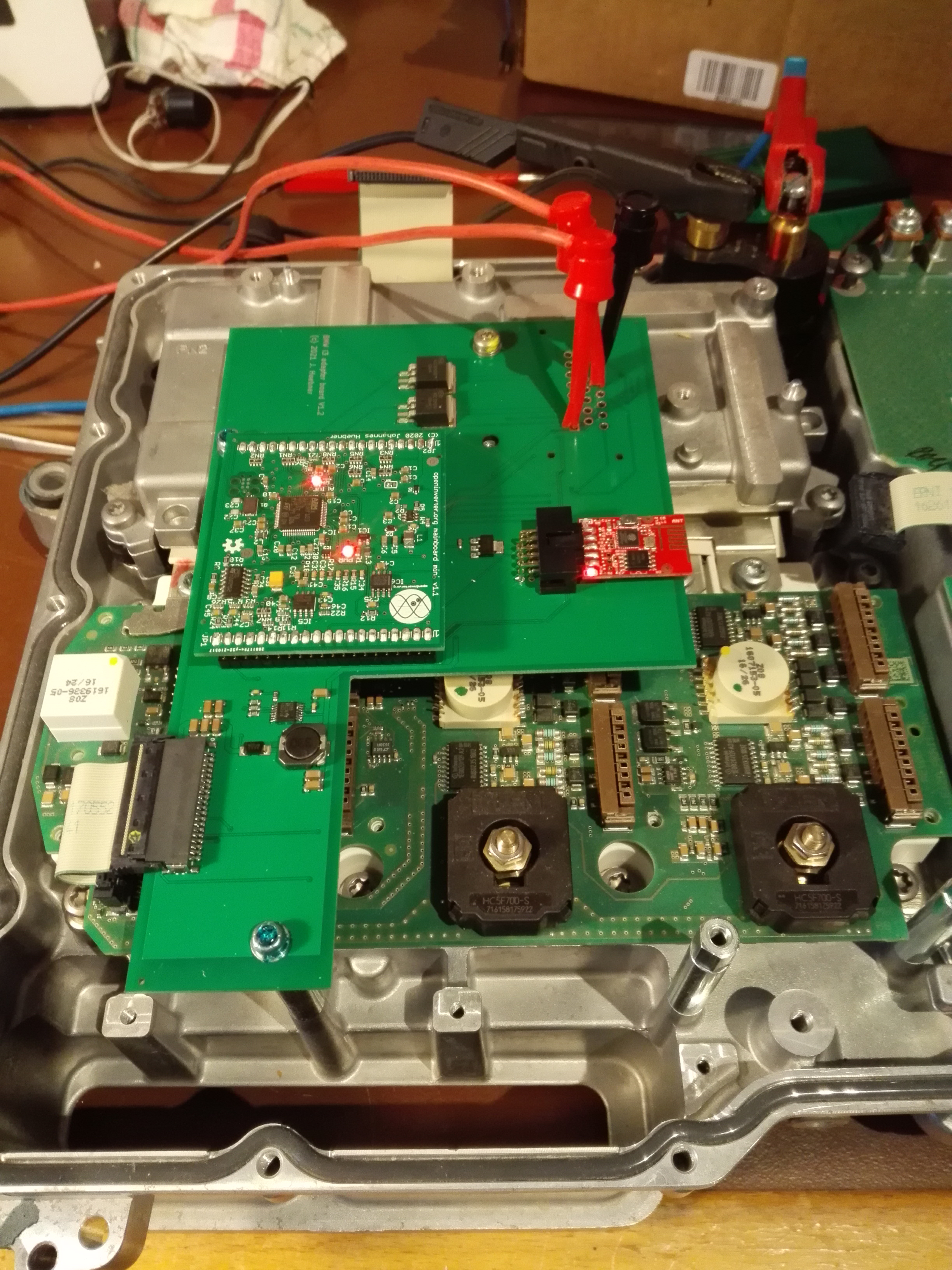

Re: i3 controller hacking from diyelectriccar.com
The next batch of i3 boards arrived today and work flawlessly.
I have to reflow the TPS61175 and the Erni connector by hand. The Erni makes it hard, I bridges several pins back to front on my first attempt. I should be able to ship out the ordered boards by the end of the week.

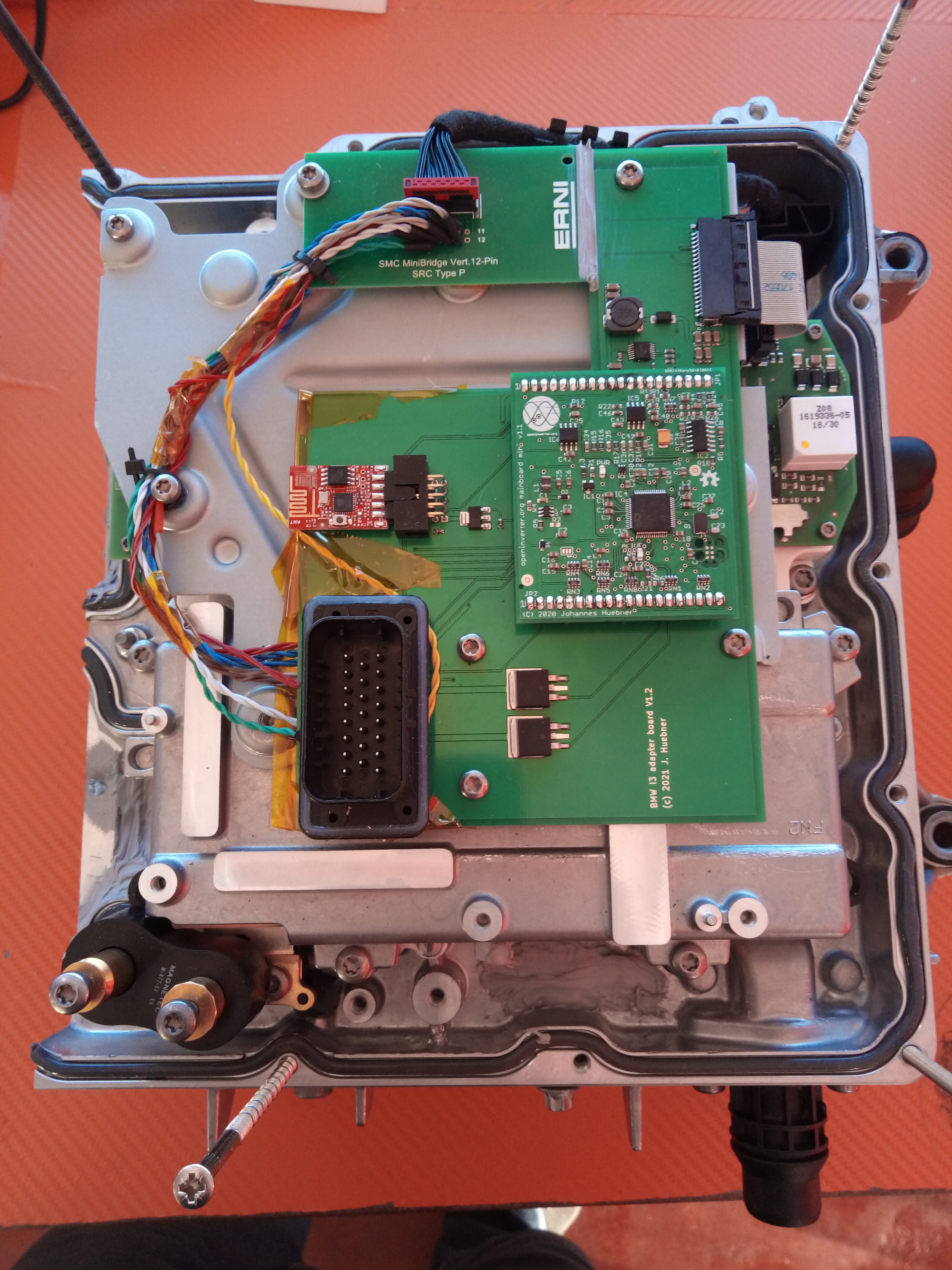

The 12-pin connector from the resolver / motor temp that connects to the BMW brainboard, is the ERNI MiniBridge Koshiri Messerleiste 12-pin, geared, SMT, Art-No. 294920 and it is available for purchase mounted on a handy adapter card.
https://www.erni-x-press.com/en/artikel/kit/169219.html
https://www.erni.com/fileadmin/import/p ... 000162.PDF
https://www.erni-x-press.com/de/artikel ... 94920.html

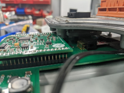

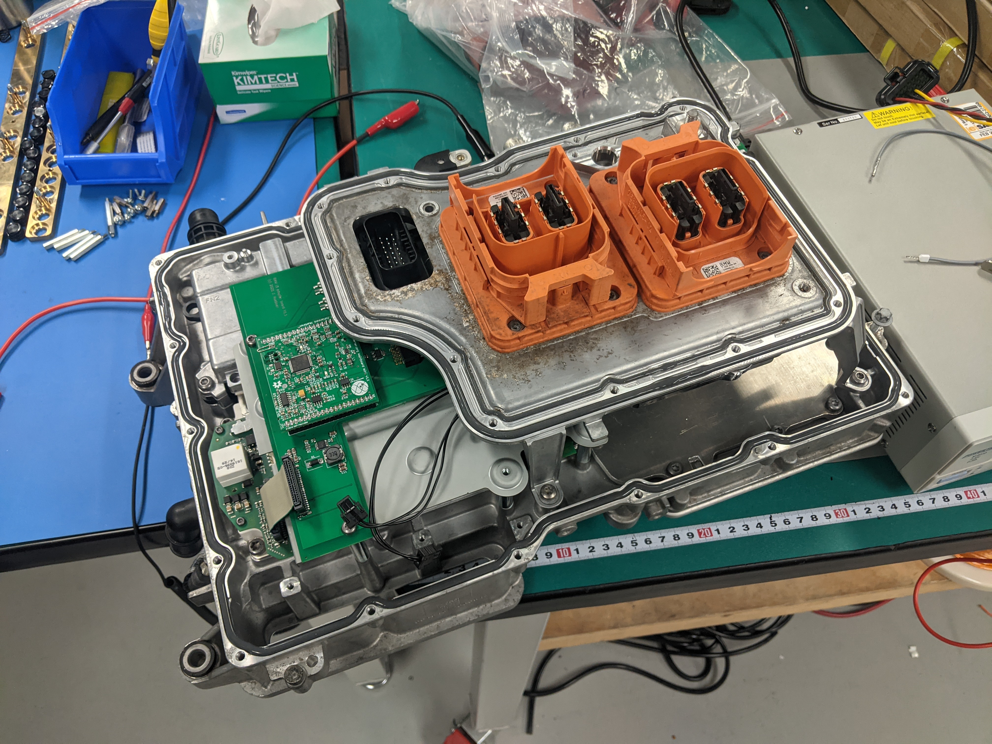

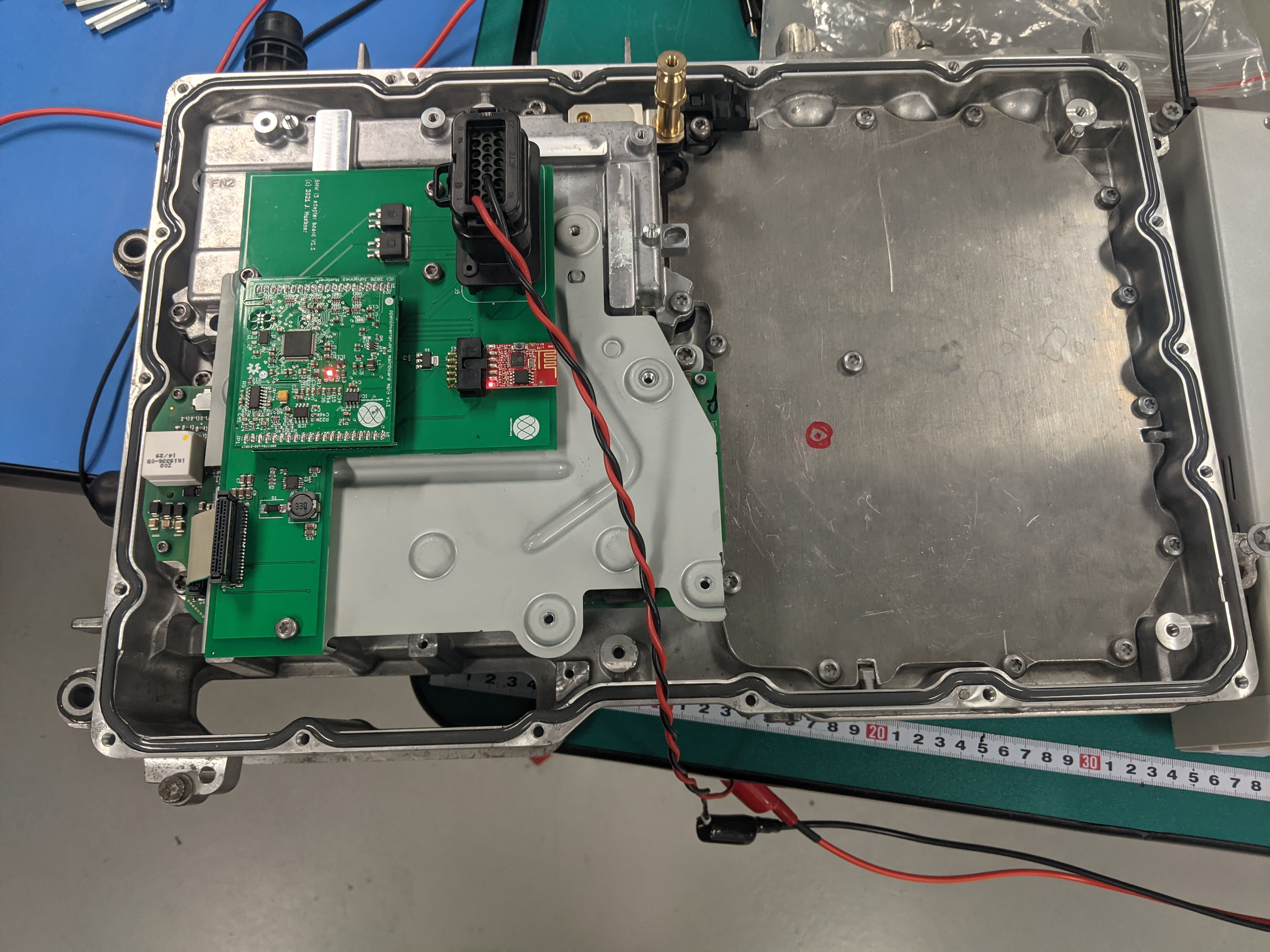

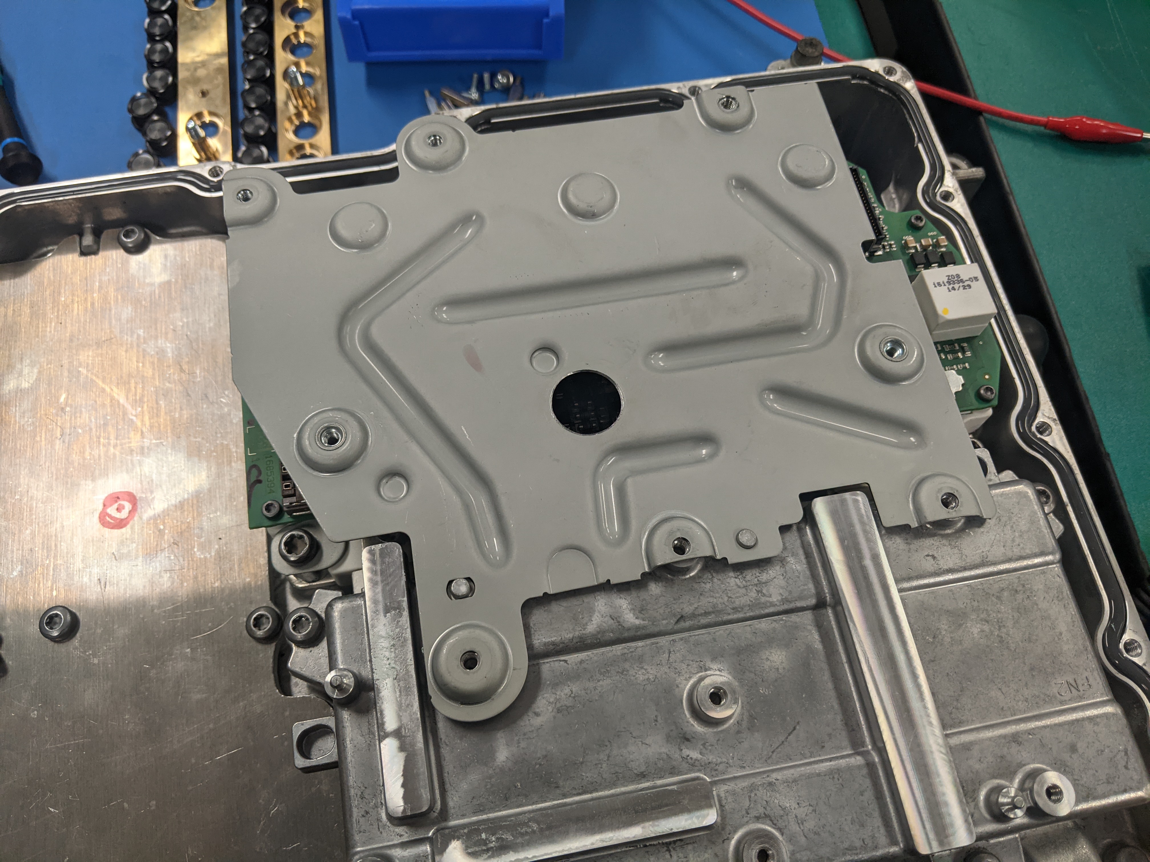

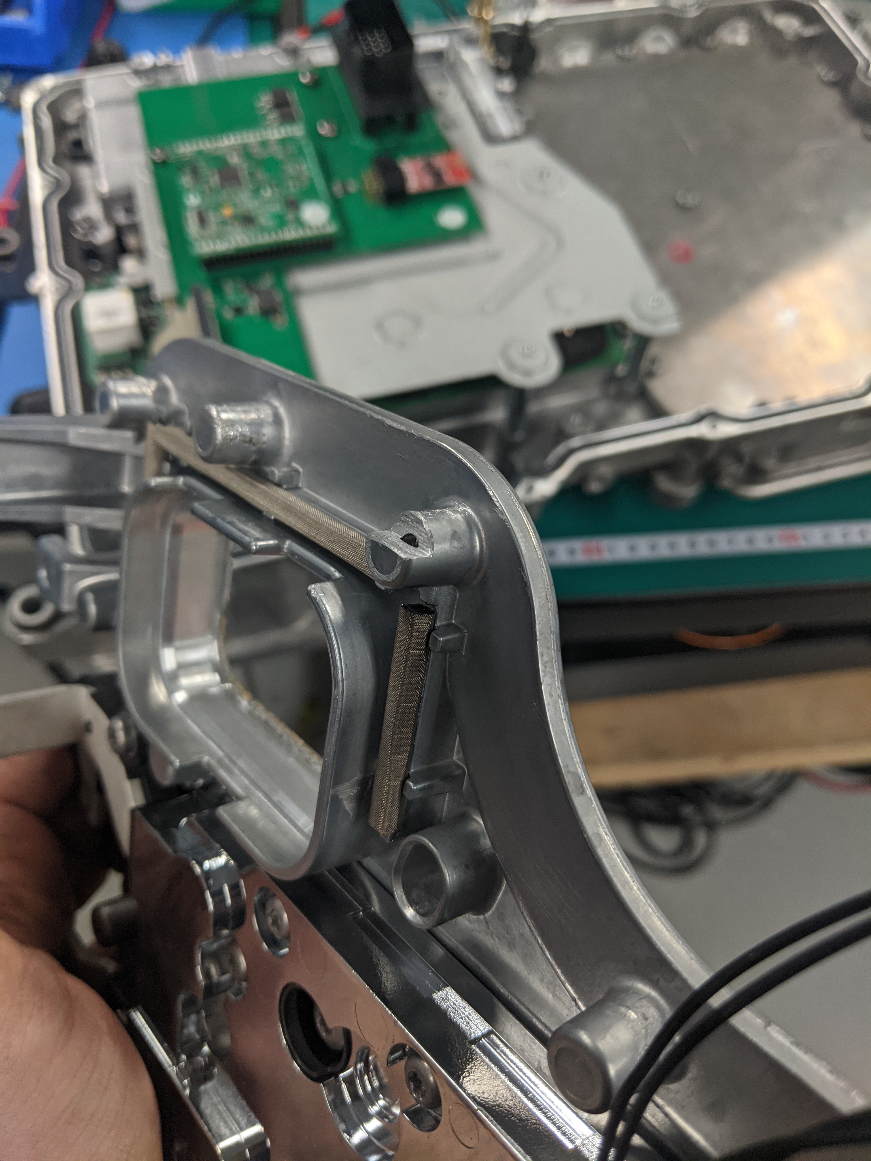

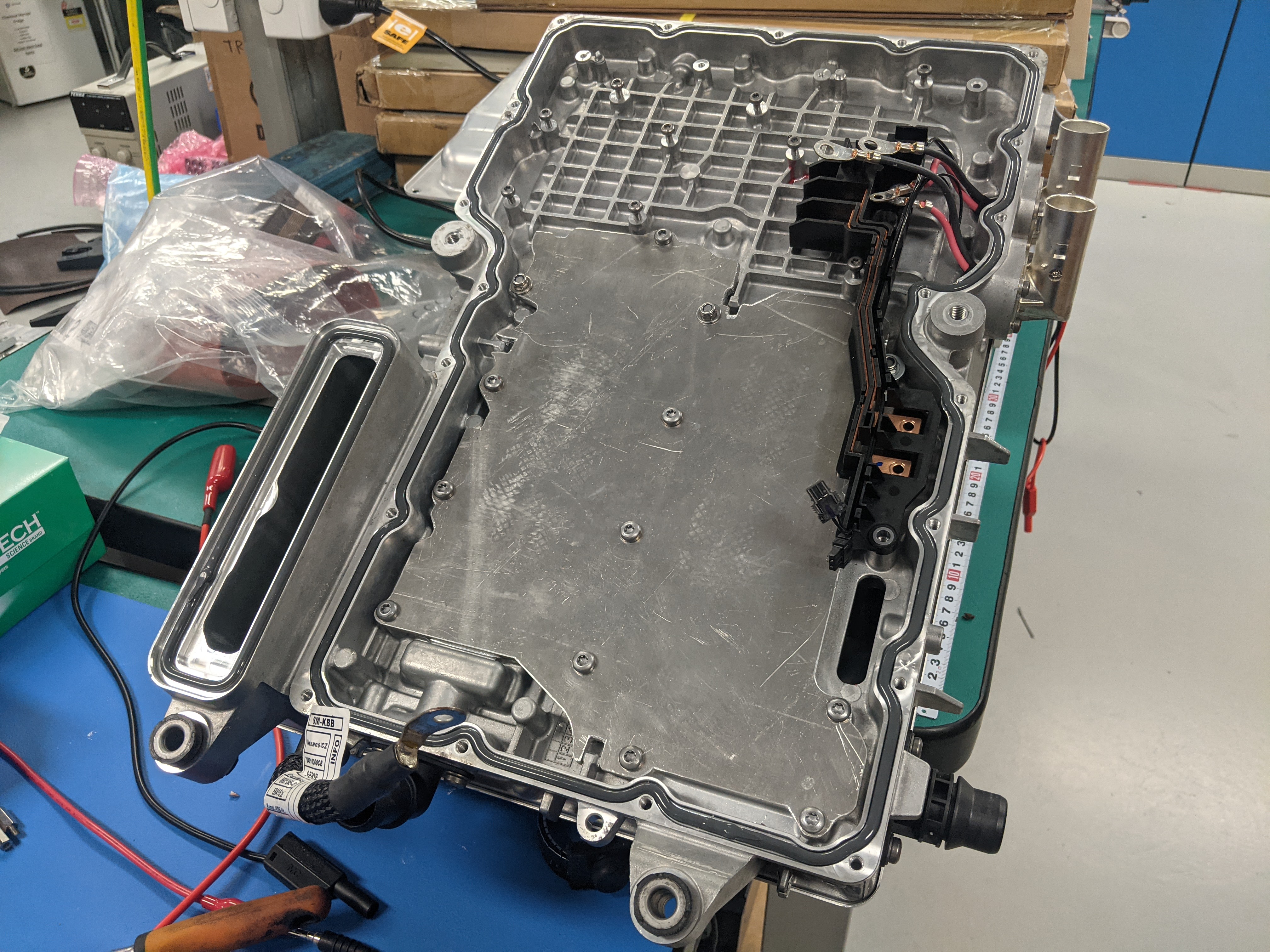

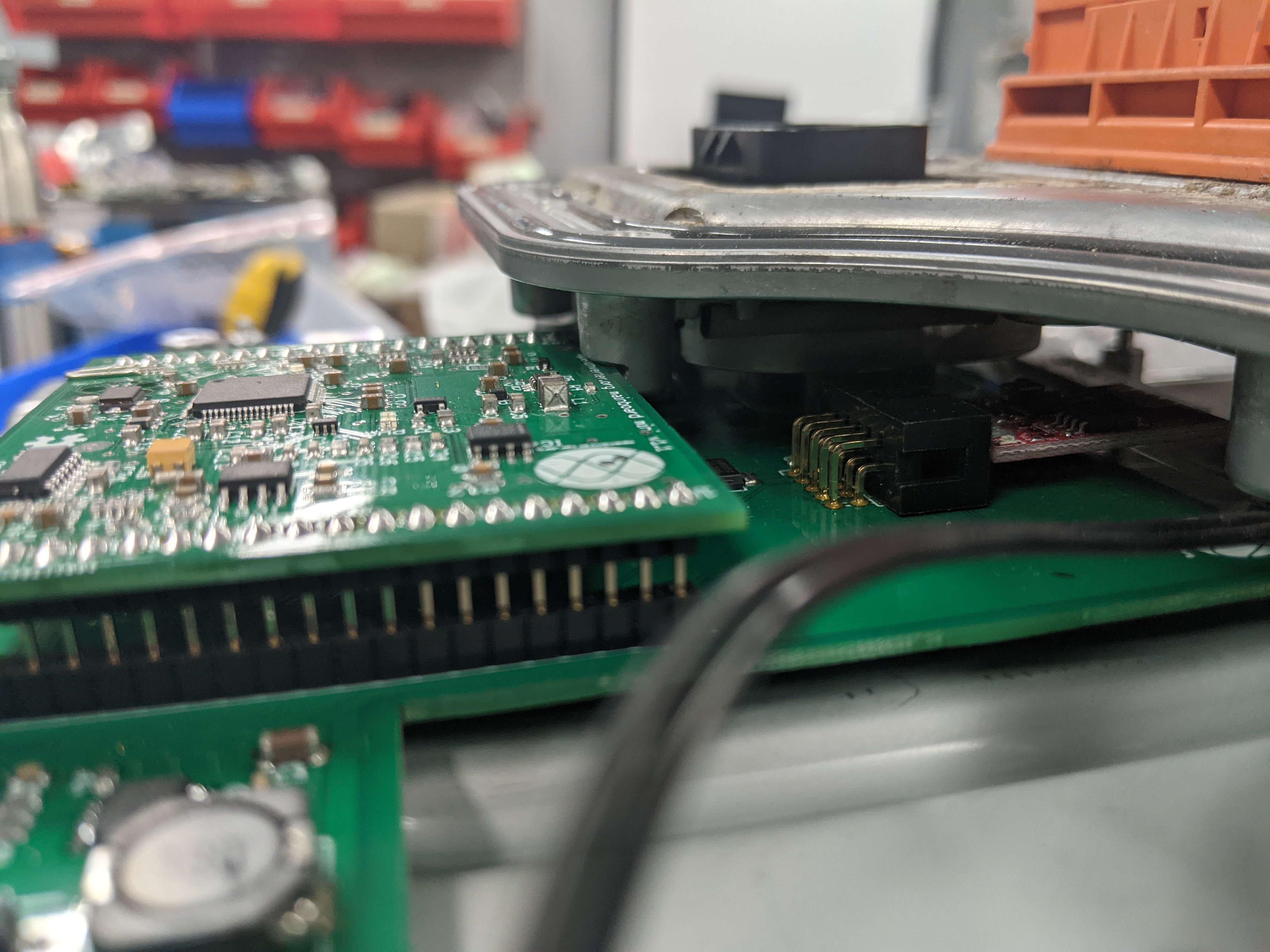

Exciting times! Lots of new people with new inverters!
I've been working on some mechanical integration bits and pieces, hopefully some that will help other members.
1: If you are planning on using the shield mounted under the inverter, you will have to knock out the centre post as it sticks up into the pins on the adapter PCBA. I used a large step drill and slowly worked my way through it. 2: One of the posts for the connector mount casting collides with the inverter, I just milled this down ~7mm and halfway across the post. The screw will need loctite to seal from the topside as you expose the threads in doing this. 3. Lastly, I've made some waterjet cut blanking plates to close off cooling for the charger and DCDC inside the housing. This is just to remove them whilst they aren't doing anything useful and remove some weight from the assembly. Unfortunately it's not straightforward to do this, as some posts have to be machined down for these flat plates to fit, and this exposes one of the threads from the liquid side. I've hydraulically sealed this one, so it shouldn't be a problem (fingers crossed). If people want DXF files for these I can definitely send some links. They are definitely not perfect, and will need some modification to fit well. I did as best I could for hole placement for a first-pass. Fine for now though!
All in all, excited to get a spinning motor! I've worked out the resolver, but not sure which of the 4 permutations I have. I was using an inverter before that could compensate for switching the sin and cos polarity, so I may need to tweak the wiring for it to work with the openinverter.
Thanks for the work so far Johannes!
- Been thanked: 1913 times
Thanks for posting
I though I had cleared that screw post by now, oh well. Can't move the adapter PCB down any further because I believe it will then collide with the top cover.
I just remembered you had mentioned that you fixed the screw post collision on the new adapter board rev, that would be it! I think it might be close still, but it probably will not need as much cut out of it as mine did.
Pinout with the colors for the resolver, suggestions and not verified.
1. 12V
2. BRAKE_IN
3. PRECHARGE_OUT
4. CANL
5. CANH
6. DCSW_OUT
7. FORWARD_IN
8. REVERSE_IN
9. 5V (OUT)
10. RESOLVER_S2/ENCODER_A___: Blue (Sin2, Sin L)
11. GND
12. RESOLVER_S1______________: Brown (Sin1, Sin H)
13. THROTTLE1
14. THROTTLE2
15. RESOLVER_R1______________: Yellow (REF1, Ex H)
16. RESOLVER_S3/ENCODER_B___: Red (Cos1, Cos H)
17. MTEMP+
18. MTEMP-
19. RESOLVER_S4______________: White (Cos2, Cos L)
20. EMCYSTOP_IN
21. GND
22. RESOLVER_R2______________: Green (Ref2, Ex L)
23. START_IN
![Image]()
With 12 pin adapter card and solder directly to the card.
Interesting! So the resolver is not connected via the main connector? I mean in BMW OEM design. What are the other signals?
Congratulations on your compacting work
The motor seems to have 2 temp sensors which are blue-gray and red-gray which are 7-8 and 9-10 on the adapter card and I have connected one. 11-12 unknown.
