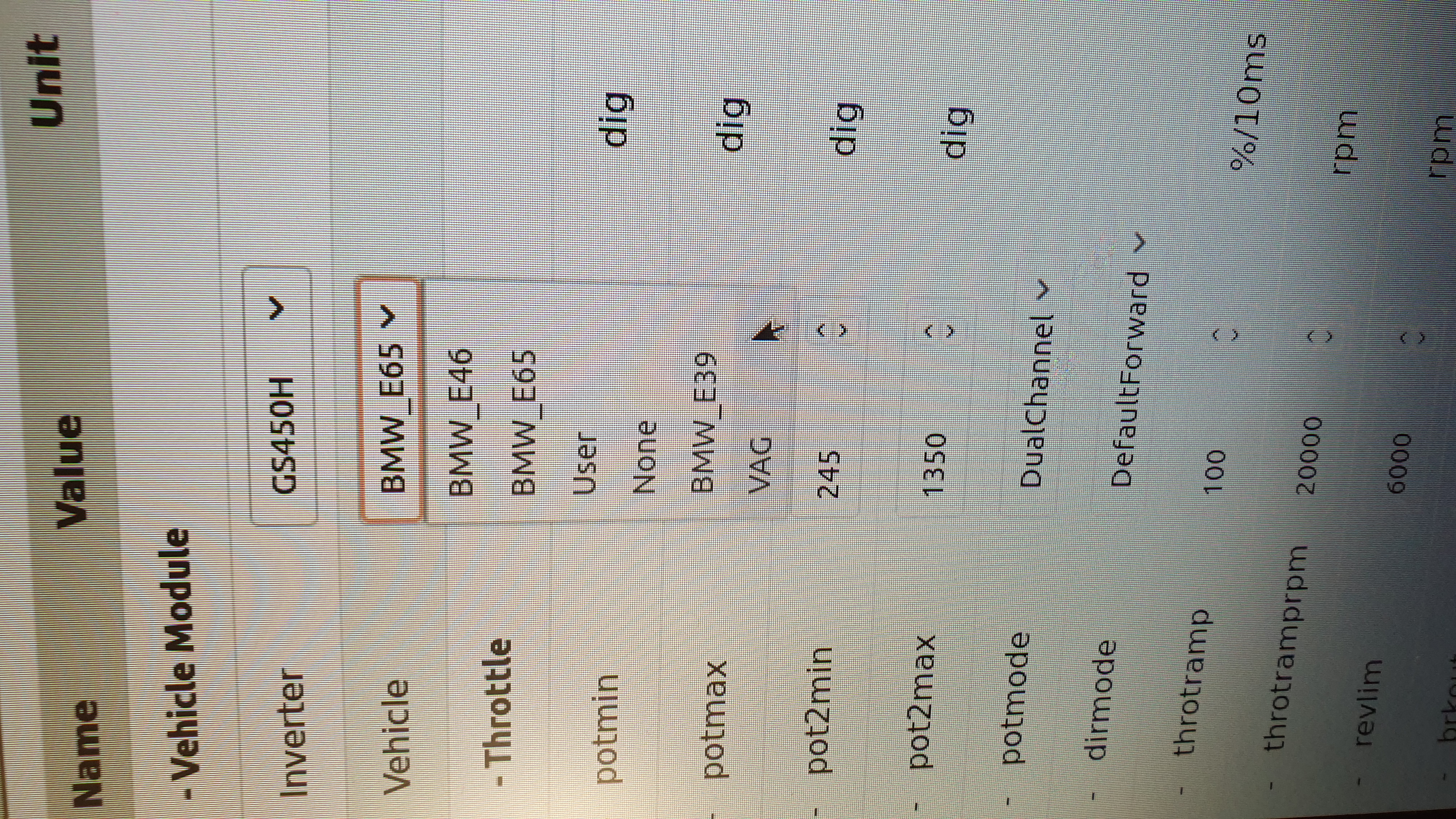

Thanks Johannes. I have added a VAG module as a way of saying thanks:)
OK, i can select GS450H now and i'm seeing HTM / REQ & CLK being generated. All 3 signals look good.

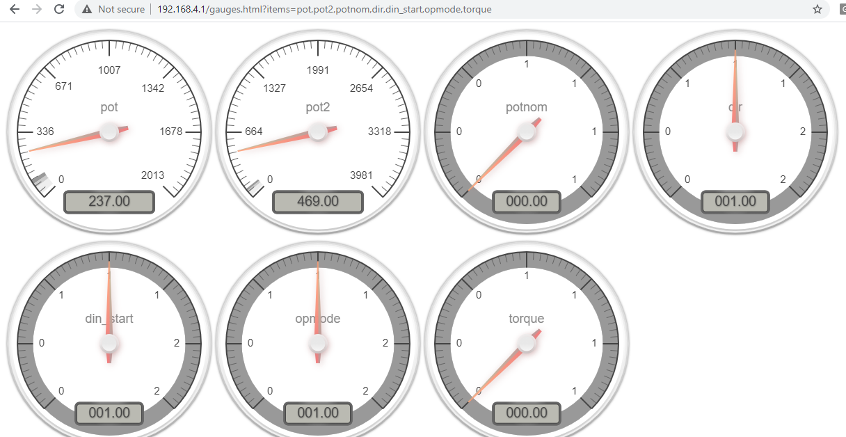

I don't seem to be getting anything on "potnom" when i push the accelerator, have i the name of that parameter correct?

Ok should say "run" under opmode but 1=run. Should show potnom and torque now.
See attached the guages and param export.Jack Bauer wrote: ↑Sun Jan 03, 2021 5:06 pm Ok should say "run" under opmode but 1=run. Should show potnom and torque now.

Ah yes you need to set udcmin to 0 also. Sorry forgot that one. Also you only need to pulse in1 high start is a momentary signal.
