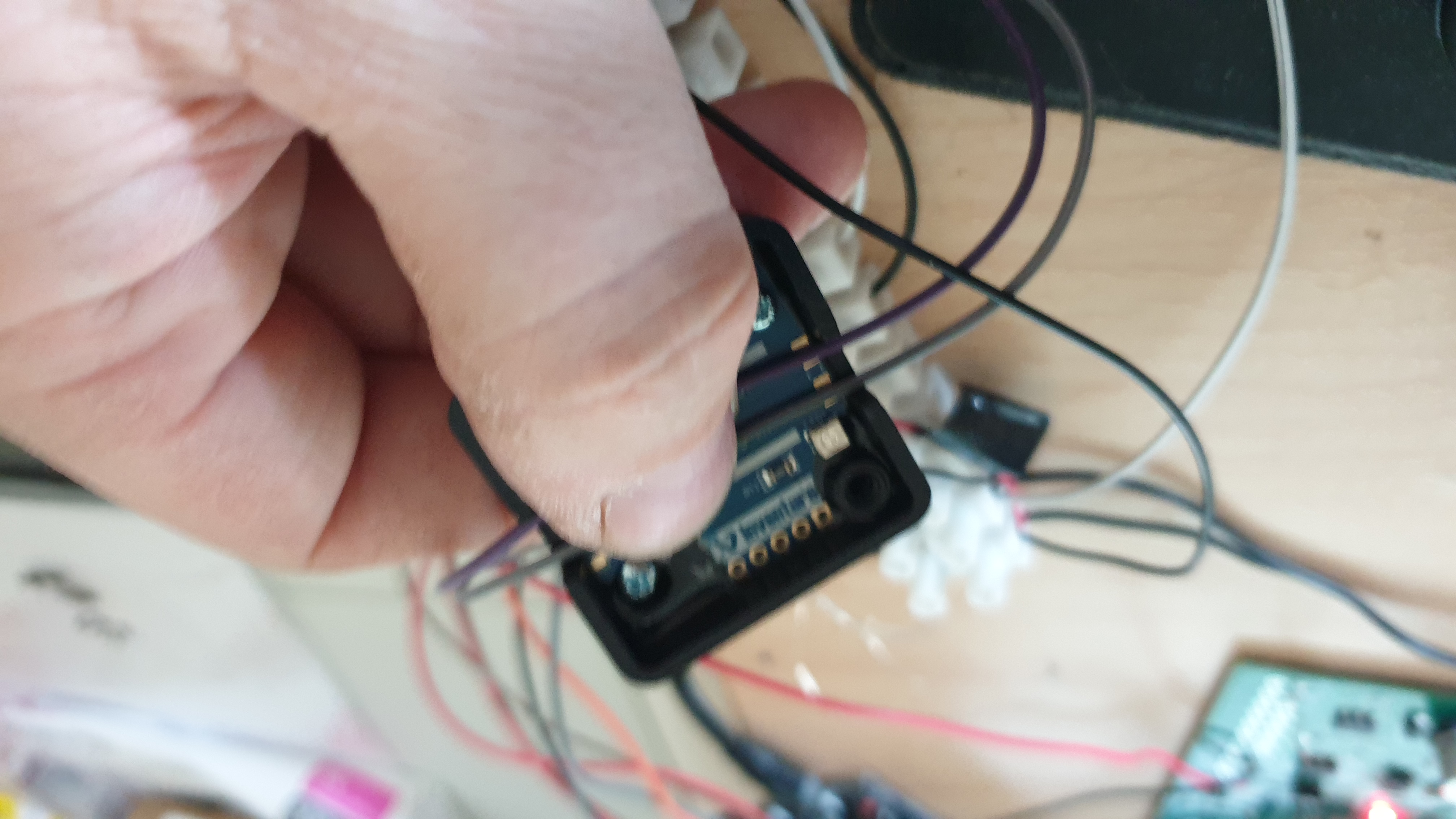

Whilst I'm trying to get the wires untwisted enough to get the can reader on without cutting them does anyone know which is can high?
Red or red and blue?
Ta
Restoring and converting a Classic Mini, I have mad ideas, semi sensible ideas and NO idea if I’ll ever get it done :lol:
paaa
Posts: 211
Been thanked: 13 times
Post by paaa »
I don't know myself but the reader will show red if you connect backwards. I normally just peel back tape a good bit on both side of where I want to place the dongle and then untwist or tighten twist elsewhere and separate the wires and hold them up to the reader without back plate installed.

Pretty sure red is high (from memory). BMW really like to twist their wiring nice and tight but it's all good quality.

muehlpower wrote: Wed Mar 17, 2021 6:48 pm The LIM is attached to the FA CAN, which can be reached on the BDC in the footwell on the right (LHD). A red cable (CAN L) and a red / blue cable (CAN H) A258 * 8B 47 + 48 or A258 * 7B 35 + 36

Ok, so I've tried the wires both ways and have a continuous red light on the dongle 🤔

Just a guess but is the car powered up and traffic on the bus? Red = standby so if there is no traffic ...

I did power the car up and plug the charger in so it was thinking about charging, I'm hoping I've found the right cables.
It's definitely one red twisted with a red and blue.

Just one thing to check is that the twisted cables sit correctly on the backplate before you put unit together. There is a risk that they sit funny and don't come close enough for contact. If you need help send me a PM and ill WhatsApp call you tomorrow.
Posts: 4000
Been thanked: 1114 times
Just tested mine this morning. The can wires do need to be in close contact with the white lines.

I was thinking the back plate would hold the wires in place well enough, I'll try holding them in place like you have and see what happens.

I managed to get to a rapid charger today and managed to get a steady green light on the pick up but it wasn't flashing so I couldn't get a log.
The pick-up doesn't seem to read with the backing plate on so I was moving the wires with my fingers and on occasion getting the steady green light.
It looks like I'll have to try the pin idea to get a more reliable reading.
