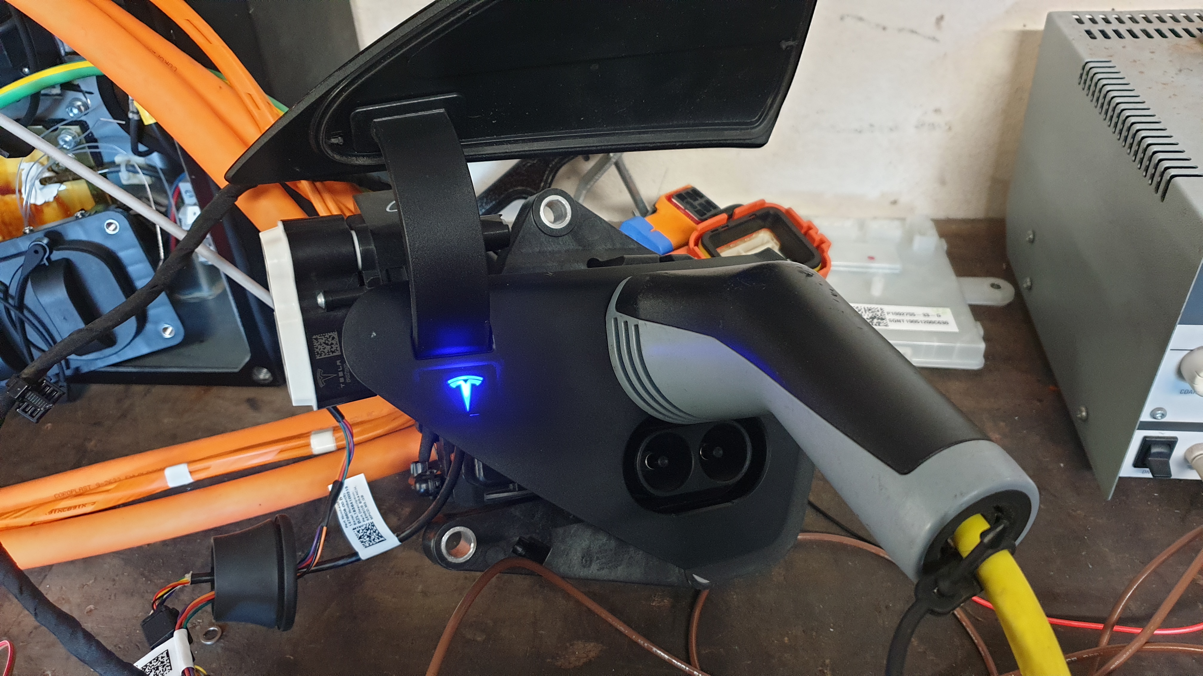

The pulsing blue T of happiness:)

* Init code fixed
* Fixed standby state to be solid blue LED.
* Removal shouldn't trigger red LED now.
* Haven't removed unnecessary IDs yet, I wanted that to be a different commit to keep the changes clean.
Redacted repository updated. Going to go for a walk now.

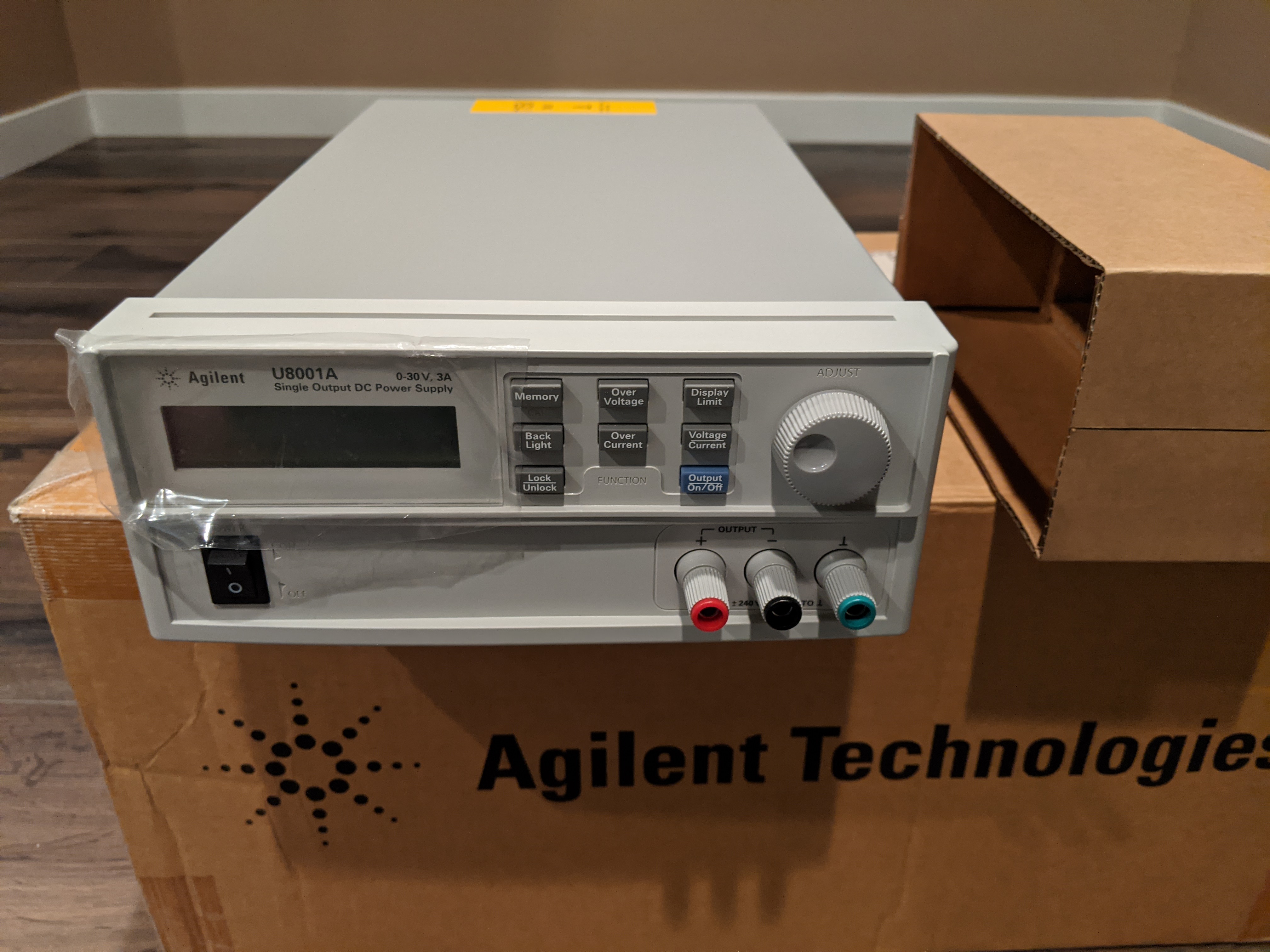

Super LOL moment.
So my unit when unhappy has a 5 second on, 3 second off pattern. I thought that was the CP ECU resetting itself in a watchdog type thing. Nope! It's my cheap Best Buy power supply giving out.
I now have a real power supply: and it no longer does weird stuff. It also auto-closes itself after a 2 minute timeout, just like the car.
Tried getting the other older CP ECU to work, but no luck. That's all for tonight.

I moved my test setup upstairs, and can see where the power brick is out of the corner of my eye. When I saw the weird stuff happening, and the light going off, I was like 'Well crap, Damien was right.'
Normally that Agilent / Keysight now is stupid expensive...over $450+, but the local electronics store had it on clearance for $250.

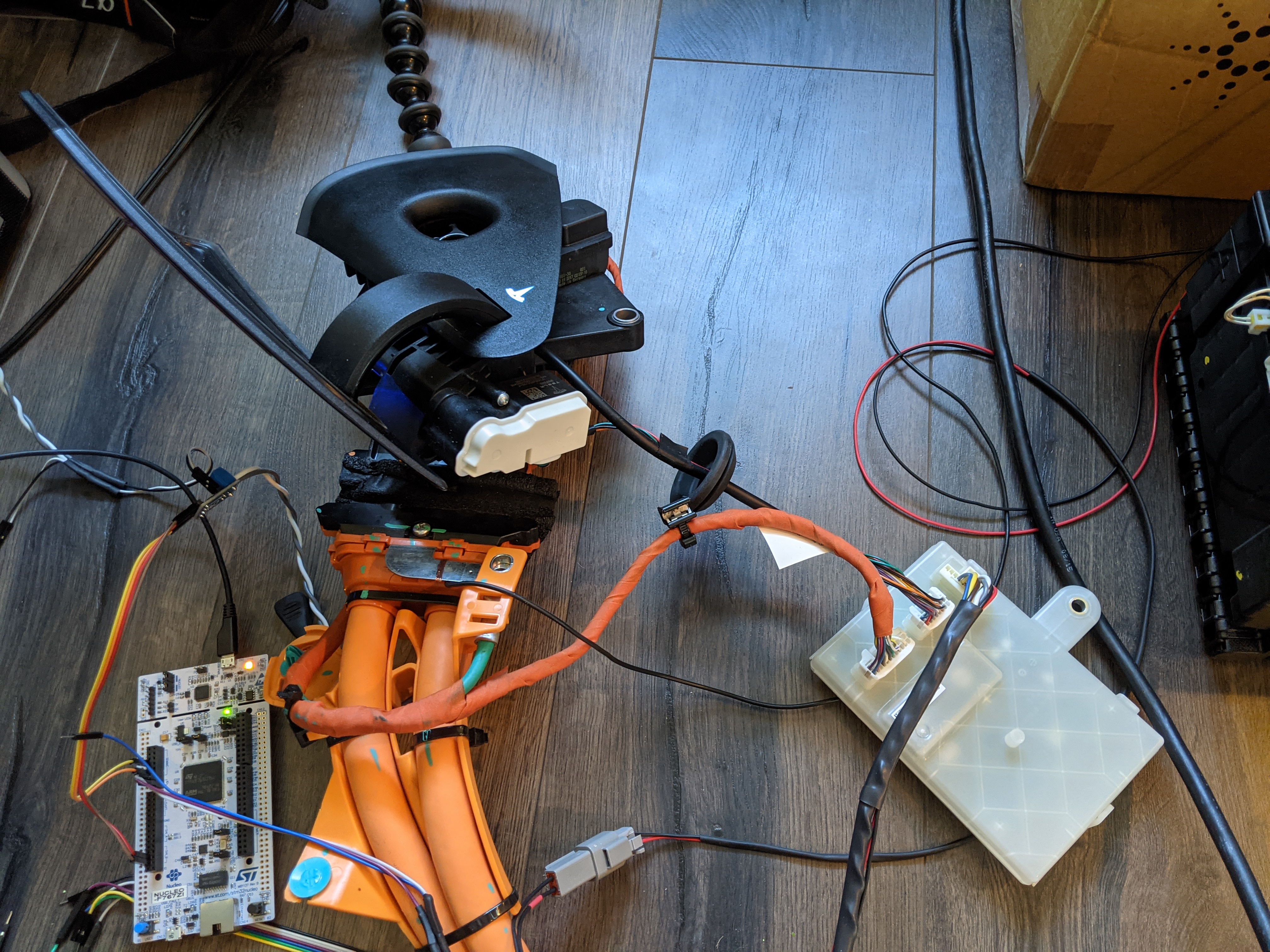

I set up the connector yesterday for the bench ECU. I just prepared the car one tonight, which is fun because I have made it so I can use a logic analyzer / multimeter / CAN sniffer on things without having to touch it. This way I can completely put the carpeting back again (for the second time! LOL), but still get measurements when I need to. Car is asking to do another software update, I want to get my sniffer in place while that happens (on both buses this time). Hopefully no more updates to the Charge Port ECU, but who knows.
Also, looks like it gets power hungry only when it's annoyed. Still needs over 1.5 amps for a moment when closing the door after that 2 minute timeout, but not that bad. Was more than the 1.1 amps the old brick could handle.

Got the setup in the car. I'll get pictures tomorrow. Much easier to capture both CAN buses at once.
Didn't test IDs from Vehicle Spy yet. I did test two IDs from SavvyCAN, no difference.
Wasn't actually a software update - just a navigation data update. Nothing to report.
Didn't review the log. I think the deal is I just need to implement a delay before declaring charge restart desired.
I did borrow the J1772 charger, and that is (now) working as expected. Turns out 1 != 2. Code updated on github.

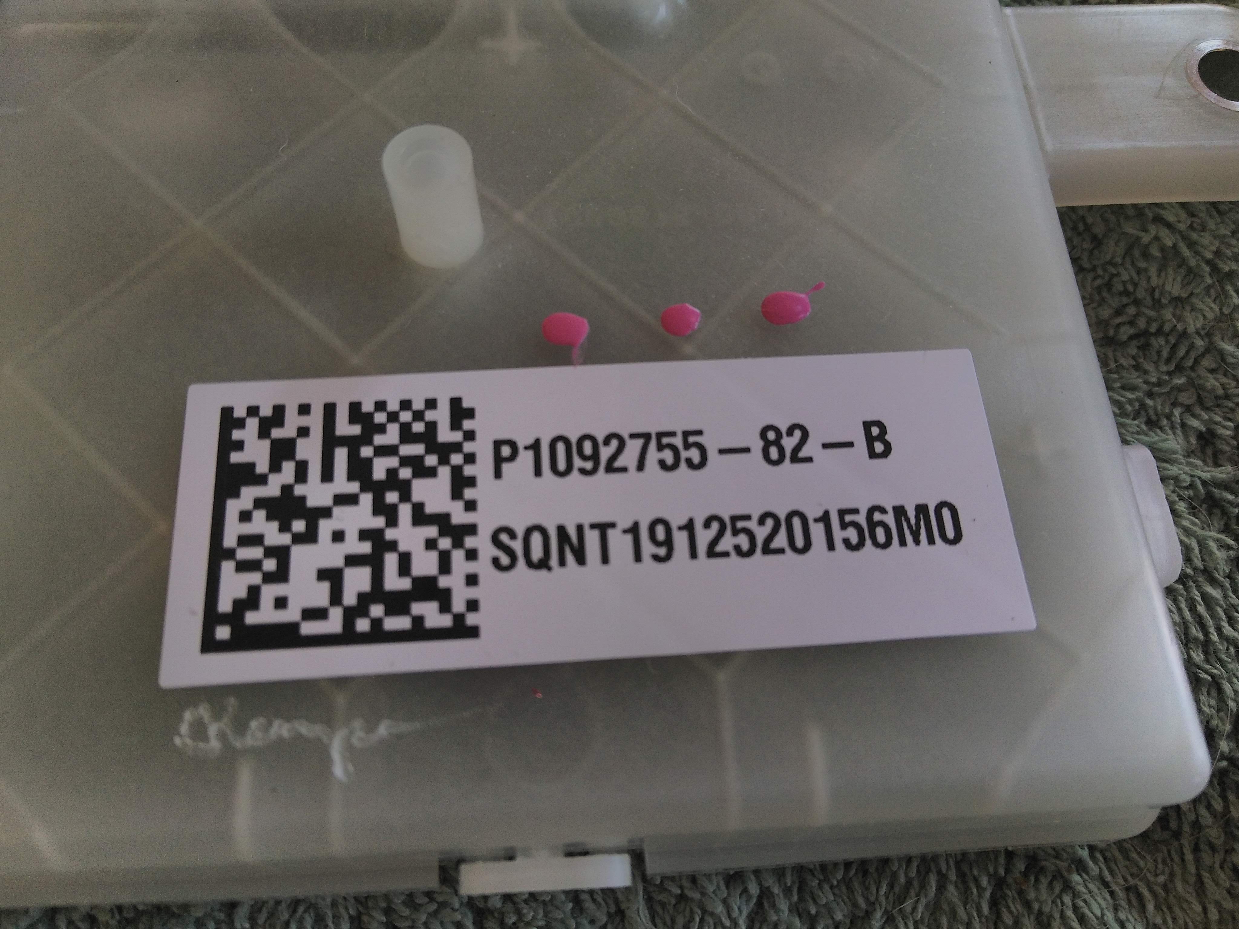

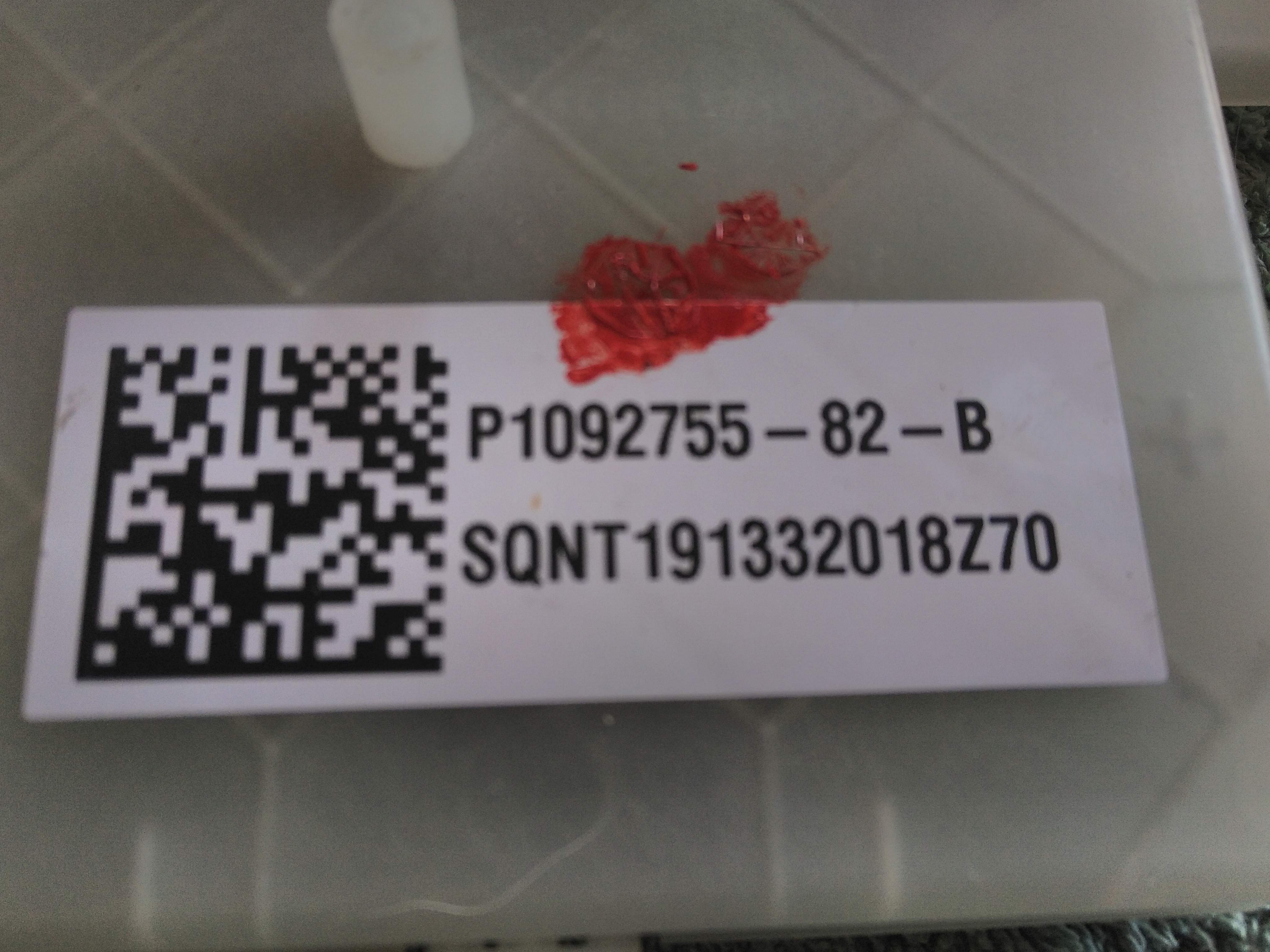

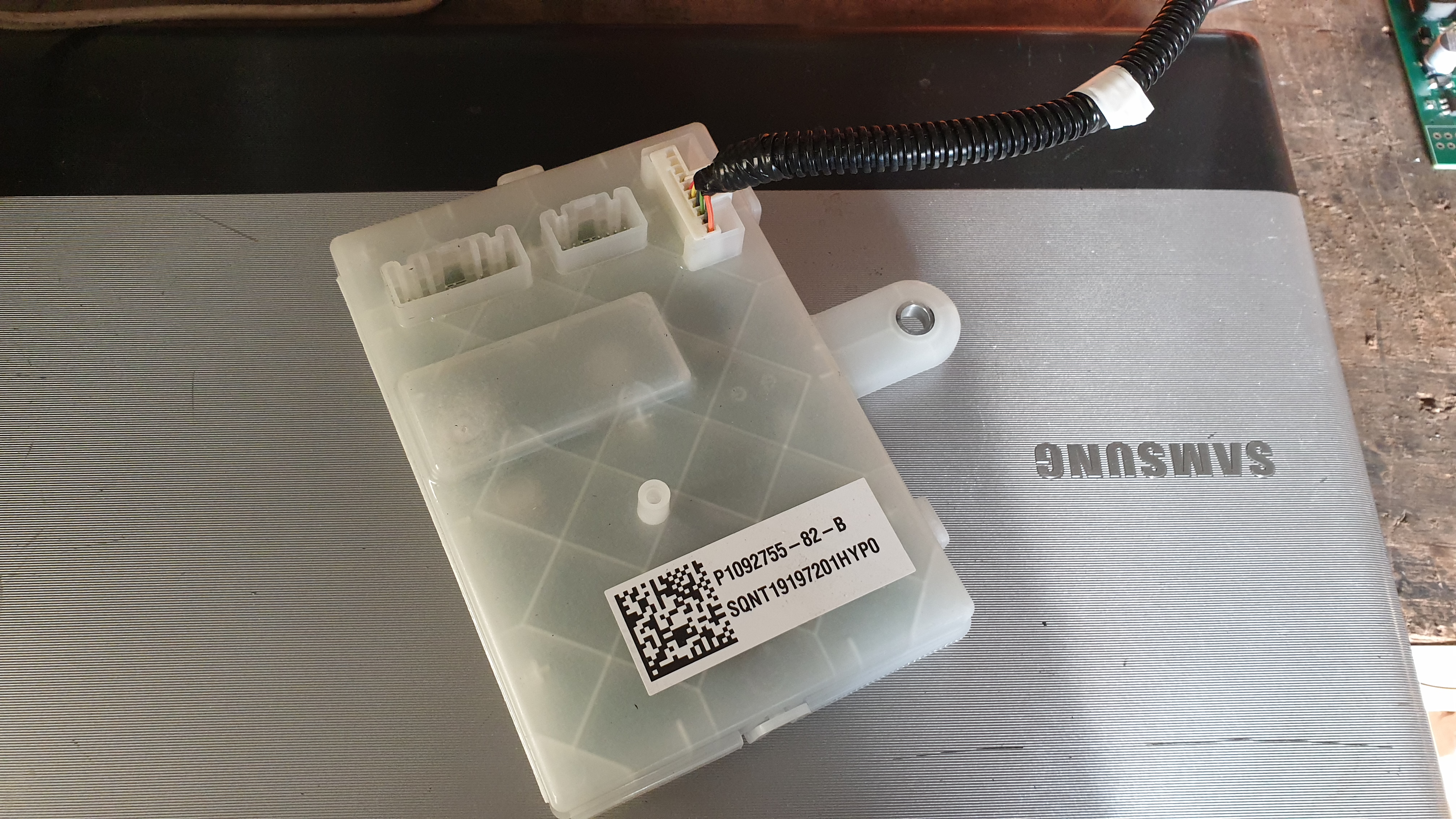

We have two more EU ECU's that we can use for test. We also have one of the EVTV CAN capture tools in a UK Model 3 if anyone needs log files.
One observation, all three EU ECU's we've purchased have the same part number despite coming from different European countries with a two year age difference. In contrast, the US ECU's we've purchased have different part numbers.

Finally got rid of the red T. I like blue. Blue is better then red. Also got my paws on another EU ccs ecu and this one comes with a bit of musk loom to make life much easier:)
- New Electric Ireland
- Posts: 172
- Joined: Sun May 31, 2020 12:22 pm
Re: Tesla Model 3 Charge Port Controller Standalone Development
Another P1092755-82-BJack Bauer wrote: ↑Sun Nov 22, 2020 1:22 pmAlso got my paws on another EU ccs ecu and this one comes with a bit of musk loom to make life much easier:)

Interesting. Of note, my initially working model was a -98 (from a 2019), my car is a -99 (Sep 2018 delivery), and the initially non-working model was a -99.New Electric Ireland wrote: ↑Sun Nov 22, 2020 12:42 pm This might help explain some of the different US ECU part numbers and possibly some parts to avoid - "On some Model 3 vehicles, an electrostatic discharge might damage the charge port ECU radio transceiver. As a result, an alert displays on the touchscreen, and the charge port door is unable to be opened using the button on a charger handle. The charge port door opens using other methods."
https://static.nhtsa.gov/odi/tsbs/2018/ ... 3-9999.pdf
I'm assuming some have -98 in the number, and some have -99 in the number. Those are the only two I know of for US ECUs. One of the "US" ECUs that Damien has does have a different number, and does not report itself as a US ECU. It reports itself as a "GB" ECU.New Electric Ireland wrote: ↑Sun Nov 22, 2020 12:16 pm We have two more EU ECU's that we can use for test. We also have one of the EVTV CAN capture tools in a UK Model 3 if anyone needs log files.
AFAIK there's only one number for EU, being the -82.
