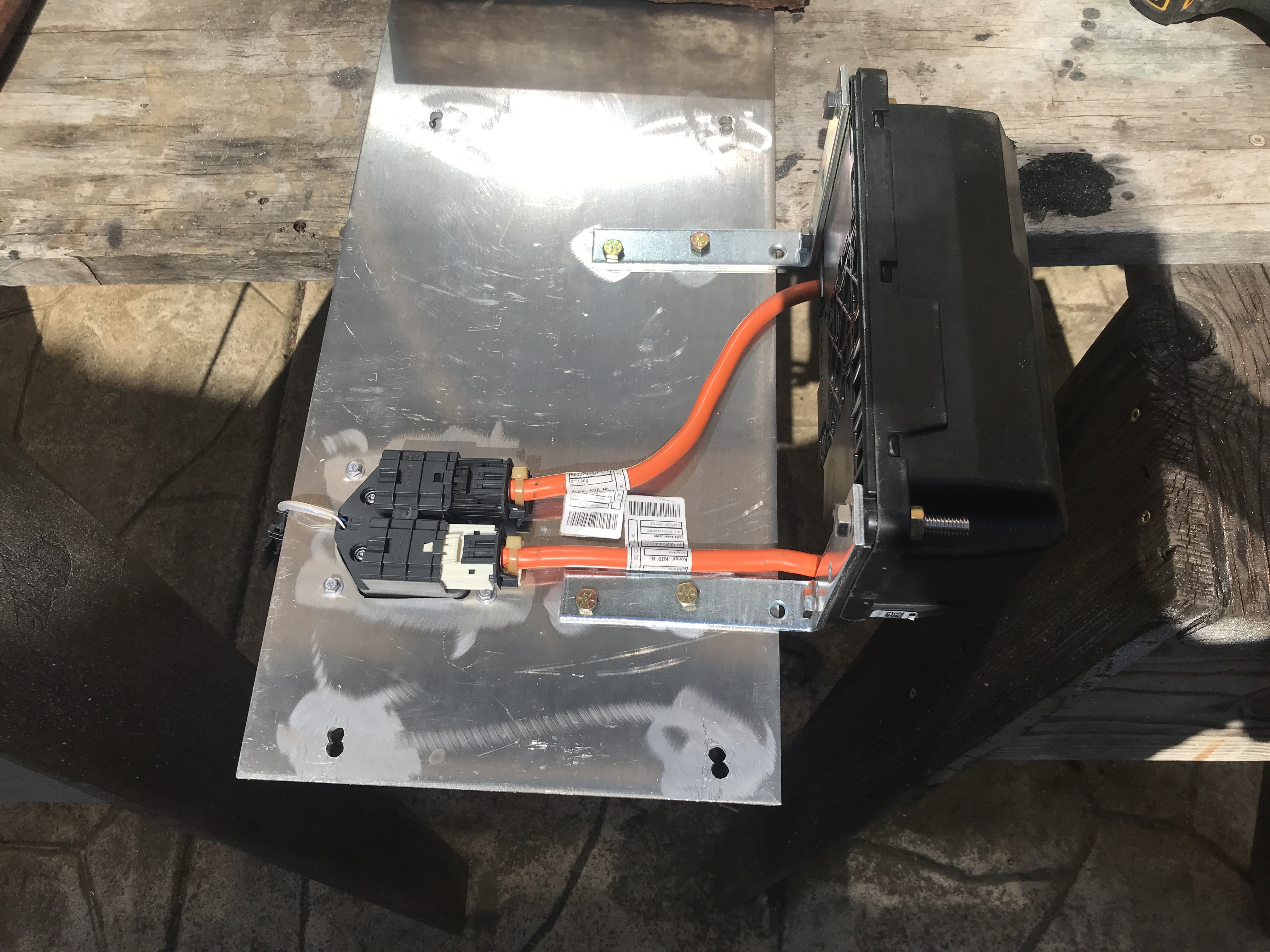

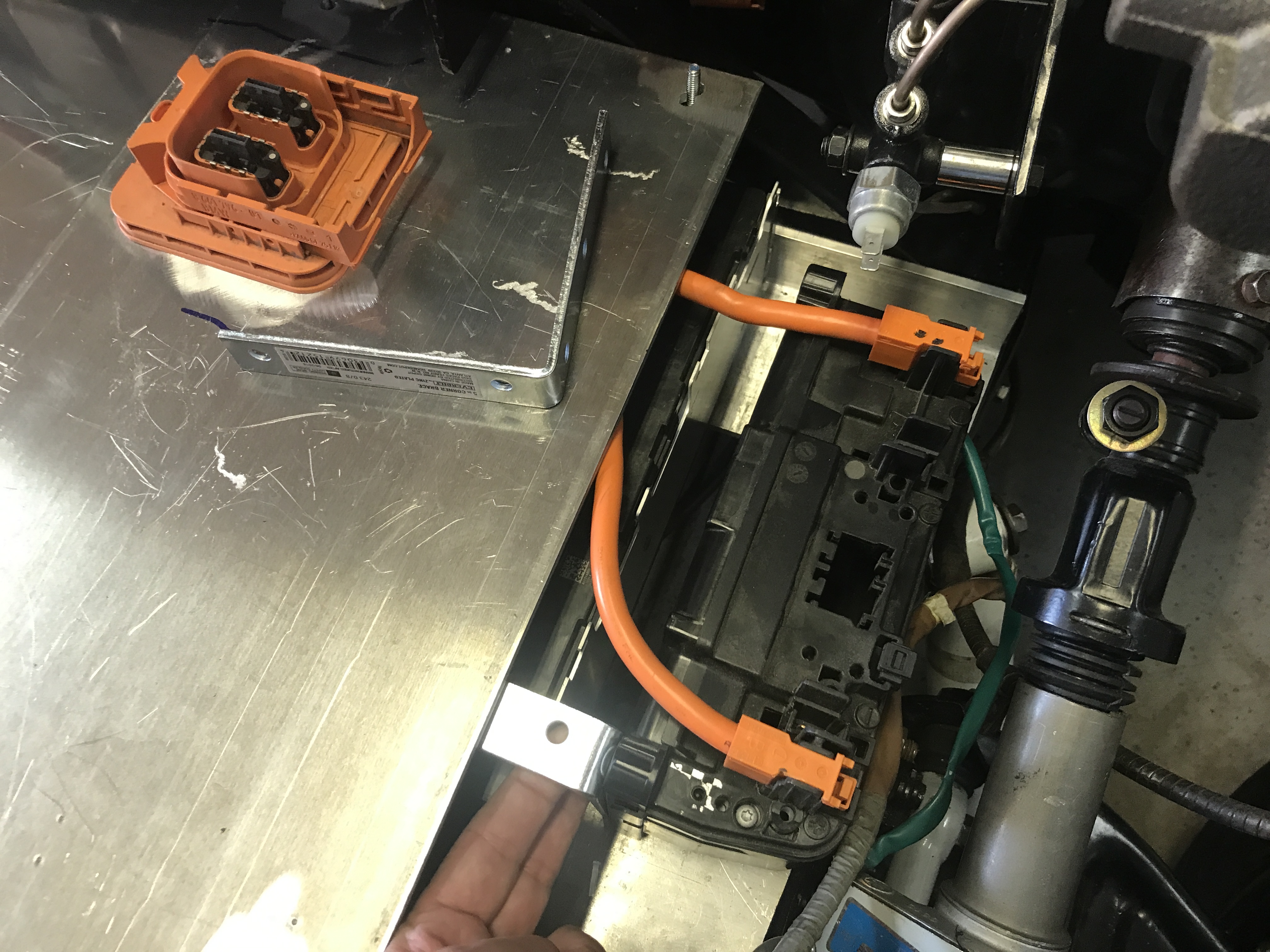

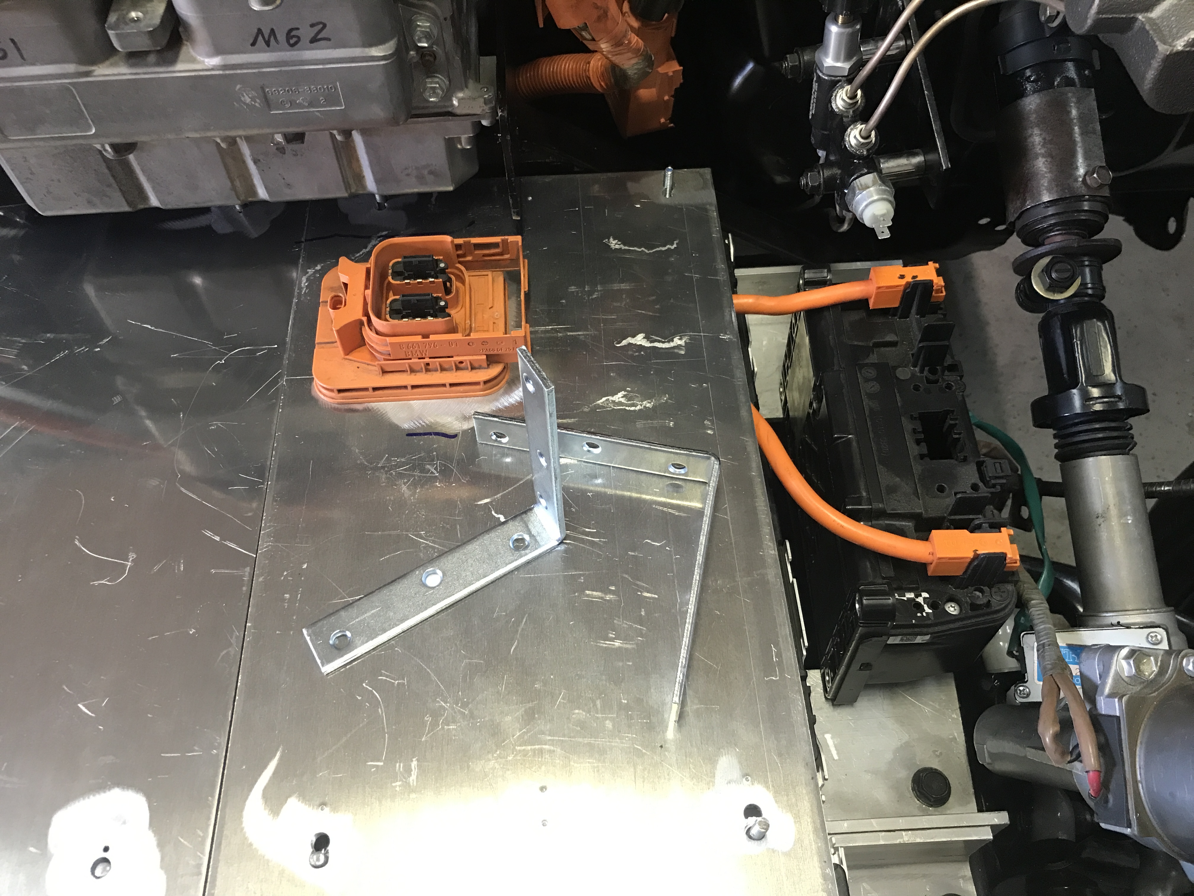

Let's see where we can shove these?
Gregski
Posts: 3157
Has thanked: 628 times
Been thanked: 1606 times

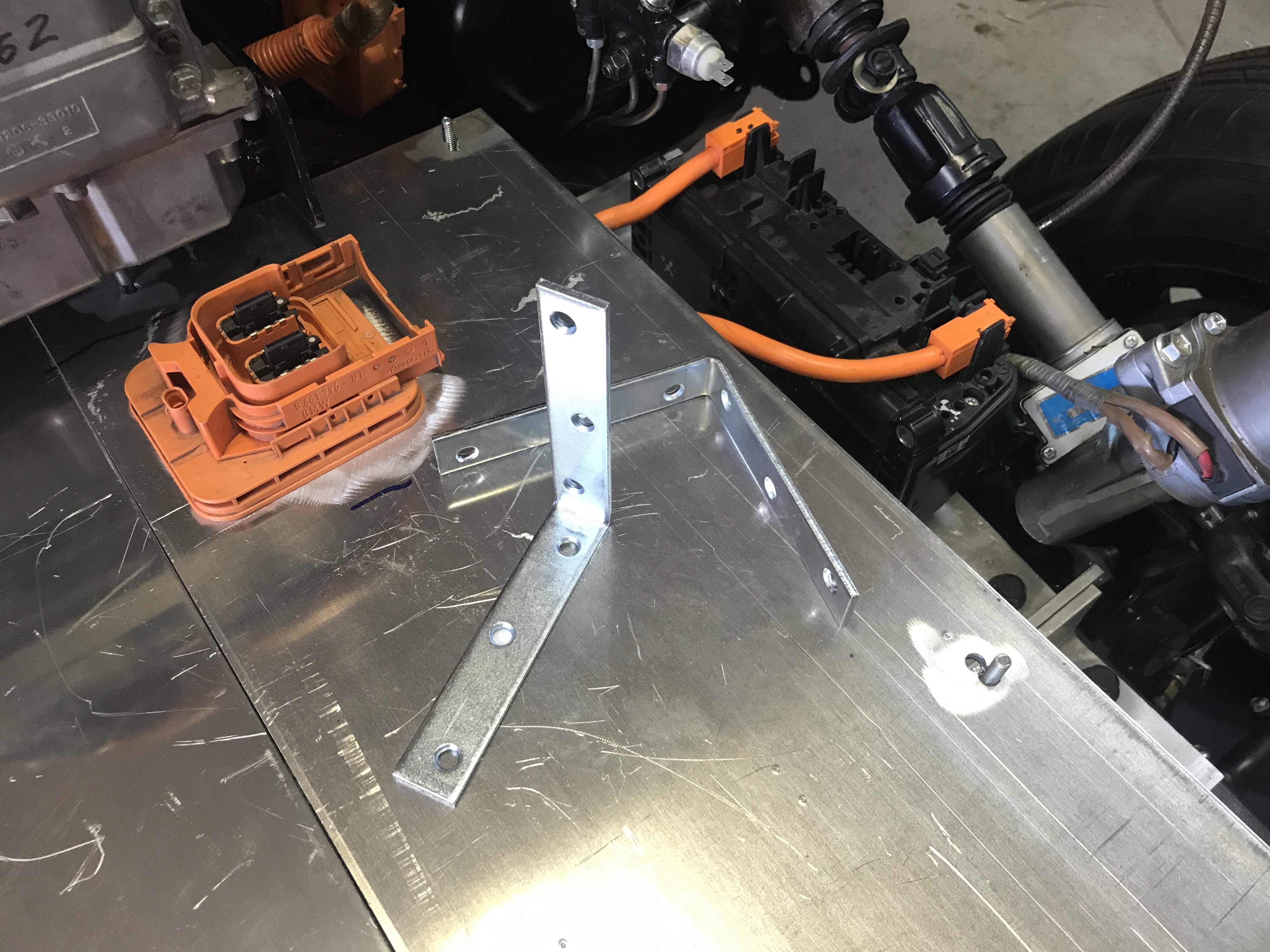

Post by Gregski »

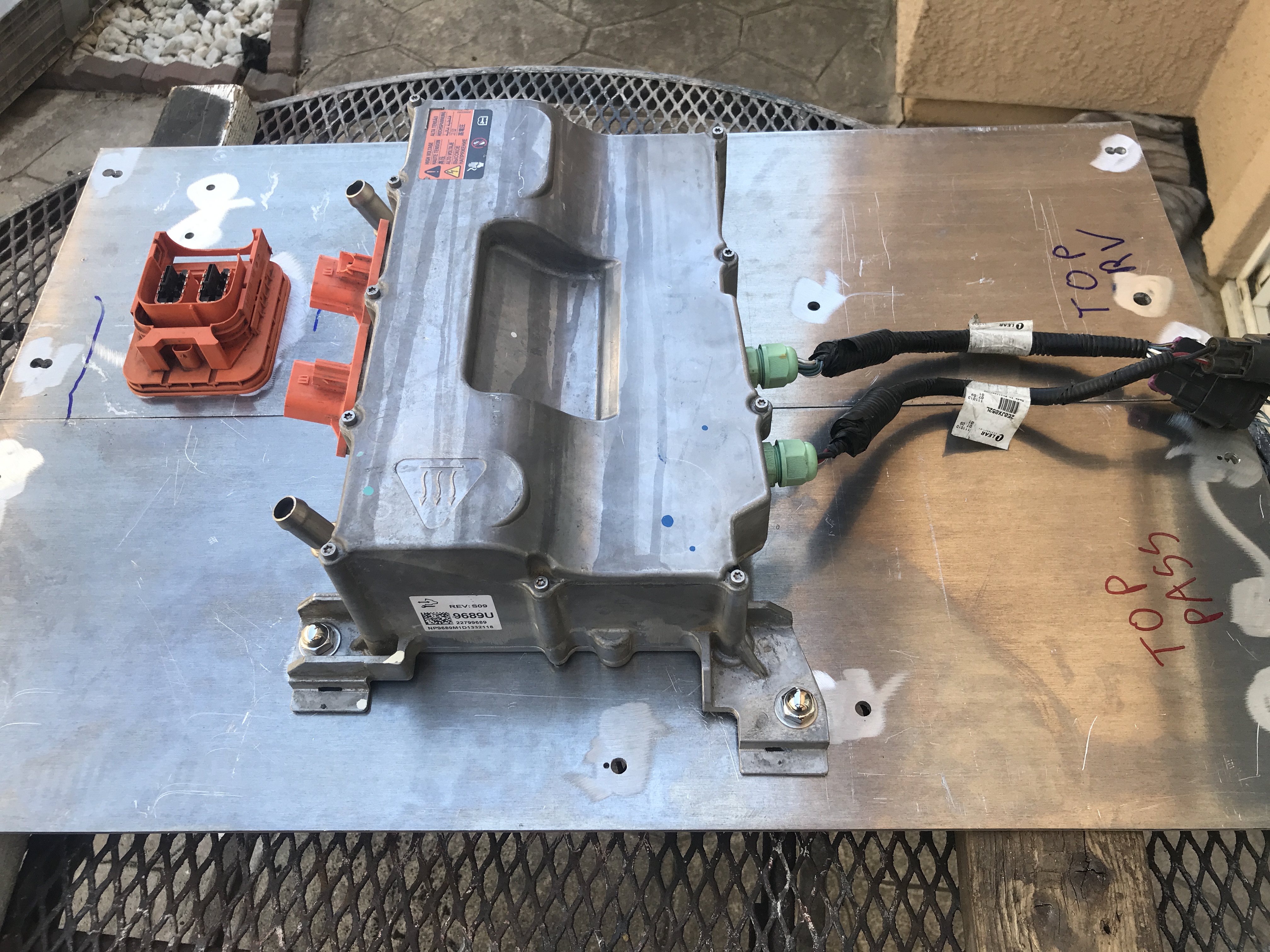

six holes each and Home Depot still got em wrong, so I had to moke some modifications, I can't stand aftermarket EV conversion parts
Gregski
Posts: 3157
Post by Gregski »

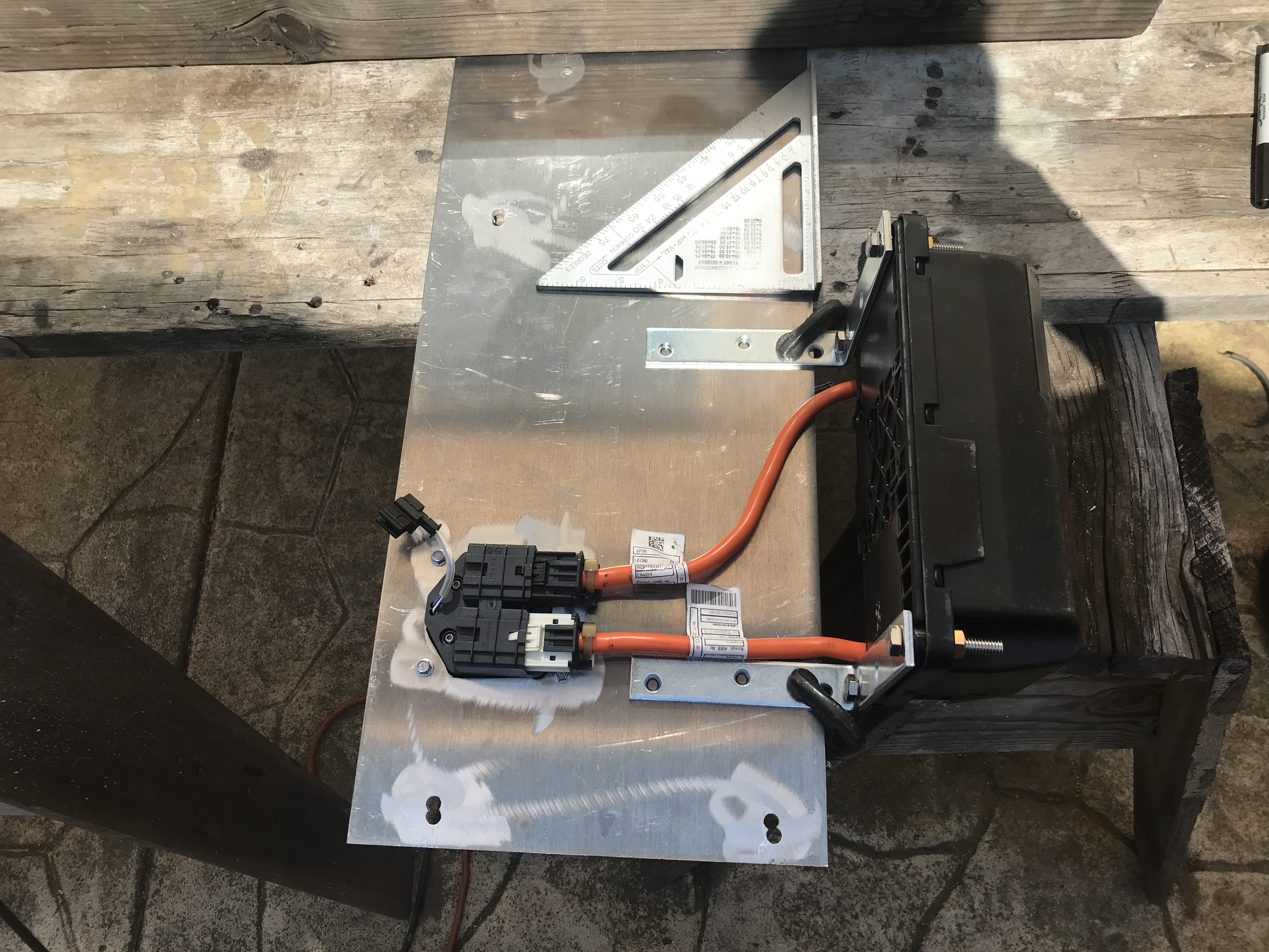

a little trial fit
Gregski
Posts: 3157
Post by Gregski »
the angle triangle is just a prop
Gregski
Posts: 3157

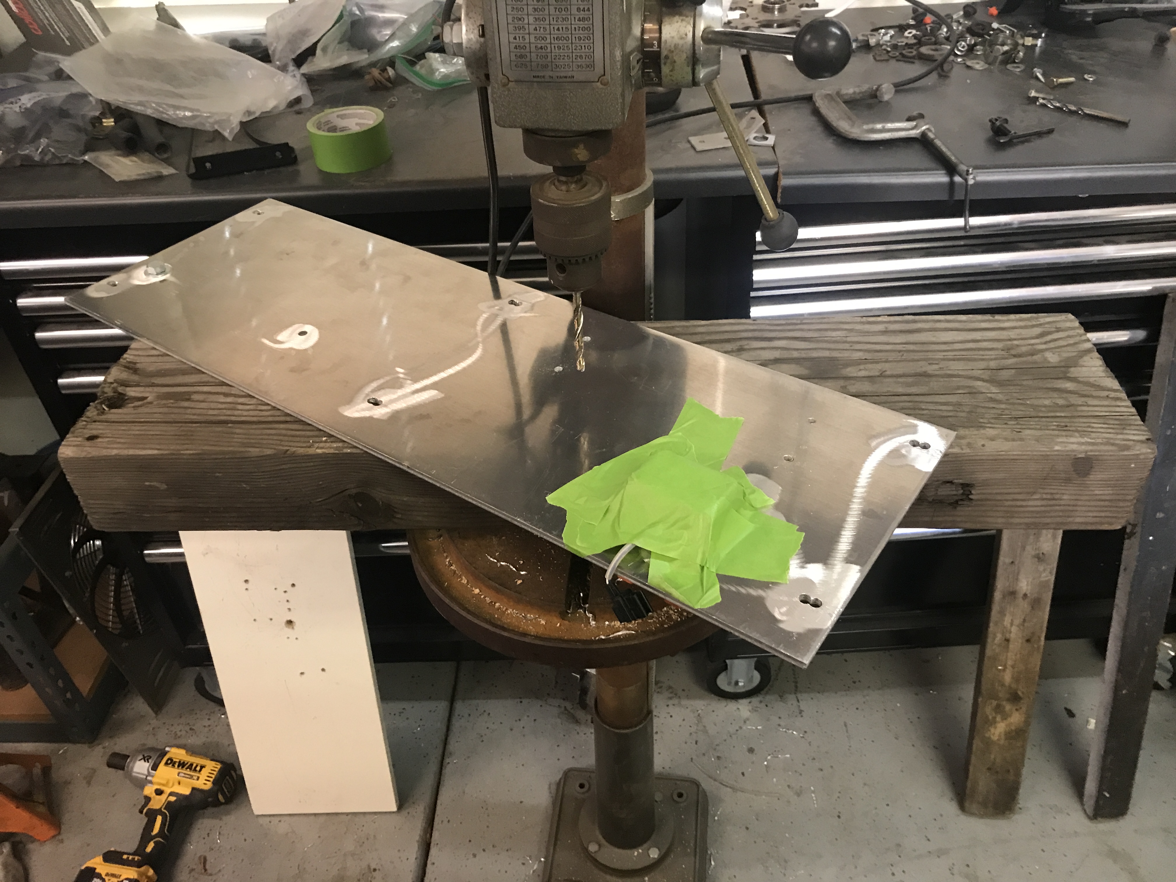

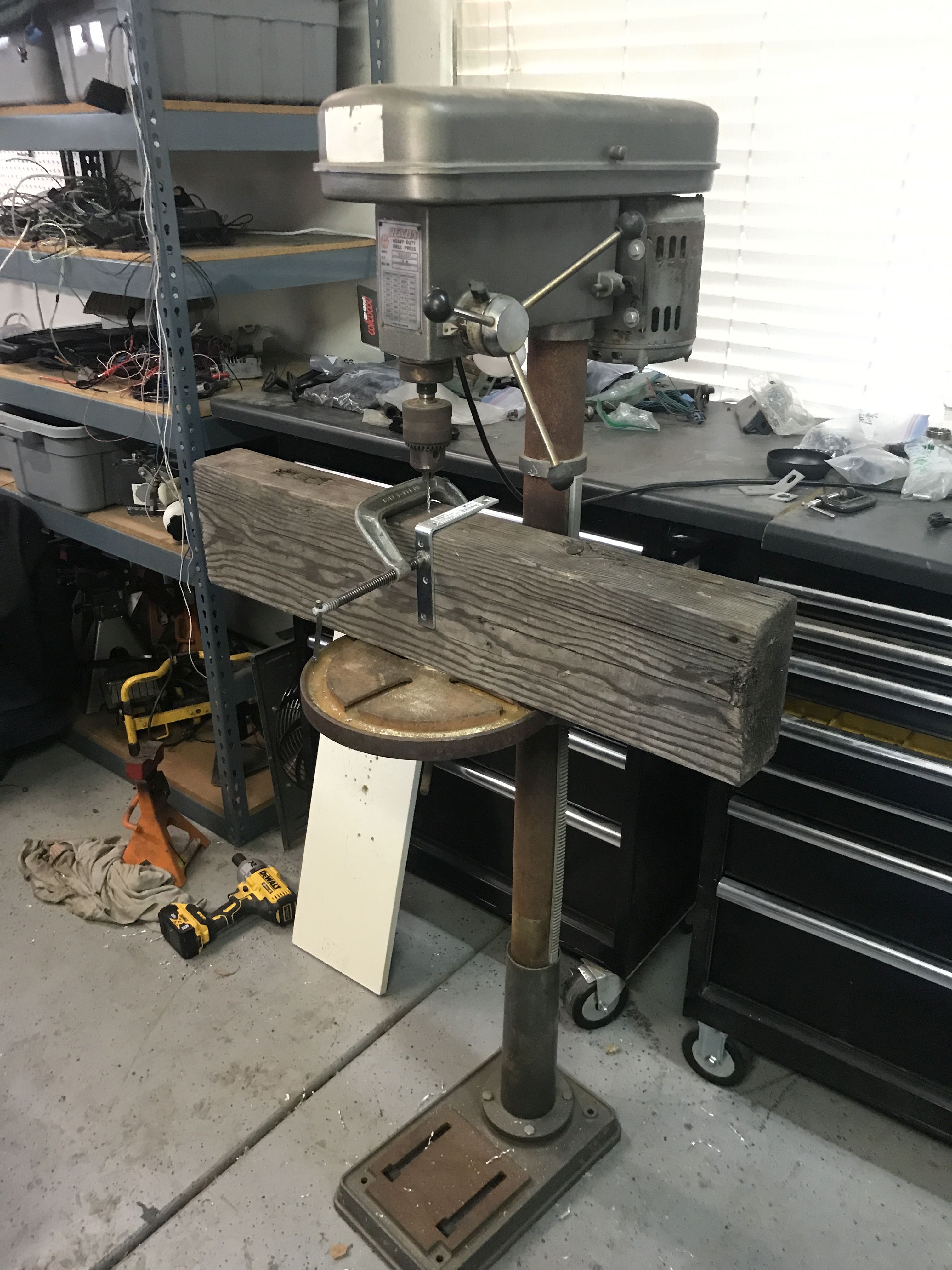

Post by Gregski »
time to poke some holes
Gregski
Posts: 3157
Post by Gregski »
that's not too shabby

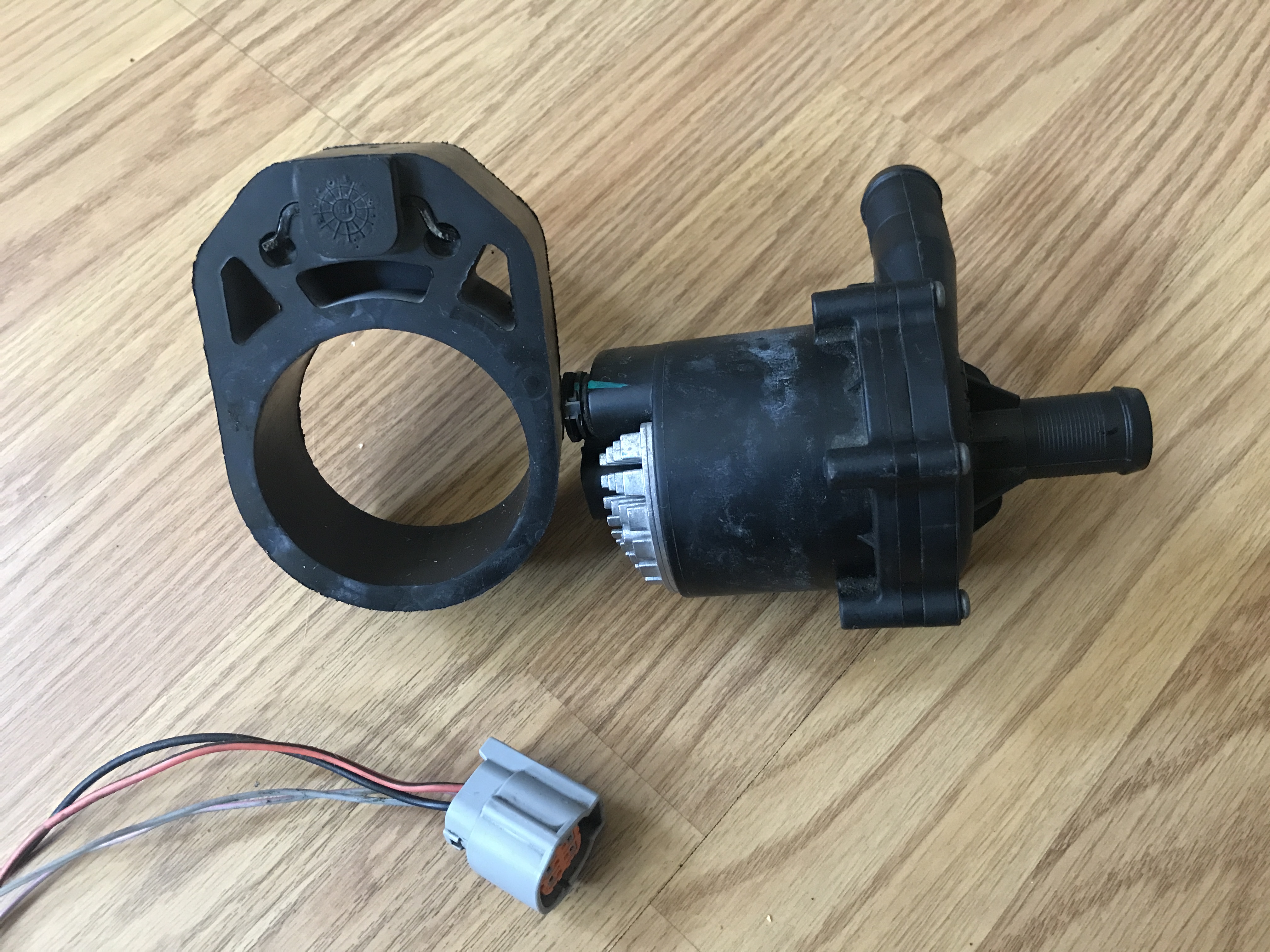

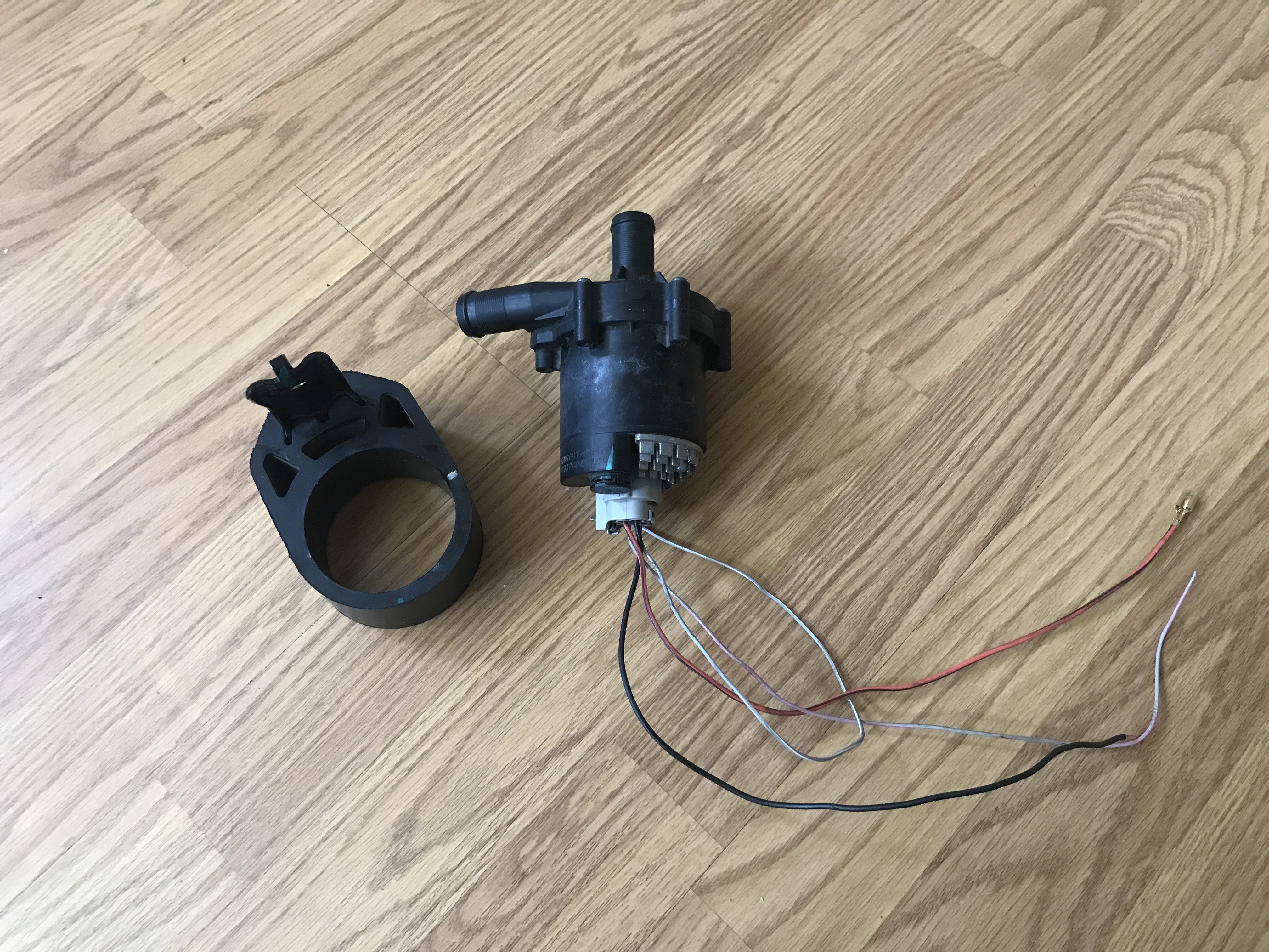

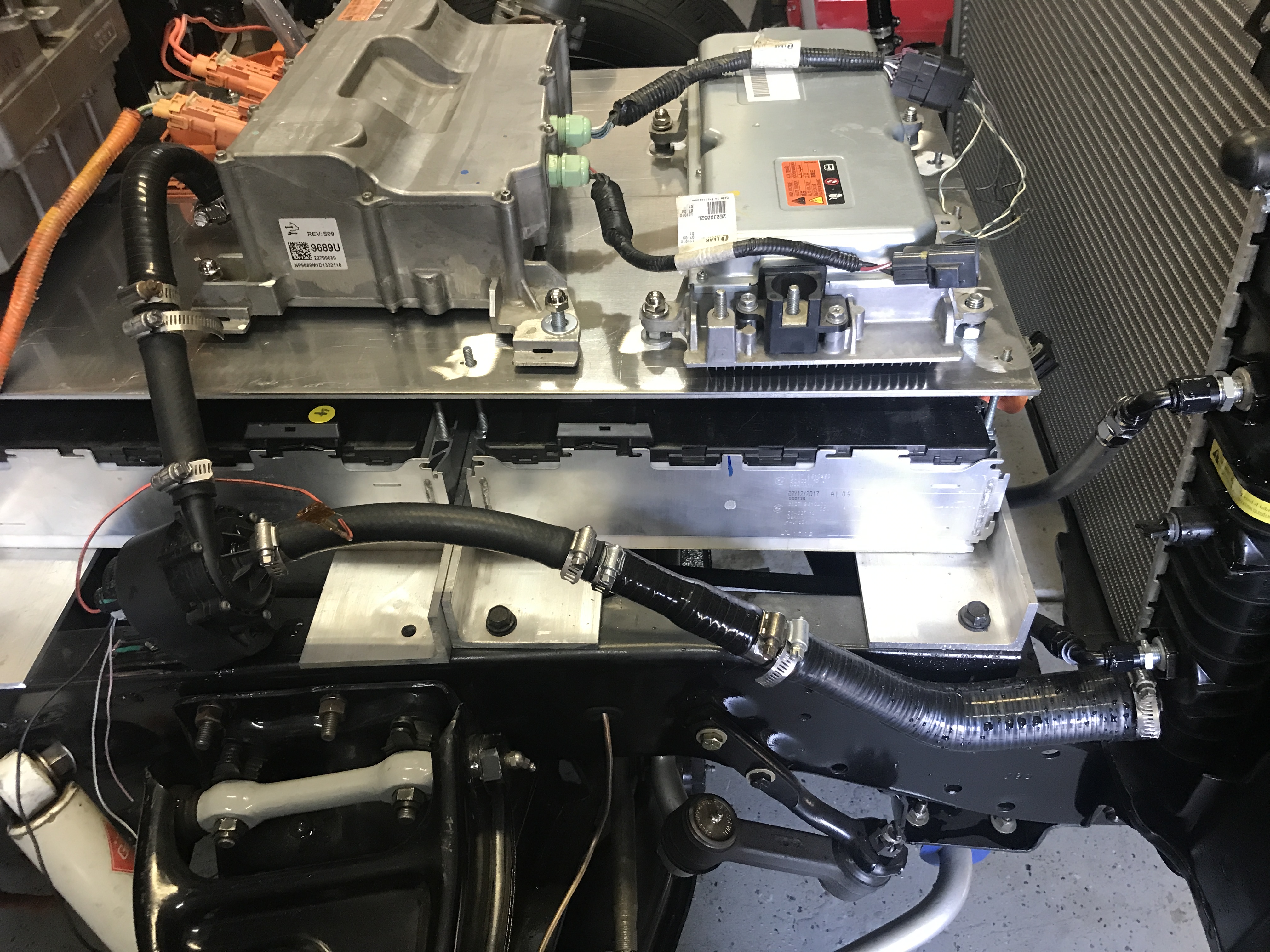

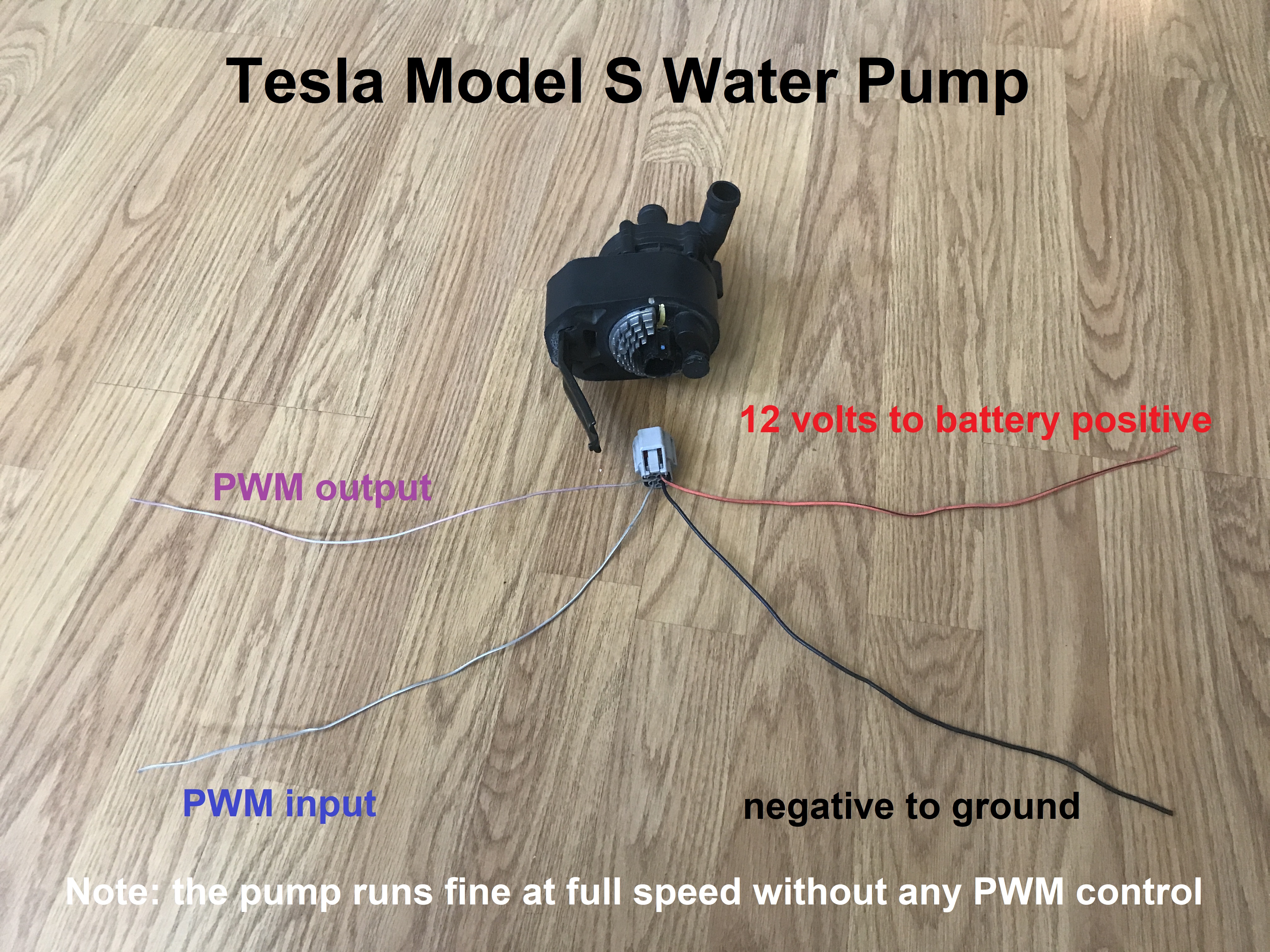

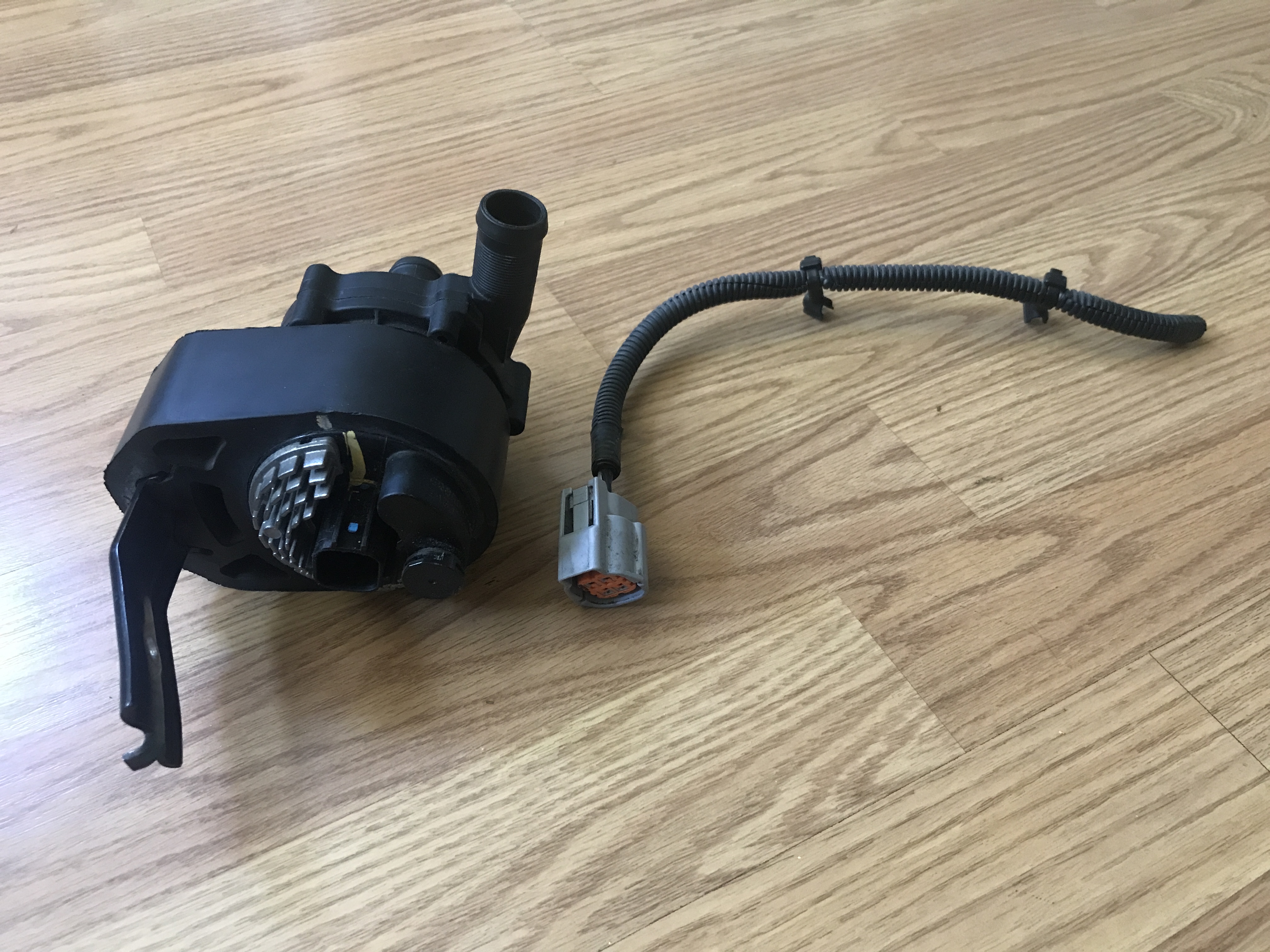

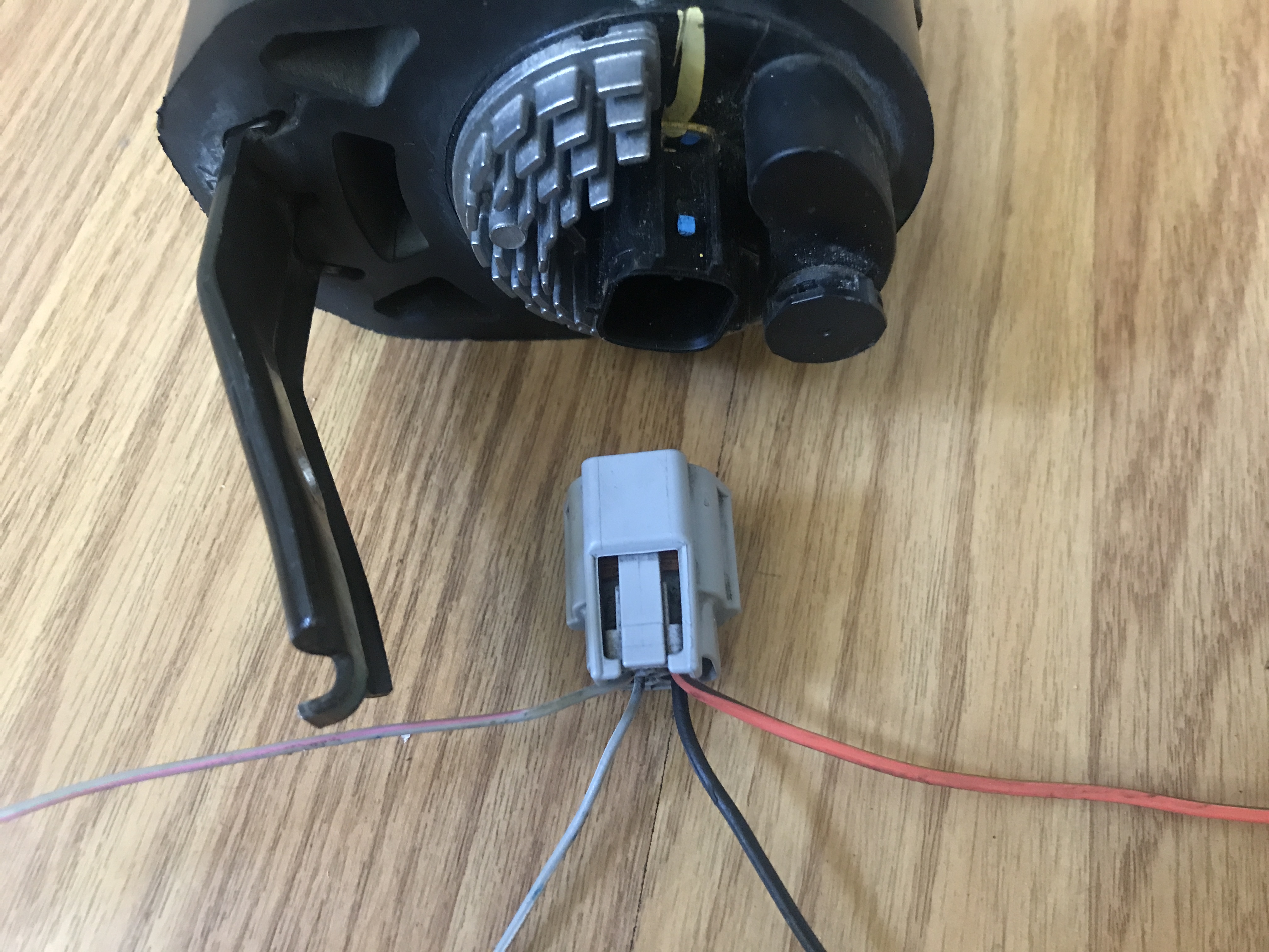

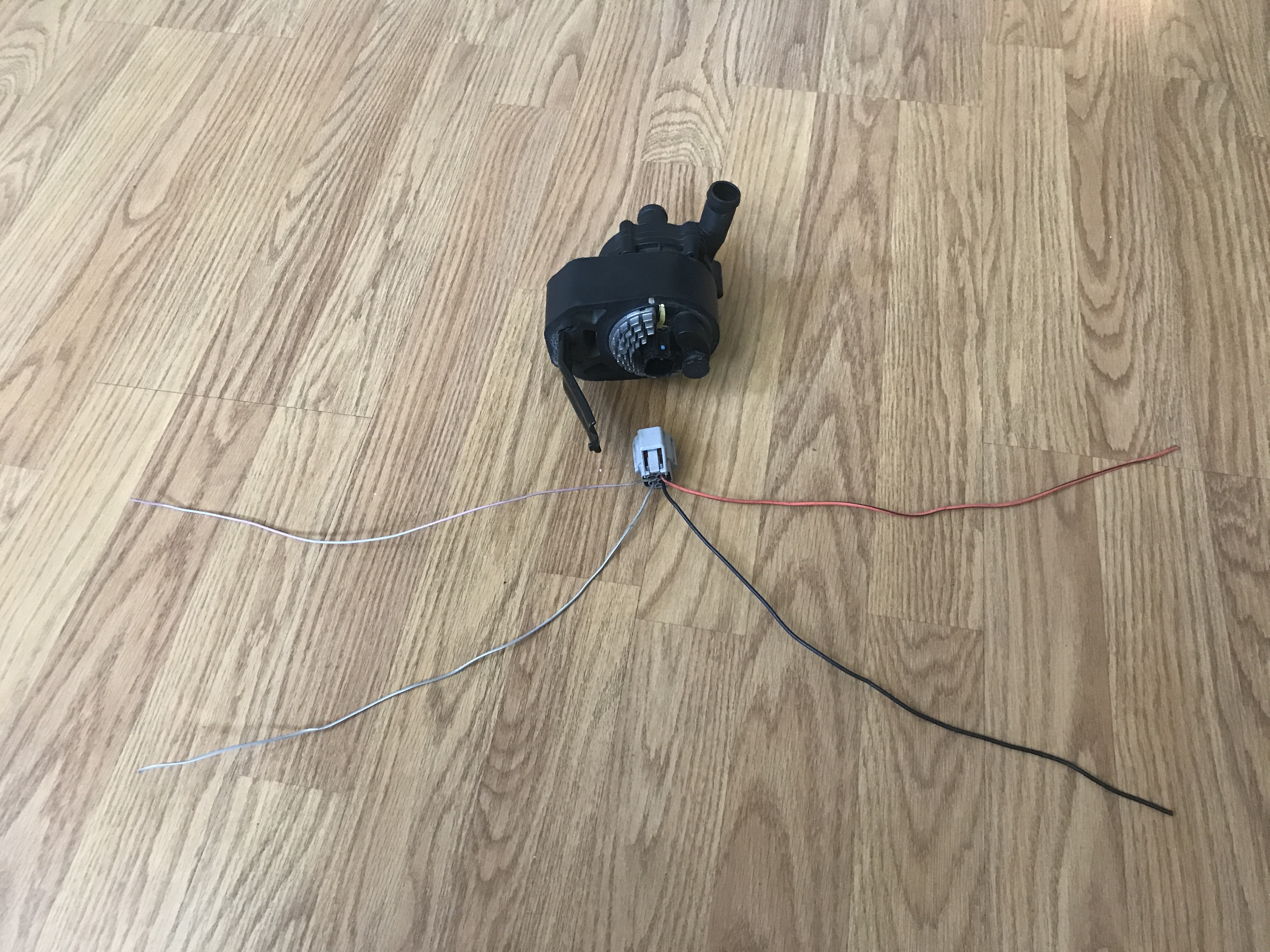

Post by Gregski »

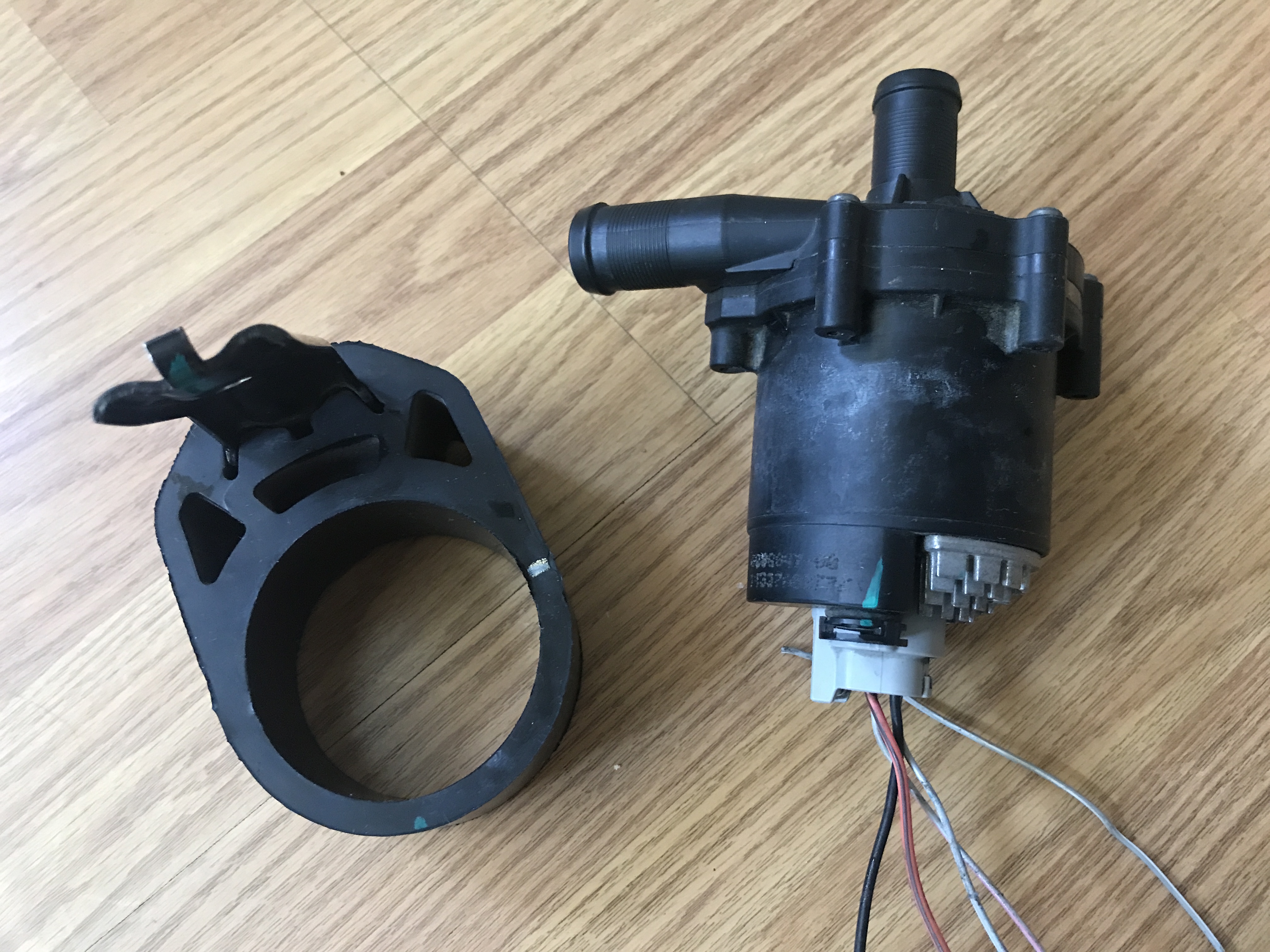

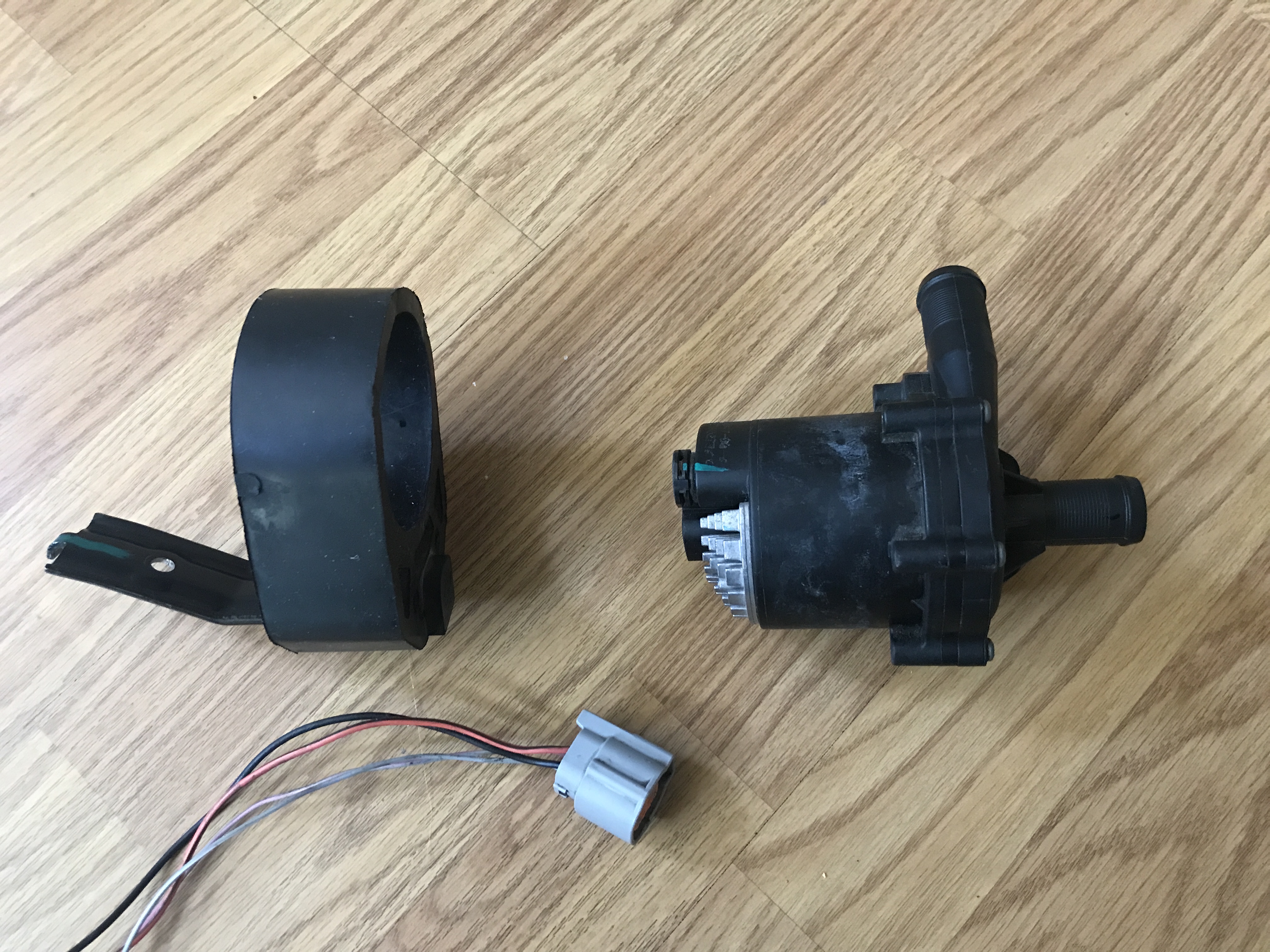

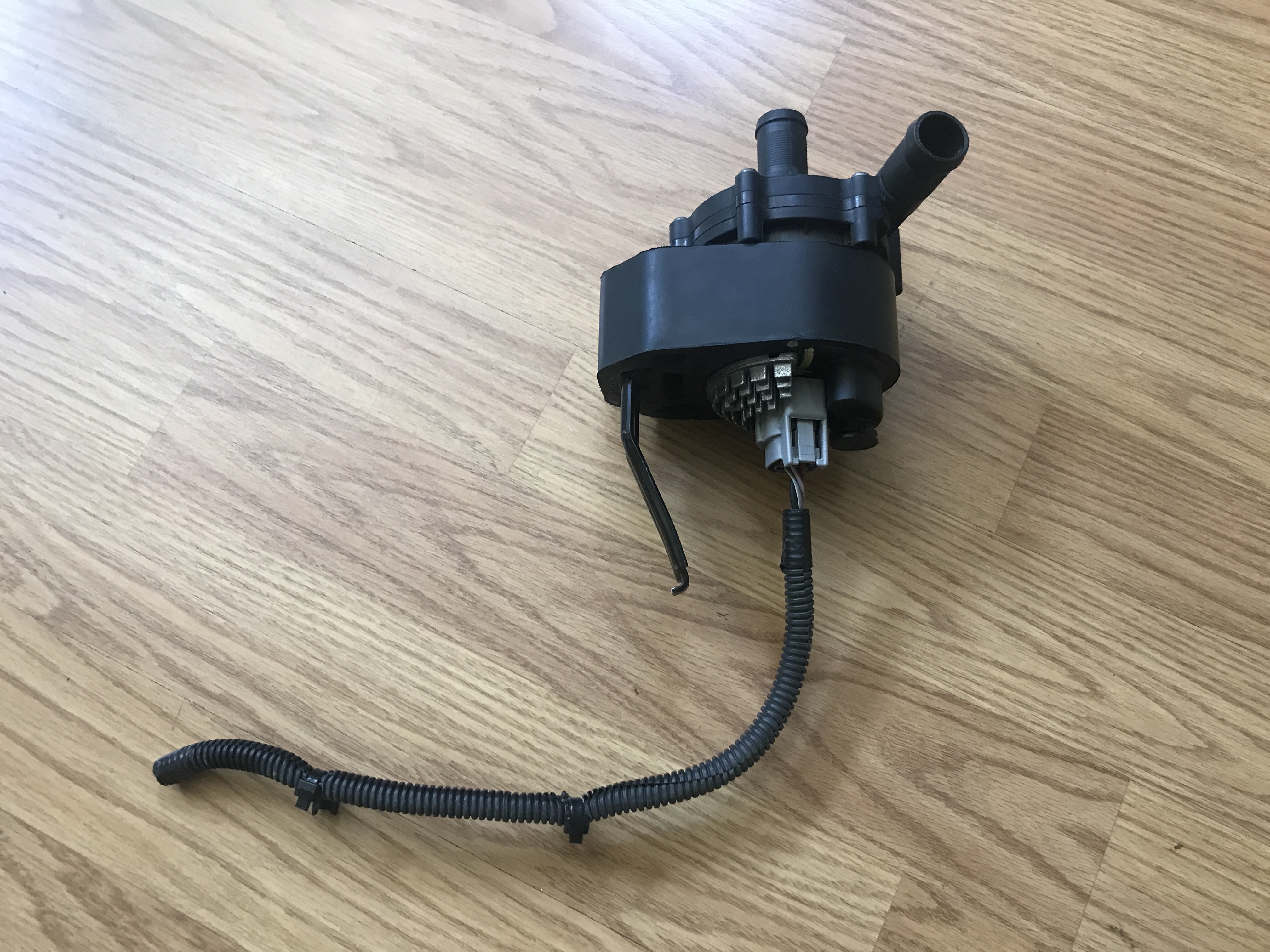

in keeping up with the current social media trends I now break my silence on the Tesla Model S water pump installation
one or two of the many part numbers
PN: 6008047-00-E, 1035348-00-G
so I call this the Tesla Model S water pump but I think someone else makes it for them and the only thing that makes it Tesla is this neat rubber bracket
Gregski
Posts: 3157

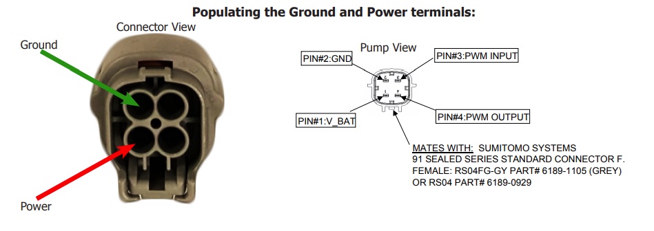

Post by Gregski »
L330070000.pdf
(3.78 MiB) Downloaded 268 times
Gregski
Posts: 3157
Post by Gregski »
"Due to the thermal expansion of rubber coolant hoses, LPE does not recommend using
worm gear clamps to clamp the hoses to the intercooler pump. Because worm gear clamps
do not apply constant tension to the hoses, the hoses can leak when exposed to cooler
temperatures. LPE recommends the use of the OEM constant-tension clamps or spring
clamps as superior alternatives to the standard worm gear clamp."
Gregski
Posts: 3157

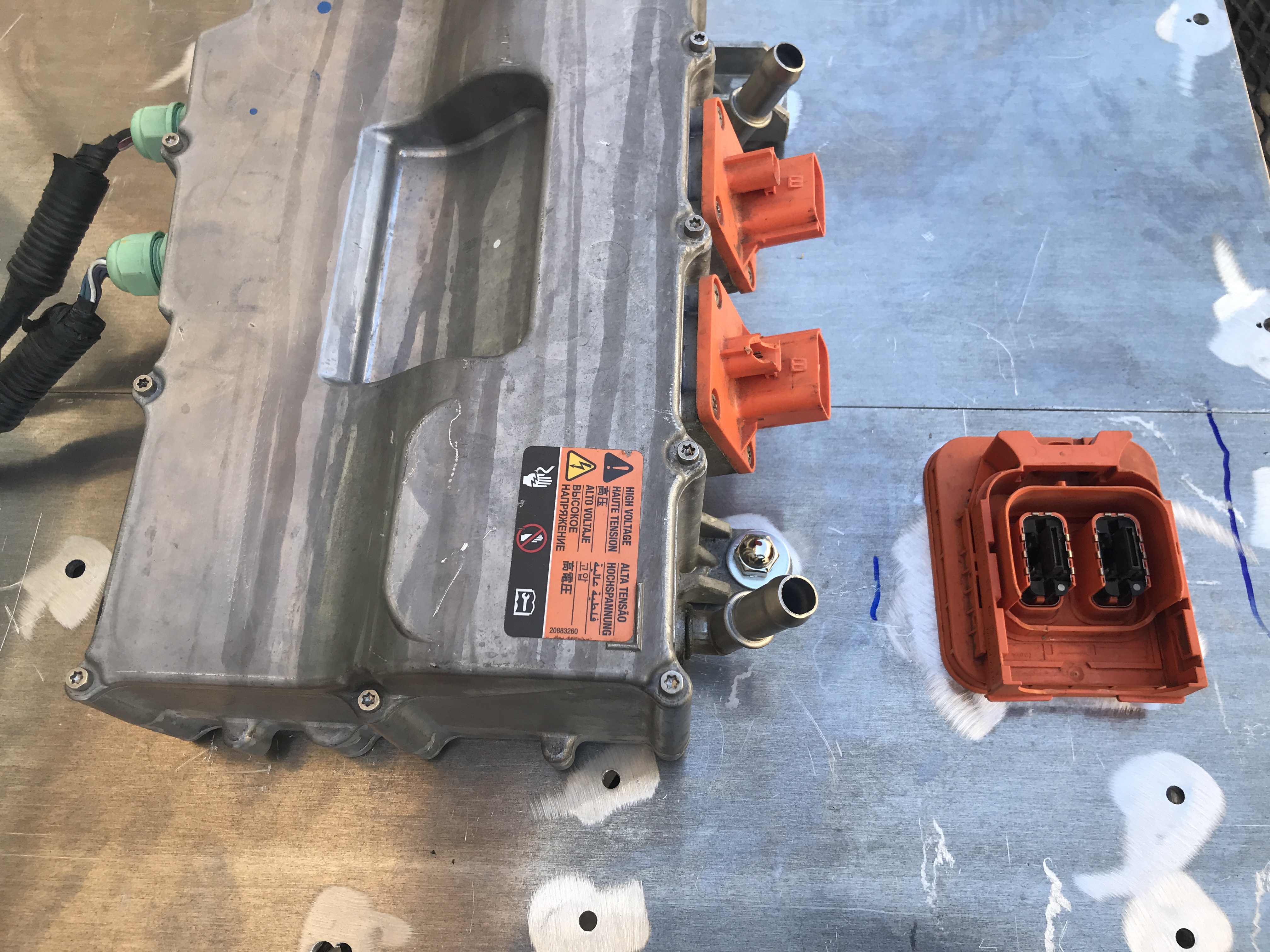

Post by Gregski »
What will this pump cool?
  • the Lexus transmission (it has two electric motors inside of it)
  • the Lexus Inverter (think carburetor/distributor combo)
  • the Chevy Volt battery charger
FYI the Chevy Volt DC DC Converter (aka alternator) is air cooled and does not require the water pump action
What? I like to watch.

Post by Gregski »

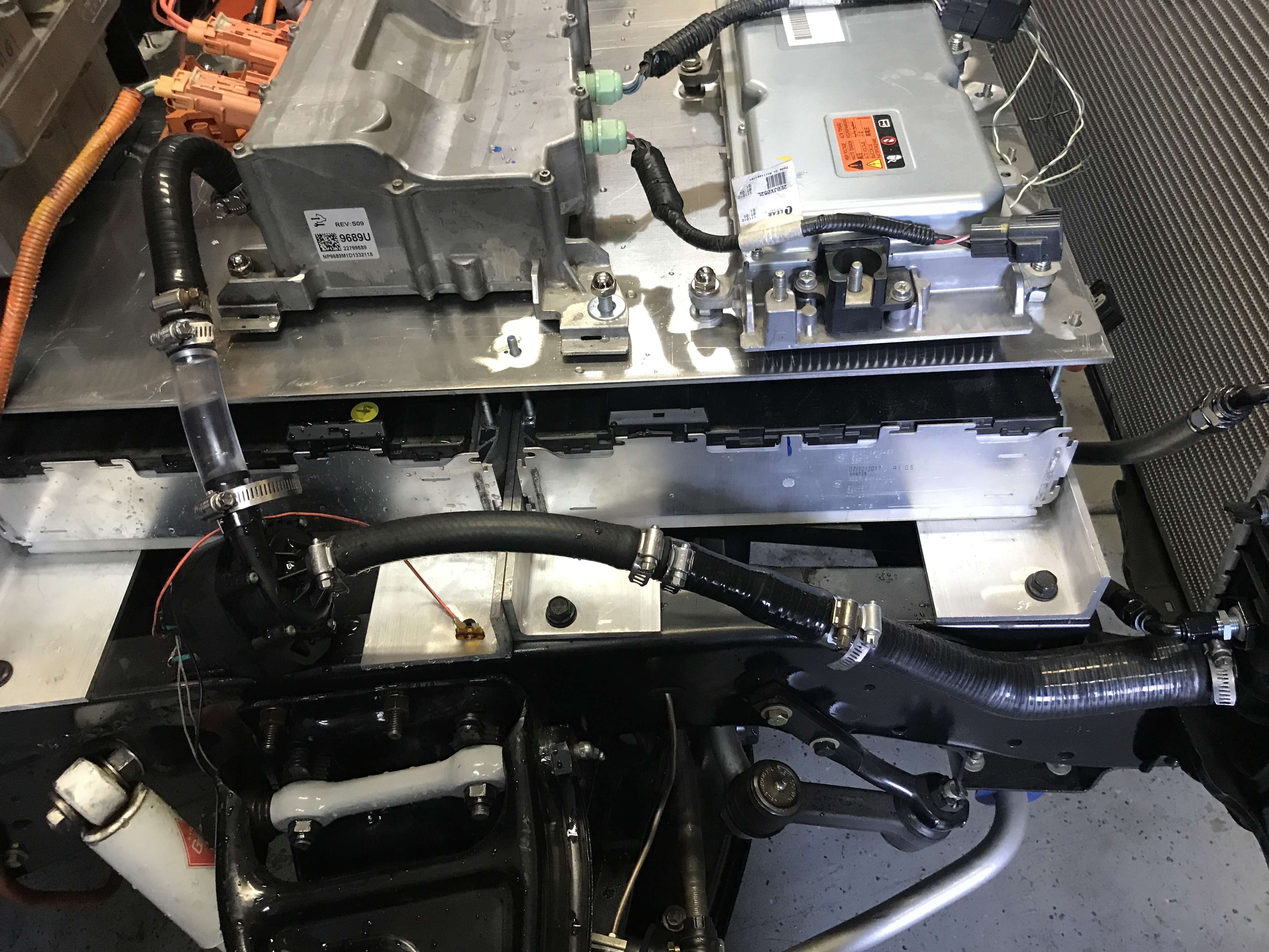

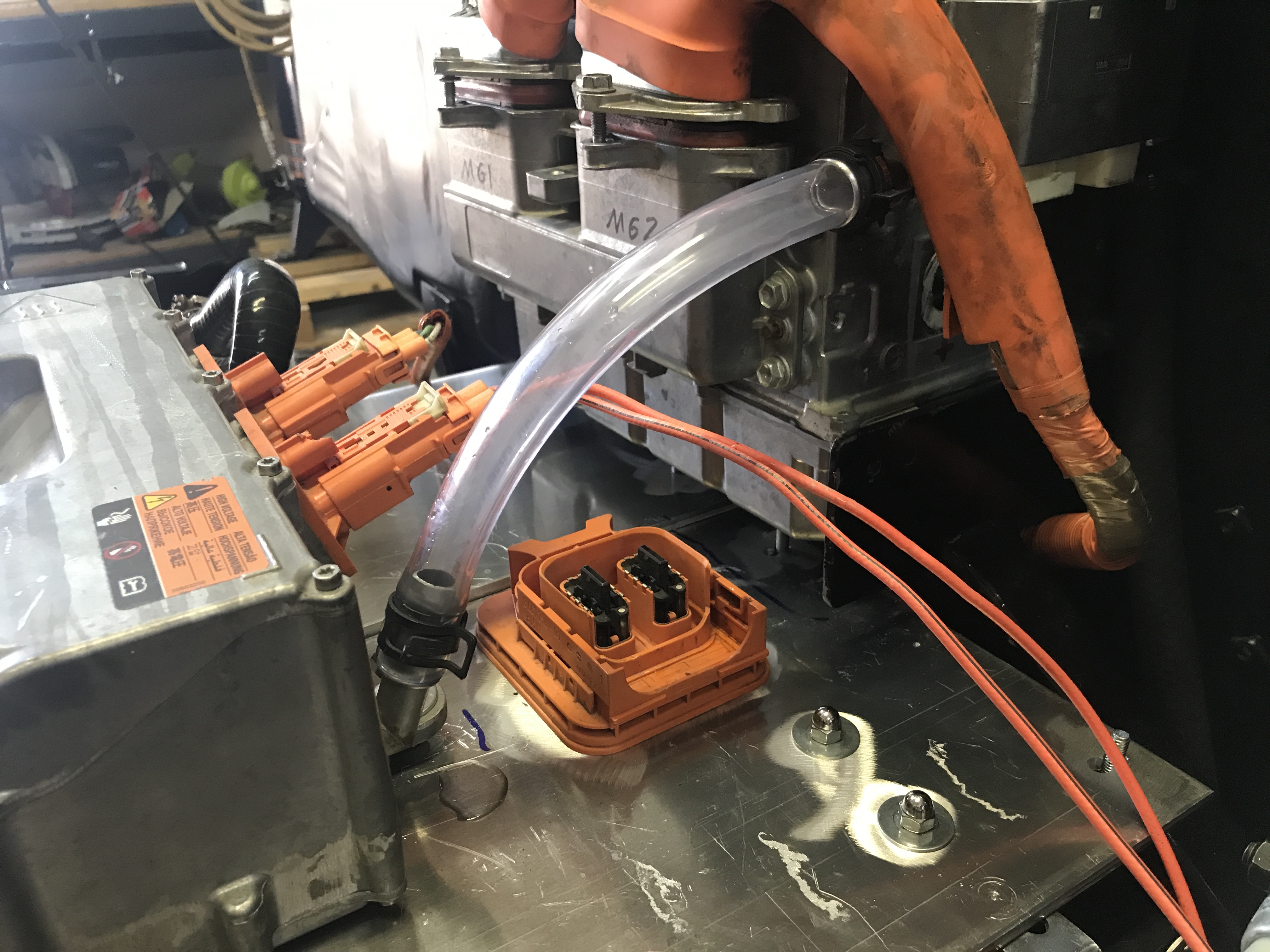

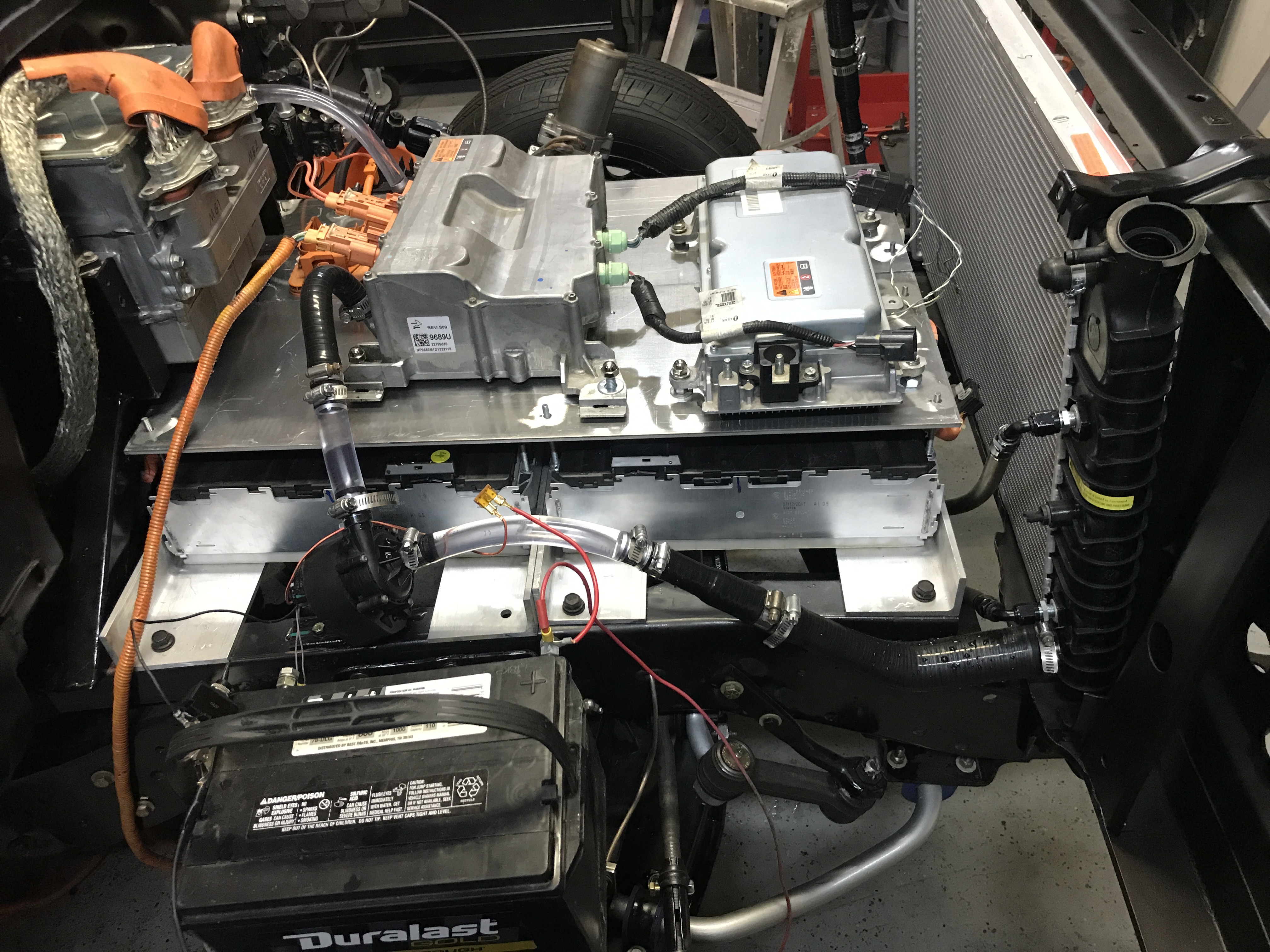

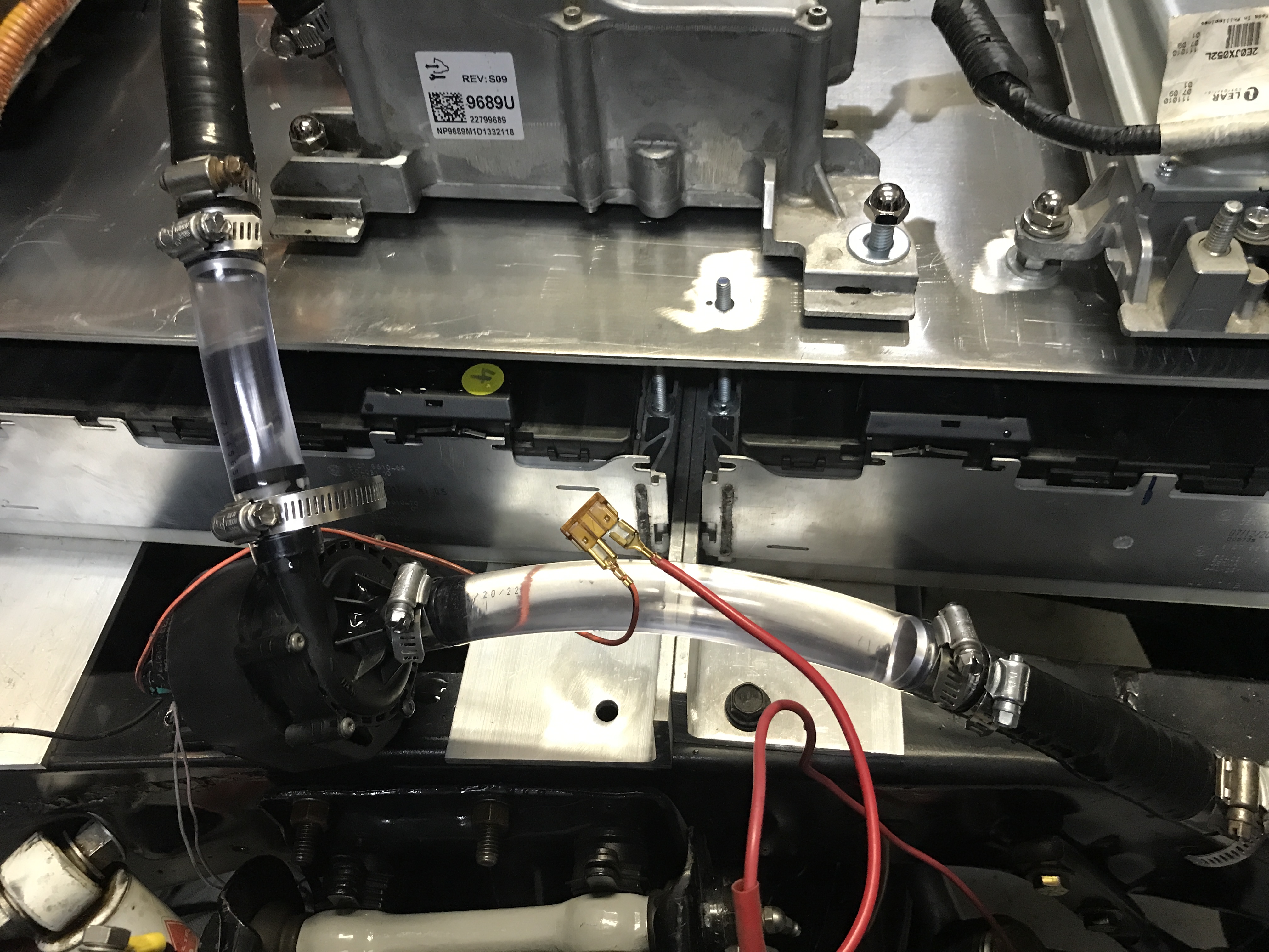

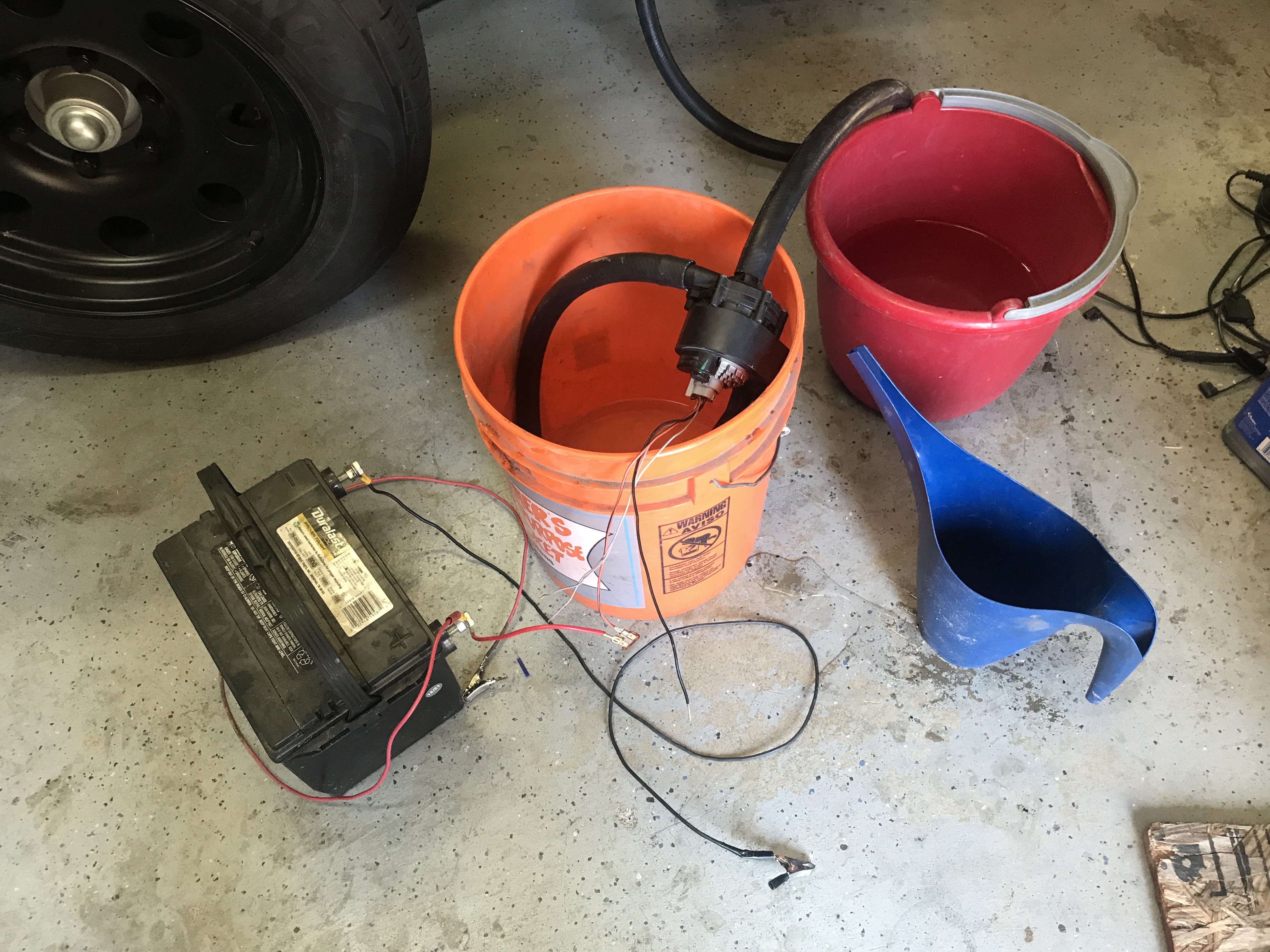

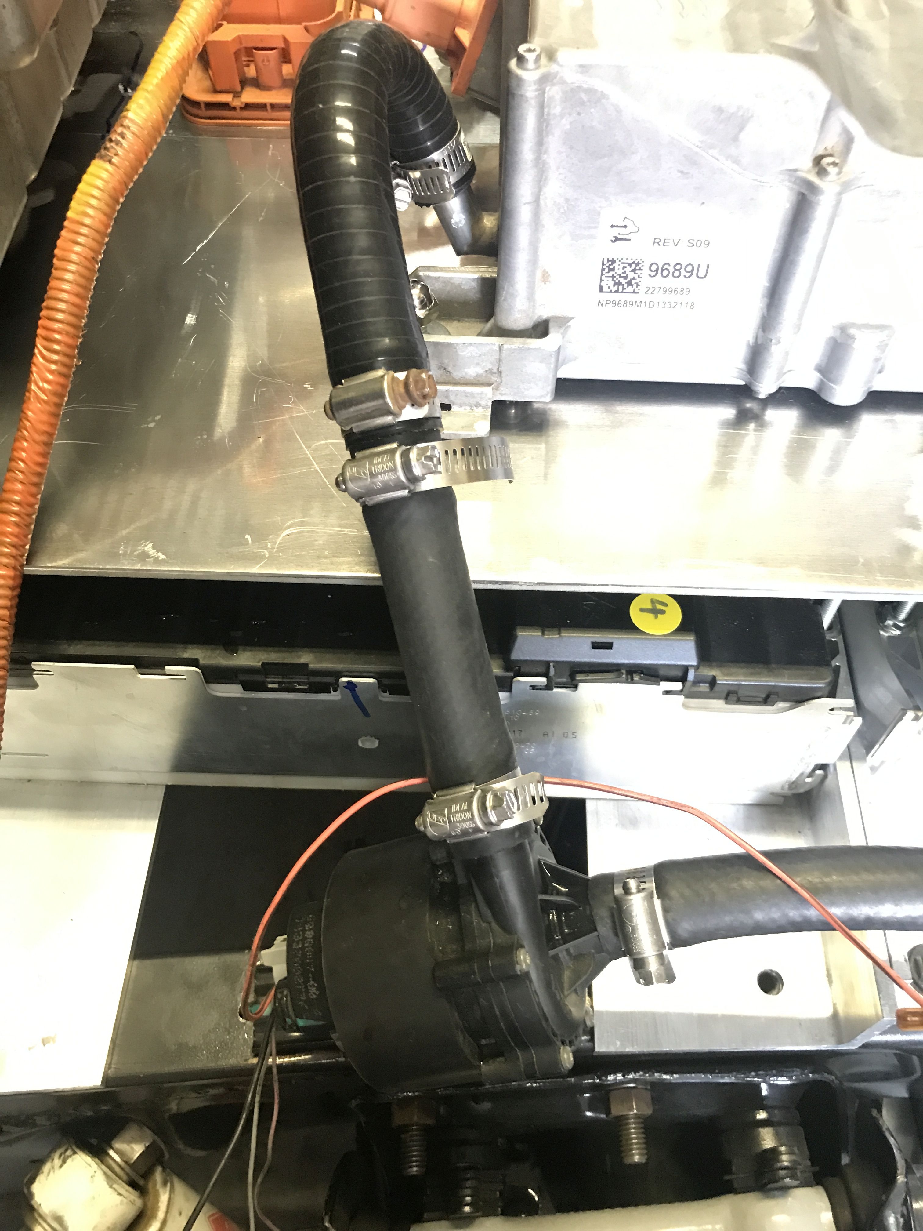

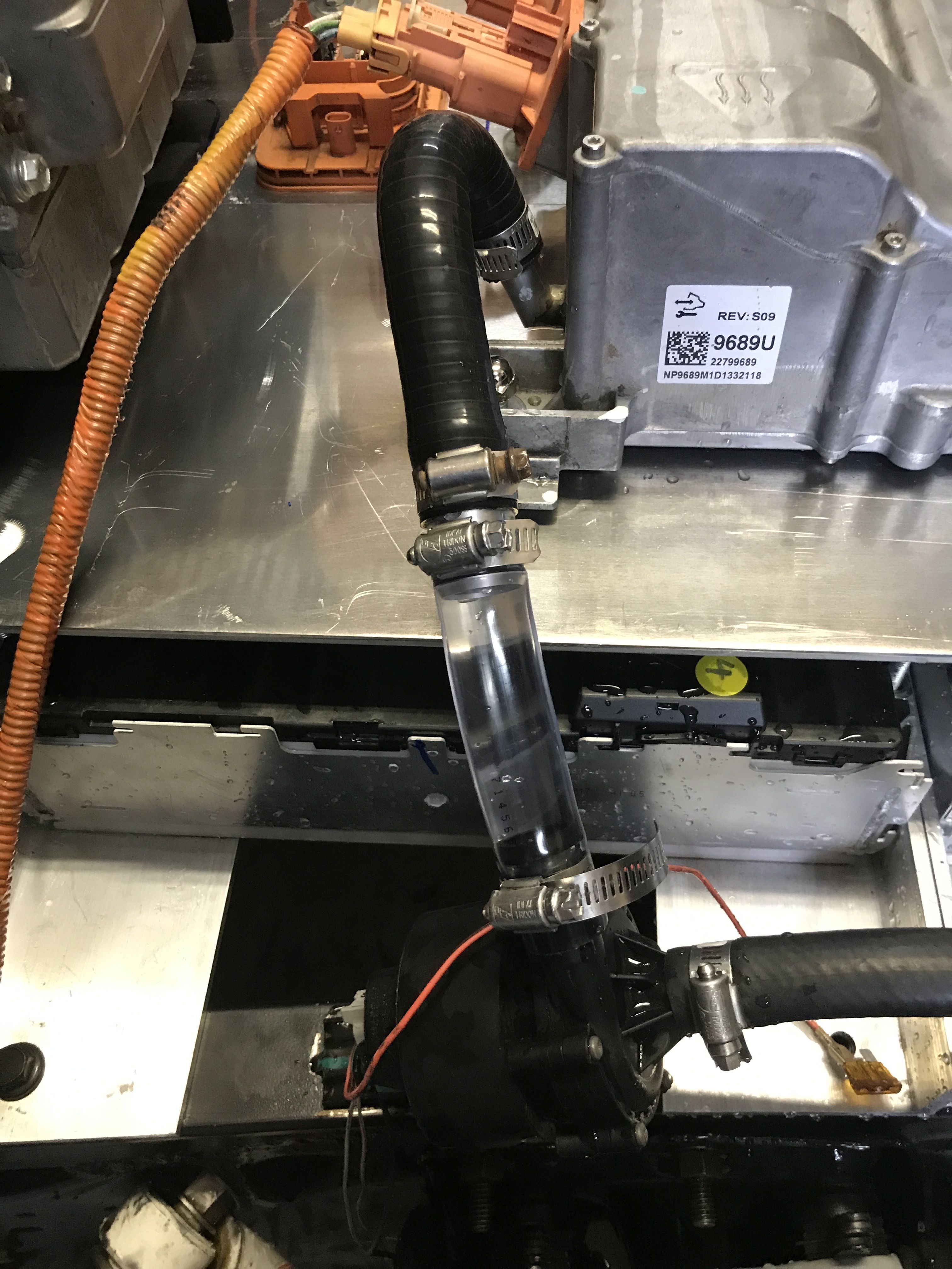

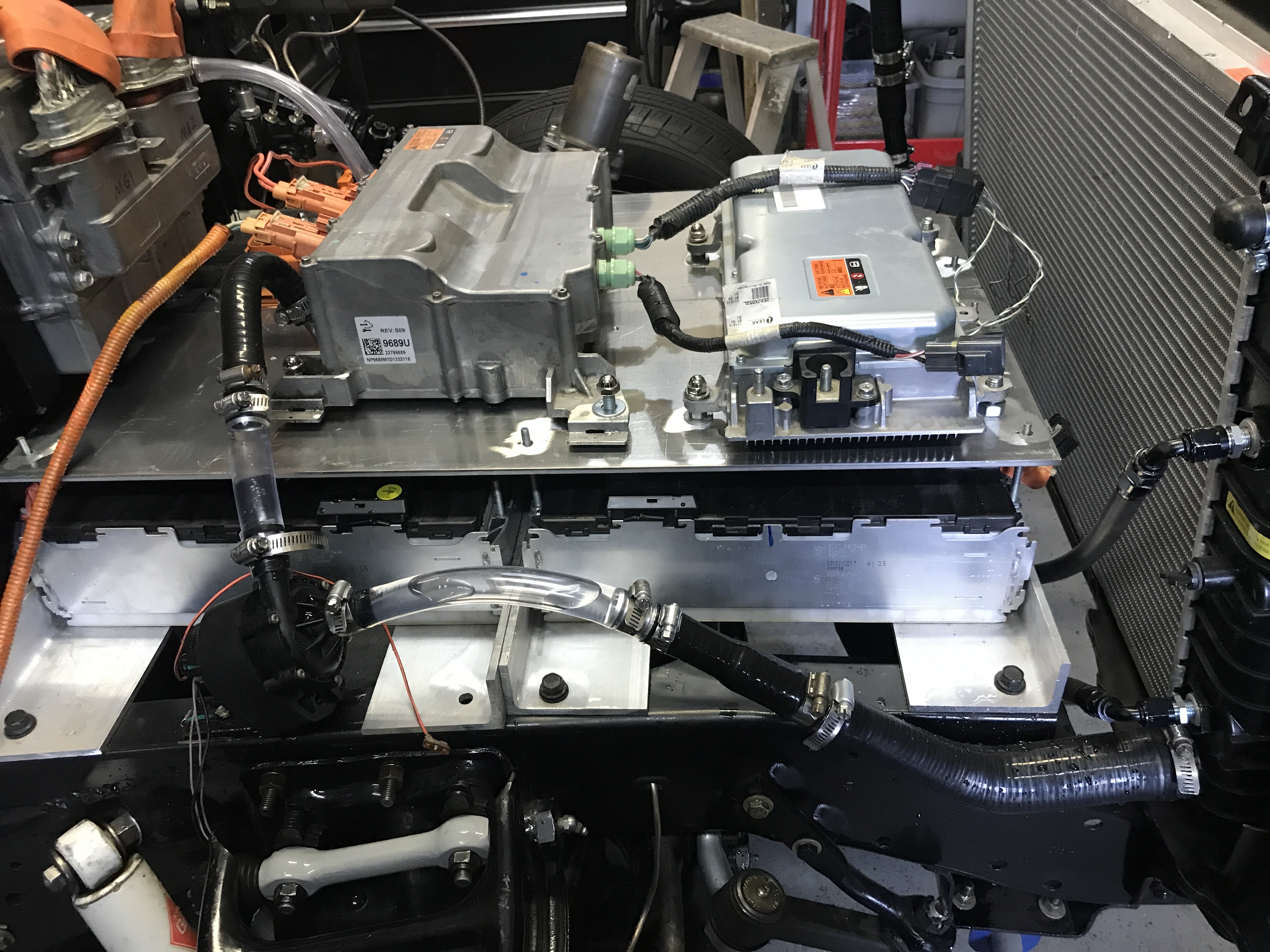

so tested it out with a bucket, it worked
plumbed it on the truck, it didn't work
Gregski
Posts: 3157
Post by Gregski »

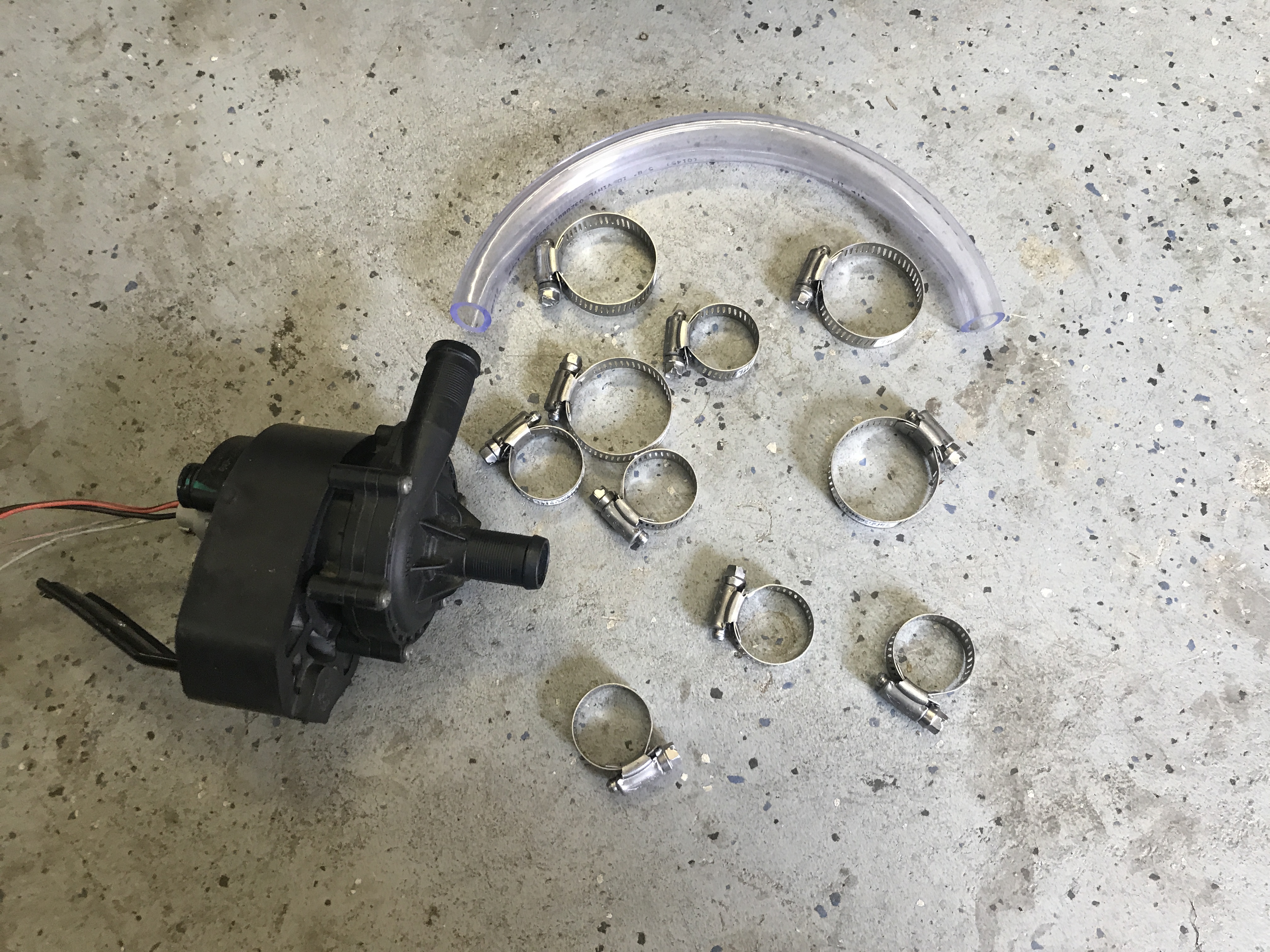

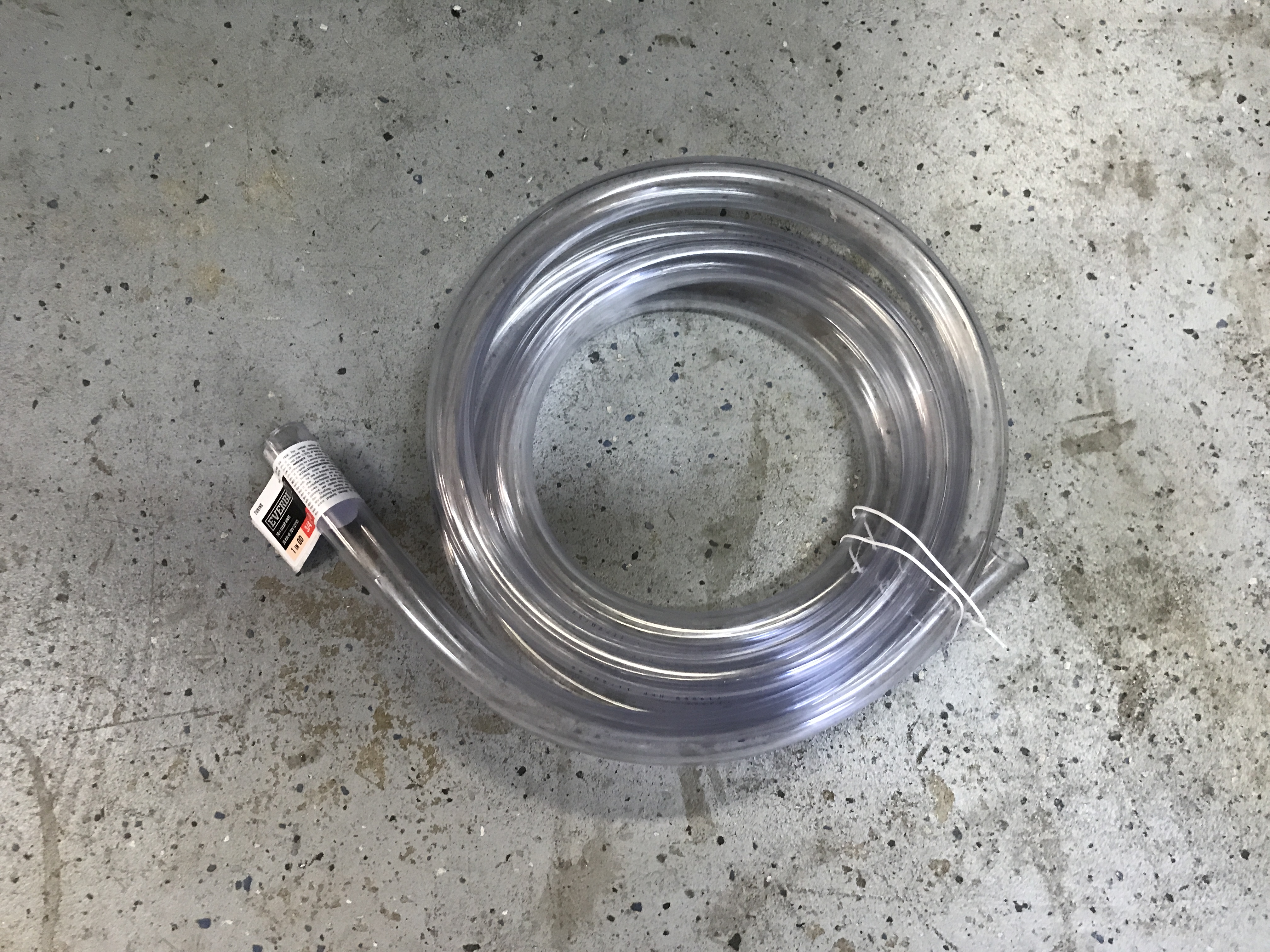

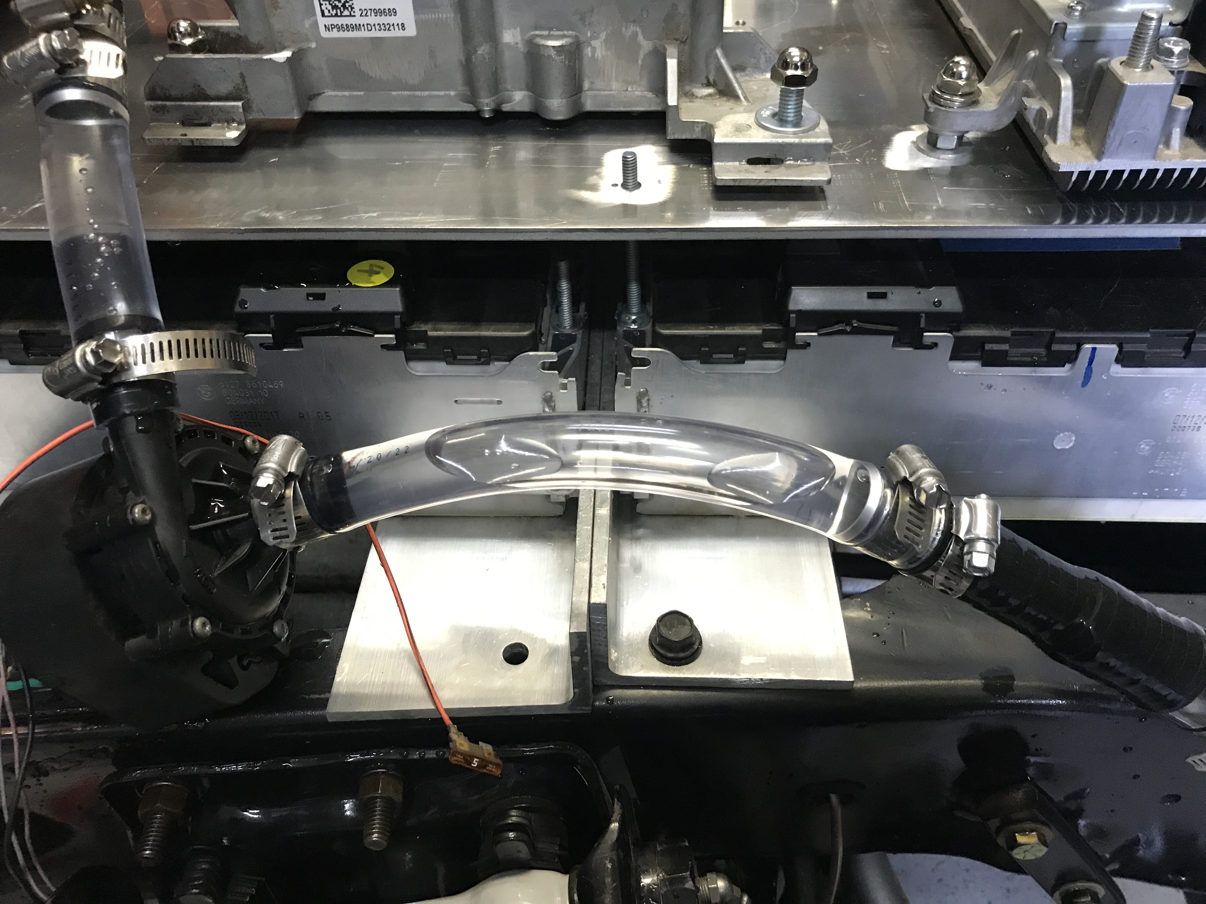

Time to troubleshoot
of course the place that sales the 3/4" I.D. clear hose by the foot was out of the 3/4" I.D. clear hose, so off to Home Depot I went (like a fool) and instead of buying just one foot of it I had to buy a spool, at California prices mind you !
Gregski
Posts: 3157
Post by Gregski »
so now we can see what is going in to the water pump as well as what is coming out... we shall call this Science !
Gregski
Posts: 3157
Post by Gregski »
don't ask me how I got rid of that air bubble as this is a family friendly forum
Gregski
Posts: 3157

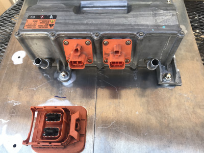

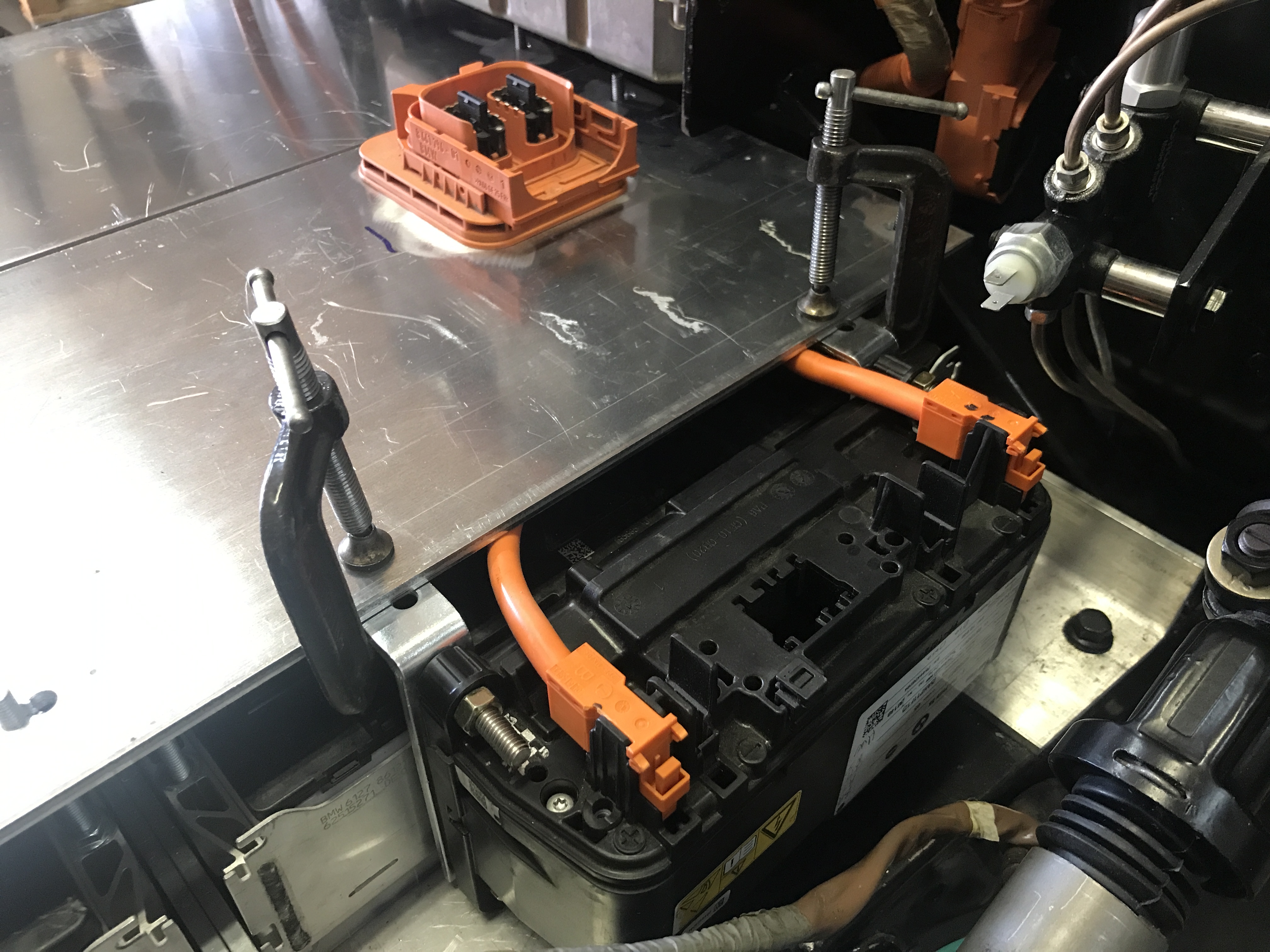

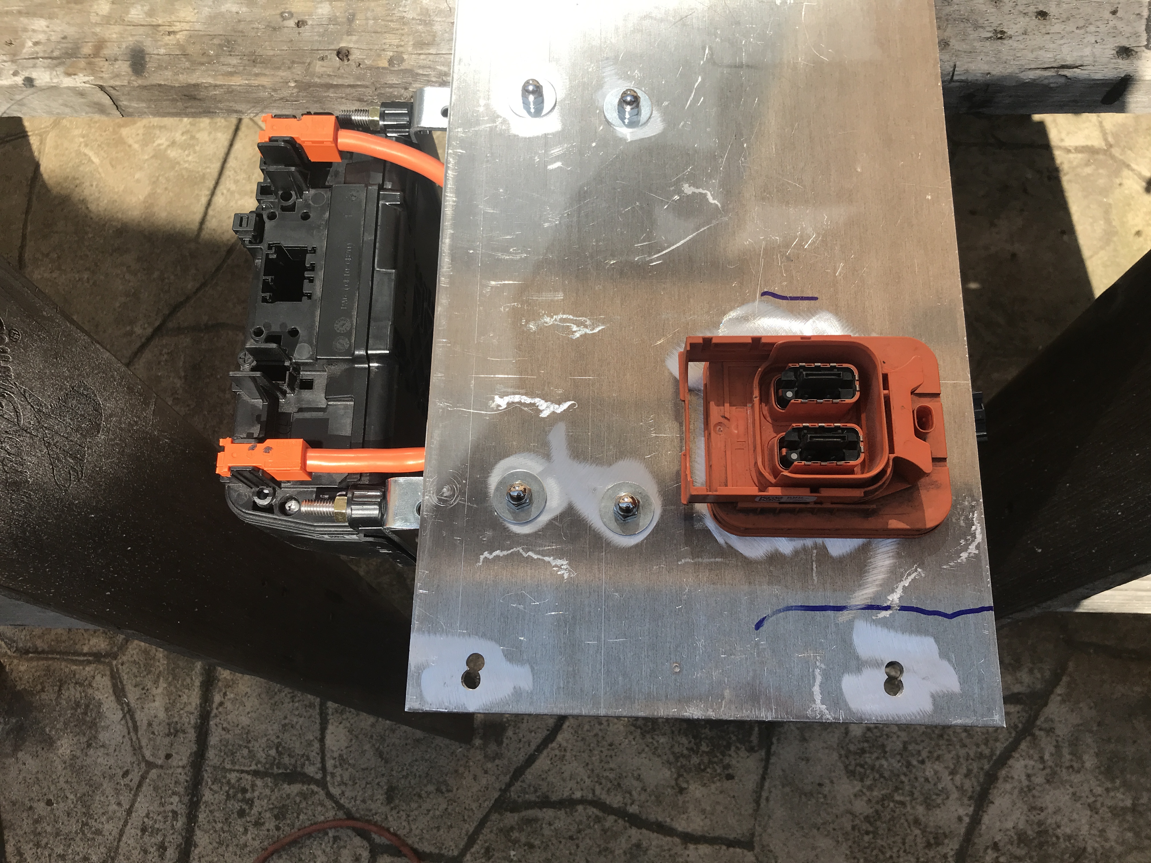

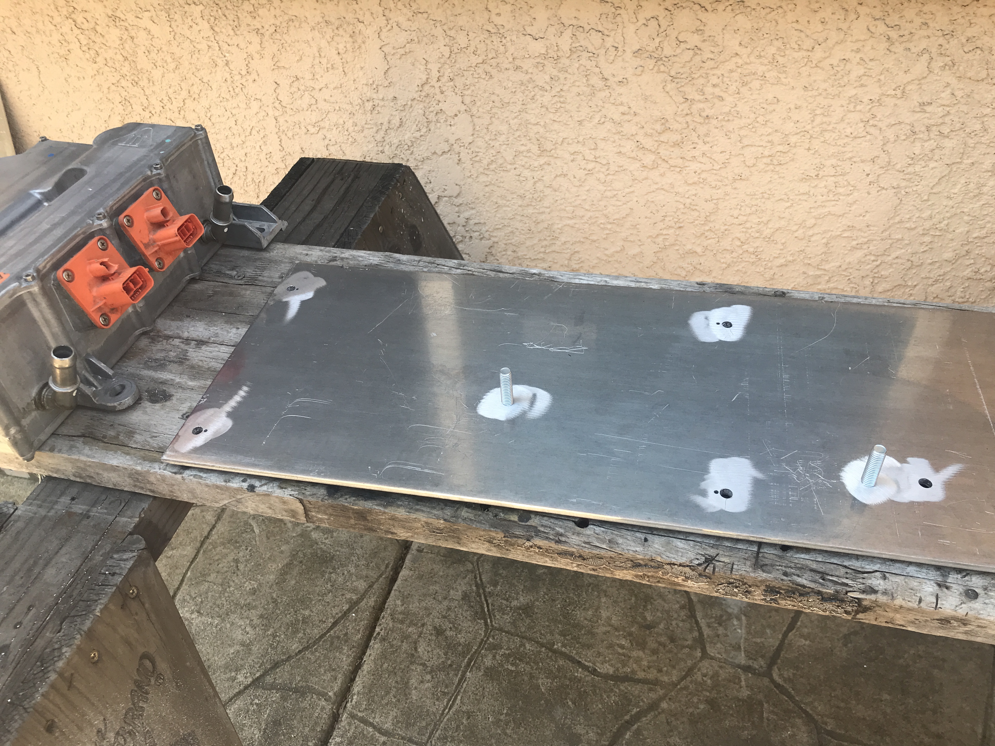

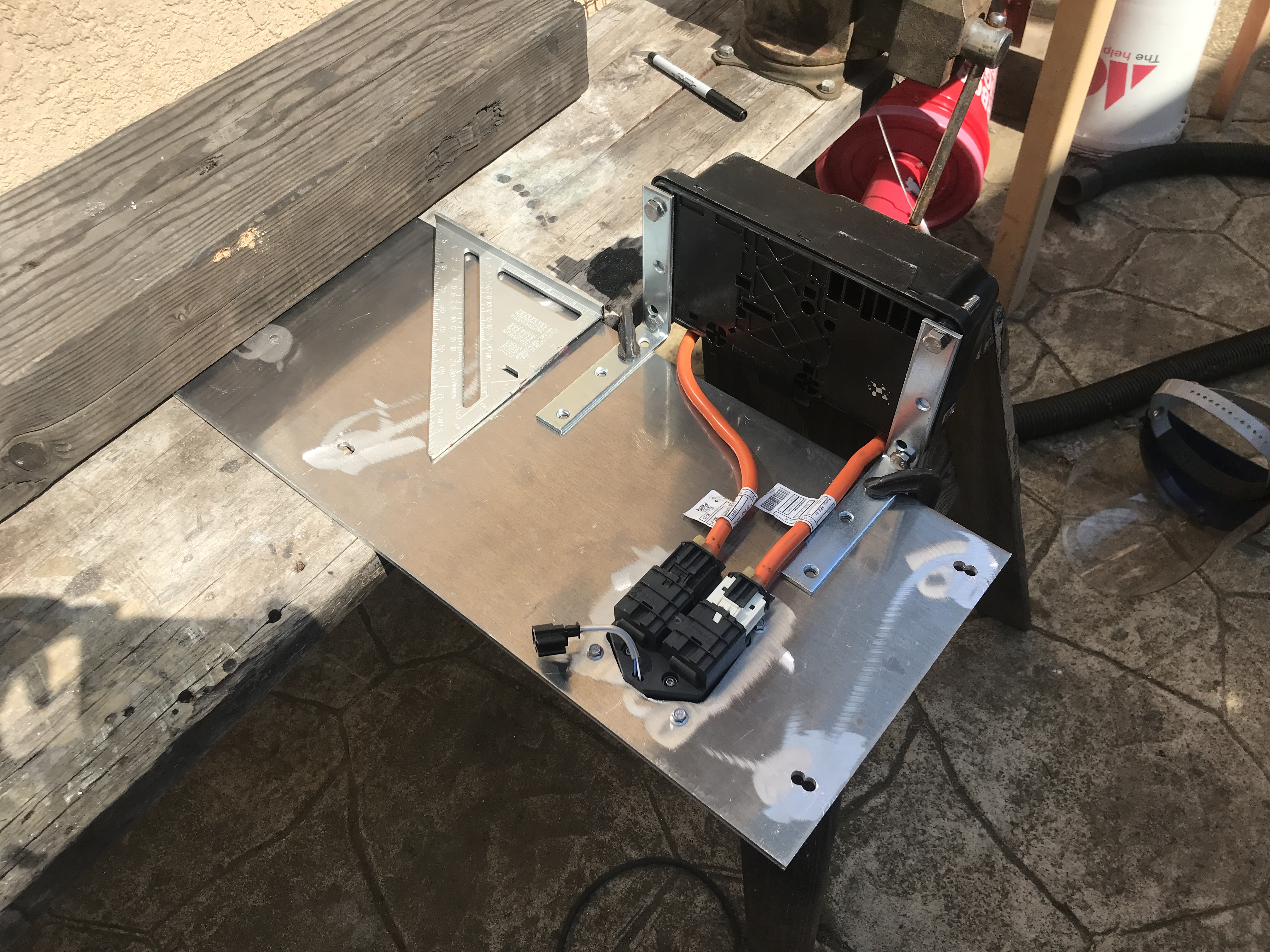

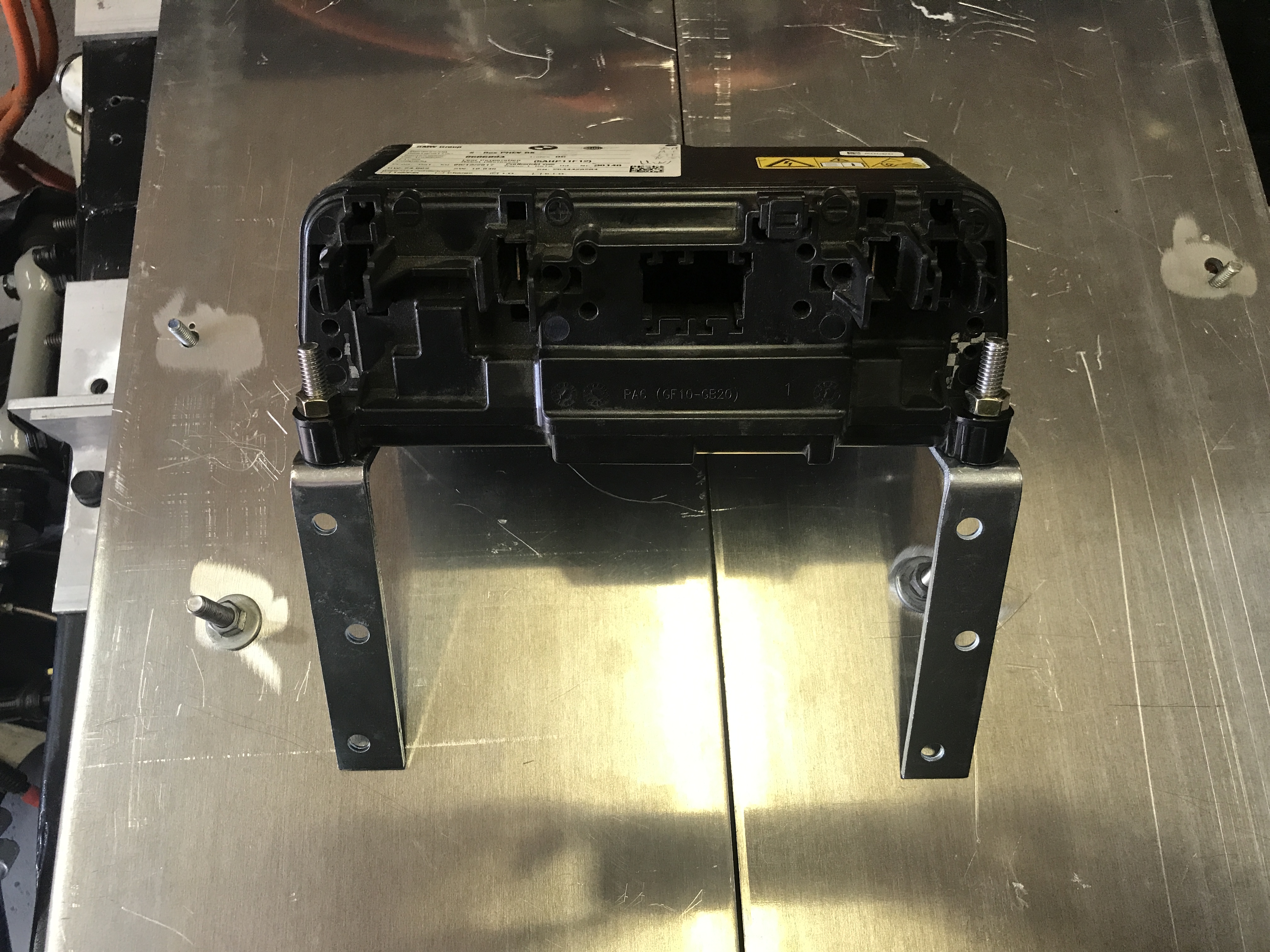

Post by Gregski »

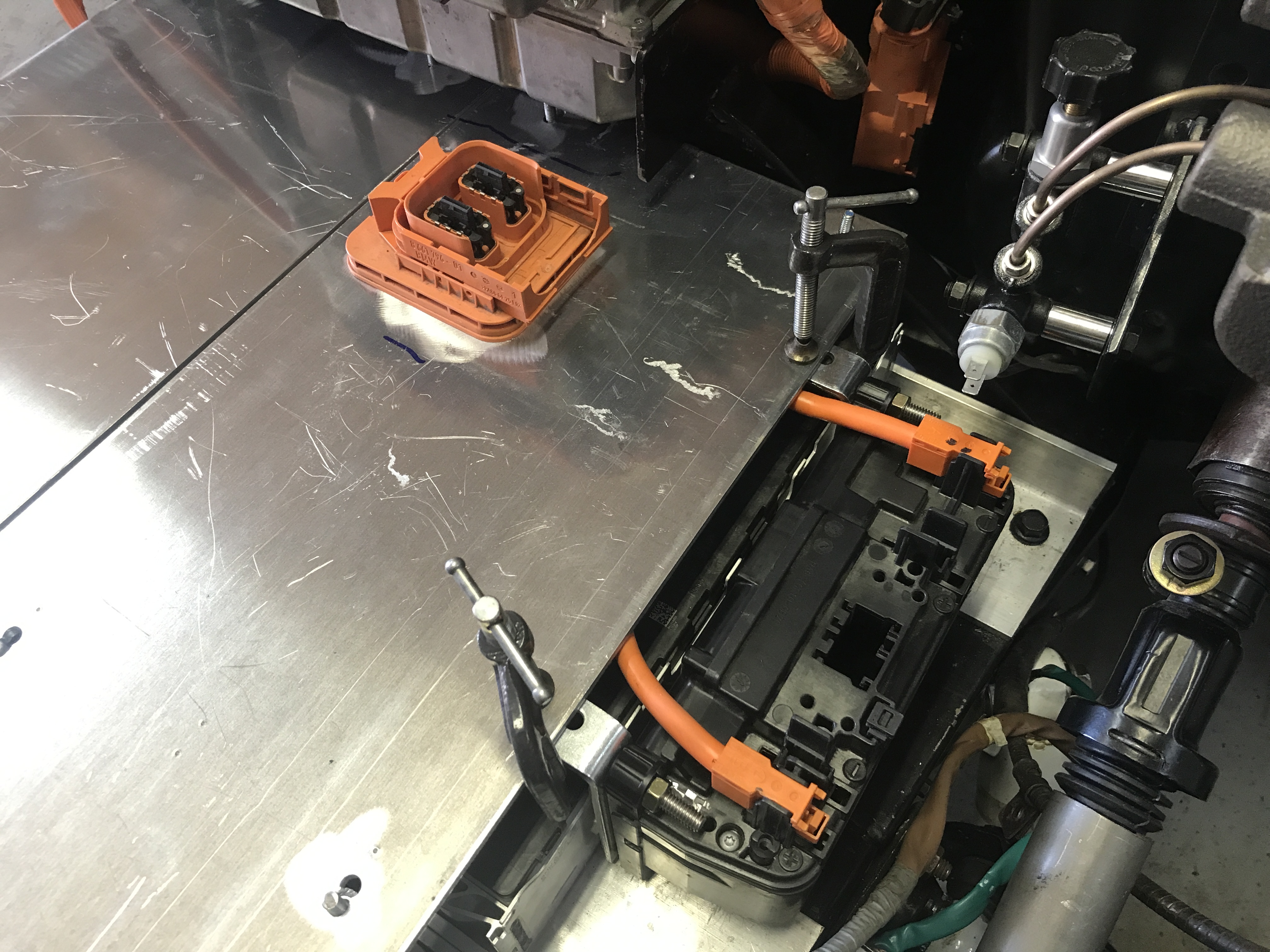

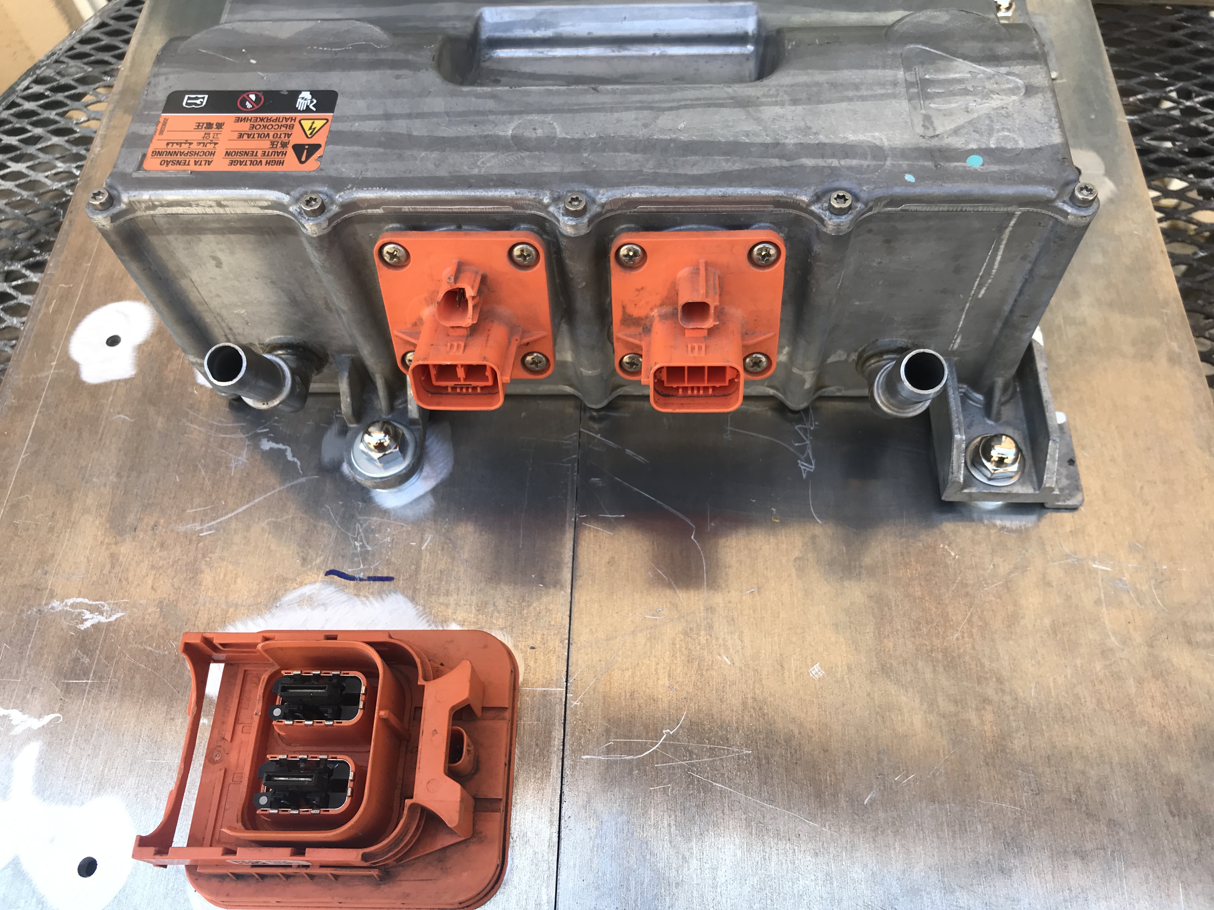

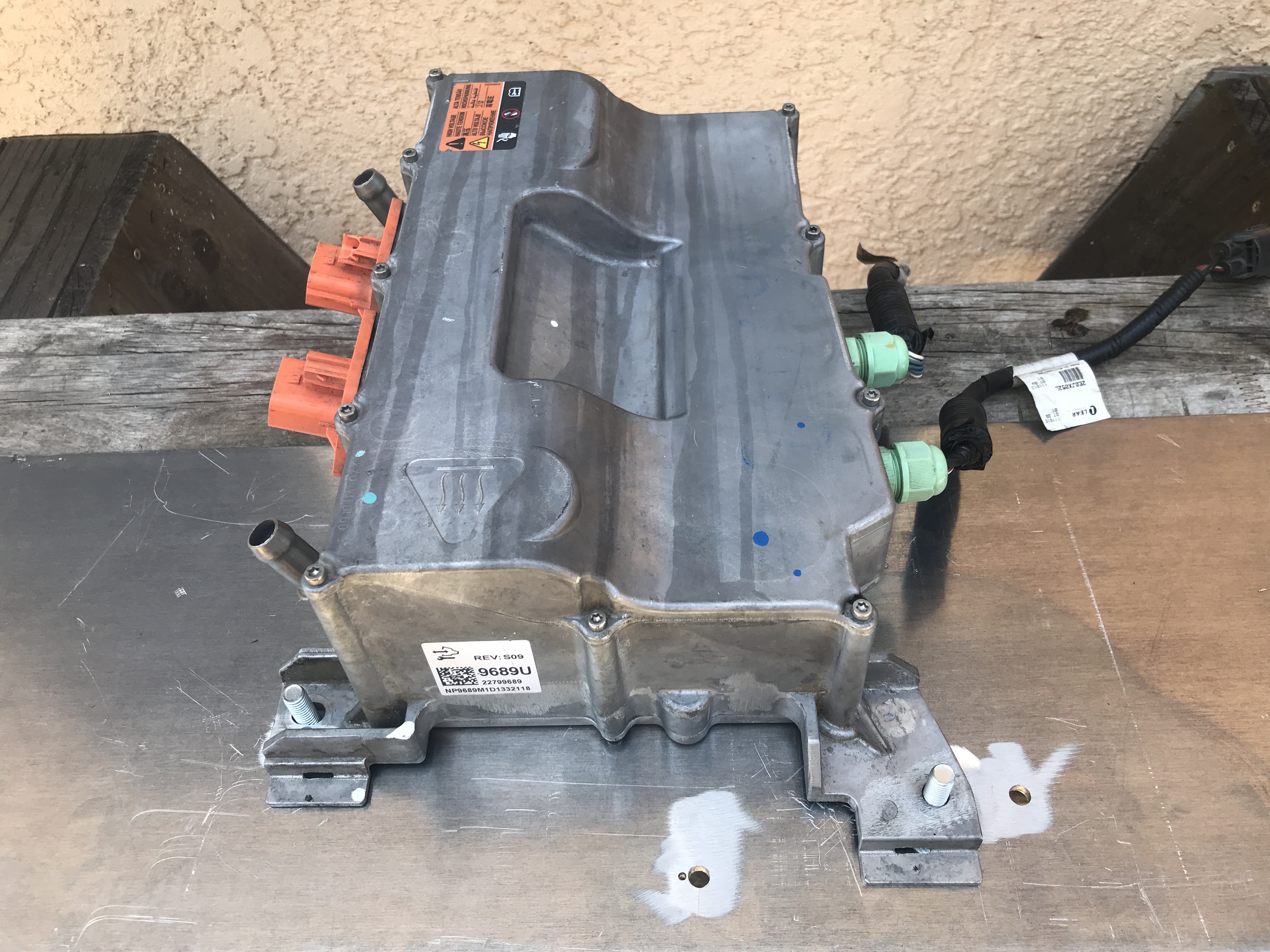

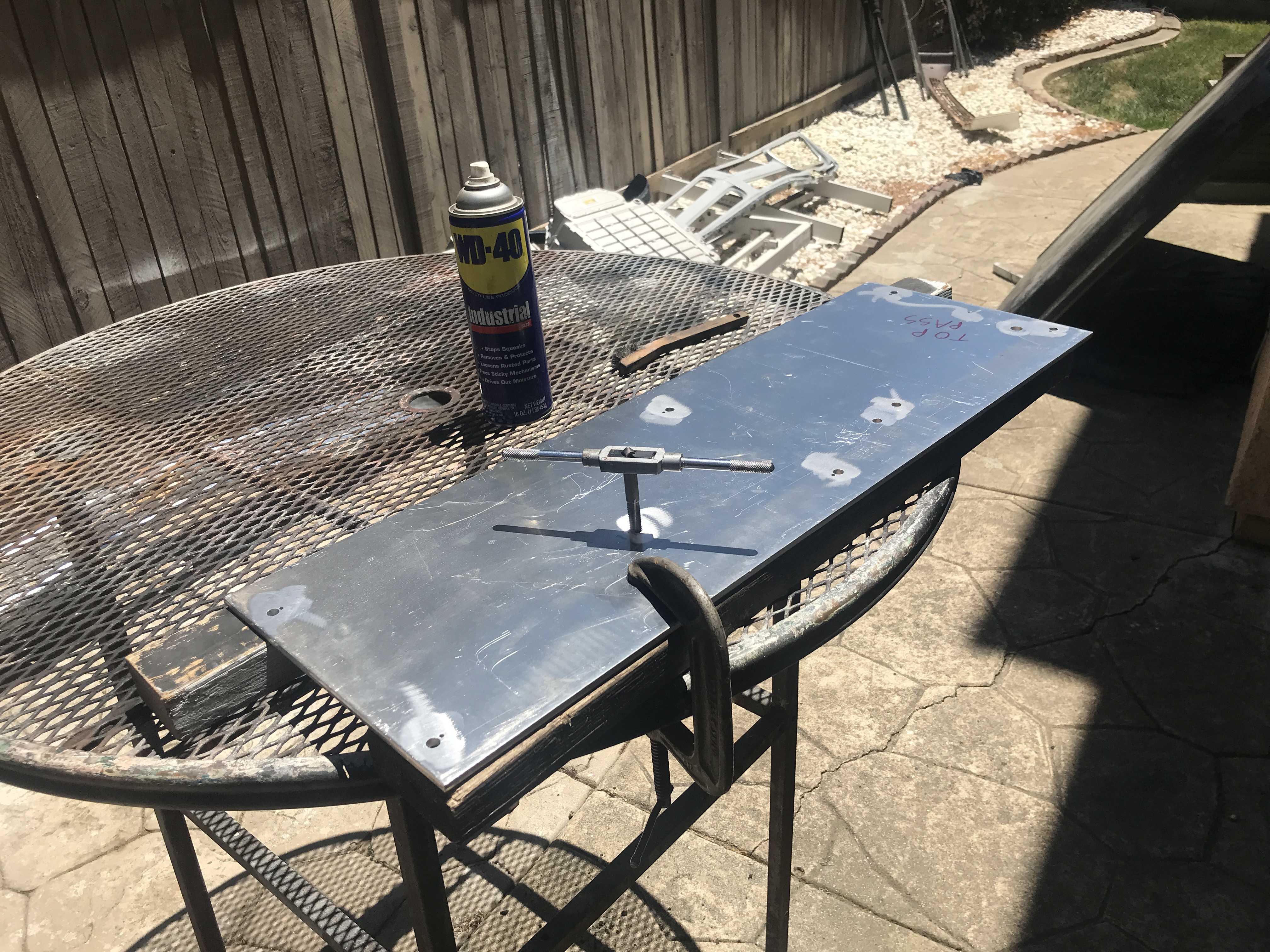

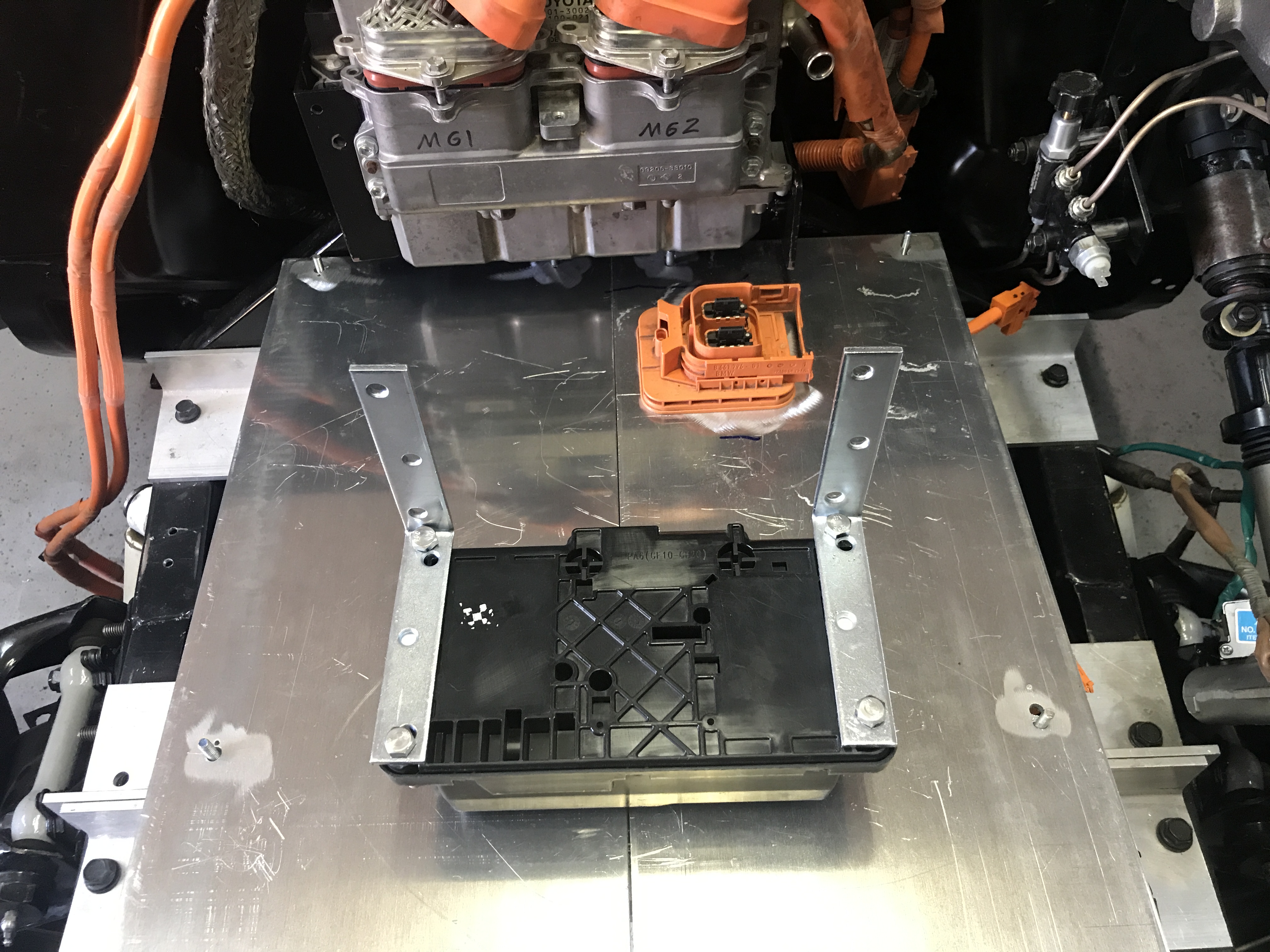

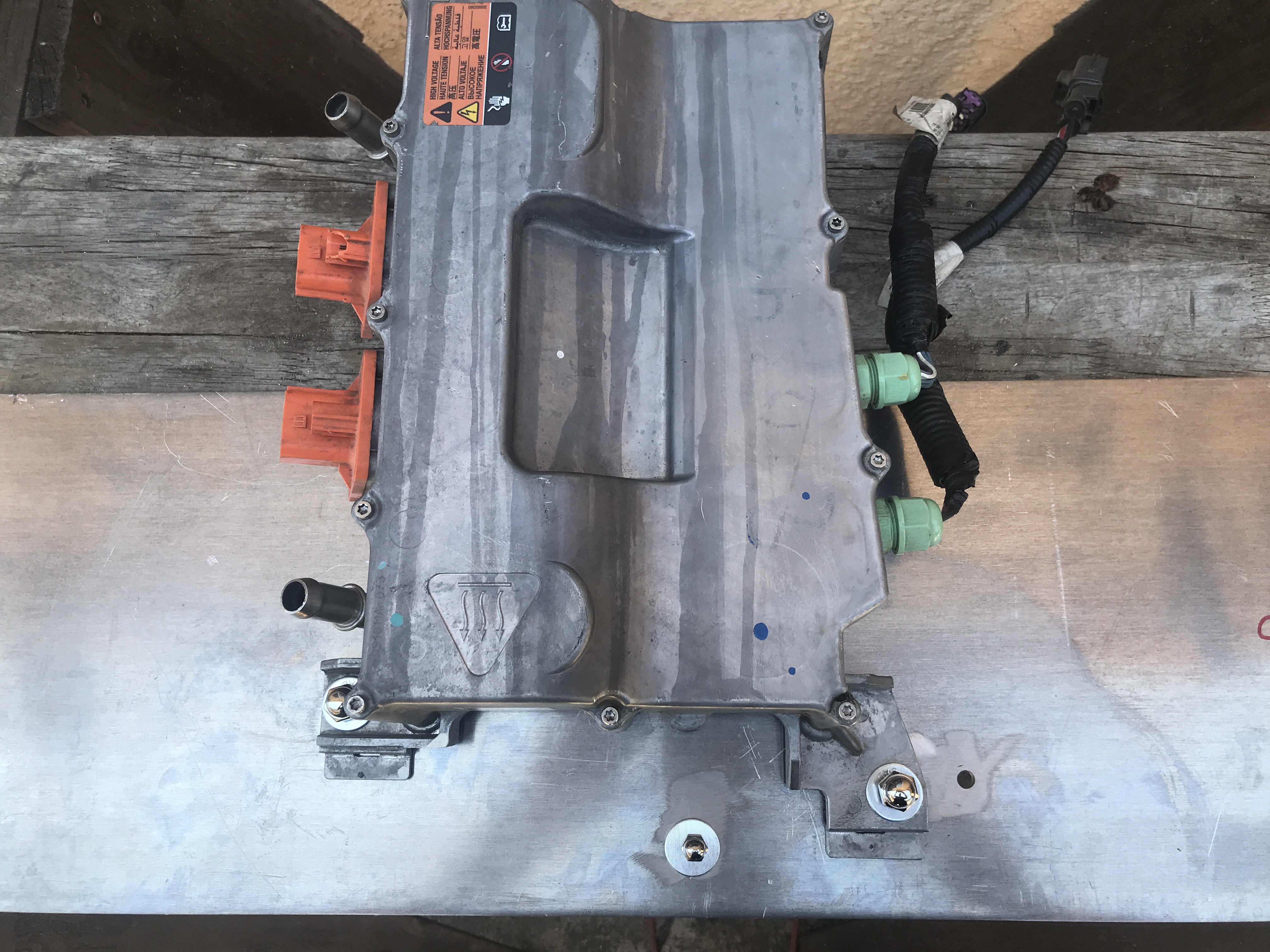

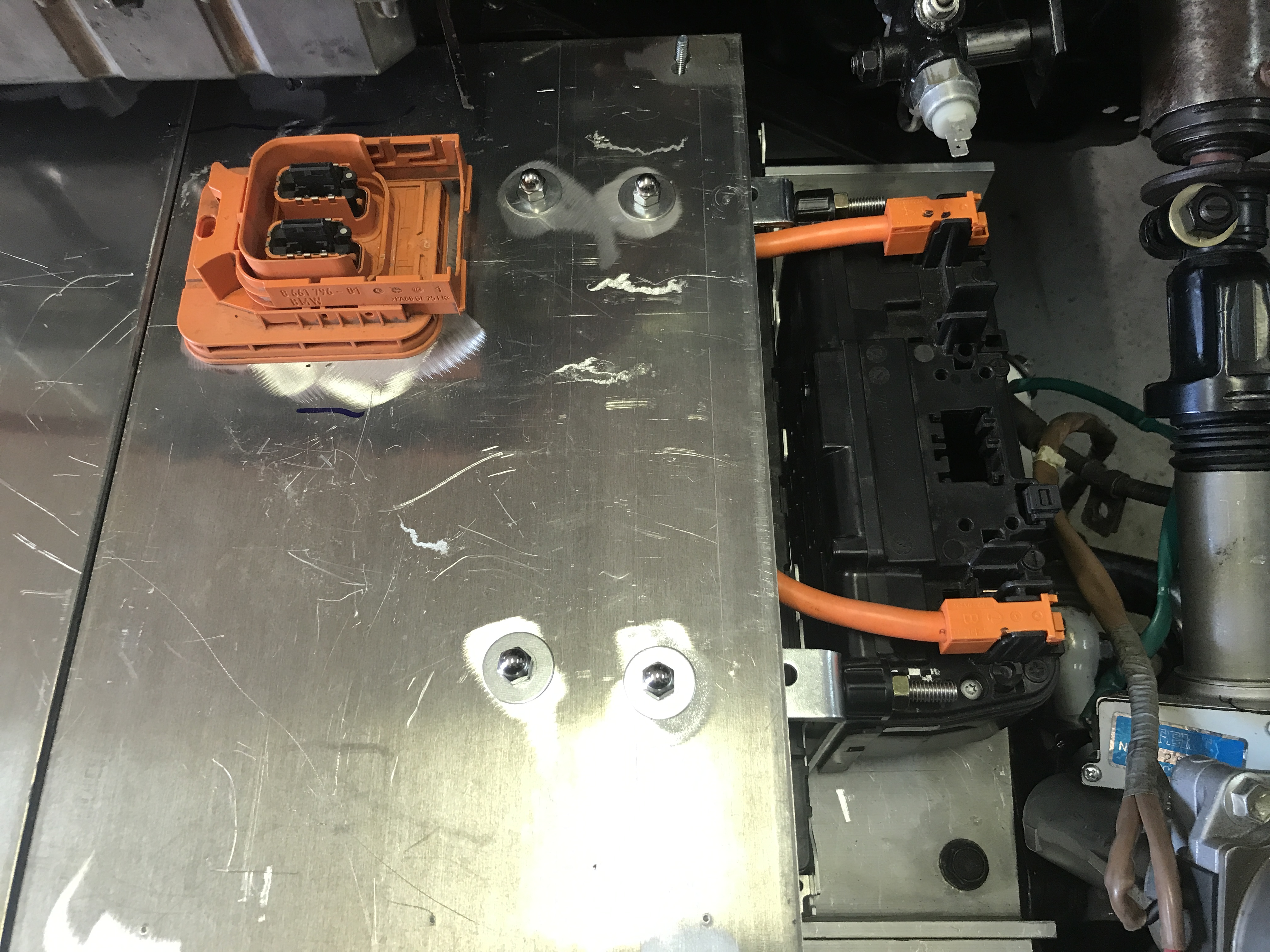

with the plumbing done and the pump pumping it was time to affix the first gen Chevy Volt onboard battery
unlike it's cousin the DC DC converter the charger's feet are flat on the aluminum plate so I couldn't wedge a nut under them to hold the bolts in the plate so I had tap the aluminum plate so that I could screw them in, last thing we need is bolts falling down on a 351 volt battery pack

Post by Gregski »
after two trips to ACE Hardware where I bought the wrong length bolts twice, I finally managed to get the 1 1/4" long ones that would not bottom out on the acorn nuts, cause that's what matters most here when building an electric vehicle and is time well spent
also that "water proof" battery tray lid now has more holes in it than fancy Swiss cheese

Post by Gregski »

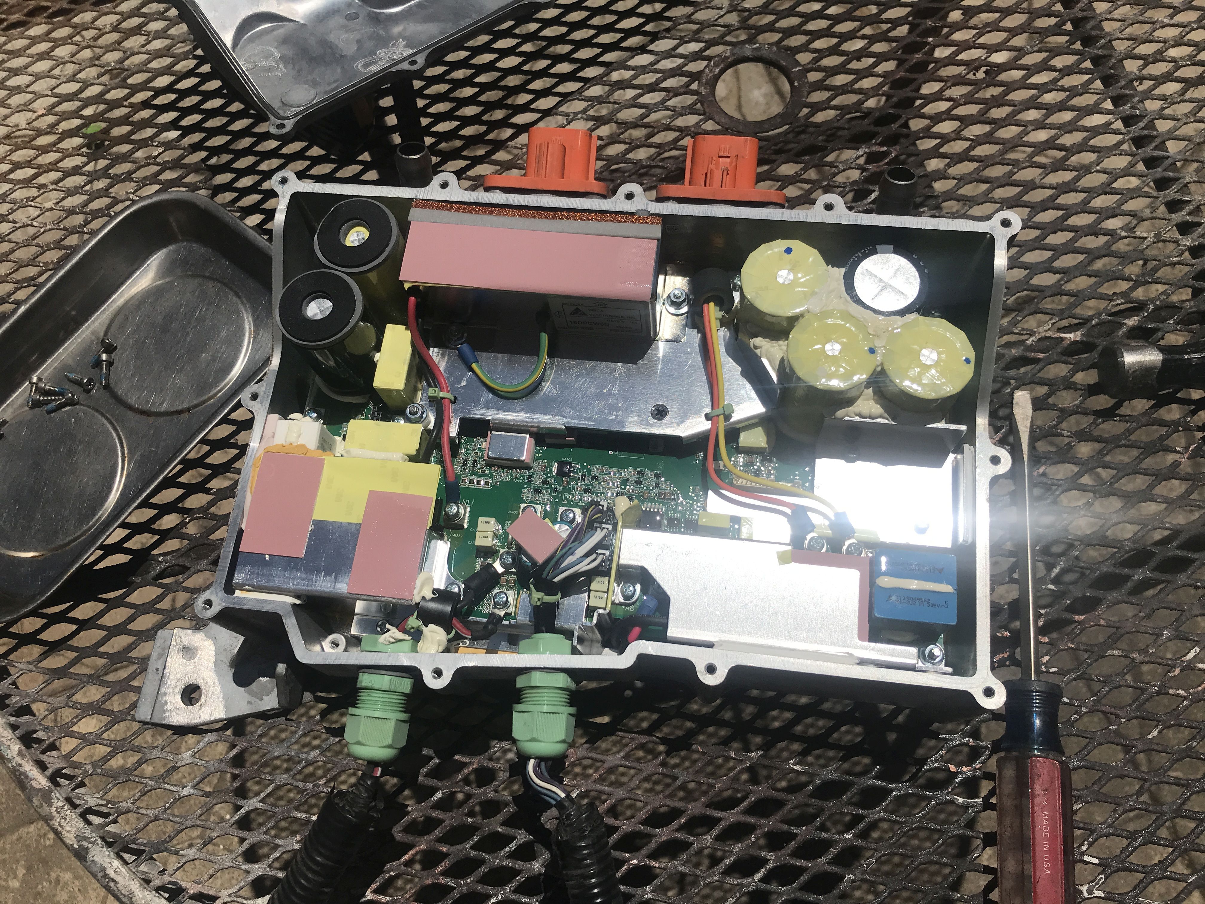

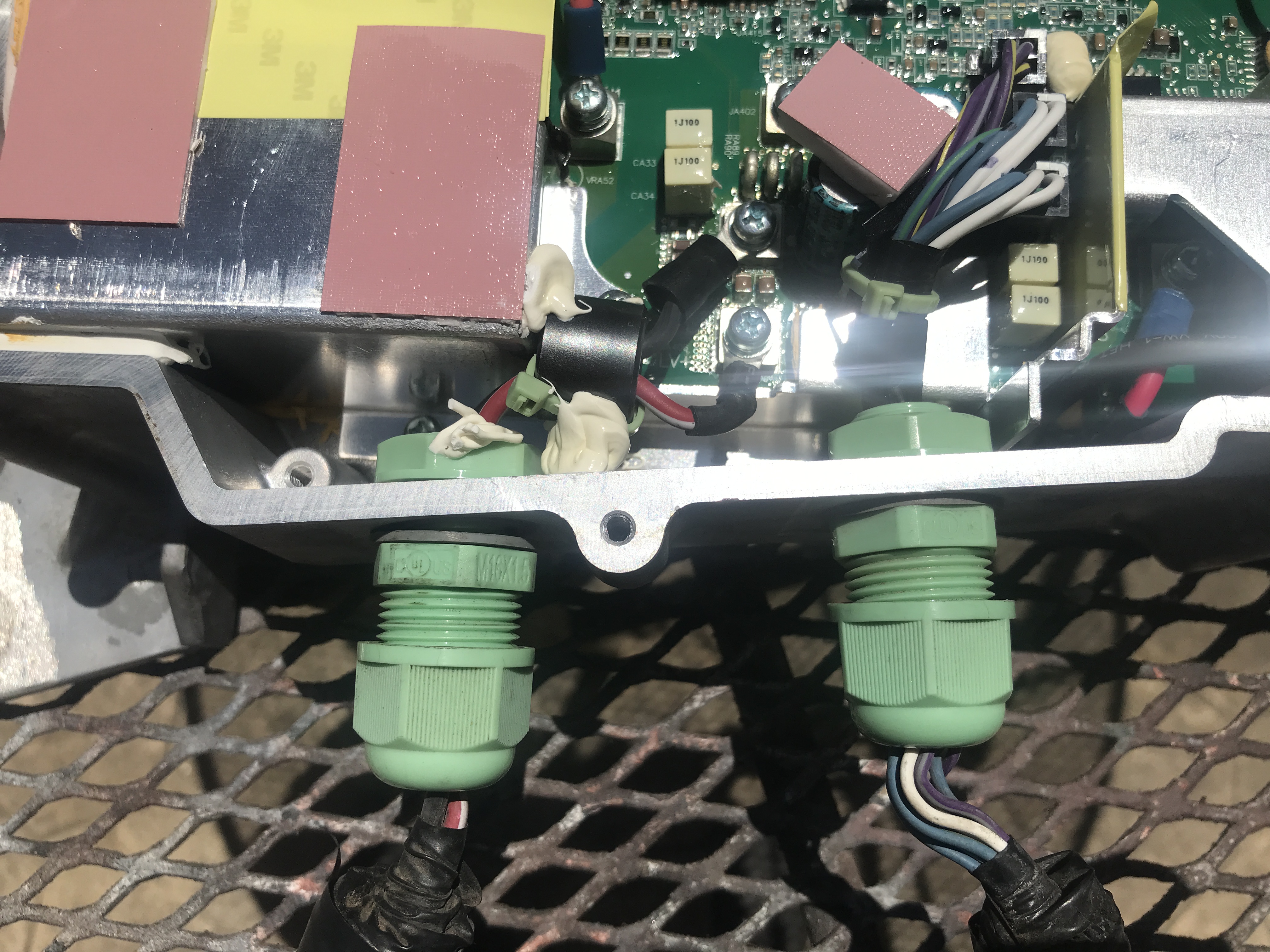

had to do a little minor repair on the first gen Chevy Volt onboard battery charger, the coupling for the regular car battery cables was loose and I needed to get inside to turn the nut on it

Gregski wrote: Mon Jun 19, 2023 1:58 pm Time to troubleshoot
Did you check how the clear hose behaves when it's warm/hot? I had variants that became very soft. From what I could find, the Everbuilt brand you have there is good for 65°C (or 150°Bananenheit).
Not much reserve I guess, especially in California, where the ambient temperature reaches 2/3 of the maximum rating already.
Gregski
Posts: 3157
Post by Gregski »
crasbe wrote: Wed Jun 21, 2023 1:25 pm Did you check how the clear hose behaves when it's warm/hot? I had variants that became very soft. From what I could find, the Everbuilt brand you have there is good for 65°C (or 150°Bananenheit).
thank you, it is not meant to be a permanent solution, I even noticed that the self gripping clamps don't contract enough to grip the 5/8ths one that connects the charger to the inverter (highest hose in the pics) so I will remove these as soon as I am ready for my first test drive, I just needed something on there to troubleshoot why the pump was not pumping

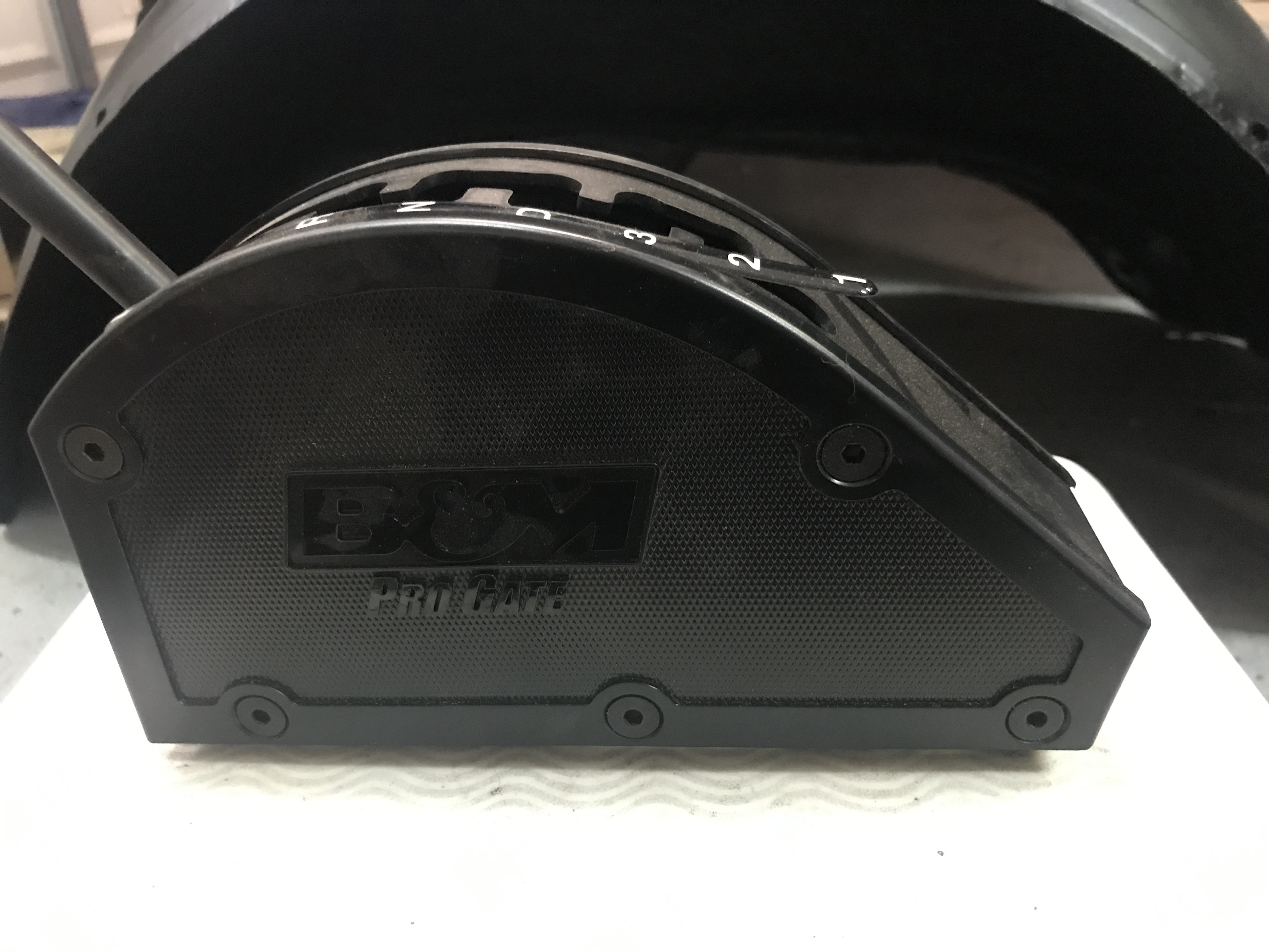

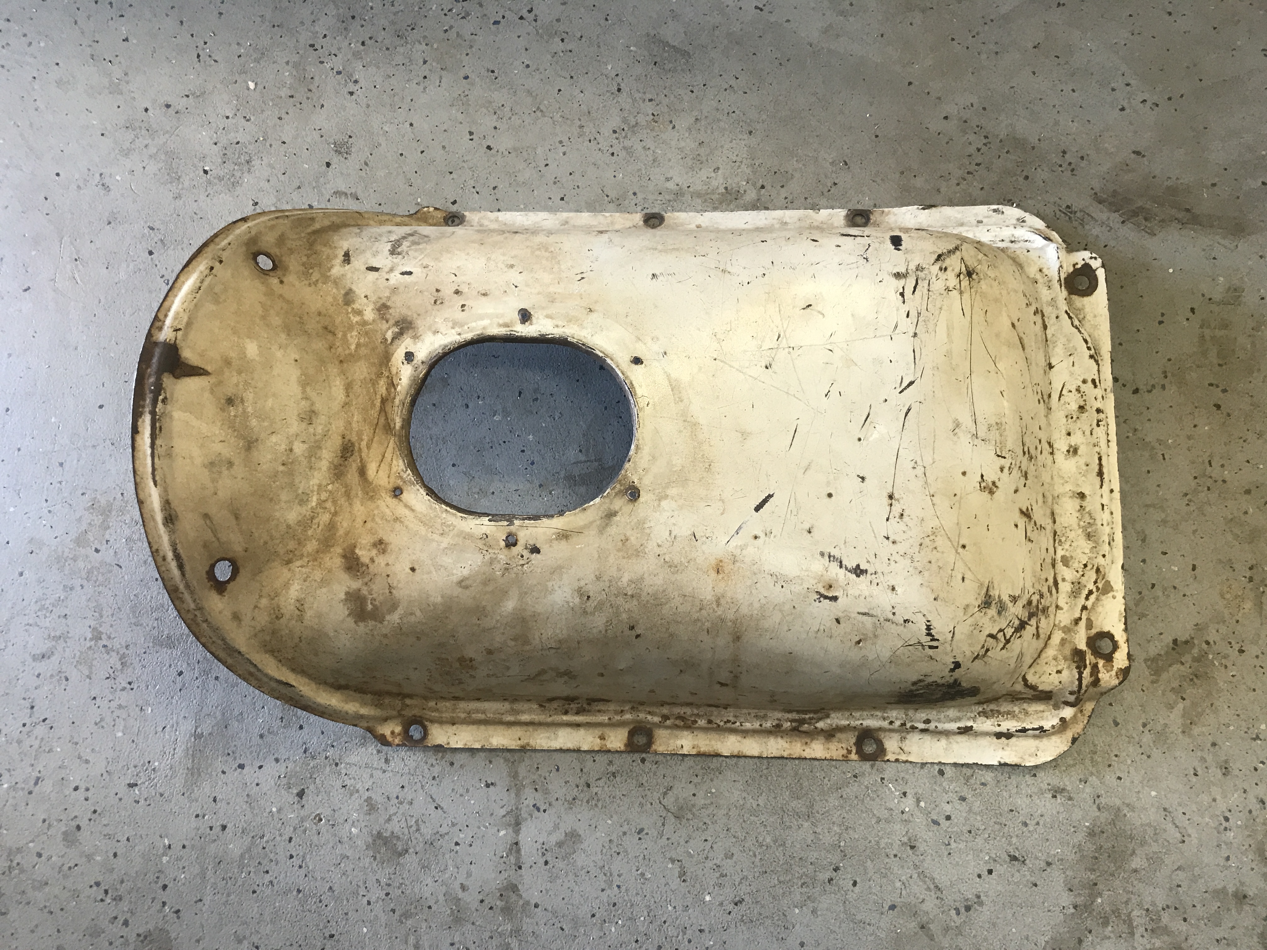

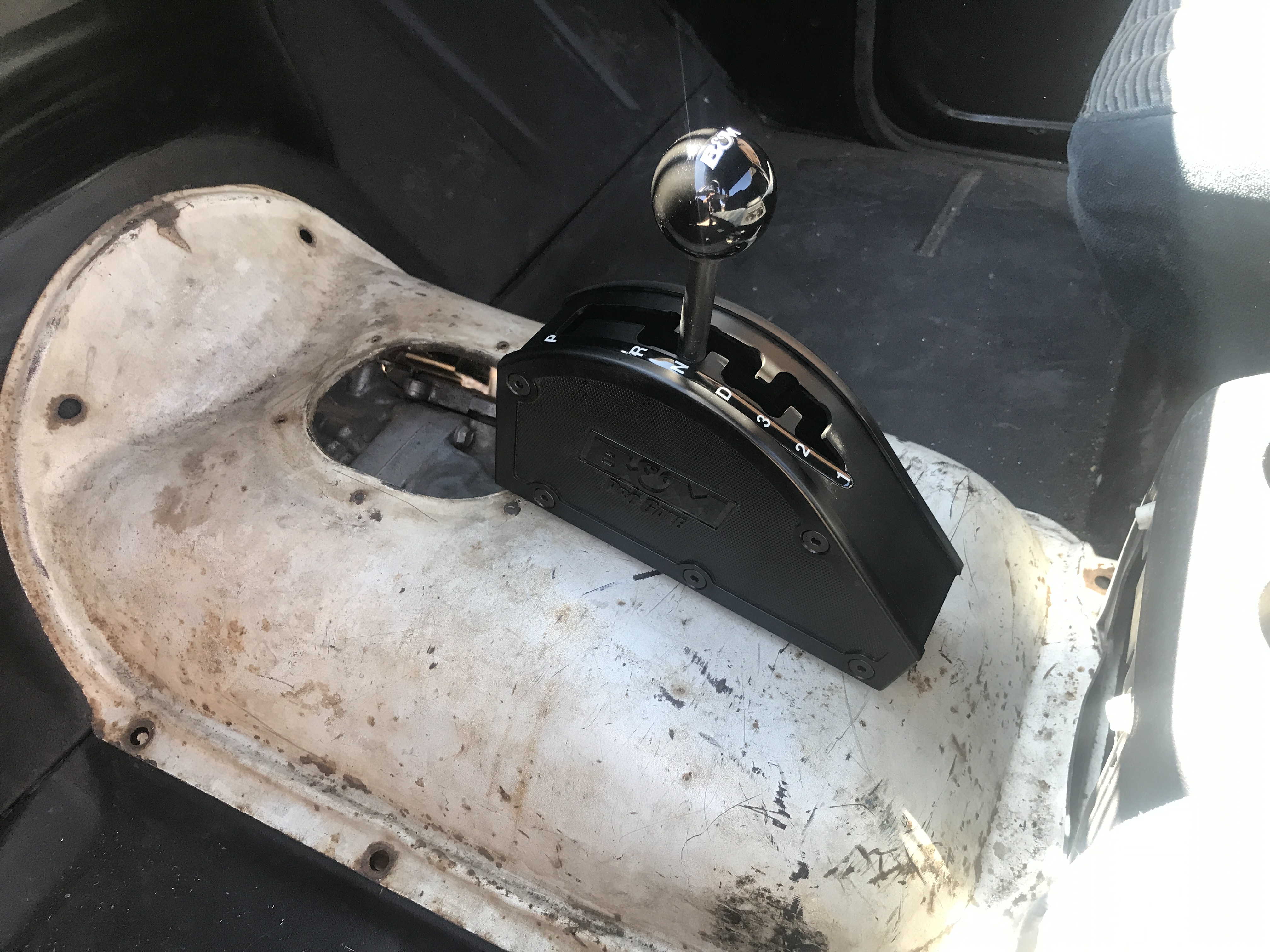

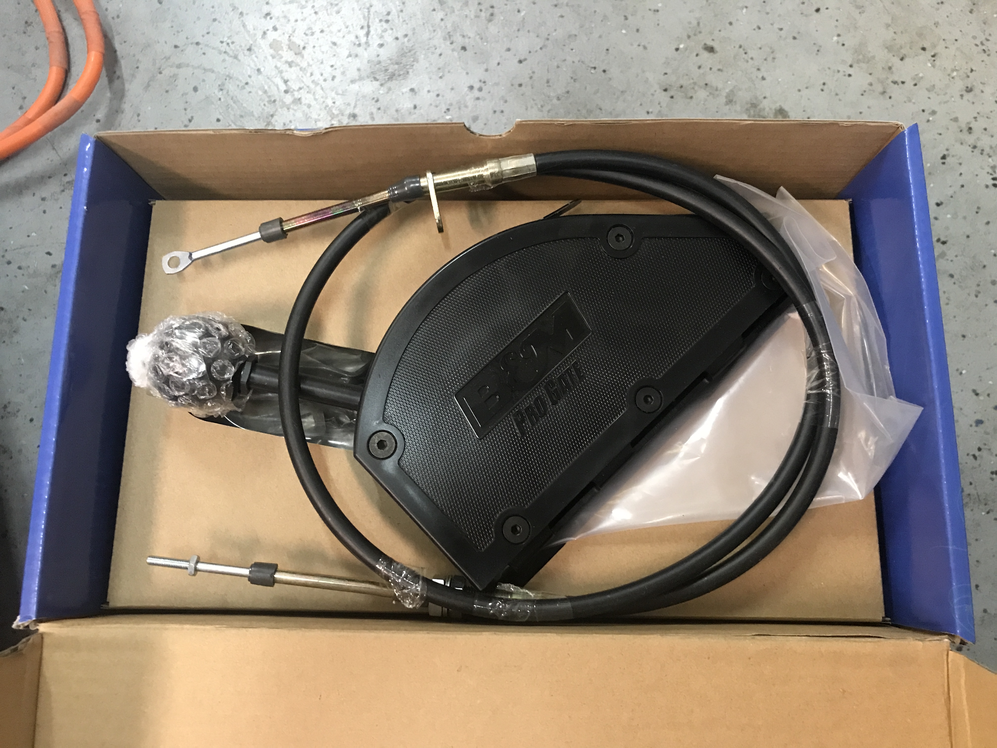

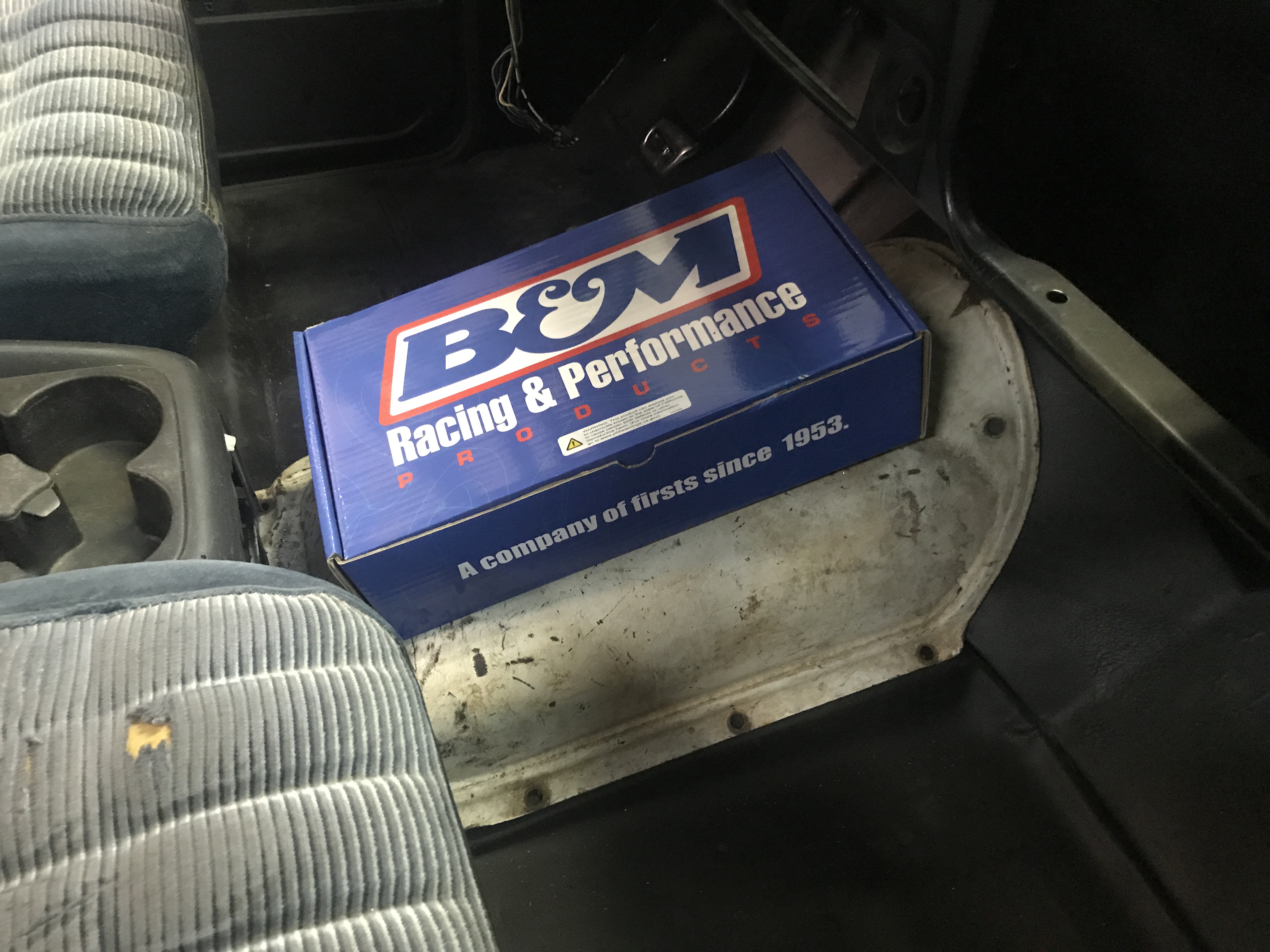

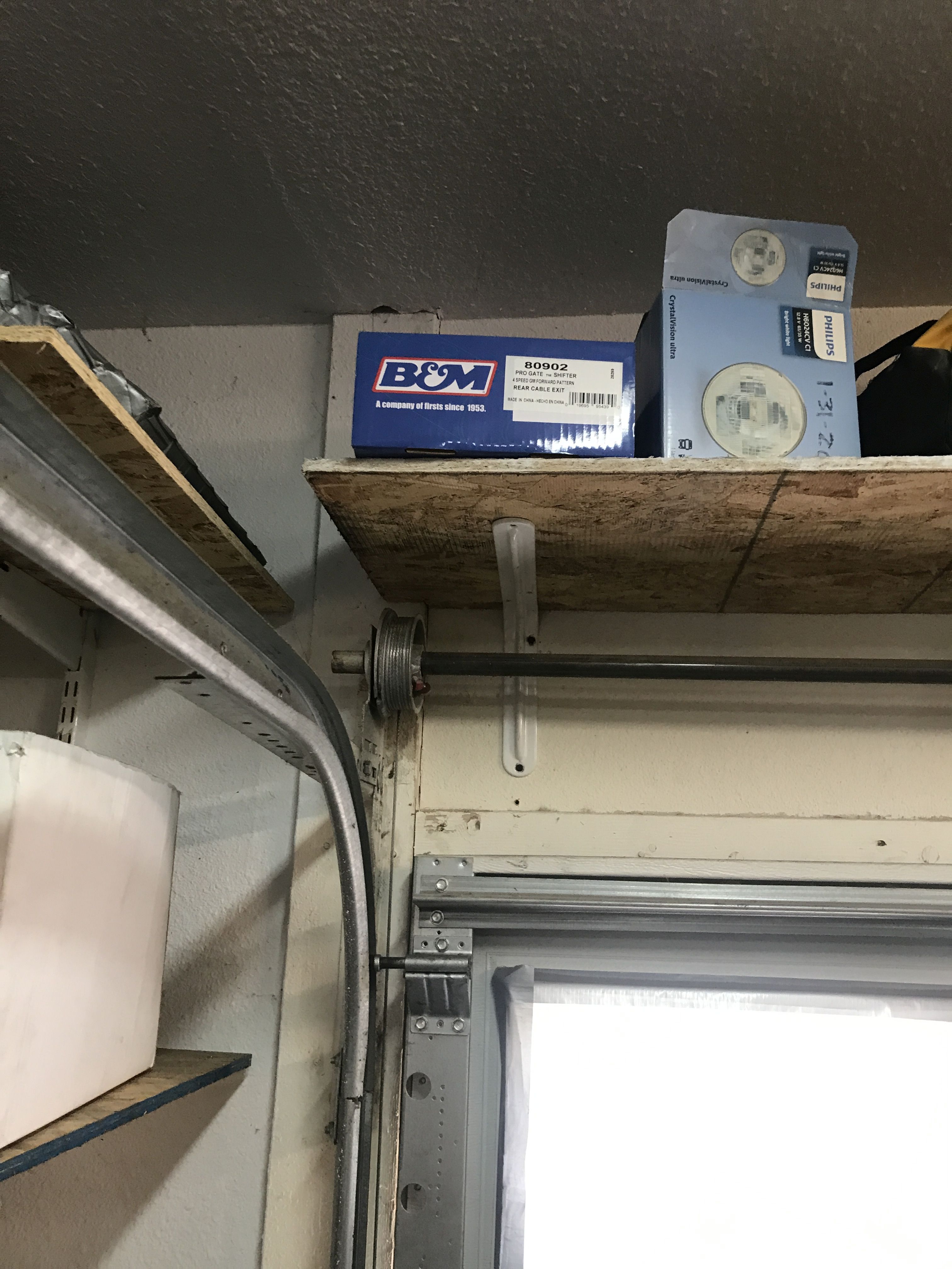

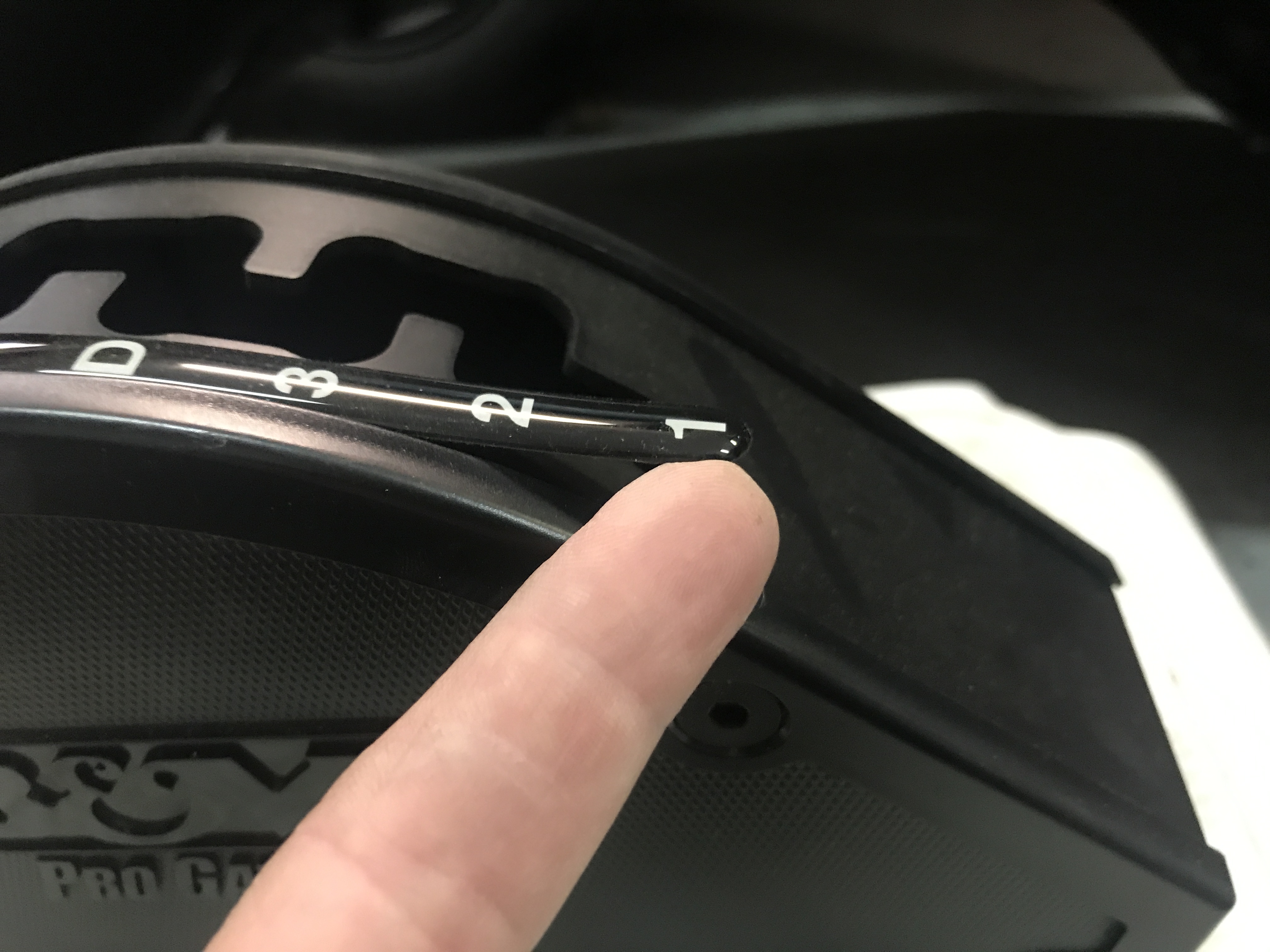

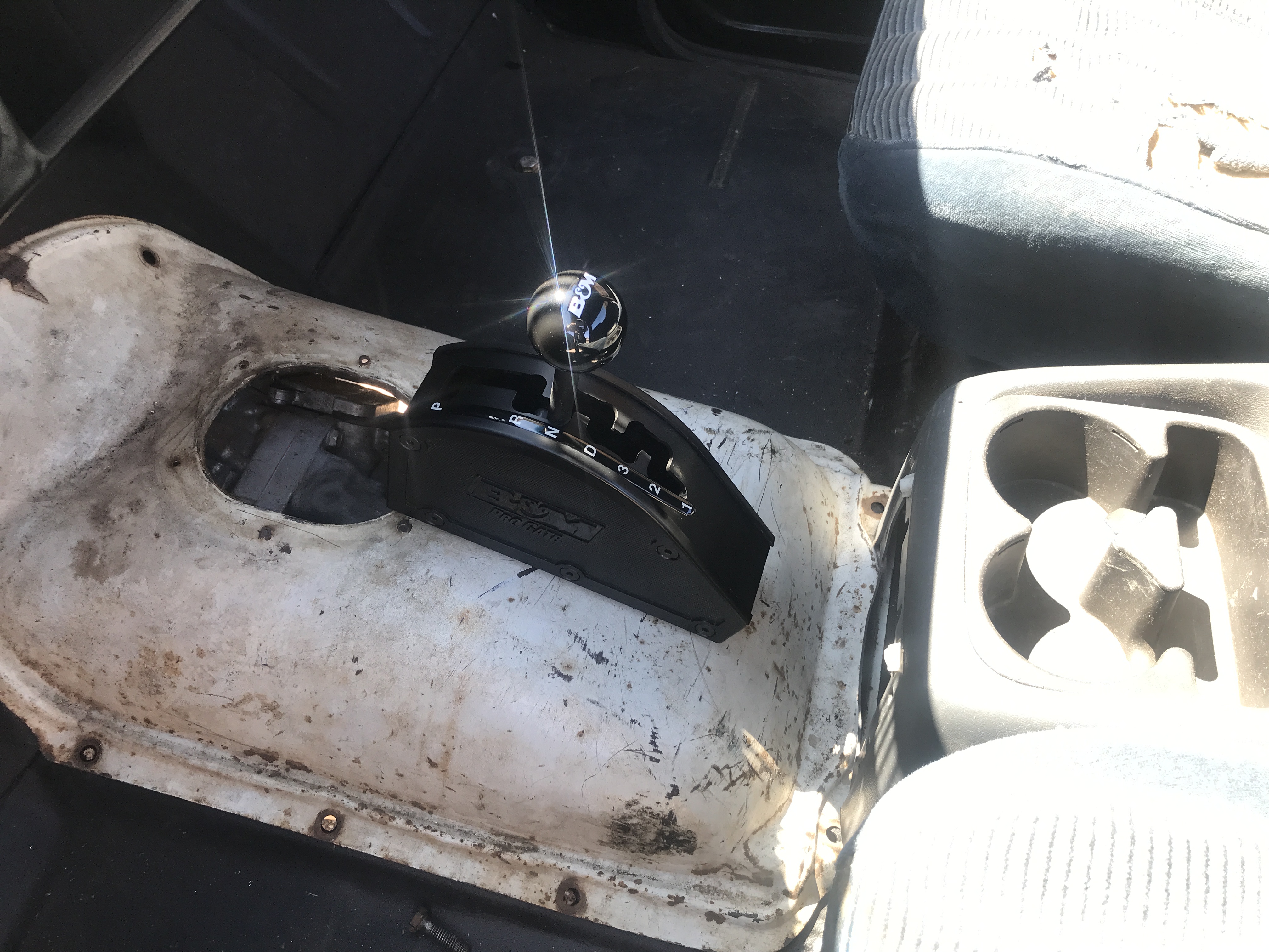

Just took that old B&M shifter off the shelf
I hope to install it all by myself
Today's aftermarket ain't got the same soul
I like that old time rock 'n' roll
Gregski
Posts: 3157
Post by Gregski »
not your father's B&M
Gregski
Posts: 3157

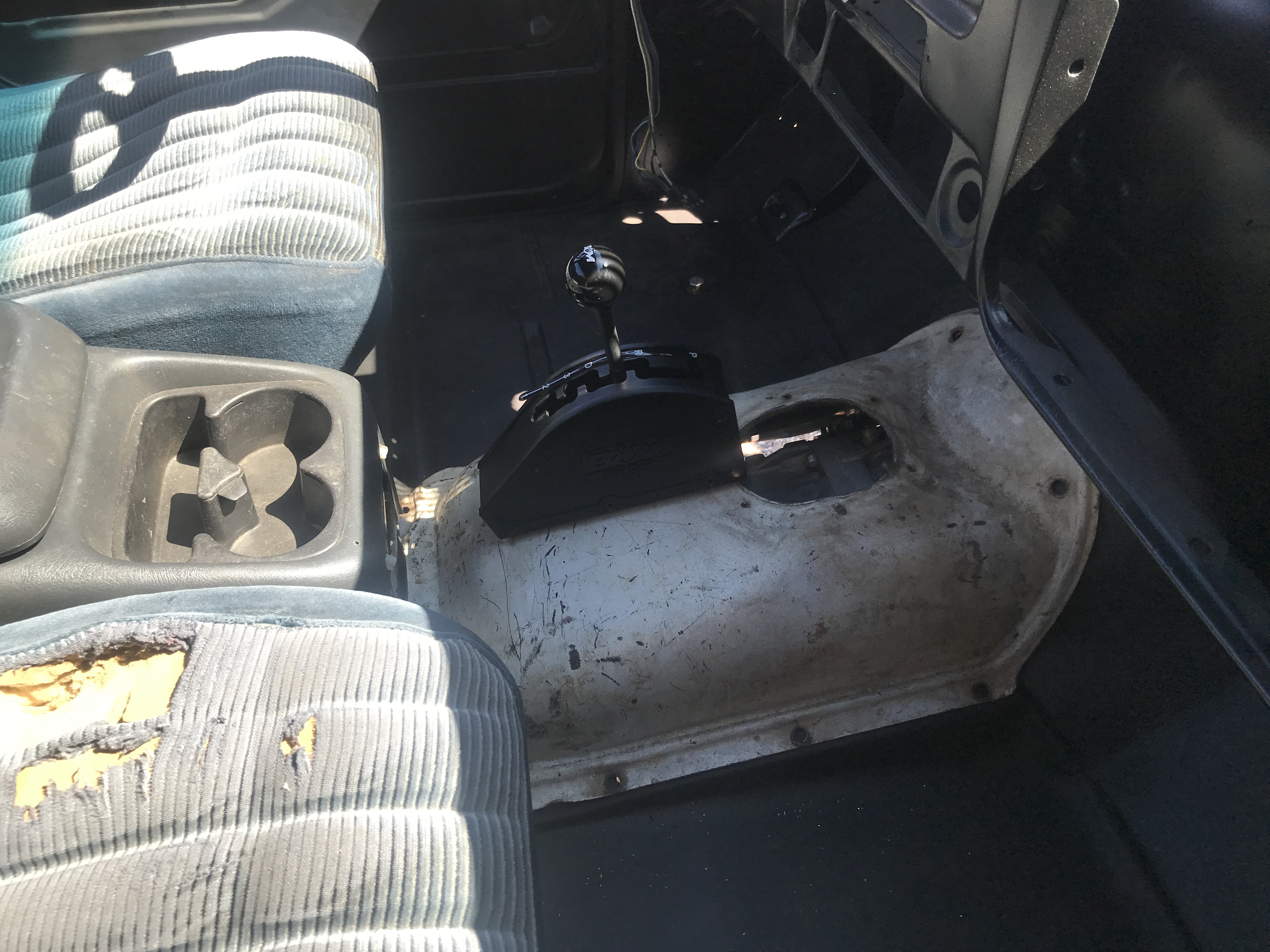

Post by Gregski »
So I'm thinkin' something like this, should be totally fine as long as I can grow my right arm another 6"
Gregski
Posts: 3157

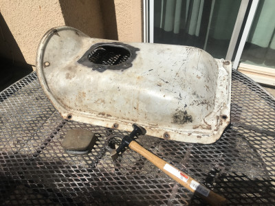

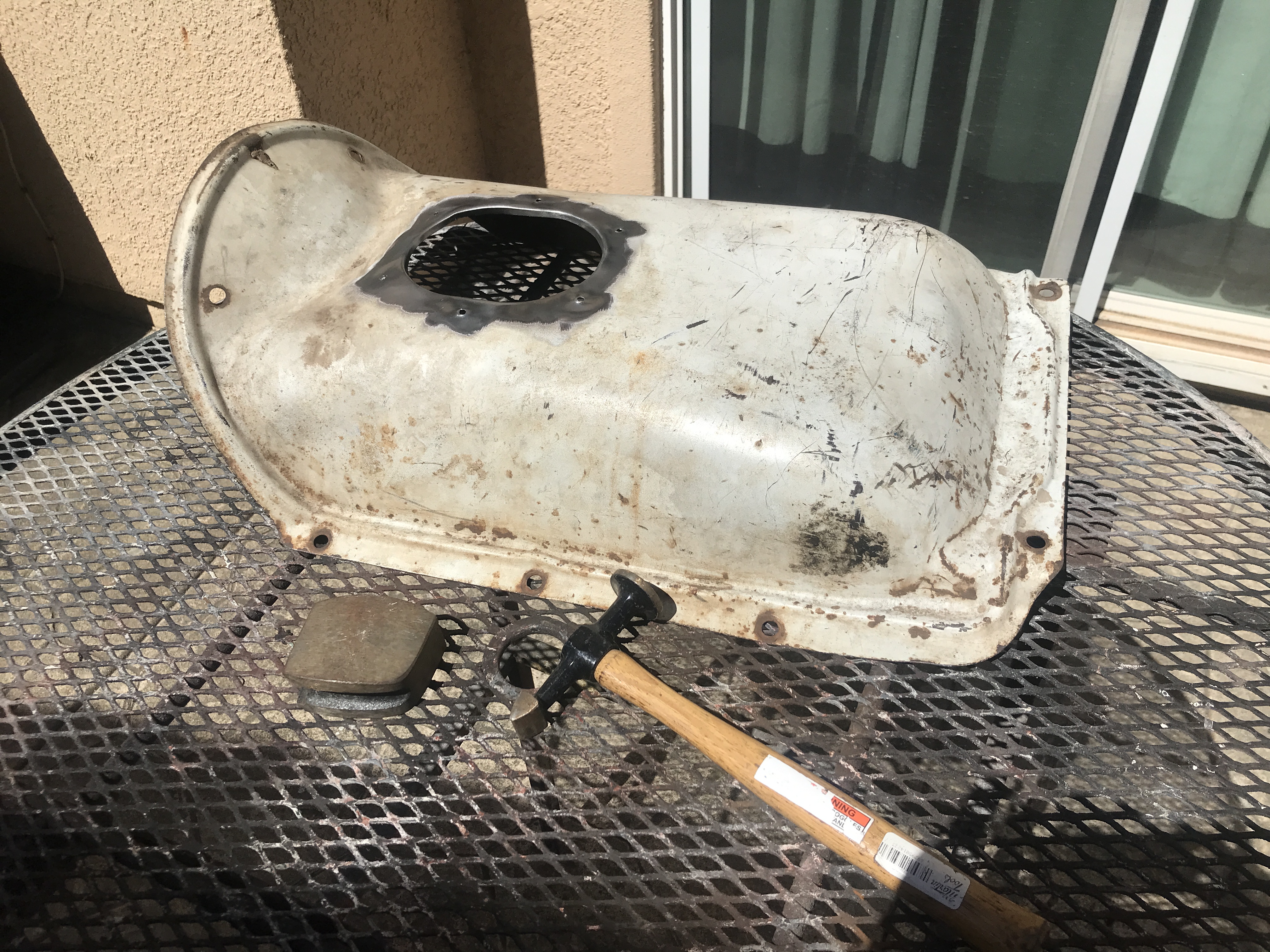

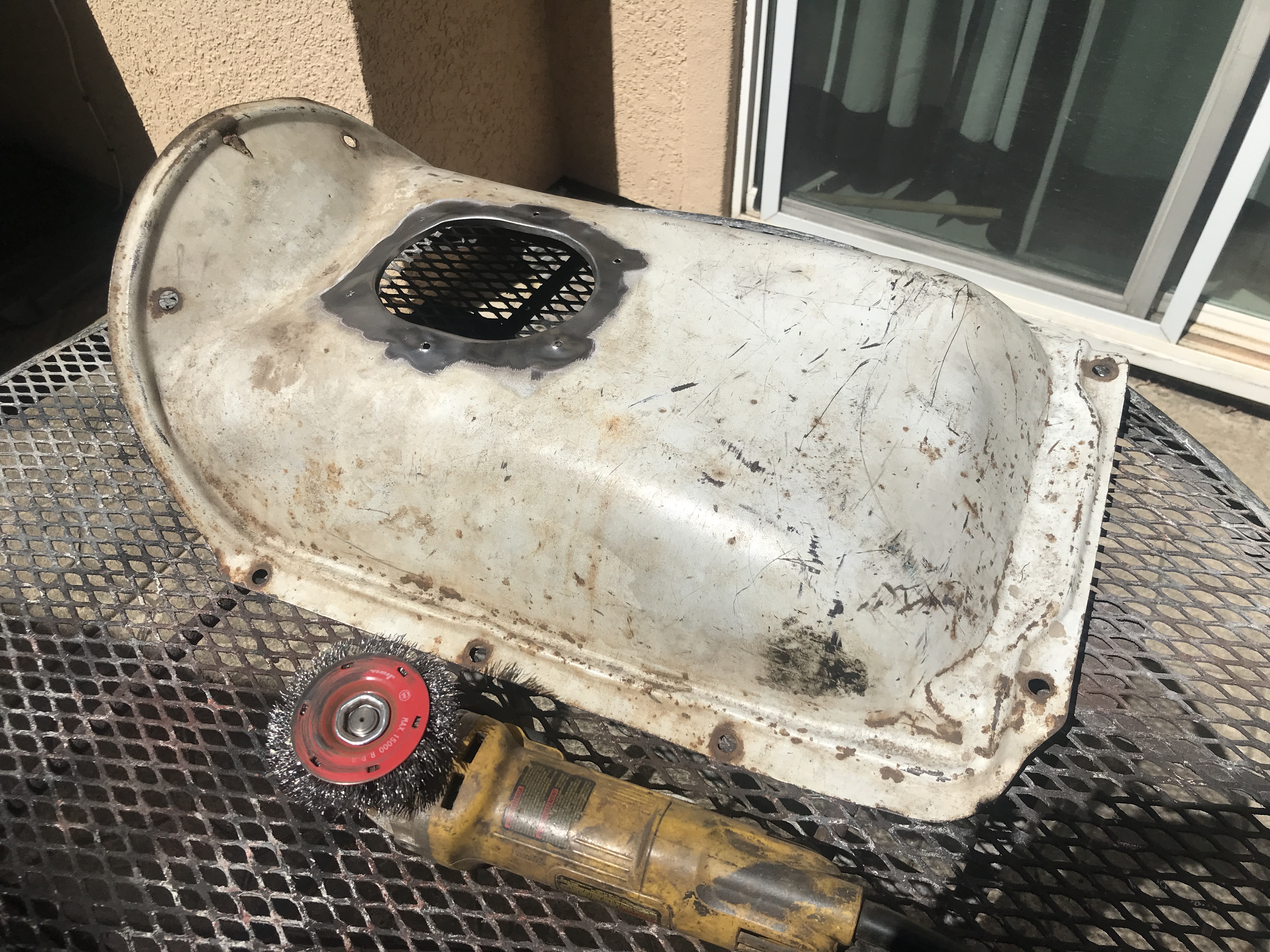

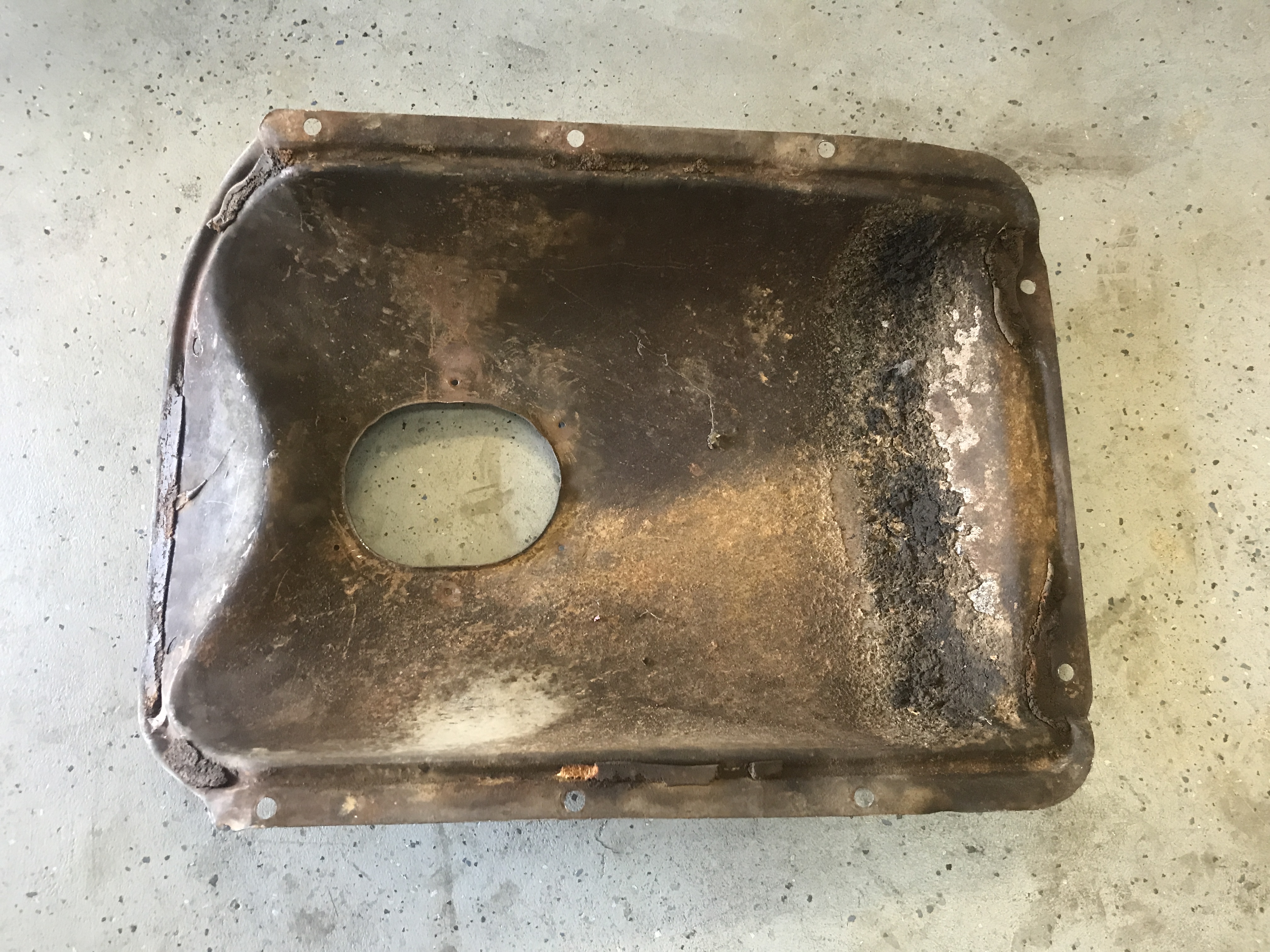

Post by Gregski »
WARNING: these next few updates of my sheet metal fab skills will make Damien Maguire's reverse engineering 3 hour long videos seem like sit on the edge of your seat riveting !
a quick shave, cause you can't weld rust or paint
and a bit of gentle persuasion
