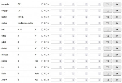

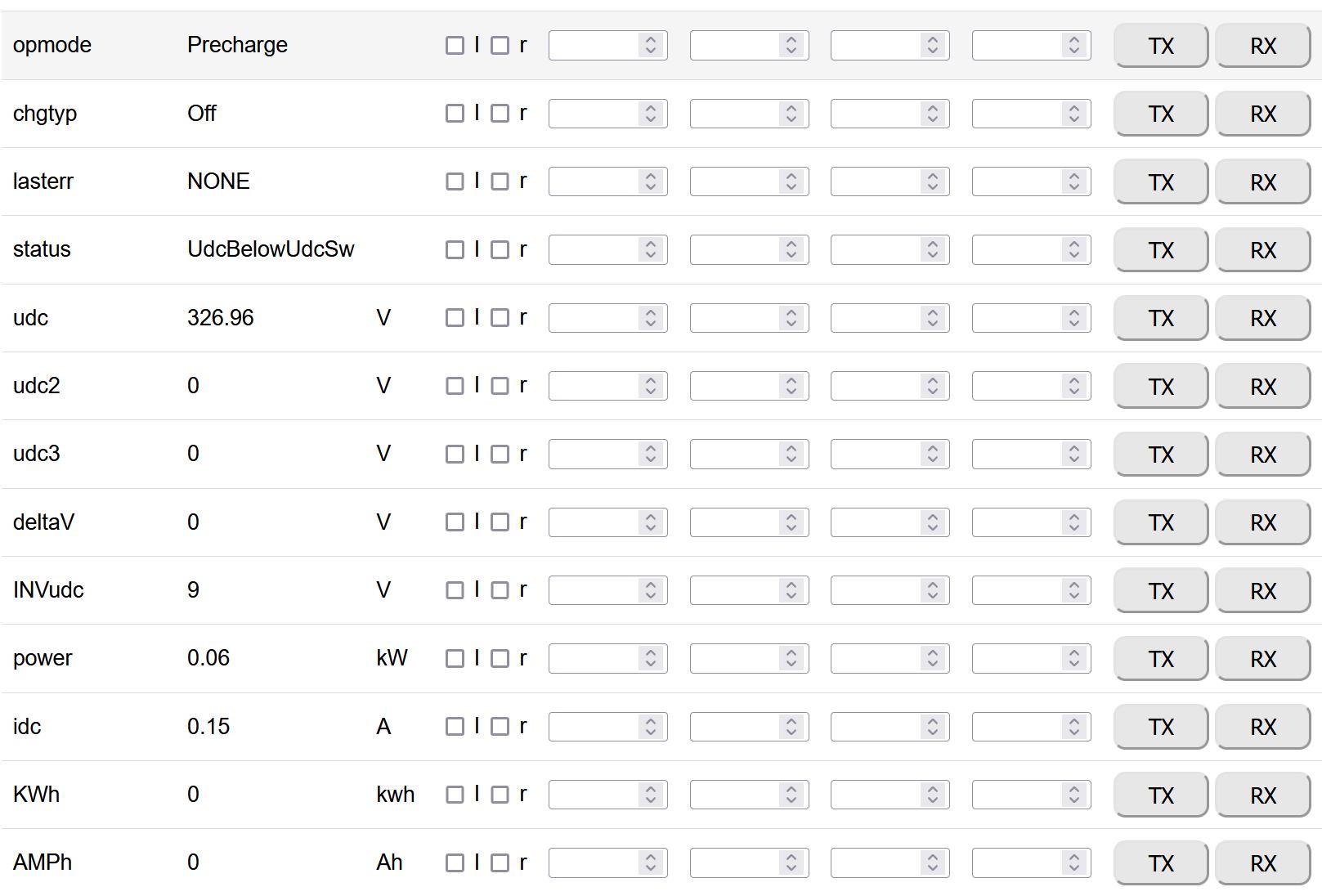

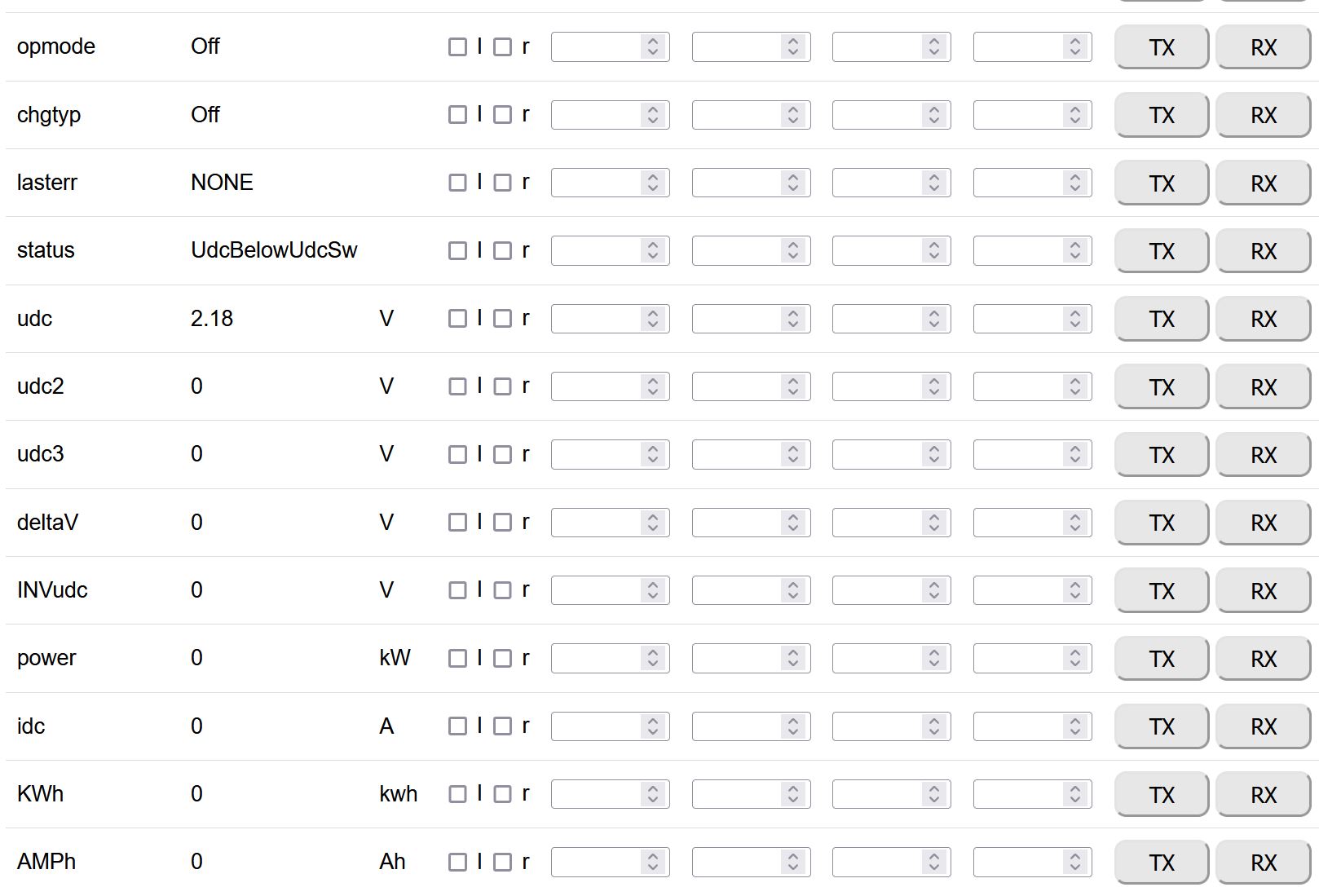

Did some more troubleshooting and testing this weekend on the Zombie and GS450H setup (after watching the new GS450H video that will be releasing soon). Spinning is still elusive but will find that issue yet!
Inverter to Zombie comms is my issue, everything else seems spot on. So I took the VCU and spent some time tracing and checking continuity from each of the four comms IC's to the header pins, checked their ground and VCC pins, orientation of the chips, continuity between the chips and the stm32. I disconnected the Tee'd in GS450H VCU and checked the twisted pair comms wiring between the VCU header and the Inverter plug. With the VCU connected to the inverter and nothing powered up, I get 61.2 ohms between each comms pair...so I'm happy the wiring is correct and in working order.
There was something bugging me about other's testing working with the E65 over CAN so I wanted to try that. Have an Arduino sketch mimicking the E65 T15 and gear CAN messages, so connected this to the Zombie and selected E65 as vehicle. As before, pre-charge and contactors work as expected. Not conclusive but in the few tests I tried, I was sure the inverter whine started when the negative and pre-charge contactors closed, but as soon as the positive contactor closed, it stopped. I tried to capture this on screenshots (shown below, before T15 and after T15 during pre-charge) but after a few attempts it didn't seem to happen any more
The only thing I can think at this stage is that one or more of the comms IC's is not functioning correctly (how would I verify that?), or is it possible there are safety shut down parameters that in my setup for some reason just shut down the inverter/comms thinking there is an issue (for example if a temp is reading a neg or too high; TMPM = -27deg)?

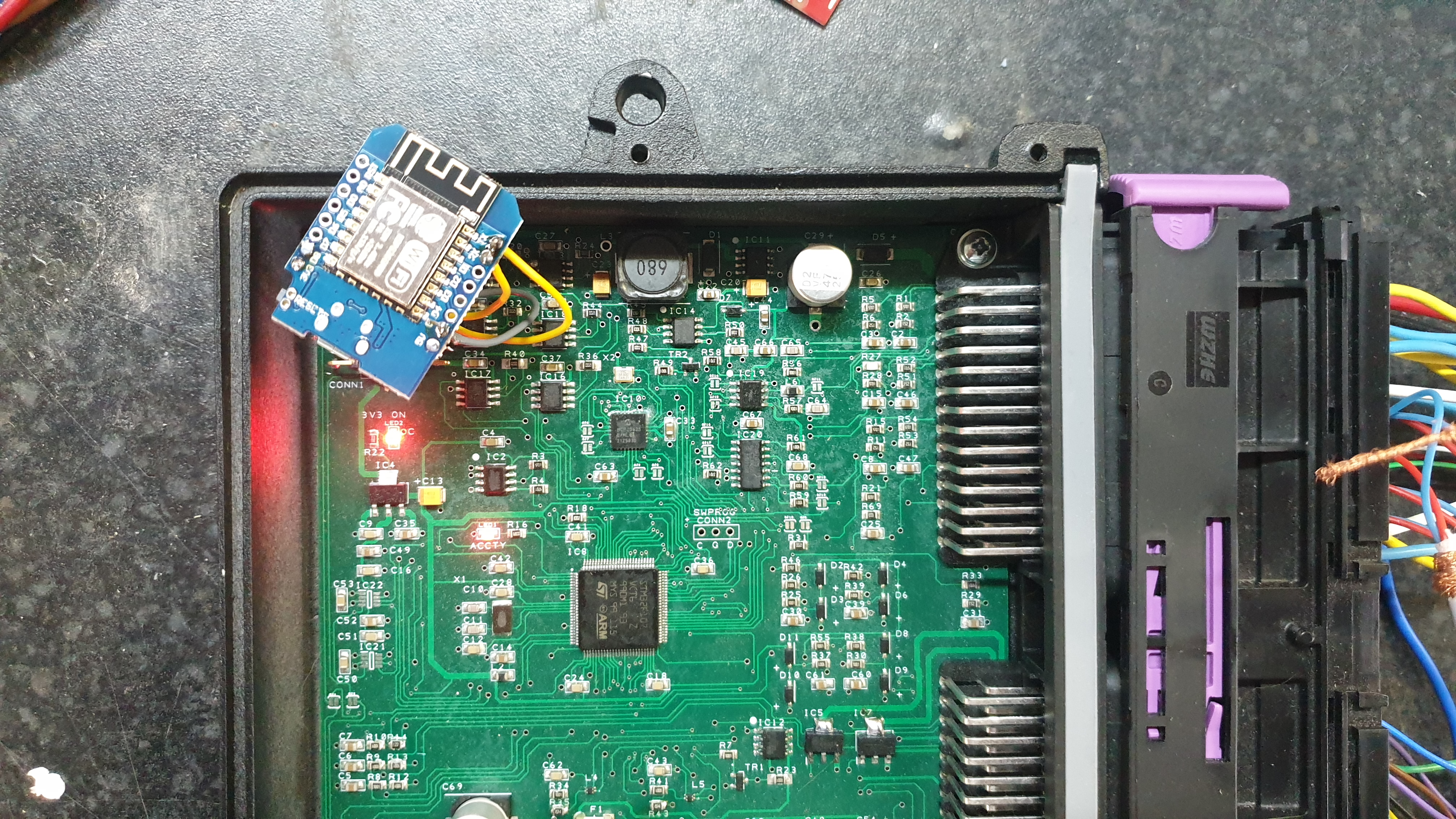

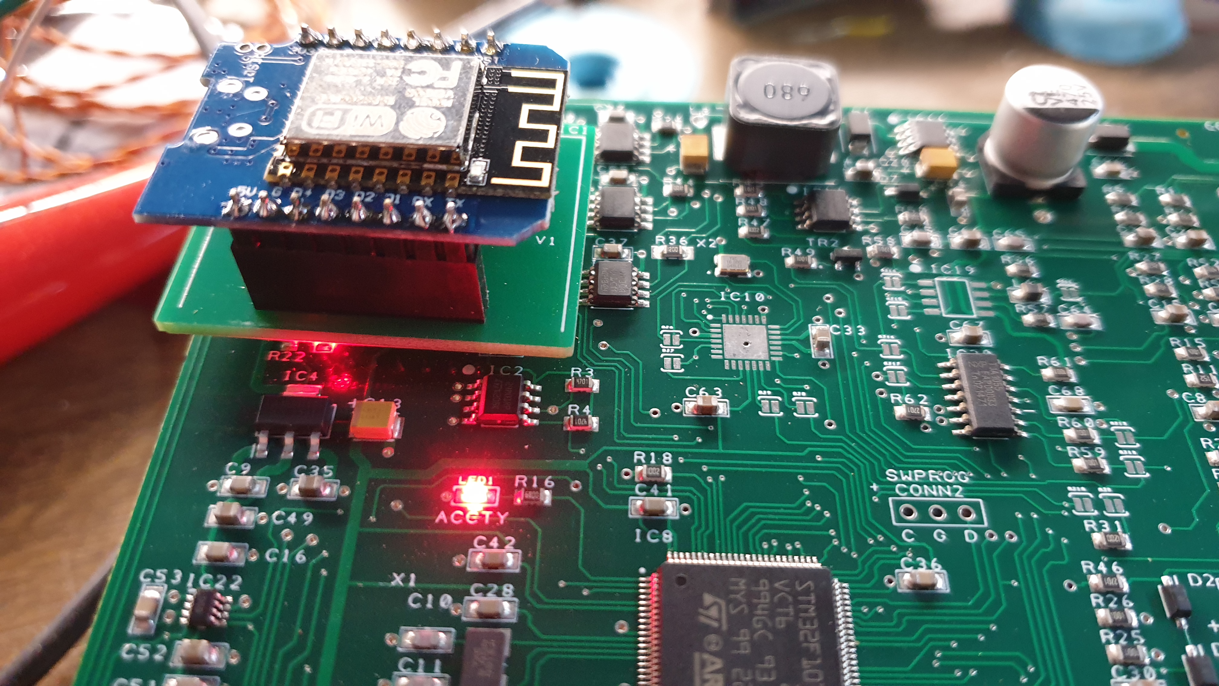

Re: ZombieVerter VCU Support
As I've mentioned in other threads the two most recent batches of Olimex ESP8266 wifi modules I have received are terrible. I'm getting over 50% failure at programming stage. Yesterday I had to program 6 modules to get two that would work and I'm observing a number of folks here on forum with issues programming over wifi and accessing the web interface. To that end I have been experimenting with a new module that seems to be much better and have designed a little adapter board to allow it to be used on existing designs without modification. Once the prototypes arrive I will do some more testing and give an update.

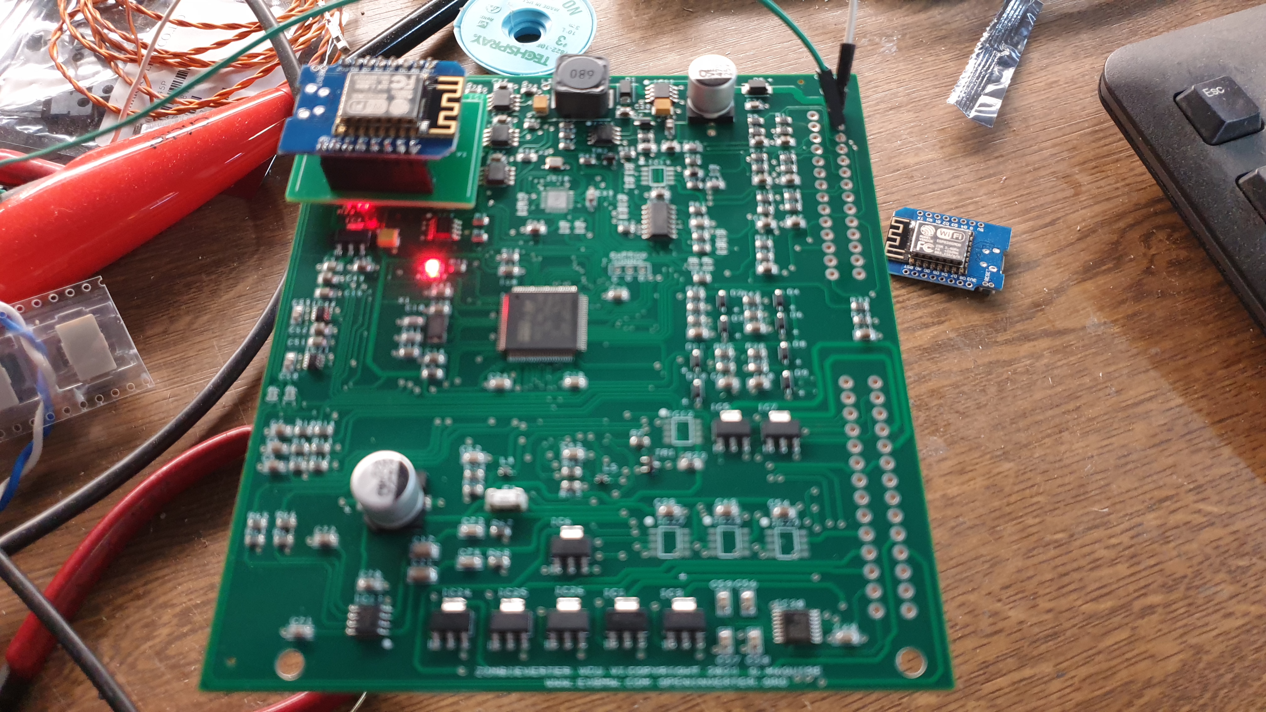

It seems I've "Bricked" my ZombieVerter !
I have a GS450h transmission and inverter (no shunt) on the bench and powered by a 20V 5A bench power supply. Using a firmware version I compiled from last March, it works fine within the power limitations with a 10k pot as throttle. - all very smooth.
I loaded the latest version (1.01) of the firmware via the onboard web front end and set the parameter settings to those that previously worked.
The first thing I noticed is the motor spindle oscillate a few degrees for a few moments when the ignition is applied, which it didn't on the earlier version. Also, I found the throttle had to be wound up much higher to get the motor spindle to move and when it did, it was a shaky rather than smooth start. At the same time, the PSU voltage was dragged down from 20V to 11V and current went to the max, but the motor didn't run smoothly.
I then went to reload the earlier working firmware version and the upload froze at 90%.
After power cycling the board, the little red led flashes but the web interface refuses to populate the form (just titles and no parameters) and the board is no longer activating relays/running the motor.
I now have a truly Zombie-ed ZombieVerter - Can anyone suggest how to bring the board back to life ?

try st link cable and just load firmware again , good chance the vci is fine just the wifi module is causing issues.
- Posts: 4000
- Been thanked: 1114 times
As I explained in the 3 video series linked on the VCU wiki page, a firmware lockup on upload does not equal a "bricked" vcu. Just power cycle the board and reupload as the bootloader is still running regardless of what firmware is in use on the device.
To reiterate, the released firmware has been bench tested AND car tested on 450h systems. I'm in the process of swapping my bench 450h system into the E39 for even MORE testing.
I just saw your photo here...Jack Bauer wrote: ↑Tue Sep 20, 2022 8:44 am As I've mentioned in other threads the two most recent batches of Olimex ESP8266 wifi modules I have received are terrible. I'm getting over 50% failure at programming stage. Yesterday I had to program 6 modules to get two that would work and I'm observing a number of folks here on forum with issues programming over wifi and accessing the web interface. To that end I have been experimenting with a new module that seems to be much better and have designed a little adapter board to allow it to be used on existing designs without modification. Once the prototypes arrive I will do some more testing and give an update.
I would suggest you to simply wrap insulating tape around the ESP and slot it within your casing. That may prevent any unwanted contact with some power pins.

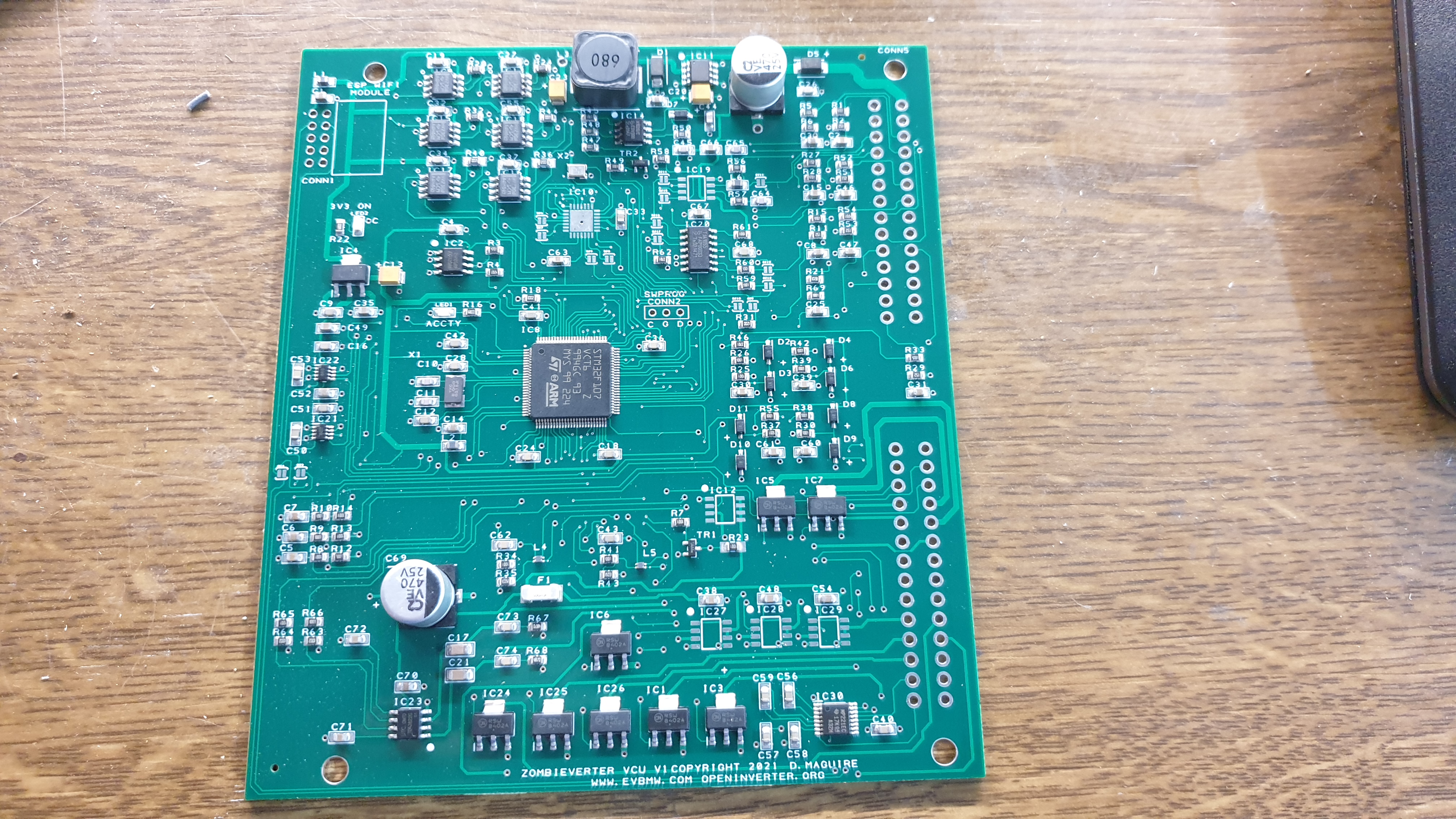

Received today the first batch of VCU board with STM32 and most other parts fitted. Been a long time:) Also Wemos wifi adapter boards received and tested working. Once current batch of Olimex modules are exhausted (and with 50% going in the bin it wont take long!) all kits will ship with Wemos modules and adapter board. We'll give it a few months to bed in then I'll do a design rev to mount the wemos on the pcb directly.

But, when the "engine start" is pressed, all relays/contactors are enabled at once.... that seems a little wrong !
Can someone enlighten me to the expected behaviour?
If all three contactors come on when you apply start, ensure your udcsw isn't set too low in relation to your HV. See the wiki for info on setting these.
