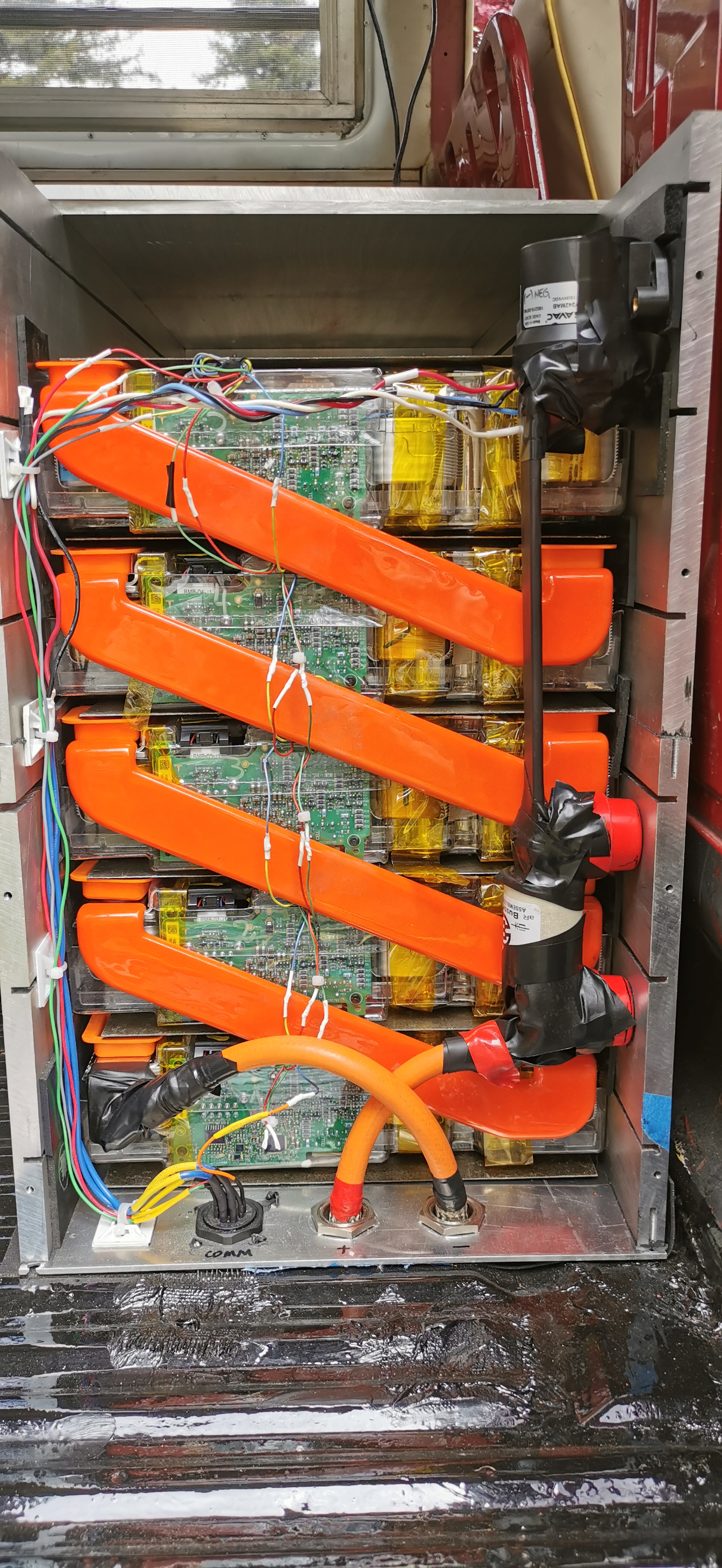

Code unmodified.
It's hard to catch the first message with the board powered externally.
Edit. Just barely touched the throttle - motor barely moved - BMS went into error.

So clearly EMI from the HV. Your wiring twisted as per OEM tesla? are the runs as short as possible? Are the runs not parallel with HV cables/busbars?

tom91 wrote: Fri May 24, 2024 9:08 am So clearly EMI from the HV. Your wiring twisted as per OEM tesla? are the runs as short as possible? Are the runs not parallel with HV cables/busbars?
Hmm. Sometimes BMS turns on with the following in the log (HV disconnected) and stays like that unless I restart via R command - doesn't work with the power cycle.

Here's my wiring setup. I know it ain't pretty, but HV and LV are mostly perpendicular or away from each other. HV connection between two boxes are shielded to the boxes, while LV is twisted pair cable.

This is probably unrelated, but as I was troubleshooting I also noticed that BMS is showing some odd spikes of current here and there when reading from ISA shunt (also inside of the same battery box and is actually closer to the HV components). SavvyCAN doesn't see these and neither does my Teensy VCU. The spikes are visible on the CAN that BMS sends out via 0x356 as seen below, as well as, when I monitor via Serial interface. Everything else that BMS sends out - temp, SOC, Status, voltage etc. - is steady.
The only difference in my VCU code from the BMS is that I don't use LPF for filtering ISA values.
readingISAamps = (long)((incoming.buf[2] << 24) | (incoming.buf[3] << 16) | (incoming.buf[4] << 8) | (incoming.buf[5]));
Also my VCU is outside of the battery box. Maybe BMS needs to be moved out of the battery box!?
(no load, everything is idle, yet a spike..)

This is my BMS board.
