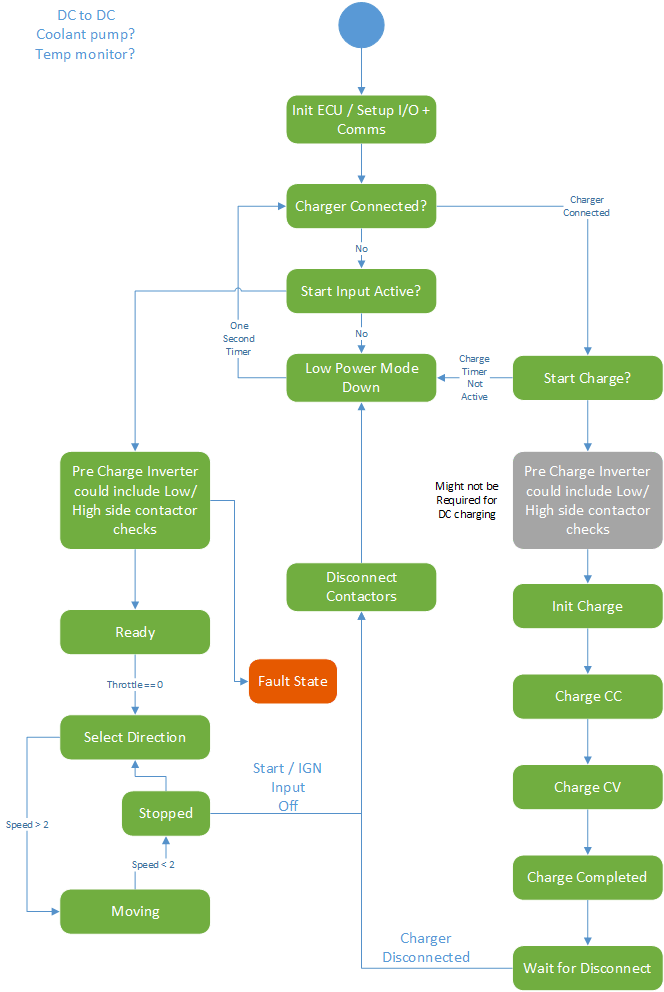

I think a state machine would fix that problem, that's what I was attempting to design with the diagram above. It would also be much easier to debug too.

Implementing the main state machine is actually straightforward, the hard part is the logic. Also some of the state transitions could be as a result of hardwired inputs or other transitions could be CAN messages etc...
I've updated the logic, if people could let me know what they think. I've possibly forgotten a few things. Things like the regen code would be implemented in the "moving" state. The "moving" state could also be used to control the electric power steering, or maybe "ready" would be a better state for that with some sort of time out.

What is the difference between "Stopped" and "Select Direction" states? May be combine them into one?
What about "Start DC-DC 12V" state with delay?

I guess the thinking is that you can be stopped, but actually be in forward or reverse gear. A better name for the "select direction" state might be "neutral"?
Also, there is a mistake on that diagram as you can go from stopped back to moving, without selecting the direction again.

I understood a bit. But I try to follow all scenarious and there is no exit to "Disconnect contactors" from "Neutral" (without moving)
In some cases, like GS450h, with machanical parking lock I quess it's more logical to make "Parking" state instead of "Neutral" with moving denied.

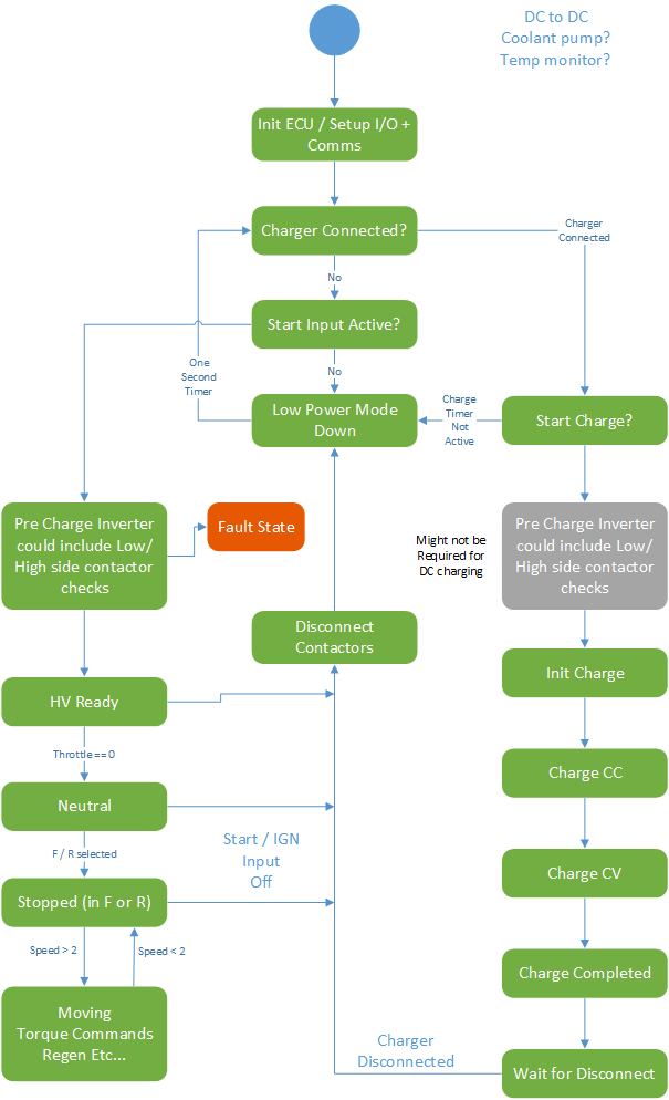

Thanks for the feedback above, here is an updated version of the diagram.

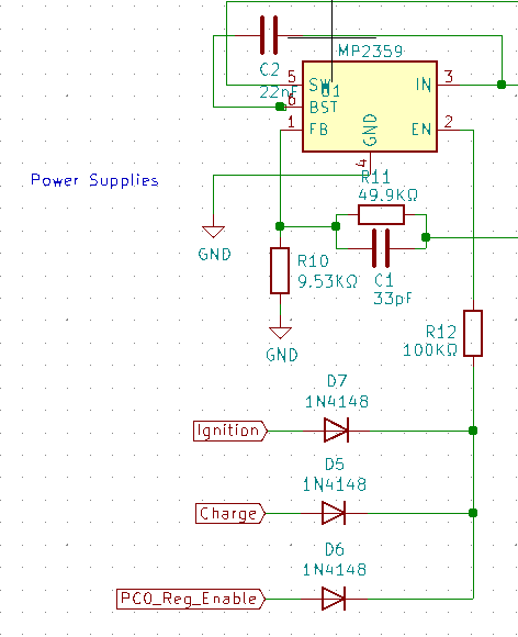

The one thing i need to confirm is are we going to put the CPU into a low power state, or is the quiescent of the power supply large that the CPU current doesn't make a difference.
Normally the system receives an ignition signal, obviously with the charging now integrated it wouldn't be a traditional ignition signal. I was considering if an external 12V charge timer could be used, this could be wired in to wake the ECU when charging is required, I've a few ideas around how this could work (might require a relay).

For the BMS we used two external input for firing up the 5V regulator.
The MCU can then choose to keep the regulator on as long as it pleases.
Power down mode was not very effective because the draw from all other chips and the regulator by far exceeded MCU consumption.

Jack Bauer wrote: Thu Jun 03, 2021 2:58 pm Well I don't see the need for a sleep state personally. I just switch off the 12v if I'm away from the car for more than a few days.
It doesn't necessary need to be a sleep state as such, but it is a state where all of the ECU outputs are off and the system is checking for ignition active or charger active. For the Outlander charger we would probably be checking an ADC for the charger handle connected. So the low power state, would actually include the two checks above it. For some vehicles we could be monitoring CAN traffic looking for KL15 signal and then deciding to "wake up proper". In the "low power" state we could have the DC:DC converter off for example.

johu wrote: Thu Jun 03, 2021 5:57 pm For the BMS we used two external input for firing up the 5V regulator.
I've used this solution in commercial ECUs and it can work quite well as the software can decide when to drop out the 5V Regulator.

Dilbert wrote: Thu Jun 03, 2021 10:34 am Thanks for the feedback above, here is an updated version of the diagram.
The most simple form of what we need is a SWITCH CASE
and in EACH case we call the methods applicable to that state.
More is not needed i think.
We should use ENUMS for the switch comparison.
