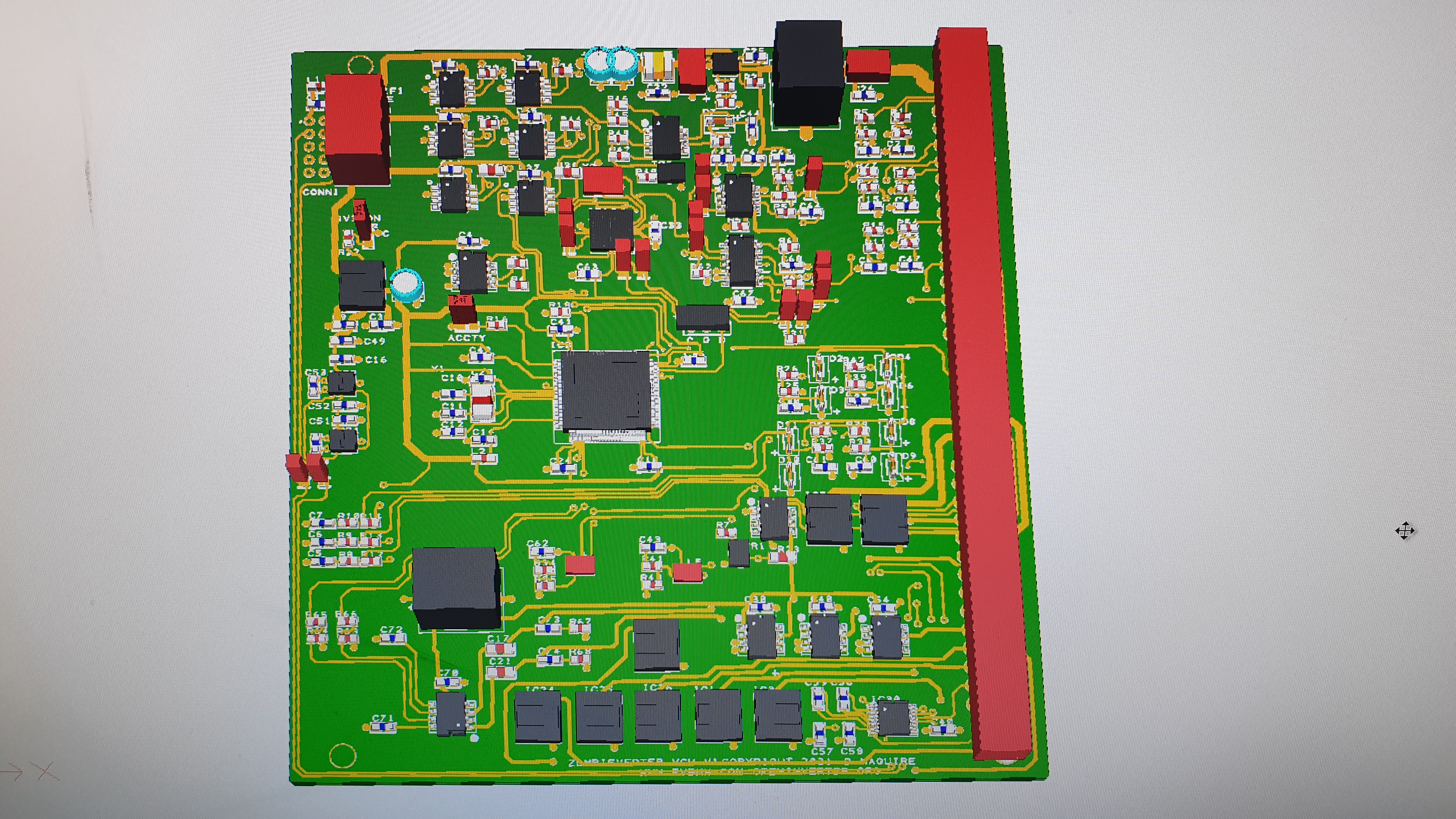

We have a schematic. Dropping into the pcb layout full time over the next few days.

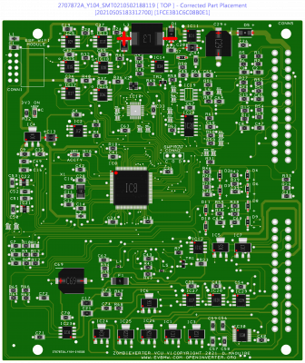

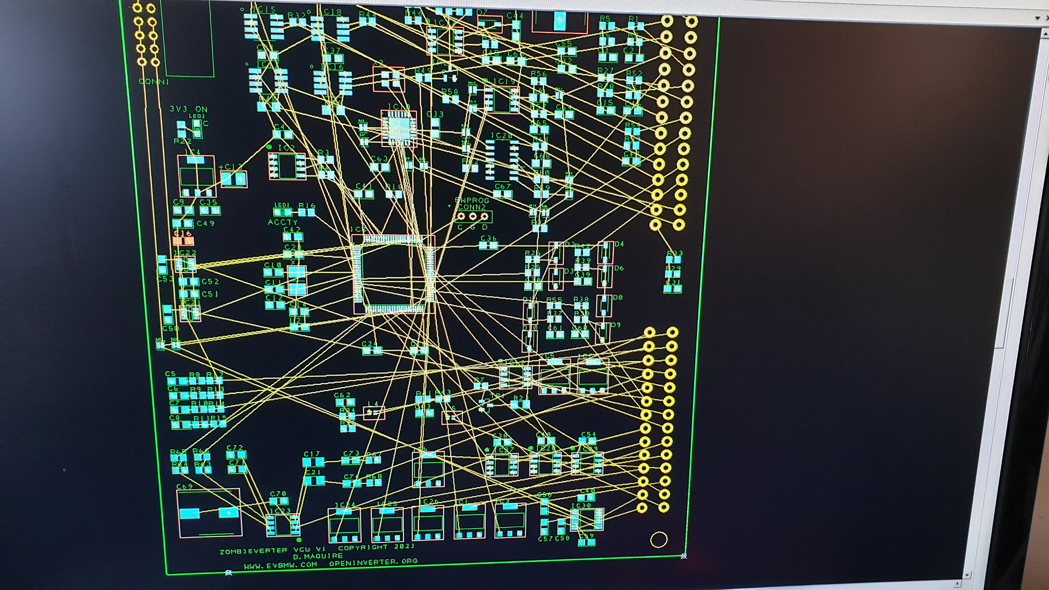

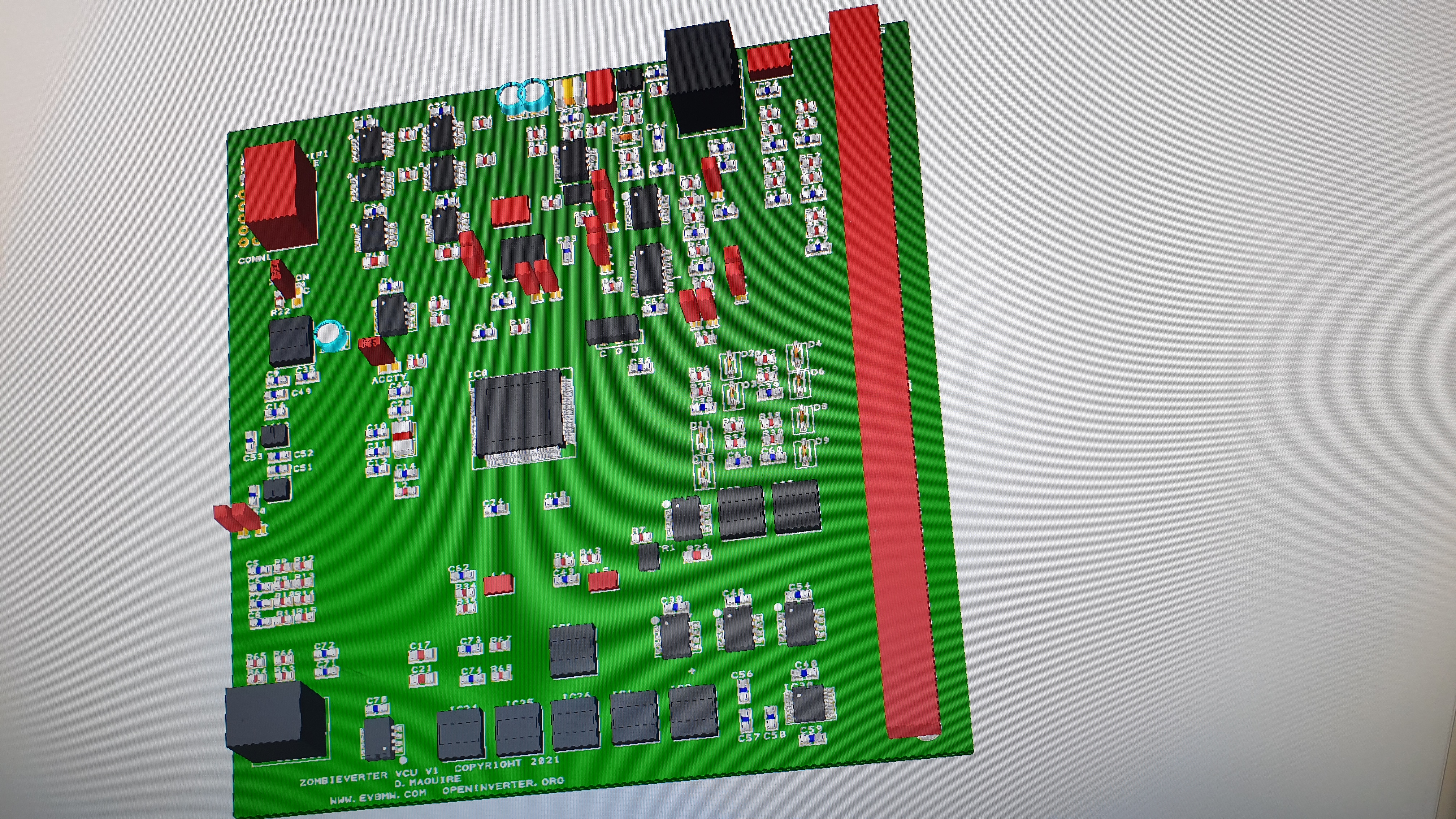

Components placed. All fits nicely on the board. Tracking starts tomorrow:)

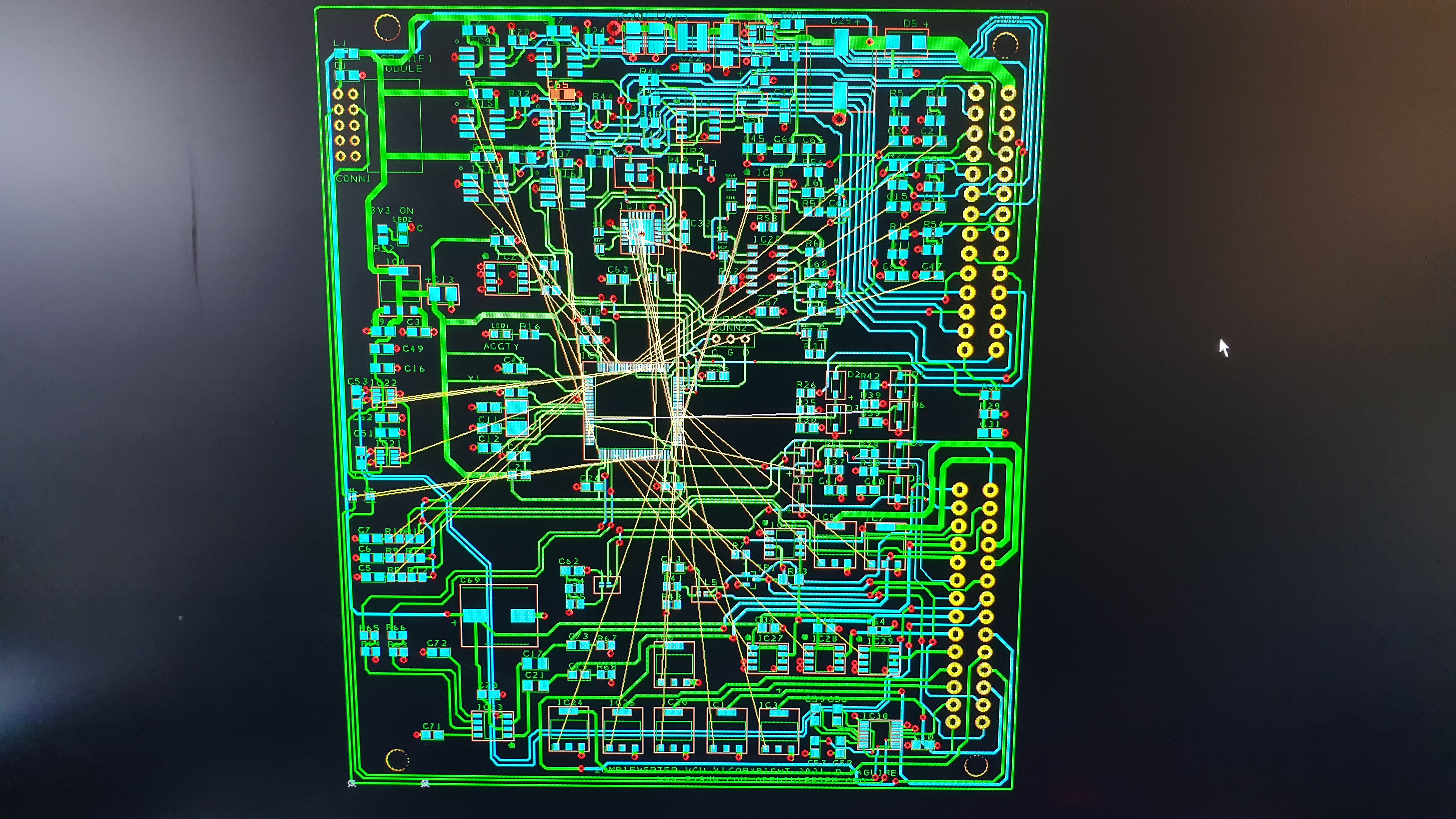

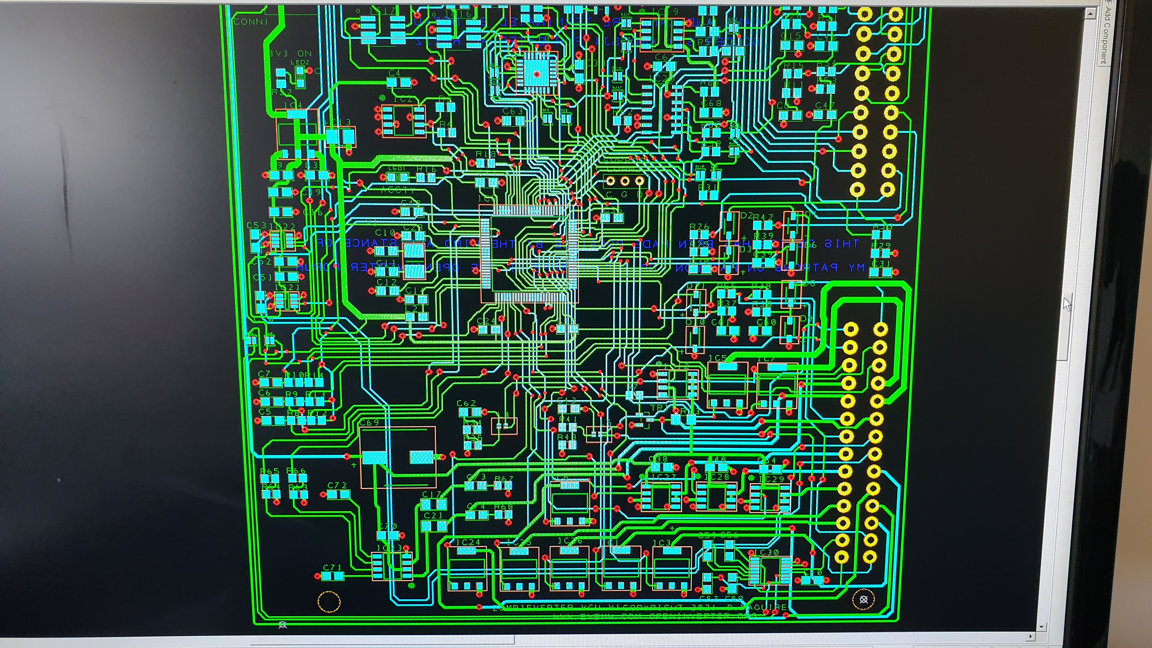

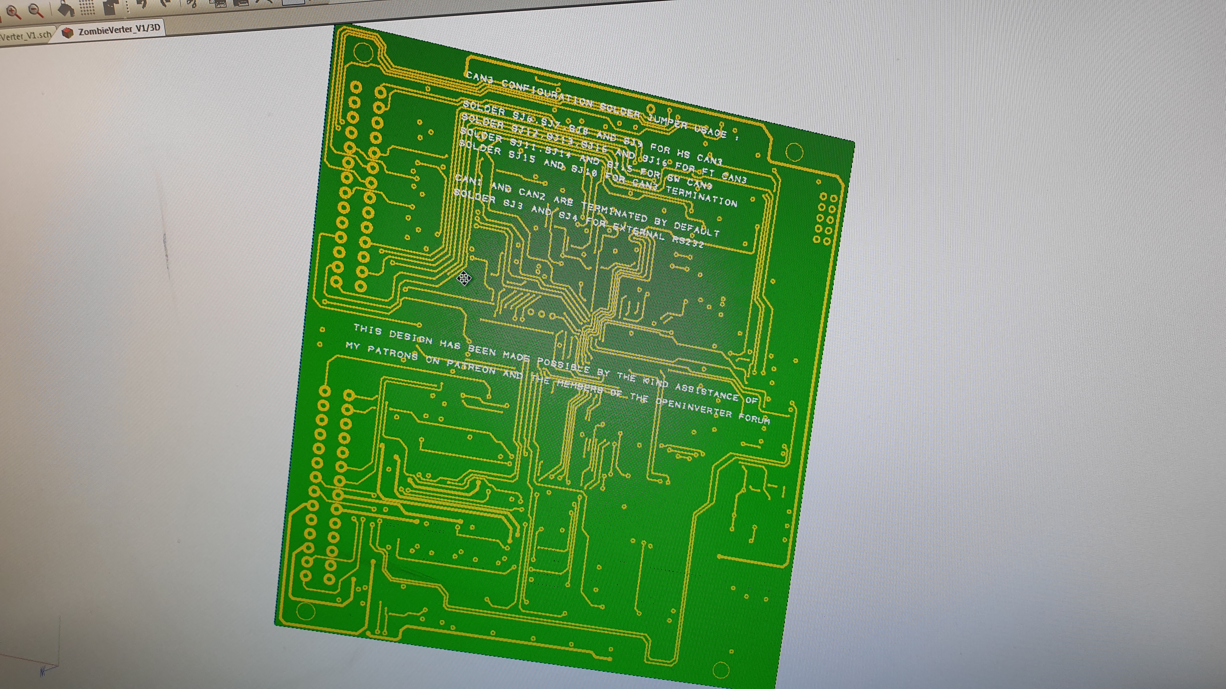

Alrighty, one day of tracking later... Reckon another day to finish tracking and another to clean up mistakes check fits with paper prints etc then we are good to go for prototypes.
So yeah, appreciate the feedback and assistance. There were a few omissions on the last schematic that I picked up on while tracking the board. Fixed in the attached. In terms of the design ethos used here I suppose its like a lot of things we color them in terms of our own experiences and requirements. Priorities for me invclude ease of use for end user (menu drop downs, simple params etc) and ability to control as much hardware as possibile in particular Toyota hybrid drive trains. We'll see where it ends up but I would see this as a good place to start

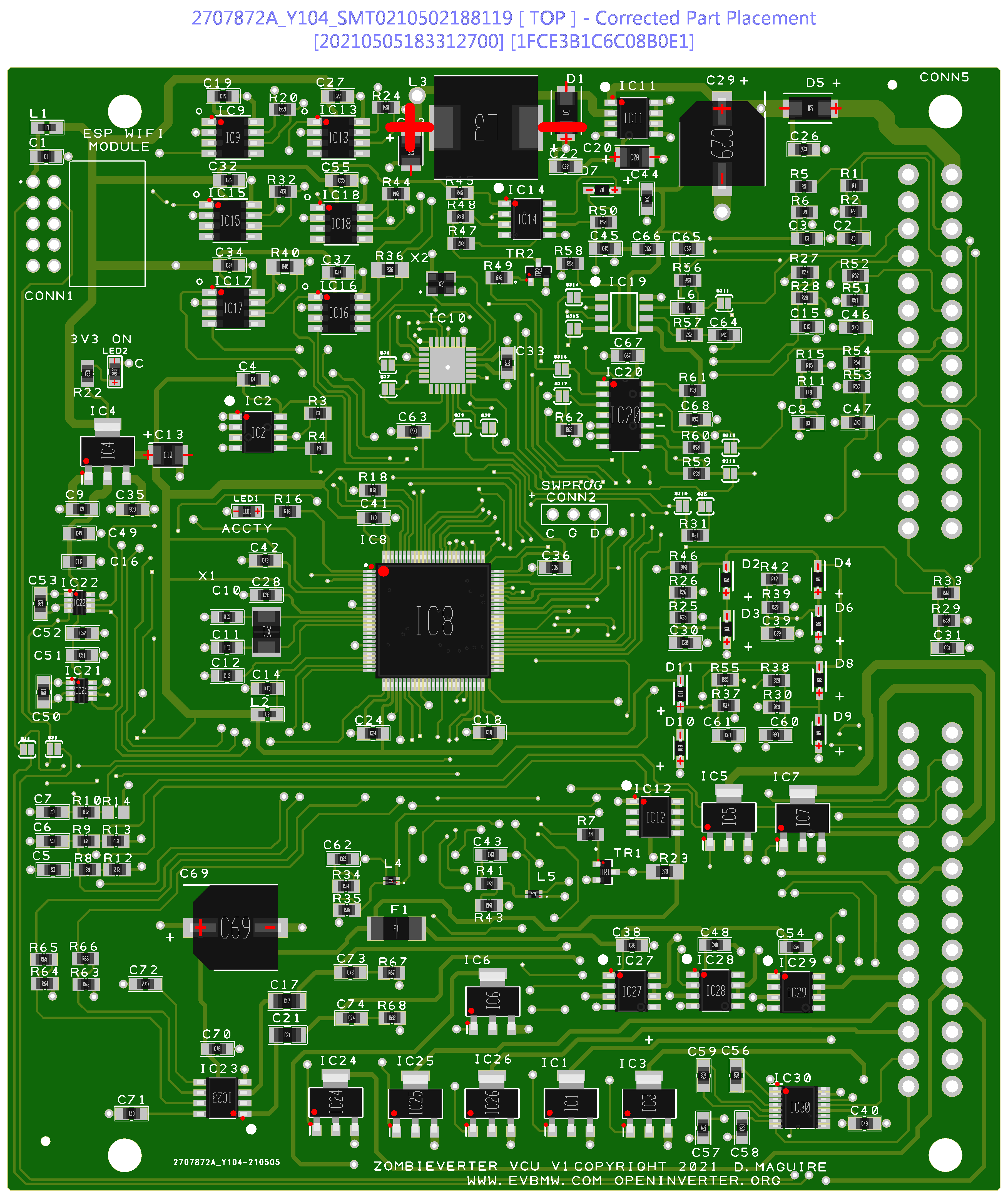

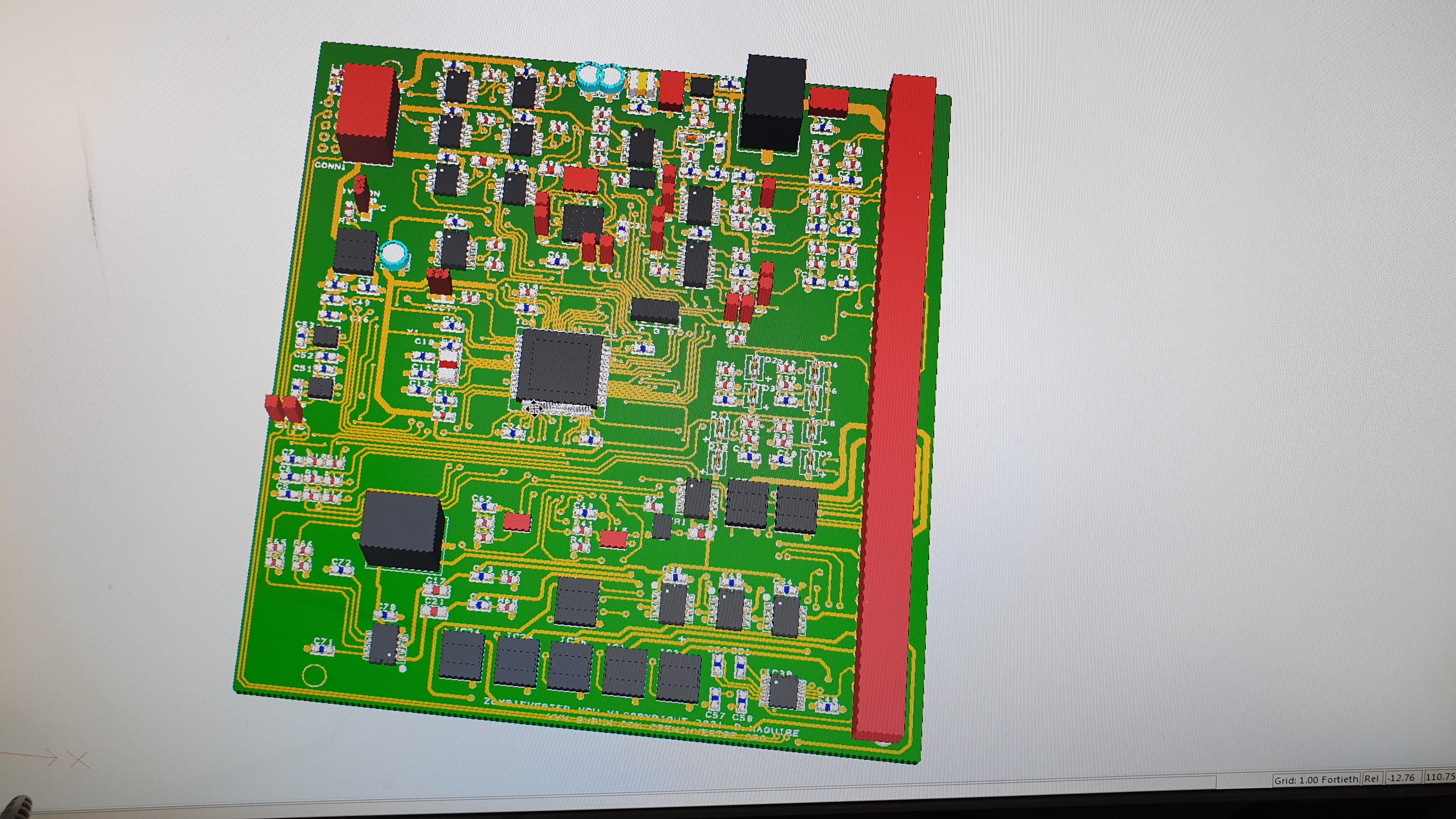

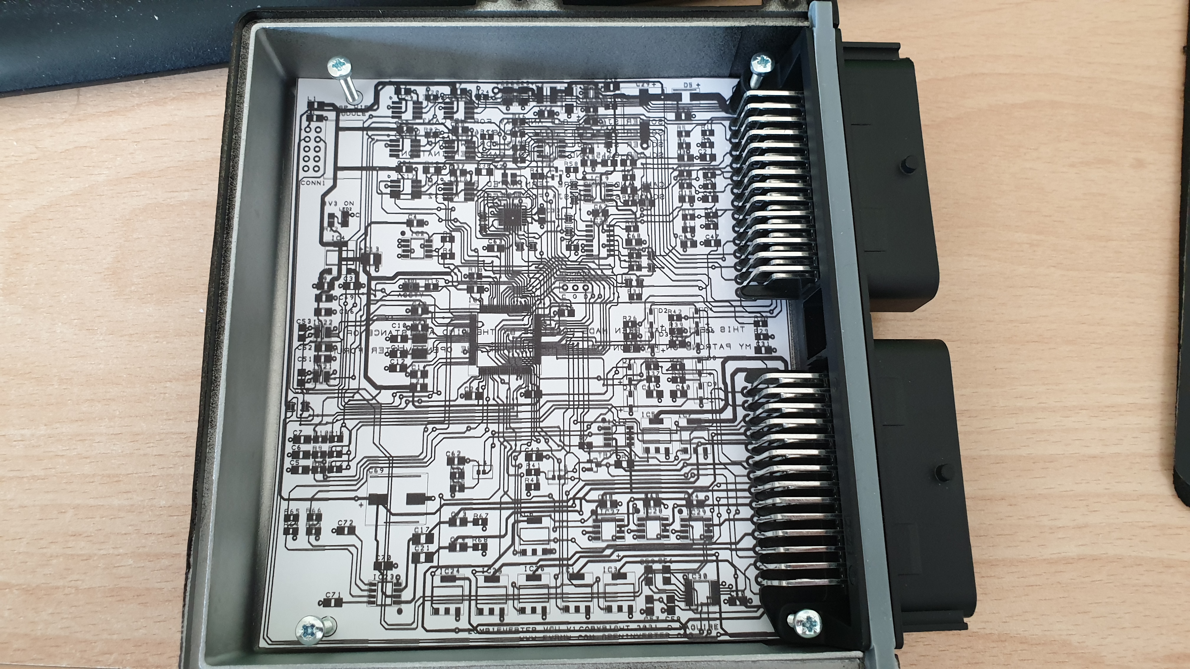

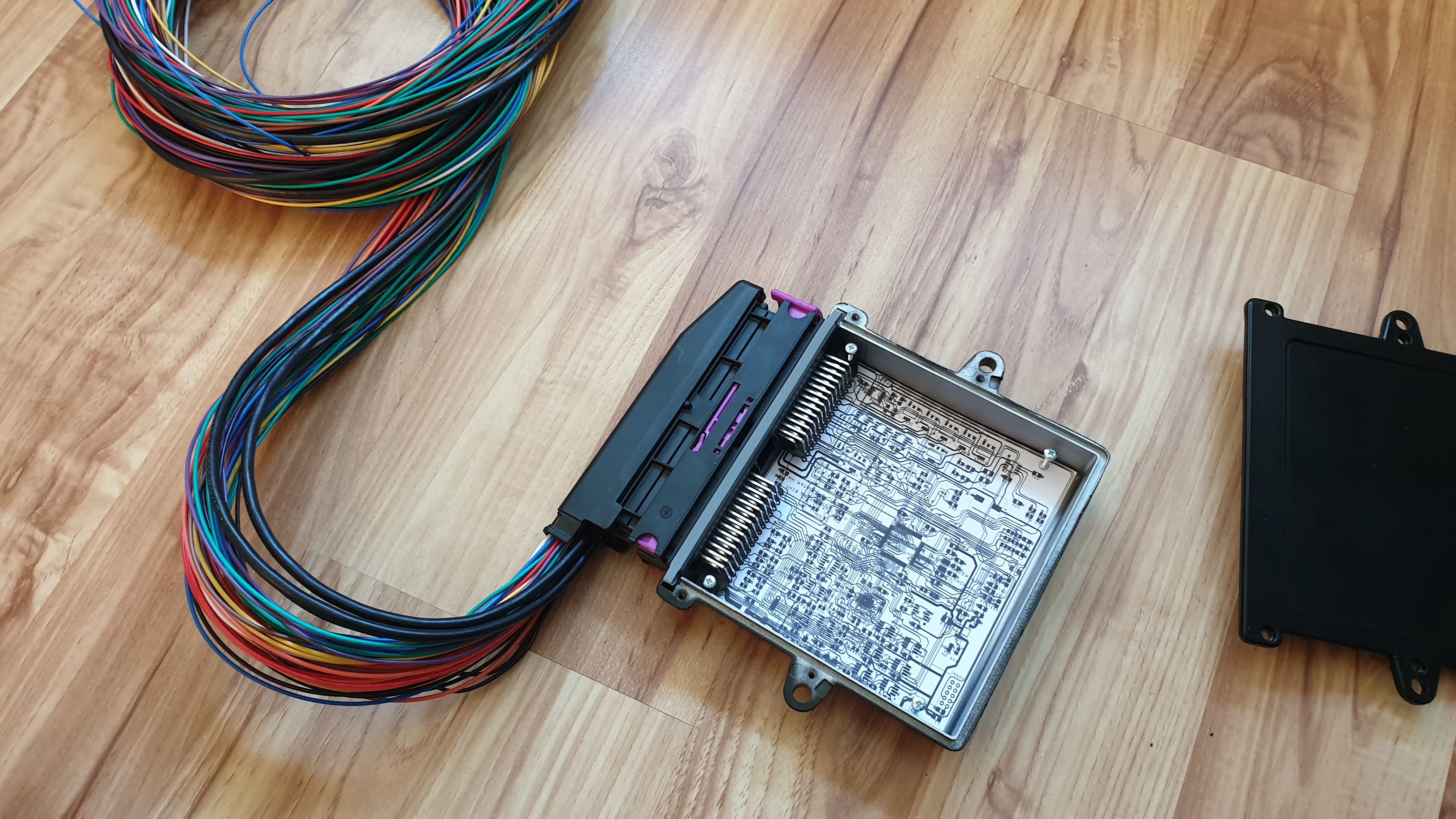

Layout done, drc passed and enclosure fit checked. Next up labeling, more checking then bom and placement file generation.

That looks like all the space is used up quite well there

Pushed the latest schematic up to the repo if anyone cares to look. Found a few sillys, will be a few more I'm sure. I'm going to get this built by both JLC and PCBway just to see how they compare. Anyway, going to wrap this up and then jump over and finish the model 3 modboard and get them both ordered.

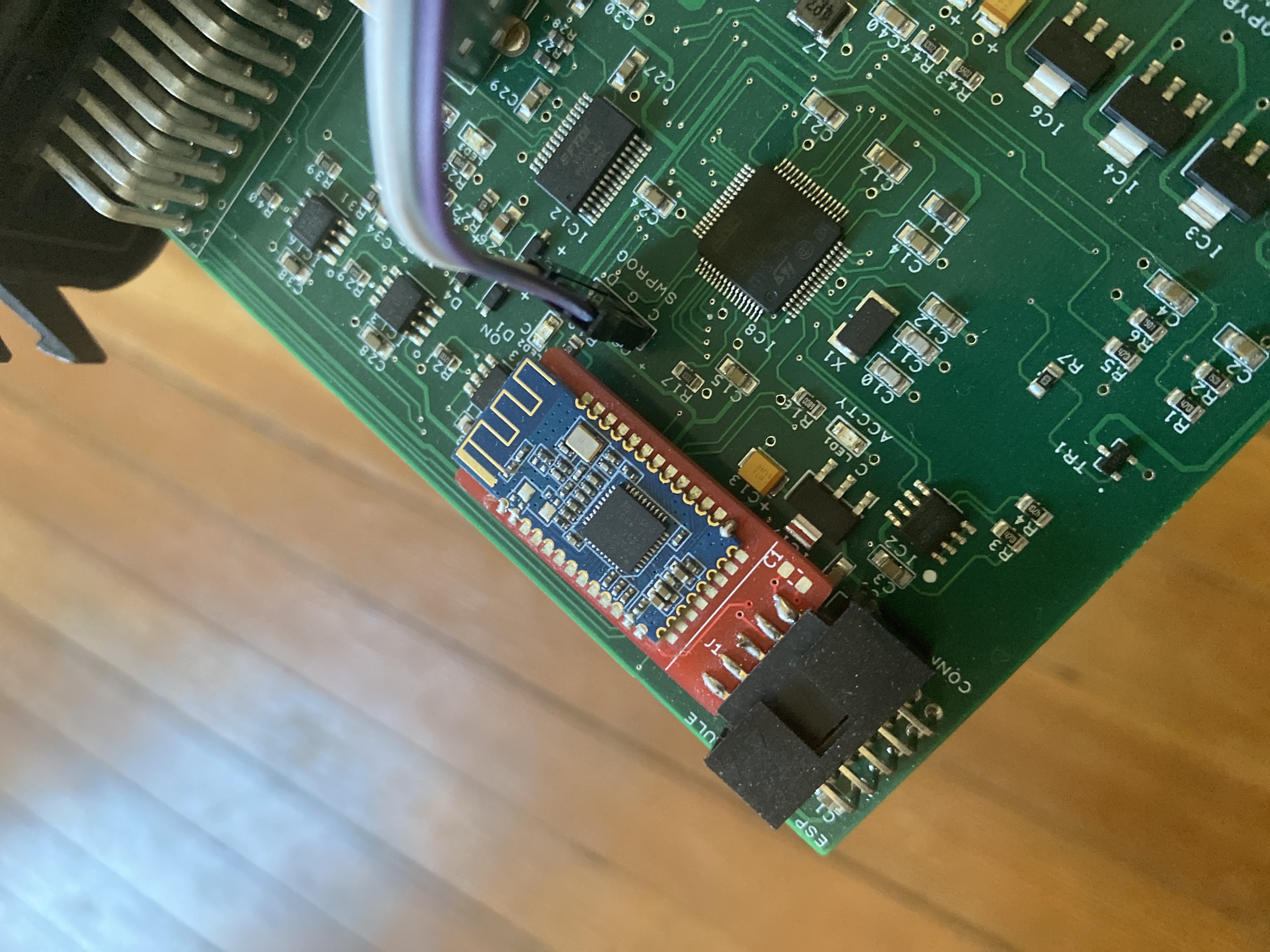

I know I'm late to the party, but has a Bluetooth receiver been considered? Even if there's no software for it now. I can imagine lots of uses. The obvious one is for displays, but we could conceivably have OTA updatea and other goodies with a Bluetooth connection.
Sorry if this is too late, but thought it worth at least mentioning.

I made a plug and play HM10 module to replace the WiFi. It’s an EXTREME back burner project that intended to use a web-Bluetooth interface. I lost interest for the time being and have been honing my C usage and CAN bus “skills”steveknox wrote: ↑Sat May 01, 2021 7:42 pm Hi,

Would be happy to send one to anyone interested in pursuing this.

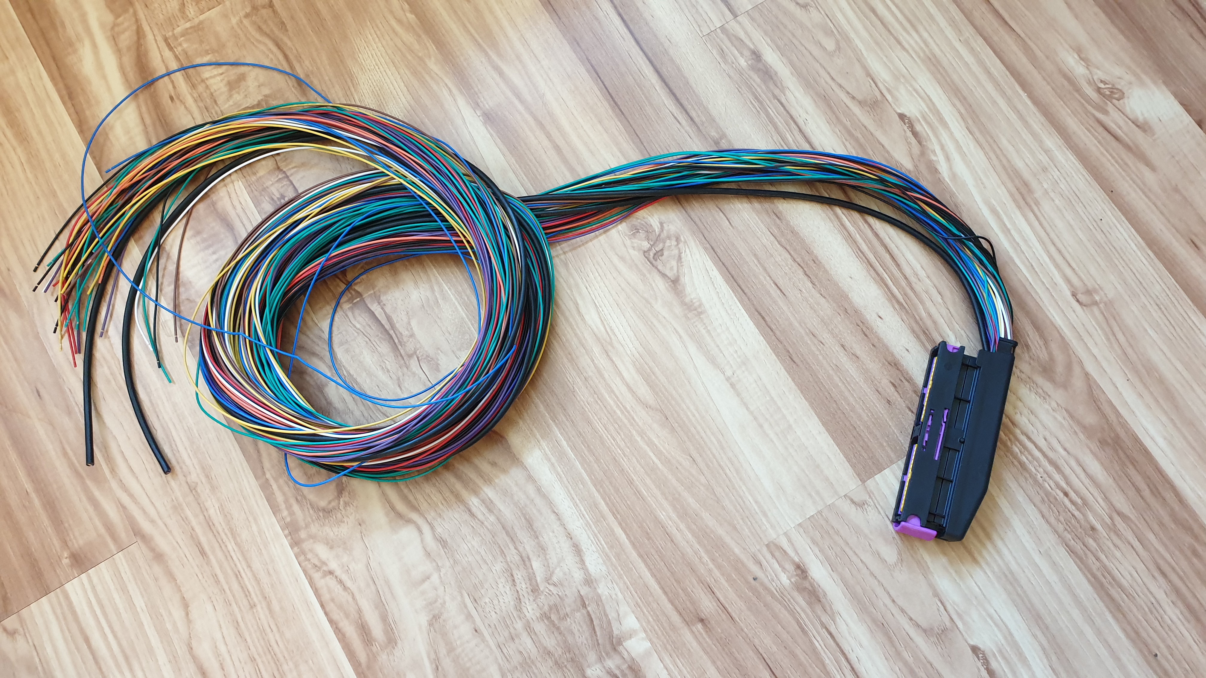

- Posts: 4007
- Been thanked: 1139 times

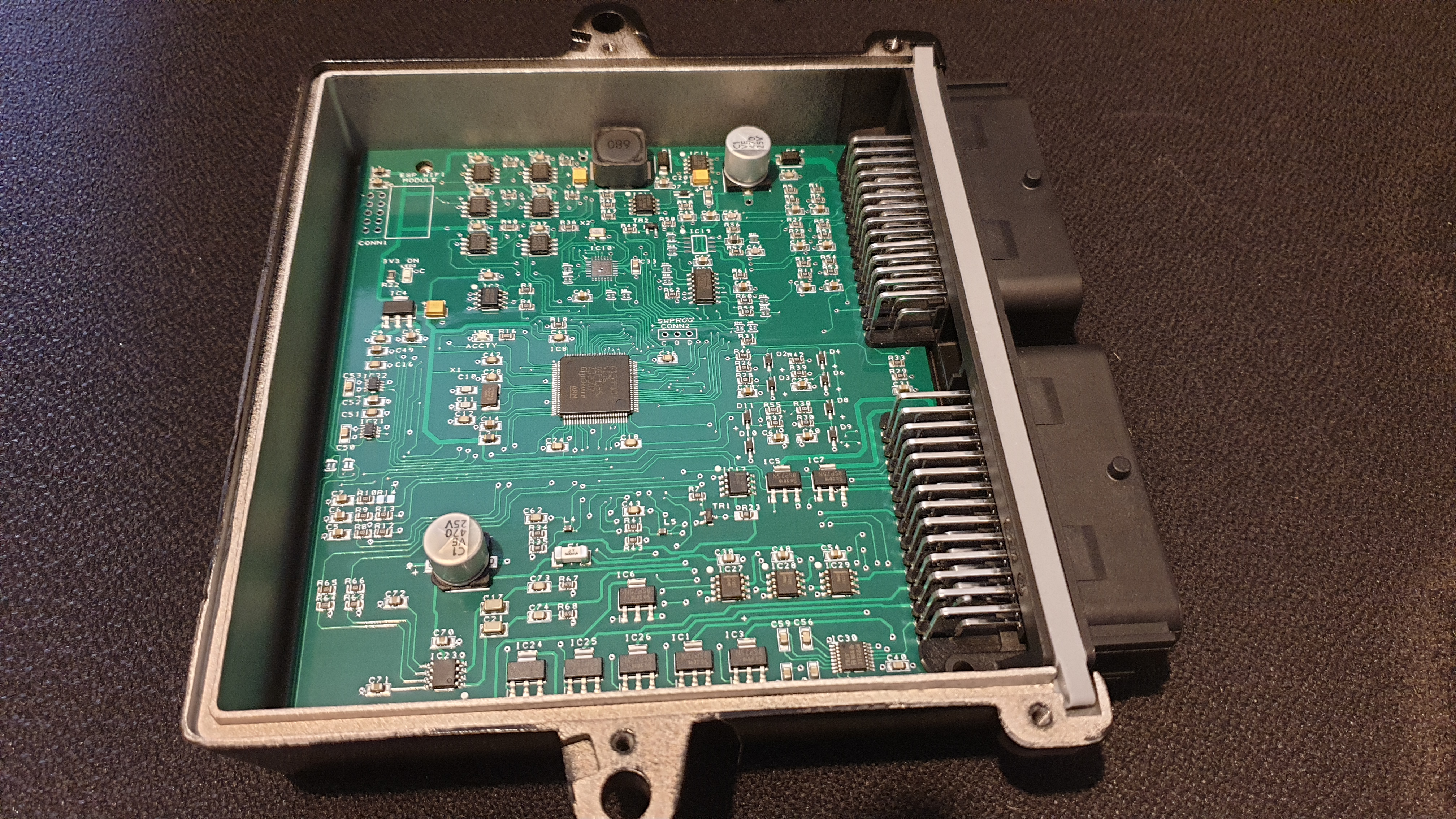

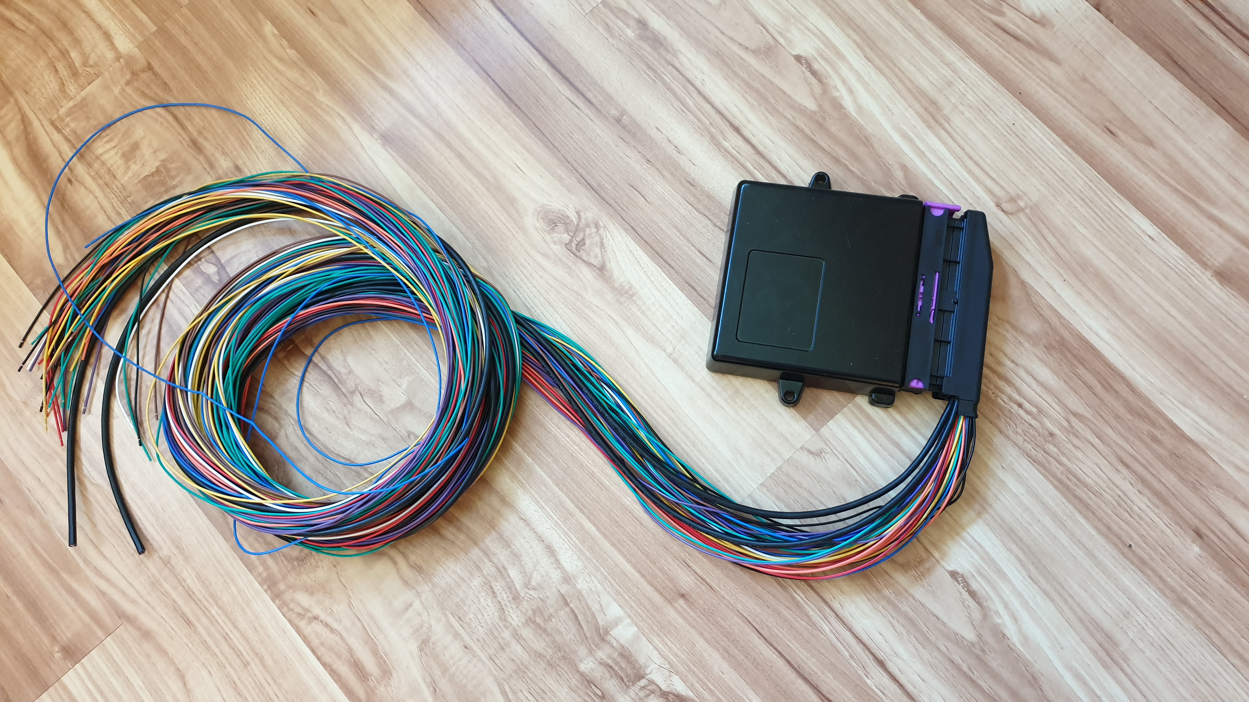

Wiring harness arrived from Aliexpress. Nice fit.

That looks really good.

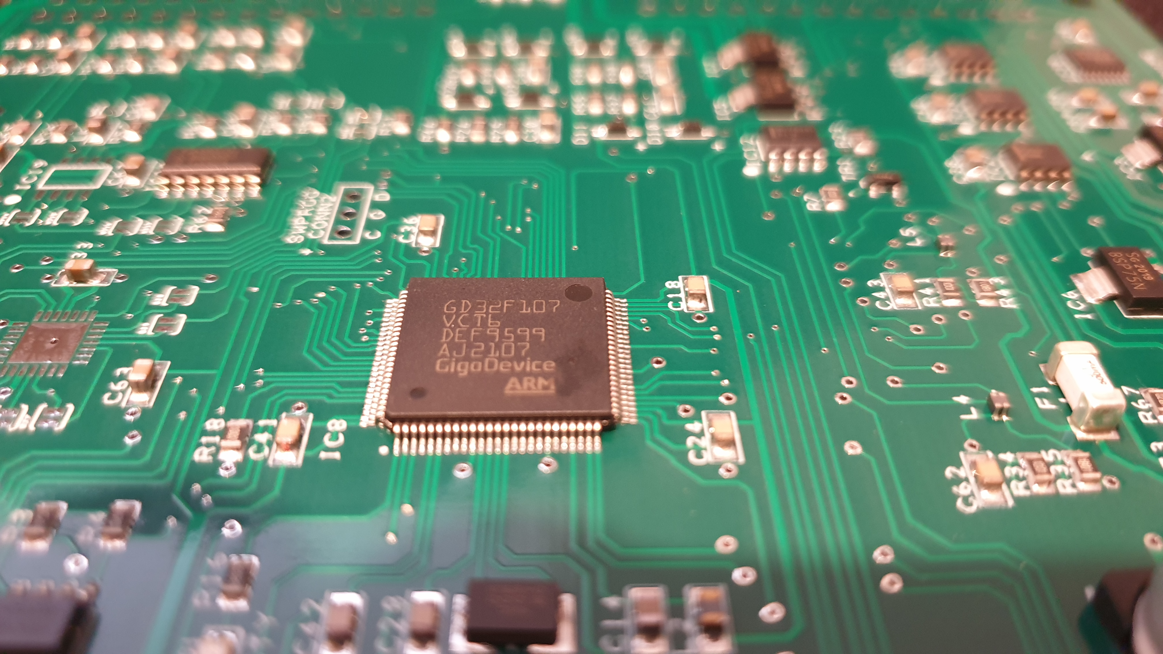

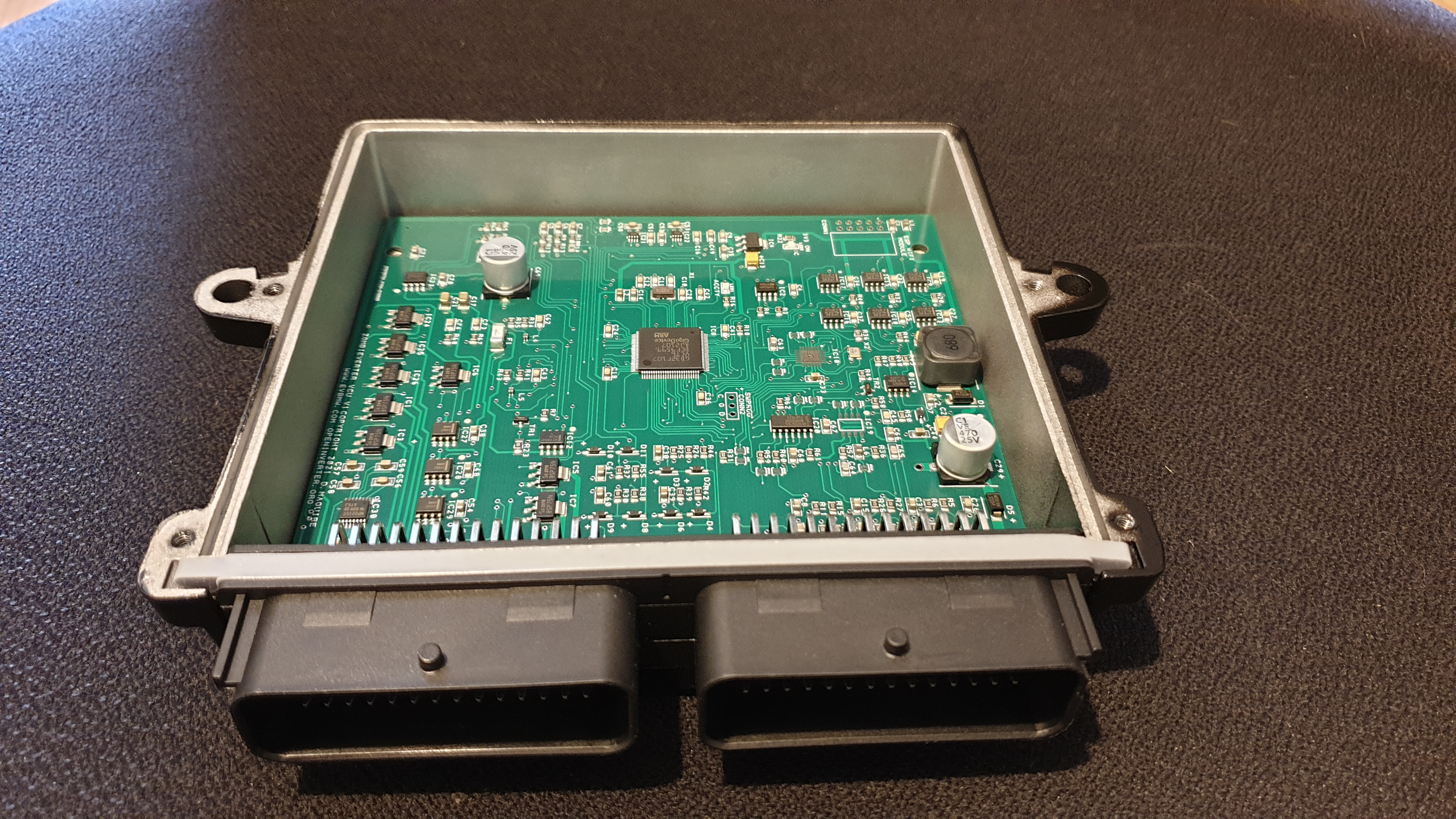

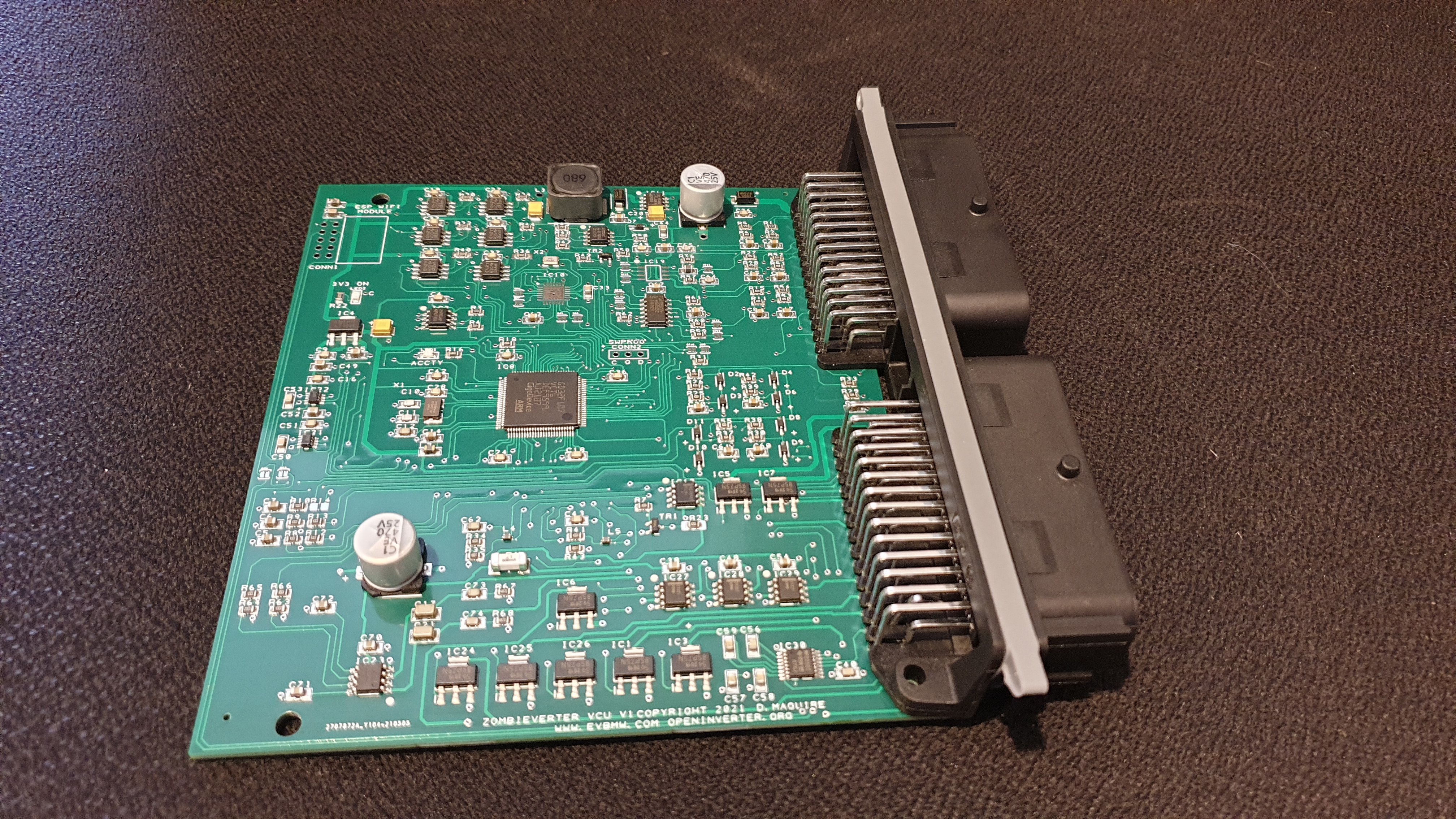

So quick update. First batch of 10 boards are now built and on their way from JLCPCB. Assuming they pass basic tests I will be making some available at a special discount to Patrons. General release subject to testing/validation and software development.
