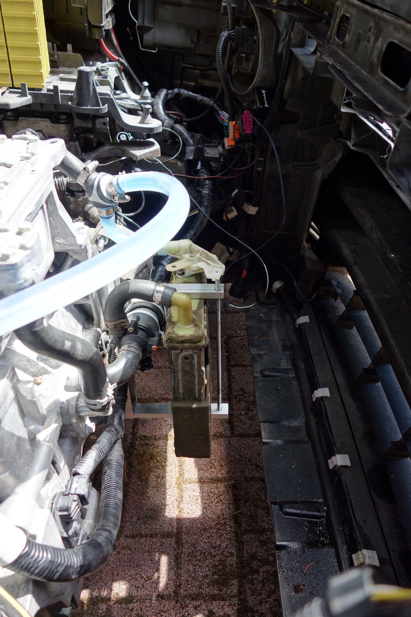

You will need to rid the code with a good diagnostic app. I remember leaving a connector off an airbag when replacing a VW Passat door once. The airbag light came on and stayed on. The code will not go out even when resetting the error codes in the normal way. You have to go deeper. I never did it again !! I used a VCDS unit.johu wrote: ↑Fri May 10, 2019 6:00 pm We have liftoff![]()
Connected my trusty 32V Sinopoly pack.
Drove some 5m up and down the driveway. There is not a lot of torque but still enough to pull against the handbrake in 3rd gear.
I took quite a liking of CAN today. I "wired up" the various control signals like key switch, throttle, brake via just mapping them on the CAN bus. So much easier then finding all that stuff in some convoluted wire harness. So there are just 4 wires connecting the Nissan to the VW world.
I've likely found the source of the airbag error. I had connected some "front bumper sensor" (whatever it senses) to the reverse switch of the transmission. They have the same plug. Stupid.
But I think the error must be deleted for the light to go out. Can that be done with Savvycan? Whats the cheapest way otherwise?
Regards and keep going. The end is near.

While waiting for the precharge resistor I decided to fix some miscellaneous problems:
Will post the ECU code on github
- Oil pressure warning: pulling low oil pressure switch depending on speed. Speed read from CAN
- Burned DC switch driver: using custom ECU with DIP relay driver and flyback diode connected. It closes DC switch depending on opmode of inverter that is also read from CAN

Today I replaced the burned precharge resistor and put in a Meanwell 62A PSU as DC/DC converter. Works well off 370V.
So now I set about tuning the motor. I tried all syncofs values from 0-59000. Put the car in 3rd and handbrake on and tried to quantify how deeps it's pulled into the springs
0-4000 - little torque
4000-7000 - no torque at all
From 8000 - spins in reverse
From 12000 - little torque
19000 - possibly maximum torque
24000 - little torque
37000-41000 - no torque
42000 - starts spinning forward
56000 - possible maximum
57000 - declining torque
So indeed the no-torque offsets are 180° apart from each other and the maximum torque is about 90°onwards. Thats a bit of a surprise because I expected the offset between no torque and full torque to be only 45° on an IPM.
I also used the idle speed regulator to keep the motor at 1000rpm while changing syncofs. Indeed between 55000-56000 idling happens at around 4A phase current. Take it towards 58000 (10° more) and it increases to 50A. So that must be field weakening current.
So far so good, but the car is barely moving as soon as I put it in gear. It barely gets me up my driveway even though rms current quickly reaches 200A and sooner or later it trips out. Since others have been more successful I'm starting to wonder if something is broken. Checked:
Any ideas what else to try? Any good reads on IPM control?

So I did a few more experiments.
At first I tested the over current limit. I had it set to 800A but when plotting il1 and il2 and pulling against the handbrake I got shutdowns near 180A. Si I revisited the "break interrupt" i.e. the routine that is called when the inhibit signal is triggered. It tuns out I did all sorts of things and then checked the pins for the shutdown reason.
I have now turned this around and bingo, what I thought were over current shutdown were actually desat events! Or more precisely desat OR some other fault signal, probably temperature. So since the shutdown occurs beyond some delay it could be that the flow rate of my pump/radiator is too low and I get local overheating. Also 180A (provided my current sensors are calibrated ok) seems a bit low for desat. Anyway, I set iacmax to 200A and ocurlim to 400 and I'm getting less desat/overtemp shutdowns.
I also tested behaviour ad speed. I tested with the idle speed controller 1000, 2000, 3000, 4000 rpm with 50% throttle limit. It turns out a setting of syncofs that works well at 1000rpm (56000) gives high currents at 2000rpm, likewise at 3000 and 4000rpm. So about for every 1000rpm I had to increase syncofs by about 500 dig (about 3°) to run with low current. Whether that is down to the motor or to some lag in position sensing I don't yet know.
When keeping the speed fixed at 1000rpm it was quite irritating to see that changing the offset from 56000 to 56500 (3° !) would cause the current to rise from 4A to 40A! Not very forgiving this beast.
So my hopes are that dethrottling my cooling system might help the shutdowns and that I can find a "syncadvance" value that compensates the apparent lag of the position sensing.
Just for repetition, here is the cooling system: auxiliary water pump from some Mercedes and passenger room heating radiator.
Question: could there be air in the inverter? I have no idea how to de-air a cooling system?

I can't really see from the picture but do you have a coolant resevoir? Typically you would want one teed into the pump input to put a little static pressure on the feed.

Yes the original one. It sits on the tube that exits the picture. So you're saying I should instead connect it to the pump input?Jack Bauer wrote: ↑Sun May 19, 2019 5:40 pm I can't really see from the picture but do you have a coolant resevoir? Typically you would want one teed into the pump input to put a little static pressure on the feed.

I've used a vacuum filling system in the past and plan to use it again on my Tesla P100 battery modules

The cooling system is very simple to deair(eiluft you guys say in Germany) if you dont have some elaborate valves and heating elements included.
1. You have your reservoir with one supply line and one output line in case liquid would boil.
2. supply line leads to 3way port on water hose from motor to radiator
3. cooler fluid from radiator to suction pump and back to motor
I use another 3way port element in section between radiator and pump. 2 points just pasthrough liquid, but i connect third one to a toilet hose with a screw plug in the end. When i have to deair my system i just supply liquid to reservoir and run the pump. When it starts to suck air i open the end valve and wait for the air to evacuate and liquid to flow from there. That is it. You can use even larger hoses. What is important is that your plug is higher than the system so air can evacuate to the highest point - the plug.

Like that basically?
What do you guys think about the radiator?

It is a bit small and without active cooling. Starts will heat up inverter a lot. Is that a car heater core? This would do for the motor, but for both inverter and motor i dont think it will be enough.
I think i will use original radiator for the motor and i will first let the water from radiator to inverter and charger and then to the motor. From here dT would have to be dropped fast. I will write more about it when i have motor in a car.
Might be a good idea to put the pump after the cooler if you are expecting higher temperatures, less risk for cavitation.
(and pump runs cooler, lasts longer)
