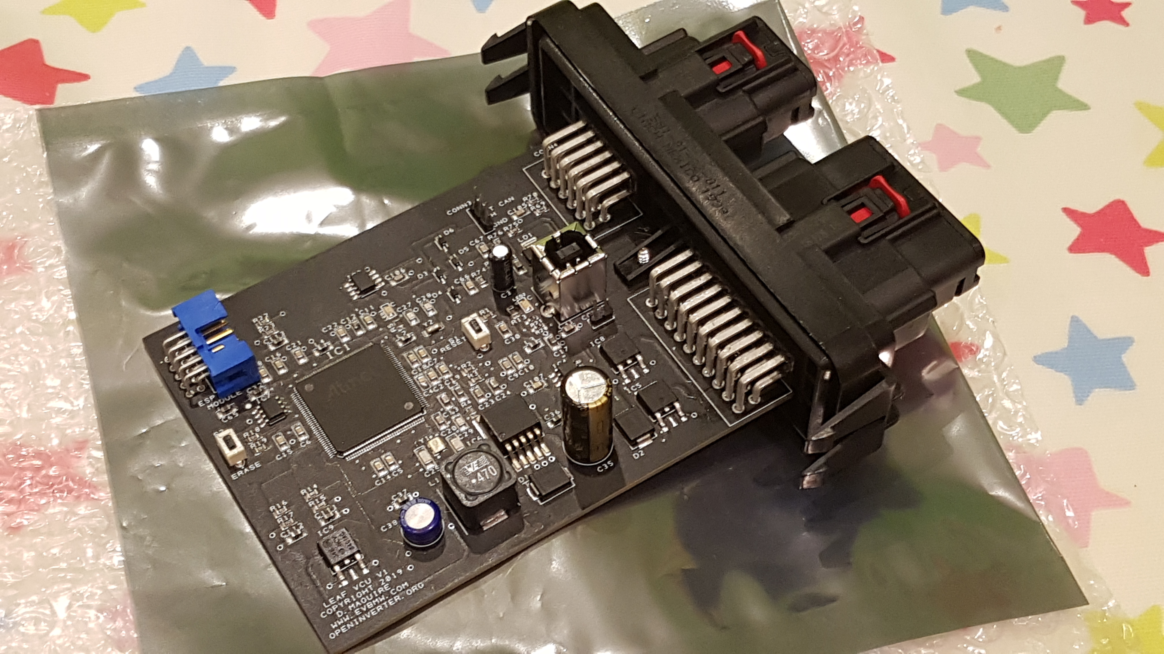

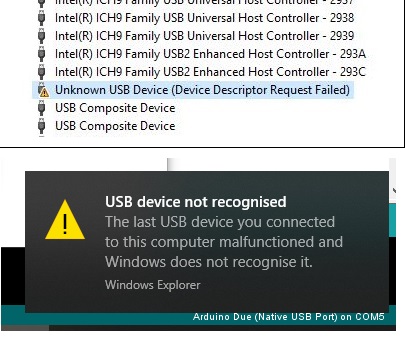

Took a while but, got the board back from resoldering the microcontroller. Nice job too. Today I finished soldering the remaining items including wiring up and labelling the VCU connectors.
After that, I proceeded with getting on with the Arduino IDE with the board connected up. When I connect up my FTDI or Arduino Due, no problem. They setup just fine and you can see them. However, when I connect the Leaf VCU, I just get USB connection errors. I try and update drivers with no success. All drivers are up to date.
Damien M did say that there was the odd chance that a crystal could be reversed on the board as their orientation markings changed depending on manufacturer. Does this look like that or is it something more basic I am missing? Tried on two laptops now. Due and FTDI work fine, Leaf VCU not.
- Posts: 4003
- Been thanked: 1125 times
Re: Leaf Gen 1 Inverter Board
The crystal is backwards. That Damien M guy sounds like a moron.
Crystal flipped. Still nada. R2 and R3 are correct at 39ohm. Dilbert suggested checking as they might have been 3.3ohm.
Next step?
**EDIT - did a bit of a tidy up. small bridge. Can see it now on COM port 8... onto the next stage. As you were...
Next step?

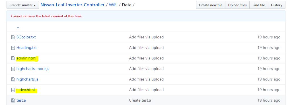

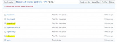

Good few nights this week to get where we are now. Followed arbers instructions flashing the ESP8266 via the FTDI board all the way down to the last line - connect your board to Johannes board...
Am I correct in saying that the Johannes web interface will work with the @evbmw Leaf VCU or have I missed a beat? Reason I ask, James (project Fig-leaf) and me have been working together to get to this point and where we see this when we both connect up our inverter and boards. No settings. Should we be doing everything through IDE or should http://192.168.4.1/ be working? All ready to go...
- Posts: 4003
So folks where exactly did it say that I had implemented a fully featured interface for this thing using the inverter web front end? I think it's a really cool idea by the way but sadly my attempts to clone myself have been .... well.....messy so far thus I have not done so.
Now, it is your lucky day as I have just been doing some donuts in the grey goose and have posted a new firmware AND a Wifi display on the github. You will however have to wade through my feeble attempts at C programming to calibrate your throttle etc.
- Been thanked: 1914 times
Is the VCU already using the STM32? If so I think it wouldn't take me long to port the firmware to "libopeninv" and thus make it fully compatible with the existing web interfaces (mine and Dimas)
EDIT: just checked - SAM3X so no easy porting
EDIT2: actually the vital parts are hardware-independent. Make some noise if you want me to tackle it.

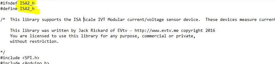

Ploughed ahead and flashed the leaf vcu with the new firmware update as outlined below. Tricky finding the ISA.h libraries but found the zip file here in the end at the end of the page:
http://store.evtv.me/proddetail.php?prod=1kshunt
I found though when compiling, an error appeared referencing ISA2.h library Opened the .h and .cpp file that were causing the error and removed the '2' in 3 locations in the code and all ran fine then. I am a basic programmer but it made sense to me to do it. Correct me if I made a balls. Now I have a vcu newly flashed with all the updated features added complete with slower flashing led for ref.
After that, via the FTDI board, I flashed the ESP8266 as before -
1. Solder GPIO0 to 0
2. Verify code in Arduino IDE - Set - Erase Flash: "Sketch + WiFi Settings"
3. Flash code onto the ESP8266 - all good, flashing green led
4. Solder GPIO0 to 1 to seal bridge back for operation
All good. Connected the Olimex up to the board and the inverter. Powered up inverter and board. All flashing as it should.
Connect up the laptop to the WiFi module, check.
Question 1 - Not sure what I am looking for yet. Is there a separate IP address connect similar to 192.168.4.1? I don't see any in the code, only the html references here. Question 2- In the IDE, when I hardwire the VCU and open the Serial Monitor, I get Voltage info fed back on the screen. Should I remain on the Native USB Port or change to Programming port to send torque commands? Sorry for these questions that might seem fundamental. Learning this side of the build as I go. Thanks

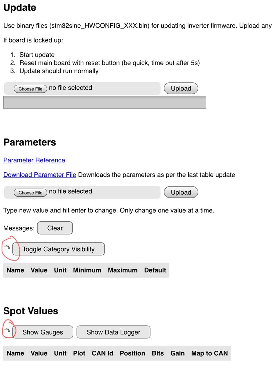

So as we now seem to have a complete lack of understanding coupled with confusion as to how the Leaf VCU works i'll jump in here and try my best to explain. I hesitiate as it seems sometimes that for every answer I give two more questions pop up but here goes.
1) The Leaf VCU is designed to run a Gen1 or Gen2 Nissan Leaf inverter and motor in stock form via CAN messages. No inverter modifications are required.
2)The Leaf VCU DOES NOT operate with the openinverter WiFi interface.
3)A pinout for the connectors on the VCU is provided here : https://github.com/damienmaguire/Nissan ... Pinout.pdf
In order to configure the VCU to run your motor it is necessary to modify the software to accept your throttle input. The VCU provides for single or dual channel throttle pedals and in its stock for on github is configured for a BMW E46 hall effect pedal. In order to change this the subroutine responsible for reading the pedal input will need to be modified. Here is the routine :

Once this has been done the VCU will now respond to throttle commands and send torque requests to the inverter.
the latest firmware on github looks for a 12v input on IN1 as a start request. It will then control the precharge and main contactors and inverter power via the three low side driver outputs OUT1,2 and 3 as per the comments in the code.
WiFi : A web interface via wifi that runs on the same Olimex ESP8266 module as the openinverter has been released on github. Once loaded and powered up a wifi access point called wifipowernet will appear. Connect to this and goto 192.168.4.1 to see the interface. Goto 192.168.4.1/admin to change the wifi access point settings.
ISA CAN Shunt : The latest release firmware also provides for connectivity with the ISA Can shunt for data display over the wifi interface.
I have created a task here requesting help with documentation etc not that I really expect much :
viewtopic.php?f=18&t=643
