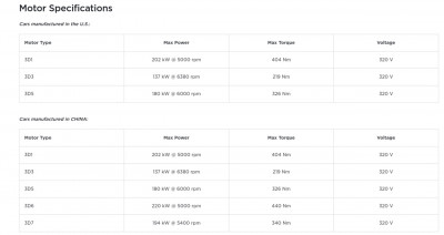

What heat produce this drive unit? Tesla claims that their model 3/Y motors have efficiency 97%. For example 3d5 drive unit have 180 KW of power. Is that means that it will make 5.4 KW of heat? (to make 180 KW it need 185.4 KW of energy) Am I right?
Is it possible to use a cabin heater core as cooling element?
Regarding the efficiency - I don't think/doubt that 97% is total drivetrain efficiency including inverter/motor/gear reduction/battery/driveshafts etc..?AMP3R wrote: ↑Tue Feb 28, 2023 4:29 pm What heat produce this drive unit? Tesla claims that their model 3/Y motors have efficiency 97%. For example 3d5 drive unit have 180 KW of power. Is that means that it will make 5.4 KW of heat? (to make 180 KW it need 185.4 KW of energy) Am I right?
Can your heater core dissipate 5.4kW of heat? If yes then this could work in theory but seems a lot of heat to me (thinking of my 3kW fan heater) - however it will be dissipating this 5.4kW into the cabin which in winter might be ok, but in the summer would not!
Obviously this is only peak load - and cruising will be much less Kw/heat, but still you need to design the cooling system for the worst/hardest case.

I think that the heat scenario is valid for nominal power.
All other powers are very short duration. So yes you need to cool that but nominal won't be used all the time either so laying out for nominal with enough thermal mass should do it.

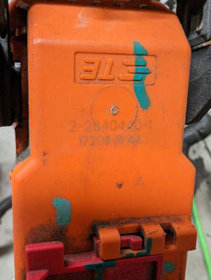

HV Connector for Model 3 RDU (wiki updated)
I took these photos to share with Damien over on Patreon and thought they'd be useful for this thread.
Weirdly the TE connector has a printed on part number that TE doesn't have published anywhere 2-2840440-1. The connector is from their HC STAK line and it's current part number is 2840900-1.
By far the easiest way to get this connector is used, and the best part is the cable assembly has the battery connection on the other side which is the same connector. So you can get a 2for in that deal for around $150.

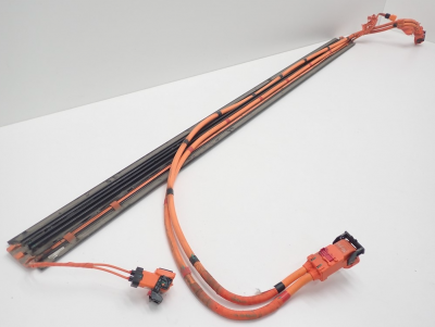

How do you think that oem cable will be enough to power the rear drive unit? Battery is on the back side and motor is on the front.
I have joined this cable to the standard (short) TM3 RDU lead.
The cable CSA is identical.
