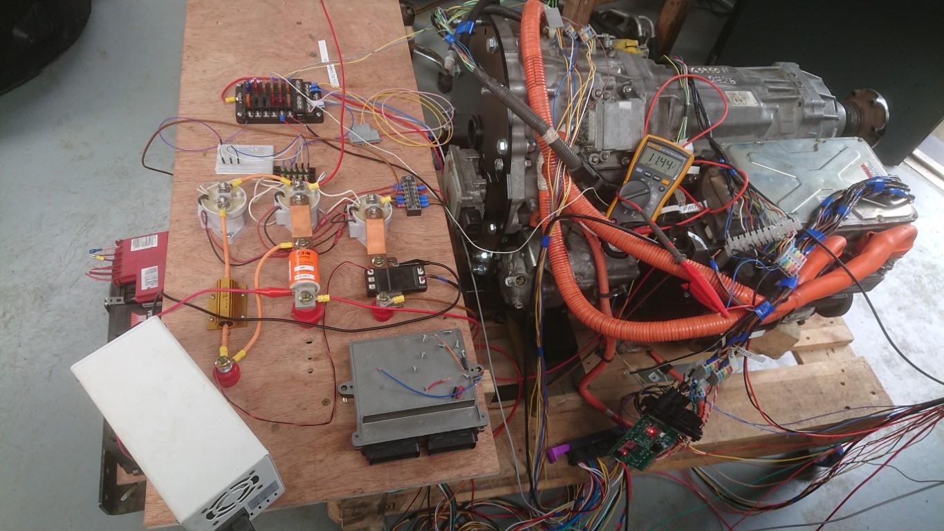

Re: ZombieVerter VCU Support

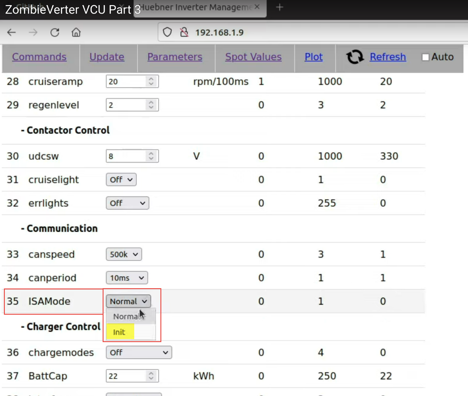

Something a bit odd with the contactor control on my setup. After a few seconds, one of them starts to buzz, or even chatter and drop out. I added bulbs to each coil to see what's happening. The behavior improves with the bulbs wired in!
Any idea what's going on here? As far as I know none of these contactors have an economizer built in.
In the video you can see the start sequence, then bulbs dimming in turn (why?), then the buzzing sound from one or more coils). I didn't look with a scope yet.
- asavage
- Posts: 385
- Has thanked: 369 times
- Been thanked: 119 times
Damien's Nov2021 video "ZombieVerter VCU Part 3" covers this, but it's 1:16 in. I knew I'd seen it, looked for it last week when you first asked, but couldn't find it again until now!

- Posts: 4000
- Been thanked: 1114 times
Double posting this here for maximum visability :
So the situation is the release code here : https://github.com/damienmaguire/Stm32- ... tag/1.00.A
works fine with the gs450h system. Compilation from the source has some major bugs so please use the release binary for now until I fix.
I don't know why the isa init was removed. Will sort this as part of the next release.

- Posts: 4000
If by weird contactor behavior you mean the vcu protecting itself from excessive current draw then yes I can explain:) The vcu uses either NCV8402 or NCV8403 self protected drivers for all contactor outputs. If the load draws too much current or too high a current for too long they will shutoff. I would not use an uneconomised contactor in any event as they will just melt coils.
et0
- Posts: 132
- Joined: Sun Oct 13, 2019 8:06 pm
- Location: Scotland
- Has thanked: 15 times
- Been thanked: 6 times
OK that explains it, thanks. Are the output pins (and drivers) for the contactors PWM-able? I'm wondering about adding economizer functionality to the VCU code versus changing all the contactors...Jack Bauer wrote: ↑Thu Aug 11, 2022 7:40 am If by weird contactor behavior you mean the vcu protecting itself from excessive current draw then yes I can explain:) The vcu uses either NCV8402 or NCV8403 self protected drivers for all contactor outputs. If the load draws too much current or too high a current for too long they will shutoff. I would not use an uneconomised contactor in any event as they will just melt coils.
- Posts: 4000
No the contactor drivers are not on pwm channels. Such a stupid oversight.....oh wait! That must me why I included 3 9A push pull PWM driver outputs on the board...

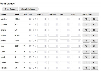

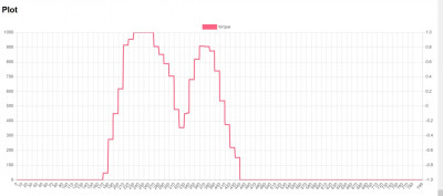

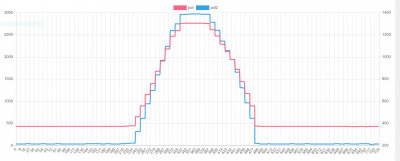

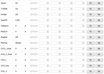

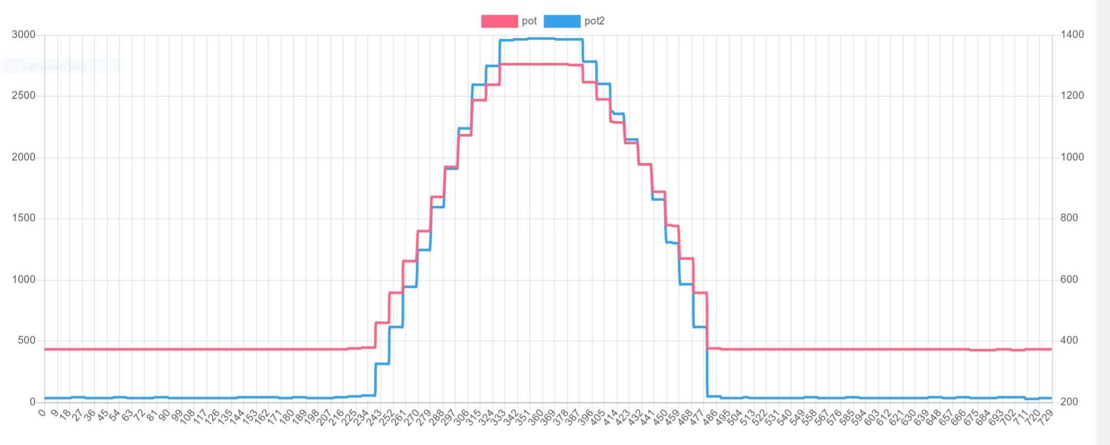

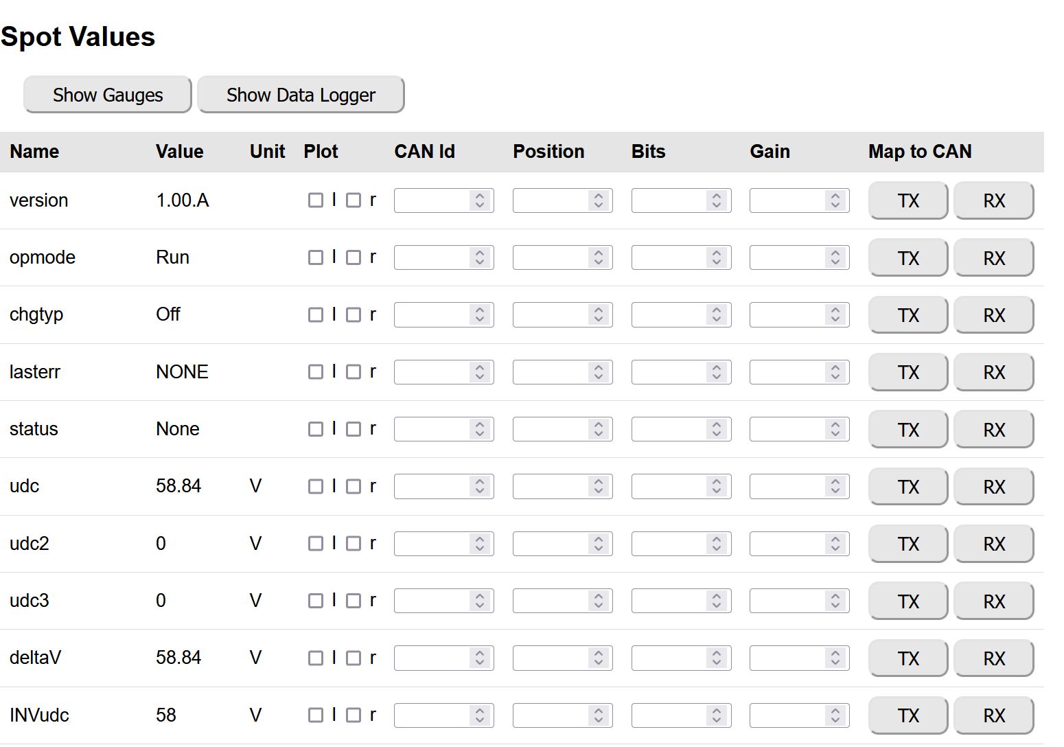

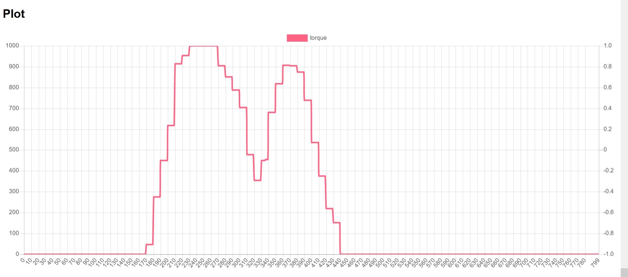

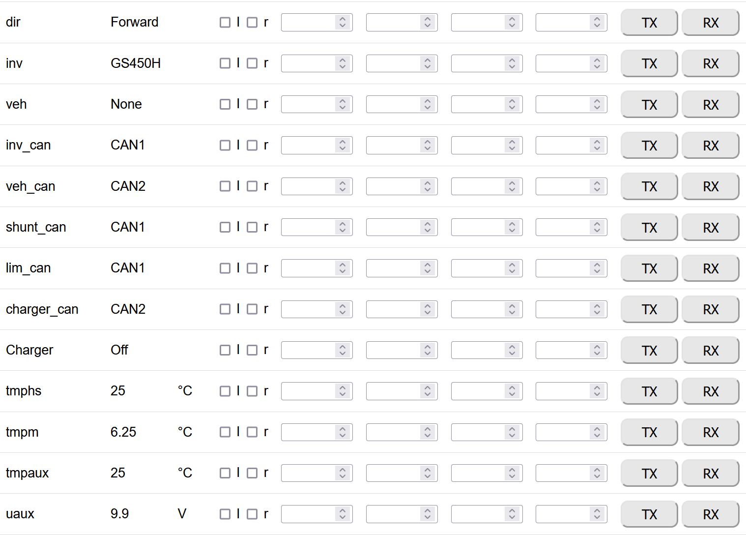

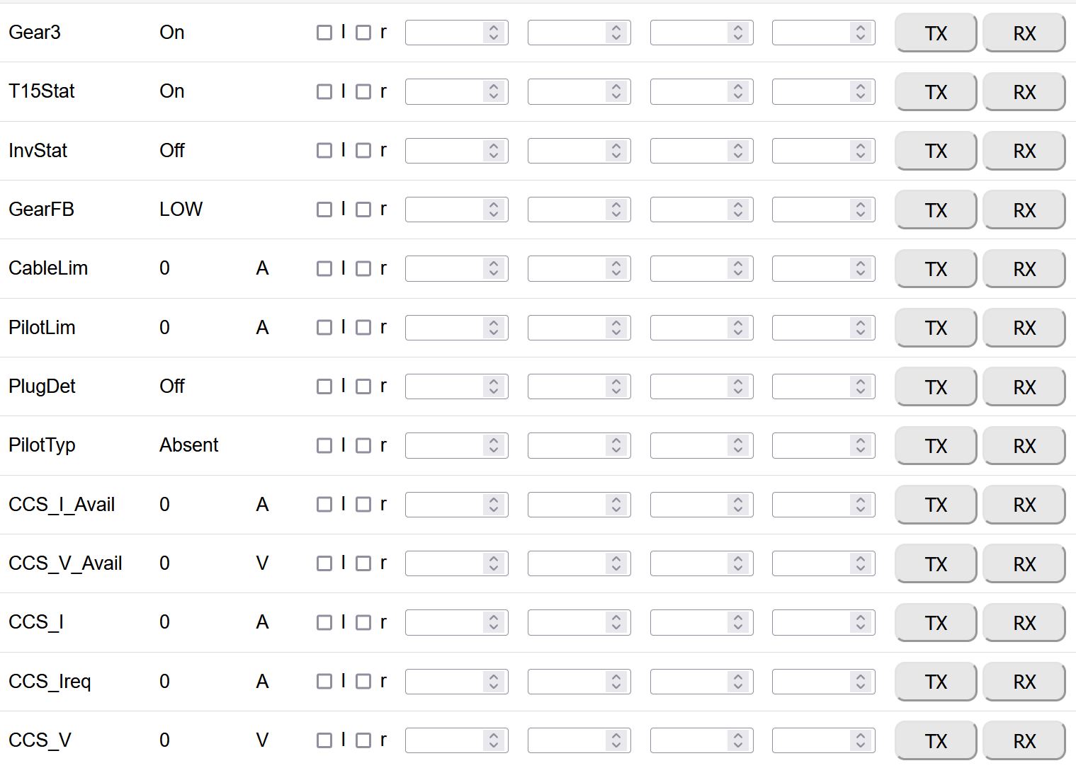

Not really asking a question here, just sharing for info...as I scratch my head a little more. Zombieverter is just playing with me
Looking forward to the new GS450H videos to see if something clicks.
So following Damien's post earlier in the week, I loaded up the binary from the link he posted and did a quick test with my GS450H setup. For the first time there was a whine from the inverter/gearbox, InvUDC was reading correctly, I could plot a torque curve (0 to 1000, where all previous binaries didn't give me any torque plot), InvStat never changed to 'On' though. Selecting fwd or rev, and pressing the accelerator pedal the gearbox would rotate a little but I was using a cheap 60V 3A or 5A supply that tripped out. I noted 'regen'travel' was set to 30% so figured I'd to a new test changing that to 0% and change over to some 12V batteries in series for the HV.
Forward to the weekend, swapped out the PSU for four 12V batteries, changed 'regentravel' to 0 and 'udcsw' to 30 from 50 for the lower voltage and tried to retest...no whine, no rotation, some head scratching. Contactors all working ok as before, 48V or so at the inverter HV input, almost 12V at the inverter power connector, and no data from inverter in web interface, looking like inverter is not powered on (InvUDC = 0 etc). Can plot pot values but zero's for torque and potnom plots. Back to the old behavior somehow.
So I tried a number of things to see if it was a sequencing thing for inverter power up, manually applying brake signal to vcu in different orders, etc, trying to mimic my test earlier in the week but don't see that I'm doing anything different and don't see any issue with the wiring. The setup still allows me to swap in the GS450H VCU, so powered it up and everything runs as it should and the whine coming from the inverter/gearbox, gearbox turns fwd and rev. So with the system powered up and in gear, I disconnected and reconnected 12V inverter power to see if this break in power shuts down the inverter until a restart or something (ruling out zombieverter and inverter power issue), but system kept working as normal once 12V applied again. Tried same disconnecting and reconnecting MTH and HTM, and the system just picked up where it left off and gearbox would still rotate. Tell's me that once the inverter is getting 12V power and has HV at its inputs, it should be spitting out any data that's needed, so is it just that the Zombie is not bothering to read it for some reason.
- Posts: 4000
So I observed something like this on the bench myself just yesterday. If you set invtype to gs450h, save power off and back on you would expect it to work. Sadly not so. We have another bug in there that stops the clock oscillator starting at power on if a toyota inverter is selected. As a bodge work around, power on, goto web interface, set invtype to leaf gen 1, then back to gs450h and I bet you get a whine:)
Hope to bash out the toyota bugs this week and write an IS300h module.

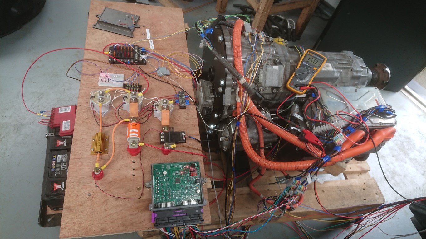

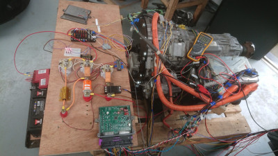

After doing this, got my tranny to turn for the first timeJack Bauer wrote: ↑Sun Aug 14, 2022 1:49 pm So I observed something like this on the bench myself just yesterday. If you set invtype to gs450h, save power off and back on you would expect it to work. Sadly not so. We have another bug in there that stops the clock oscillator starting at power on if a toyota inverter is selected. As a bodge work around, power on, goto web interface, set invtype to leaf gen 1, then back to gs450h and I bet you get a whine:)
86elcamino
- Posts: 64
- Joined: Thu Apr 15, 2021 12:06 am
- Location: Lake Jackson, Tx
- Has thanked: 6 times
- Been thanked: 3 times
After hooking up to 60v worth of batteries, the transmission will spin nicely in forward, then without changing any settings, the next press of the throttle will spin the other way, not as well. In reverse, it won't spin at all, while juttering a little, and whining. This is the same whether it is in high gear or low. Any ideas?
