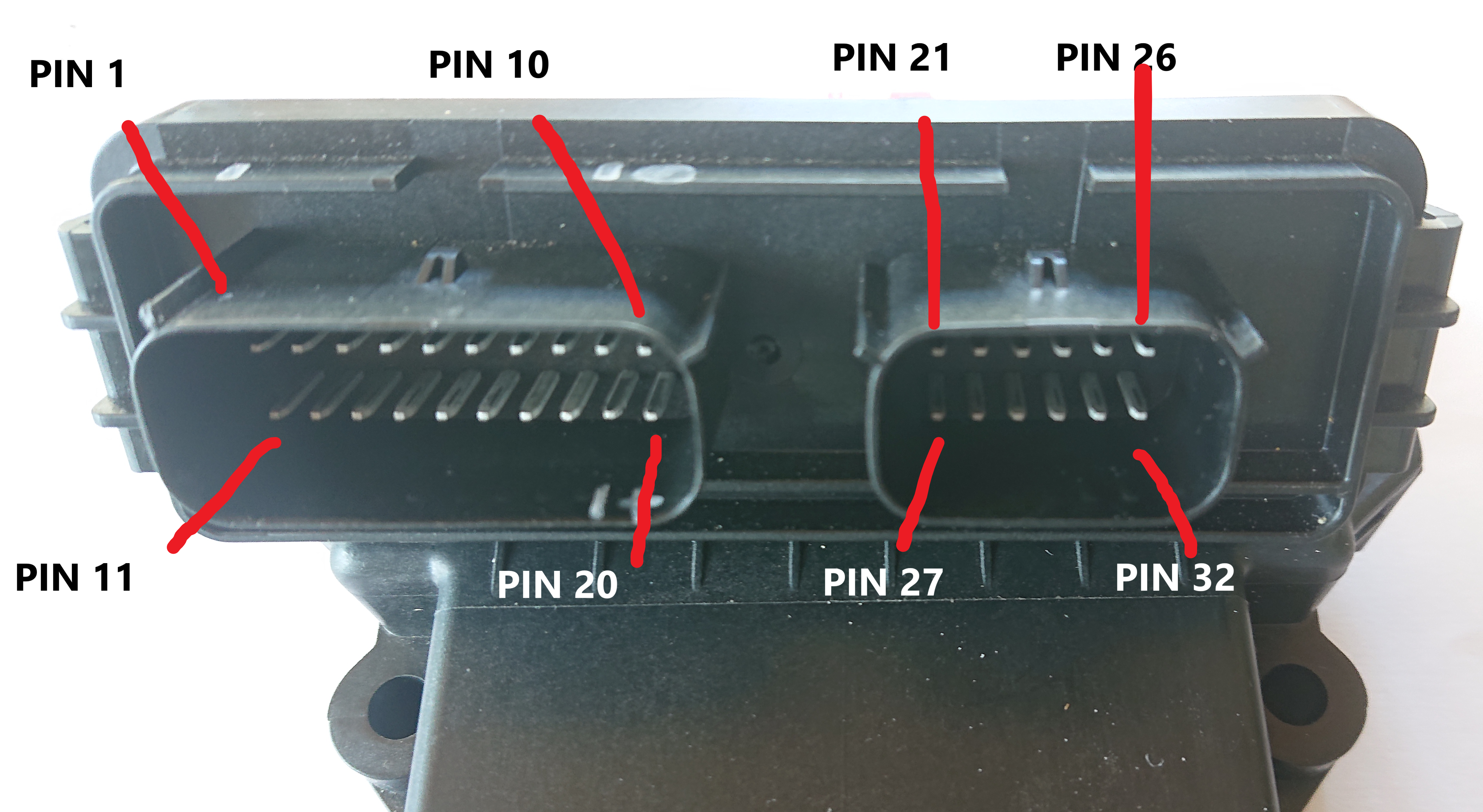

I added the internal wire colors to the Wiki, but could not figure out the process to add another column for the external colors, which are different.

Cannot seem to load this file to wiki, or forum with a compter, so here it is with my phone. Feel free to replace the wiki one which is corrupt.

Thanks, I can confirm there is a nice little picture now

Can someone add a second wire color column to the "32 Pin Inverter pin mapping" table for the external Inverter wires? I have all the colors, but completely fudged up adding a column for them.
Time for ICE Melt
- Posts: 1081
- Has thanked: 478 times
- Been thanked: 308 times
I haven't contributed anything in a long time. Or worked on my own car in a long time.
https://openinverter.org/wiki/Toyota_Pr ... in_mapping
Today I:
- Updated whoever wrote the colors as abbreviations and wrote them out fully (anyone who doesn't have this memorized might take "B" to be Black, Blue, Brown, "G" to be Green or Grey, etc. Can't get confused if the words are there).
- Created two new pictures of the top and bottom of the inverter-side plug, numbered the pins right on the image so you can't get confused.
- Added an extra column for Zookeeper as requested.

I used the Toyota wiring conventions, so if anyone looked it up, everything matched. Nicely done on the I-10 connector!!!
Thanks, I will add the external colors ASAP.
