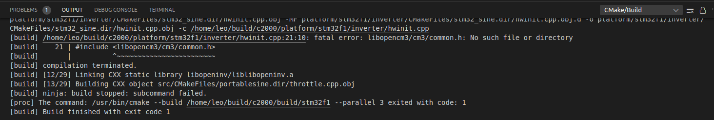

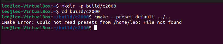

Hi guys,
I'm new to the project and I'm having some issues with the software.
We want to install the Tesla motor in an Evum (a small commercial vehicle from Germany). In addition, he should then be converted to the off-road version with a roll cage, etc. This is not a problem, but none of us are software professionals...
We bought the JTAG adapter board from the evbmw shop and are now having problems copying the chip. I'm working my way through davefiddes' guide on github. However, we are currently already stuck on the build process.
I downloaded the github files and saved them in the created c2000 folder. However, when you run
always the following error message (image 1).
Before that I had compiled the libopencm3 file for STM32 in VS code (at least I hope the output is in picture 2)
I would be really grateful if I could possibly help me on the jumps.
Thanks very much

My c2000-inverter project as it currently stands is not a functional inverter. If you attempt to run it on a Tesla Model 3 drive unit it is trivial to brick the drive unit and render it completely inoperable. Once bricked it is impossible to fix at this point in time.
Damien is working on an alternate logic board based on the existing STM32 inverter software which may possibly produce a working solution sooner. This project is still in its very early stages.
If you must use a Tesla Model 3 drive unit I would highly recommend using one of the commercial solutions from Ingenext or EV Controls.
An Open Source hardware and software solution will emerge eventually.
