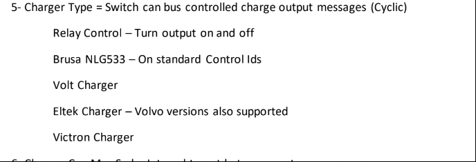

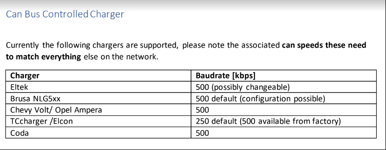

Quick question.
Which option should I select for the SimpBMS to control (ex. tell it to start/stop charging) Elcon charger via CAN bus?
Snapshot from ‘e’ Charging Settings: Here it says TCCharger/Elcon are supported via CANbus...

Re: Simp BMS
Manual is out of date for some parameters. There is the option for the Elcon / TC Charger available.
Charger Type 4 is what you want to set it to.

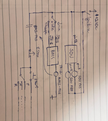

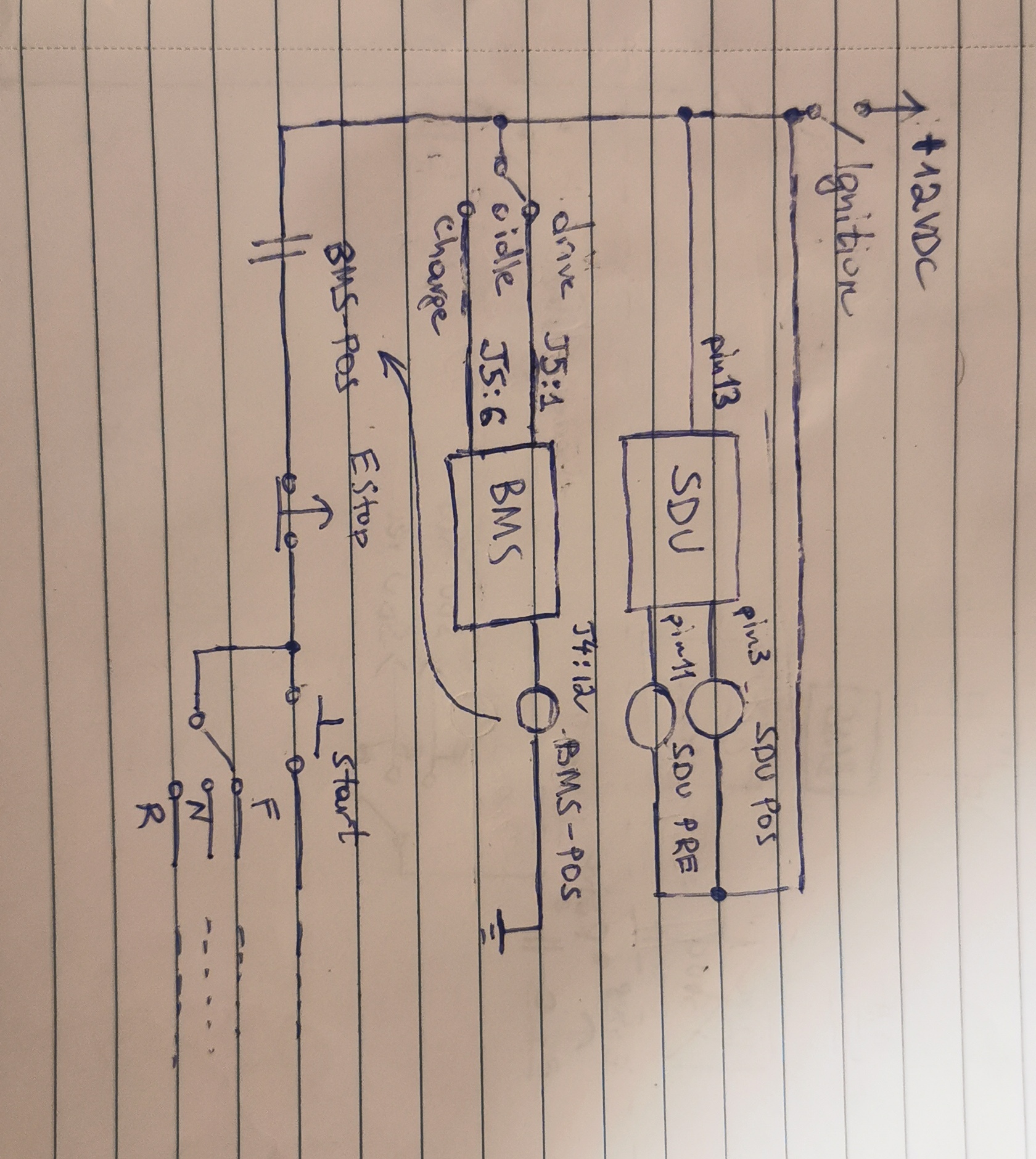

A little sanity check please.
Is this a correct way to go for, when Tesla drive (SDU) controls the main contactors - SDU-POSitive and SDU-PREcharge for both drive/discharging and charging. SimpBMS interlocks the SDU via the Start, F-R-N signals? SimpBMS will communicate with the charger via CAN.
Is there a minimum switching time between J5:1 (key on) and J5:6 (charge enable)? Planning to use a 3-position switch for now. Assuming that when the car is charging, putting the switch into Idle possition will make BMS tell the charger to stop charging.
Sorry if my questions are much too obvious...
Thanks in advance
Thanks in advance

Re: Simp BMS
The diagram is fine, it will disable the SDU from working due to no gear signals, just make sure you set the signals to switch (12V) and not button (momentary 12V)alexbeatle wrote: ↑Sun Aug 27, 2023 4:00 am Is this a correct way to go for, when Tesla drive (SDU) controls the main contactors - SDU-POSitive and SDU-PREcharge for both drive/discharging and charging. SimpBMS interlocks the SDU via the Start, F-R-N signals? SimpBMS will communicate with the charger via CAN.
It is fine to use a switch to change between them. It checks the inputs continuously.alexbeatle wrote: ↑Sun Aug 27, 2023 4:00 am Is there a minimum switching time between J5:1 (key on) and J5:6 (charge enable)? Planning to use a 3-position switch for now. Assuming that when the car is charging, putting the switch into Idle possition will make BMS tell the charger to stop charging.
