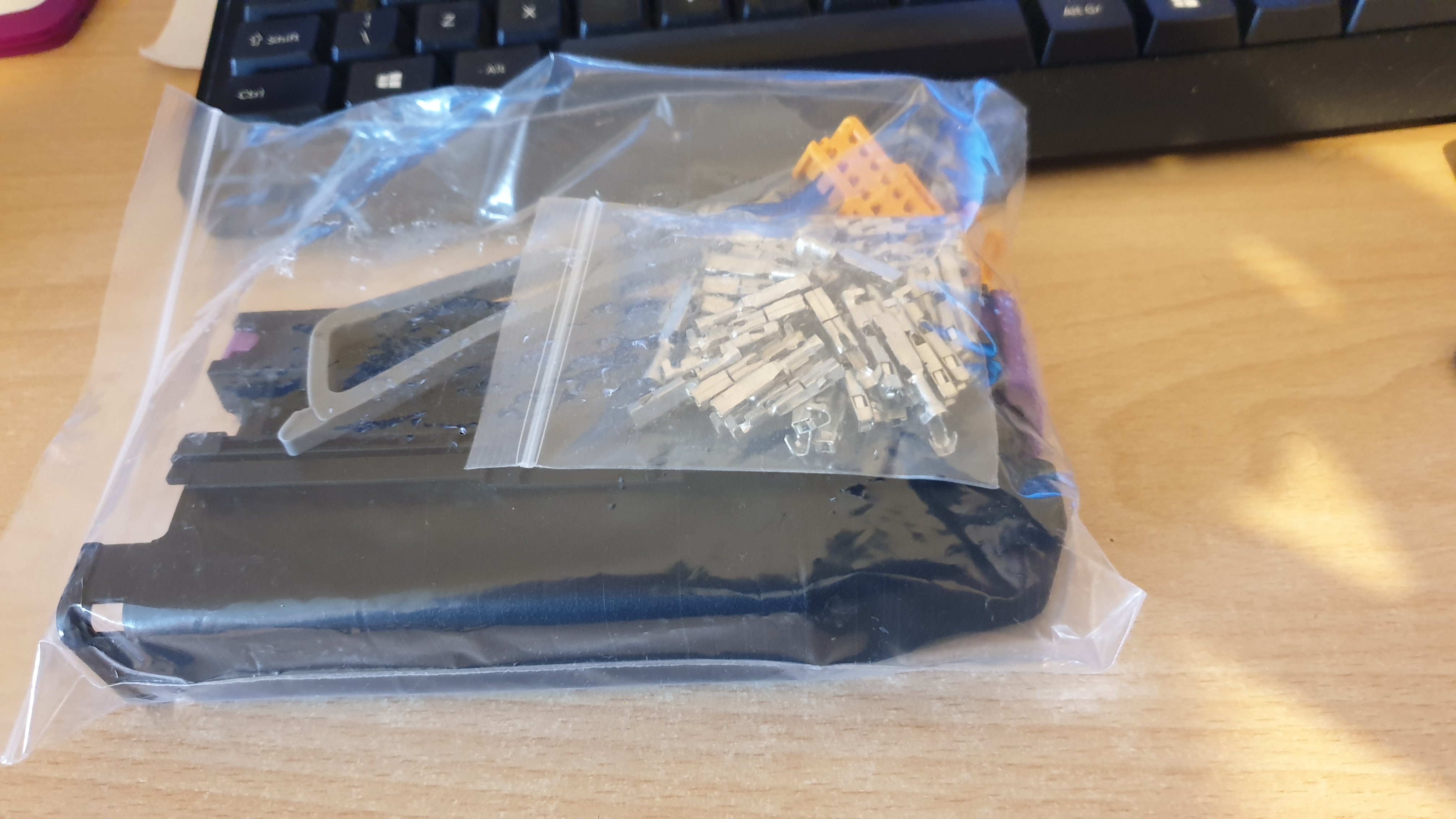

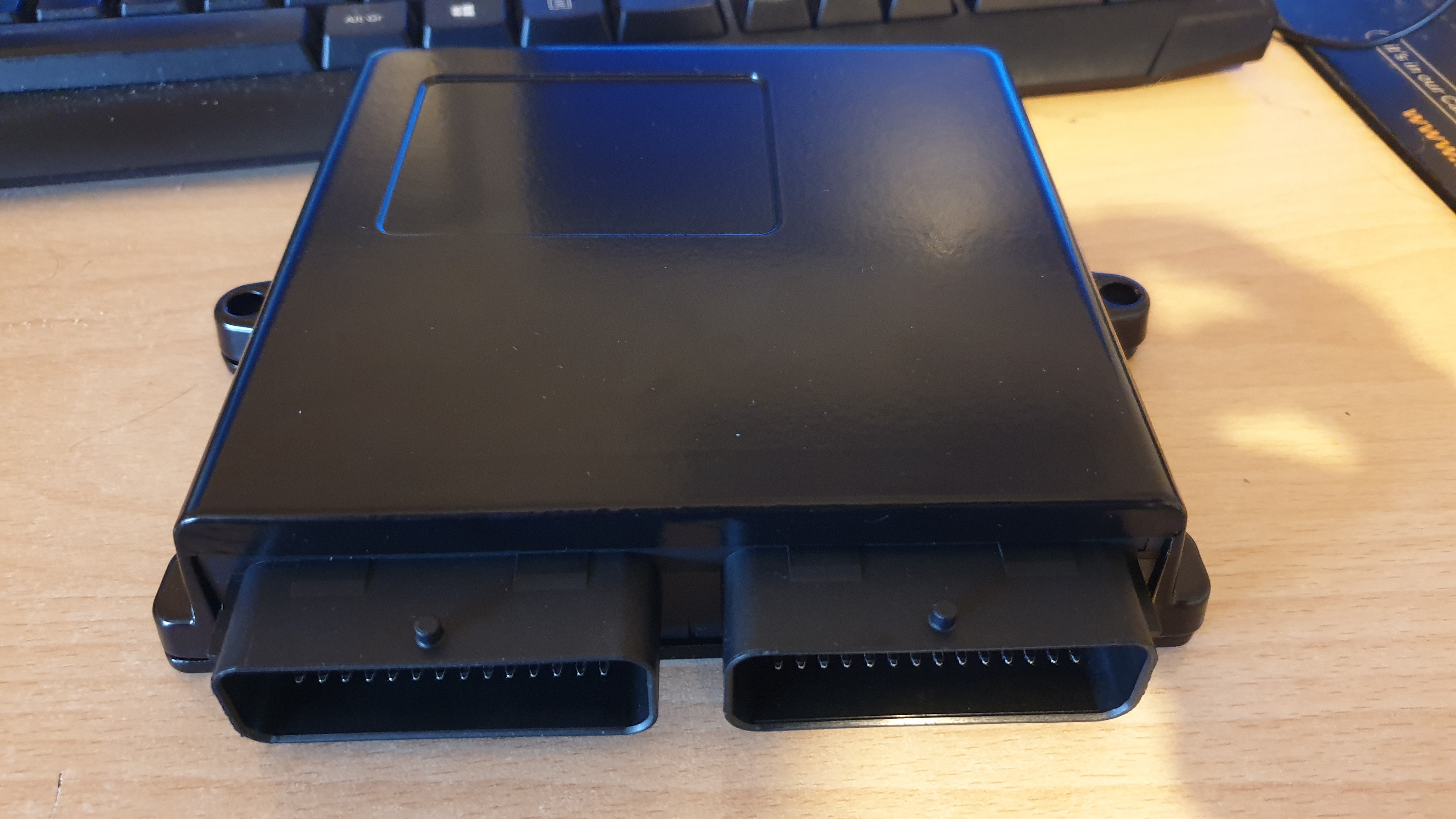

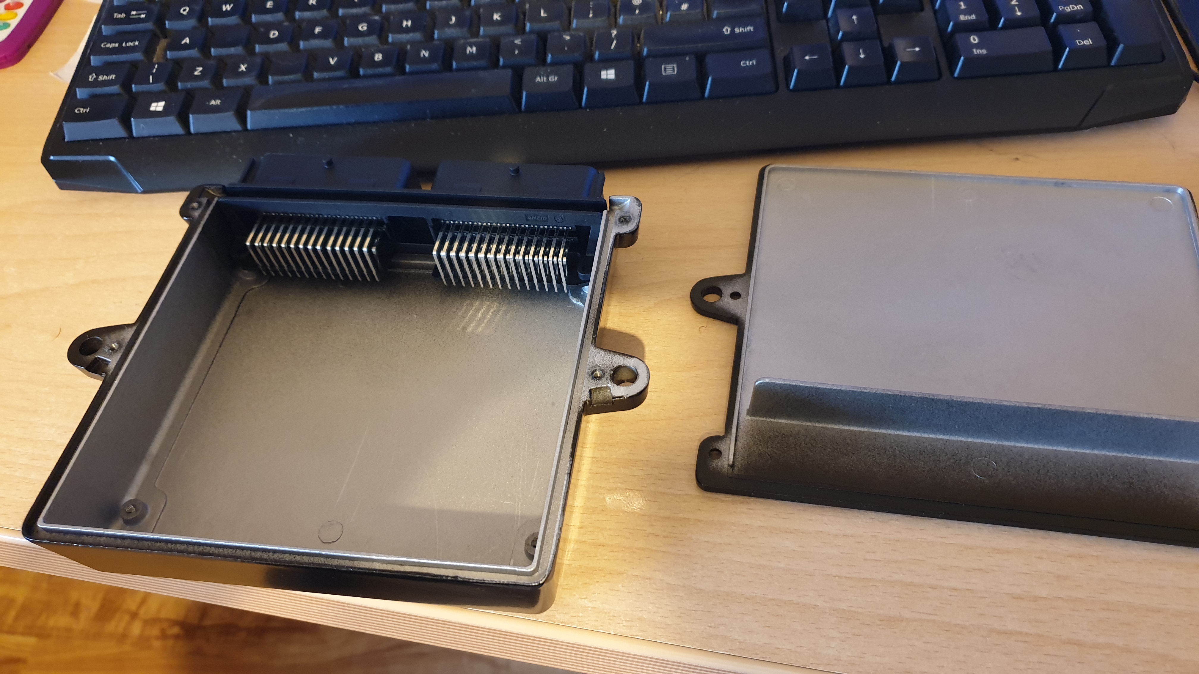

- Posts: 4000
- Been thanked: 1115 times
Enclosure kit arrived and looks great. Looks like the board mounts to the 4 corners via m3 screws. I'll go ahead and order a few more from the seller to have available when boards arrive. I may end up migrating all the projects to this enclosure and connector as the ME-MX stuff is getting very hard to source and expensive.
