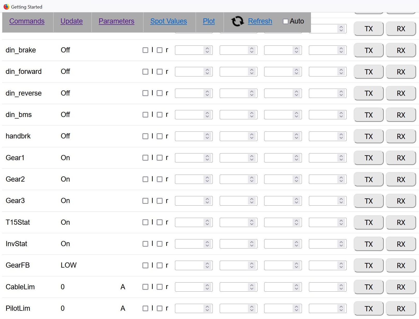

I've been doing a little more troubleshooting on my Zombie/GS450H setup. Still no motors turning but learned something about the INVstat.
I've updated the firmware to the file Paaa shared (thank you again Paaa
), tested with and without brake pedal pressed as up to now I was testing without brake pressed and wondered if brake signal is required to allow system to start up. I've also tested with Vehicle set to both 'none' (using my standard car T15/start signals) and E65 (inputting T15 and gear selection via CAN from an arduino). I've also checked and double checked my wiring again and continuity between the relevant CAN transceiver pins 6 and 7 and the inverter control plug pins. All still seems ok but still no motor turning, and really it seems its the inverter not turning on that is the issue.
What I have noticed is that INVstat does actually change to 'On' when the ignition on signal (T15) is present and before the start signal is received. I can hear the clunk I mentioned in the posts above when I switch 12V power to the inverter. Once the start signal is received, the contactors sequence as expected, HV is present at inverter, Opmode turns to 'Run' with no errors, but now INVstat changes back to 'Off'.
So it would appear something is triggering the inverter to switch off again. If I can see the INVstat changing from 'Off' to 'On' at T15, is that coming from the inverter comms (I'm hoping its that MTH is good data as per the GS450H VCU rather than just a firmware code thing)? Which would mean comms could be ok? What are the things in the firmware that change INVstat to 'Off' so, is it some errors, sensor readings, data issues?

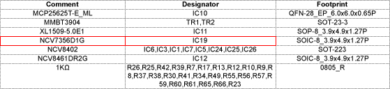

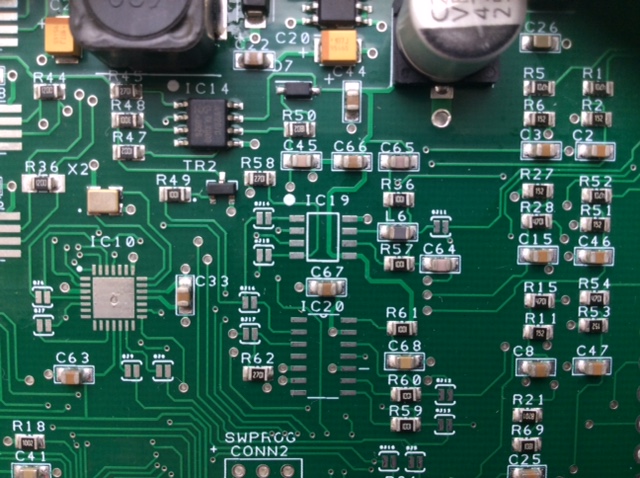

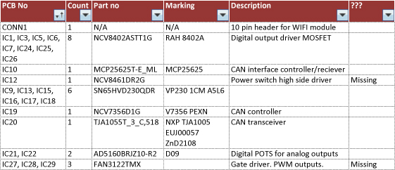

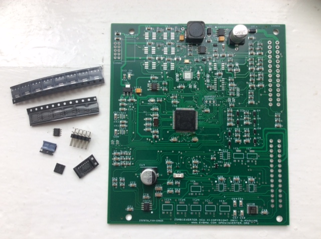

Apologies for the longish post but for those of us receiving their Zombie boards in this time of chip shortages (especially if you’re as scared of the electronics side of things as I am) I thought I’d share how to make sense of the bag of loose components that comes with the board. From Damien’s Github repository ( https://github.com/damienmaguire/Stm32- ... are/Zombie ) download the Bill of Materials (BOM) file and the schematic file:
Also get a powerful magnifying glass to read the markings on the components.
The component locations are marked on the board with a white rectangle and an IC number. This example shows the location for component IC19 in the middle of the picture. In the Bill of Materials spreadsheet find the IC number in middle column, then read across to the first column which gives the part number. Use the magnifying glass to read the markings on the components until you find the one which, sort of, matches the part number. I say ‘sort of’ because none of mine were an exact match. For IC19 the part number is NCV7356D1G and the component was marked V7356 PEXN. I decided that was a close enough to ID it.
The middle column of the spreadsheet also shows where the same specification component is used in multiple locations. To find out a bit more about the components look at Damien’s schematic and use the part number to search one of the online electronics stores such as mouser.co.uk
Through a process of elimination you can find out where the loose component go and which, if any, are missing. I put all this into a spreadsheet to hand to the guy who’ll be populating my board for me.
