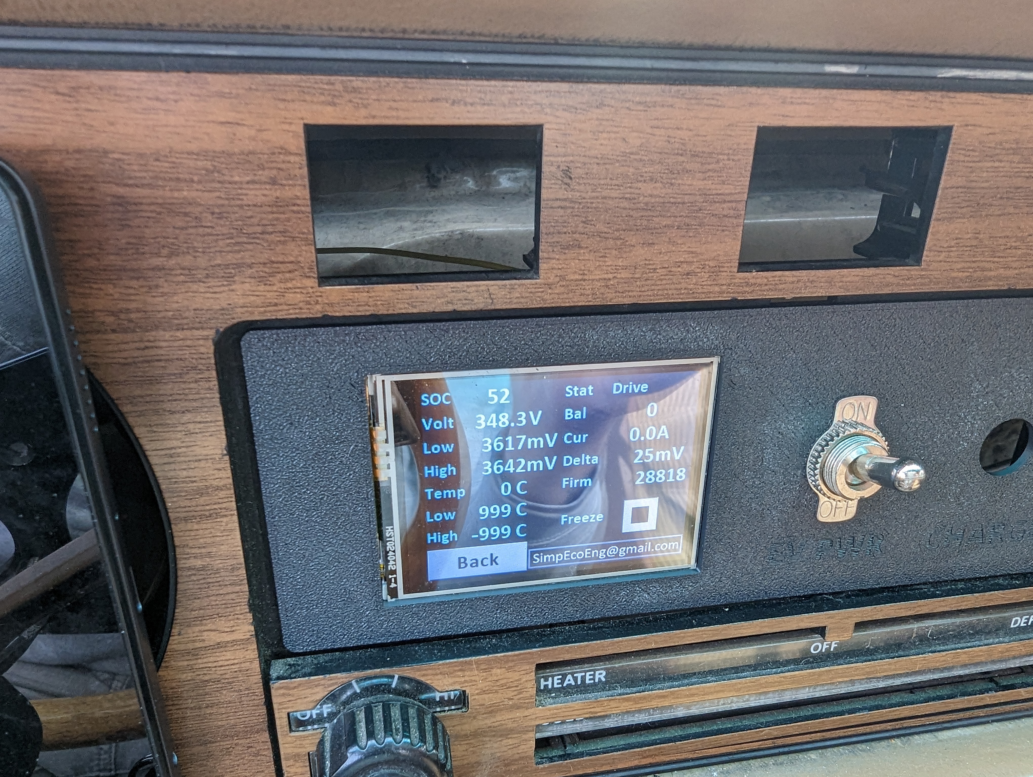

New challenge is figuring out why the nextion display only updates data when it's power cycled. The SoC doesn't change but the voltages do. So while i'm driving I have to watch voltage to see SoC.

Re: Simp BMS
Okay that is weird as it does get broadcast as you can see the voltage change. Can you confirm which display file and SimpBMS firmware you using?

I purchased the setup through kitoffgrid like 2 years ago and haven't updated any firmware. I'll take a look and maybe record a short video when I get home.

it's hard to see in the video, but the display is V1.0.0
video shows the key cycle that updates the SoC meter. The photos are the SoC and voltage prior to trip.

Re: Simp BMS
Please update the BSM firmware according the instructions in the end of the user manual: https://github.com/Tom-evnut/SimpBMS/bl ... 0V0.29.pdf
Alot has been updated since the firmware version 28818
