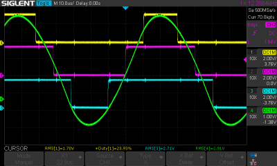

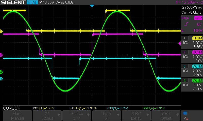

I also made good progress today though a lot more theoretical. Got the resolver exciter code finished and synchronised with the PWM generation. Gave me a trace like this:
This shows the 3 main phases (with static 25%, 50% and 75% duty cycle PWM - high-side drive for reasons) and the exciter output on the wiring harness all perfectly aligned. The exciter output is reduced a bit by running at 12.2kHz (2.24V) rather than 10kHz (3.17V) but I'm hoping this should still be enough signal to provide an accurate position. Next stop for me is getting the analog capture of sine/cosine and phase currents going.

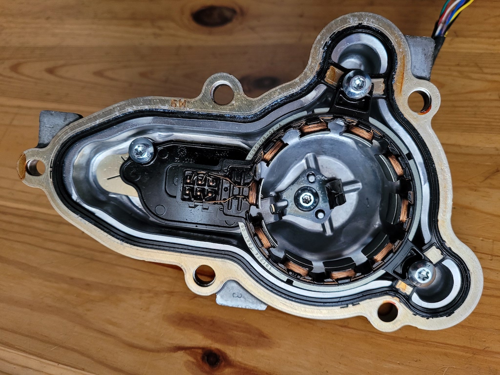

I have two of questions about offsets:
1. The Tesla resolver is not a rotating exciter but a fixed one. There are 10 equally spaced coils in a ring. I can't tell which are exciters and which are the resolver and how they are connected.
- 10 gives only odd combinations of e.g. 2 exciters and 2x2 resolver?
- This combination should do something with the offset?
- Also a bit uncertain when the exciter sinus current peaks should cause max resolver current.
2. What sampling window wrt the exciter sin wave? I guess symmetrically around it's max?

That's the key bit of information. The odd (sinusoidal) shaped rotor acts as a variable transformer and couples the excitation to the sine/cosine coils depending on the position.fbo wrote: ↑Wed Feb 23, 2022 10:50 am

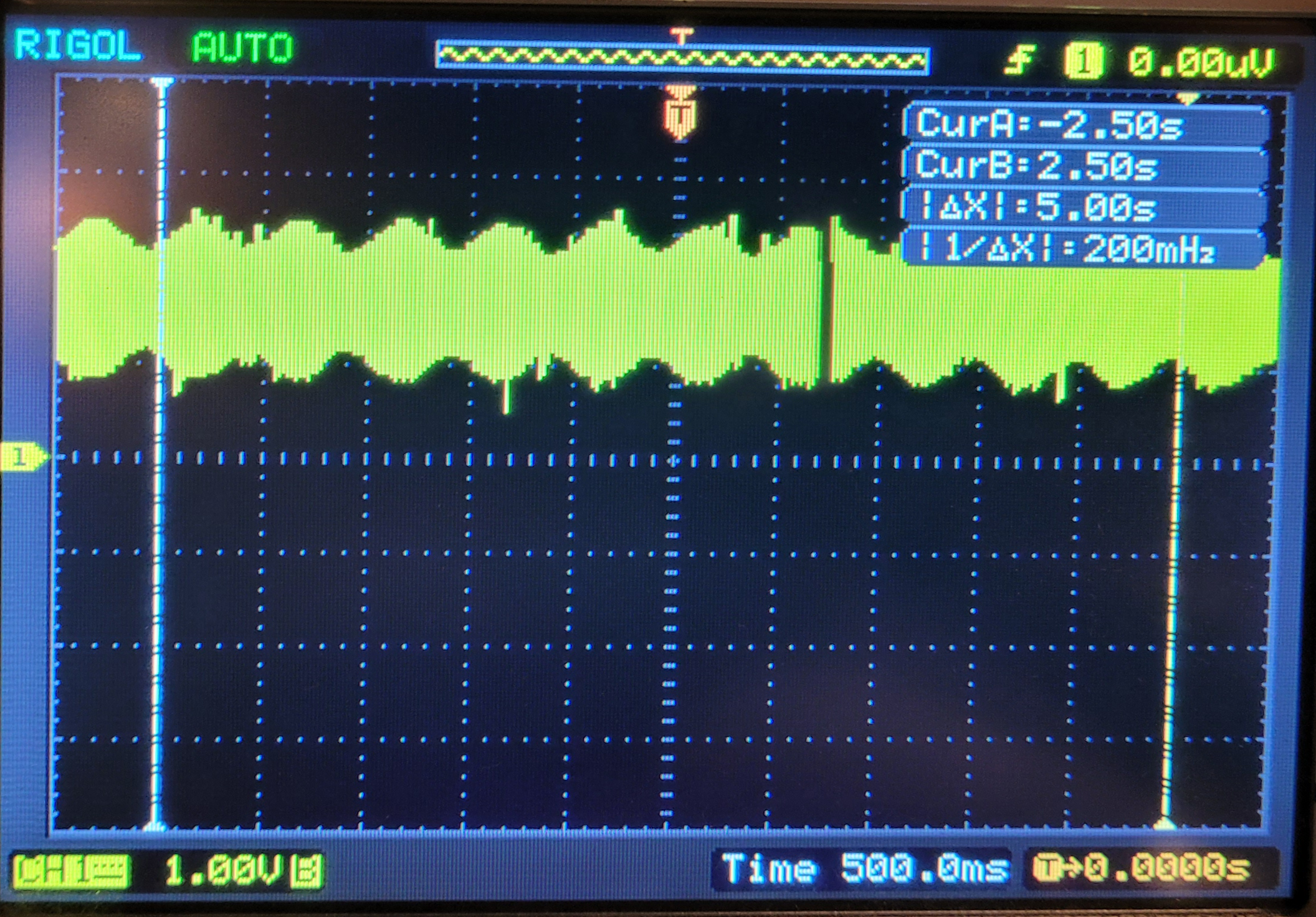

Resolver triggered at 12.2kHz responding to turning engine. Rotor move is by enforced theta (angel input to inverse park clark) stepping at 2*pi/sec, i.e. 2*pi/12.2k every irq - rotor moves much slower like at 2*pi in 16-ish seconds.
Seeing approx 80us sinus wave and the expected "hull" - at about 500ms.
Forgot the gear ratio, so actual rotor is moving about 10x faster. And it is obviously 1sec over entire 2*pi of the hull.

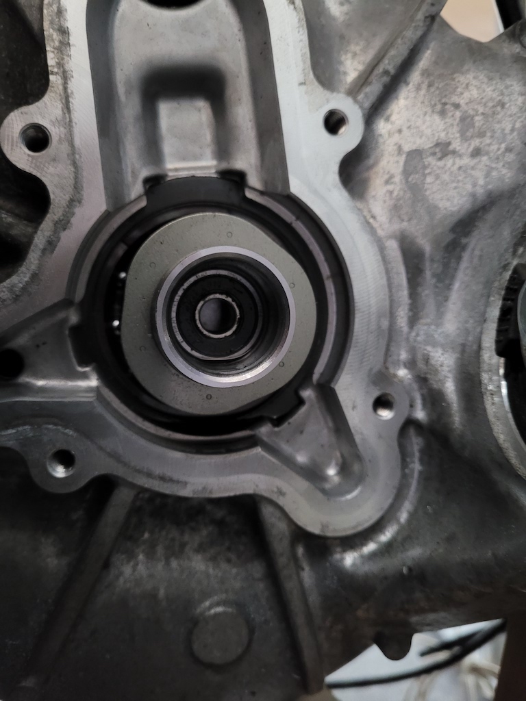

What about the 10 coils though? With the resolver unmounted and sending PWM to the exciter I got a small nail to stick and "sing" on each single coil.

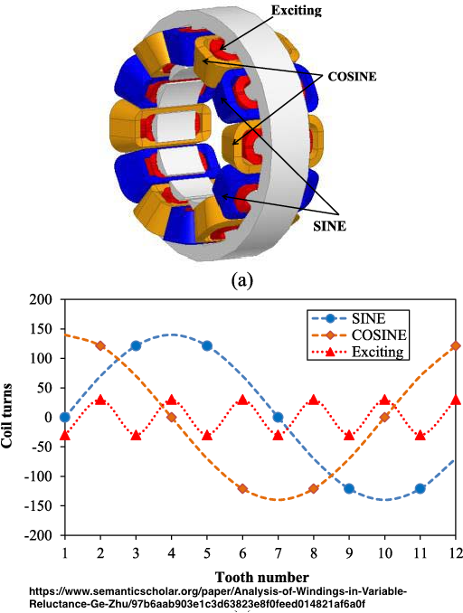

Just sharing this picture.
https://ieeexplore.ieee.org/document/6953227
Exciter and resolver coils are placed in the same tooth! Exciter are in every tooth. Just unclear if the Tesla resolver has alternating sin and cos coils or all 3 coils integrated into each tooth.
1 pic explained everything and more than 1000 youtube videos glossing over actual key info. This one pic contains all the missing information I was lacking for the past 2 weeks to understand how the resolver works. I thought it had to be like that but no evidence found until I saw that pic.
