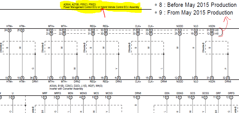

My only idea is to add some RJ45's, which would have things like CAN and the toyota protocol, this would free up pins, but would require the enclosure to be cut for the cable/conenctor. But would allow us to use CAT5 cables, which is really handy for bench setup etc...Jack Bauer wrote: ↑Tue Mar 23, 2021 7:38 am Yep that's the one. I agree re the connector but unless anyone has any other ideas its the only show in town that's available to mere mortals with greater than 40 pins ....
I connected up the Yaris Inverter to the Gen2 motor this morning, and kinda as expected no inverter whine. I did try and see if it would accept a longer THM frame, so went from 100-120 bytes but nothing. So to get the Yaris inverter working we'll need to get some data logged from hybrid yaris. I've a feeling it just needs the init frames like the Auris/Prius one.
In a bit to figure out the Yaris, i had a look at the wiring on the toyota portal, which you can just pay for access by the hour. It looks like depending on when the yaris was made it will be one of 2 ECUs which could be providing the hybrid data! I'm tempted to try source either of these ECUs and see what they send out to configure the hybrid unit on startup....

This looks like one of the Yaris modules:- 89981-0D161

Perfect thanks, that's interesting i wonder have toyota different firmware versions on the yaris on either side of that 2015 production change over. I wonder might we see the same thing with newer Auris / Prius boards too. I just checked my Ebay account and apparently, my unit comes from a 2017 car.
This probably brings up another issue, one which i definitely don't know the answer to, how do toyota flash new firmware to the inverter. From memory one of the times the Auris was in for a service it got the firmware on the Inverter updated (possible some sort of temperature fix). I assume they are using the Async serial protocol as i don't think the Japanese like K-line.
On my setup today I had a minimal set of connections to the inverter:-
