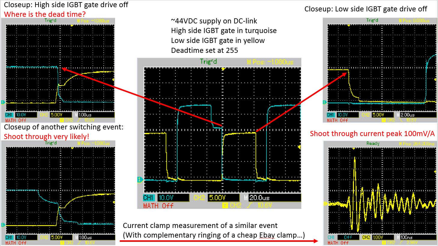

I've continued to investigate the strange behavior of the inverter. The following figure hopefully sheds some light on the origin of the issue.
It is a measurement made right at the high side and low side gate of one of the half bridges. Has anyone measured the signals right at the gate of the IGBT from a working inverter to compare?

Your waveforms are indeed mysterious. Especially where the blue line just stays half way (or 2/3 way) active and there is no deadtime. I'm assuming the drive signal generated by the stm32 don't look like this.
I don't exactly remember how I found the 78 deadtime for the gen2 inverter. I think dimishing returns, at some point the current hardly decreased with increasing deadtime so I left it there.
What is the HV current draw with PWM off?

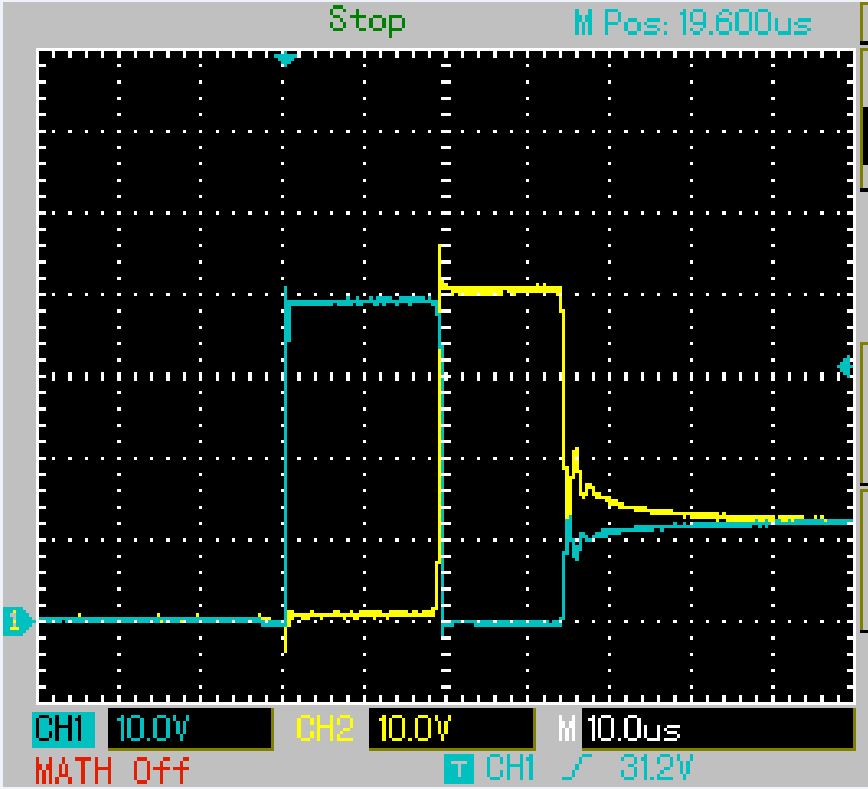

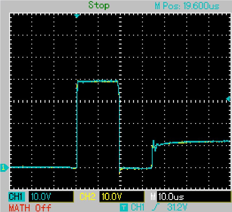

The reason for the strange waveform is quite well explained in this link:
https://electronics.stackexchange.com/q ... e-ic-issue
In short, judging by the waveform, the half bridge is working just fine.
In that same explanation, the writer speculates about the cause of ringing at the switching events.
In his view, during the dead time, the inductive energy stored into the stator coil creates a resonance tank with the parasitic capacitance within the half bridge output. Once the dead time has passed, the resonance energy is introduced with a discharge path and quickly levels of.
This got me thinking. What if the IGBT died due to an over voltage caused by excessive ringing during the dead time?
The fatal test run was performed with a small induction motor and the cables where separate, practically all over the place, 2.5mm2 and with around 1m of lenght.

so if you load down your two remaining phases with a resistor, the 2/3 part should be gone?
So maybe too much deadtime is unhealthy as well?

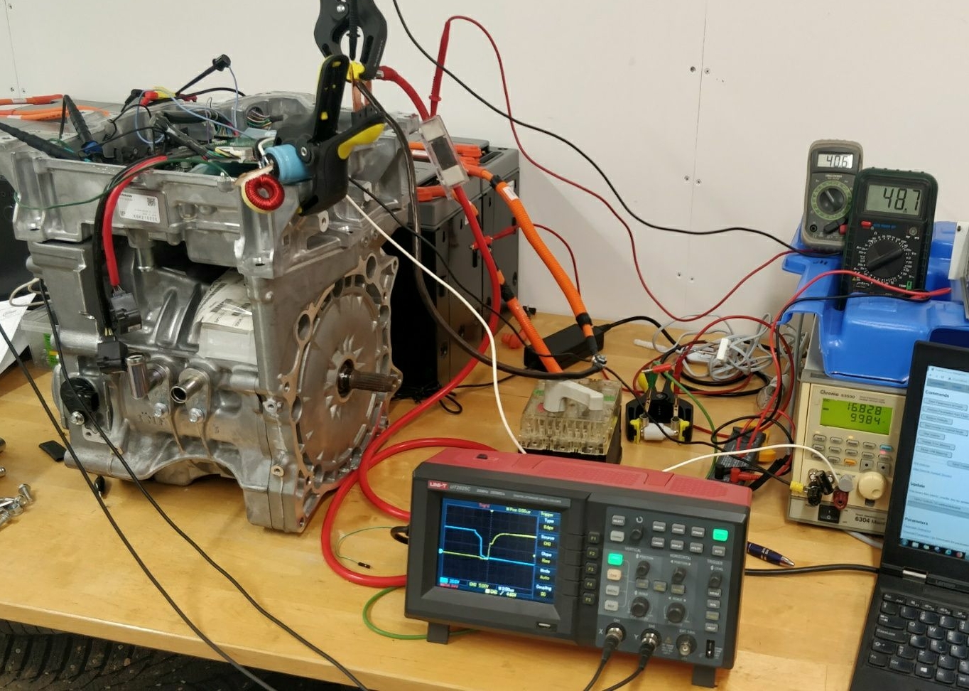

Made some measurements with the single battery module supply.
This time I attached a random toroidal 1.4mH power inductor and a 1000uF 160V capacitor to one of the phase outputs to create a buck converter circuit. Then I loaded the system with my active load with several different current levels.
The setup can be seen in the picture.
The multimeter at the back measures the DC-link voltage. The one in the front measures the DC-link current (10mV/A).
The active load is drawing 10A in CC-mode. Efficiency is 85% and the thin cables are probably inducing a considerable voltage drop.
With 3A loading, the efficiency was 93,6%.
The oscilloscope measures the IGBT gates and as expected, with load on the output, the dead time can be seen at the falling edge of the high side IGBT gate signal.

Much better! How much deadtime now?

Deadtime is 180 and with this setting the unloaded DC-link current is 50mA.
I'll start increasing the voltage next, but this time gradually by adding more modules one by one.

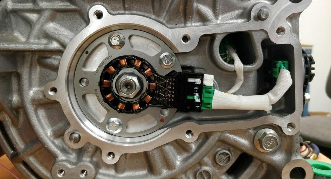

10. The encoder reads correctly. While turning the motor, the angle varies between 0...360 and without turning the jitter is less than +-1.
Everything seems to be correct, but still the reaction of the motor to Id is anything but smooth and current limit is asserted.
Is there a possibility that sin and cos are mixed? I do not know if the system would give any reasonable angle reading in this situation.
My pinswap setting is 0. Even though the connection are correct according to my tests, should I still try different pinswap values?

Kelju wrote: Sat Nov 21, 2020 9:39 pm Everything seems to be correct, but still the reaction of the motor to Id is anything but smooth and current limit is asserted.

About checking the number of motor poles and the correct configuration of the resolver.
Is it so that the angle on the web interface will change 360 degrees as the motor axle is turned one full revolution?
Is it possible that the angle feedback seems to be correct even though sin and cos are mixed?
I need to check how the angle changes in respect to the actual angle of the motor chaft in my case.
Kelju
Posts: 171
Joined: Sat Aug 22, 2020 6:54 pm
Has thanked: 13 times
Been thanked: 18 times
Re: Nissan Leaf Gen3 inverter
Post by Kelju »
I checked the number of poles on the motor by running some current into phase 1 and sinking it through phase 2 with my programmable electronic load. With 8A current, 4 stable "home" positions can be sensed so from that respect the spec of this motor is the same as for the previous models: 4 pole pairs.
Then I continued my testing of the resolver.
With respoelpairs set at 4, I get the angle change from 0deg to 360deg already with 1/4 rotation of the motor shaft. This indicates that the respolepairs should be 16. However, this value does not work. I get a solid 0deg, whenever I have respolepairs set higher than (motor) polepairs.
Is it normal that I get 360deg from resolver when motor shaft only turned 90deg?
I popped the resolver cover open and this is what it looks like:
Posts: 3660
Has thanked: 145 times
Been thanked: 368 times
Kelju wrote: Sun Nov 22, 2020 3:49 pm Is it normal that I get 360deg from resolver when motor shaft only turned 90deg?
You may set resolver to 8 pole pairs and try the motor at 4 pole pairs. Remember resolver works in quadrature mode.
So you may also try using 2 pole pairs on the resolver.
Some motors also have 5 pole pairs resolvers!!! :shock:
Also i noticed that there are some resolvers out there which amplify voltage from 1,6V exciter into 5V on sin/cos outputs. Those do not work with openinverter since signal voltage quickly saturates the input which accepts only 3V3. Try scoping the resolver sin/cos wires so you can see what is the max voltage return.
Posts: 6968
Has thanked: 454 times
Been thanked: 1771 times
Yes that is what 4 resolver pole pairs means. It is matched to the motor pole pairs. You can see 4 lobes on the core and it looks exactly like the Gen2 resolver. So theres not your problem, respolepairs=polepairs=4
Even with sin/cos swapped you will get angle feedback, just in the wrong direction.

I thought maybe there is something wrong with the motor, so today I tested with a Motenergy ME1304 axial flux PMSM which I had available "off-the-shelf". This motor has a sincos position feedback and the V3 mainboard read the position feedback just fine.
To my big dissapointment the behavior is completely the same! The motor just make a rough click and over current fault is asserted.
I am also still experiencing a strange behavior every time I apply power to the V3 mainboard. After applying power, the stored occurlim value is -100.
If I try to start the inverter at this point even without any voltage applied on the DC-link, occurlim fault is asserted.
If I first set occurlim to over -1000, say -1100, the inverter start normally into manual mode. After this one successful entering into manual mode, I can set the occurlim back to -100 and it starts in manual mode just fine. The same happens with sin FW.
What could explain this behavior? Is it possible that something on the V3 mainboard is damaged? Remember, all the PWM channels, current inputs and position feedback is tested to work...
With the ME1304 connected to the inverter, I measured the phase outputs. The first oscilloscope capture shows the phase1 in blue and phase2 in yellow. The second picture shows phase1 in blue with phase3 in yellow.
According to the captures, Phase1 and 3 are in phase and both connected to DC-link(+) while phase2 is in 180 degree phase shift and driven to DC-link(-).
I had a light bulb in series, so this is why the voltage is only at 10V level after the starting pulses.
