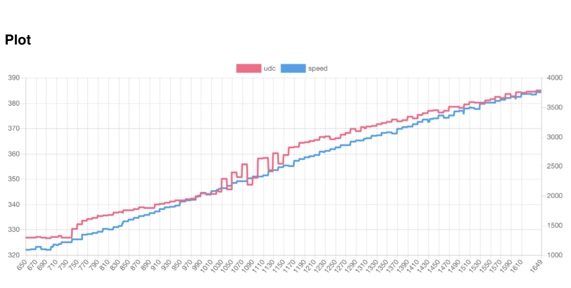

Finally had the chance to try this.
I'd previously done the PCB changes so today I refitted the boost converter and connected the CPWM pin. I've flashed the new firmware and tested with the wheels off the ground. Nothing went pop but I couldn't tell whether the boost converter was doing anything either.
I'm assuming udc should show the boosted voltage? So I would be able to see the voltage increasing with rpm if it was working?
Is it just the three auxiliary pwm parameters that I need to change?
Unfortunately, I'm in quarantine at home having come back from a work trip abroad so can't go out and test on the road until the weekend.

Yes, udc should show boosted voltage and yes those three parameters govern auxiliary PWM. Can you make a picture of your mods?
You can also set pwmgain=0 and pwmofs = 2048 to generate a 50/50% dutycycle (also works outside run mode). Just check if you see this. CPWM must be pulled up to 12V with 470 Ohm. Be aware that with just that, the input is shorted out by the boost converter. Anyway, with PWM running you should see 1.6V at the ULN input and 6V on its output.
Also I forgot the inverse logic in my parameter example. PWM full on means no boost! So set pwmofs=8192 and pwmgain=-0.5 then boost should kick in above 4096 rpm.

Success! :)
Added the pull-up resistor and after some fiddling with parameters the voltage now increases with rpm.
Just need to test it on the road, but that will have to wait until Friday when I’m out of quarantine!

Finally managed to test this on the road. Nothing went pop and the voltage boosting seems to work perfectly, however it doesn’t seem to help as much as I’d hoped. There is definitely a small improvement to acceleration/top speed but there is still a big drop off in torque above 20mph. With full throttle, it still never pulls any more than 50-60 amps DC so a max power of around 15kW.

I’ve done limited testing due to the DC DC issue but it is at approximately 450V at 50mph. I did a quick test with the voltage permanently boosted (not linked to speed) to 480V as well. I know Johannes recommended not boosting at low speeds but this seemed to give the best results, what was the reason for not boosting at low speeds?

tom3141 wrote: Sat Apr 03, 2021 8:15 am I know Johannes recommended not boosting at low speeds but this seemed to give the best results, what was the reason for not boosting at low speeds?
I suspect when boosting at low speeds you are limited by the 20kW limit of the DC-DC converter. When it is not running the inductor just acts as a short and shouldn't be limiting power as much.
