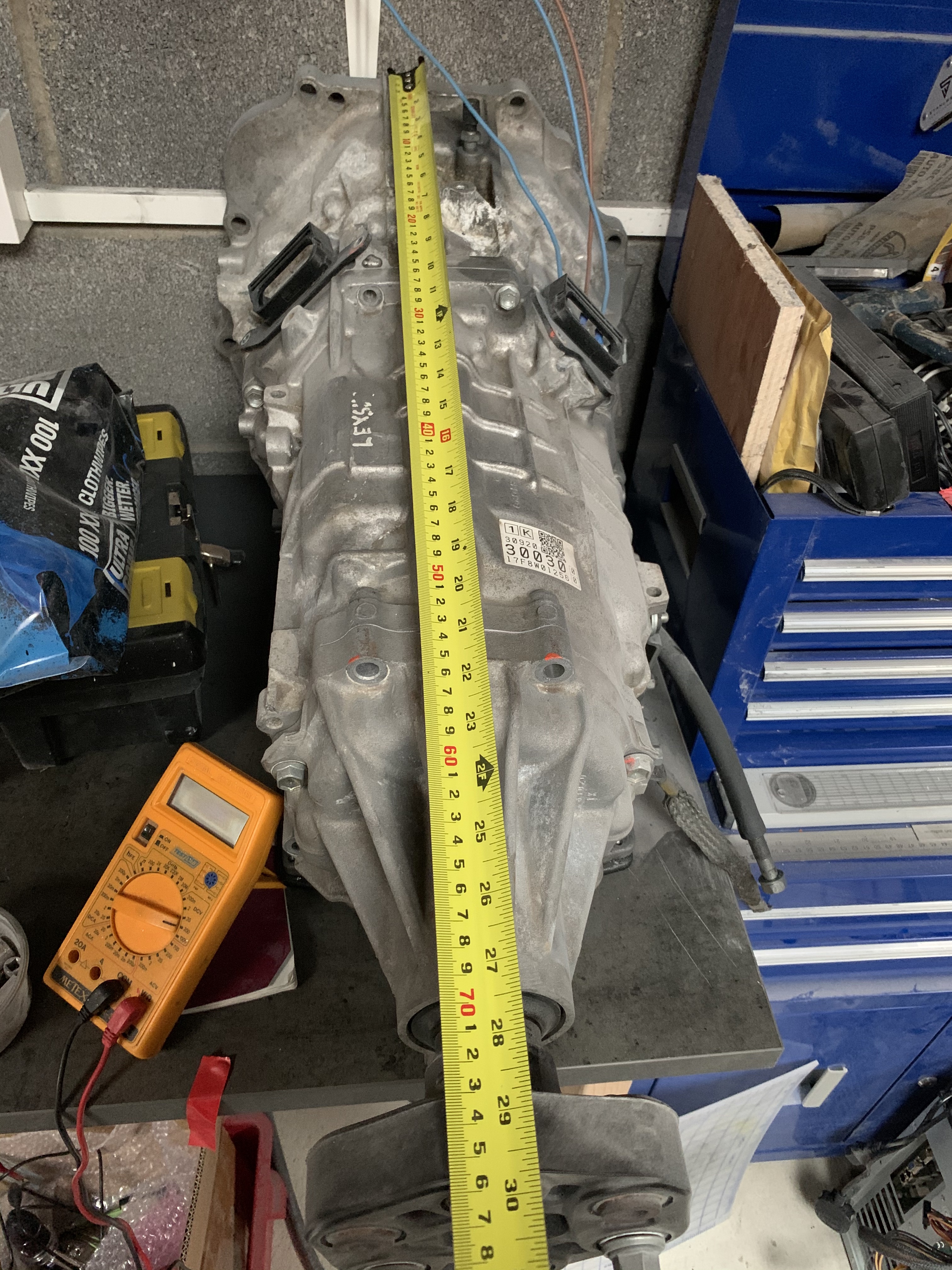

thornogson is there any chance that you could put a measure tape on the L210 gearbox for a rough length, width, height?
This could be a better set up for my project, but I've limited space in the transfer tunnel of my Samurai and I haven't been able to find dimensions online.
Thanks a mill!

thornogson
Posts: 61
Joined: Sun Mar 15, 2020 10:04 am
Location: United Kingdom
Re: L210 gearbox
Post by thornogson »
hugow93 wrote: Thu Jan 28, 2021 7:20 pm thornogson is there any chance that you could put a measure tape on the L210 gearbox for a rough length, width, height?
Thanks a mill!
yes for sure , I'll do it this afternoon, there's a ton of info on the similar L110 box here ... https://slideplayer.com/slide/14432904/

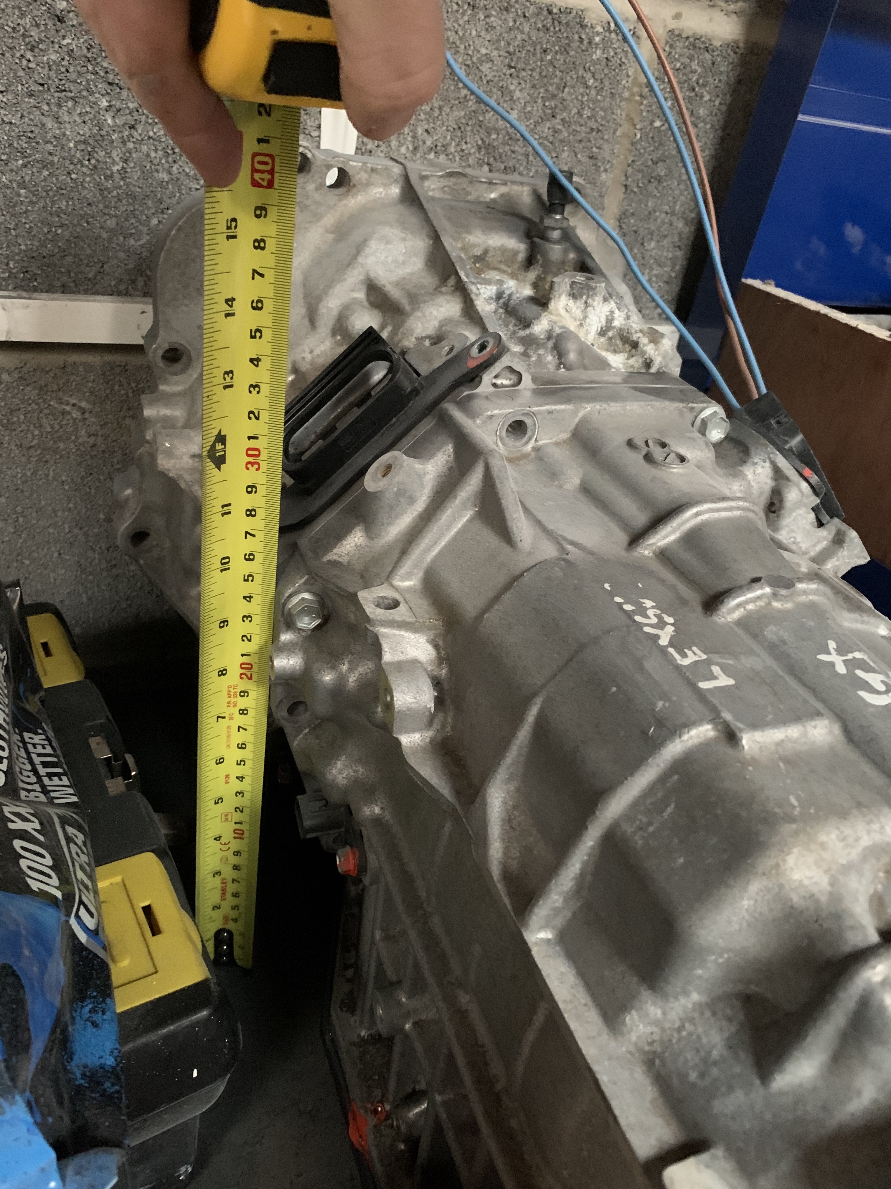

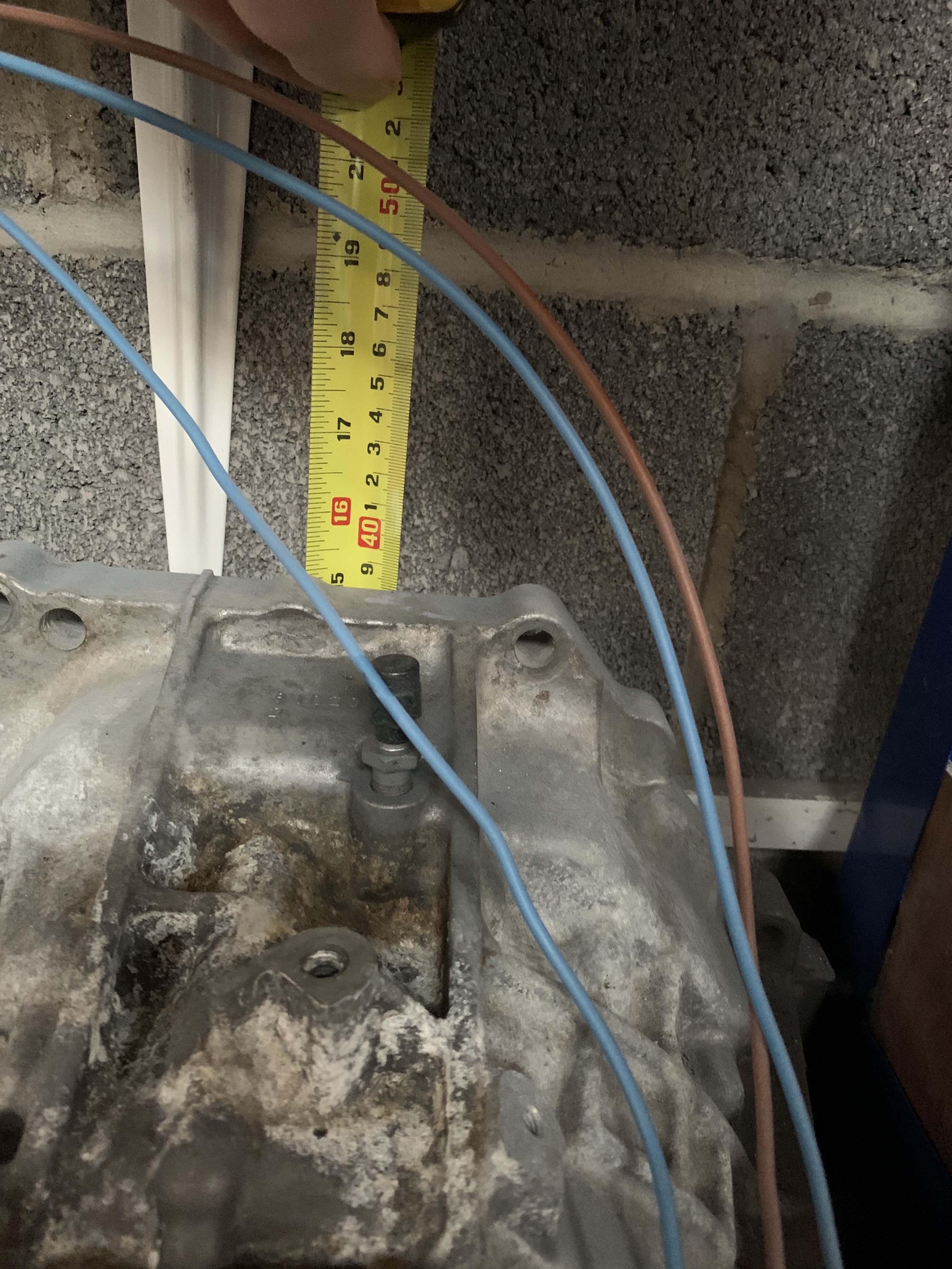

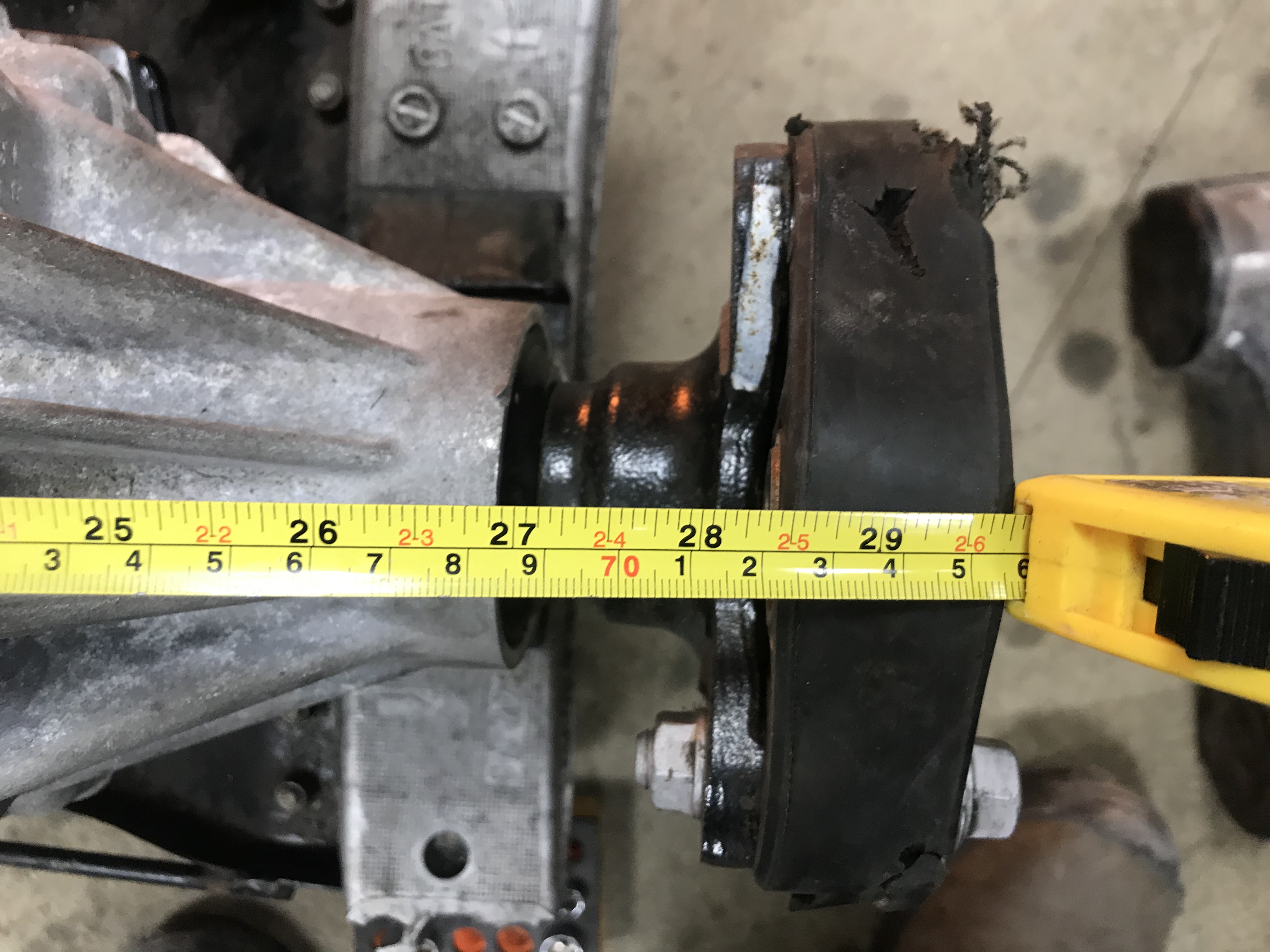

Post by chrskly »
I'm out in the garage today, so, took a few quick measurements.
About 760mm from the bell housing to the output flange (including the rubber thingy).
Height from the oil pan to the highest point on the bell housing is around 400mm
And height of the flatter bit after the bell housing is around 340mm.
HTH

Damn! @chrskly , beat me to it by a whisker , I confirm all those measurements , length from bellhousing to drive flange is 720mm and it weighs in at 92 kg with the rubber thingy and ally gearbox X member.
