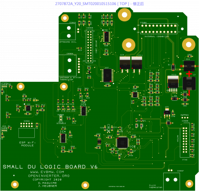

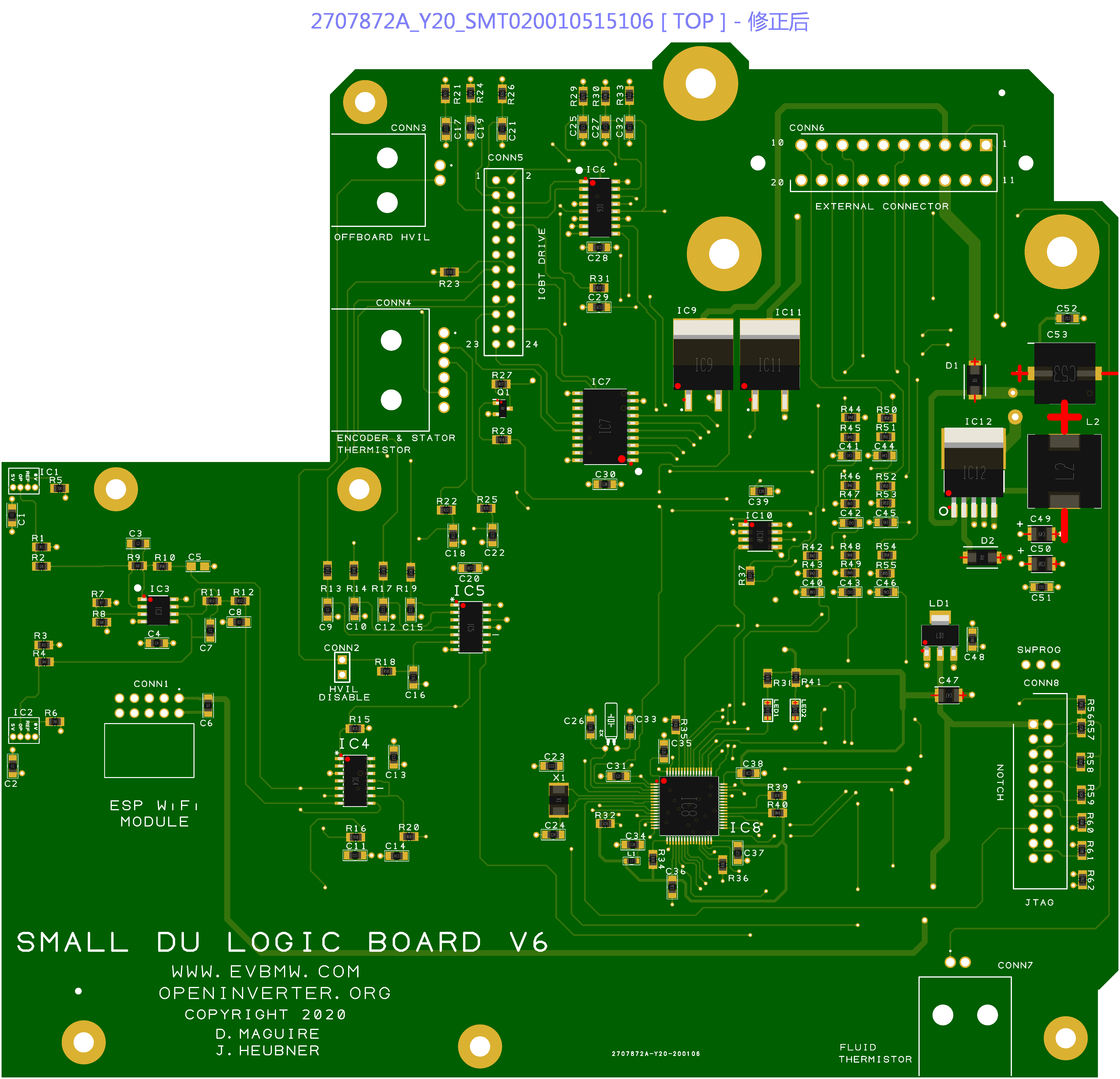

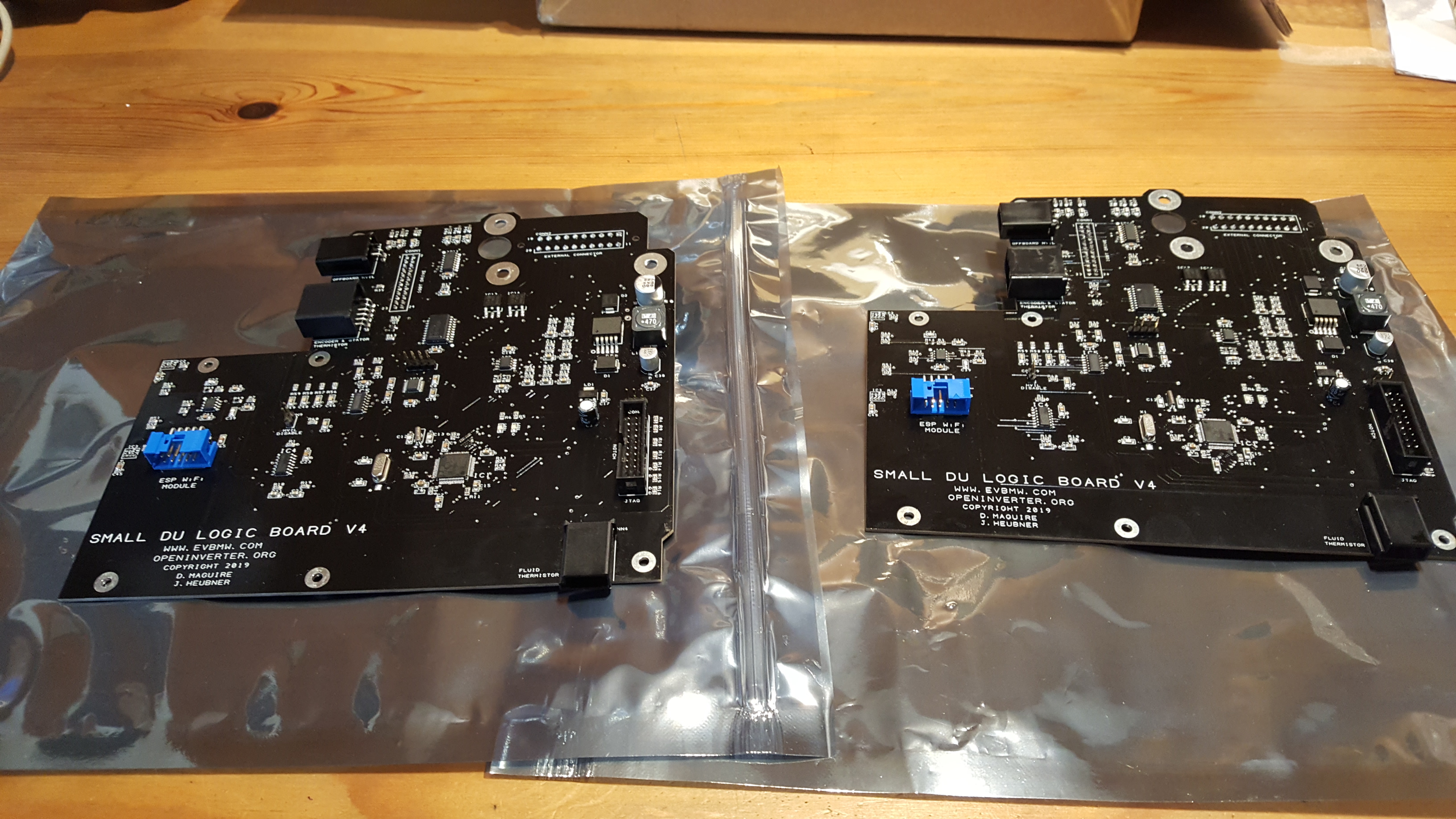

Some good news on board supply. I have now acquired a much more reliable pcb manufacturer here in Ireland and boards will be in stock for immediate dispatch. No more silly delays and boards are being built on an automated smd line so quality is much improved.
- JaniK
- Posts: 404
- Has thanked: 101 times
- Been thanked: 15 times
