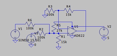

Coming back to Current sensors.
1. Gen 2 inverter has 2 current sensors per ciruit: 2 for Mg1 (Phase V and W) and 2 for Mg2 (Phase V and W)
2. The current sensors are bi-polar - between 15 and 20 volts peak to peak (7.5v or 10v = 0 amps) Is it 15v or 20v, or is it in between these values?
3. V3 board uses these currents (converted to voltage of 0-3.3volts) to monitor over current (set in parameters by user) - only monitor?
4. V3 board has 2 Current inputs (converted to volts) - #pin 6 = II1 current - which means input current between -3v & +3v, AND #pin9 = II2
5. The +/-3v input from #pin 6 and #pin 9 are connected to a circuit in series BEFORE arriving at the V3 board. This circuit is the 'day counter' - example https://www.ebay.fr/itm/Adjustable-3A-D ... 2320889426
6.The MG1 Phase Currents V (converted into voltage) from the Inverter arrive via the 32 pin White Main connecter on pins #2 (GIVA)and #3 (GIVB). Why
2 wires? Is it positive and negative values?
7.My 2cents pea brain understands that GIVA & GIVB would connect to said 'day counter circuit board' in parallel- inputs (15v-20v), and then we set the output reference to 1.65v for input current of 0 volts.
8.If this is correct, we would duplicate the MG2 Phase Currents V via JP7 #pin 9?
9. We don't need or use Phase current W, OR is this where Johannes was talking about 'blending'? Does that mean we connect both MG current sensors in parallel to II1 and II2 respectively?
I hope the answer is not staring me in the face somewhere in the wikis (cause I looked), or I will have to go stab myself in the foot with a blunt object or something...

OK, one more time...
At zero current, the voltage output is zero.
The output voltage changes at 0.025V per Amp.
Output voltage is positive for positive current and negative for negative current.
It's bi-polar, as in the output voltage changes polarity. I really can't think of a way to make the description simpler.

The current outputs are described in this previously referenced source; http://techno-fandom.org/~hobbit/cars/ginv/i3elec.html
The A & B channels appear to simply be duplicates.
As I have previously proposed, the summing amplifier that performs the level shifting to can have a third input added.

So we have the transfer function but not the limits, it isn't possible to design a suitable conditioning circuit without knowledge of the output range.SciroccoEV wrote: ↑Mon Apr 27, 2020 5:00 pmOK, one more time...
Do you know what voltage the output saturates at? Are they 15V p-p or 20V p-p?
The http://techno-fandom.org/~hobbit/cars/ginv/i3elec.html site does not specify as far as I can see, maybe I'm going blind. It is particularly important for FOC to have accurate current data and especially important that the current inputs don't saturate when current is actually still increasing. Crap in equals crap out in other words for the FOC algorithm.
- Been thanked: 1913 times
I would assume +/-600A or +/-15V to be a sensible range. So 30V p-p. FOC doesn't need that good SNR but I agree saturation would probably trigger a current limit.
EDIT: modified your design for roughly +/-15V and two inputs

The linear output range of the current sensors likely exceeds the over current shutdown point of the power module.
Damien has performed short circuit tests to determine the approximate over current shutdown point.
Do I have to connect the dots for you?

"As I have previously proposed, the summing amplifier that performs the level shifting to can have a third input added"
Thanks Scirocco, but this is again over my electronics level. I 'sort of' understand the concept, and the changes Johu has done to your schematics proposal, but above me.
I found a differential summing op amp on Herdware.com, but don't know if it is the 'quick fix solution'. I am happy to pay someone to build this circuit, or let me know where I could find it as standard item and populate myself.
I am currently in position as "sitting duck" after realising that both boards cannot run a motor on its own. The 3 "extra" items require designing or aquiring as standard add ons....Depending on these 3 "extras", the appropriate board can then be ordered. Damiens being through hole, allows for more modifications from what I understand, but V3 is closer to a "tested" compatible solution (without much possibilities to modify once populated).
Glad my questions however have helped Johu to eliminate some wires
Why don't you just build that circuit on your strip board? Dual OpAmp and a few resistors. You can skip the second input, it is only needed for charging. You need to build the circuit TWICE (thus dual opamp) once for il1, once for il2.
EDIT: a solution that would run both inverters will need two mostly independent brain boards/a dual brain board and will obviously loose the ability to charge.

So V3 PWM outputs are 3.3v.
Main inverter 32 pin (MUU,MVU,MWU) require PWM input signals of 12v. This is where the ULN2003 solves the problem - boosts 3.3v to 12v?
Then the circuit for dual op amp receives the MG2 (GIVA and GIVB) inputs from inverter (15v p-p), and sends 0 - 3.3v signal to II1
Am I getting this?
