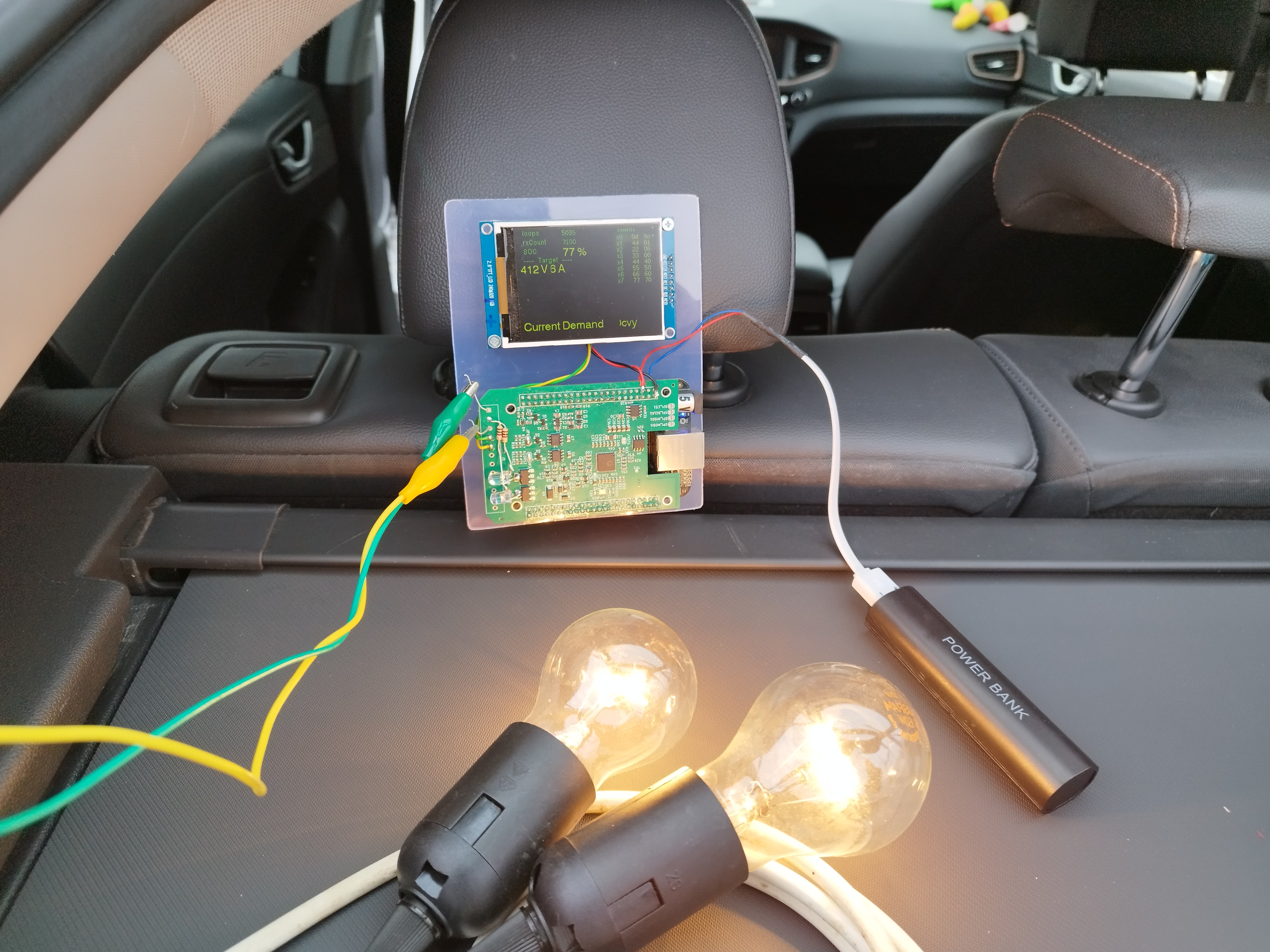

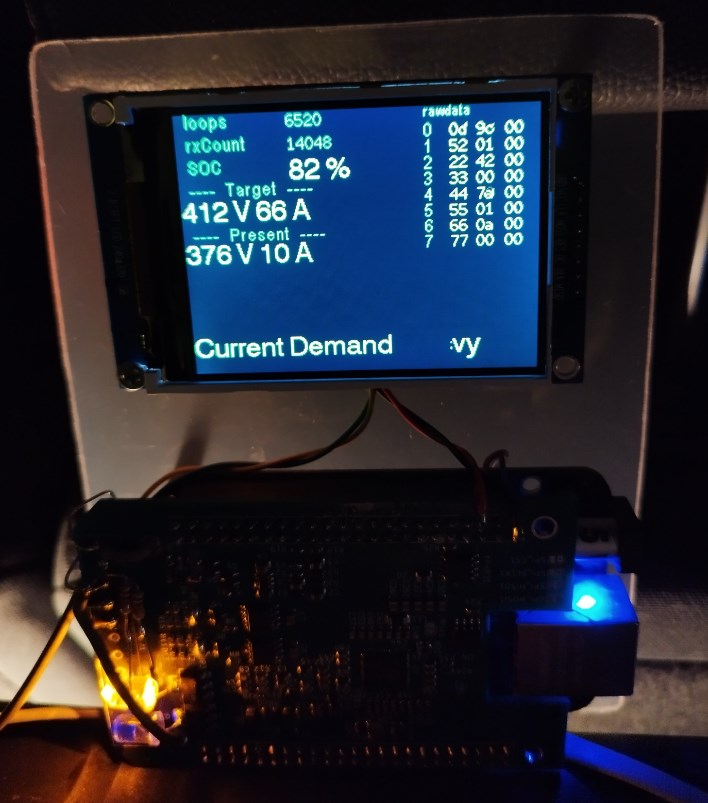

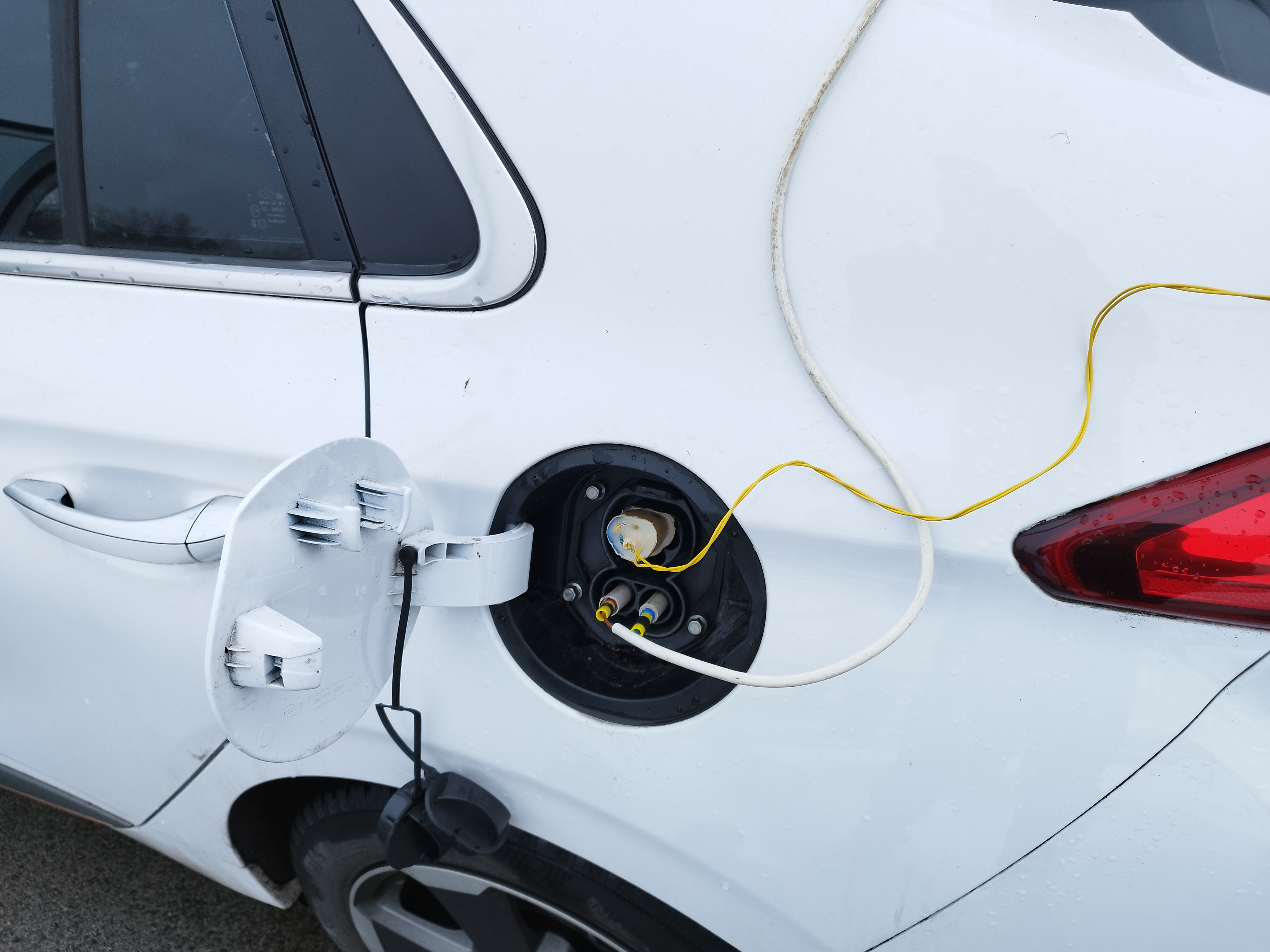

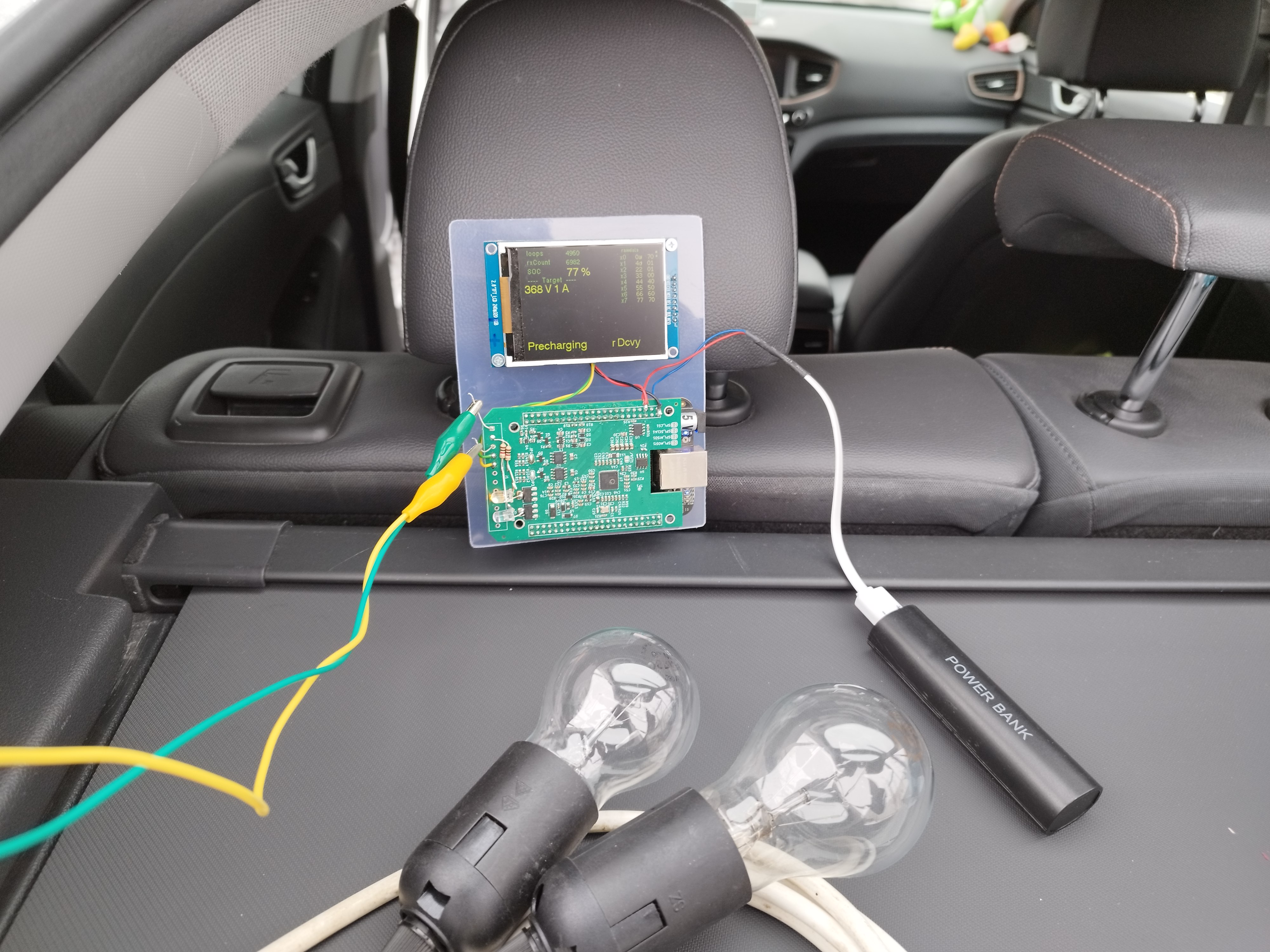

Good news: After some improvements in pyPLC, the Ioniq is happy to provide power for 10 minutes, as we knew it from the past.
The issue was, that pyPLC needed quite some time (above 200ms) to answer the CurrentDemandRequest of the car. It is not fully clear, why this take so long. I disabled some logging and an unnecessary decoding step. Now pyPLC reponds within ~70 to 80ms. This is still quite slow, but seems to be good enough for the Ioniq.
Github commit: https://github.com/uhi22/pyPLC/commit/9 ... 82275d93c3
Maybe other cars are more strict. In case someone can find out the intended message response time from the DIN70121, we could check whether we need further optimizations.
[Edit] I have no timeout values for the DIN spec. But for the ISO15118-2, the values are: V2G_EVCC_Msg_Timeout on EV side for CurrentDemand: 250ms. Expected reaction of station for the CurrentDemand: V2G_SECC_Msg_Performance_Time 25ms. This means, the ISO says that the EV shall detect a timeout if the message needs ten times longer than specified. This is quite relaxed. If we assume, that DIN has the same values, then the 80ms of the latest pyPLC is slower than specified, but still factor 3 below the timeout time. This should be technically fine for the moment.

Re: Energy Controller including CCS interface
Identified some room for optimization: We are responding CurrentDemandResponse.EVSEPresentVoltage = 0V, while the Ioniq is requesting 412V and 66A. This does obviously not matter for the Ioniq, but maybe other cars are more strict. So it would make sense to report the real voltage as EVSEPresentVoltage.
Created issue https://github.com/uhi22/pyPLC/issues/44

Solved the issue with the EVSEPresentVoltage zero. Now we send the battery voltage which we know from the precharge-phase, plus a small random jitter to make it not too boring. The behavior of the Ioniq does not change, it still aborts after 10 minutes. Changed pyPLC and the display software to also show the (faked) present voltage and current.

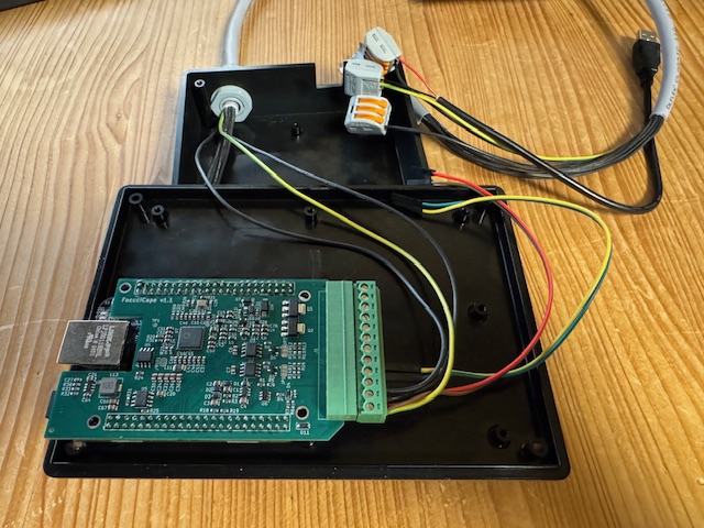

I managed to install the BeagleBone Black and as well today the famous Foccci Cape. There was one hurdle that I had to pass. In your description at the point "First steps with the QCA" the plctool doesn't work. The reason was the not existing pip on the flash.uhi22 wrote: ↑Mon Feb 02, 2026 8:42 am
https://github.com/uhi22/DiDeBoCCS
For anyone who is thinking to use the FoccciCape solution, please have a look whether this helps. Any feedback welcome. Improvements are ongoing, I think a next senseful step should be the integration of a precharge power supply, to satisfy the cars which are expecting real voltage during precharge.
With the description here
https://openinverter.org/forum/viewtopi ... 710#p87710
I got it to run, worked perfect.

Todo I tried to connect to my i3, but I don't see anything in der logs that the pyPLC communication would start, although everything looks like in your description in the setup_focccicape.md. I found only one change that was necessary at the installation of the following packages.uhi22 wrote: ↑Mon Feb 02, 2026 8:42 am
pip install pySerial
sudo pip install pySerial
pip install requests
sudo pip install requests
I need to do it with pip3 otherwise pyPLC doesn't start and brought failures.
Because I didn't see any communication I measured the voltage between CP and PE at the foccciCape, and I thought it should be something around 12V but I measure -12V and it moves to something around -9V and -6V and back to -12V - so probably the cppwm Skript is doing his job. I have only a multimeter to measure it, and the frequency I saw was 2kHz. So should this work with these values, or what do I have to change?
At the input of the FoccciCape I use a MeanWell 12V PowerSuply which was necessary, because only a power bank with 5V was not enough for the FoccciCape and the BeagleBone Black. The BeagleBone was in a boot Loop. The measurement at the input is clear +12V how expected from the Power Supply.
As mentioned here https://openinverter.org/forum/viewtopi ... 570#p88570 I changed in the cppwm.py to the following line
f.write("948000") # a little bit below 5% to compensate hardware delay
in case of CP PWM backwardation, and it helped. Now I measure +12V at the CP and also a frequency with 1kHz, but my i3 is still unhappy and doesn't like to communicate with the FoccciCape - any ideas what to check next?

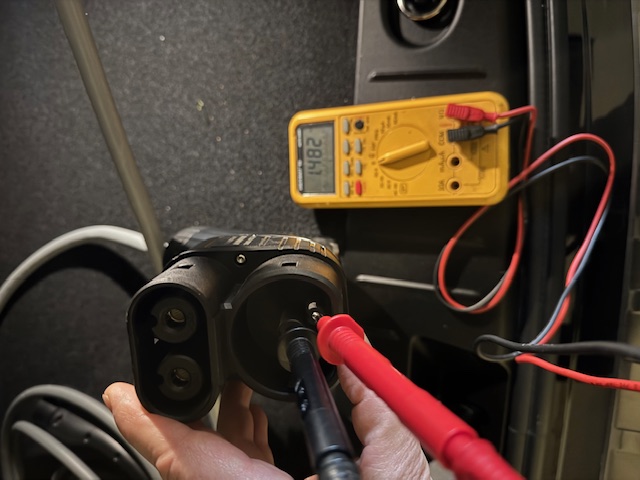

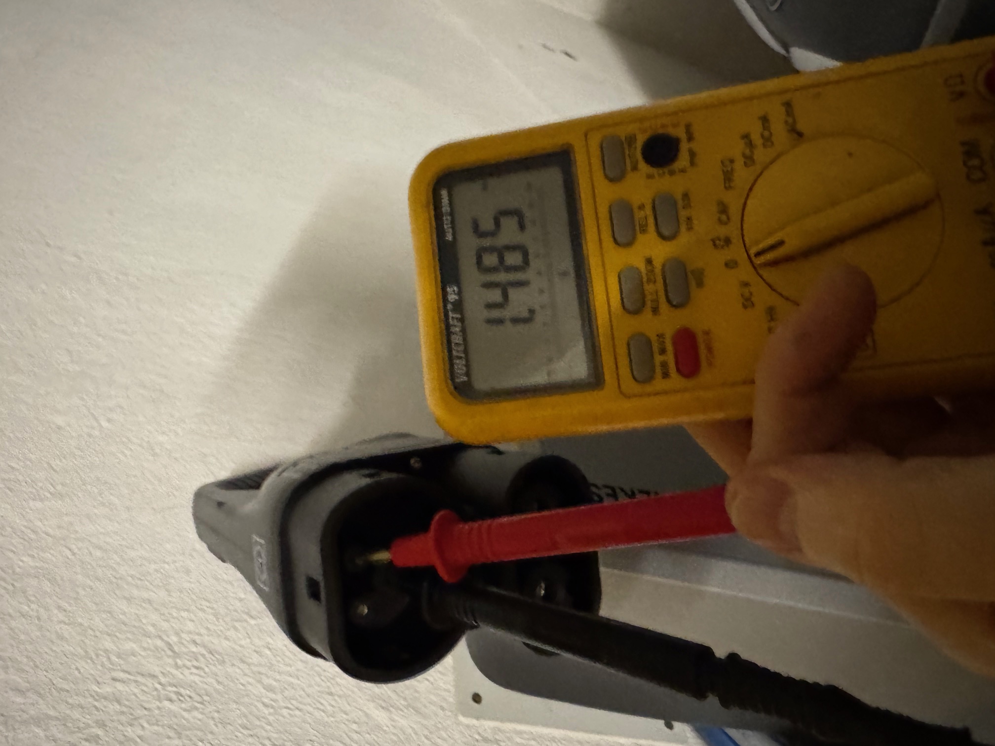

Yes, the 1k5 resistor is in place - but false I think it is between cp an pe, my stupid false, have to change and will report after that.johu wrote: ↑Sat Feb 21, 2026 6:11 am The 1k5 resistor between PP and PE is in place?
Try executing the commands from cppwm.py manually to see if they actually run without errors. E. g.Code: Select all
echo 1000000 > /sys/class/pwm/pwmchip0/pwm0/period
The 12V power supply is ok for me, because you will have almost in each Car a 12V plug to connect the DiDeBoCCS Box.
Edit:
Now the resistor is between PP and PE and the i3 is communicating with the FoccciCape, but at least it is blinking red. I don't see any communication in the evseNoGui.py session, so something is still not ok. I will attach the journalctl file and the pcap file from tcpdump. Maybe someone could see the problem.

Is the foto the old or the new state? It shows the wrong behavior. It is in the CP hole, but shows the 1k5 which shall be on the PP.
