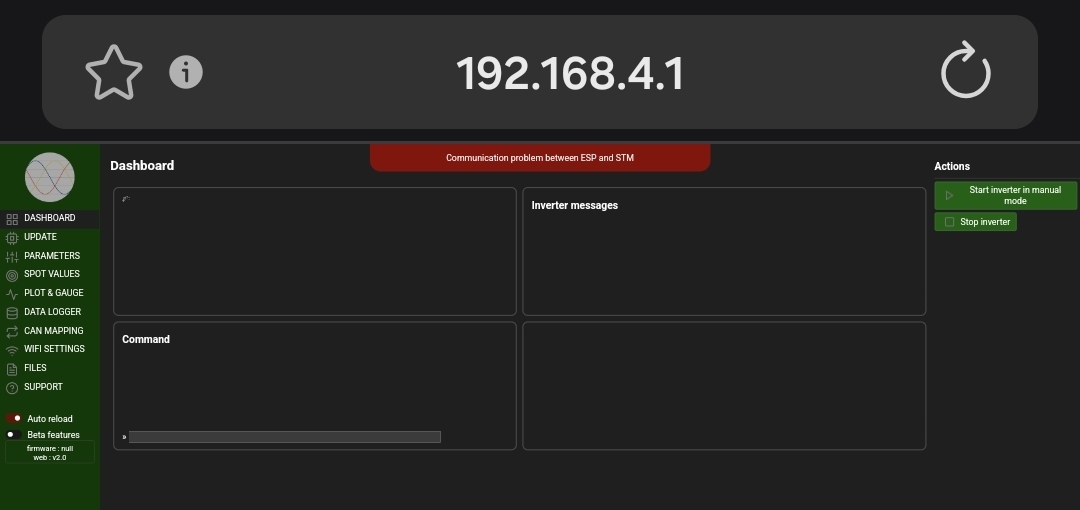

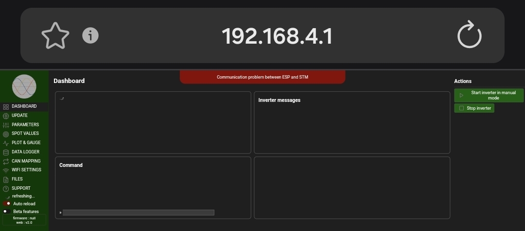

But the strange thing is, I can upload it to both boards I bought, but 1 board it works, 1 led red constant, 1 led blinking.
Other board, after uploading, 1 led constant, other led stops blinking.
Message: communication problem....
When changing code back, it works...
So 1 board new code is working, 1 board didnt work.... strange??
If I do any modifications on code, no communication between stm and esp
Boatloader problem?
Both boards showing this message.
I can upload both boards your code, but cant see anything...

Hello,
After both boards communication problem, I do this:
Upload in state of .hex, .bin to 0x08000000.
After it upload .hex again, and both boards are working now.
I did not understand what the problem was, but both boards working now.

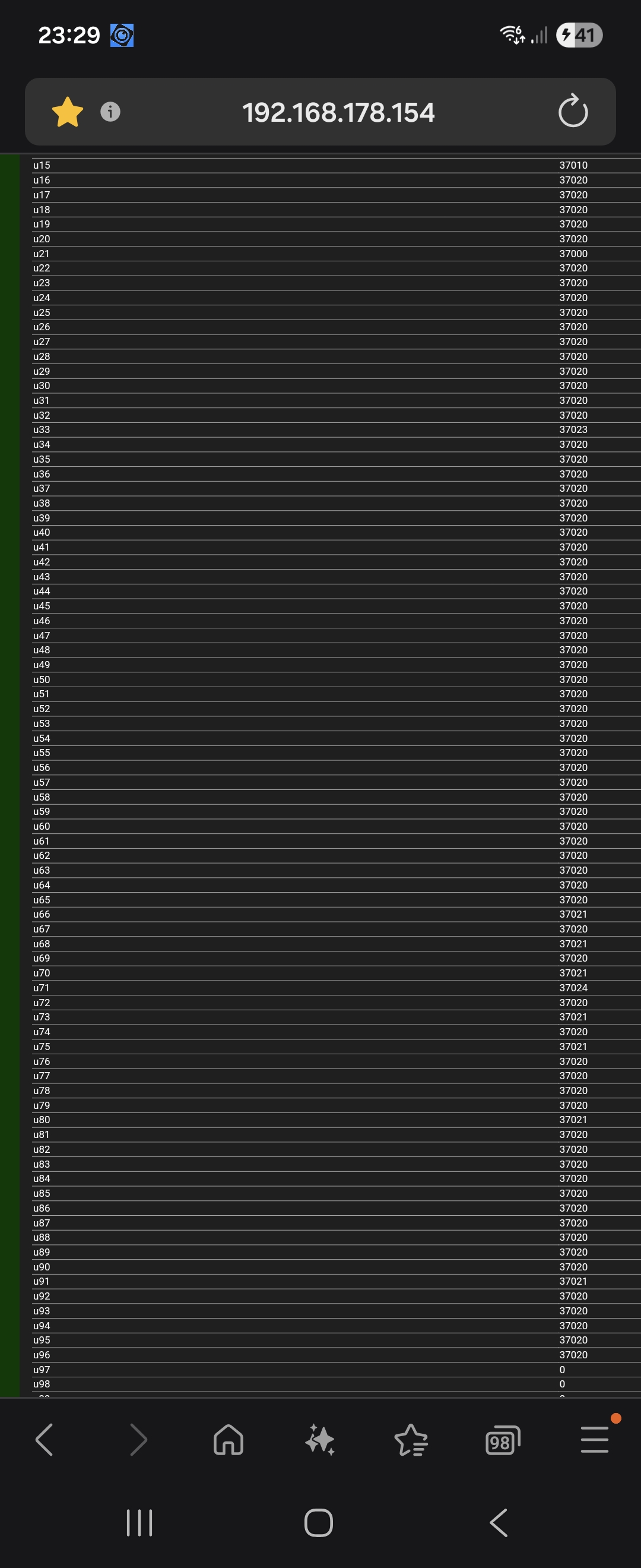

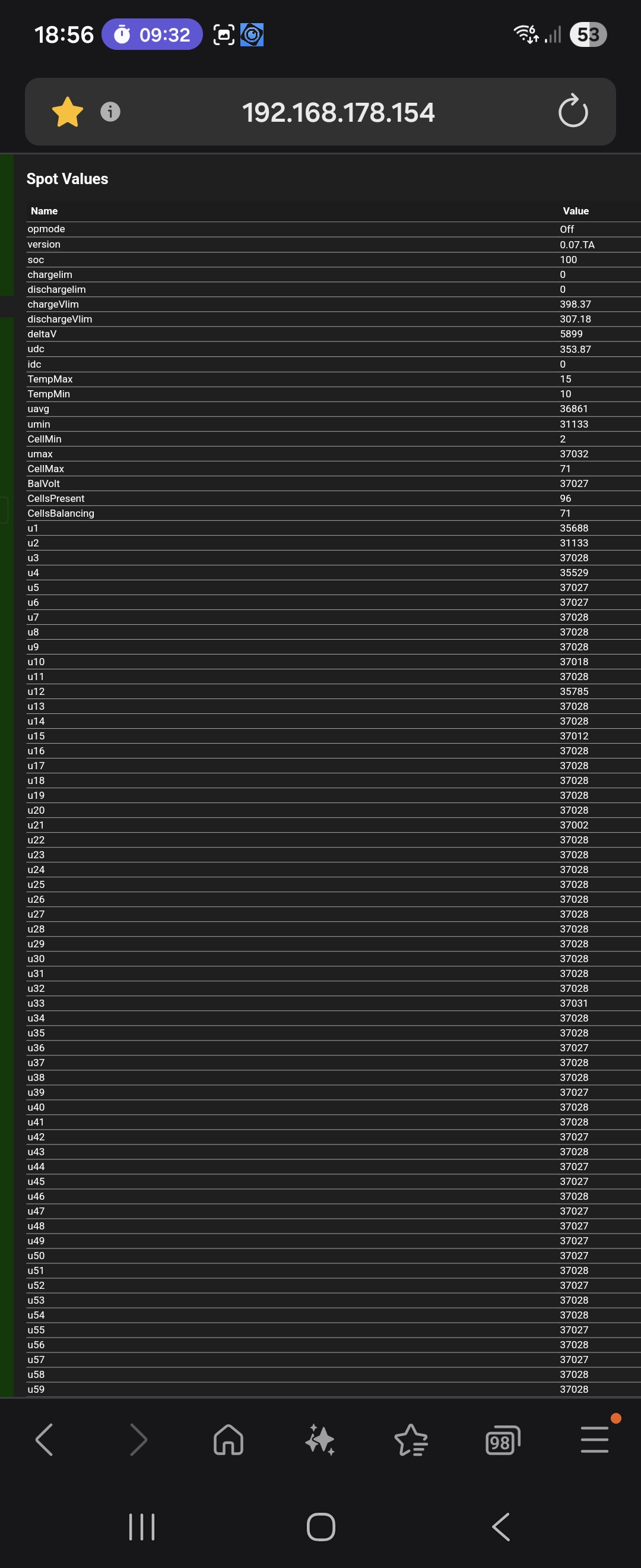

Module1 is defect. Bad leaking cells (lithium) which decrease cellvoltage of 2/3 bricks.
So we use your board to balance immediatly the 3 good modules (over a weekend), open battery, and place 1 other (well balanced module) in the battery. We only have to (dis)charge the replaced well balanced module, to same voltage, maybe balance whole battery again, and place in car.
Well balanced for us is very important, because you have a good 0-point (start point).
So I did some modifications, I make cellvoltage 10 times "better", so balancing can be better.

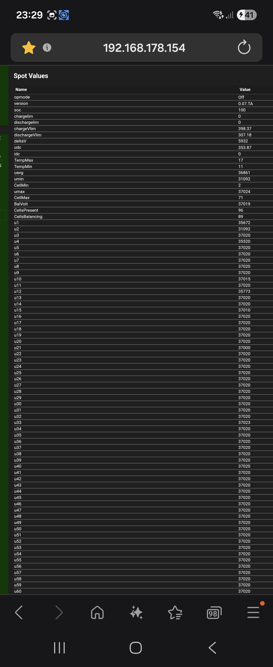

by hanskraayeveld
The measurements of the cell voltages is really very accurate... I begin to admire the batman chip...
I know why it has to be very accurate, because the SOC of the LPF. Only one millivolt can be a soc change of~ 3%.

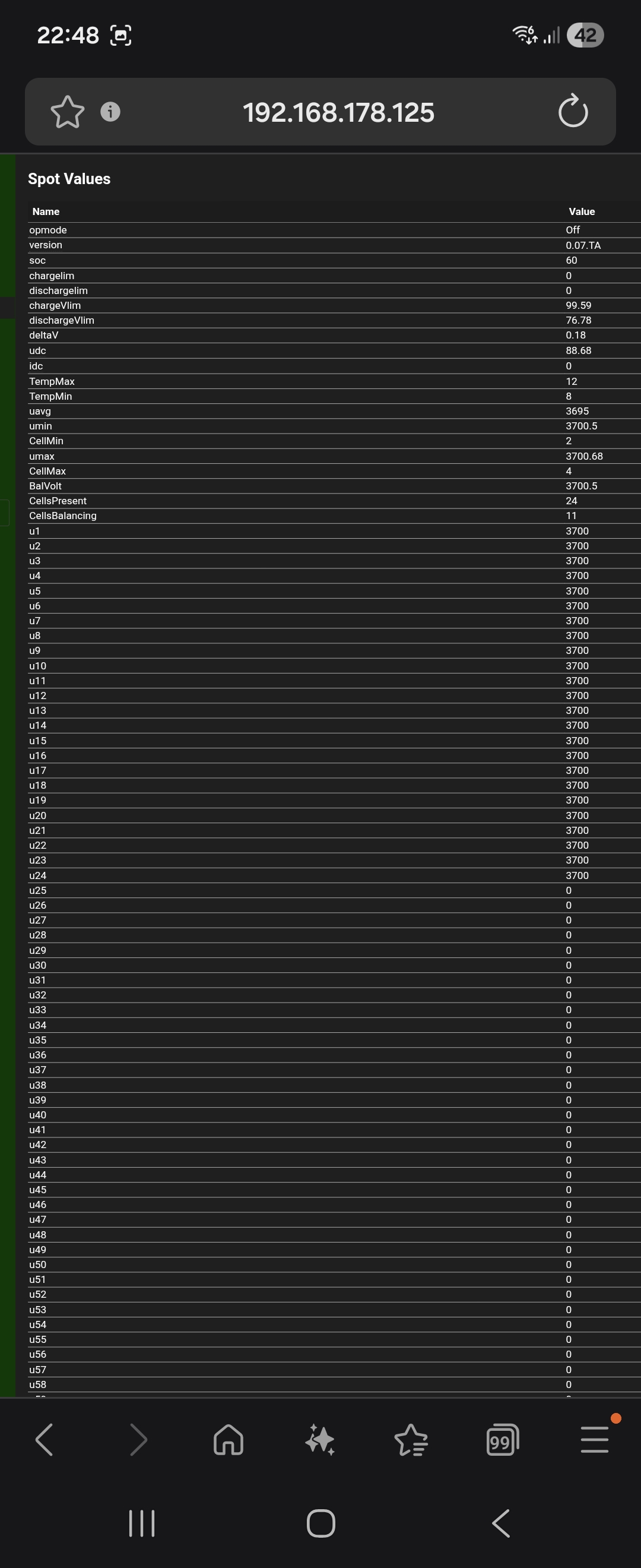

Posted: Sun Nov 02, 2025 9:49 pm
by hanskraayeveld
This M3 battery balanced, module1 defect.
Other module1 balancing to 3687 mv, after it replacing.
