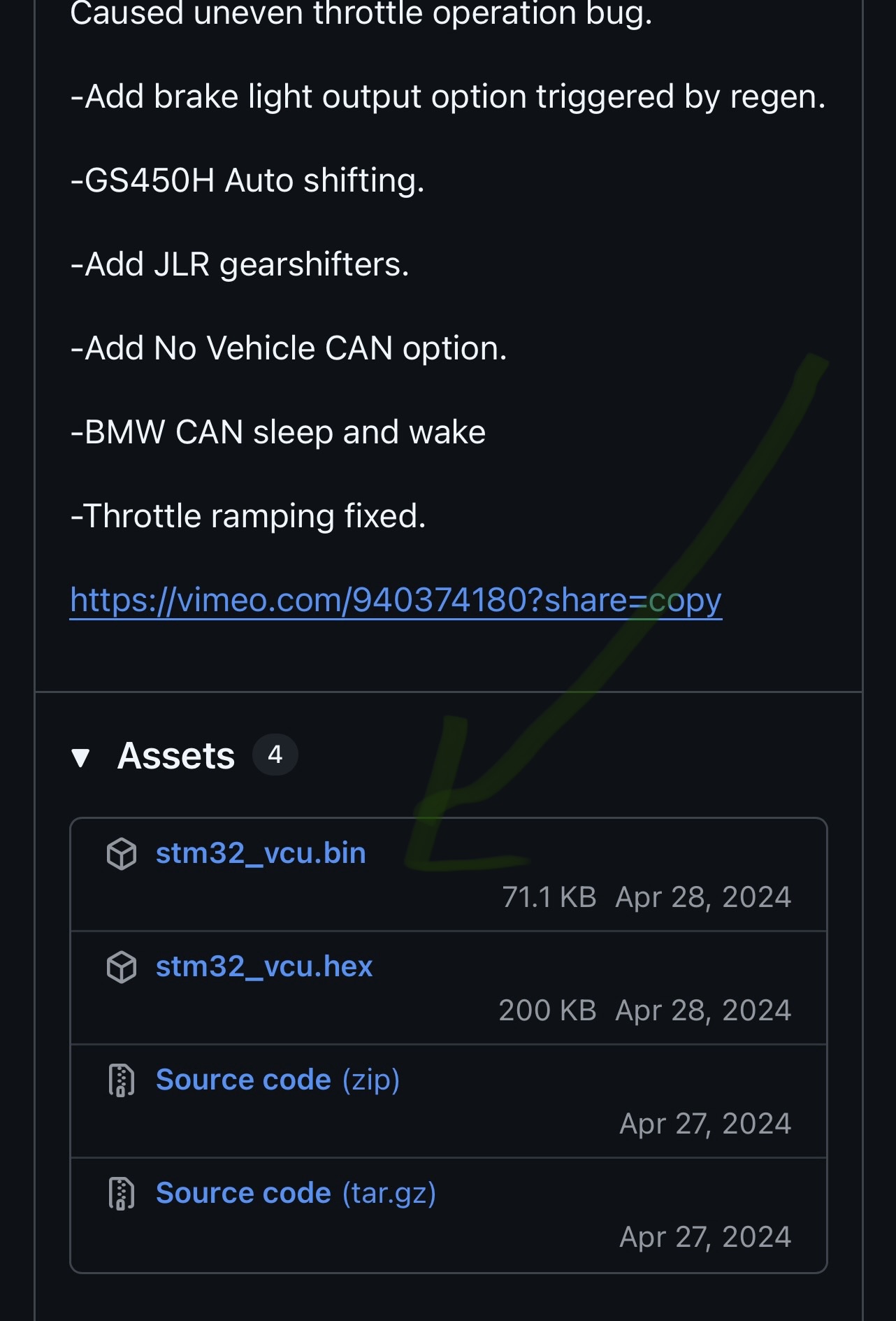

tom91 wrote: Wed Dec 31, 2025 10:14 am Yes update it to the https://github.com/damienmaguire/Stm32- ... /tag/2.15A
Okay, so I downloaded the 2.15A bin file as linked and upgraded the Zombie.
Unfortunately the file seems to be 2.20A on spot values even after numerous Zombie reboots and refreshes… is it possible to be the wrong file? 🤞

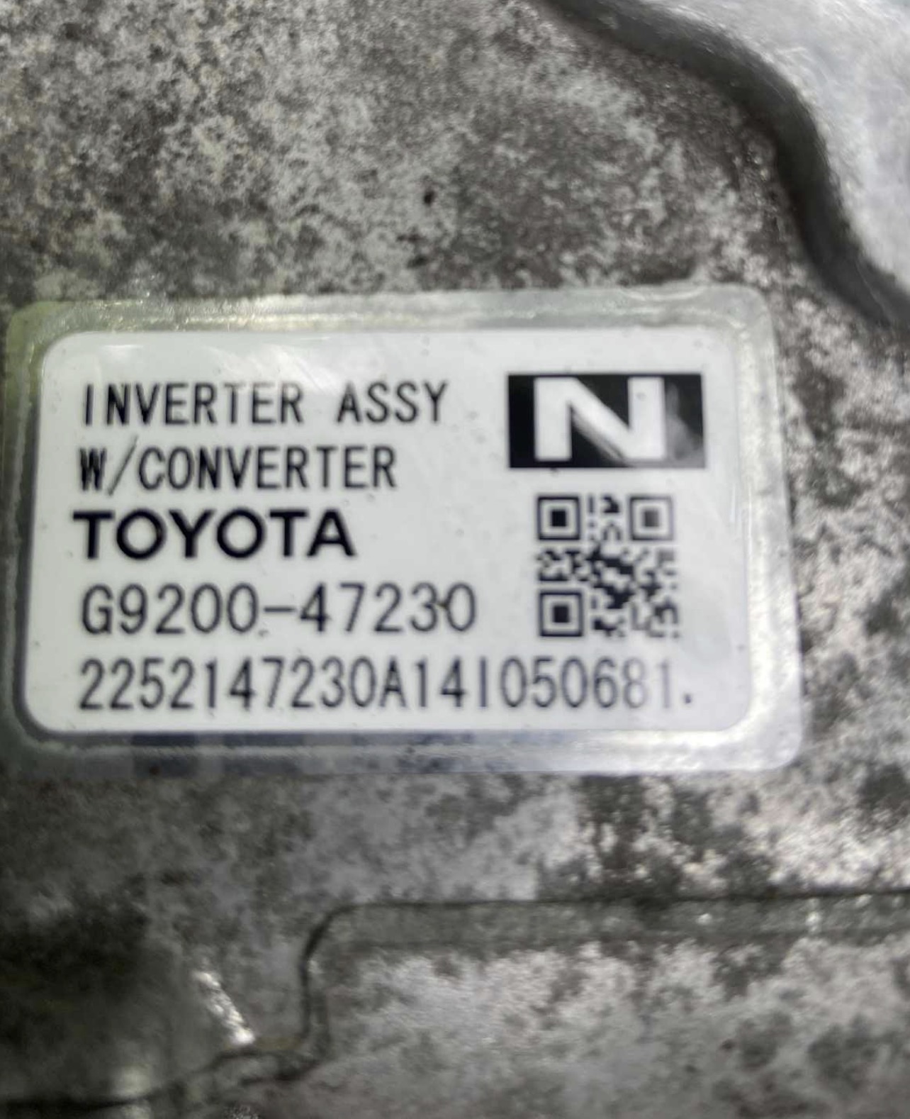

Change inverter and change it back again. Can you also please post your inverter serial number/part number

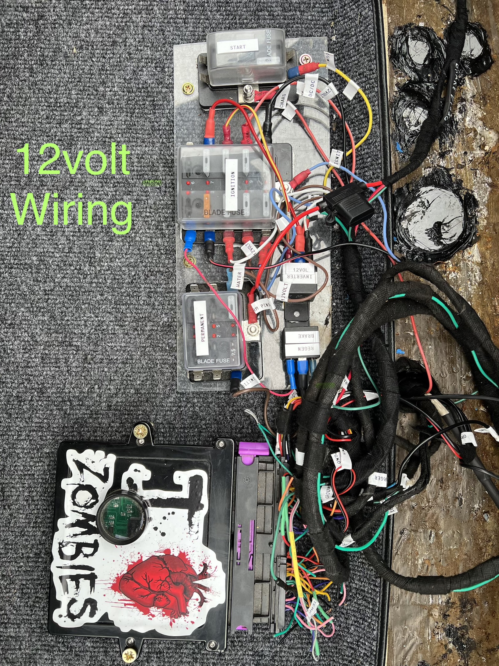

Did you provide an over view of your wiring? Just want to check its all been done right. Mainly interested in the grounds and 12V supplies and relays.

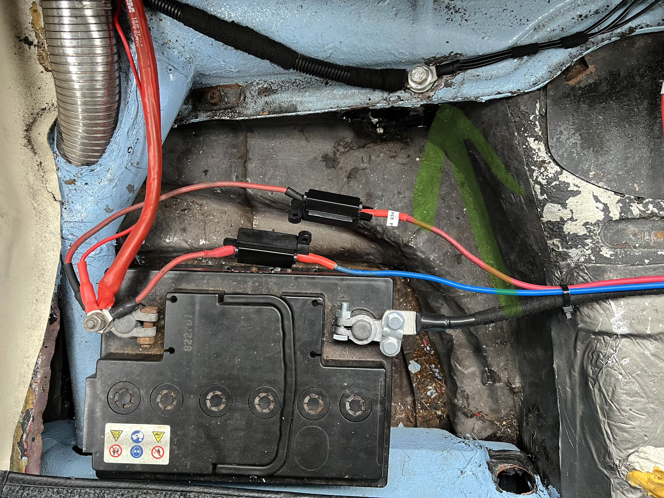

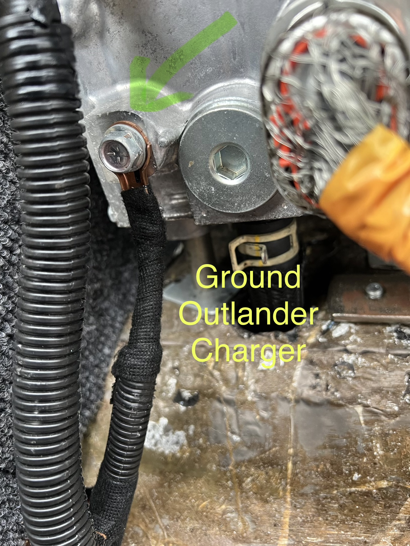

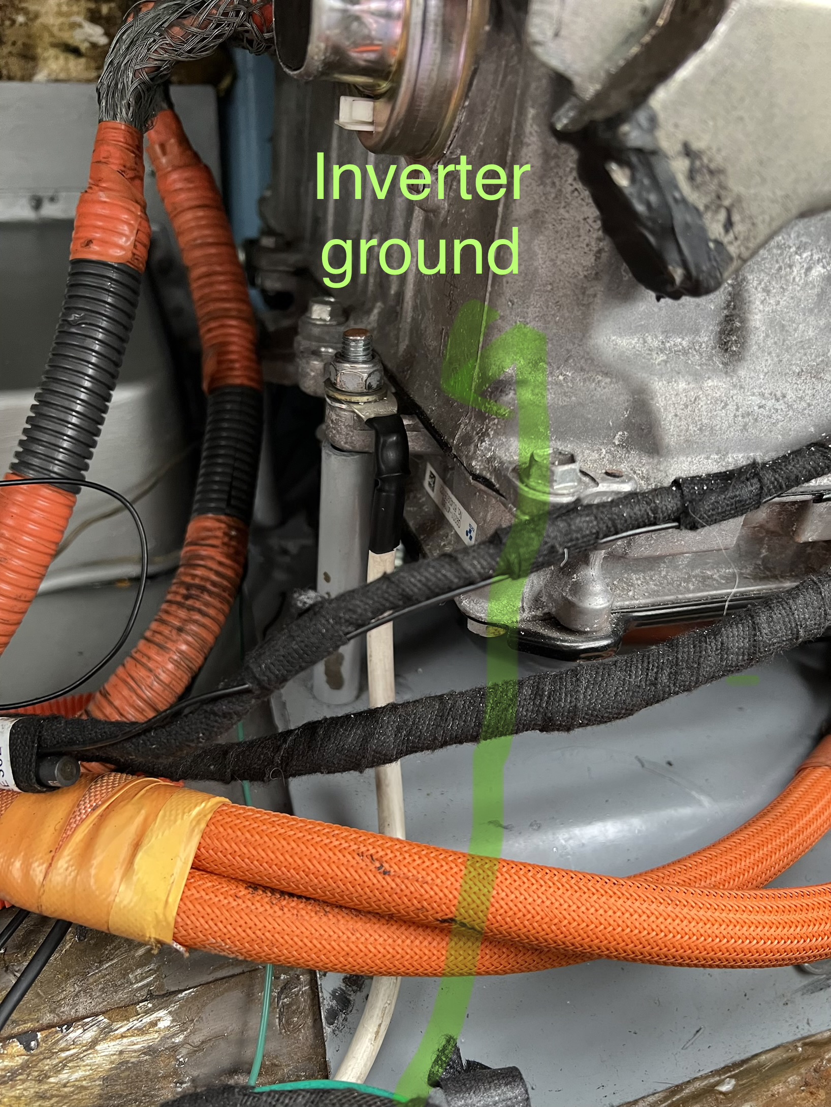

tom91 wrote: Wed Jan 07, 2026 4:35 pm Did you provide an over view of your wiring? Just want to check its all been done right. Mainly interested in the grounds and 12V supplies and relays.
I don’t have a wiring diagram but I will take some detailed photos tomorrow to show the setup.

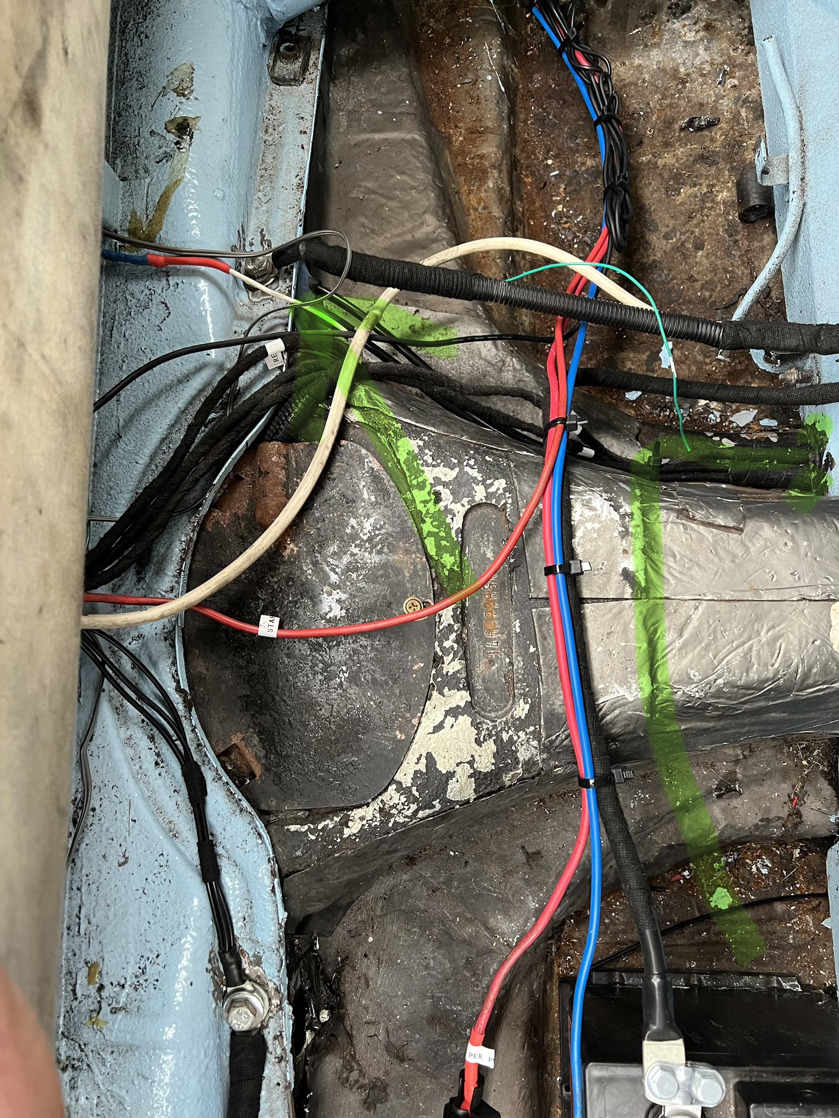

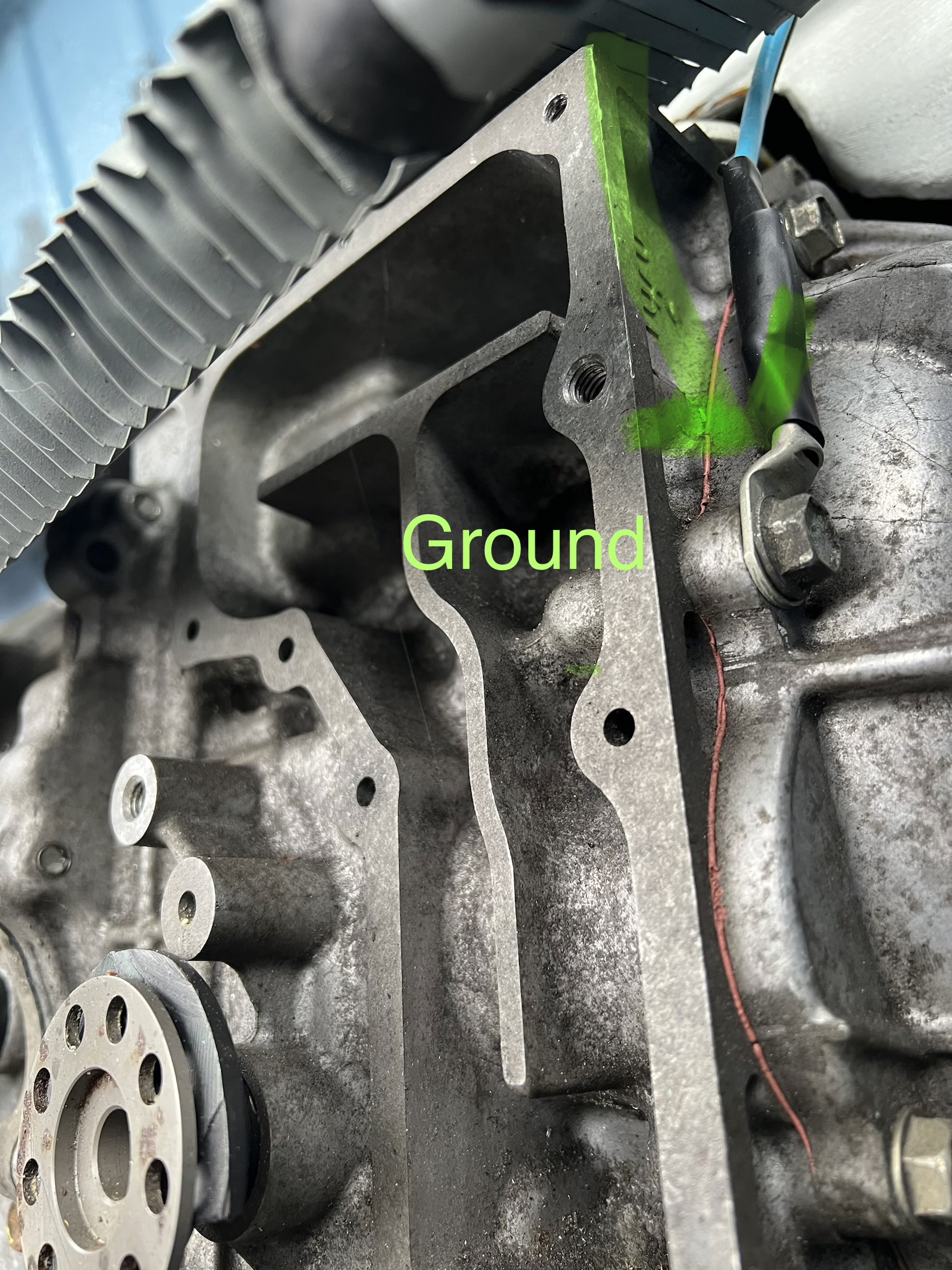

I slavishly followed Greg’s Rabbit wiring etc and because of having worked on quite a lot of VWs and Subarus I made sure that there is an abundance of grounds.

Re: Unlocking the power/torque of Prius gen 3 drive train?
Post by Ghia66 »
12volt wiring layout and grounds
Posts: 2962
Has thanked: 328 times
Been thanked: 847 times
Is all the 12V to the inverter via that relay?
If the issues remains like it does need to confirm what inverter Greg has in his rabbit and what firmware was used as a base for testing on it (yes I did write it but its a while ago).
