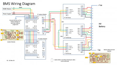

For anyone building their own version of the Huebner BMS, I've just corrected a couple of errors in the Isolator BoM (RS485 Version). The crystal should be 11.0592MHz and the processor should be an ATMEGA88P.

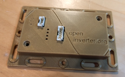

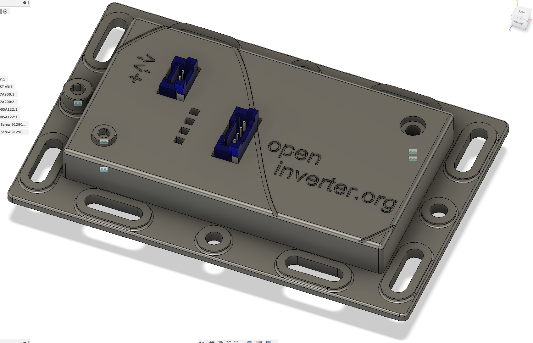

Also been working on some enclosures for the various modules that can be 3d printed. Here's one for the battery measurement module:
There's a few tweaks then I'll put the stl files somewhere in case anyone wants to make some for their system.

I was just wondering, could you do the case "Lego" style? I.e. in a way that you can stack them so you don't need to mount all of them individually. Like some notches that slide into each other on opposite sides.

I realised there was a mistake on the Huebner BMS wiring diagram I made. The connections on the 1st isolator module connector JP2 were reversed. Also I swapped the position of JP2 and JP3 on the diagram to match the actual PCB:
I've updated the version earlier in this thread and updated the Wiki page.

Very nice, thanks for updating the wiki also

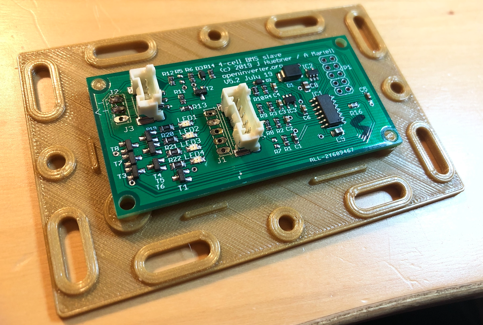

So finally the first 100-batch of slave modules are approaching Europe. Will finish up the CAN isolator and get some made.
So, say in 2 weeks time I can ship out to beta testers.

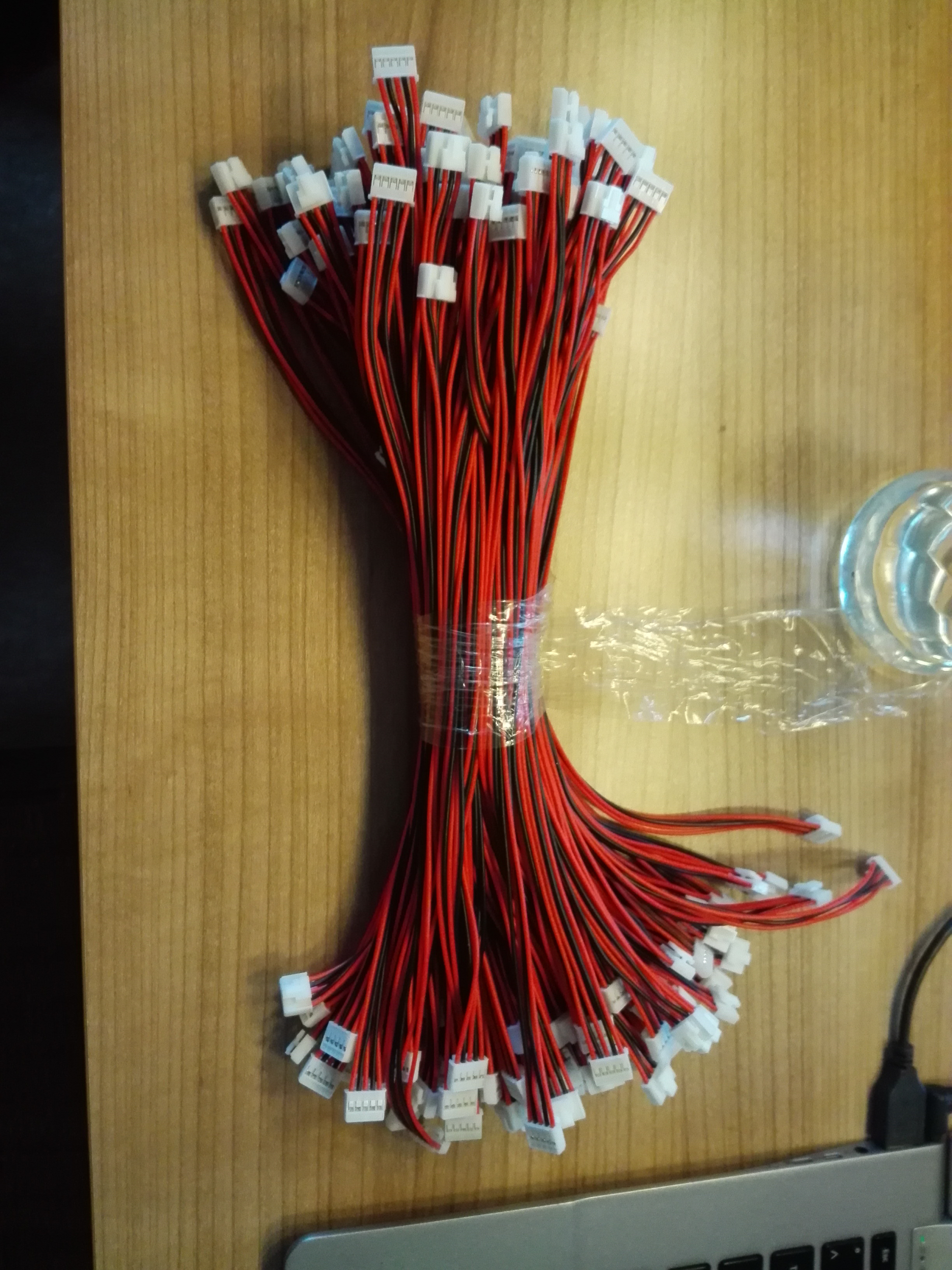

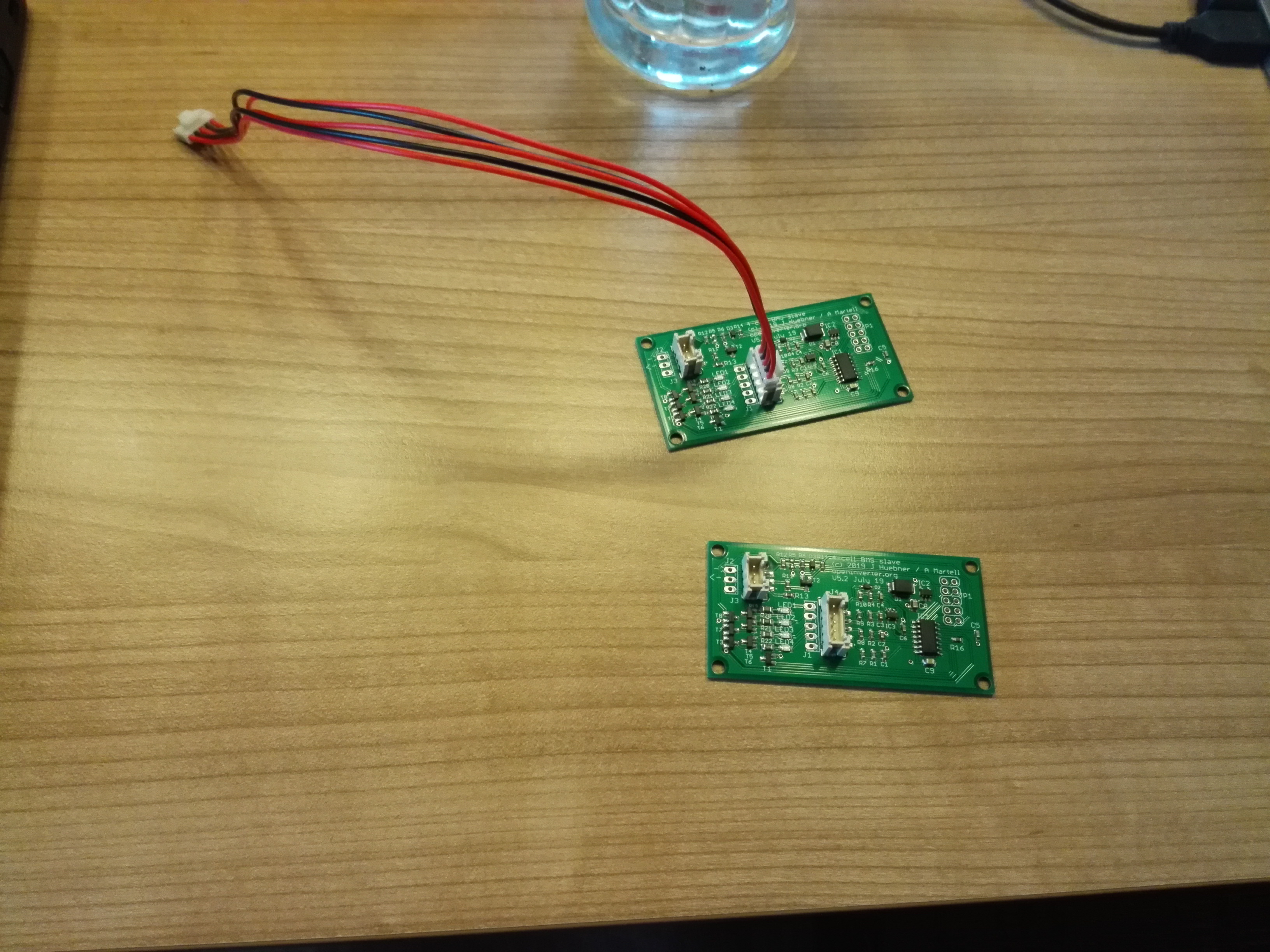

Well, look what came in the mail today
Big shoutout to Patrik and Daniela from Ledaros who made it possible.
Now lies some work ahead. Unfortunately the Zeners fitted to all board need to be replaced by normal diodes as they cause a vampire drain. With that done it's time for software flashing and calibration. Prior to that I need to clean up my desk
I will also send out an isolator. Time to make the first software and wait for the PCBs to show up.
For all testers:
As you can see the cell cables were not manufactured as needed: they have plugs on both sides. Just cut one off. The comms cable is not included as the desired length is unclear. You will need to obtain 3-pole JST connectors. Intemediate modules only have two pins populated, only the first and last module have all three populated with B+ and in or out connected to the isolator.
You can start sending your shipping addresses and an email address via PM

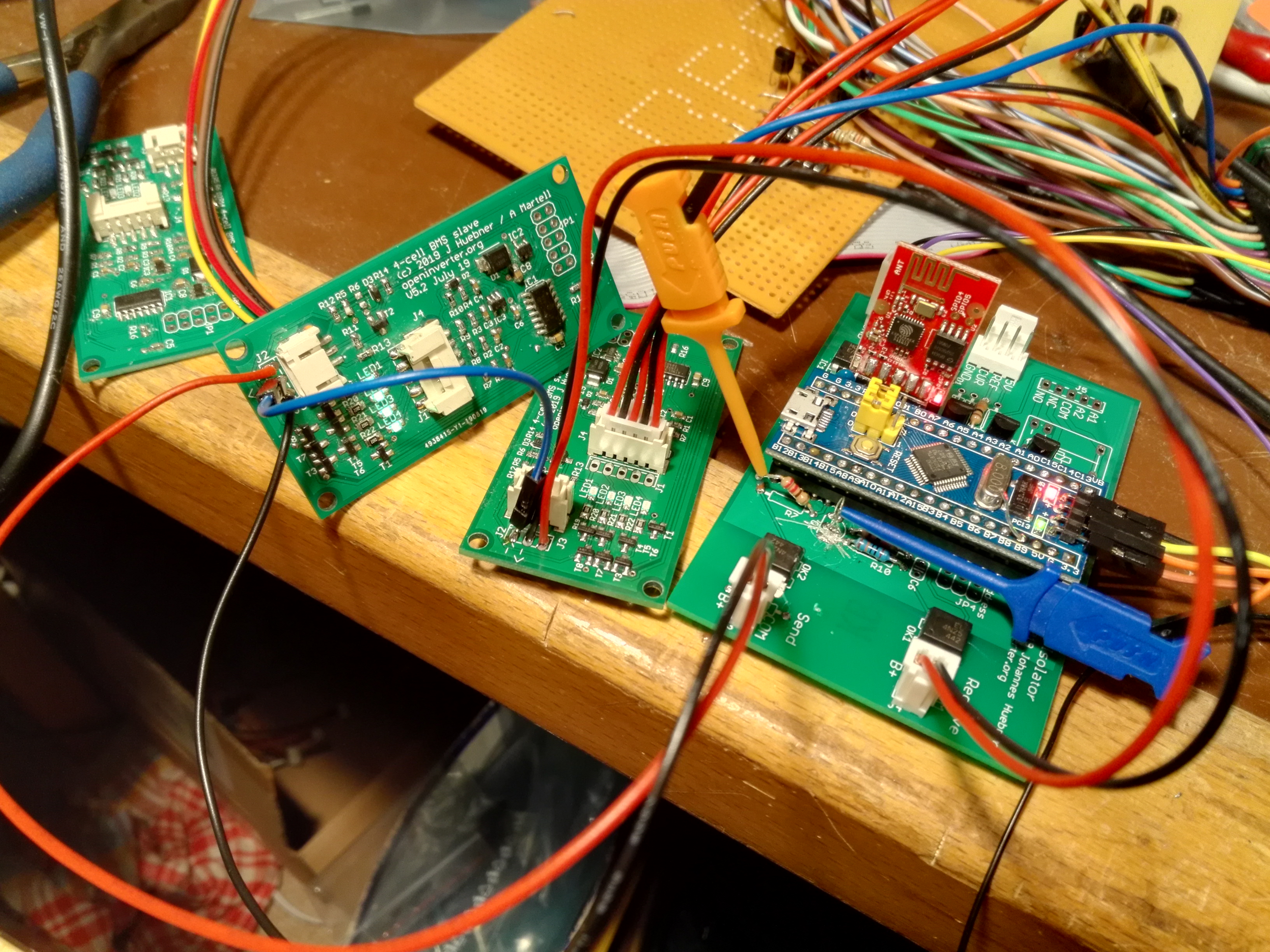

Re: 4-channel BMS with daisychain bus

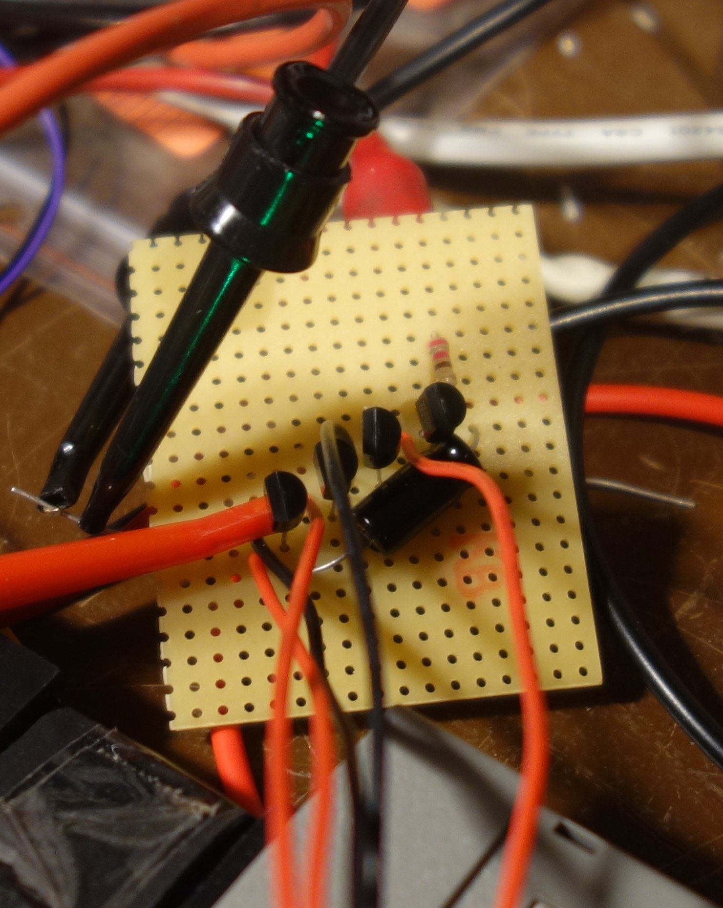

Running the first tests with the CAN isolator.
It has some glitches but they are easy to fix. The so-called 5V-tolerant pin actually never rises above 3.7V. So when using it as on open-drain driver for the opto, the opto is constantly on. Mitigated this with a series Zener, next version will just not rely on 5V tolerance.

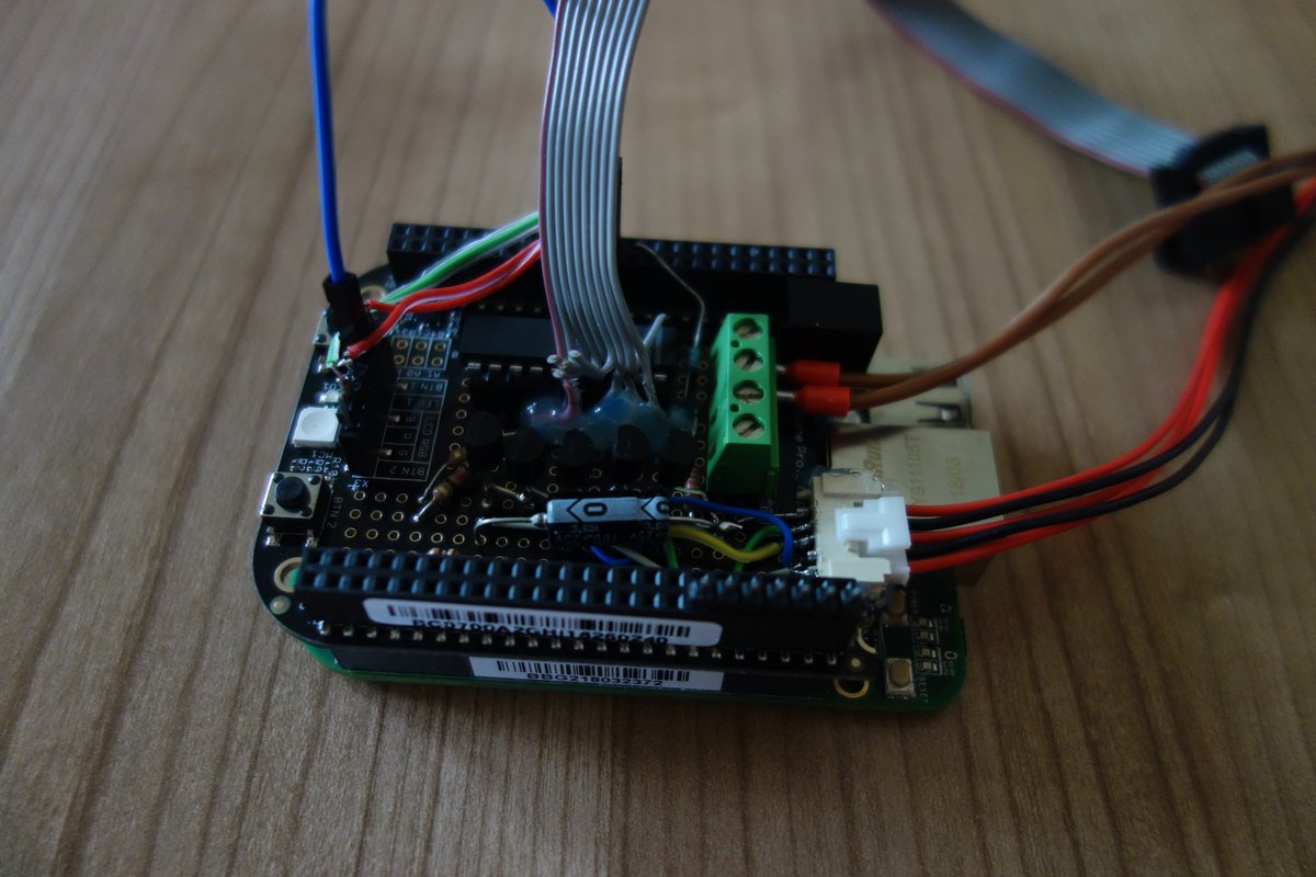

This is my programming station: a BeagleBone Green. It's SPI interface is used by a custom avrdude with "linuxspi" driver and the pins are beefed up with a 74F1244 tri-state driver. Shunt references provide the necessary reference voltages for calibration and a button lets you start the calibration and programming procedure, fully automated.

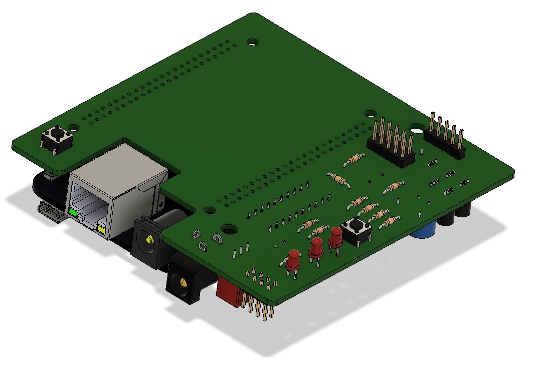

Working together with Andy (sonachan1) we have developed the calibrator as a nice BeagleBone Cape with through hole parts (want to upload some renderings?)
The fact of having this calibrator spawned another simplification: the bit-length-encoded protocol has its root back from the IR communication and the fact that the Attinys RC clock skew is like +/-10%. Not so if you can calibrate it. And the calibrator can calibrate it, thats why it's called the calibrator, haha. That brings it down to +/-1% which is good enough for UART communication. So thats what I did. Soft-UART in the slave modules (10kbaud) and hardware UART in the STM32.
Works great and I hope it will be less susceptible to noise. It certainly raises performance and concerning the slave modules it is a pure software mod.
