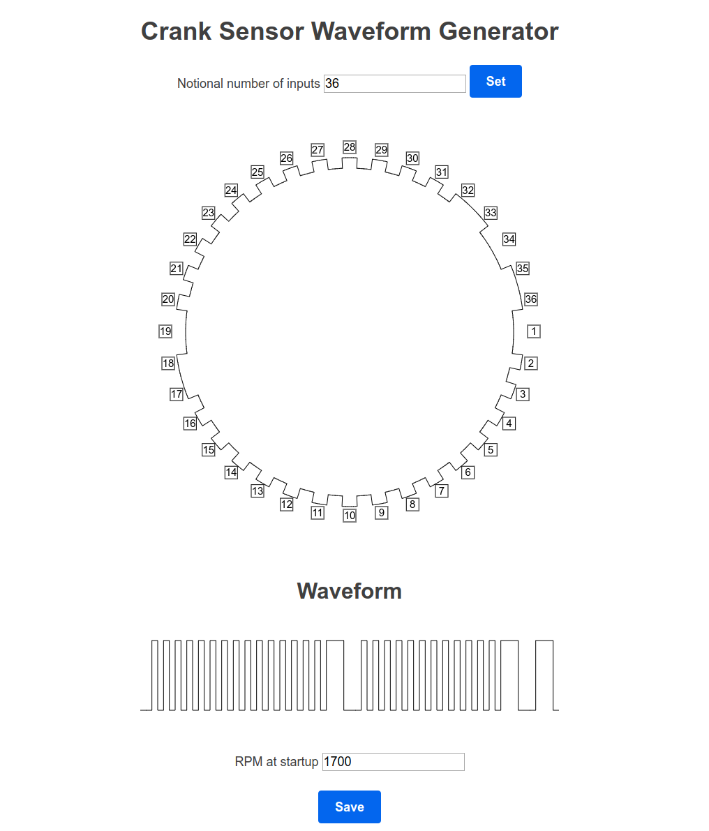

Is that for your crank position sensor? (the 58/60 hole one) If so for 1000 rpm = 1kHz signal out which could be bit banged on a 16MHz arduino without too much hassle, just turn the pin on or off every 500us, you could even count and miss a couple, If I remember correctly you're passing the signal through a second arduino to ditch the two unwanted pulses?
You can use float in the target pulses but not the source.
I'm currently trying, so far unsuccessfully, to get the PCM in mine to think the engine is still there. I have an even weirder shaped crank position sensor.
I can generate the matching waveform, albeit square, but if it is zero crossing being used it should work so there's something else I'm missing.

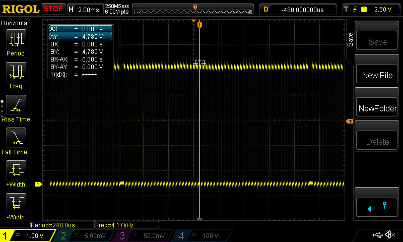

Yes this is Mazda RX8 RPM sensor. For my friend we used the sensor, but first we turned it incorrectly and car wouldnt count pulses. Yes pulses must be correctly oriented. When we fitted it correctly everything woke up. He uses transmission and so he put it directly on motor coupler inside transmission bell.
Maybe it would be best to just record the period to SD card and transmitt it to the ECU when you start.
I am also going nowhere with this. I connected my scope to input and output and i see a thick like in the voltage area. I think sensor pin is swamped with hash. Because i see pulse going to arduino at 4.5V. But nothing is comming out of D9. If i connect it on desk, then everything is good.
I am using just one 3pole cable. I need to get Lycy cable with shield....
doobedoobedo
Posts: 263
Location: UK
Re: Weird Speedometer Question
Post by doobedoobedo »
Everything goes better on the bench.
You've made me look at my waveform generator again (which I'll realease for esp8266 or esp32 depending on which I decide to use) And I think I messed up, so thanks :)
A flavour:

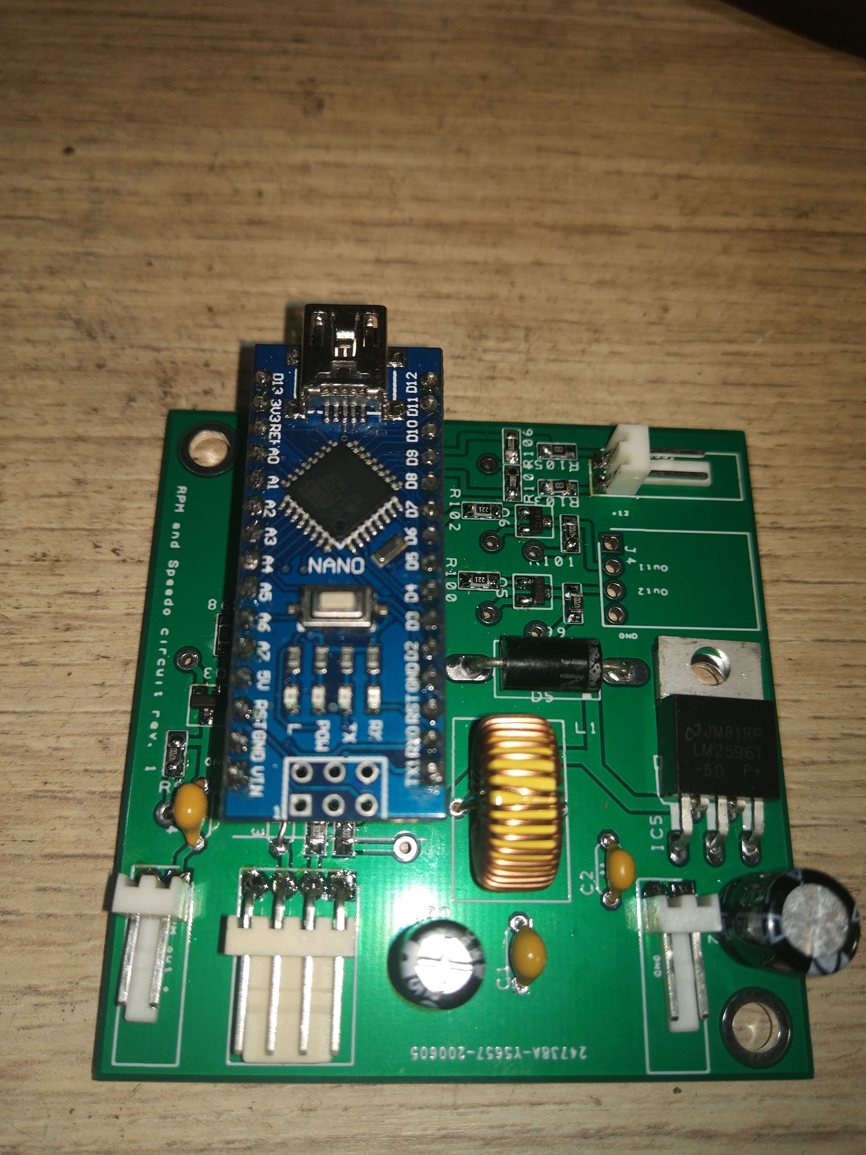

Ok i got across the hash and i found my Arduino has some faulty solder on it. I solved that and now i have a twitching speedo.

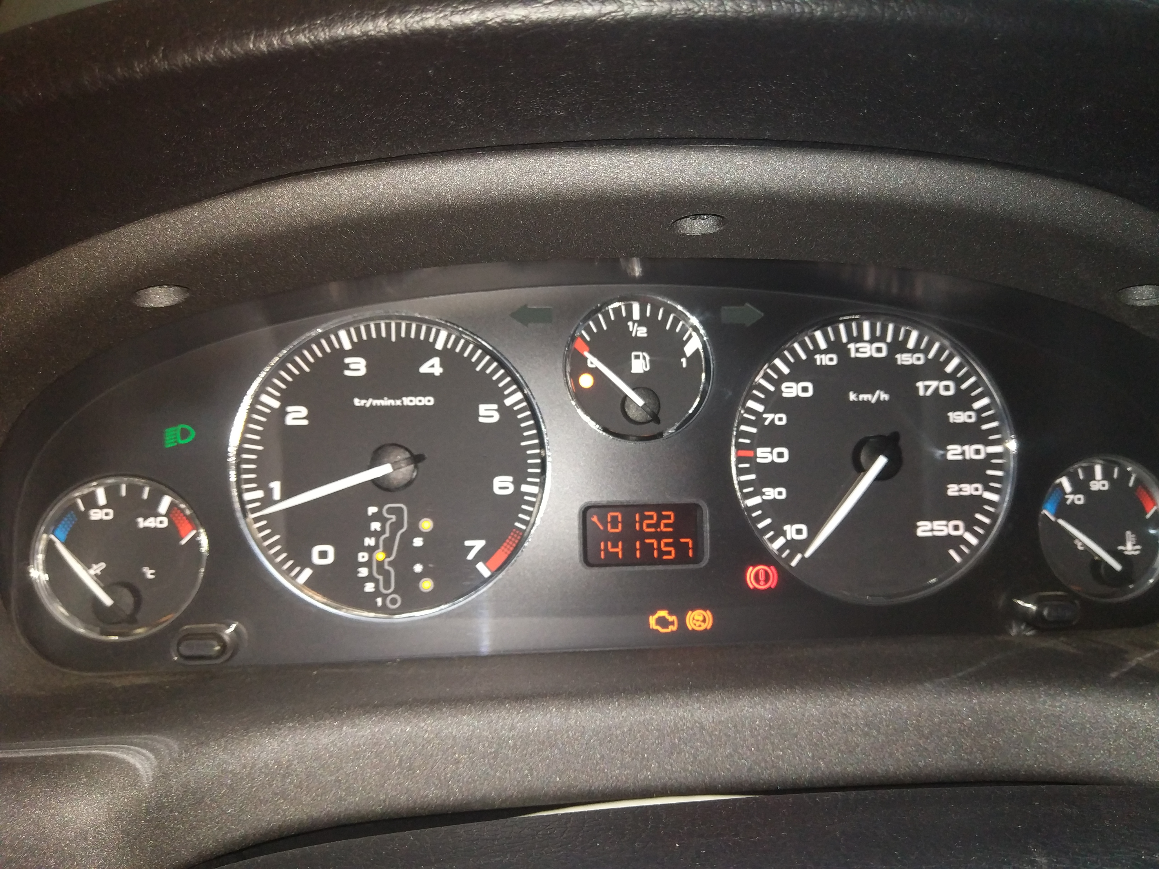

I got the speedo to correct display of speed. I am surprised because the actual frequency diverges from calculated. Strange!
But all in all i am satisfied that it works.

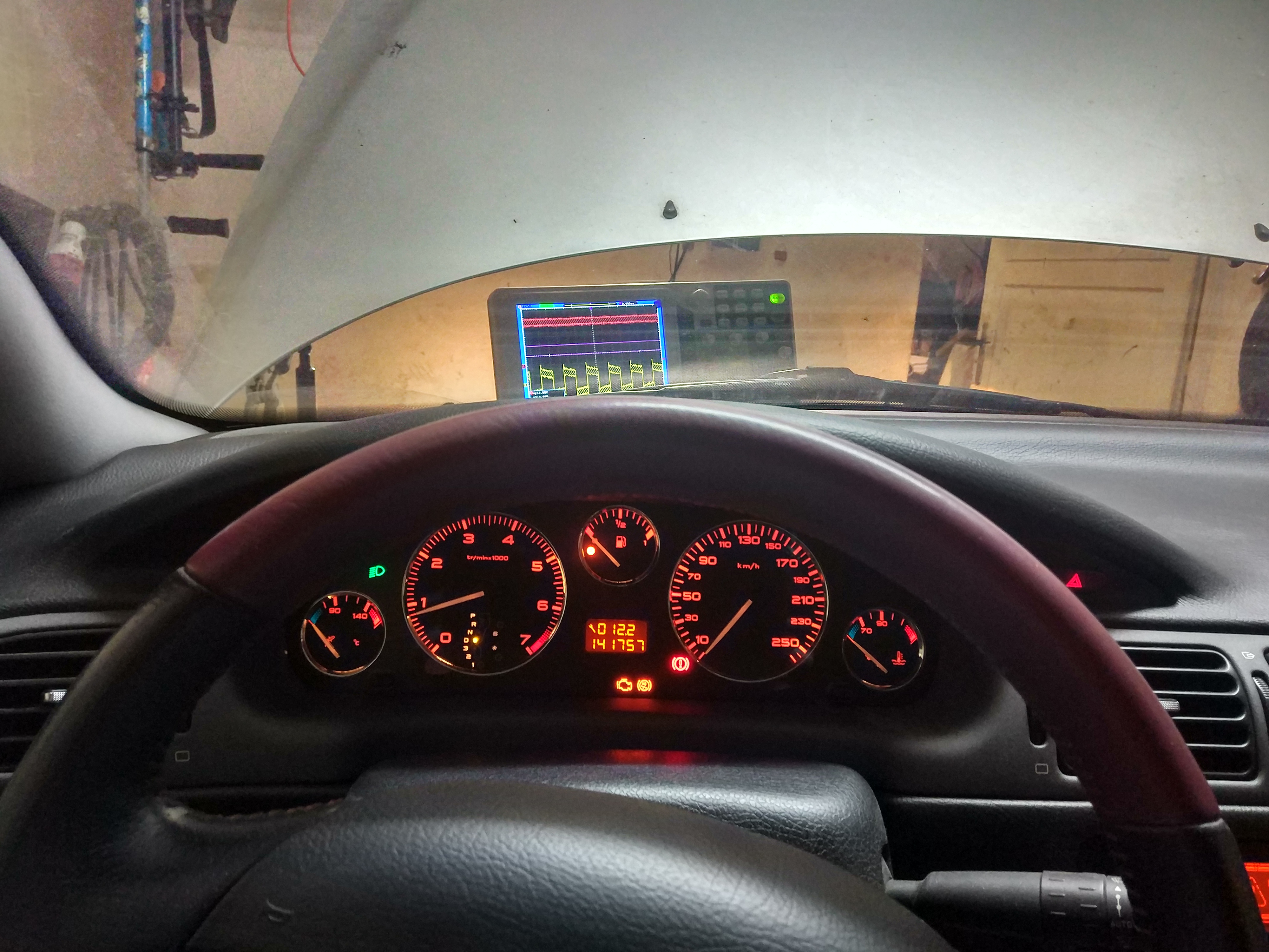

Nope! My 406 coupe was made by Pininfarina in Turin. Actually it had V6 3L engine. And to complicate matters further tacho uses 60 hole ring on torque converter with last two holes lengthened. In effect last three pulses are one pulse that lasts 3 periods. I dont think just tone generator would suffice.
Lo and behold! I was playing with Arduino code and copiyng Damiens code into Rons and suddenly i got square pulse out of D10. Since it was 0V to 5V it obviously didnt do anything for my RPM which needs a "zero crossing" to count one pulse. Since last time Ron suggested to use a ceramic cap to invert falling side of pulse below 0V i tried that. Wow! I instantly got a series of relays clicking and my RPM indicator rose to 450RPM!!!!
Now second iteration i setup to 850rpm to look more natural to driver. Surprisingly i even got ABS system working with one wheel up!
Now i just have to discover if i can use signal from D2 to vary the D10 with 58 pulses per rotation.

doobedoobedo
Posts: 263
Location: UK
Sorry I've not been particularly active. Glad your tacho works :).
I have code for outputing any wave pattern on a pin, so 58 then miss 2 isn't a problem. I'll take a look at combining with the other code.

OK I had a look at this last night. My original code was for ESP so I looked at porting it to the 328p which I have successfully done - however there is an issue which I'll explain.
The 328p has 3 timers:
Timer 0 is used by arduino for the millis() function which is needed by the original code.
Timer 1 is used for PWM of the original code.
That leaves timer 2 (which I've not had to use before). I'm bit-banging the pwm so I can leave the gaps, this requires an ISR on compare match (CTC mode). No problem I think, I check the datasheet and most of the info on timer 2 is an obvious copy and paste from timer 0, including CTC mode, there is one crucial difference though, the bit which sets CTC is marked as read only in the docs and indeed it is - so the documentation tells you how to set up CTC mode etc. on timer 2, but you can't because you can't set the bit.
I have code which works for timer 0 (it's incredibly simple) now but that breaks the original...
I just did a POC it should show 2000RPM
#define RPM 2000UL
#define GAP 2
#define TICKS 60
#define OUTPIN 10
volatile uint8_t step_count = 0, gap_count = 0, tick_count = 0;
void setup() {
  pinMode(OUTPIN, OUTPUT);
  noInterrupts();
  // Configure timer 0 (8bit resolution)
  TCCR0A = 0;
  // set CTC mode
  TCCR0A |= (1 << WGM01);
  // set prescaler ...
  TCCR0B = B00000010; // prescaler = 8
  //TCCR0B = B00000011; // prescaler = 64
  // want freq = 2 x (RPM/60) x TICKS
//  16MHz/freq = 2xprescalex(1 + OCR0A)
  OCR0A = 249; // 2000RPM
  // set compare match A interrupt
  TIMSK0 = 0;
  TIMSK0 |= (1 << OCIE0A);
  interrupts();
  //Serial.begin(115200);
ISR(TIMER0_COMPA_vect){          // timer compare interrupt service routine
  if (step_count == 0){
    if (gap_count == 0){
      digitalWrite(OUTPIN, HIGH);
    step_count++;
  } else {
    digitalWrite(OUTPIN, LOW);
    step_count = 0;
    if (tick_count == TICKS -1){
      tick_count = 0;
      gap_count = 0;
    }else{
      if (tick_count + GAP >= TICKS){
        gap_count++;
      tick_count++;
void loop() {
Which gives this waveform
doobedoobedo
Posts: 263
Location: UK
I take it all back - typos in the datasheet :x
It's now working on timer 2!

I managed to build and test an Arduino Nano interface board for speedo and RPM. It also has couple of inputs and outputs remaining.
If someone needs one i still have 3x bare pcbs available. PM me. Otherwise i put the code and files on my github.
https://github.com/arber333/Arduino-Nano-RPM-Speedo
See my build here:
https://leafdriveblog.wordpress.com/202 ... r-working/

Hello, @arber333 can you provide the parts list that you used for pcb arduino speedo?
arber333 wrote: Wed Jul 01, 2020 8:10 am I managed to build and test an Arduino Nano interface board for speedo and RPM. It also has couple of inputs and outputs remaining.
See my build here:

Sure, they are elements inside the PCB file. To get their values use Design Spark to make Bom. I will try to see if I forgot something...
dakol89
Posts: 2
Joined: Mon Dec 14, 2020 7:37 pm
Post by dakol89 »
arber333 wrote: Tue Dec 15, 2020 5:13 am
dakol89 wrote: Mon Dec 14, 2020 7:49 pm Hello, @arber333 can you provide the parts list that you used for pcb arduino speedo?
See my build here:
You are right i found the information in the pcb file, but i did not find the transistor model to use
Posts: 3562
Has thanked: 134 times
Been thanked: 335 times
dakol89 wrote: Wed Dec 16, 2020 12:34 am You are right i found the information in the pcb file, but i did not find the transistor model to use
True. I actually used NMOS PMV65XP, just because i had them here. You use what you have available for testing...
For the 5V regulator i used LM2596TV the same one Johannes used for rev2 Openinverter board.
Now that you mention... maybe it is because i use NMOS that i have some twitches on speedo line... I should have used 10K pulldowns on transistor line. I will investigate.
