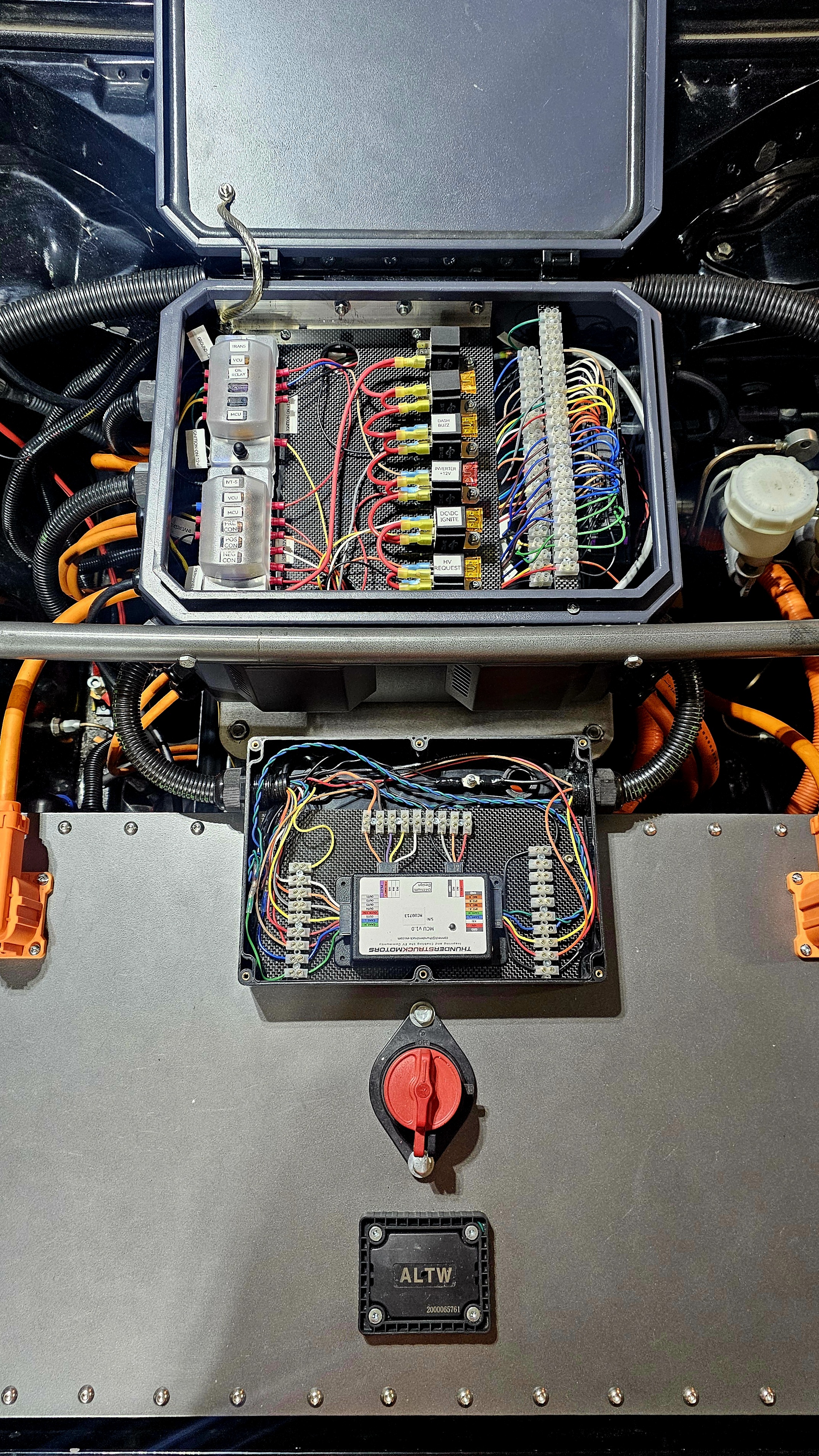

I have 2 issues.
1, its incredibly jerky but I still gotta play around with throttle parameters.
2, the HVreq doesn't work when it receives 12v, so I cant charge. It should simply go through the sequence of initiating precharge and close all the contactors? Is there some parameter that might be inhibiting the HVreq from activating.
Or is there another way to get the contactors to close to allow charging?
I have 2 issues.

Hi. Got the low speed judder sorted out. I was going the wrong way with some parameters.
Only way to get it to charge is to put it in run mode and plug in the charger.
Screen grabs of parameters

Haha, ya, so the zombie has little to do with controlling charging.
The Thunderstuck MCU looks after charging via CAN
I just need the HVreq to work to close contactors for charging.
Totally under the impression I just have to send 12v to the hvreq pin.
Sorry for the dumb query.

Hey thanks!
I have 4 a123 modules in 2 pairs. One up front and one in the back.
Wiring was quite simple. I don't know a massive amount about electrics so ive done what I feel is acceptable but not posting specs about wire gauge etc incase folks copy my ignorance. I have contactors and fuses in both boxes. I feel its a safe setup.
I have a 3.73 diff and my rev limit is set at 12k and I haven't hit that limit and I am getting 120kph.
First runs my rev limit was at 6k. And I was getting 88kph at that rev limit.
I think I have plenty of speed.
As the car is so quiet now ive pulled the rear end for a rebuild as its clunky and I had the 1 piece drive adapted into a 2 piece to try and alleviate the vibrations.
My battery setup all hinged around the Thunderstuck MCU.
Their system was incredibly easy to implement and make work with those a123 batts.
Poor Kelan at Thunderstuck must 100+ emails from me asking really dumb Qs
Hopefully ill get some decent miles on this before the snow arrives.
