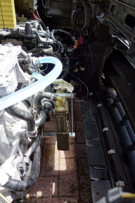

We have liftoff
Connected my trusty 32V Sinopoly pack.
Drove some 5m up and down the driveway. There is not a lot of torque but still enough to pull against the handbrake in 3rd gear.

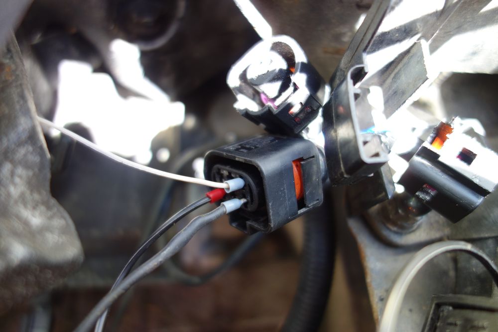

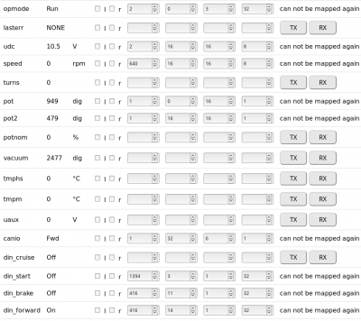

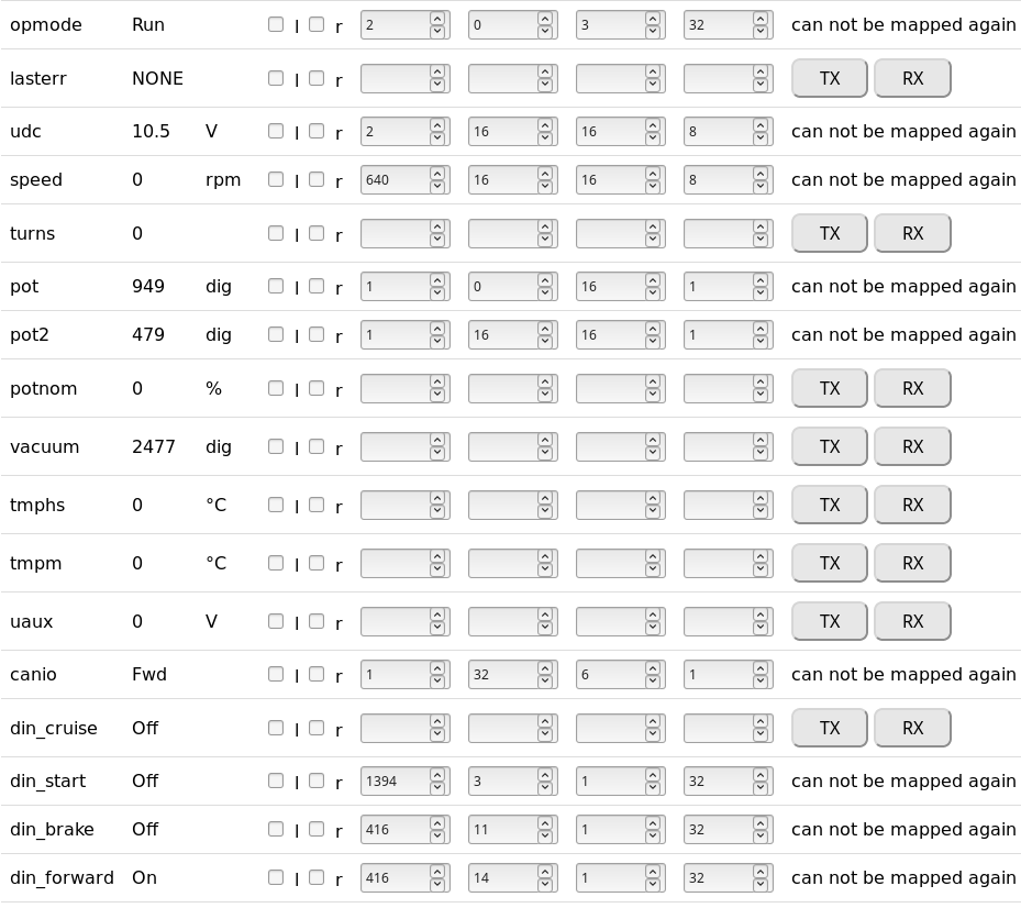

I took quite a liking of CAN today. I "wired up" the various control signals like key switch, throttle, brake via just mapping them on the CAN bus. So much easier then finding all that stuff in some convoluted wire harness. So there are just 4 wires connecting the Nissan to the VW world.

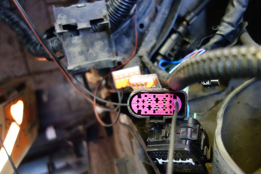

I've likely found the source of the airbag error. I had connected some "front bumper sensor" (whatever it senses) to the reverse switch of the transmission. They have the same plug. Stupid.
But I think the error must be deleted for the light to go out. Can that be done with Savvycan? Whats the cheapest way otherwise?

A vagcom cable should do it. About 10 Euros on ebay. Congratulations on the test drive. I have an 80v pack ready to drop into the E46.
- Been thanked: 1913 times
Yep, ordered one.

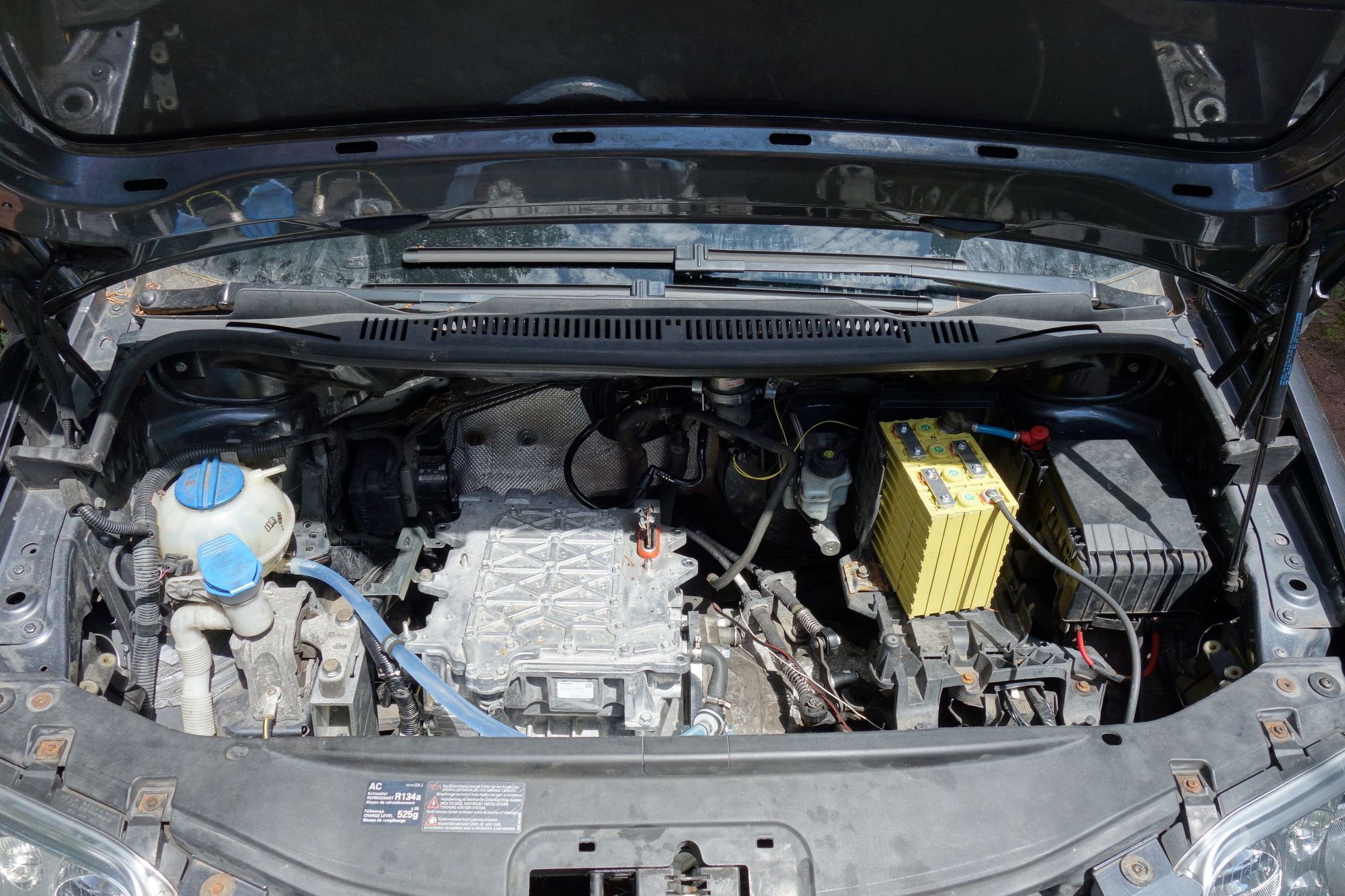

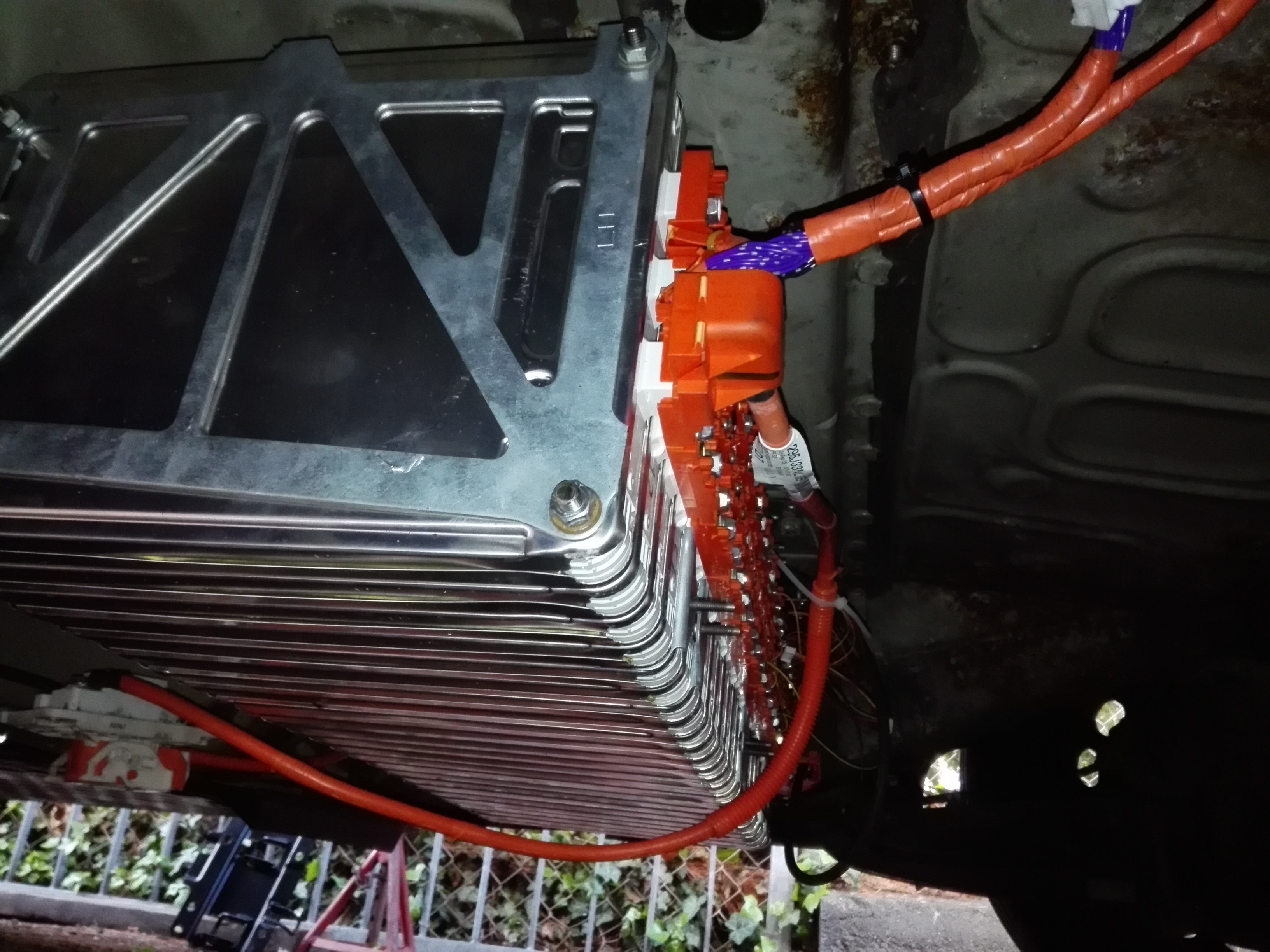

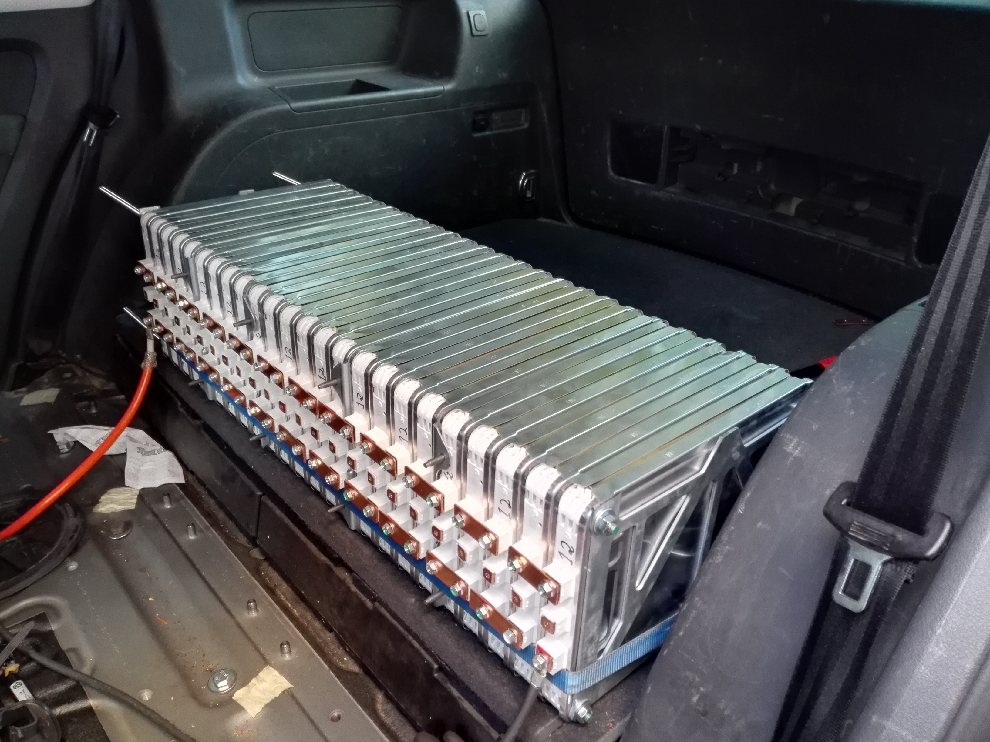

Mounted one battery in its final position and one temporary.
So now I could test at full voltage (380V). First thing I did was burning out the relay driver buried in the inverter
So I did manual precharging from now on
So when car is not in gear it tends to "idle". I got it to spin up to 4000rpm. The throttle/current curve is weird. When at high speed when I ease the throttle current actually increases. A lot to tune here. syncofs is 57000, next I will try the value that Arber used.
The first test drive was very slow and with unwanted regen. So just like Arbers experience.

Wow! So you actually did a full test drive with 360Vdc! That is a great step.
So did you use a strong steel profile to mount the battery pack? This will be tested now that your car will move and buck under 360Vdc.
I am looking forward to testing your findings in action.
A
No I was too lazy to change the mounts
I drilled the middle one so that it now also fits. Also re-tapped the hole with the damaged tread.

You will need to rid the code with a good diagnostic app. I remember leaving a connector off an airbag when replacing a VW Passat door once. The airbag light came on and stayed on. The code will not go out even when resetting the error codes in the normal way. You have to go deeper. I never did it again !! I used a VCDS unit.johu wrote: ↑Fri May 10, 2019 6:00 pm We have liftoff![]()
Regards and keep going. The end is near.
SDev
Yes will see what software is included with the Chinese adapter.
The culprit is the most probably the front airbag sensor. It must be close to the starter motor. I'm afraid I sold it with the motor? If anyone knows a part number, let me know.

Today I replaced the burned precharge resistor and put in a Meanwell 62A PSU as DC/DC converter. Works well off 370V.
So now I set about tuning the motor. I tried all syncofs values from 0-59000. Put the car in 3rd and handbrake on and tried to quantify how deeps it's pulled into the springs
0-4000 - little torque
4000-7000 - no torque at all
From 8000 - spins in reverse
From 12000 - little torque
19000 - possibly maximum torque
24000 - little torque
37000-41000 - no torque
42000 - starts spinning forward
56000 - possible maximum
57000 - declining torque
So indeed the no-torque offsets are 180° apart from each other and the maximum torque is about 90°onwards. Thats a bit of a surprise because I expected the offset between no torque and full torque to be only 45° on an IPM.
I also used the idle speed regulator to keep the motor at 1000rpm while changing syncofs. Indeed between 55000-56000 idling happens at around 4A phase current. Take it towards 58000 (10° more) and it increases to 50A. So that must be field weakening current.
So far so good, but the car is barely moving as soon as I put it in gear. It barely gets me up my driveway even though rms current quickly reaches 200A and sooner or later it trips out. Since others have been more successful I'm starting to wonder if something is broken. Checked:
Any ideas what else to try? Any good reads on IPM control?
