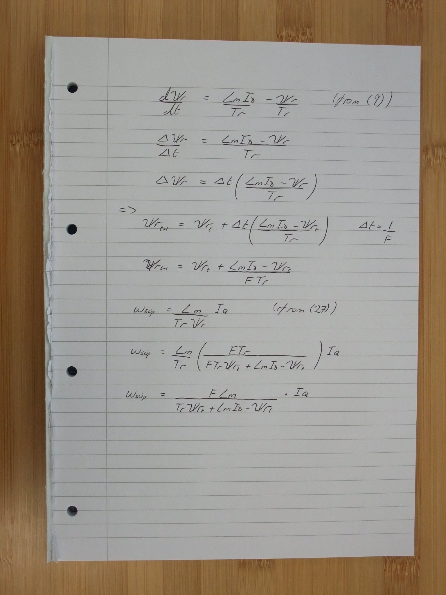

catphish wrote: Sun Feb 12, 2023 10:30 pm I'm not sure how best to explain, but I'm thinking that Lm multiplies the input value FOC::id, and hence comes along with it throughout the recursive process. Perhaps this is clearer if written like this:
   IdLm = FOC::id * LM;
   rotorFlux -= rotorFlux / TR;
   rotorFlux += IdLm / TR;
All terms just become LM larger.

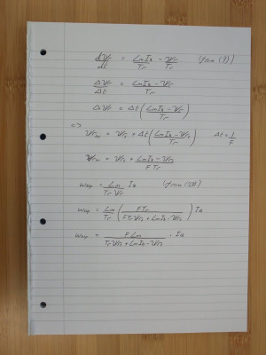

Had a look at this but still can't work out how Lm could cancel :? Here are my calcs in case they are of any use?

Pete9008 wrote: Mon Feb 13, 2023 2:52 pm Had a look at this but still can't work out how Lm could cancel :? Here are my calcs in case they are of any use?
Thank you for going through this. On the very first line of your calculations, you have "-Psir/Tr". My argument was based on the assumption that Lm and Id are both factors of Psir. If Ld were doubled, Psir would also be doubled independent of time.
I'm no longer certain that I'm correct here, but my best argument is as follows, this isn't a mathematical proof, more a demonstration of how it would be executed:
Starting condition:
Psir = 0
First iteration:
Psir = LmId / Tr - 0 / Tr = LmId / Tr
Second iteration (we insert the previous value of Psir):
Psir = LmId / Tr - (LmId / Tr)/Tr
Pete9008

Are you referring to equation (11) here? If so that is just for the steady state, where dPsir/dt = 0. Under non-steady state conditions I think you need the other term too.
Gut feel is that either solution will actually work, I think the extra term is mainly there to include flux decay due to rotor resistive losses and I would have thought that would be a fairly minot component compared to everything else.

Pete9008 wrote: Mon Feb 13, 2023 5:05 pm Are you referring to equation (11) here? If so that is just for the steady state, where dPsir/dt = 0. Under non-steady state conditions I think you need the other term too.
Nope, referring to Phir in equation 9 - the one that's self-referential. I'm suggesting that if you replace Phir with... itself... Lm and Ld appear as factors.
NB: this really isn't very important, probably best not to spend any more time worrying about it for now.
