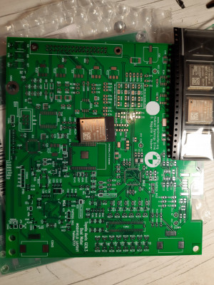

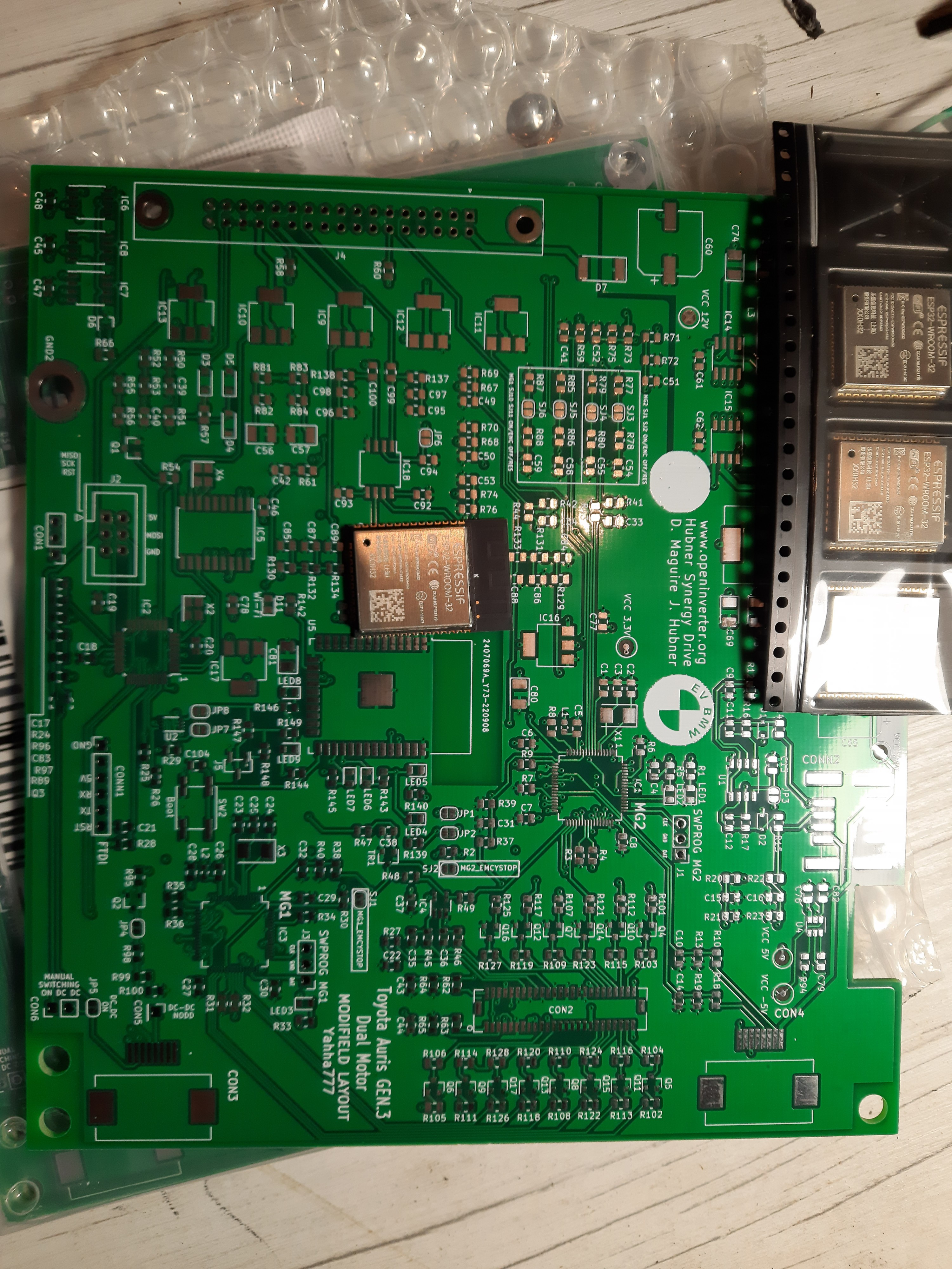

I found JLCPCB stocks an ESP32 (ESP32-WROOM-32E) module that they can solder directly to the board for about $3
They also have an ESP8266 module but that is out of stock. So I think I will make a variant of the Nissan Leaf adapter board that takes this and as I understood the web interface runs pretty much as is on the ESP32.
If that goes well I will put it on the other boards also. Not sure about adding an SD card slot or just use the streaming variant - with the clear downside that it requires a receiver to be running. But could be just another ESP32 that's listening?
Yahha777
- Posts: 53
- Joined: Wed Feb 27, 2019 7:03 am
- Location: Belorussia. Borisov
- Has thanked: 16 times
Re: ESP32 Based Web Interface & Data Logger
Yes, that's a good idea! In terms of hardware, I solved it. Now it would be even better to run both UARTs for two controllers just came from JLC. While there is no time to fill in the components.johu wrote: ↑Tue Oct 11, 2022 3:10 pm I found JLCPCB stocks an ESP32 (ESP32-WROOM-32E) module that they can solder directly to the board for about $3They also have an ESP8266 module but that is out of stock. So I think I will make a variant of the Nissan Leaf adapter board that takes this and as I understood the web interface runs pretty much as is on the ESP32.

- Been thanked: 1918 times
Very nice! Yes those dual usart would be ideal for this board.
Did you do it in KiCAD? Is it on github?
Yahha777
- Posts: 53
Yes - it's made in KICAD. This is my second attempt to create a board, the first had some errors. Not on GitHub. I can share.

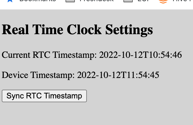

Added setting the RTC from the web interface.
Will look at the SD Card downloading next.
