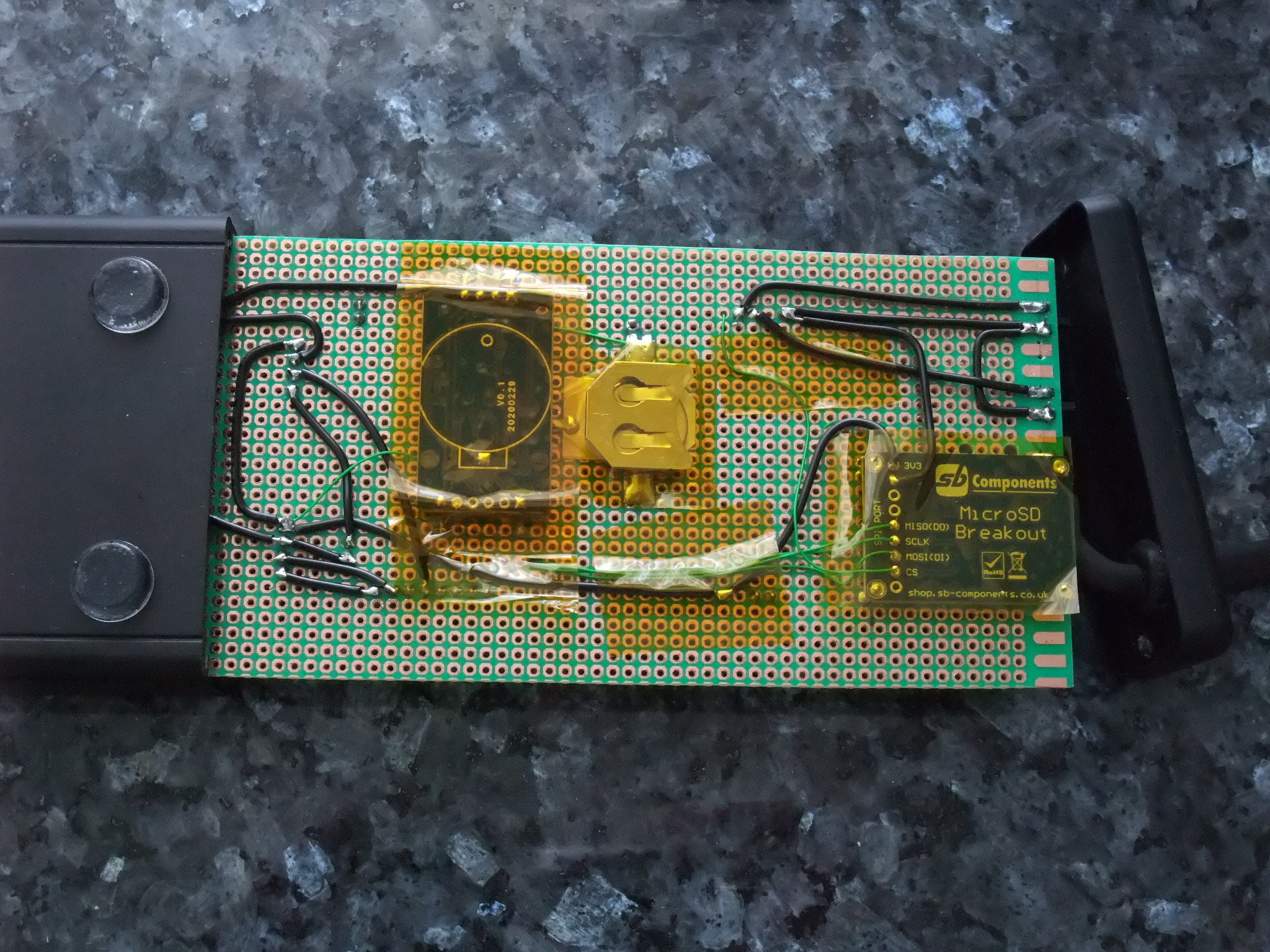

This was the CAN logging setup I ended up with:
The GVRET box is connected inline with the engine ECU, the car side bus connects to one CAN port on the box with the engine on the other. The box is then set to do port forwarding so that the intercepted messages get forwarded on to their destination as well as being logged. This setup means that the log file contains details of whether the source of the message was the car's bus or the engine ECU and so saves a lot of guessing. Tip - if doing this and saving to SD card make sire that you set the box to GVRET format, if you leave it in the default CRTD mode it doesn't save the source bus information.
The power supply for the box was initially from a cigarette lighter USB adaptor which meant that it turned on and off with the ignition (and so could be left connected without draining the car battery). Unfortunately, while the car started and appeared happy, the ESP and ABS were non functional. Presumably there is some early initialisation that was missed while the box booted up. Powering the box from from a separate battery sorted this.

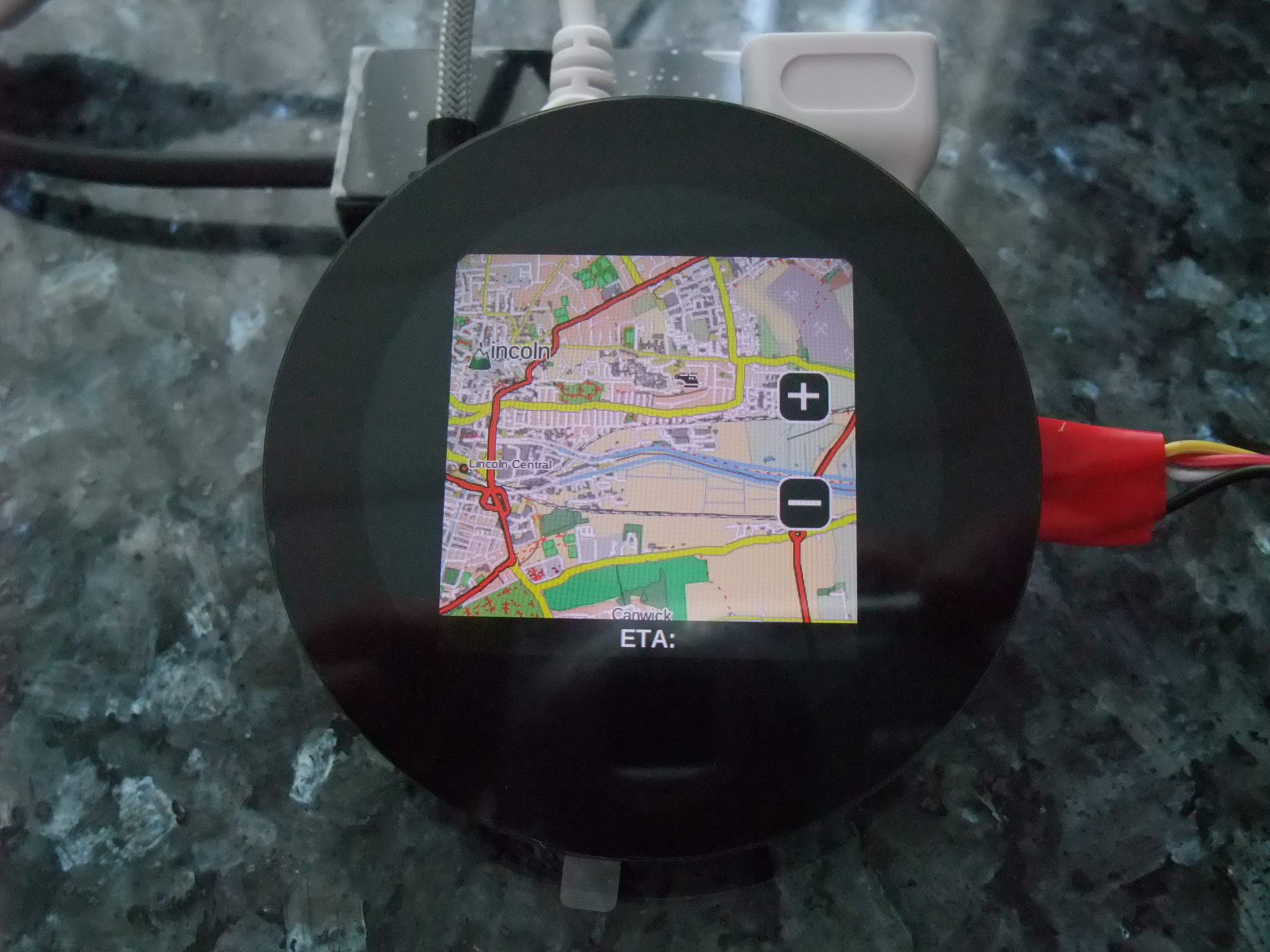

On a completely non related topic I have also started playing with a replacement for the rev counter. This is the standard instrument cluster:
The right hand RPM gauge will be fairly useless following the conversion. I considered repurposing it for something but it seemed a bit of a waste of space. Instead I'm going to use a Pimoroni Hyperpixel display, these are round, 480x480 pixel, IPS displays that are just about the right size to replace the rev counter. A Pi Zero 2W plugs onto the back meaning that it can be programmed using any standard Linux tools (I've got it set up with remote cross compile and debug in Qt which simplifies development). This is a mock up of what the screen will look like in normal operation:
The ring round the top half will show battery current (regen on the left, drive on the right, colour coded to battery capability - green up to 3C then turning to red), the middle bit is predicted range with inverter and motor temperatures below and then battery voltage and temperature graphed below that (again colour coded, red for anything that is not considered normal - no idea what sensible limits should be here!). Beneath that is a general info/warning/error display. It will also be active during charging to show charge status.
There is also a I2C to CAN bus board connected that will be used to pick the required messages up of the bus.
At the moment it's just a basic framework and still needs all the CAN message handling adding.
I also added Navit sat nav to it - not quite sure why but then why not!
The satnav turned into a bigger project that the gauges in the end, and probably not worth the bother, but it's done now.
