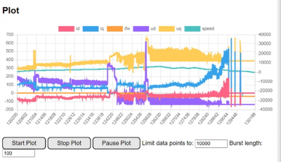

Below is the plot recorded during self-acceleration due to FW. ud is maxed out but uq is not. It rather looks like it has a new minimum value that it can’t fall below.
johu wrote: Fri May 27, 2022 3:17 pm I also added SW ocurlim. So when software measures il1 or il2 > ocurlim it will shut down
This change is not on github yet, is it? Sometimes during those strong regenerative braking incidents, id shoots up to some crazy value (>10000) for a split second. I am afraid that this is due to a faulty readout from the current sensors and thus, maybe il1 or il2 are also at some high value. If the inverter shuts down at such a moment, this would put me in full regenerative breaking at high rpm, wouldn't it? That’s something I do not want to test ;).

LeonB wrote: Fri May 27, 2022 4:10 pm Below is the plot recorded during self-acceleration due to FW. ud is maxed out but uq is not. It rather looks like it has a new minimum value that it can’t fall below.
Thanks for the plot. I'm assuming it's with the last firmware 5.23.B?
Is self-acceleration less pronounced now?
Yes if FW collapses you get a short burst of strong regen until motor speed drops to generate less than battery voltage.

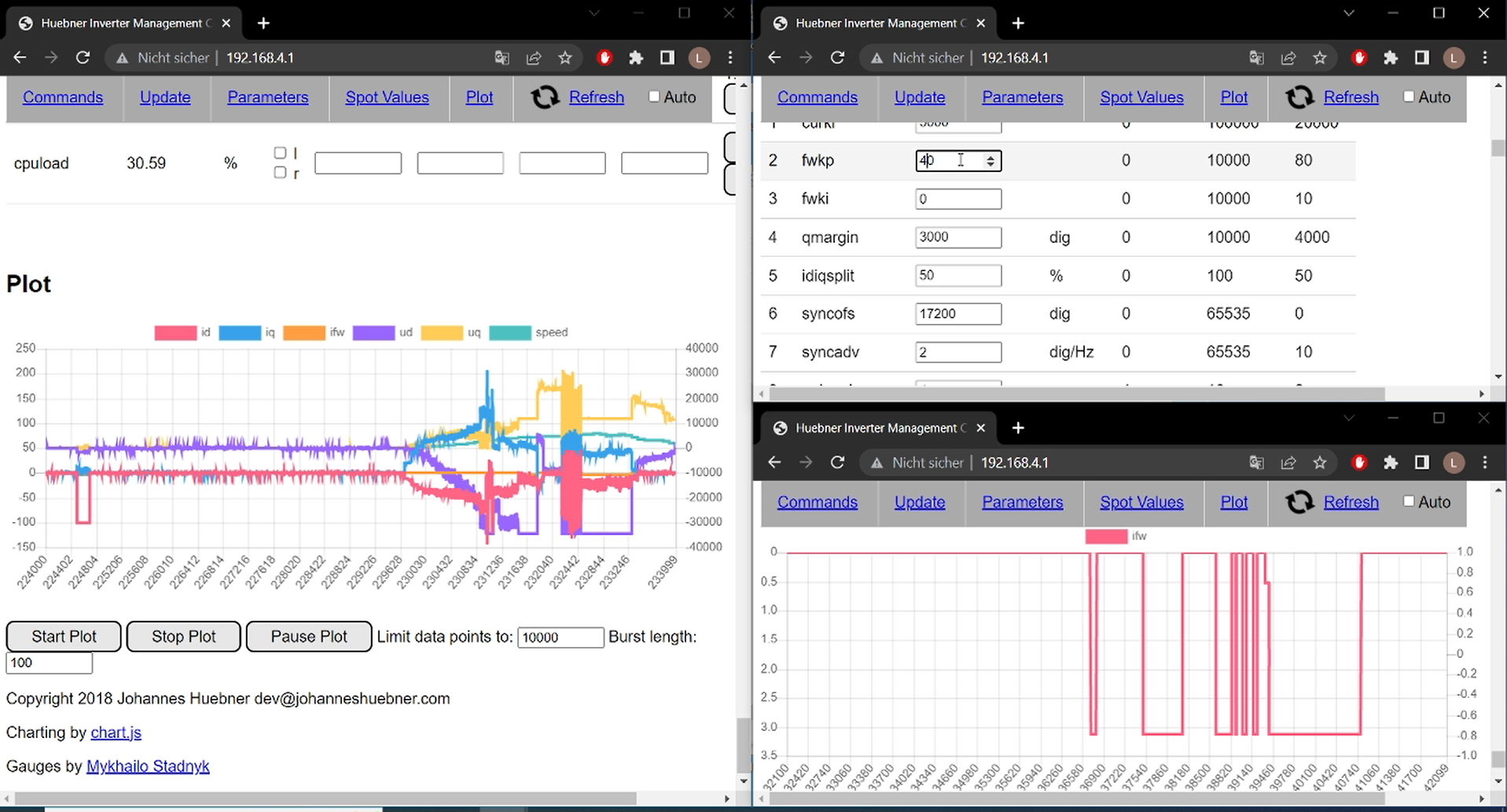

I just tried the newest firmware with the fix. First I wanted to optimize syncofs and syncadv: I started with syncadv = 0. I accelerated normally to various rpms and then switched to idiqsplit = 100. Then I tuned syncofs so that I could push down the gas pedal without creating any torque. This gave me some values from which I calculated syncofs at 0rpm and a suitable syncadv. I ended up with syncadv=3. It’s a bit tricky to maintain constant rpm but in the end it worked quite well, at least for throtcur=1. Going above that led to a very quick acceleration at some critical id value >100A, resulting in a software overcurrent error (that also works ;)). So I remained at throtcur=1 for the rest of the test.
While doing this I noted that at 100% throttle, the uq amplitude seems to be capped just above 10000. When letting go off the throttle it is able to reach higher values. This was with fkwp=fwki=0 and qmargin = 3000:
I then tested with fwkp=10. There was no uncontrollable acceleration but also no other effect. Ifw reached a maximum value of 1 and oscillated. Below are the plots for fwkp=40. This created some rattle and noise (as can be expected from the id and iq currents oscillating with >100A amplitude). After letting go off the gas pedal, the oscillations stopped but there was some weak self-acceleration. What only came to my mind after the test drive is that ud was nearly maxed out before FW kicked in. Thus, it had a hard time to add even more id. I will try again with lower idiqsplit.

Actually that looks pretty promising. Good work finding the matching syncadv. Actually 3 is quite close to my earlier uttered theory comparing the age of id/iq and angle. Now the FW controller needs more gain because it hardly seems to do anything.

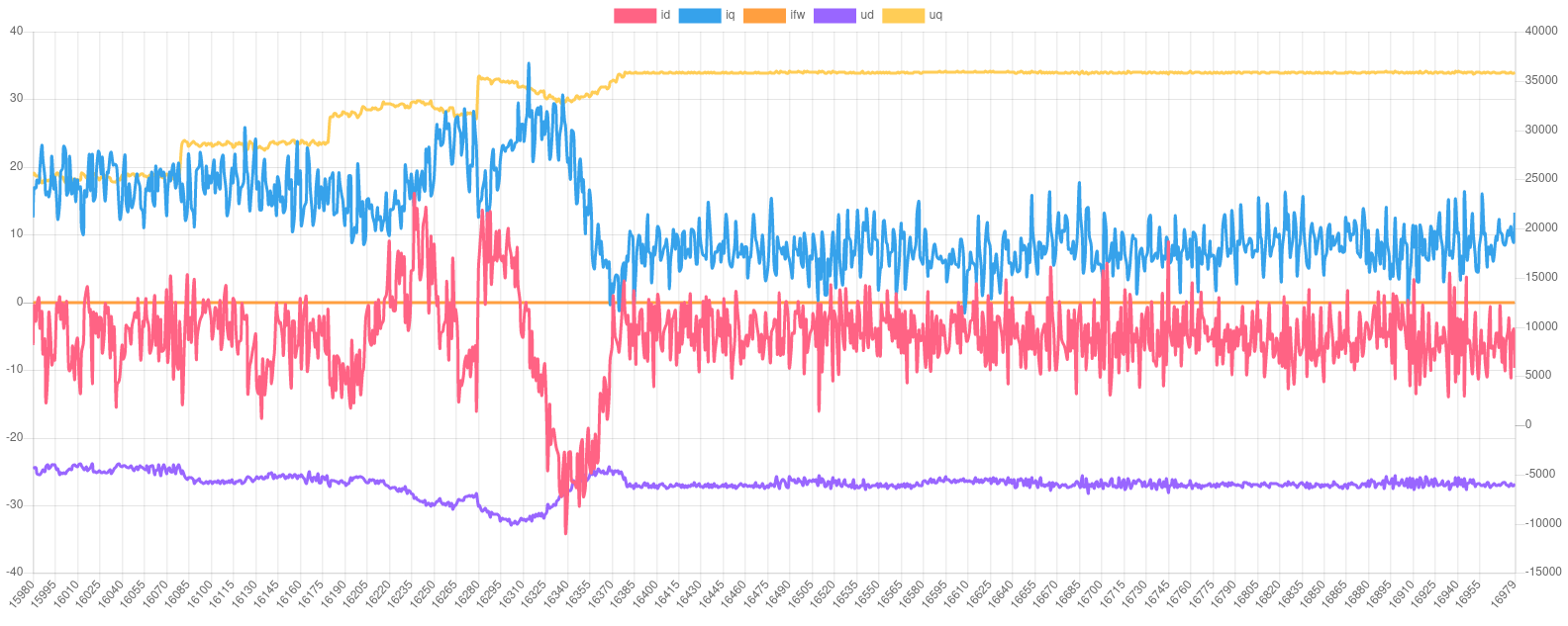

I tried again with idiqsplit down to 20% and fwkp up to 400. There is no change in the behavior, ifw still maxes out at 4 and everything is oscillating heavily. fwki=0 for all tests, as even in standstill any value above 0 causes some rattling in the motor. Below are examples with fwkp=100 and fwkp=400. Notice that I have a quite high curkp, so even without FW there is some oscillation of the PI output values, id and iq. I have spent quite some time trying to get curkp lower, but there are always unwanted effects (self-acceleration, torque oscillations, ..) associated with that.
Again, throtcur=1 was used. I then tried to tune syncadv for bigger currents, but it seems impossible. I went along a small decline with the handbrake at just the right position to keep at constant rpm. Then I changed syncofs in a range of 2000 with 100- and 50-digit steps around the suspected value-> I could not find a value where the motor would not start accelerating in the region of id~150A.

Oh, ifw display has a bug but the actual value should be correct. Tripped over my own fixed point math wire... So when you see 4 it is actually 4*32
Now see what happens at lower kp values, hopefully oscillation goes away

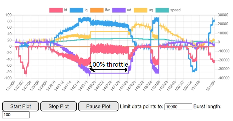

Now tested myself and I have to say it's quite useless. I turned off FW by setting both gains to 0 and I still got self acceleration.
Also went back to legacy FW with just the amplitude limit only to find that it doesn't actually make a whole lot of difference. Shortly before reaching max amplitude there is still a wiggle. If curkp is too low (32) this wiggle becomes so strong that it trips on overcurrent. Once I've "punched through" it the wiggle is gone and everything is smooth again.

Yes, I can confirm that there is basically no effect. Whenever FW kicks into action, ud gets or is already maxed out. So even when switching fwkp around, between values of 0, 10 and 20, there is no difference noticeable. Only when getting to fkwp=30 (where ifw~120A), the rattle and oscillations start again.
As a side note: If I got this right, the new FW algorithm tries to change the angle of the id-iq vector towards the id-axis to create more id current while keeping the total current constant. Isn’t that rotation equivalent to a rotation of the measured rotor position? I tried to tune syncadv with FW disabled and it makes a strong difference, the motor accepts 3 times the power at syncadv=35 compared to syncadv=3. Of course, syncadv is coupled to frequency and not uq and this is probably what makes it unstable at higher rpms. But maybe one could botch a FW algorithm which changes syncofs depending on uq amplitude?
