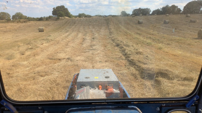

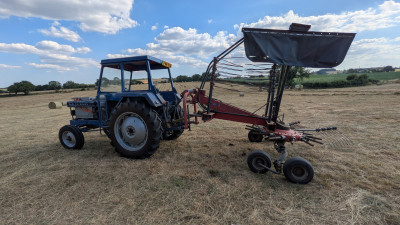

Finally done the first bit of actual hard work with the electric Leyland today. Had it on the hay rake rolling up for the baler. I was quite happy with the results. The power usage was really much lower than I was expecting. This isn't a small rake, a bit big for the tractor really given it will lift the front wheels off the ground allot when I'm trying to turn around at the end of each row. But max power draw I saw was about 11kW when I was going uphill, going down hill and hitting the rpm limit I would only pull around 4kW. The motor hardly noticed, in 31C ambient temperatures the motor maxed at 41C and inverter at around 36C.
So for being out for several hours I only used around 13kWh of power.
I didn't have it fully charged to start with, but we had to stop because of a flat tyre on the rake rather than needing to recharge. It's really very encouraging on what this tractor can usefully do. I will try and get it on a small square baler as I think the power requirements for those are also quite small. The big round baler is probably too much to ask as the PTO requirements for that are around 50kW, no question it will run it, but just not for a useful amount of time.
I also got it insured last week and the new logbook came back last month. So I would now call this complete on the paperwork side at least. Still need to put the bonnet on one of these days! I also bought an LED light bar and some rear work lights for winter work.

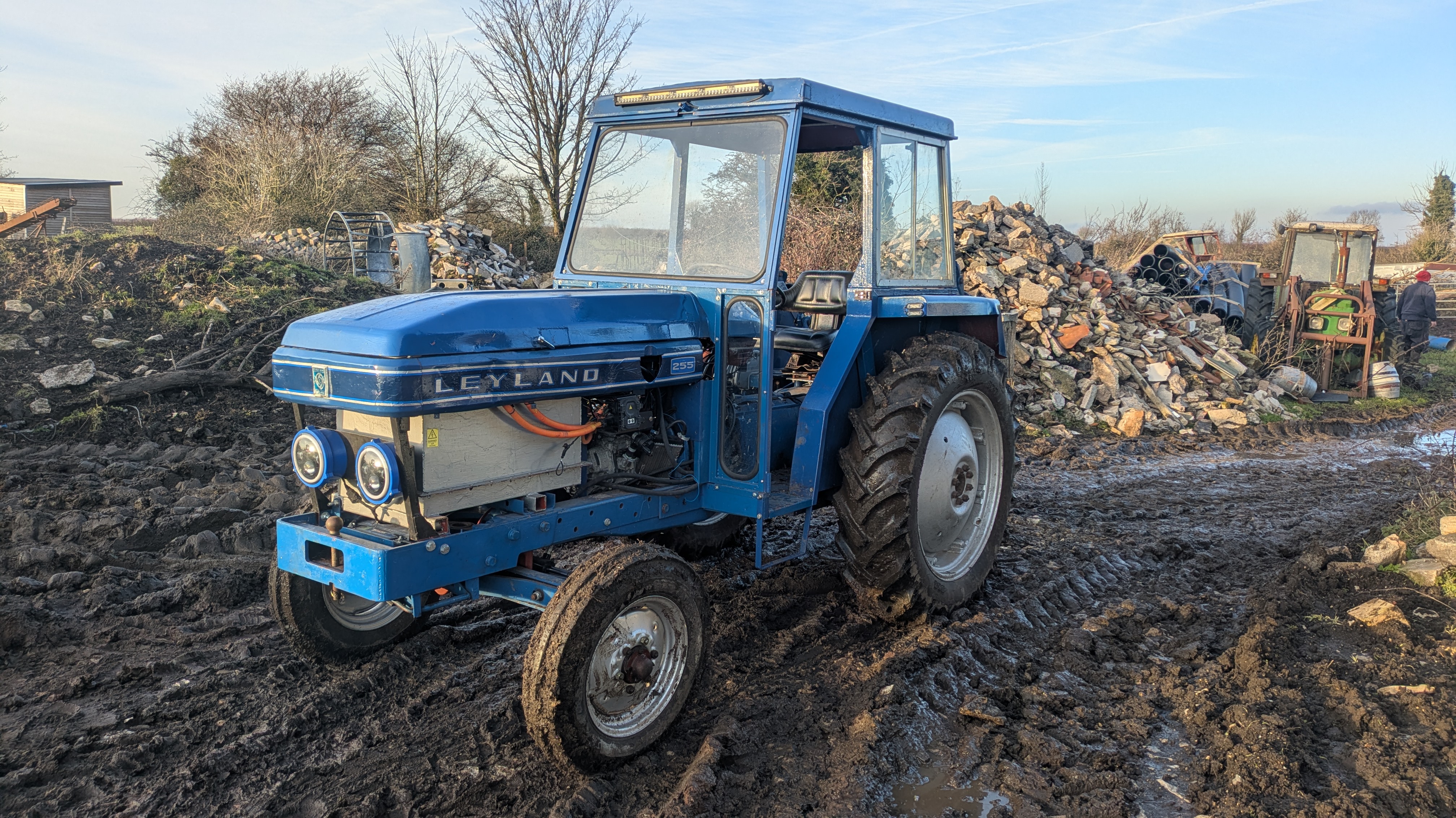

Haven't managed to do any baling yet so far with the tractor. But I did use it last weekend to bring a field of square bales in, around 6-7 trips back and forth. Energy usage is so small it could do this for a couple days on a single charge.
The torque is great though, just leave it in top gear and it goes anywhere even with a full load on the back.
This weeked I brought it down to my house in preparation for the Mid-Somerset show. About 10 miles which it did just fine. On the way I took the oportunity to test a CCS charger. I wasn't sure quite how it would go as I didn't have time to log into FOCCCI and check any settings. My setup isn't quite right right so my SoC isn't that accurate currently. However to my surprise it click in and started to CCS charge first time! I didn't stay for long as the battery was still quite high.
Rather annoyingly I didn't take any photos from the show today, but here's one from a smaller show I dropped into last weekend in-between getting the bales in.

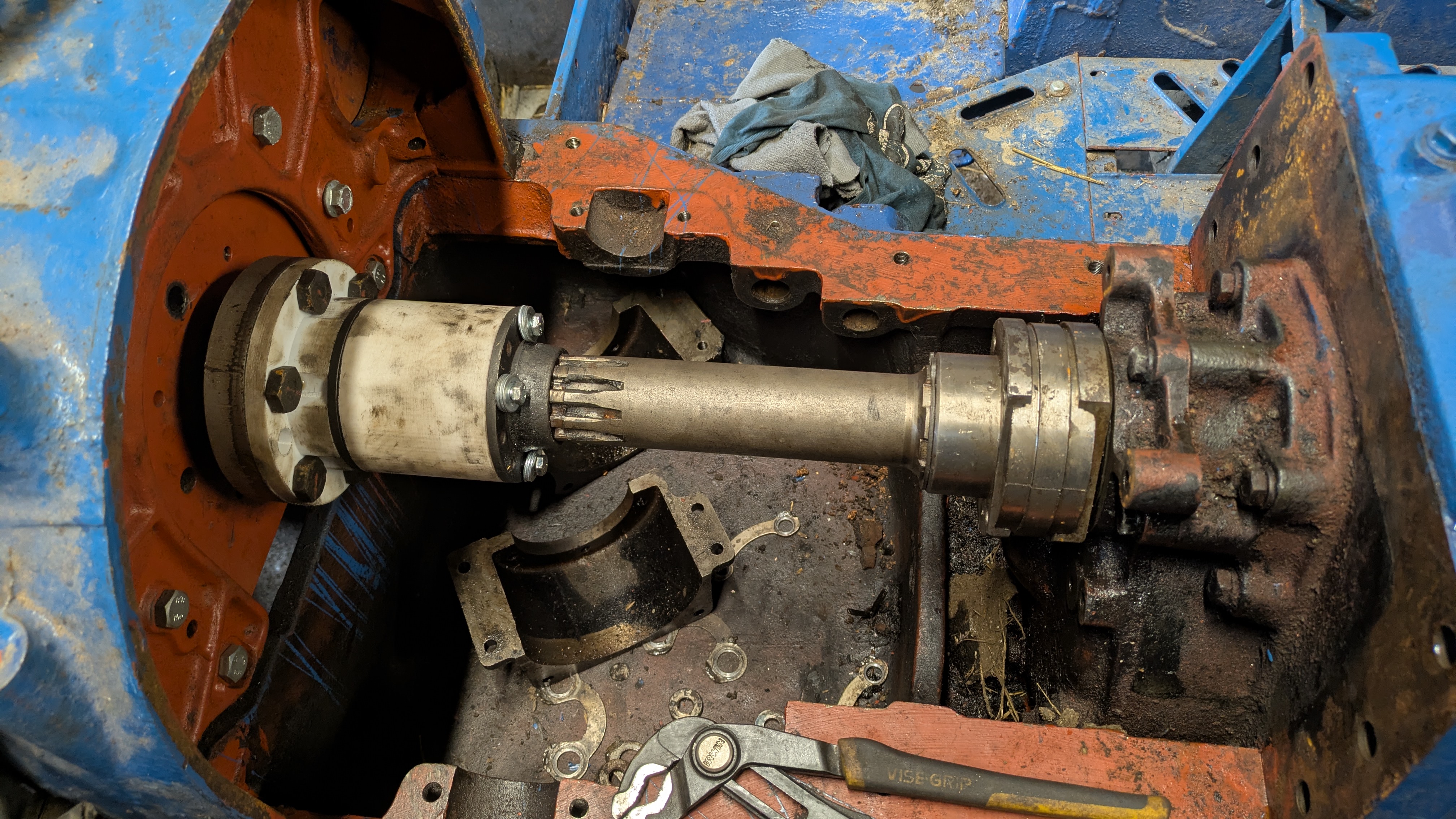

With a good bit of road use I have decided that I will be removing the flywheel and clutch arrangement over winter. It isn't mounted 100% centred so it is limiting my rpm more than it should. This doesn't make any difference in the field but on the road it does make it a tiny bit too slow. I never use the drive train clutch anyway and I have found that I don't really need the PTO clutch either. Since I can spin the motor down instantly it's not like having to turn an engine off to engage PTO drive or change gears.
With the flywheel removed I know the gearbox can take allot more RPM than standard as it's used stock in tractor pulling builds well over this sort of power.

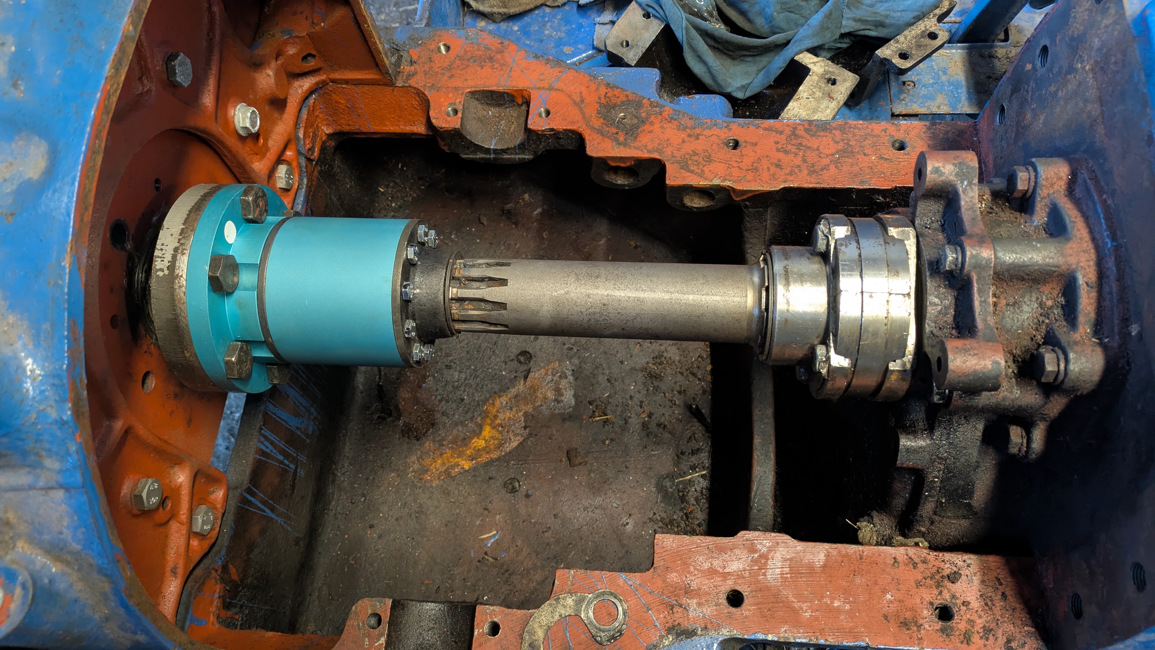

I've spend the last couple of weeks working on the clutch delete. The tricky thing was indeed connecting up the PTO input. However the solution is looking quite simple in the end. Luckily the bolt patterns for both clutch inner parts are the same. So I can just bolt them both together onto the first adaptor plate.
A couple of adjustments to make then I'll get those made up. Already removed the pedals so that frees up the left side of the cab completely.
Working on a new neater fusebox, then when that is all put back together it's onto the charger integration and BMS. Can't wait to have it moving again, I already miss having a tractor that just works when we need to move something around the yard.

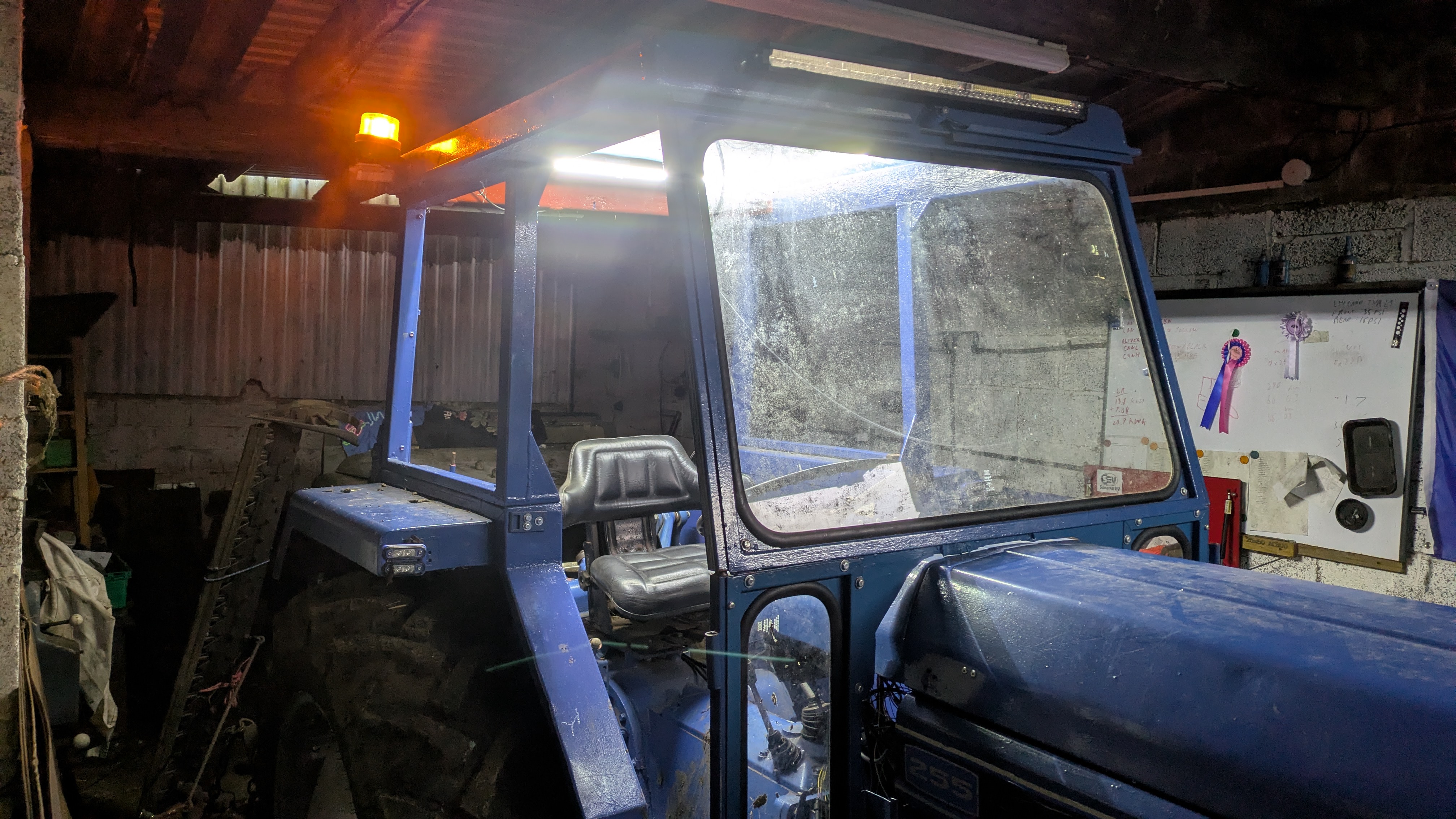

Tractor has been back together since the new year. JLCCNC got the part delivered before the shop down the road replied to my first email.
Finished up the new fusebox which is neater, but my wiring going to it is just as untidy so I forgot to take a photo of that.
I did finish up some bits that I never got around to last year. Now have a nice cab light and beacon, as well as trailer light socket and rear number plate light. So 12v wise I think there is just the wiper motor left to wire up.
With the new flywheel delete I upped the max RPM to 2500, up from 1750 that I was using last year which was limited by the flywheel being slightly off centre. On the road it's quite terrifying now at 20mph, but about what it did with the stock engine. It's very smooth so I could definitely up the RPM limit but the brakes on these were bad 50 years ago.
Very much looking forward to doing some actual farming this year. Looking to secure my own 20 odd acres to run things how I want. But I'm sure I'll get plenty of work done with it whatever happens.
Still a bit of work to do on the MG charger integration. Currently charging through FOCCCI interface at the moment which is a step up from last year at least.
