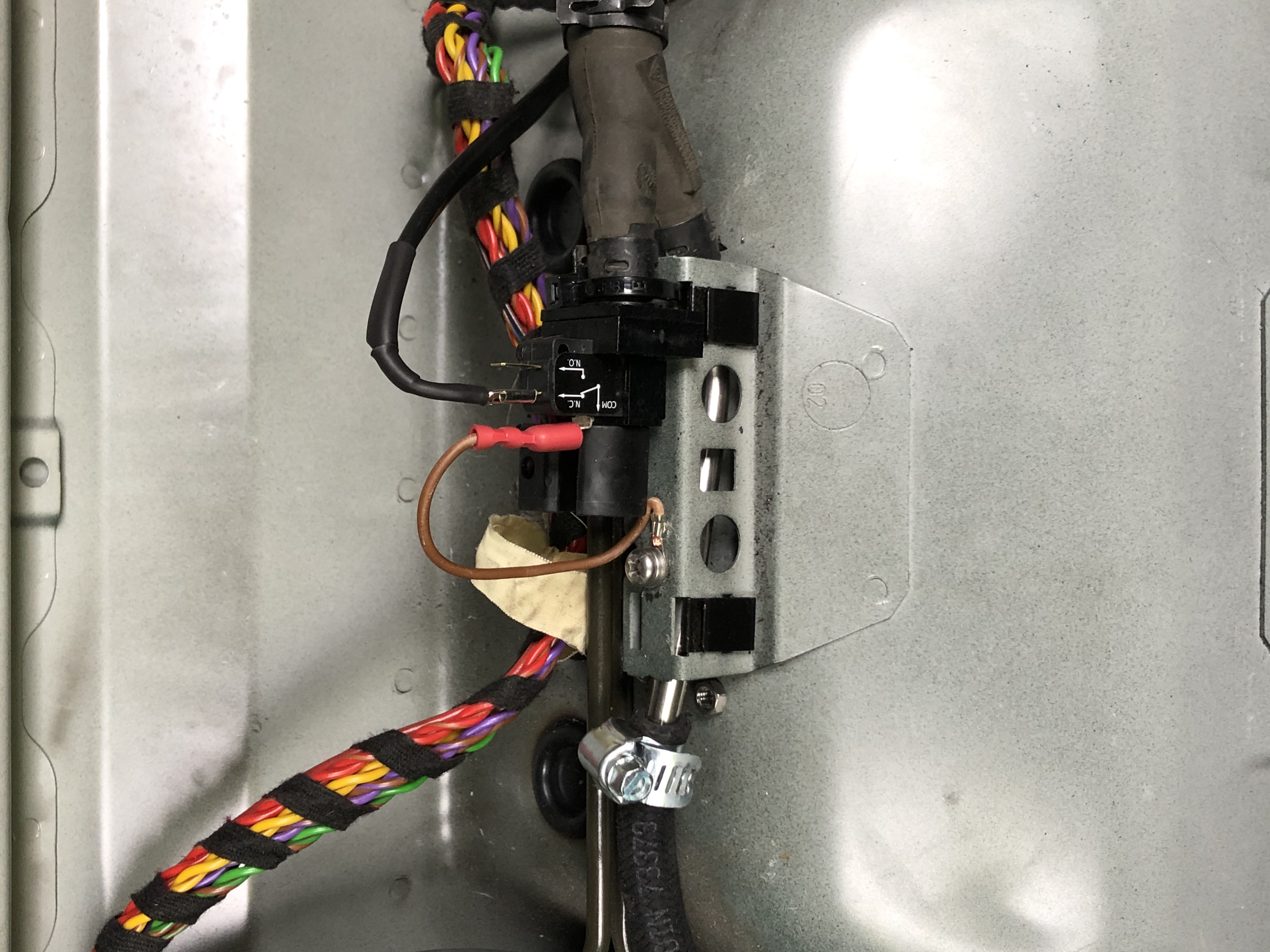

Just wanted to provide an update to the cheap Chinese Dracarys brake vacuum sensor. It’s junk so I binned it. Worked perfectly for a month or so then started playing up.
I’ve upgraded it to the multicomp PSF109S-81-330 as recommended. It now works as expected with the pump kicking in every few presses of the brake pedal. Cost was £30.
Installed on my Porsche:

Well yes Dracarys switch can act up. But really it is just a mechanical switch with brass body, membrane, nut and spring. You torque the internal nut and increase pressure so equilibrium is reached sooner or later.
Whenever it acts up i remove it from my car and clean it up and reset the spring. This spring sometimes wedges against membrane and switch is allways on or wont work. After i cleaned it, it works as before.

I just don't want to have to worry about 'servicing' it every few months. Better to just buy the unit above and be done with it. Also, the multicomp version is adjustable. I've done 250 miles on the car since fitting and very pleased with the braking performance.arber333 wrote: ↑Tue May 05, 2020 3:38 pm Well yes Dracarys switch can act up. But really it is just a mechanical switch with brass body, membrane, nut and spring. You torque the internal nut and increase pressure so equilibrium is reached sooner or later.

I agree. I need to warn you though, i used the PSF109S switch in my car. After couple of years of use i saw its contacts rusted out since they are exposed to elements. If you put the switch in a box then i think it will not rust.

Thanks. it's already inside the car (in the frunk) so it should be fine. I'd be happy to service or replace it every few years if necessary.

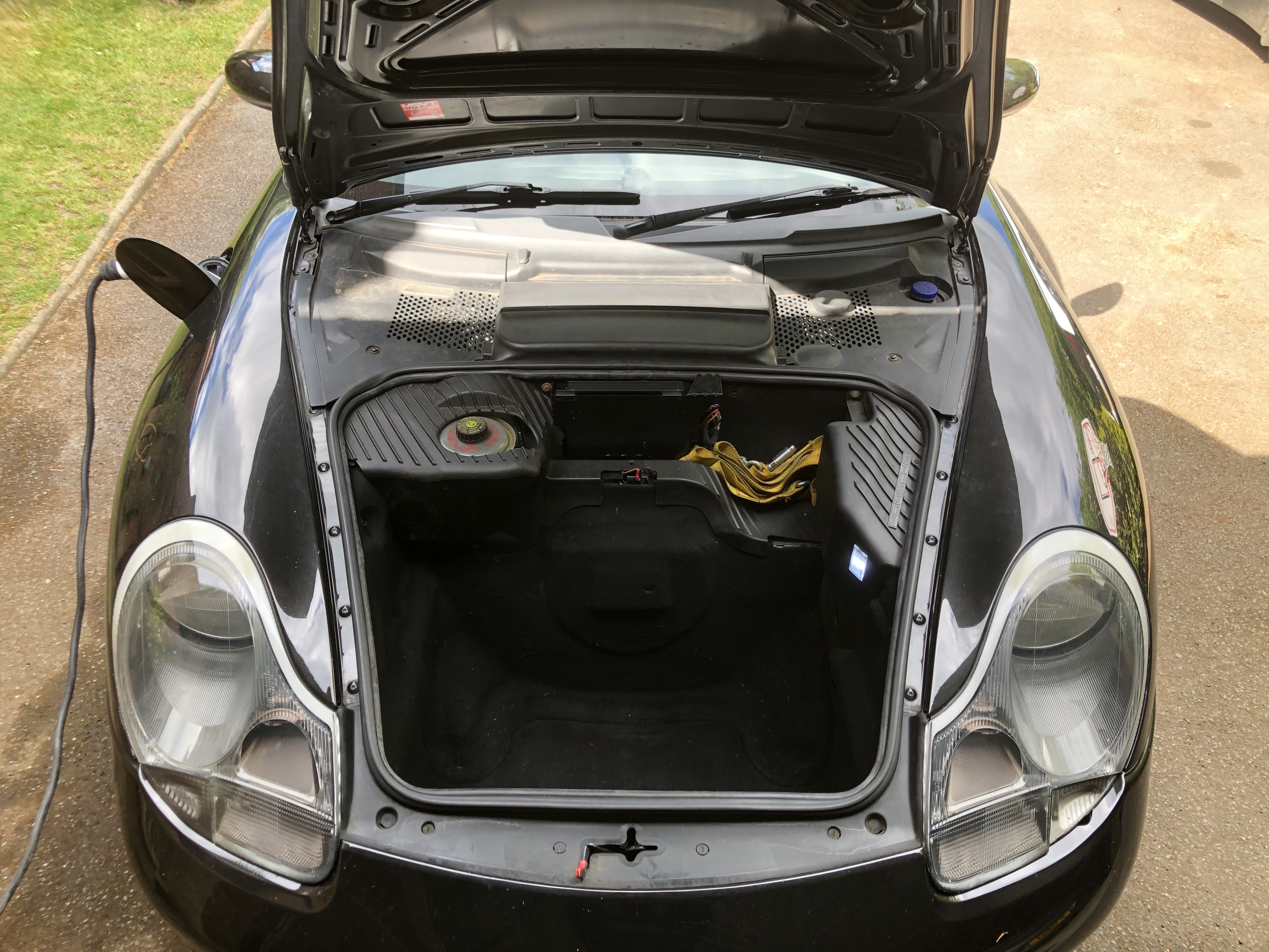

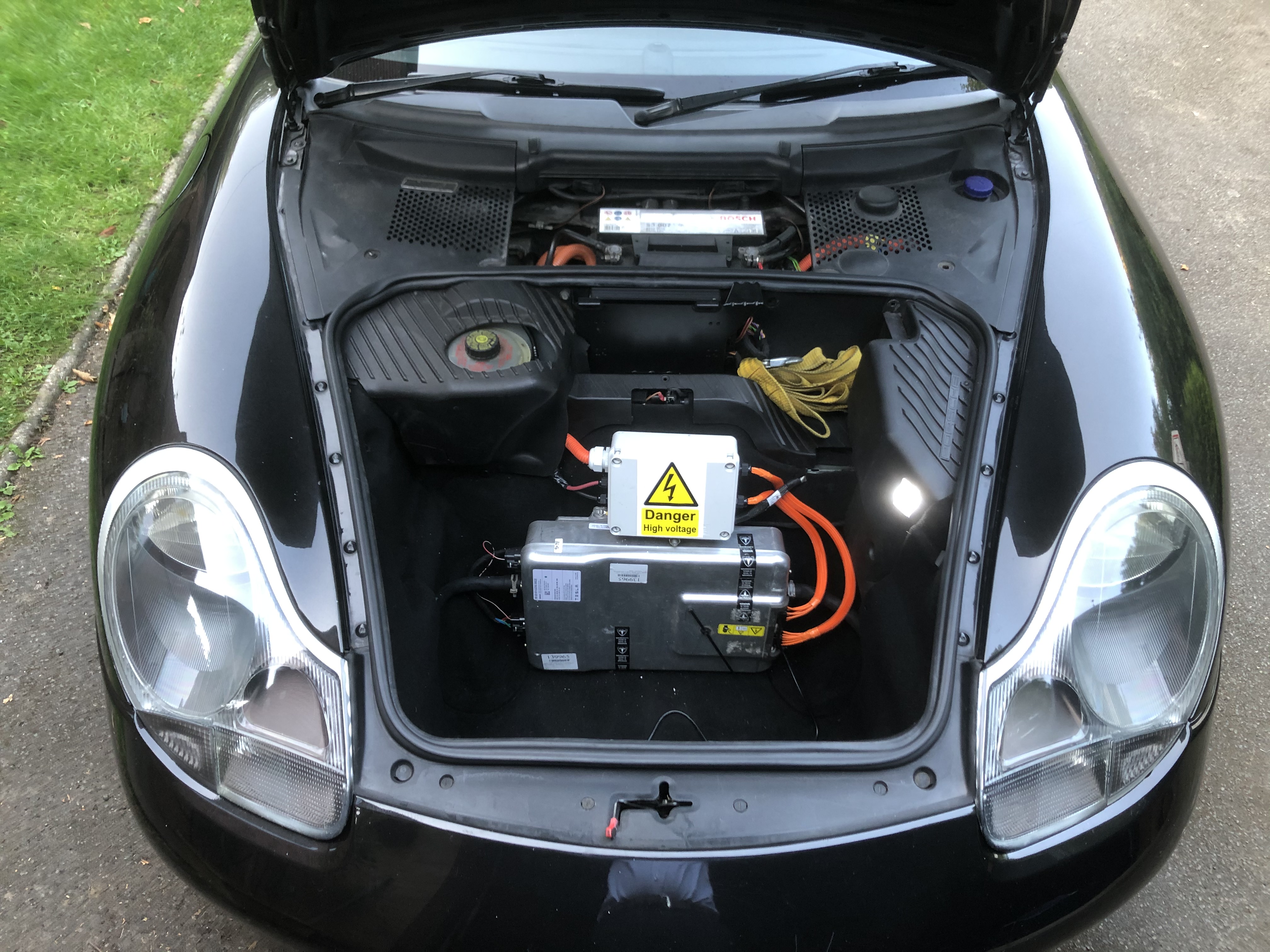

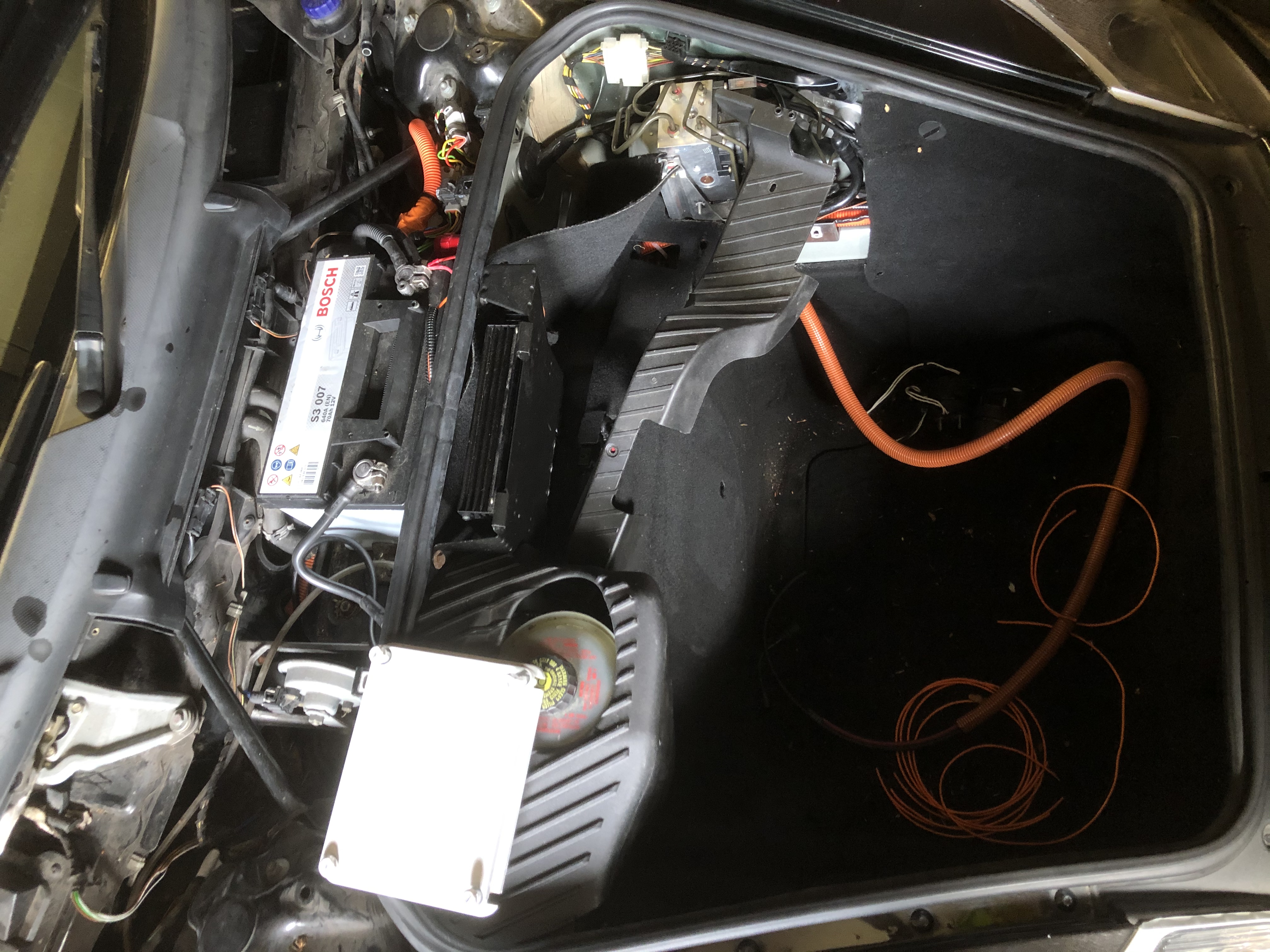

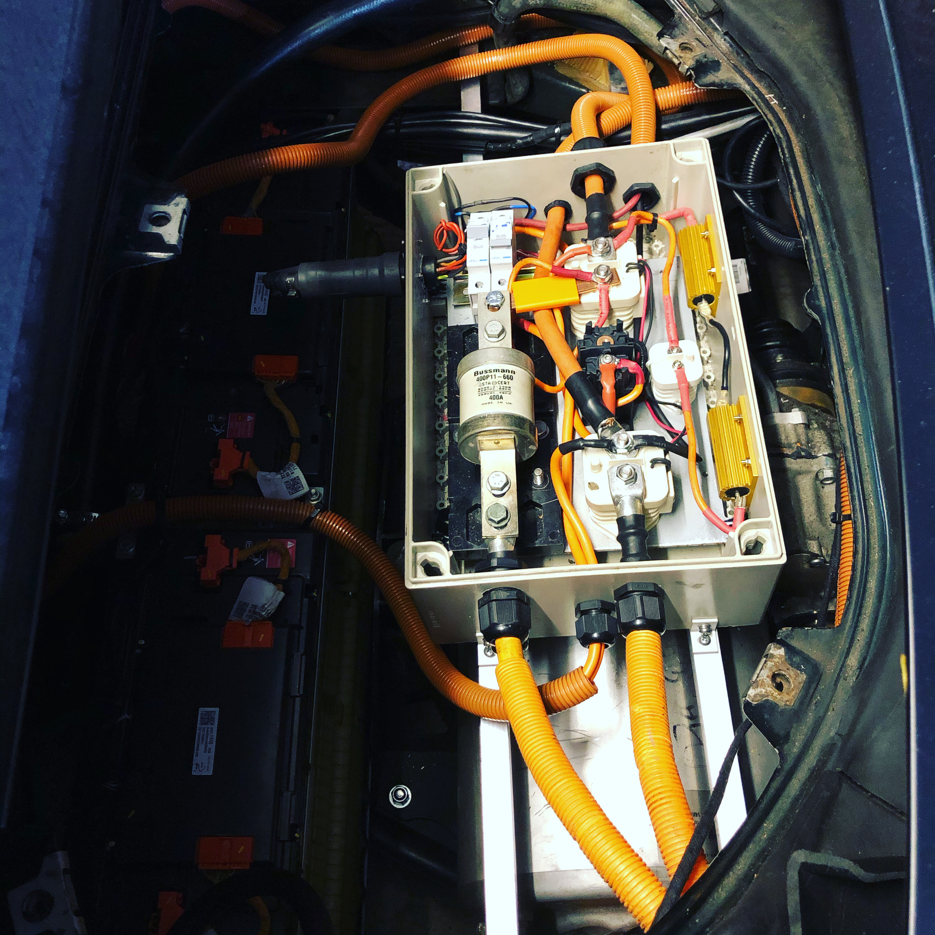

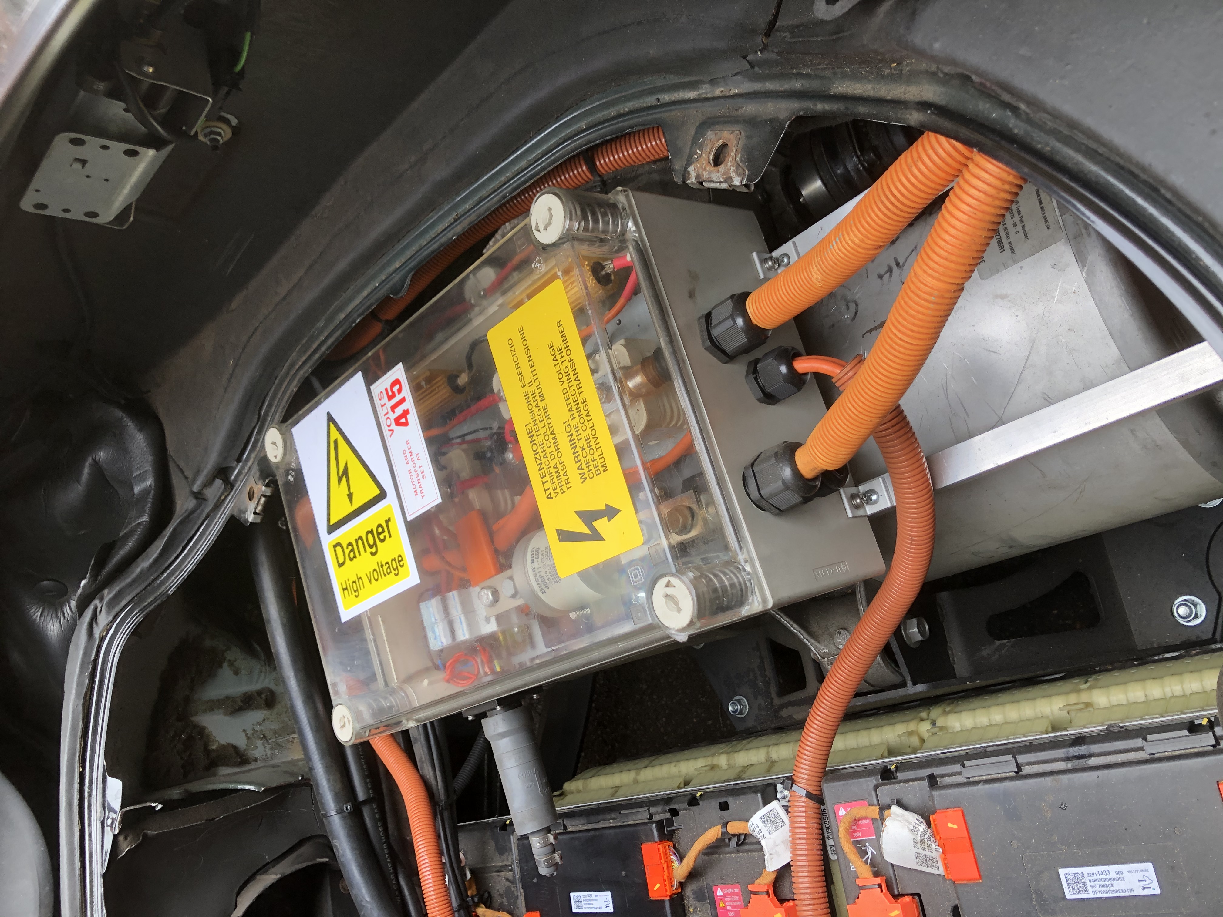

A few more updates:

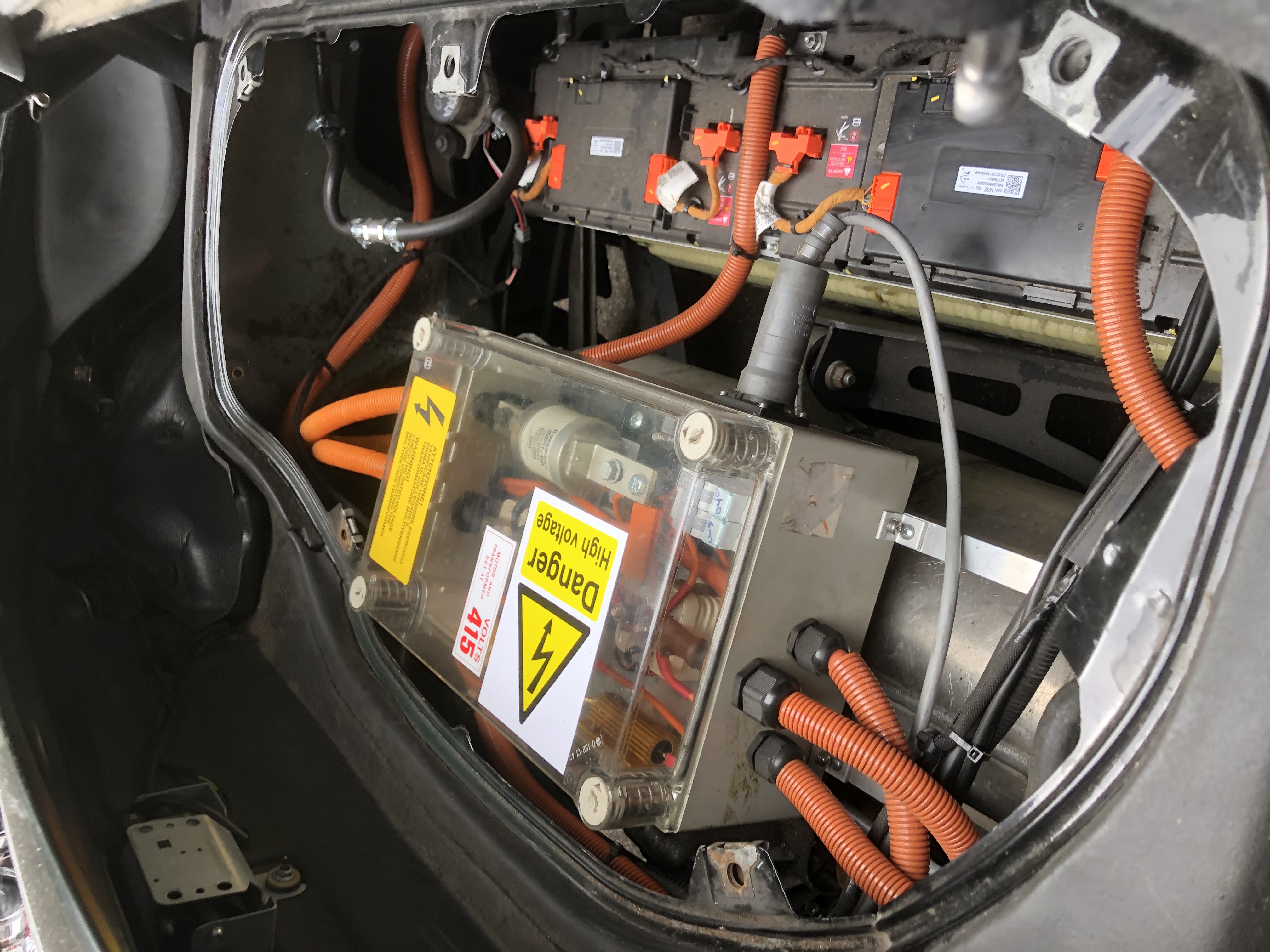

I placed all of the carpets back in the frunk (you can just about see the wires for the vacuum sensor):
A little tidying up of the HV junction box, but still more to do:

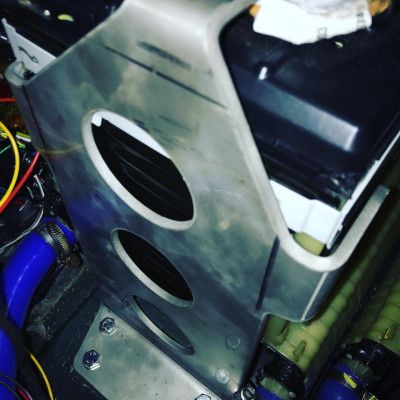

Fitted a battery brace to the middle battery:
The car is driving really well and I'm starting focus on some of the 'nice to haves', such as getting all of the gauges working, lock pin for charge socket etc.

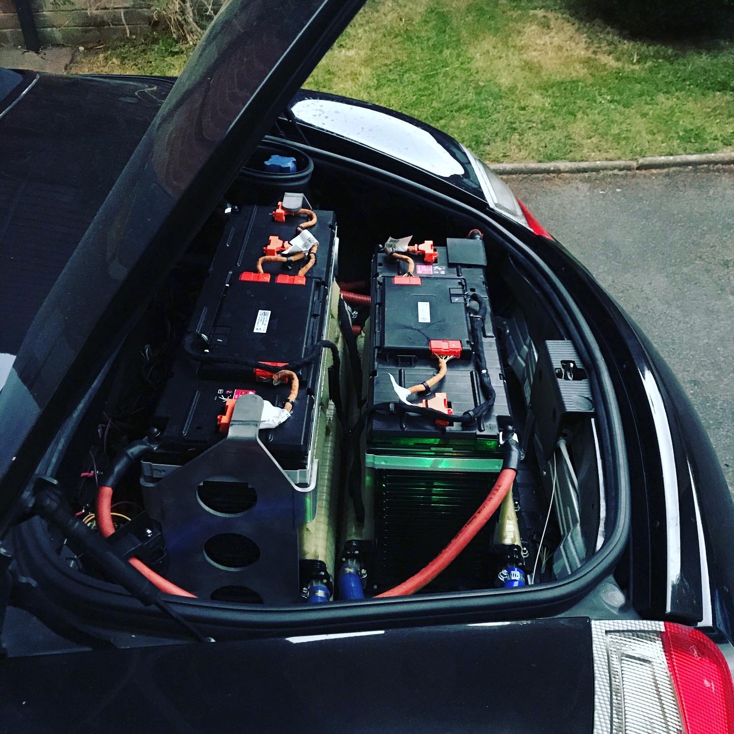

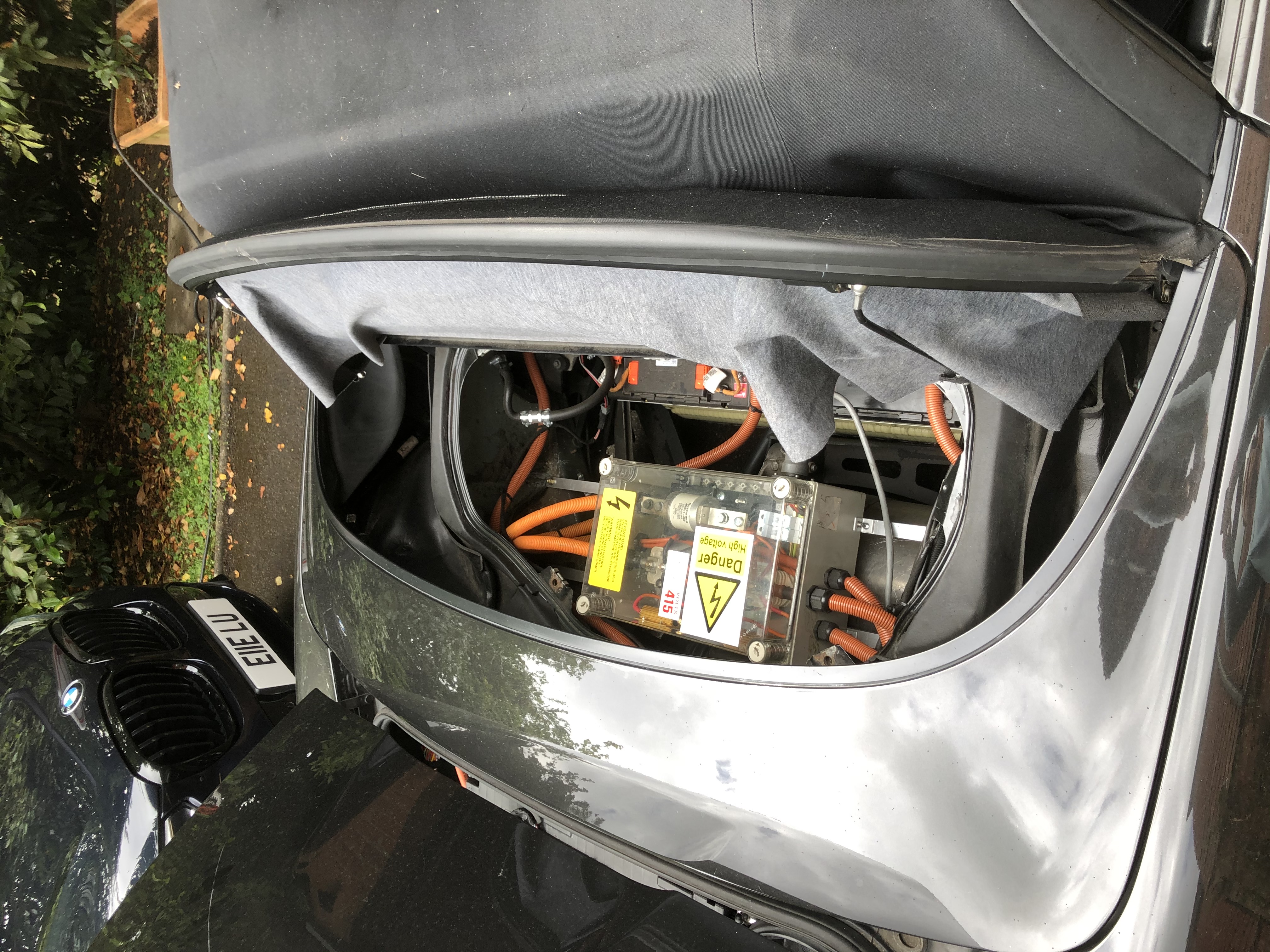

Re: Porsche Boxster 986 Tesla conversion

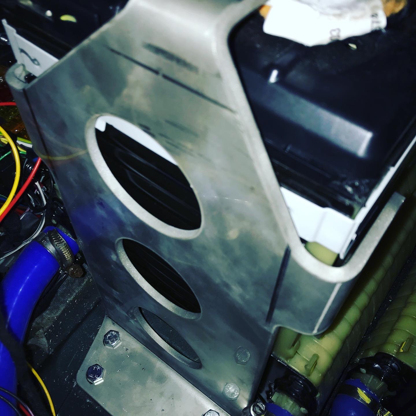

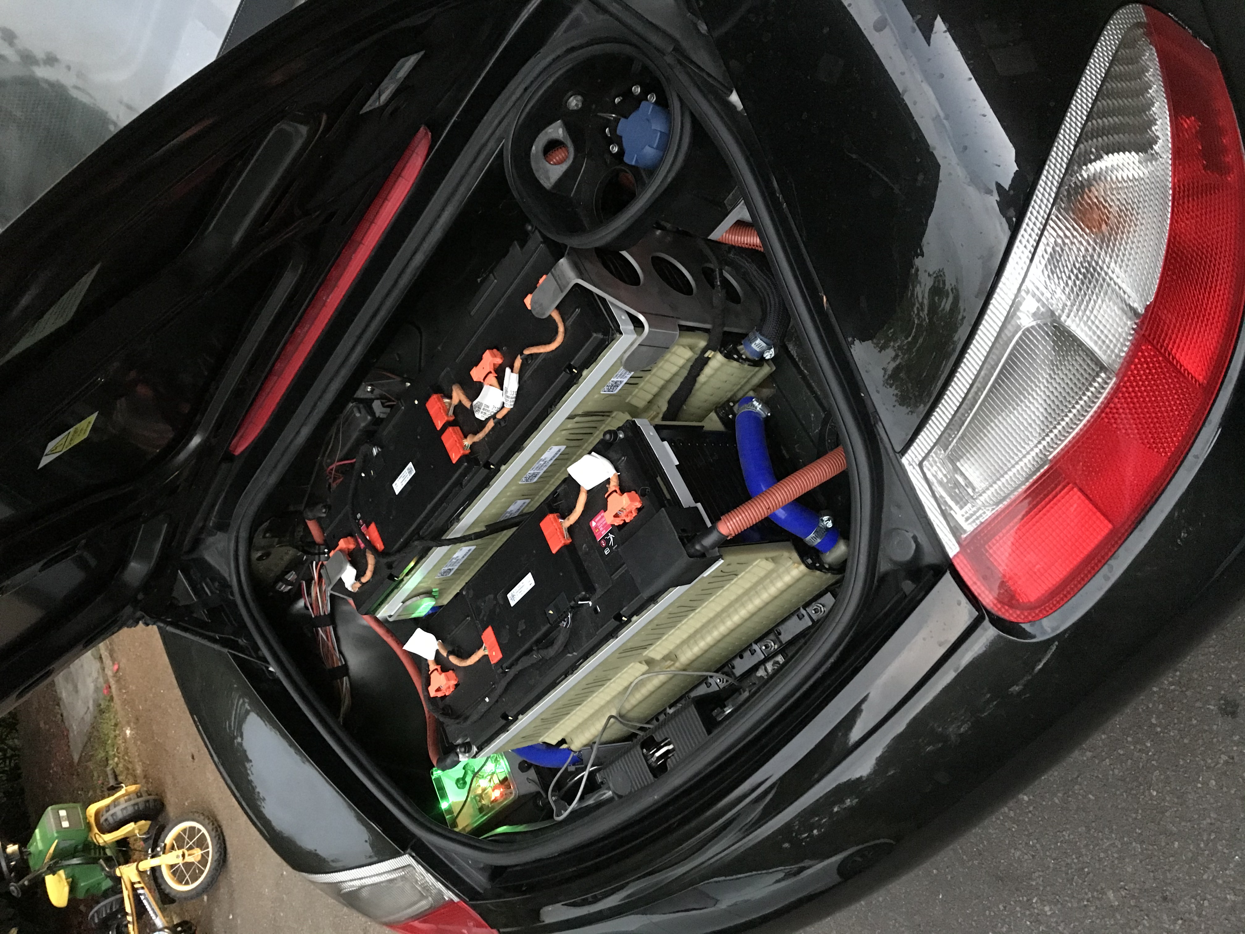

I'm using a Davies Craig EWP and one radiator (2.7 Boxster has two). Pump is just after radiator then drive unit, then batteries, charger and return. Drive unit hasn't got above 30 degrees. I'll need to incorporate a valve and battery heating as we approach winter.Isaac96 wrote: ↑Tue Mar 24, 2020 8:28 pmBoxster EV wrote: ↑Tue Mar 24, 2020 11:13 am
The larger of the three banks sits across the frame system inside the engine bay. It rests on the original volt battery tray which has been cut to size and reinforced with some steel box sections welded on. It's then bolted onto the frame.
The weight of the Tesla drive unit and battery bank that the frame system is supporting is connected to the bolt holes of the original front engine mount (and rear mounts). The whole system is still less than 100kg lighter than what the same bolt holes were supporting with the OEM ICE.
It will be very tight to stack another bank of volt cells on top. It's doable but not without more fabrication and grief.
Hope this helps.

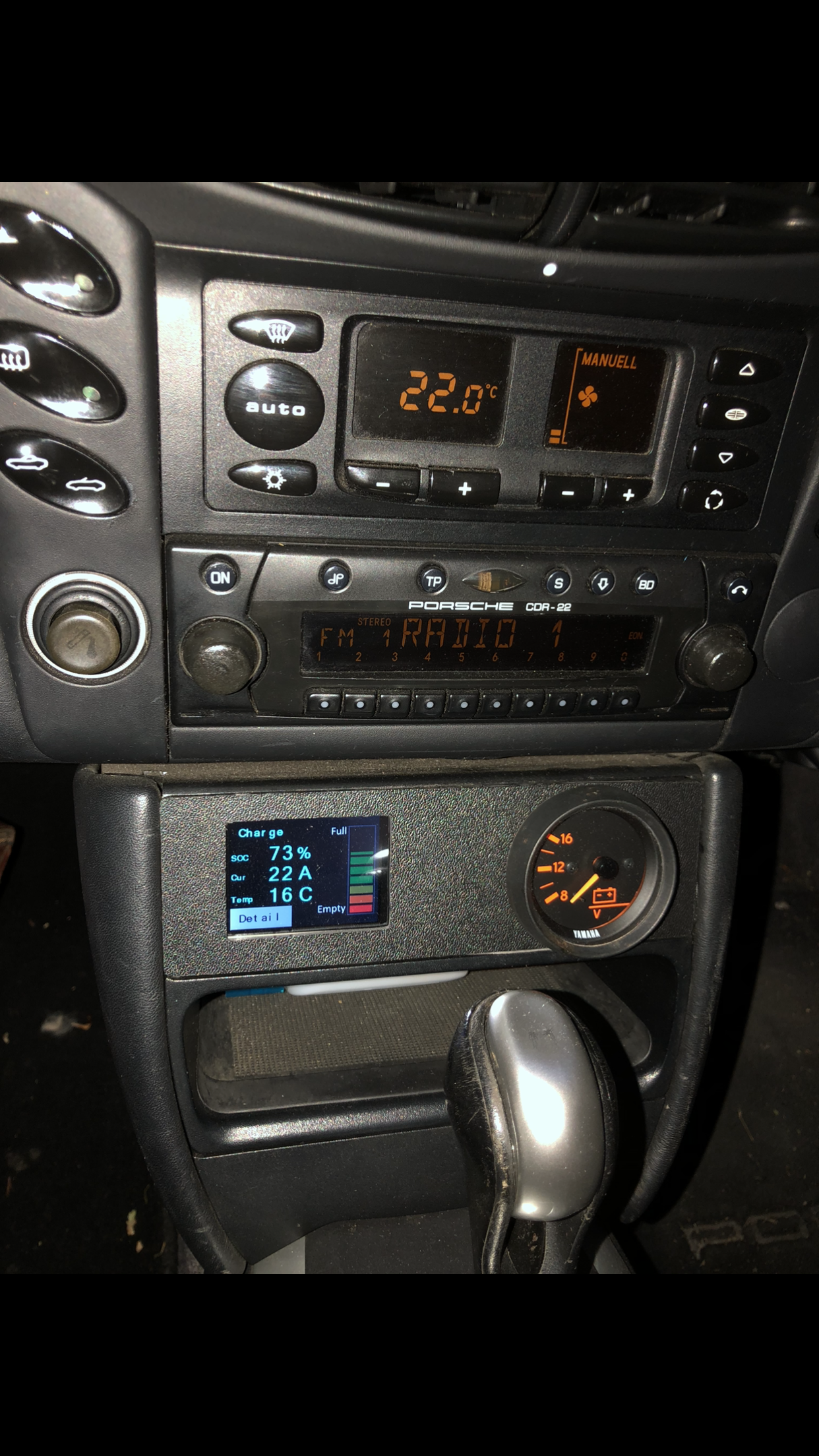

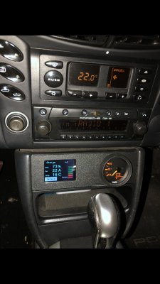

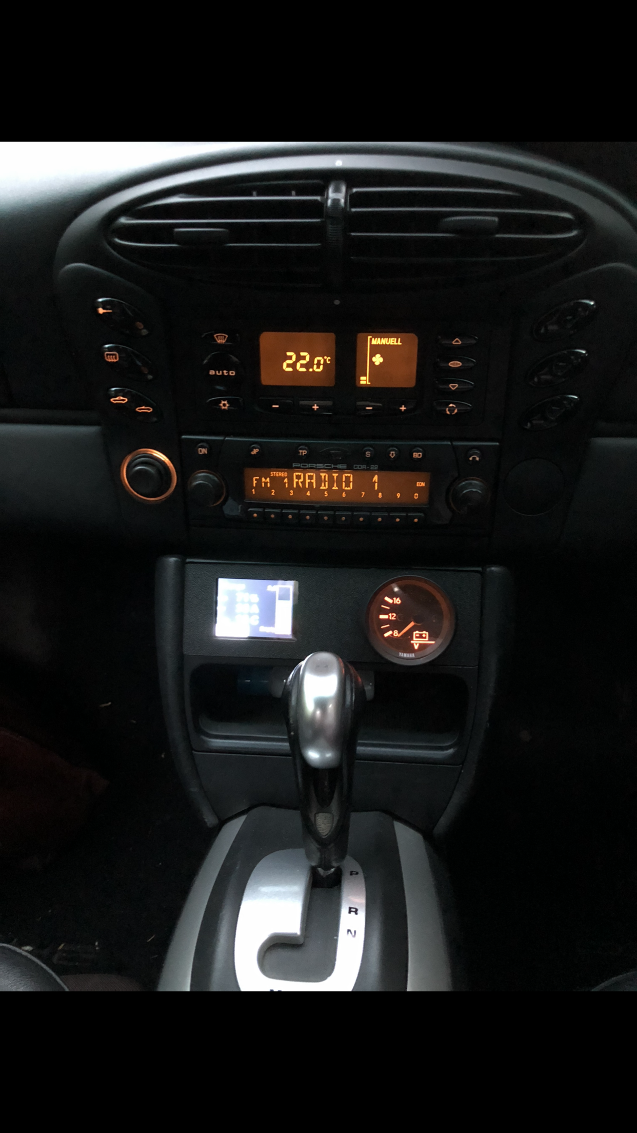

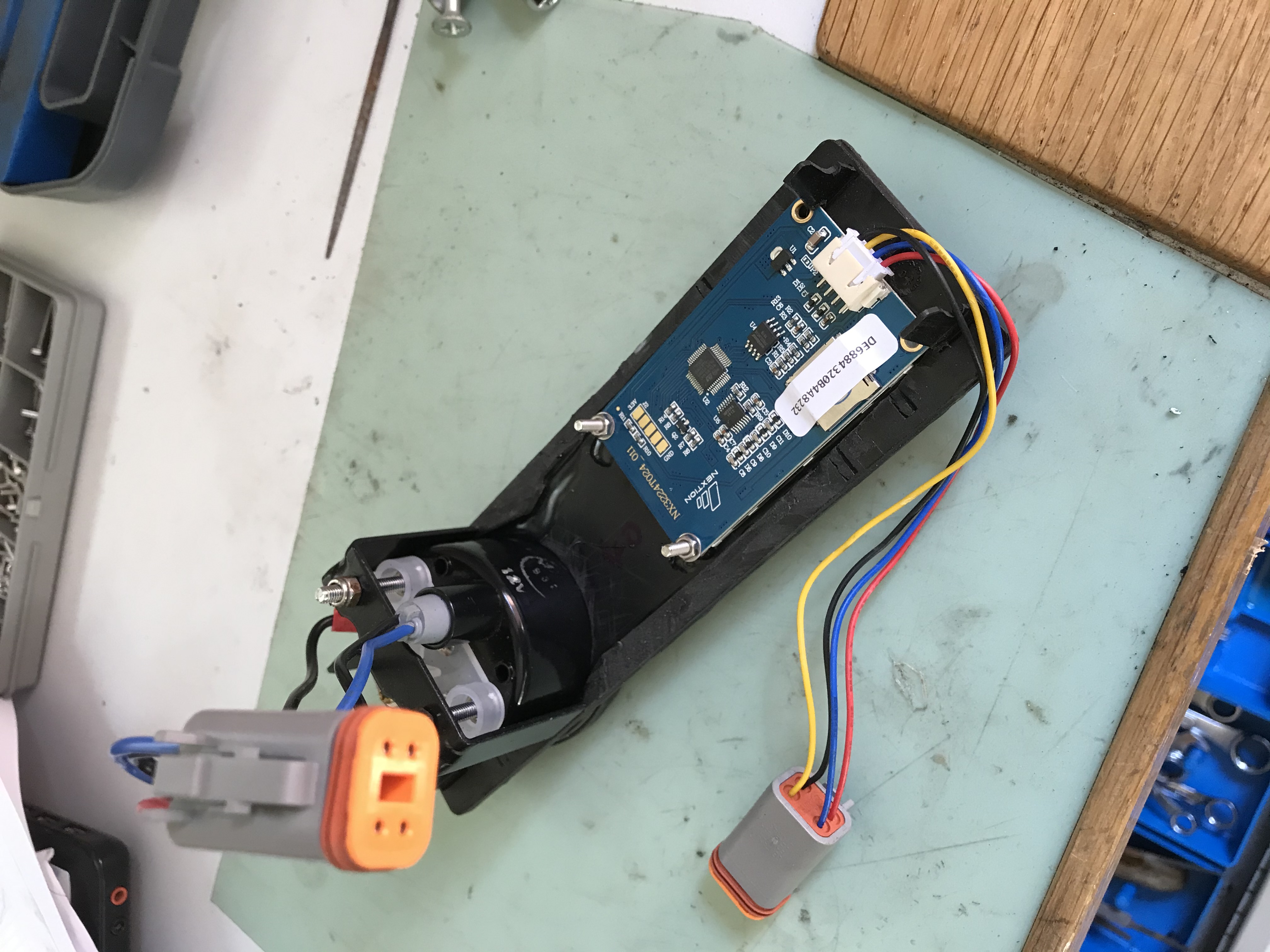

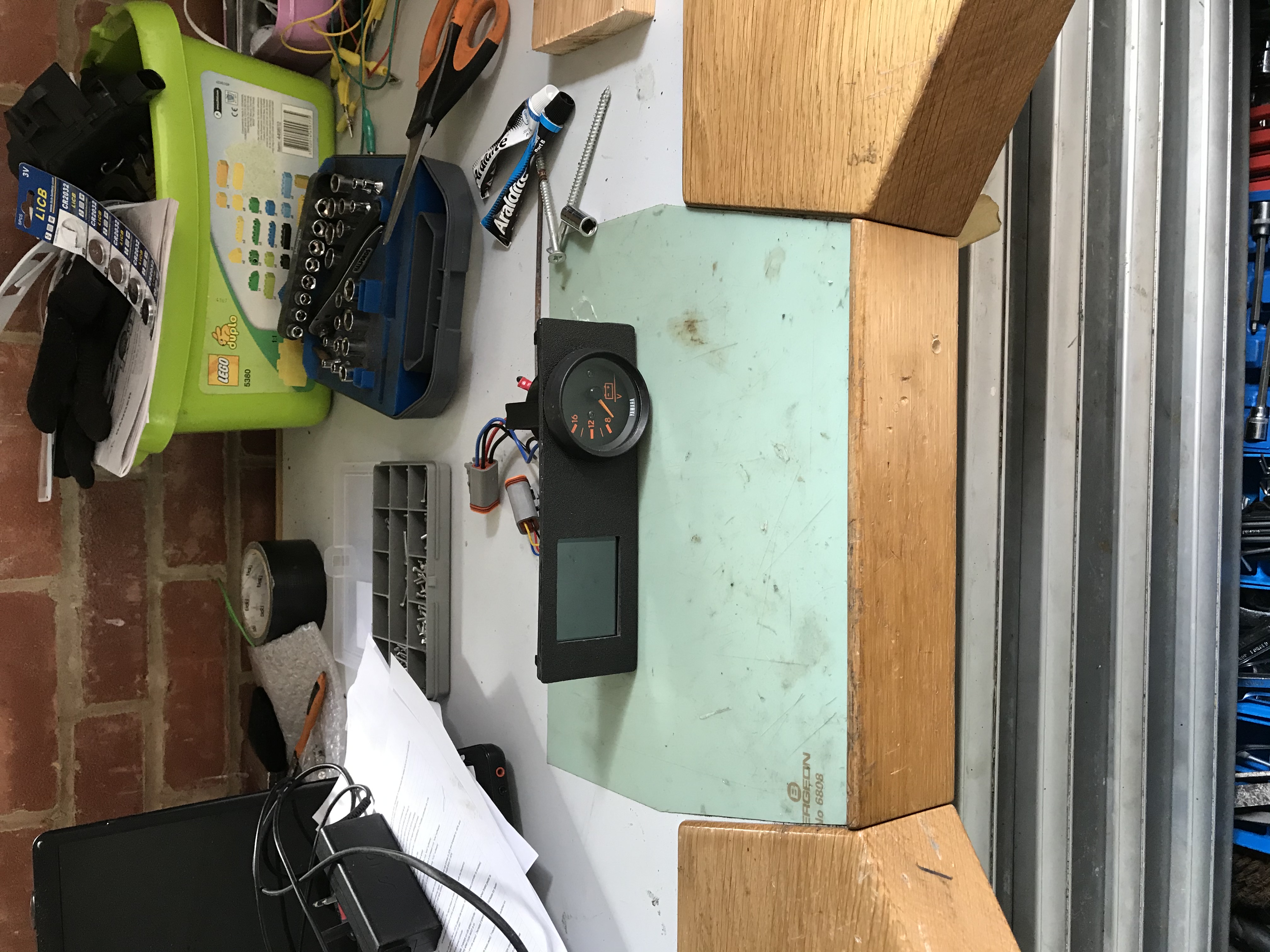

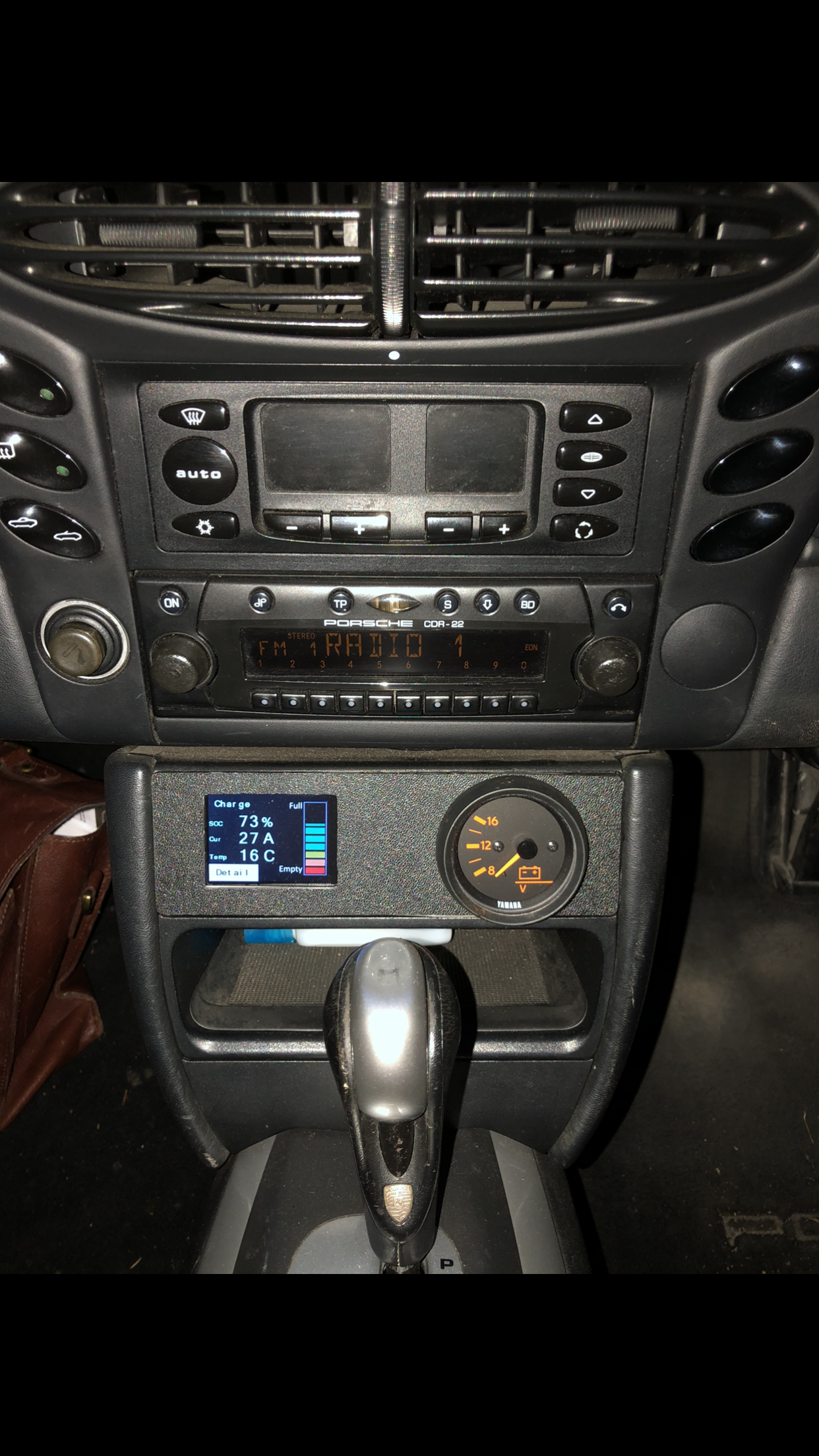

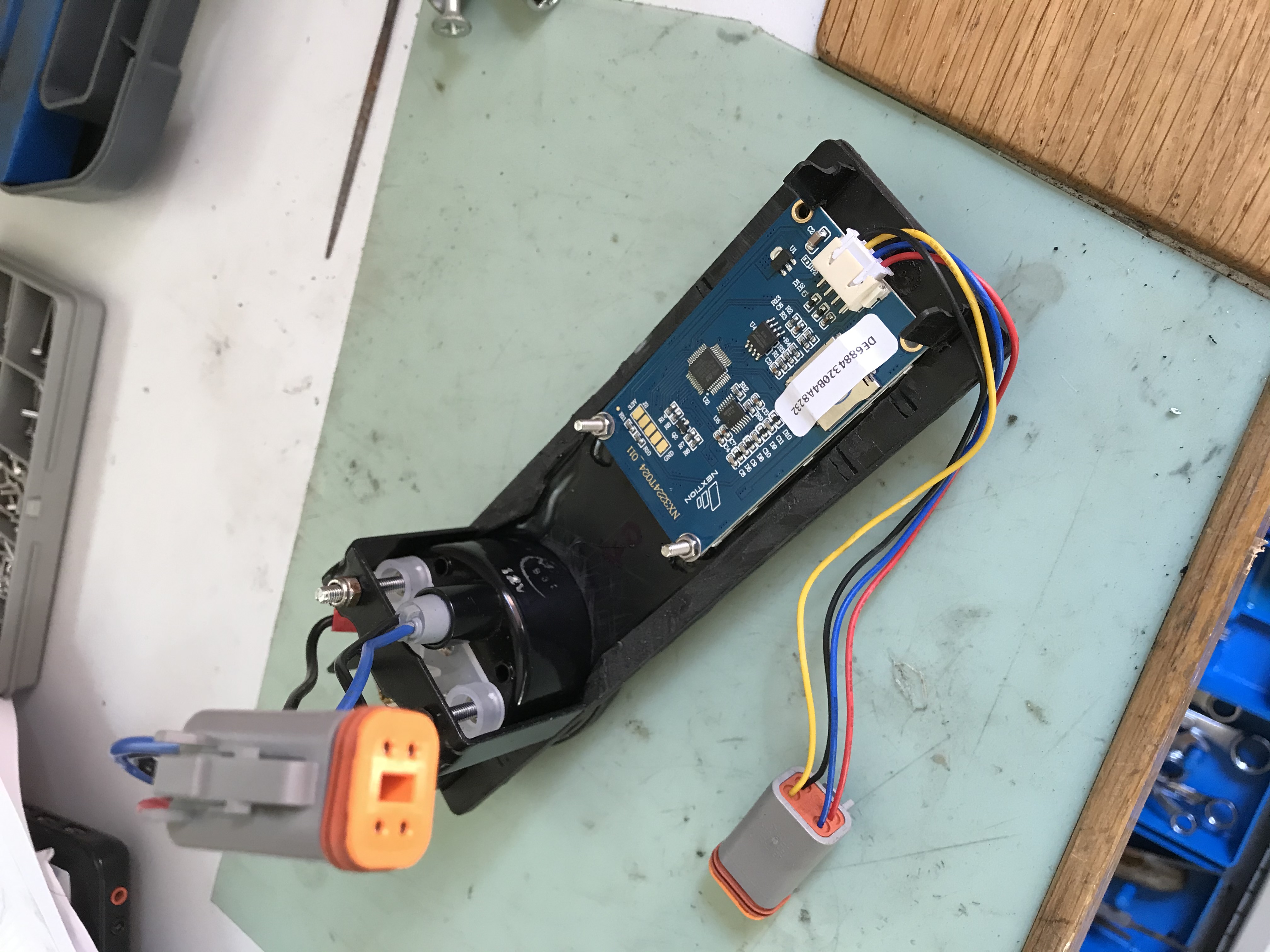

I decided to make a small panel out of ABS plastic to house the Nextion SIMPBMS display and also install a voltmeter gauge for the 12v battery. This little section replaces the redundant OEM CD storage slots. The finish is more than acceptable (the pictures don’t do it justice).
Any excuse to use Deutsch connectors too.
Looking good, its always great to get on to finishing touches like this on big builds.

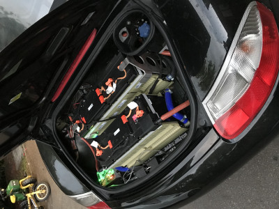

Also, a few other random pictures. The medium size battery bank is being removed from the boot and being fitted in the engine bay area in the next few months (yes it does fit and will go inside a IP battery box). Although the range on this build is poor, it’s well worth the sacrifice to have max power from the motor (and volt batteries don’t break the bank):

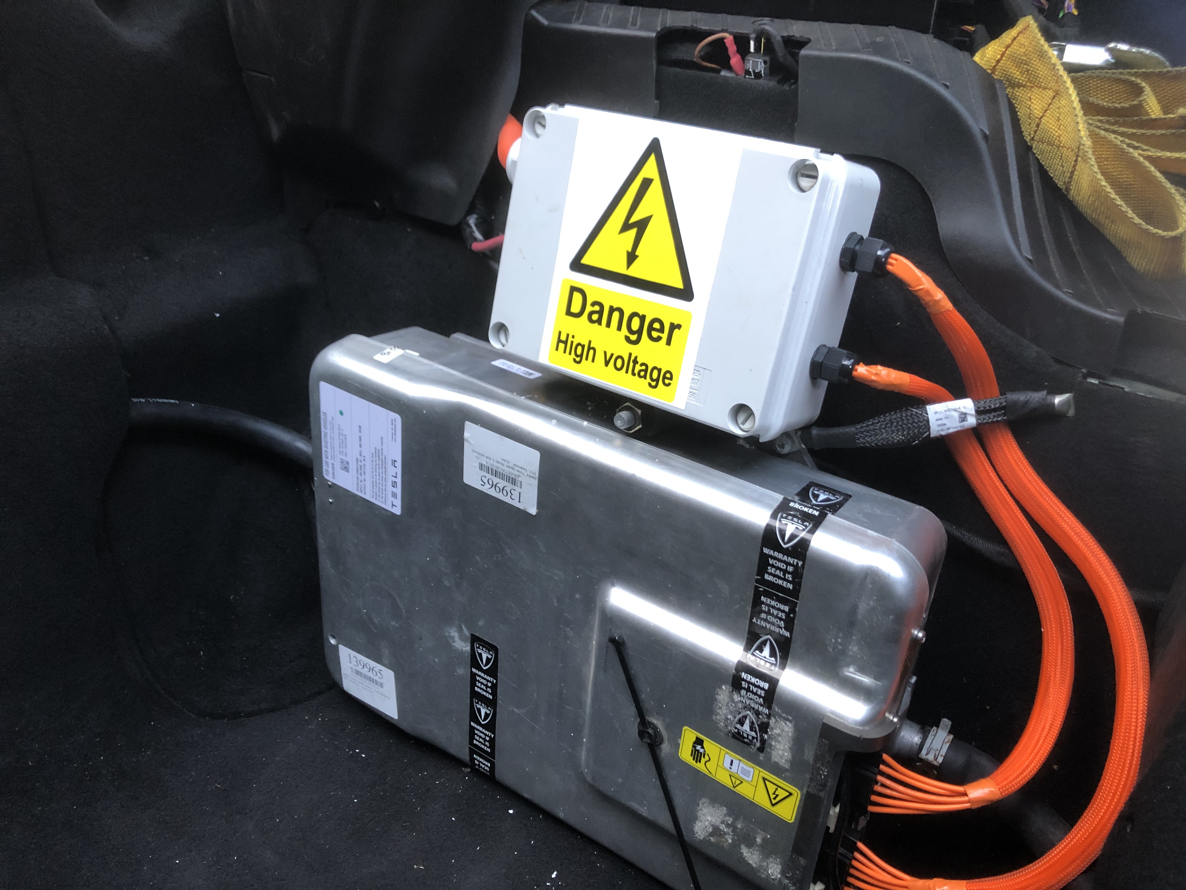

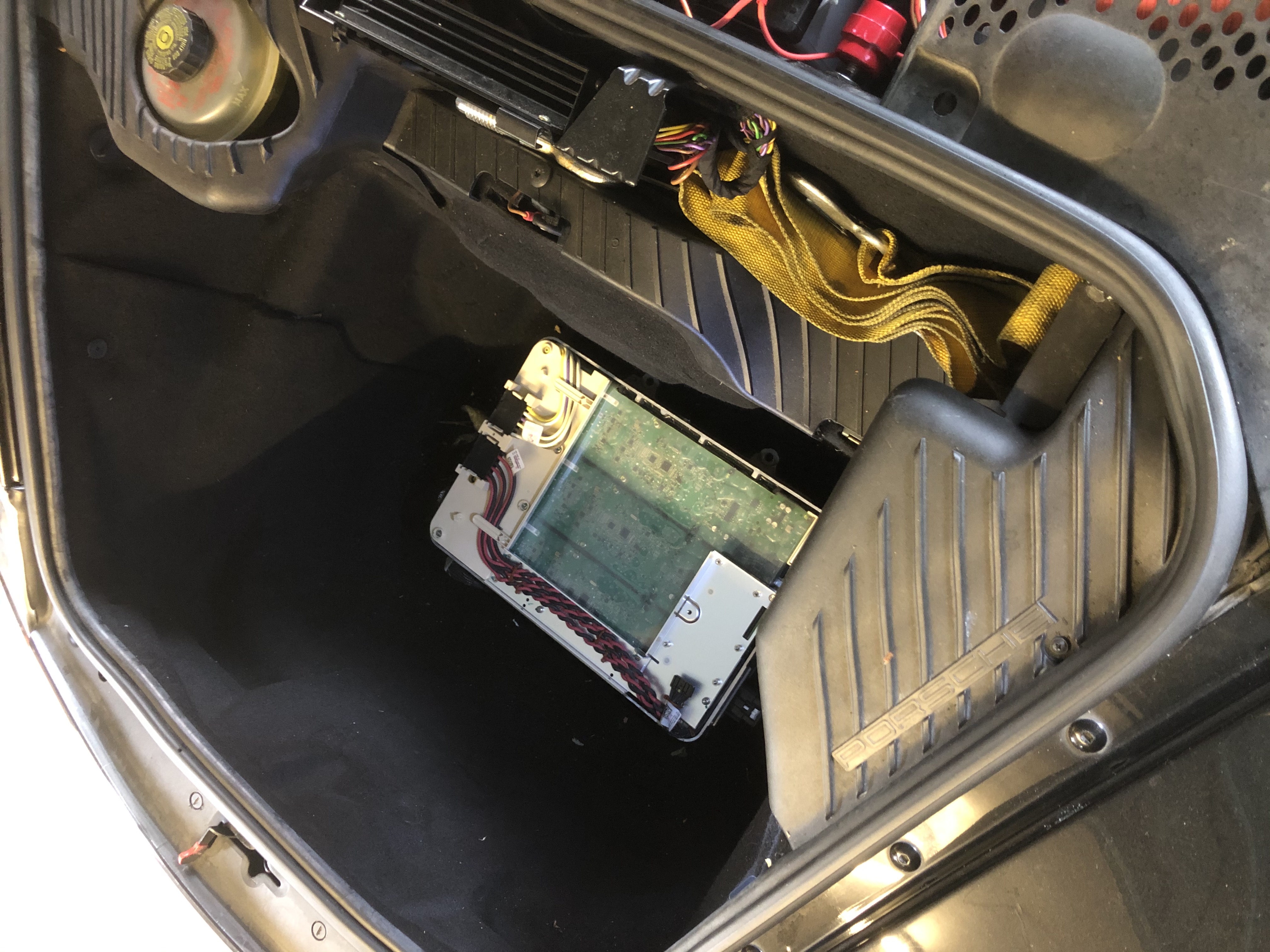

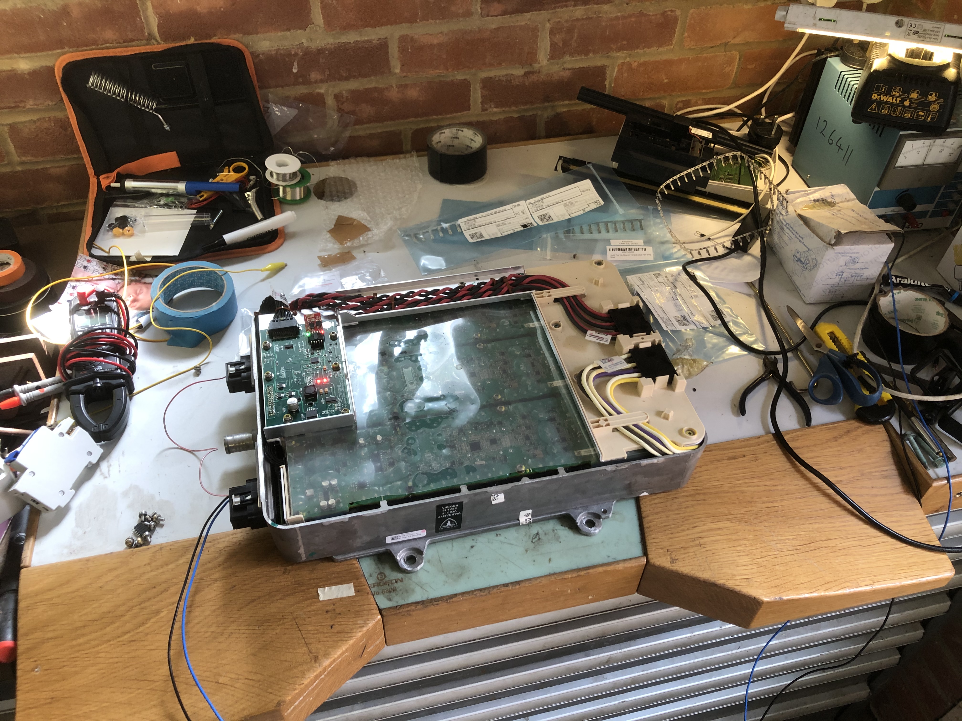

Made a very tentative start on my Tesla gen 2 charger. I’m going to post my falterings here rather than the Tesla charger thread as I don't want to clutter it up. However, if there’s anything new or relevant I’ll post it in the Tesla thread.
Ideally I want to get the Tesla charger working before decommissioning the Chevy volt charger set-up for obvious reasons (it would annoy the hell out out of me if the car was suddenly off the road for a few days or weeks). As it's presently working a treat:
So,the charger is going in the frunk with with DC cables running to the rear of the car via the cabin rather than underneath (neater solution). I'm paralleling the 6x DC 2mm2 cables from the charger, via three 20amp DC solar fuses, to 2x DC 6mm2 shielded cables which will then run to the rear of the car, inside orange conduit. Fusing the 6mm2 cable again just before it's terminated onto the battery inside the HV junction box.
The cable goes through the fire wall where the clutch line used to live. It then runs underneath the auto selector, handbrake assy and through the rear bulk-head hole where the gear cables were previously routed and into the mid-engine bay.
What I didn’t realise was how bad at soldering pcbs I would be. Shameful but functional (i hope). The V5 board is in and powered up with 12v on the bench.

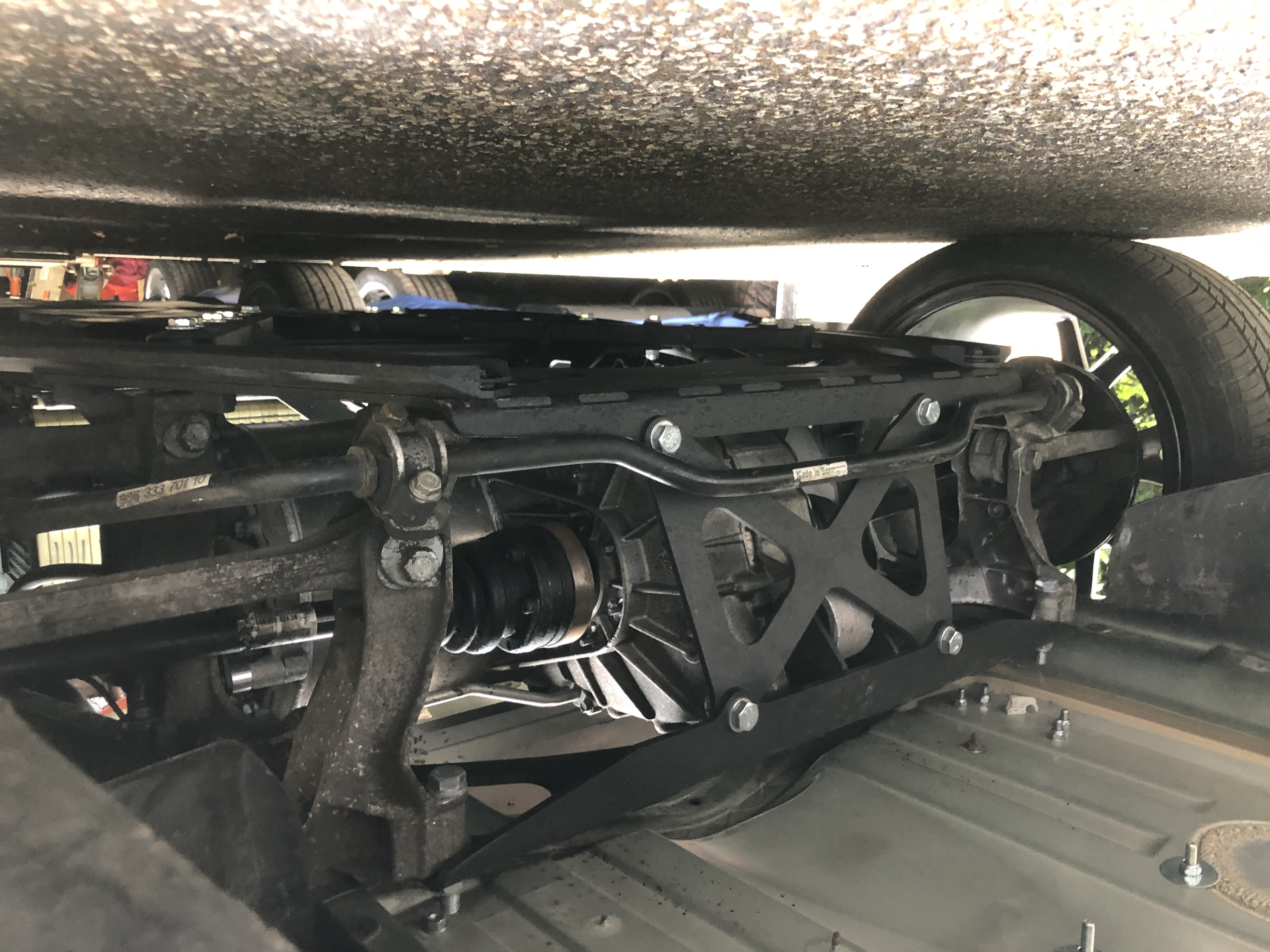

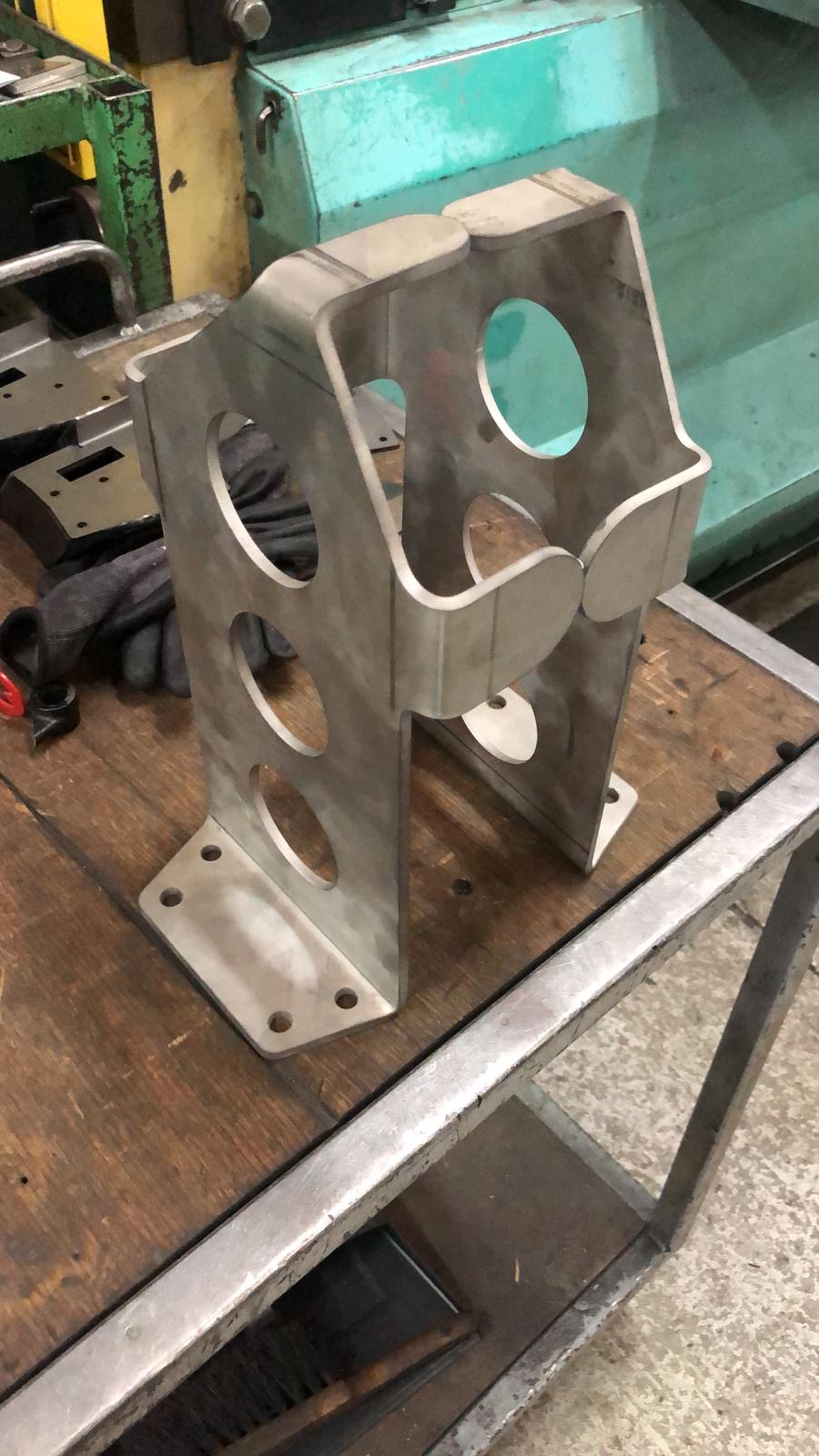

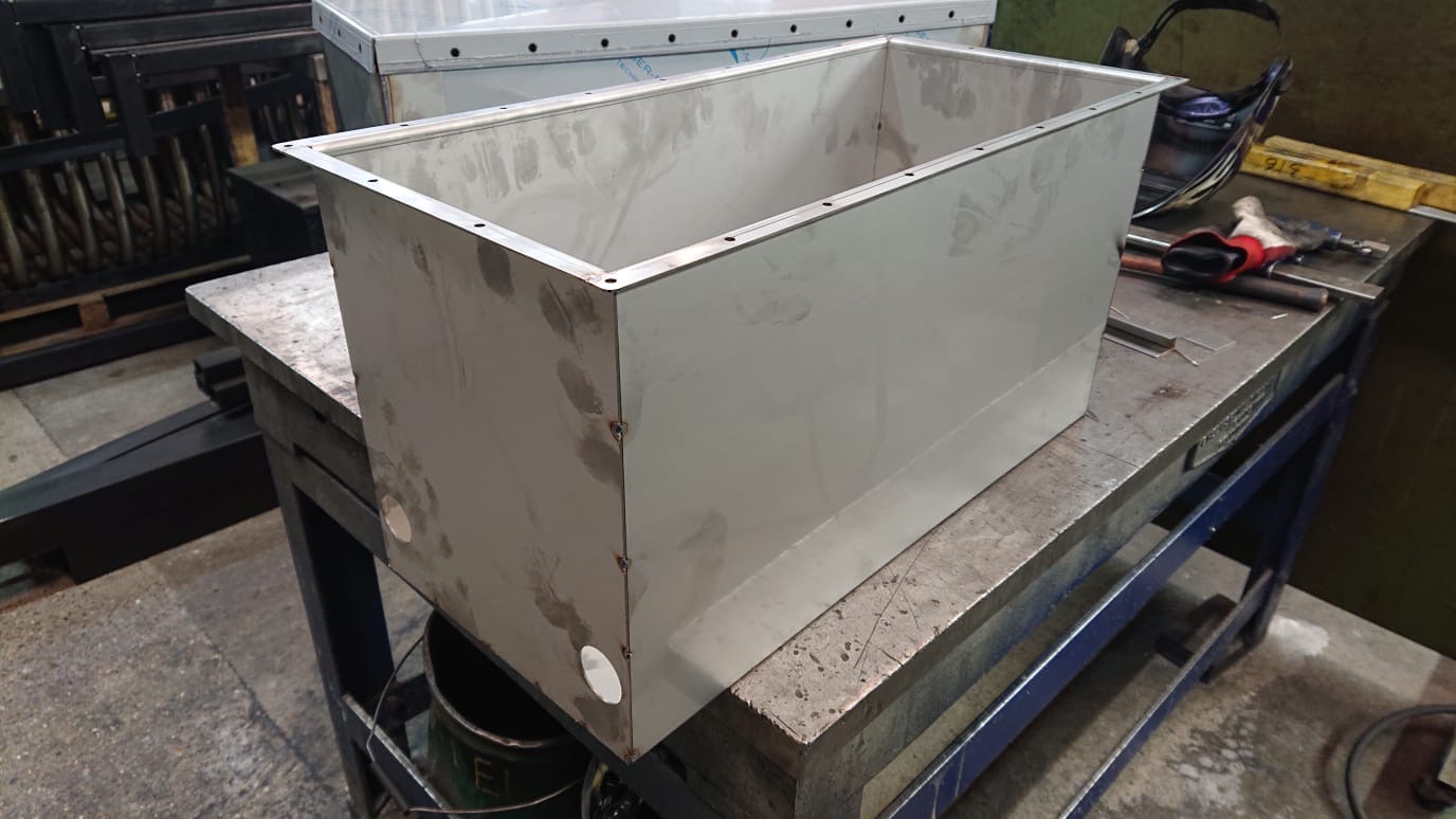

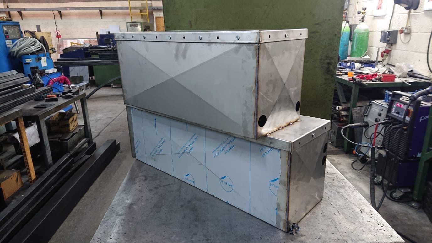

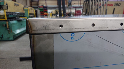

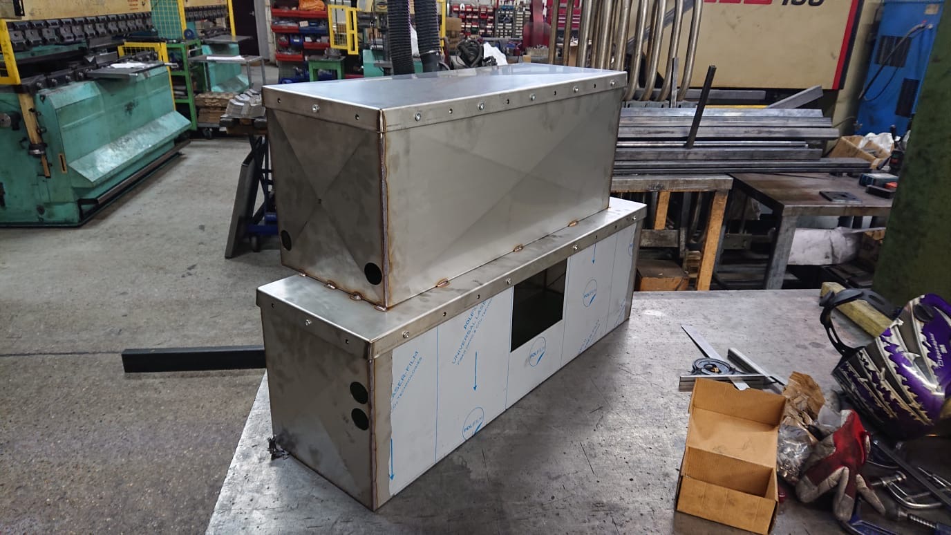

I’ve had battery boxes fabricated to bring this contraption closer to what a commercial conversion company would achieve. The main purpose is to ensure the car is safer in every respect and capable of driving in inclement weather.
Battery weight is circa 190kg and now 70% of that will be between the front and rear axle. The remaining battery brick will go under the boot floor. This’ll mean I’ll be able to maintain 100% use of the boot space front and rear.

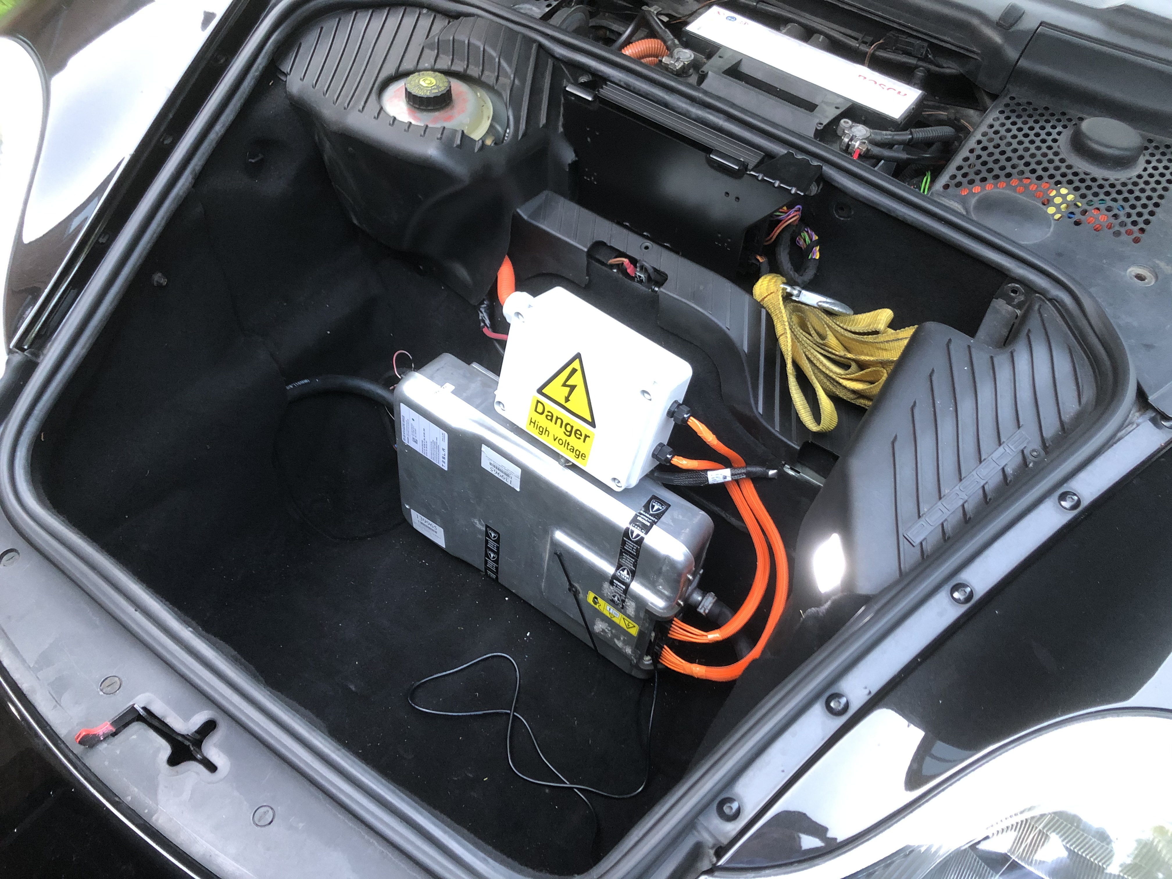

A few pictures and meandering thoughts following my recent Tesla gen 2 charger installation with V5 logic board.
-Installation instructions are all on Damien’s GitHub or in the Tesla charger threads. I read both thoroughly before I started and printed off the installation instructions.
-I used 2mm2 HV wire to run from each charger module and then paralleled them in a separate HVJB nearby. 6mm2 was used to connect directly to the battery via DC HV solar fuses at both charger and HVJB.
- Having a good quality Usart1 lead is necessary. You’ll need some 2.54 pin heads to solder to PCB. It’s helpful to familiarise yourself with ST-Link V2 programming and buy a cheap dongle and fly-leads from eBay for firmware updates.
-Before connecting the AC or DC sides, I configured the charger for testing. Reduced the AC current down to 3amps and set auto enable to off. Once testing is complete, I continued with the installation and configured my preferred settings.
-When incorporating the EVSE wiring, I found out that the charger wants 12vdc a few seconds before applying AC current. I am leaving my charger permanently connected to the 12v for now.
-A good ground on the charger and EVSE earth connection is fundamental. I didn’t at first and Elon was seriously upsetting my Rolec wall pod.
-As I’ve installed this for single phase charging only, I beefed up my L1 and N with 6mm2 cable. The standard 1.5mm2 was getting a little warm
-Note that charge termination happens about 3vdc above termination voltage at which point the EVSE will stop providing AC and return to READY state. For example, I wish my charge to terminate at 392vdc which is about 4.10v per cell. I set my termination voltage at 389VDC to achieve this.
All done!
In conclusion I’m charging at about 10amps across each charge module (I have a 32amp EVSE at home). This is taking about two hours to charge my 16kwh pack. The fact that charging speed is now comparatively so fast, I should be able to comfortably run all my associated systems off the 12v battery during charging (switched on by the 240vac relay coil) without the need to keep the 12v battery topped up.
I still have some work to do in terms of integrating with SIMPBMS.
I'll fit the car's spare wheel cover over the above kit to conceal it.
All done!

Hello! Can you please help me identify the pins of the motor encoder connector? I know the 23pin connector but i don't know the pins on the motor encoder. Thank you!
I also purchased the 4-pin encoder connector for the LDU from https://zero-ev.co.uk/ and plan to use shielded cat6 network cable to connect this to the 23pin connector:
https://zero-ev.co.uk/product/tesla-lar ... model-s-x/

Costin J wrote: ↑Sat Sep 19, 2020 9:44 pm Hello! Can you please help me identify the pins of the motor encoder connector? I know the 23pin connector but i don't know the pins on the motor encoder. Thank you!
viewtopic.php?f=10&t=76#p1026
