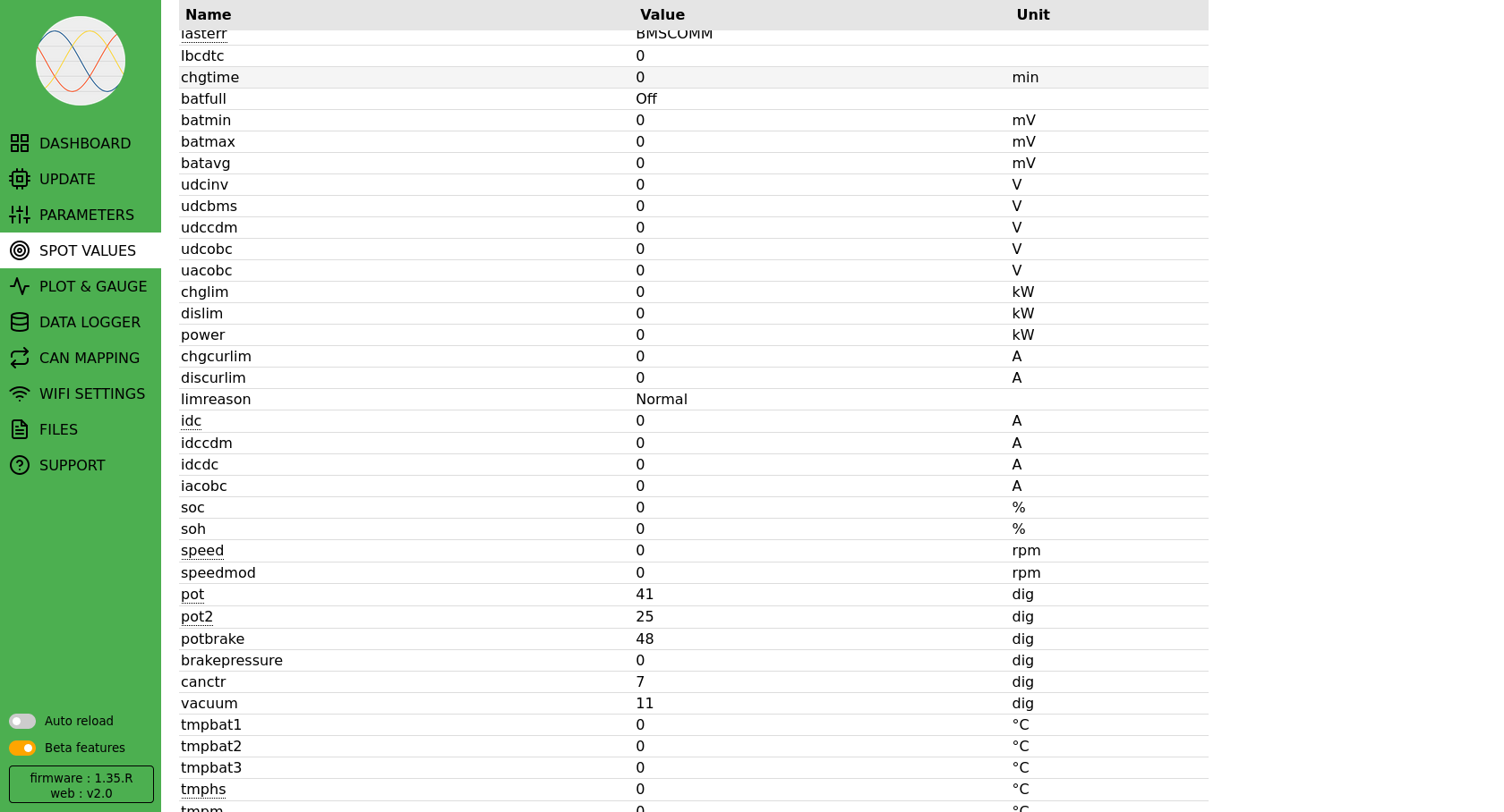

I have worked on the ui-rework branch a bit more and I think it is now better than the original gui. It was just a few tweaks like allowing to turn auto-reload off and removing the double fetch of json data when reloading.
https://github.com/jsphuebner/esp8266-w ... /ui-rework
When it is lined up with the directory structure of the master branch I think I'll merge it over.
Only downside: it loads slower because it has more assets.

- chrskly
- Posts: 174
- Location: Dublin, Ireland
- Has thanked: 69 times
- Been thanked: 69 times
Re: Web interface improvements
I had to do some fighting with some crappy Olimex boards
but managed to get there in the end.
Changes:
* For screens where the width is less than 1000px, the menu bar will automatically shrink down and only show the icons.
* The icons get bigger to make them more easy to tap on a small screen
* The toggles and version box dissappear (no room for them)
* I've made the right hand menu a bit smaller to leave more space in the middle.
* You can manually grow/shrink the menu by clicking on the logo.
* Right hand menu gets hidden on the spot values page because it has not content
This works OK down to a screen around 800px wide.
Pull request with changes here : https://github.com/jsphuebner/esp8266-w ... ce/pull/21
All feedback/suggestions/thoughts are welcome

I believe I have now merged the new UI to all variants main/master branches
- ESP8266
- ESP32 - UART
- ESP32 - CAN
Would be cool to unify this a bit more. The Web Code for ESP32-UART and ESP8266 is identical. The CAN Web code is a bit different but 90% identical I would say. Maybe we can shell out the commonalities in a submodule?
