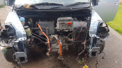

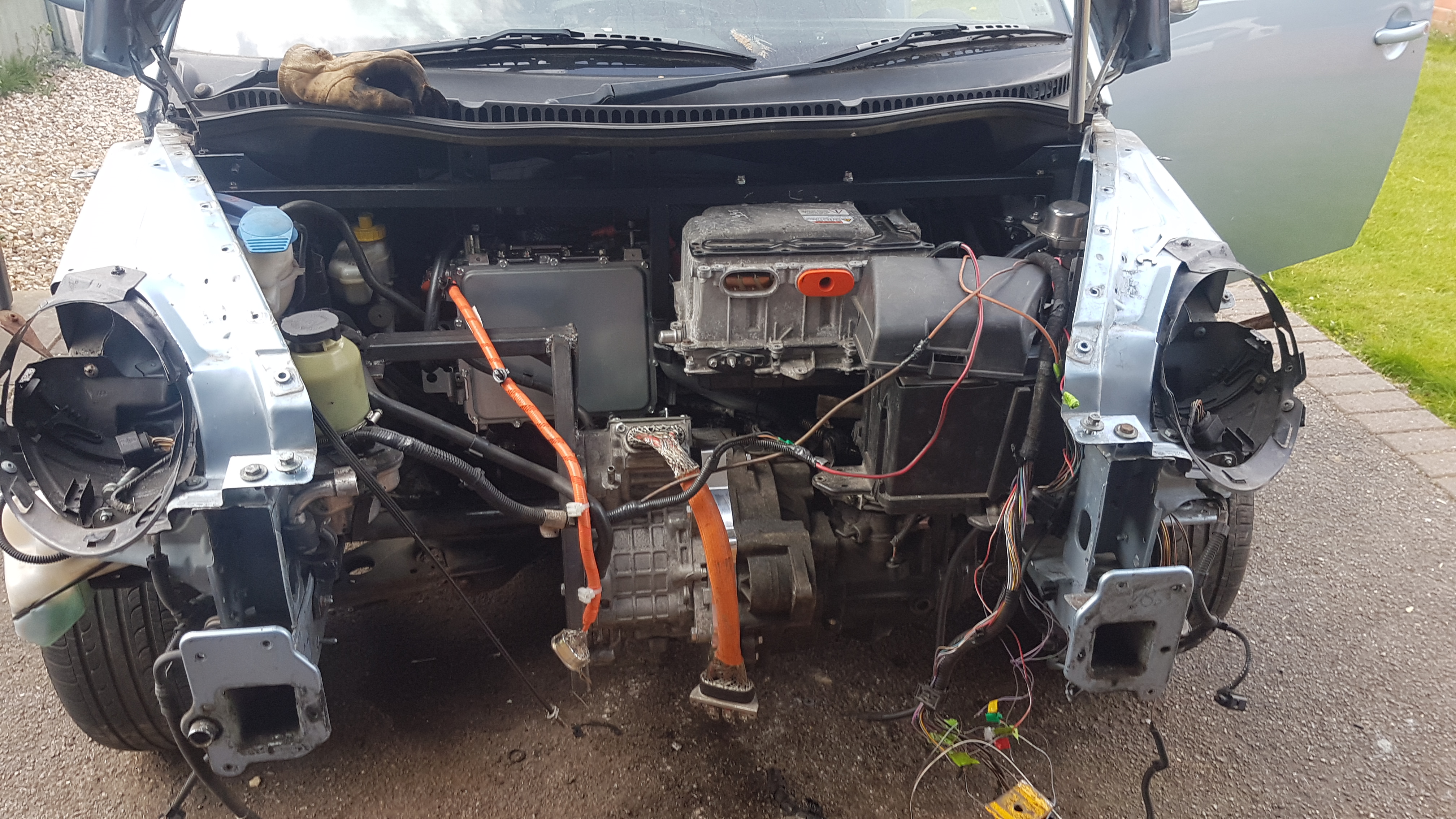

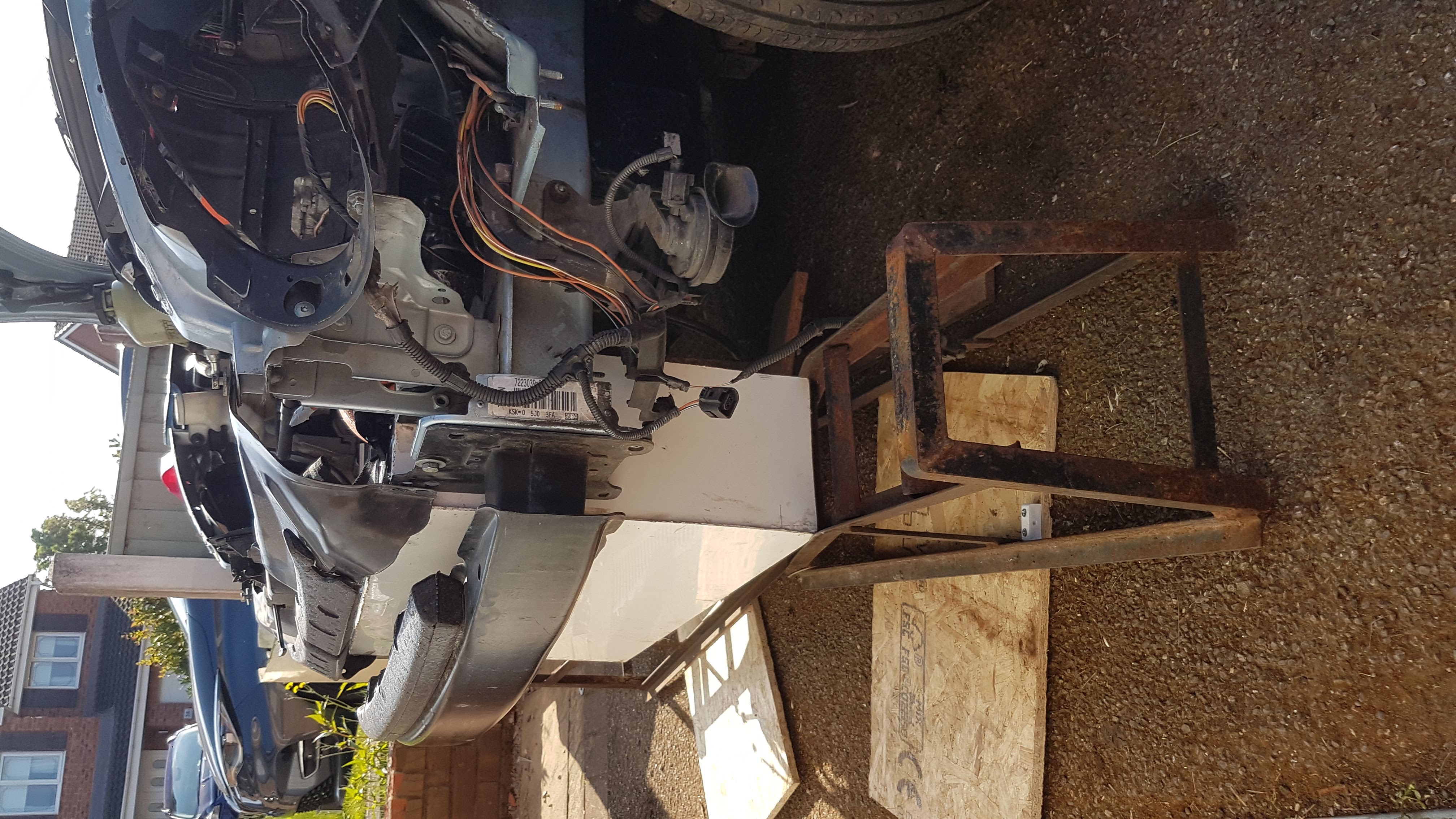

Motor mounts done now. Getting close.
Still need to finish the battery box and tweak the charger mount and some wiring.

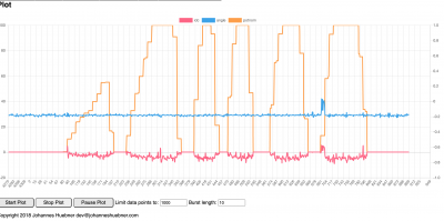

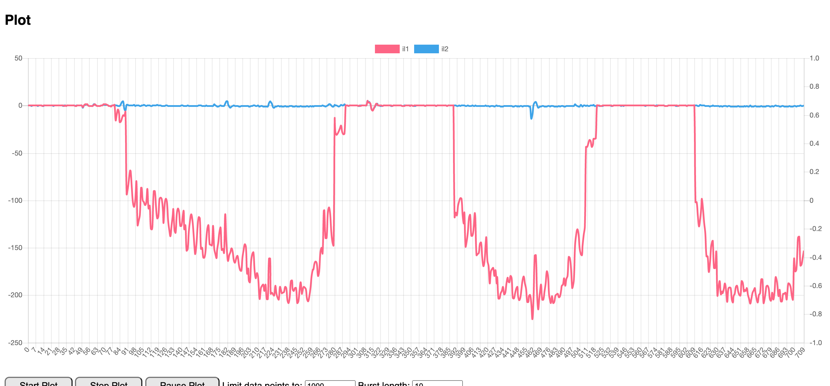

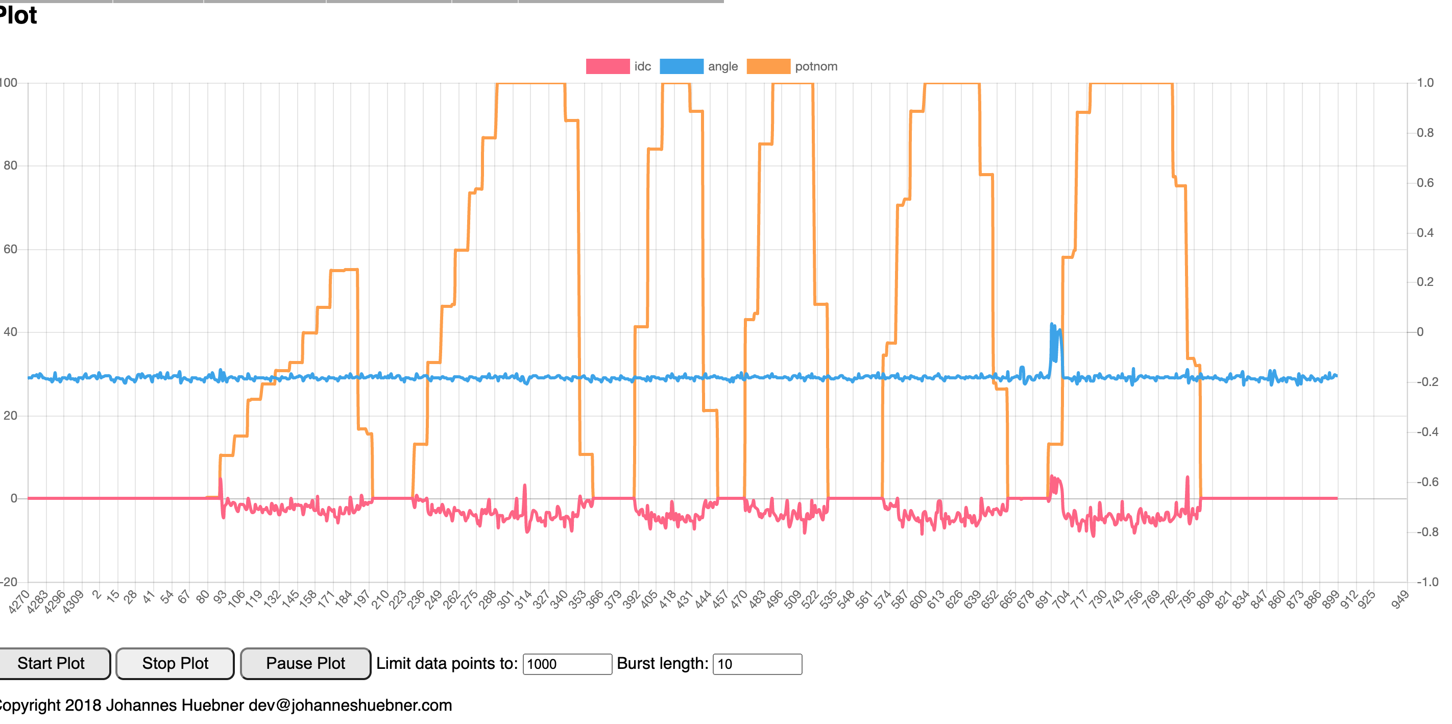

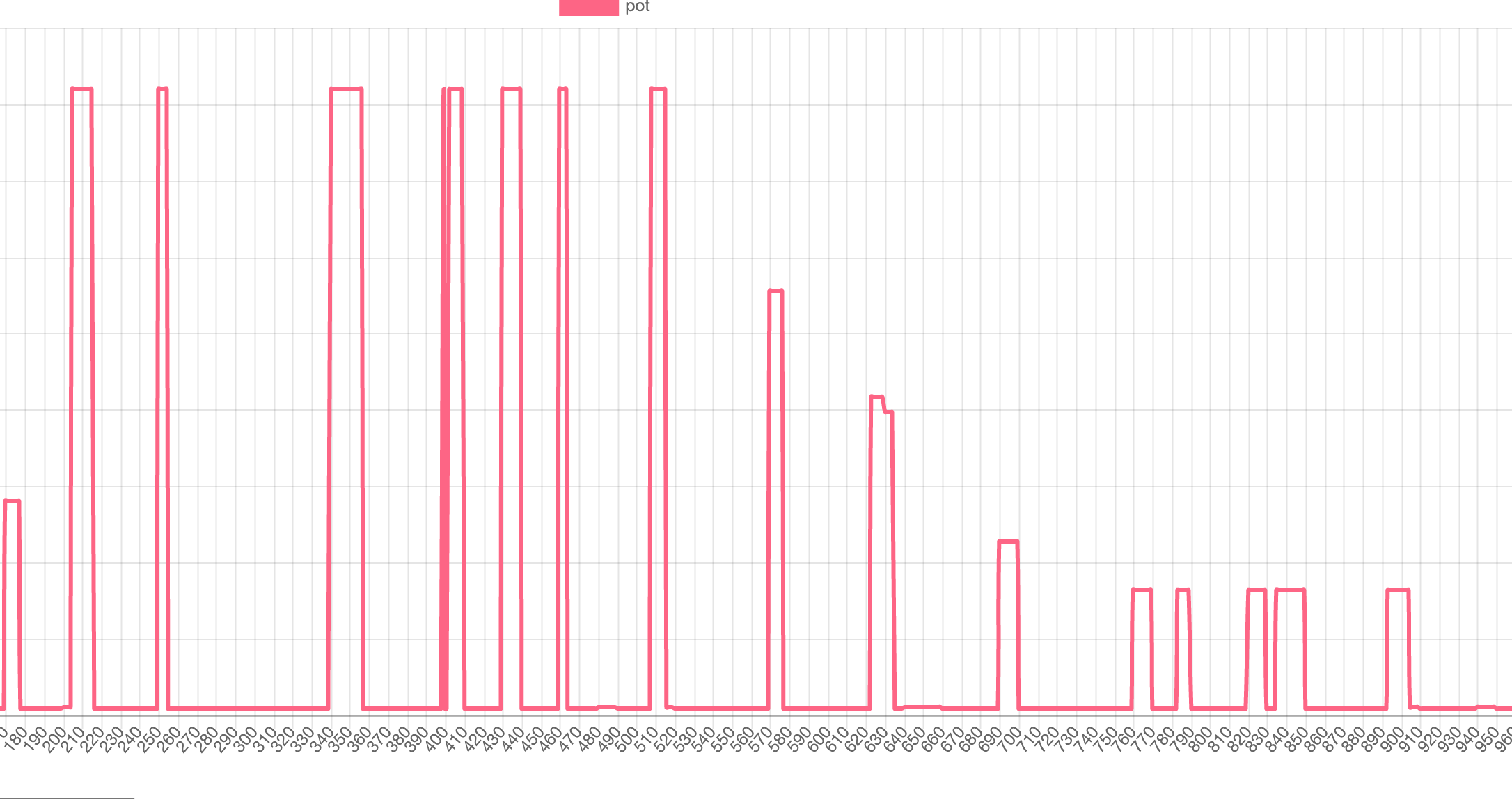

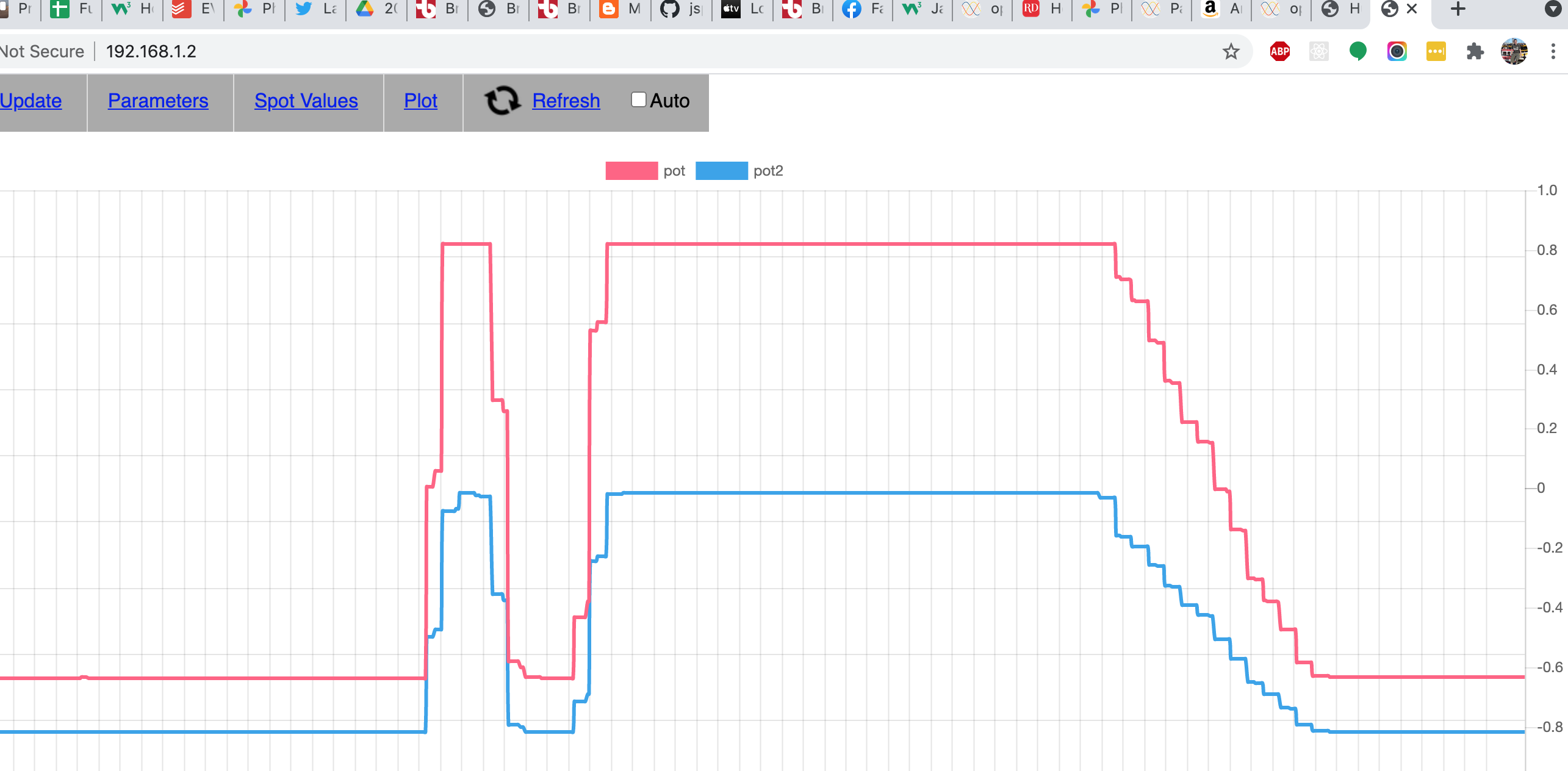

Pot Plot from VCU:

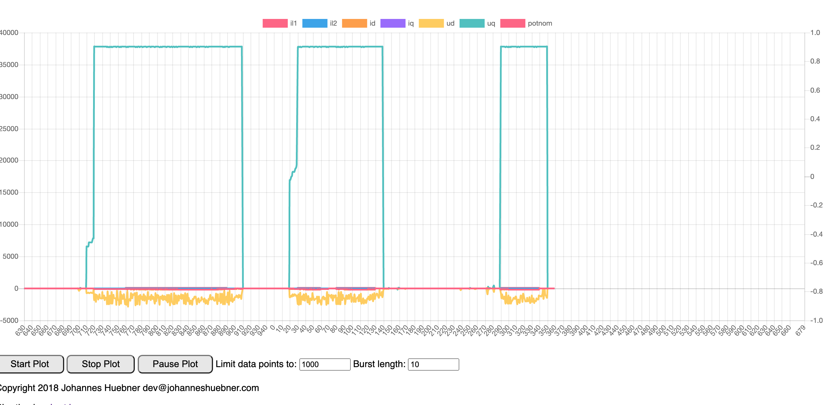

Pot plot from Inverter
Still think I'm having can bus issues, it's set to 10ms in the VCU.
Savvycan says:
Average inter-frame interval: 46.758ms
Minimum inter-frame interval: 9.966ms
Maximum inter-frame interval: 4.29496e+06ms
Any ideas/suggestions?

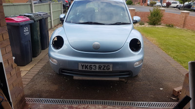

And we're rolling.

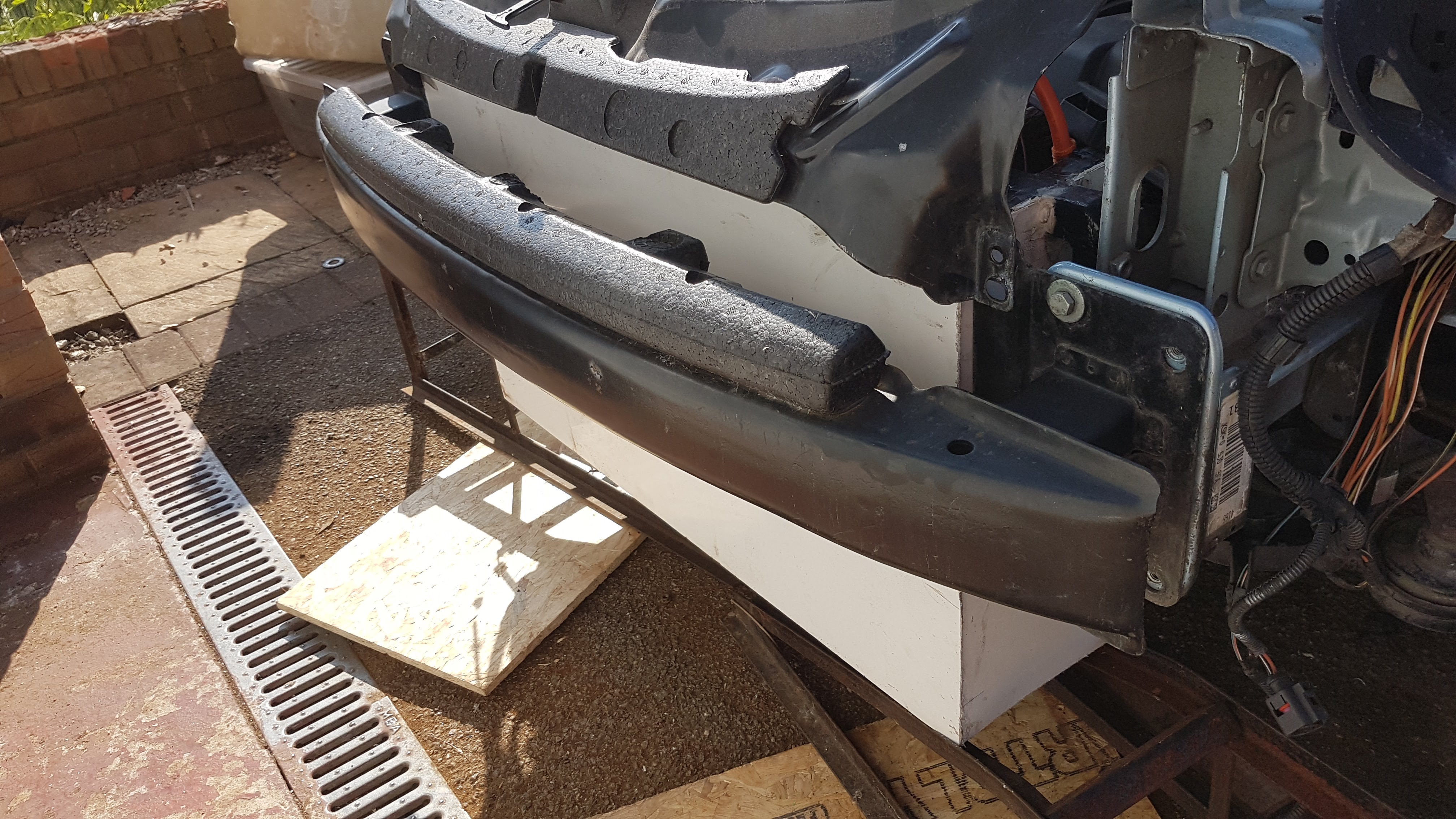

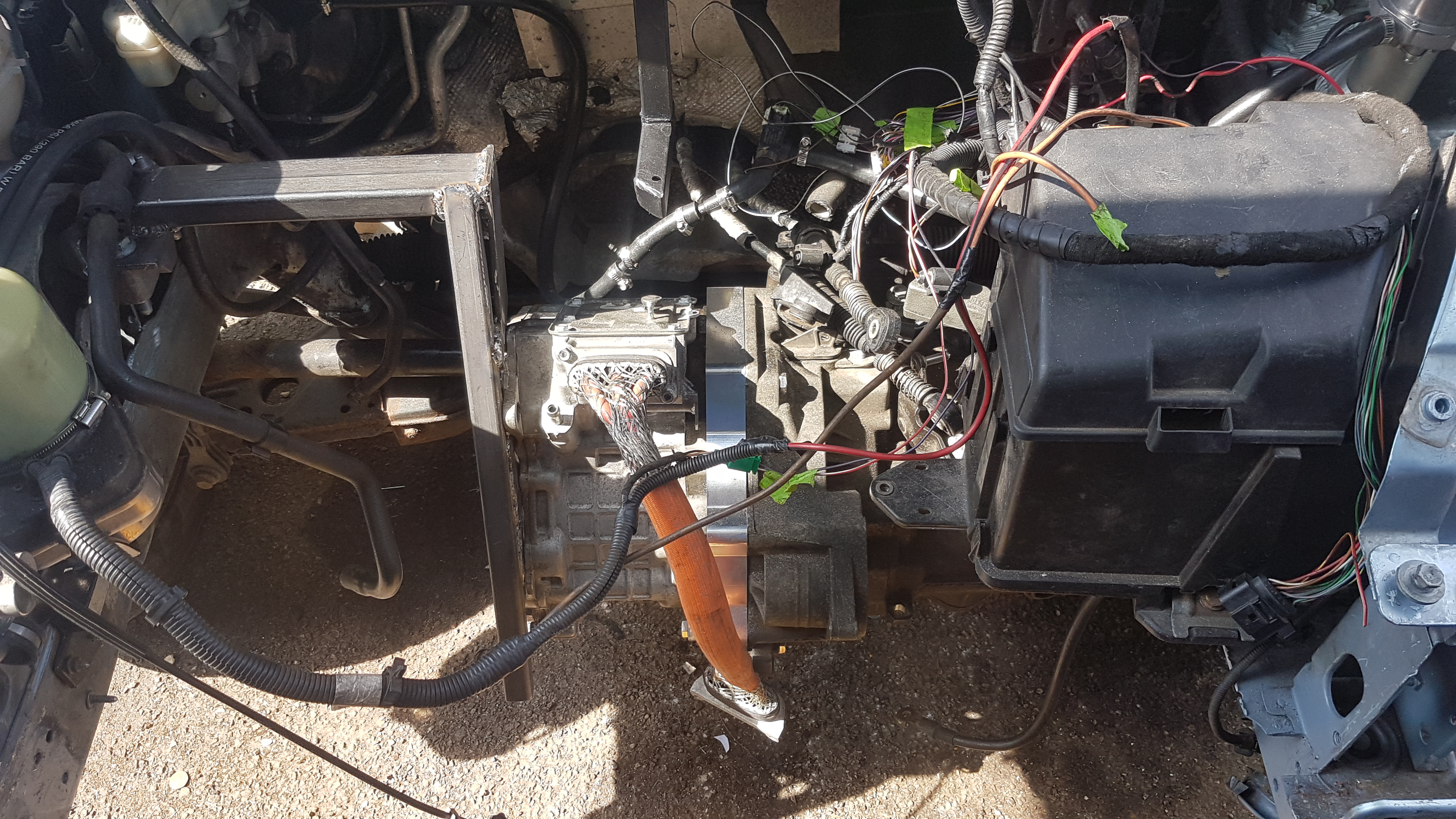

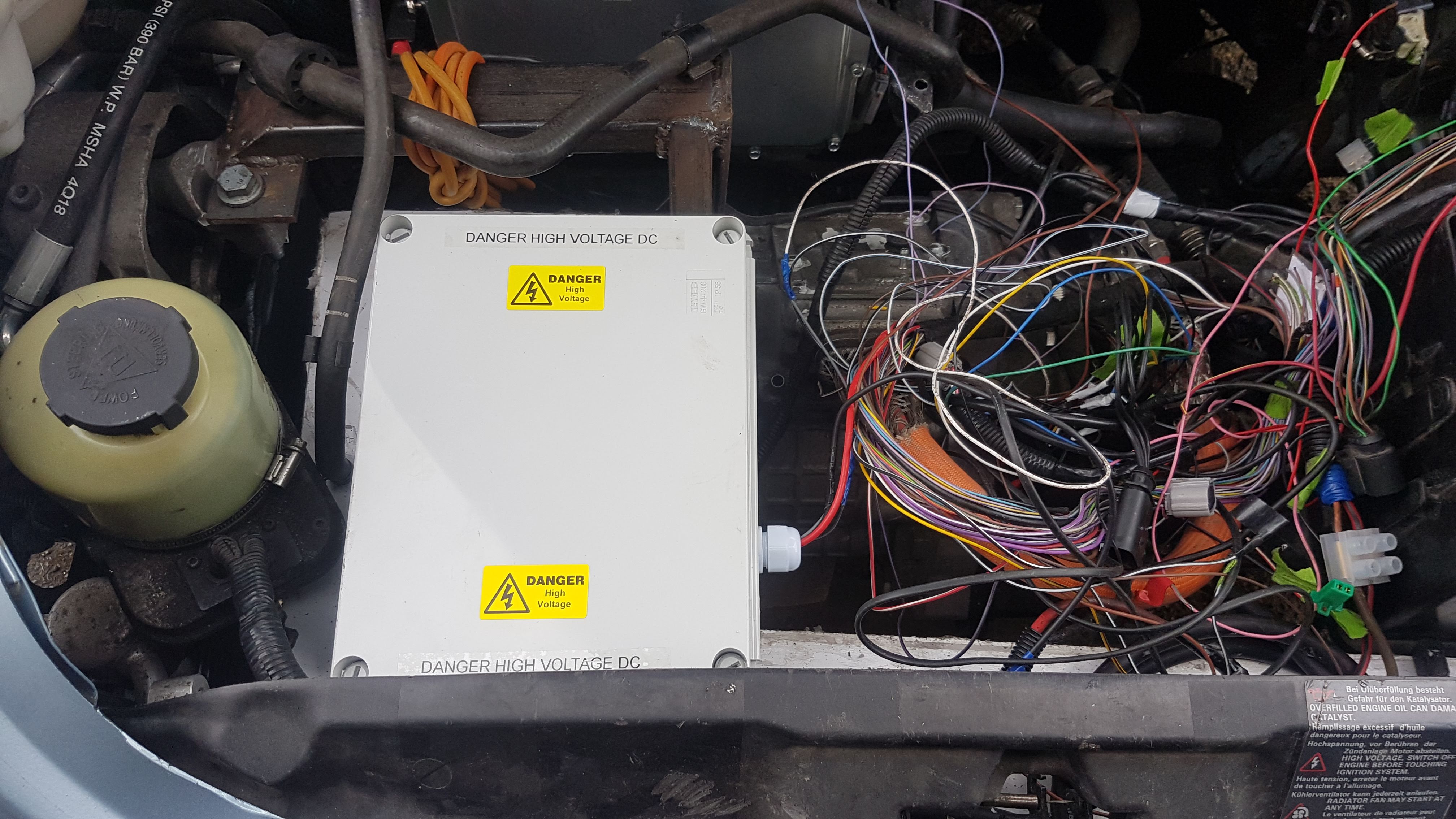

After a couple of goes at a battery box, first time with a steal frame and fibre glass, I've now got the box built, with PVC sheets sealing it.
The front end is reassembled with the box in place. I've decided to have the contactors and fuse outside of the battery box.
Few more little jobs to do, cooling loop and a couple more brackets to make up, tidy some of the wiring etc.
I hope to add a second GTE pack at some point, so will likely look at getting the battery modules repositioned in the future, but just want to get something usable as soon as possible now.

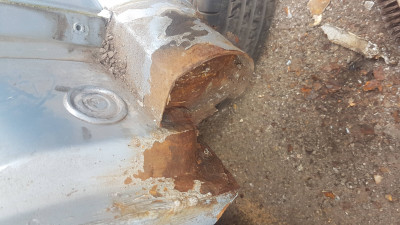

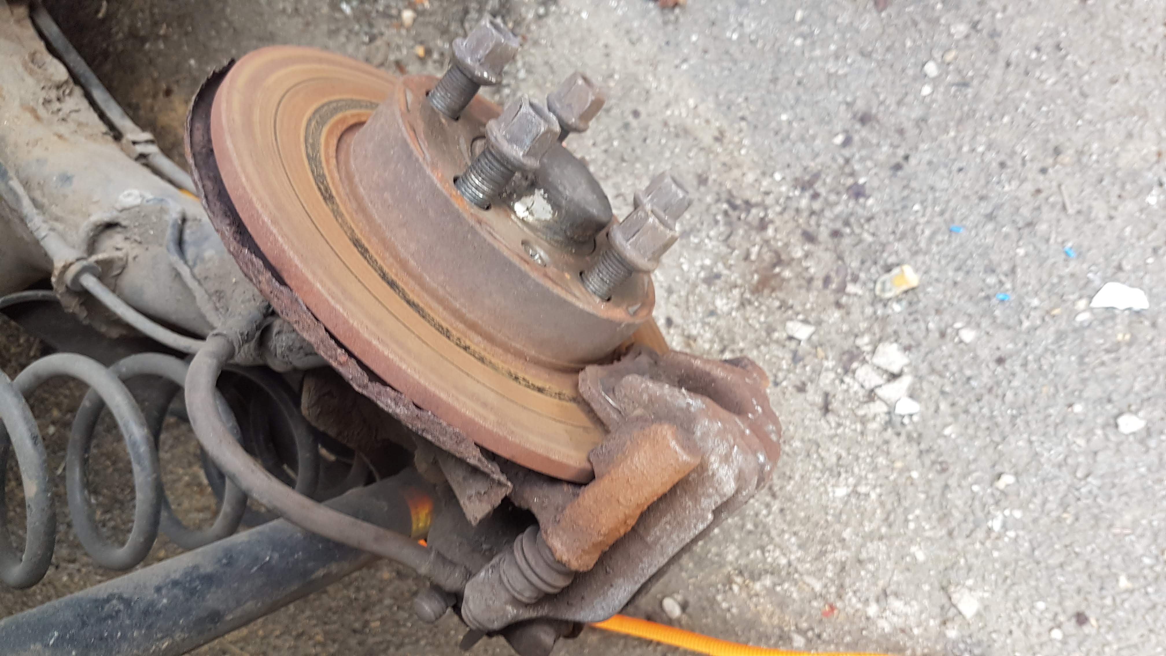

I checked the MOT history and just before I bought the car it failed:
"Rear Brakes imbalanced across an axle Axle 2 (1.2.1 (b) (i))"
"Offside Rear Service brake excessively binding (1.2.1 (f))"
So I'm awaiting new pads and discs to be delivered, hopefully that and cleaning up some corrosion on the calipers will sort that. While there, I noticed some corrosion around that also needs addressing and a patch welding in on the sill.

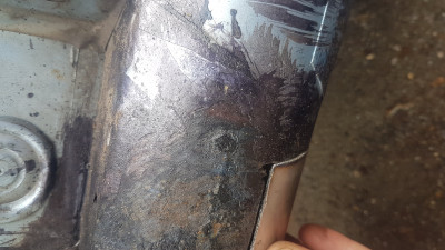

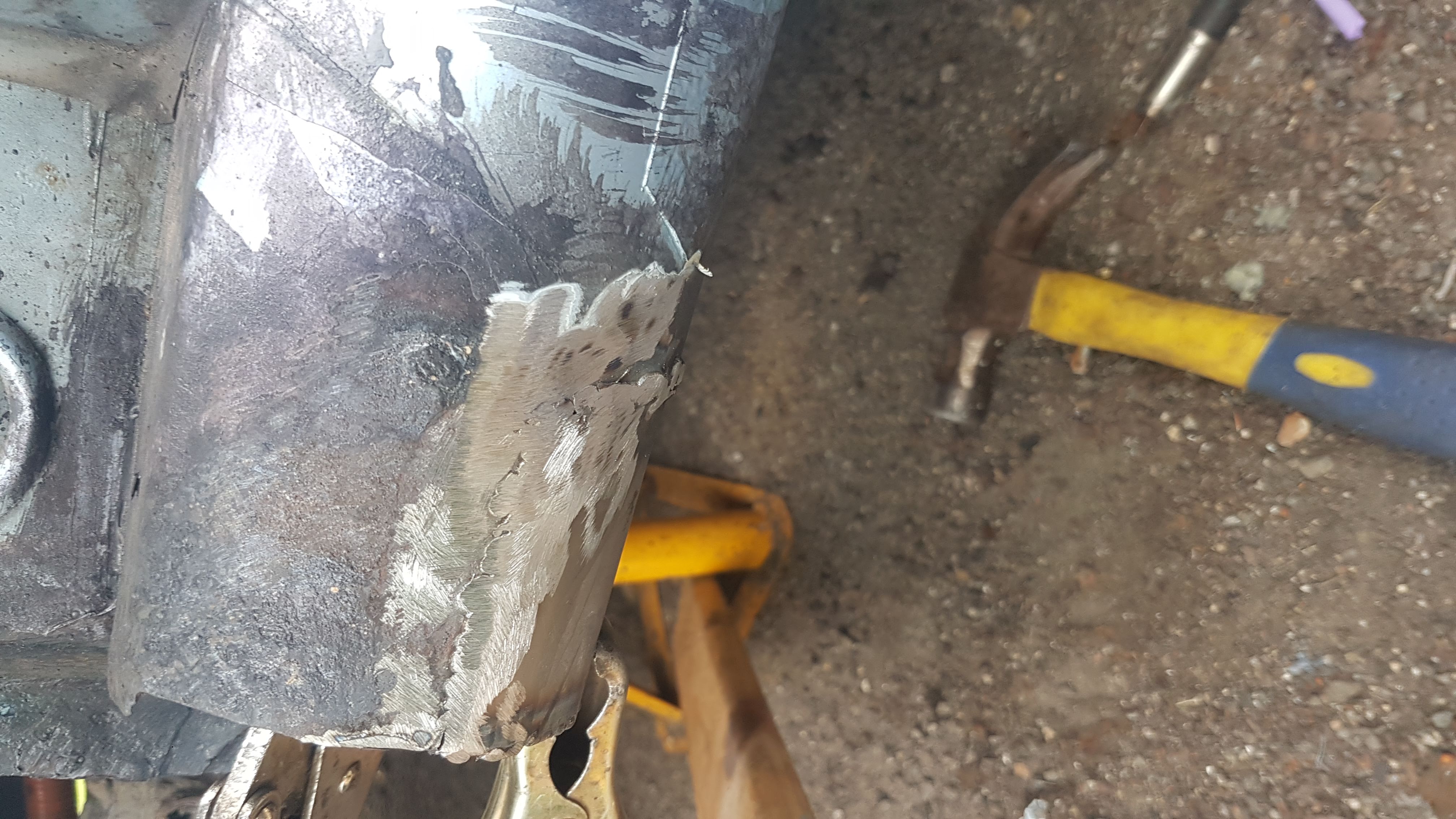

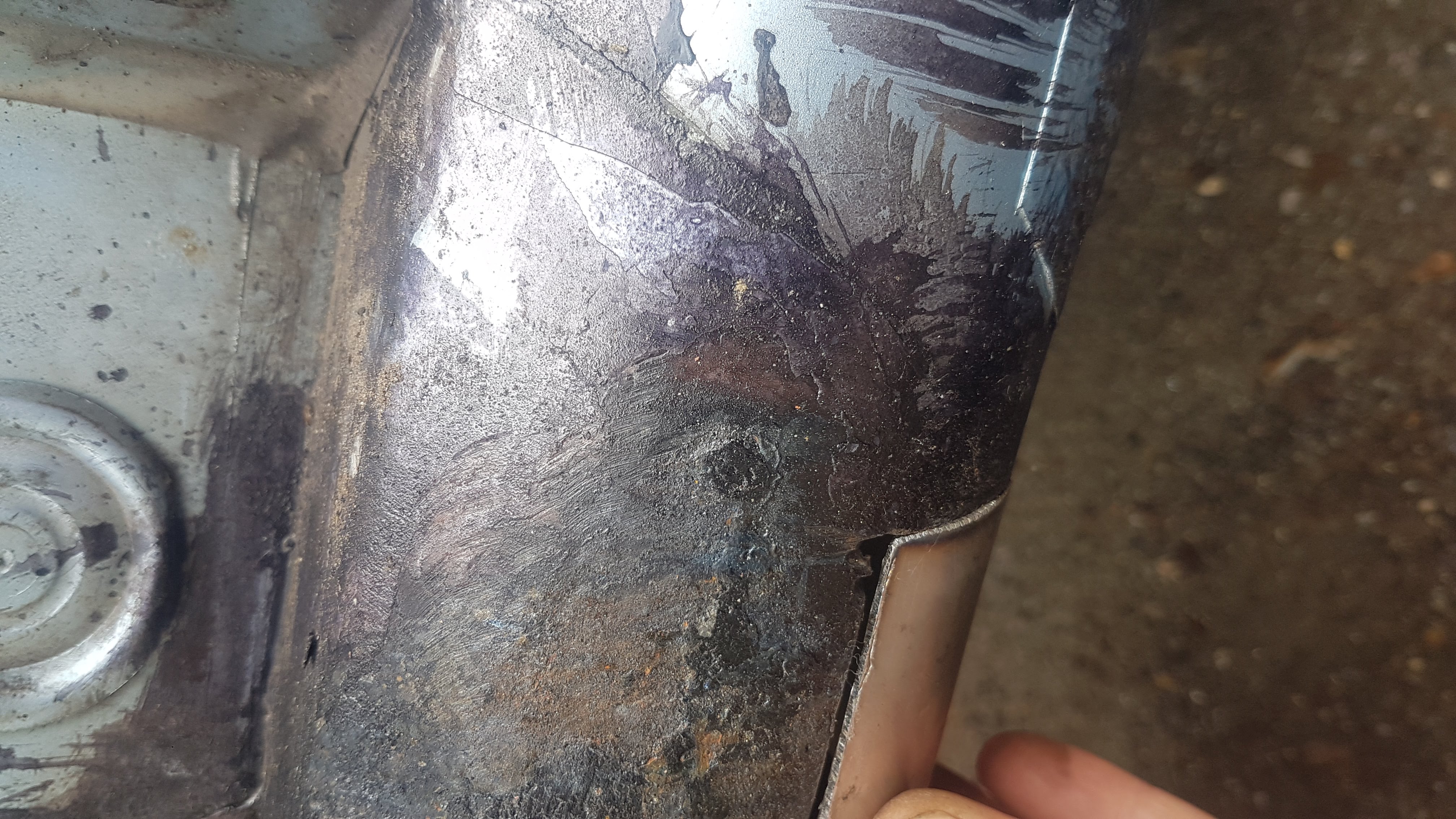

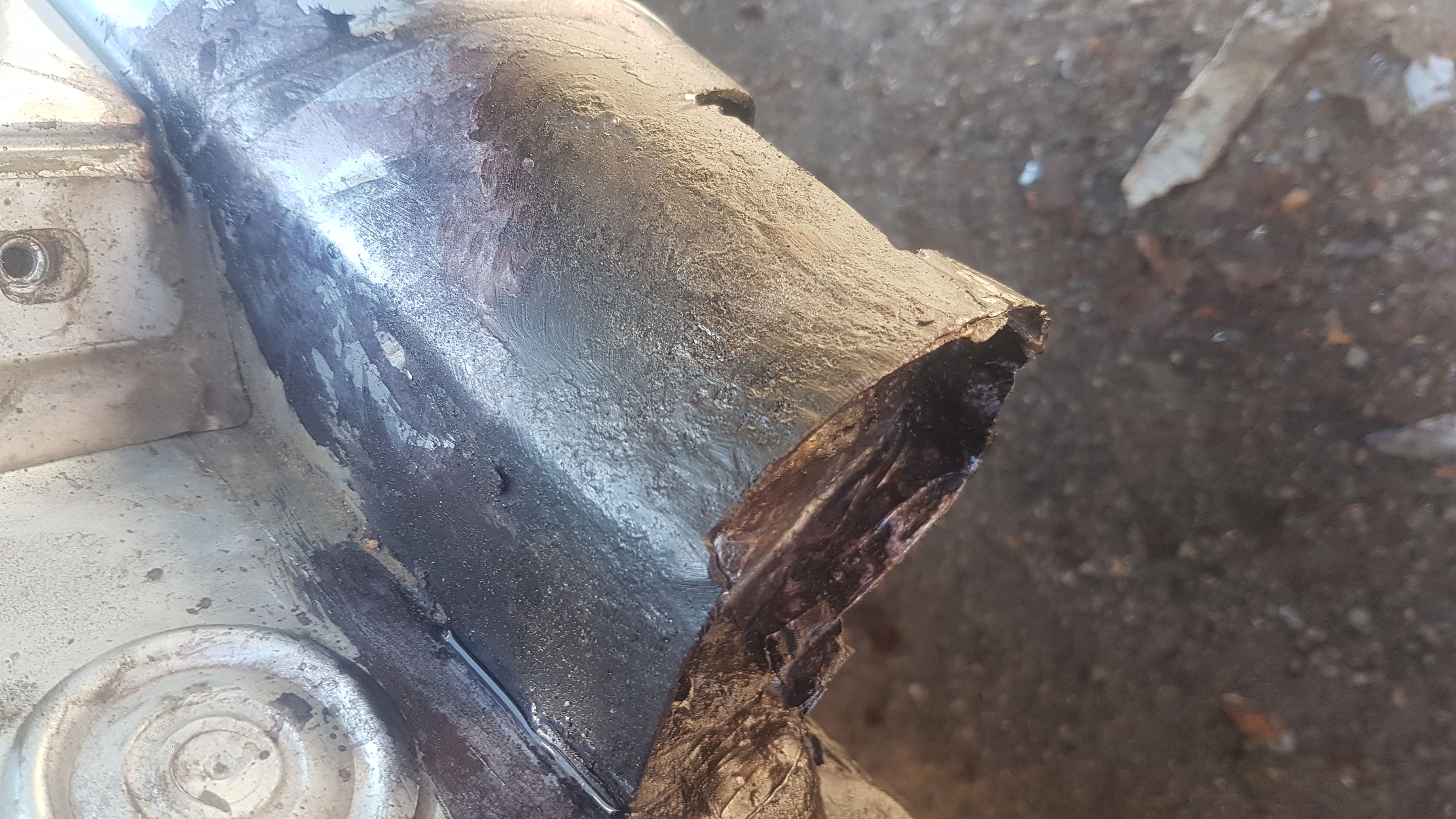

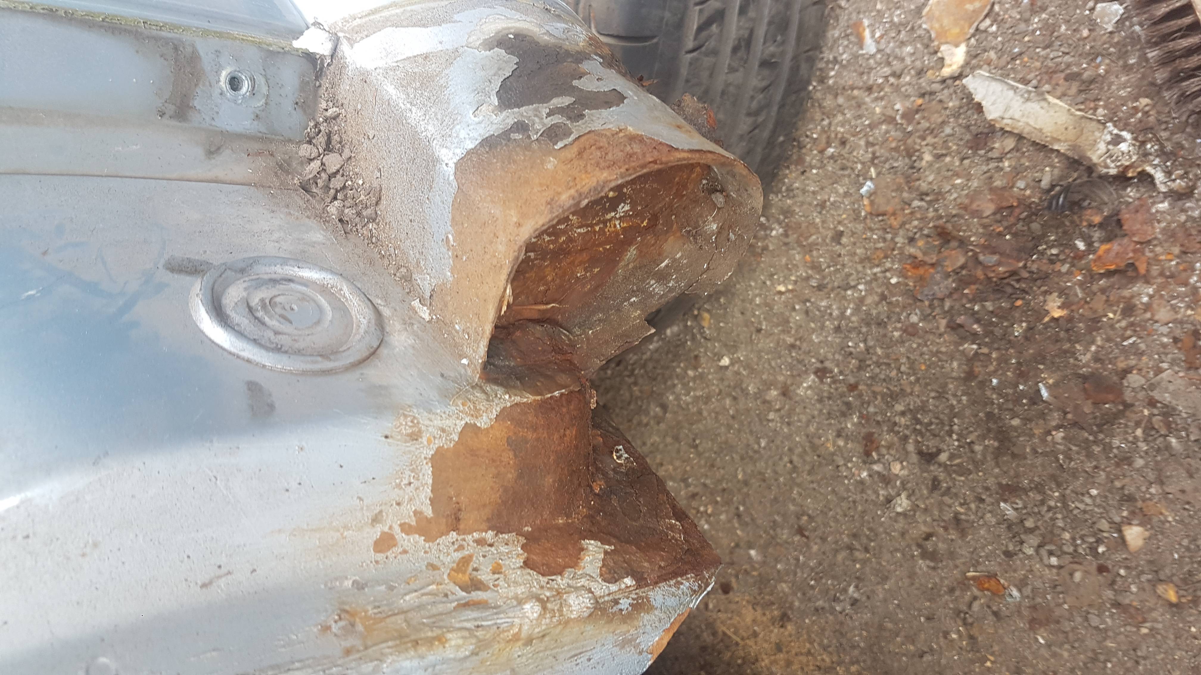

Repaired the rotted bit of sill, thankfully it's under the plastic arches so it doesn't need to look good.
Bad news is, I've lost rotation again

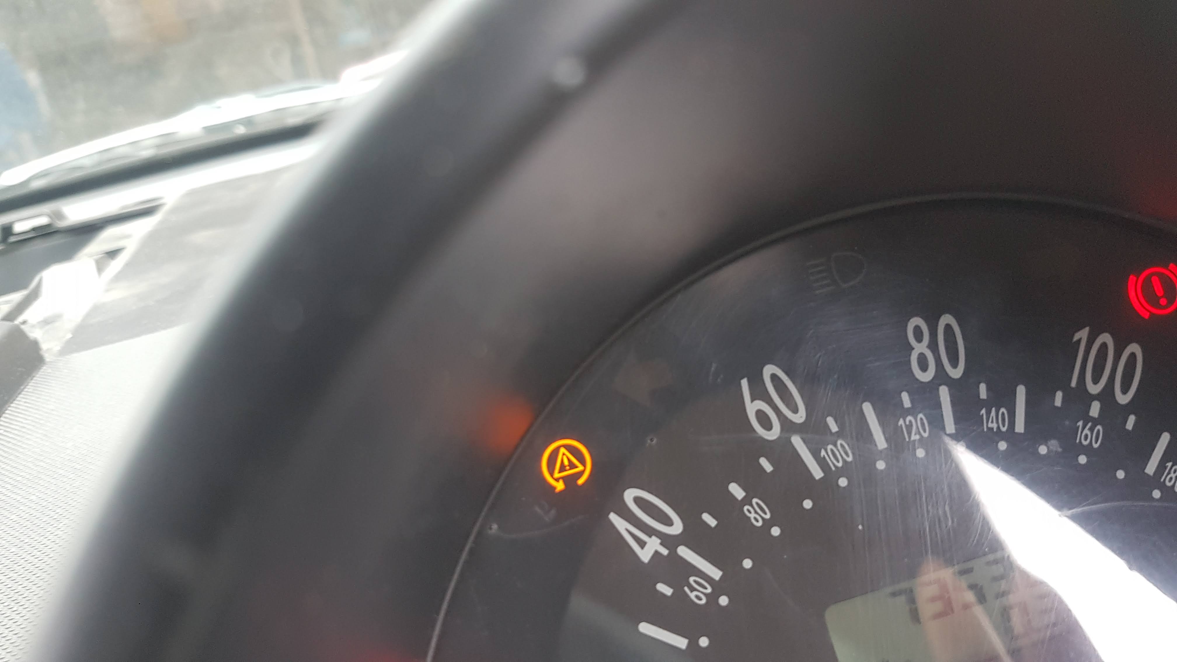

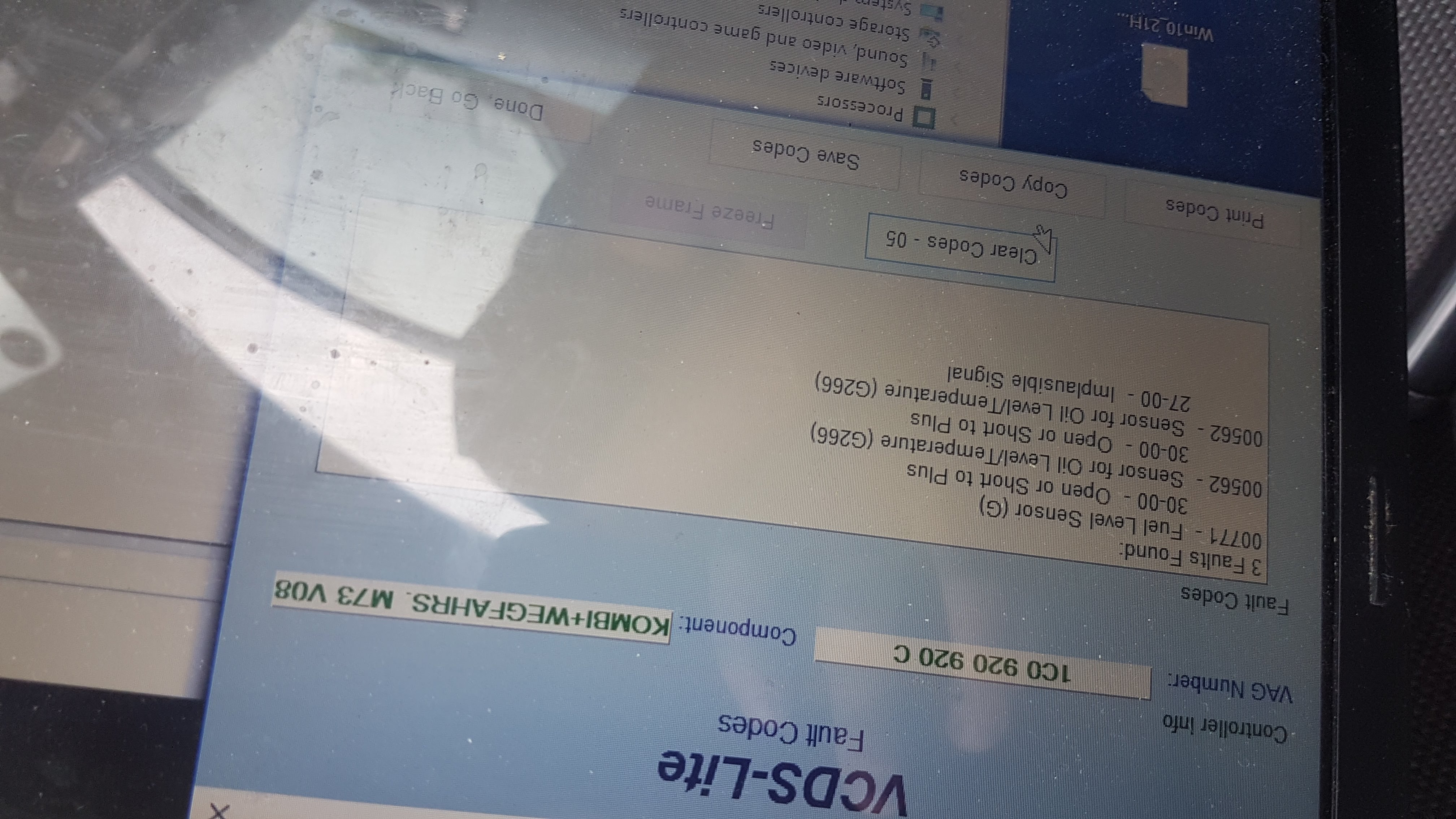

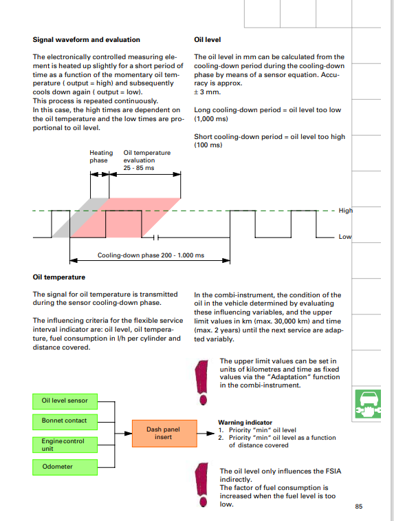

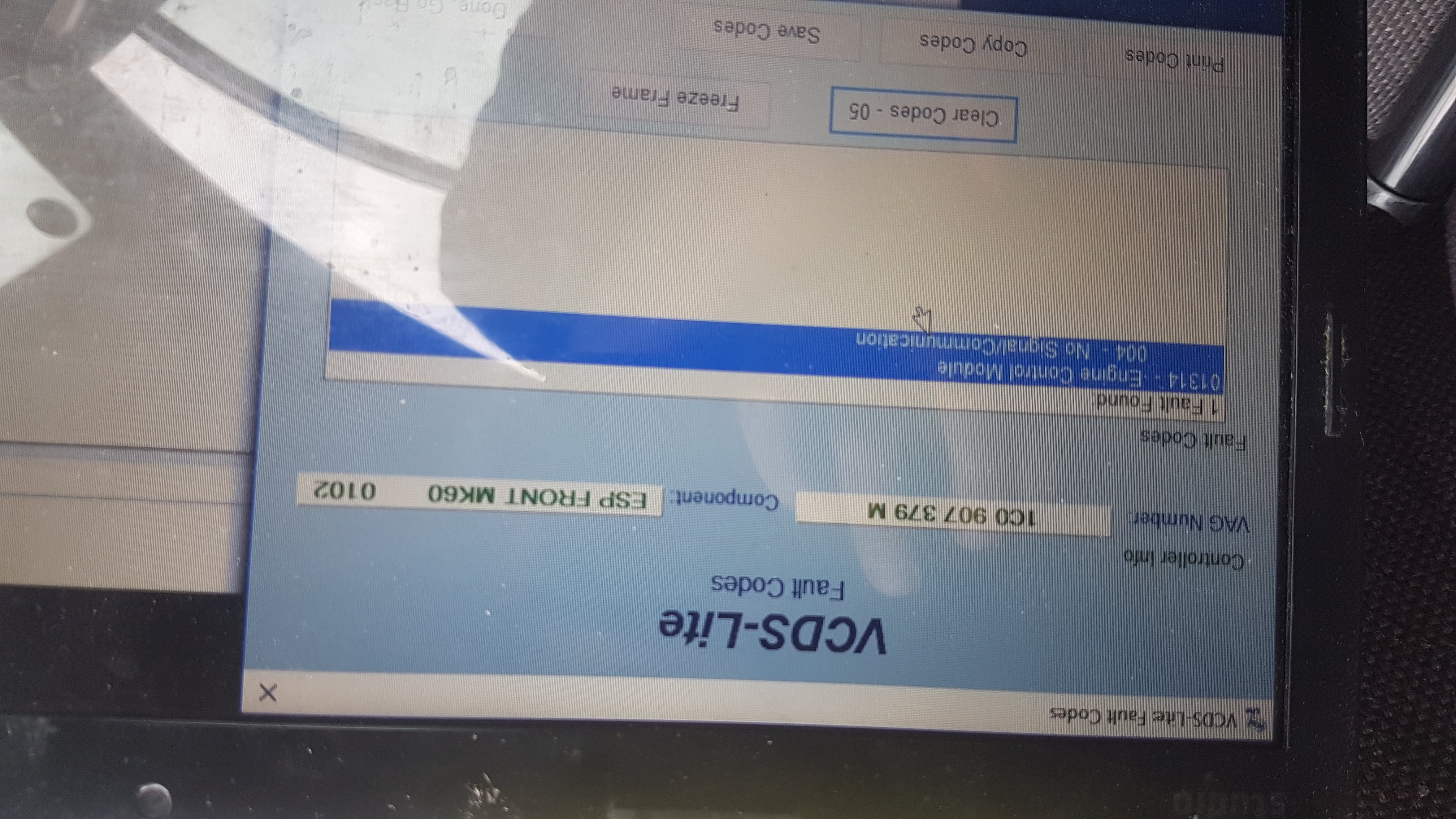

Got 2 error lights on to deal with. It looks like I might have to do something different to @johu on the Tourran.
- Posts: 3795
- Has thanked: 166 times
- Been thanked: 411 times
Re: VW - Beetle 2003
Do you keep your ecu connected? Then you can just use correct resistance instead of sensors and keep oil temperature in 90ies.
When i was trying to convince my Pug BSM(french ecu) that motor works i had to use coolant temp sensor with parallel resistance (ecu expected heated engine) otherwise it would throw DTC. It thought motor was out of coolant!
Also you can use your fuel level sensor to show SOC level or just show it 300R for EU cars.

I didn't keep my ecu, doh. I plan to eventually show soc on fuel gauge but for now, just get if of errors. Will have to do some research
*EDIT* Looks like PWM of some sort that I need.
- Posts: 3795

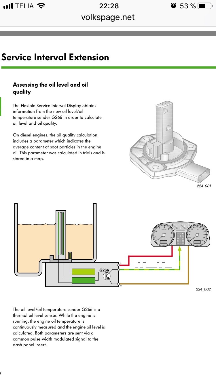

Try 1Khz signal 5V or 12V and try varrying duty. Usually it is 1Khz 30% to 75% duty for fans and pumps, i see no reason it shouldnt work for sensors too.

I've found a bit more info, apparently there's a sync pulse then 2 further pulses, then width of them varies with temperature and level. Trying to extract more information.
Maybe I can disable it in the instrument like Johannes did, though the seem procedure doesn't work.
