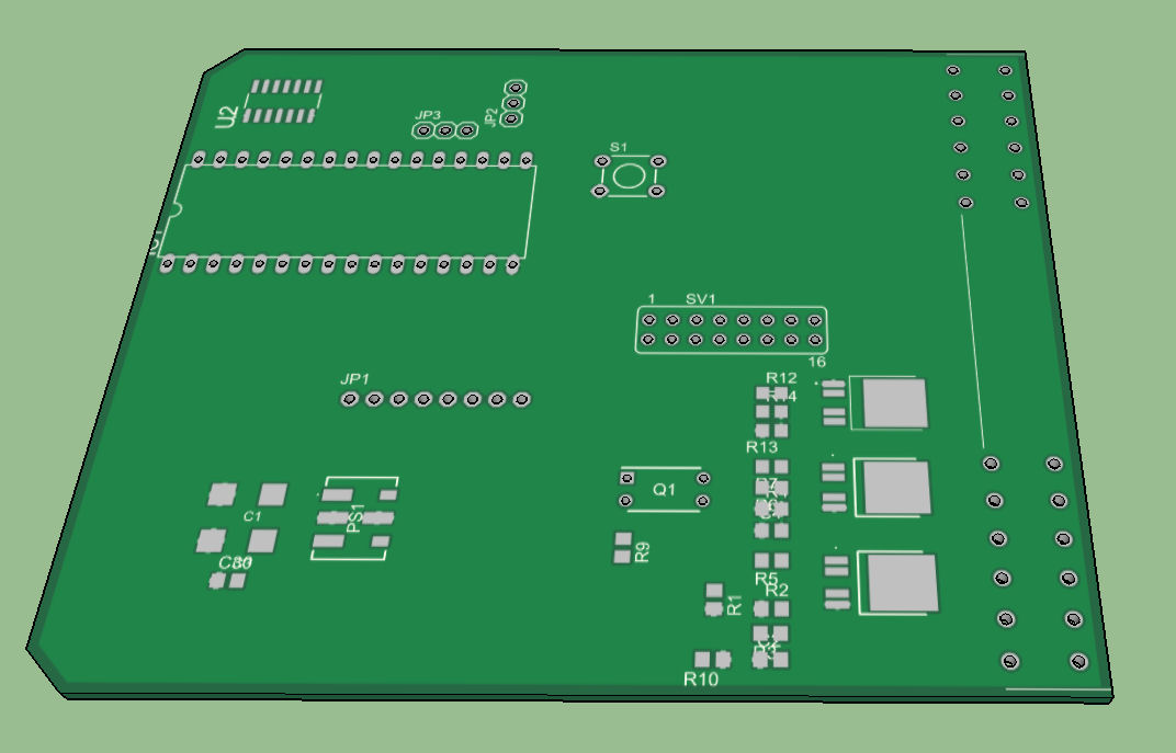

@explorer232 : Are you planning on open-sourcing the Blender/stl files for your converter plug/socket? I'm interested in going down that route, based on a Raspberry Pi4b, AR7420, and Waveshare RS485/CAN HAT to talk to a Nissan Leaf 62kWh (2001 model).
My initial thought would be to build the plug/socket unit, minus the HV connections, to test out the HomePlug and CAN-bus comms, so being able to build this cheaply would be a good start.

hwthomas wrote: Wed Nov 29, 2023 3:08 pm @explorer232 : Are you planning on open-sourcing the Blender/stl files for your converter plug/socket? I'm interested in going down that route, based on a Raspberry Pi4b, AR7420, and Waveshare RS485/CAN HAT to talk to a Nissan Leaf 62kWh (2001 model).
yes it will be open-sourced.
At the moment I am waiting to CCS combo socket from ali to test my design and I am working on chademo shield for foccci board.
I hope that PIN 7 on the chademo plug (car side) is sufficient to powering this converter.
