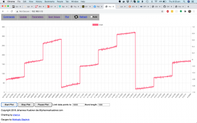

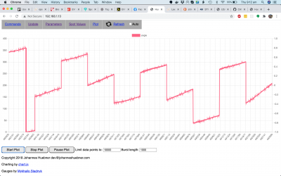

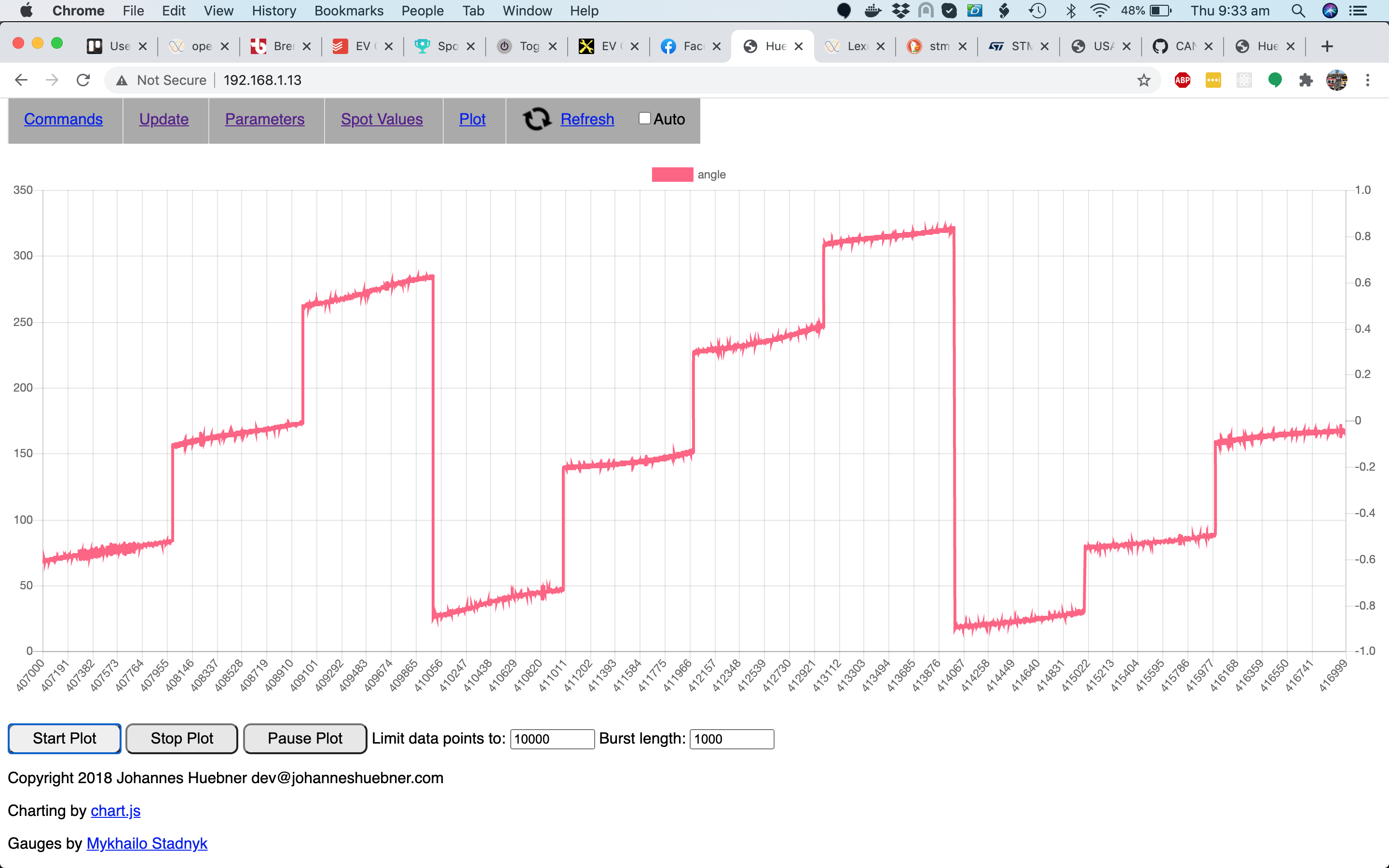

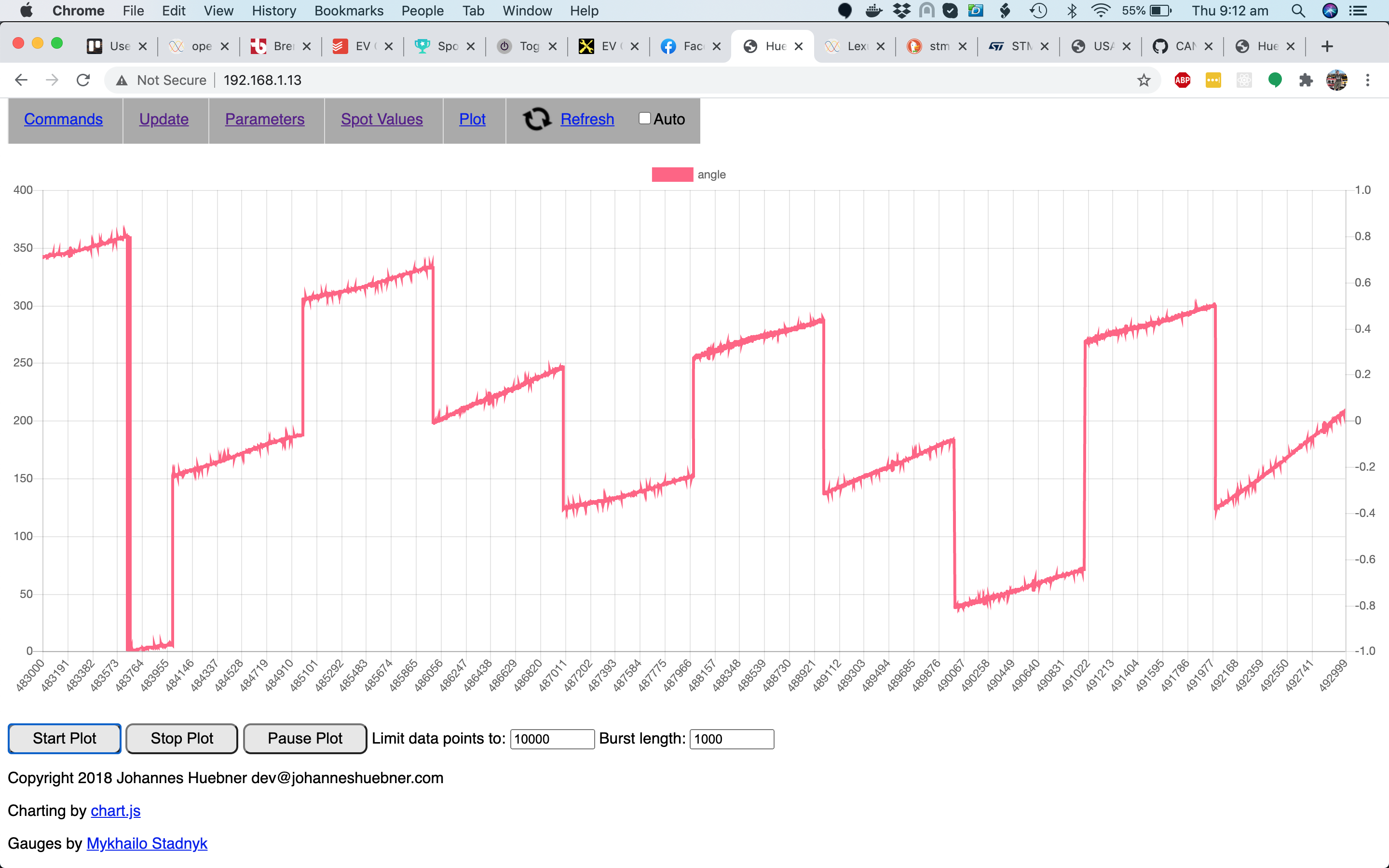

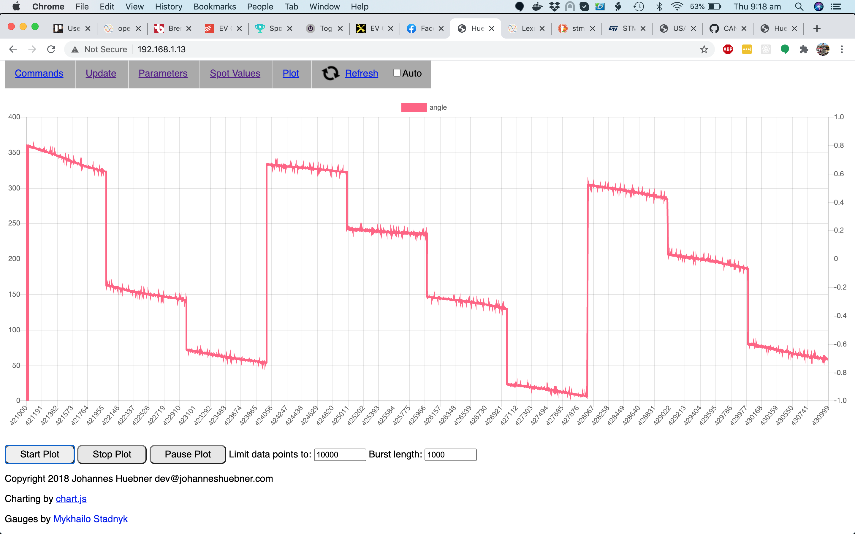

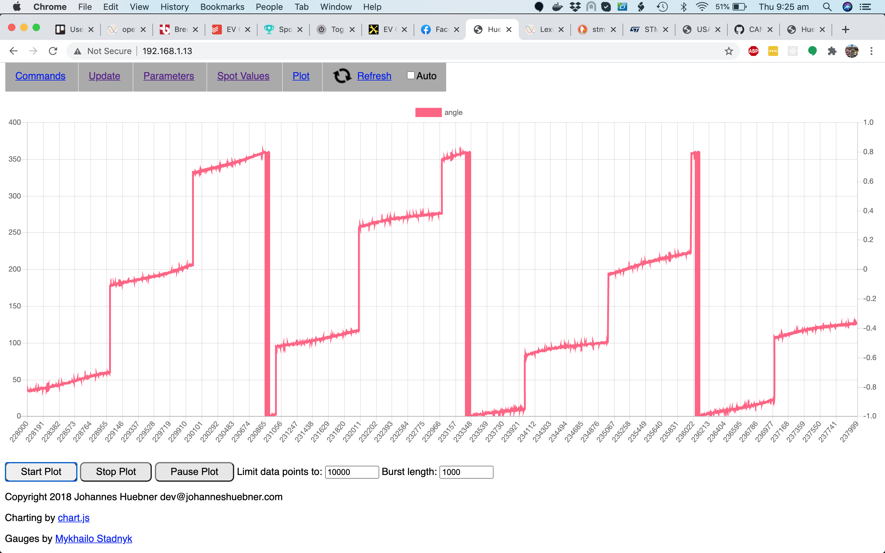

This is what I have mounted:
I get a reading now but it is not full 360 degrees but varies from around 120 to 240 when I spin the motor. Is the signal voltage wrong and how would I solve this?
