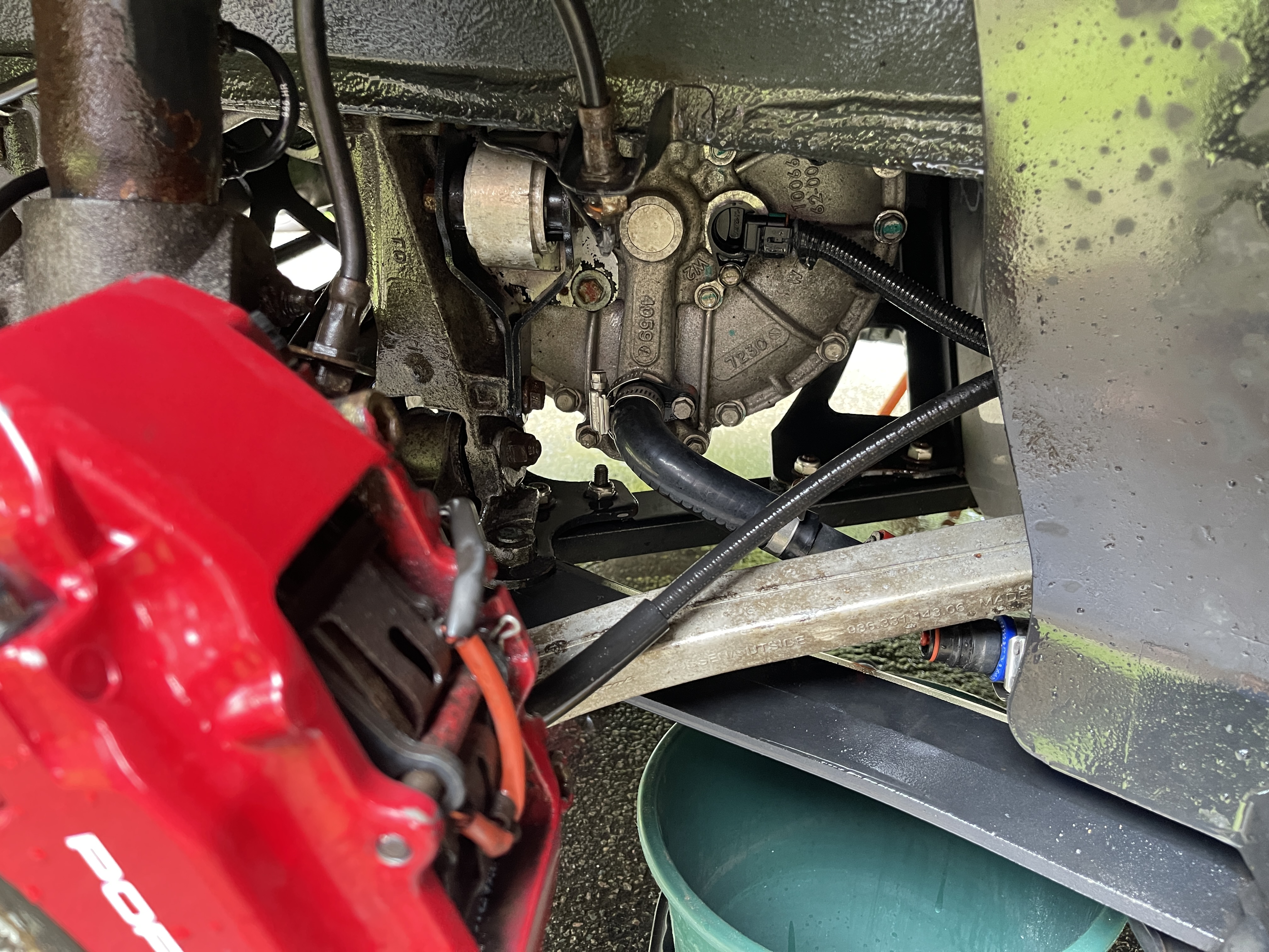

by Boxster EV
I’ve bitten the coolant delete bullet too. Just fitted this from Revolt Systems in California. My car is used as a Daily, so didn’t have the time to have off the road whilst the existing manifold was modified. Took about 2 hours to fit.

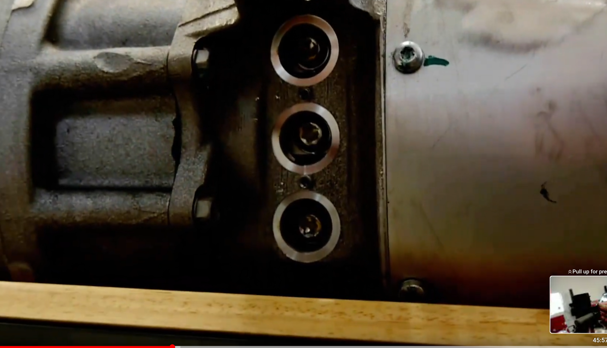

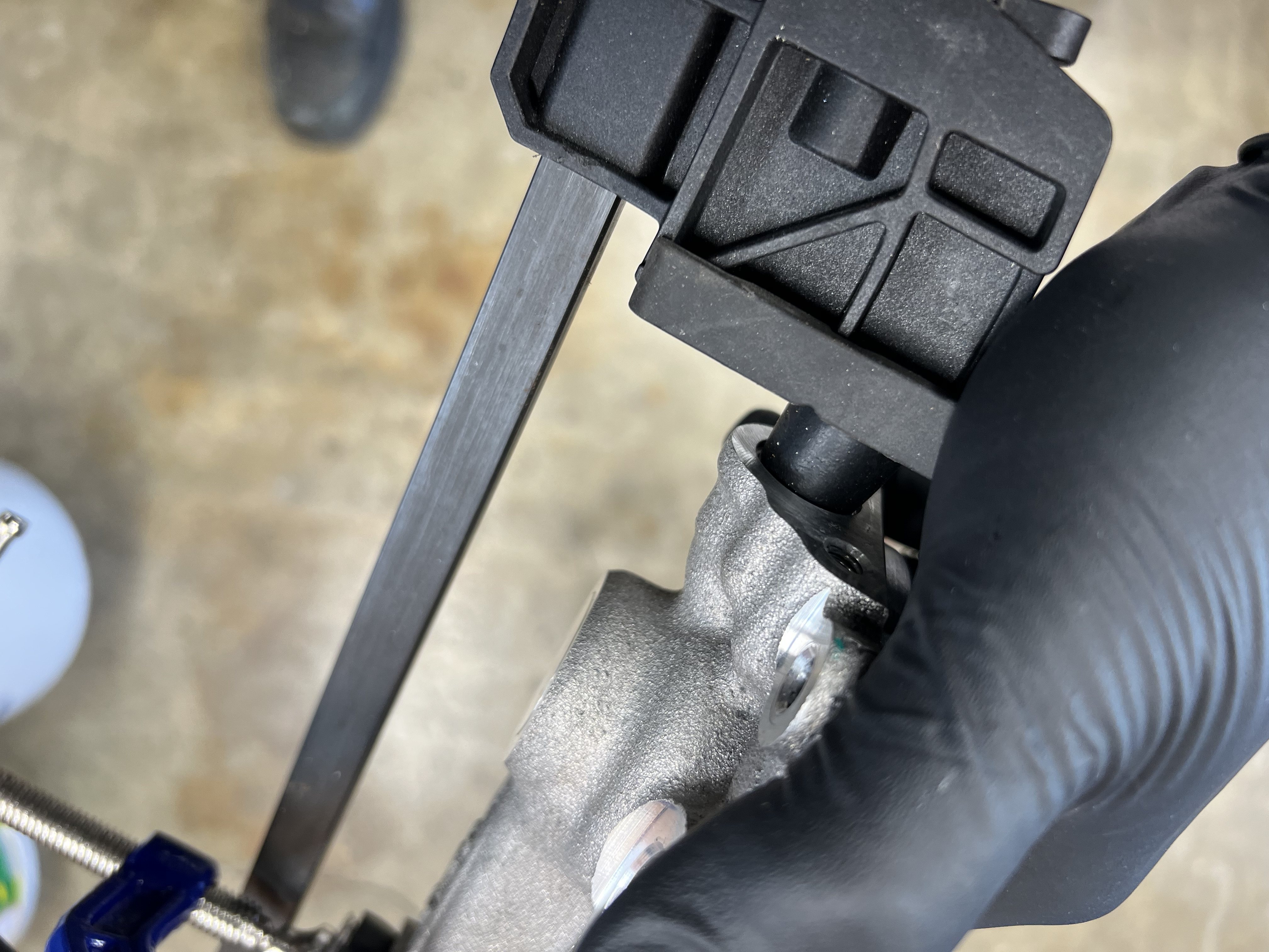

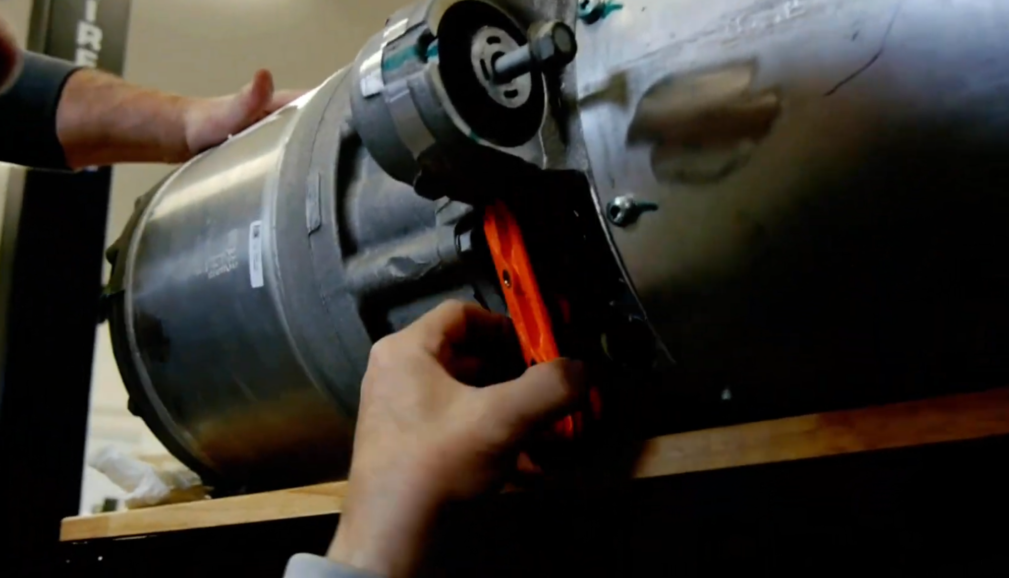

Some notes & pics on my journey:
LDU rotor cooling bypass ("Coolant Delete") modification
LDU rotor coolant bypass plug
LDU special disassembly tools
LDU Rotor End Cap removal tool

Posted: Mon May 06, 2024 7:16 am
by sirpewe
What do you use for seal material (brownish on the maifold)?
And do you have any drawing or cad file for the plug you like to share?
Or possibly if you can sell a plug? :)
Posted: Mon May 06, 2024 12:07 pm
by asavage
sirpewe wrote: Mon May 06, 2024 7:16 am What do you use for seal material (brownish on the maifold)?
That picture is misleading; if you follow the link, it makes more sense. The red gasket you see above is for the pressure test jig I set up to provide proof positive that the plug would not leak.
The red gasket is not used for mounting to the LDU.
sirpewe wrote: Mon May 06, 2024 7:16 am And do you have any drawing or cad file for the plug you like to share?
Follow the link, please.
sirpewe wrote: Mon May 06, 2024 7:16 am Or possibly if you can sell a plug? :)

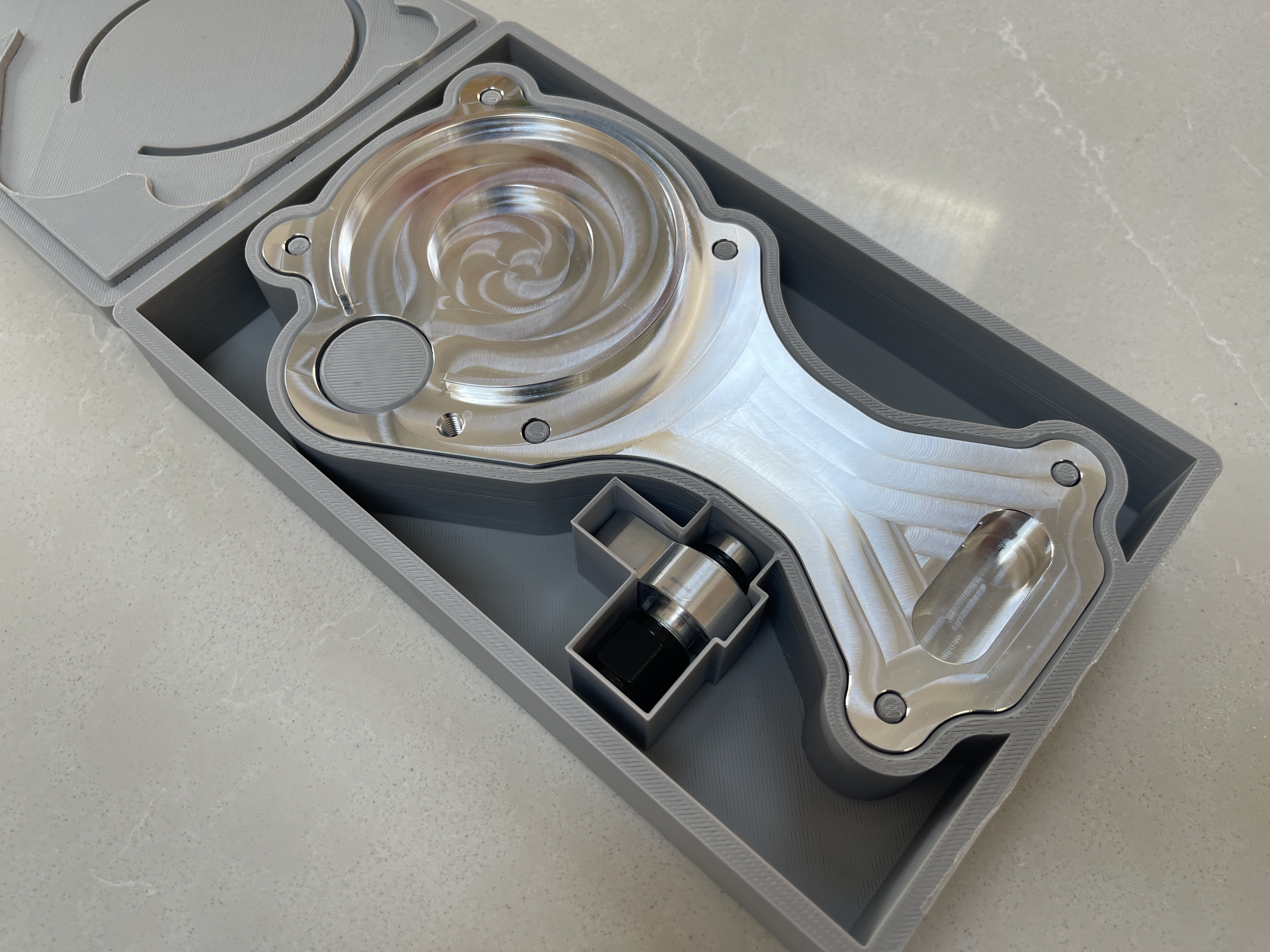

Howard & Mr. Hyde have a batch of SS formed sheet metal plugs coming, that will be cheaper than machined aluminum ones like mine. If you follow that link, you'll read that my two plugs were machined locally by a fellow who doesn't want to get into production; he does only one-off prototype stuff like this.
If there was sufficient demand, I could have a run made by eMachineShop.com . If I bought around (50), I could sell them for about $30 + shipping, but I doubt there will be sufficient demand, and the SS sheet metal plugs will be cheaper; most people will probably want to go that way instead.
I prefer the machined aluminum plug, myself.

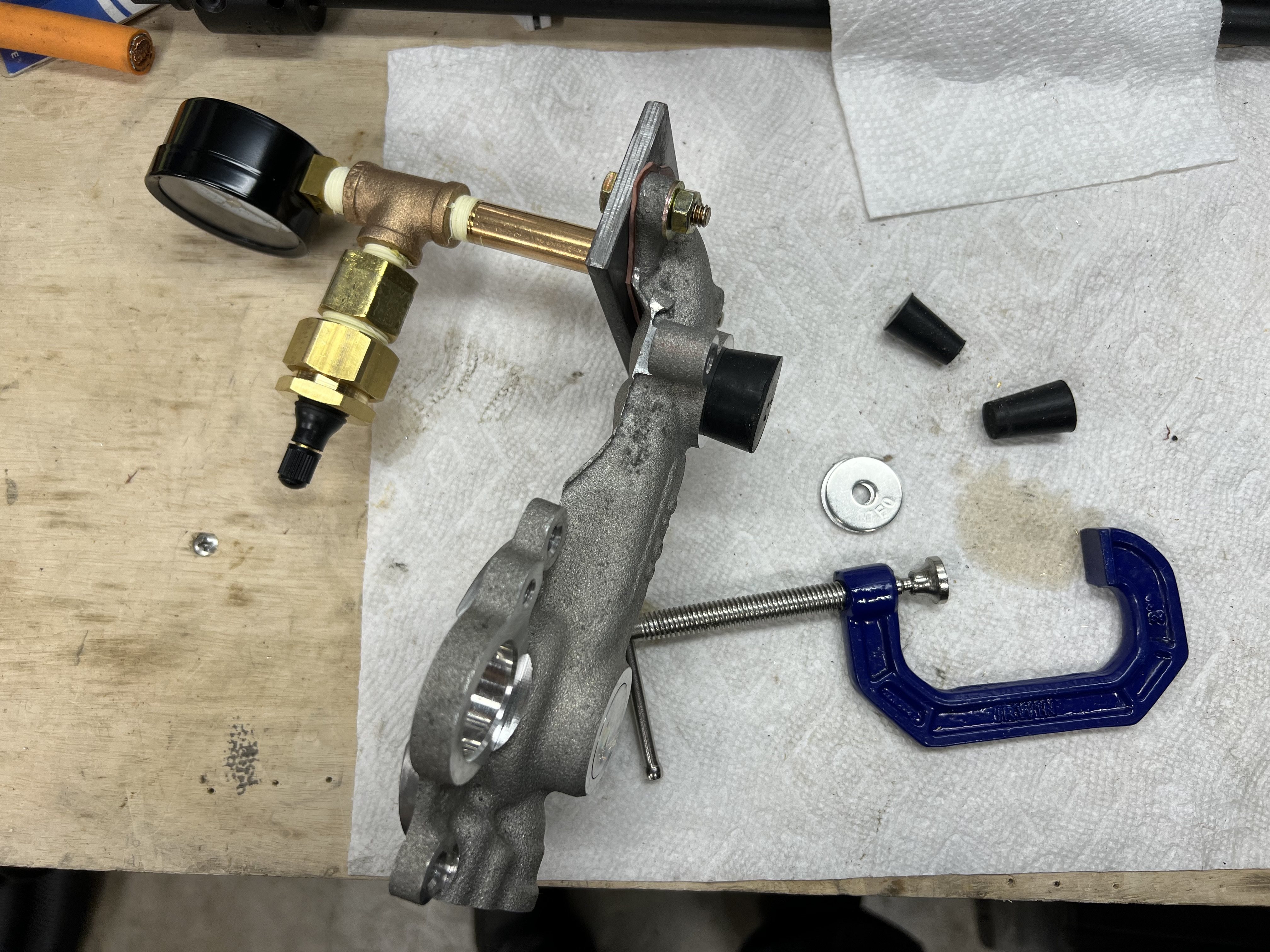

by asavage
The second plug, .005" oversize + Loctite 640, passed 30 PSI for two hours with no leakage. 30 PSI pressure differential is at least ten times what that plug should ever see, so I was satisfied with the result.

Boxster EV wrote: Sat May 04, 2024 3:37 pm I’ve bitten the coolant delete bullet too. Just fitted this from Revolt Systems in California.
While machining a part such as this is relatively straightforward for those with the skills to draw it and with CNC, what will impress me is when somebody will start offering the various formed o-rings for the LDU. AFAIK, these are currently unobtainable, and having bespoke formed o-rings made isn't as simple as handing a drawing and a slug of metal to your local machinist . . . or is it?
I was verrrry careful handling mine, knowing that if I damaged or lost one I'd be unable to replace it.
Posted: Wed May 08, 2024 2:02 pm
by Boxster EV
asavage wrote: Wed May 08, 2024 1:41 pm While machining a part such as this is relatively straightforward for those with the skills to draw it and with CNC, what will impress me is when somebody will start offering the various formed o-rings for the LDU. AFAIK, these are currently unobtainable, and having bespoke formed o-rings made isn't as simple as handing a drawing and a slug of metal to your local machinist . . . or is it?
I was very careful handling mine, knowing that if I damaged or lost one I'd be unable to replace it.
Yes, they are seemingly unobtainium. I have a couple of spares that I managed to source from broken drive units. I also ran a very light bead of high performance RTV over contact surface to make double sure it sealed.

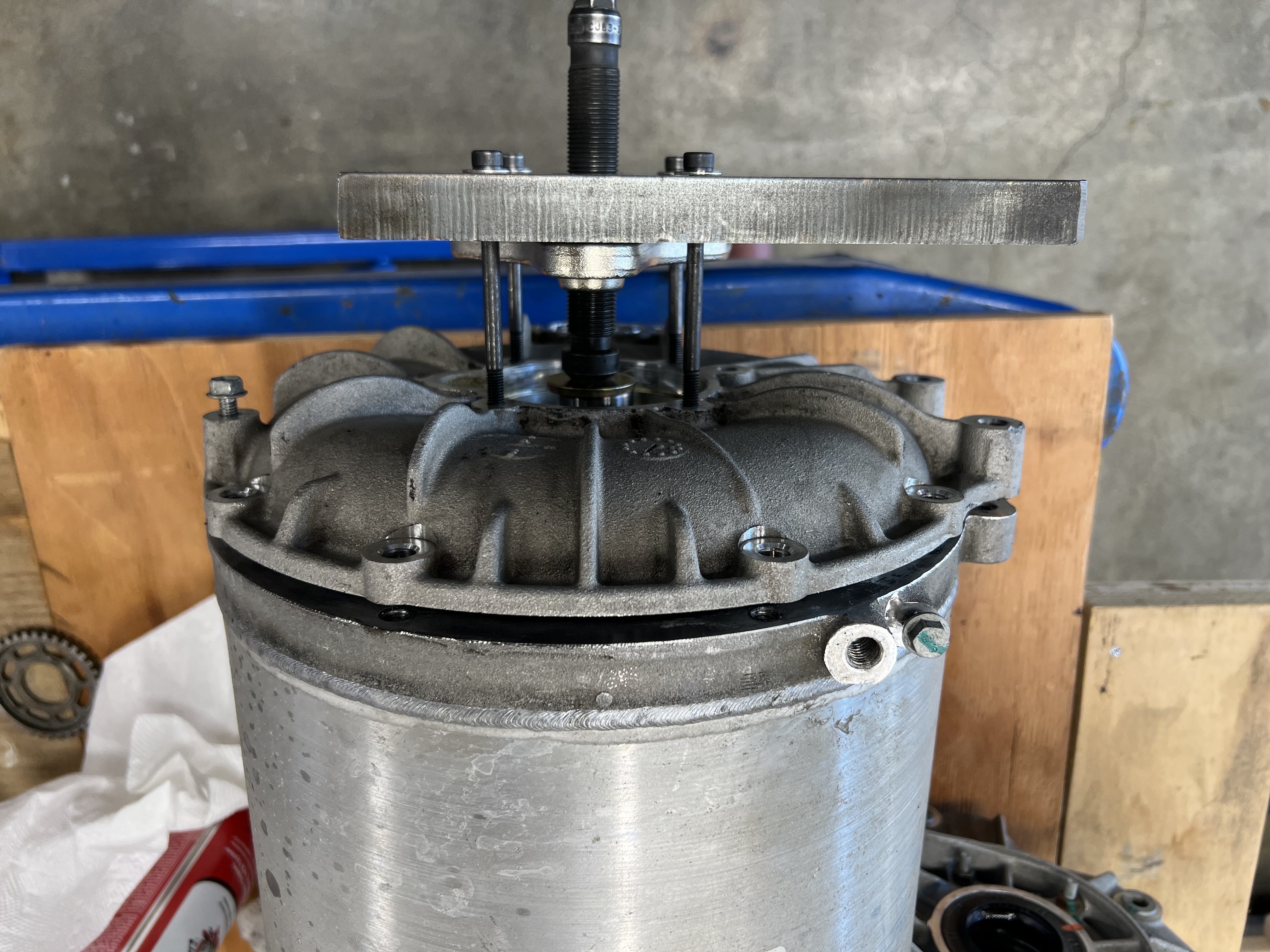

A couple of things here.
Cleaning the rotor isn't going to change the measured isolation resistance, because there's no electrical connection (at 500v or less) to the HV portions of the LDU. I mean, we clean the rotors, of course, when we have them out, but do they need to be cleaned? No.
Removing the rotor wasn't a walk in the park for my recent LDU repair; I fabricated a fixture setup to allow enough pulling force to remove the rotor with the inside bearing remaining in the case.
LDU rotor puller split shaft collar
LDU rotor puller
LDU rotor puller
LDU rotor puller setup
It wasn't simple or easy, but other than replacing the inside rotor brg., it allowed me access to as much of the stator as is possible. I was able to use a water-based cleaner and surfactant to remove all the coolant and corrosion byproducts from the exposed stator laminations, "wash" the exposed surfaces, blow warm air on the stator for a day, then douse everything I could with IPA (99%! not 70%!) to further dilute any remaining water that stubbornly wouldn't evaporate.
Having said all that, a user reports having three unsalvageable LDUs with shorted (low iso) stators right now; not all low iso stators can be "dried out". There are shops that are removing the stator from the case and rewinding/repotting them, but I have almost no info on this myself; you can readily find more on YT, etc. but I don't think of this as an economical path in the US at this time; it's certainly less expensive to find a less-soaked/higher iso stator/gearcase, than to try to rebuild a wet stator here.
You have to dry it out, to the best of your ability, before reassembly. It will not dry itself out later. I suspect that by no pulling your rotor and cleaning/drying as much as you could access, you may have been recycling old moisture in your LDU.
Yes, removing the rotor seems to be the most challenging part, hence why I attempted to avoid it (and likely have created more work for myself). Good example of one way to do it, thank you. Seems better than snatching/dropping the drive unit.

IDK the spec on your MS (you have a GEN2 Rear HVJB and OBC, so it's Jan2014 or newer) but the GEN1 spec (during testing) is 1.8Mohm min. for the entire HV system (with the contactors open ie the HV battery not being under test) -- see pg. 6 of the Isolation doc. I linked above (again, this is for others following along). So, testing just one part and getting that low reading . . . is bad.
Thanks for showing your test methodology. This tests the HV leads to the LDU but not the stator because, as you noted, the stator is not actually in circuit when not powered by the IGBTs. That 0.9Mohm is quite troubling. I venture to guess that there's an issue with those leads to the LDU themselves, which is a failure point I've seen mentioned elsewhere sometime in the past. Corrosion at the plug-in EMC shields grounds/glands? This is good news, yes?
Yes, you can test the stator windings at the 3-phase HV wiring at the center of the gearcase, under that orange cover with the "do not disturb" iconography. For others (sorry for the poor lighting; these are found images, not mine):
LDU inverter/stator internal HV junction access
My experience on mine was that testing could be accomplished without removing those bolts and isolating the stator leads from the inverter leads; almost no change in test results occurred when I tried both methods. The access to these isn't horrible on the RAV4 EV, but IDK what access is like on the MS with the LDU in the car. As yours is on the bench, this'll be easy for you.
[later]
If your inverter side had had coolant exposure, it creeps up the small harnesses and usually causes errors that the customer sees, but I could theorize that it could also reduce iso enough to give the test result you're seeing. But I see that you have the inverter cover off, and you'd have said if you had any blue drops of death sitting in the cover's bottom.
