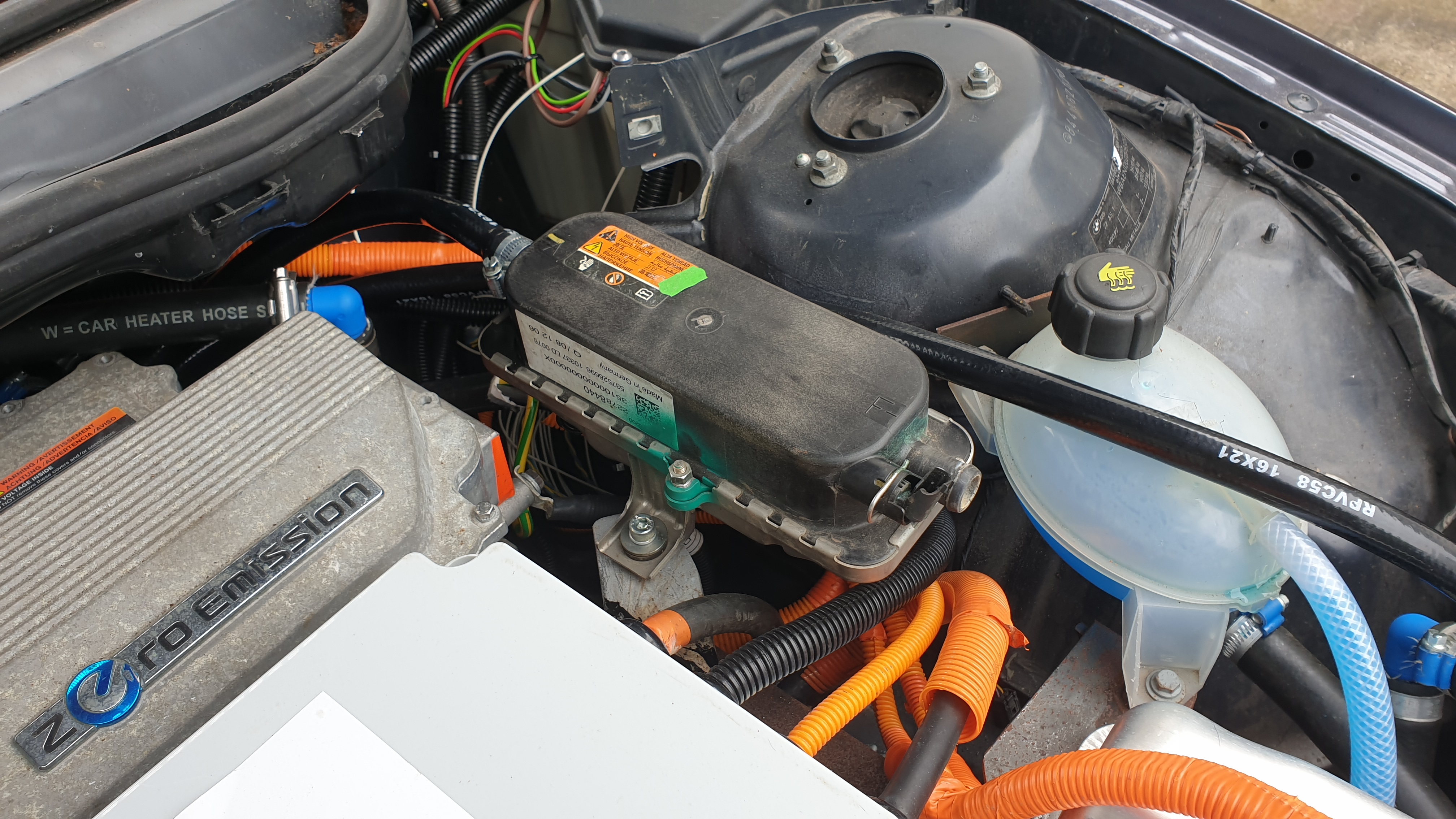

And on that subject
The new h/w will incorporate swcan for controlling things like the volt/ampera cabin heater now installed in the grey goose.

Yes please! That's great.Jack Bauer wrote: ↑Sat Mar 20, 2021 6:27 pm And on that subjectThe new h/w will incorporate swcan for controlling things like the volt/ampera cabin heater now installed in the grey goose.
