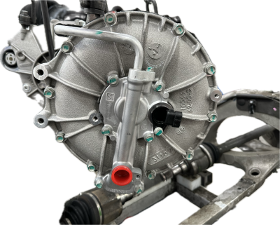

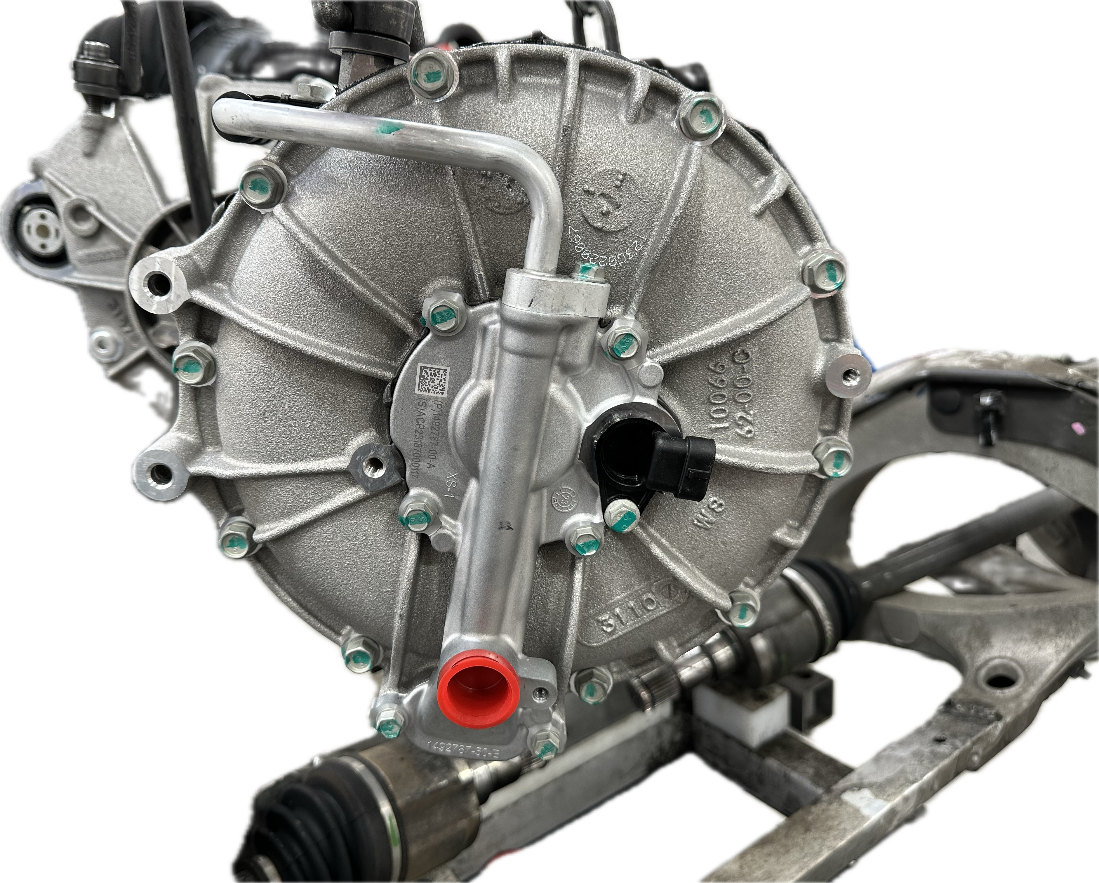

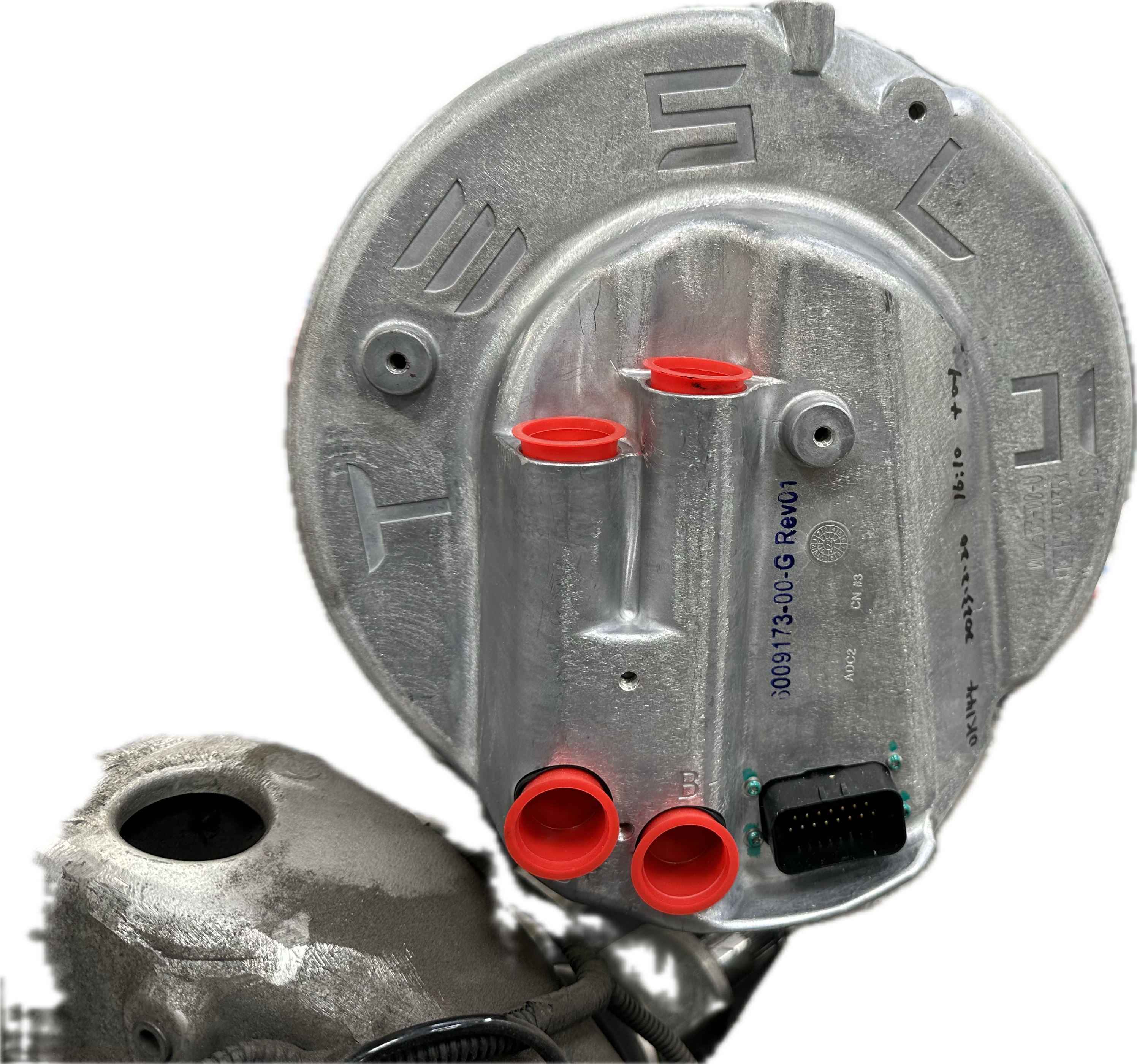

Hello everyone, I joined so I could add the pictures of the new 1002633-00-U Base-Drive-Unit here for everyone. These were taken in an Orange County Tesla Service Center.

blodg1 wrote: Wed Nov 08, 2023 8:40 pm Hello everyone, I joined so I could add the pictures of the new 1002633-00-U Base-Drive-Unit here for everyone. These were taken in an Orange County Tesla Service Center.
This seems to be a brand new LDU made in 2023. T23*** printed on the motor end plate shows it was first manufactured in 2023. And no R + number at the end means its wasn't a reman (R1 = 1st reman, R2 = 2nd reman etc). Can you confirm?
Quite interesting if Tesla is still making LDUs in 2023.
Hi! Great photos. Could you possibly be able to take the coolant connection from the motor? We would sure like to see how it looks inside. If the coolant really has been blocked from the rotor or not.

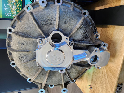

We're building our own version of a "rotor coolant delete manifold". This one can be used either as a straight up coolant delete (like the Rev U drive unit), or oil cooling can be added on for the folks that want it. We expect to have production ready units in stock starting in January.

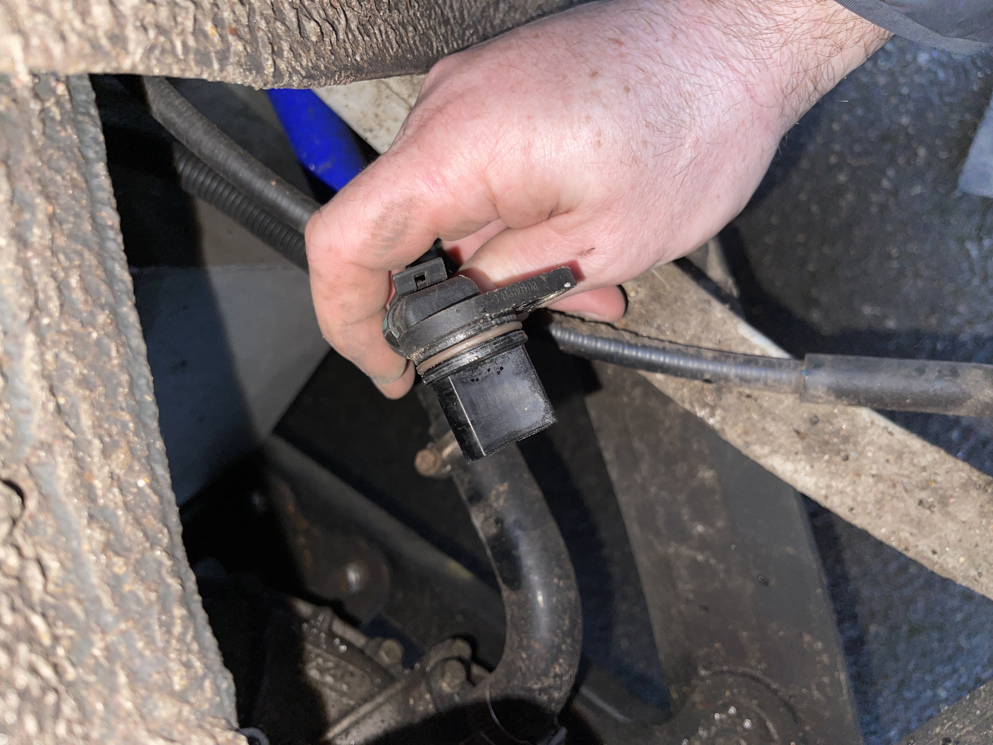

A small update regarding my SKF seal and speedi sleeve.
I pulled the encoder whilst fault finding this issue. The wheel was still dry. A little residue on the encoder but that might have been from the silicon used to seat the seal.
Edit: forgot to mention that I think that's 17k miles on this set-up but I haven't done many miles over the past few months.
